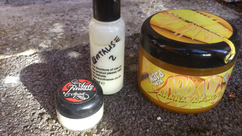

so my AF goodies were Revitalise 2 and spirit wax, all panels were treated to an application of Revitalise 2 and then 3 coats (applied over a period of days) of Spirit on the driver’s side and my regular wax of choice Dodo Banana Amour on the passenger side.
For point of reference, Menz SF4000/106a is my regular polish combined with AF Triple depending upon the task in hand.

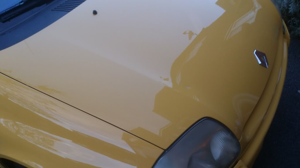

Referring to AF site, Revitalise 2 is the middle of a 3 polish range and listed as the mid range cutting polish capable of tackling medium to light paint defects. I applied this as instructed by DA applying at speeds 2-4-2. I also broke the rules and tried this by hand on the bumper.

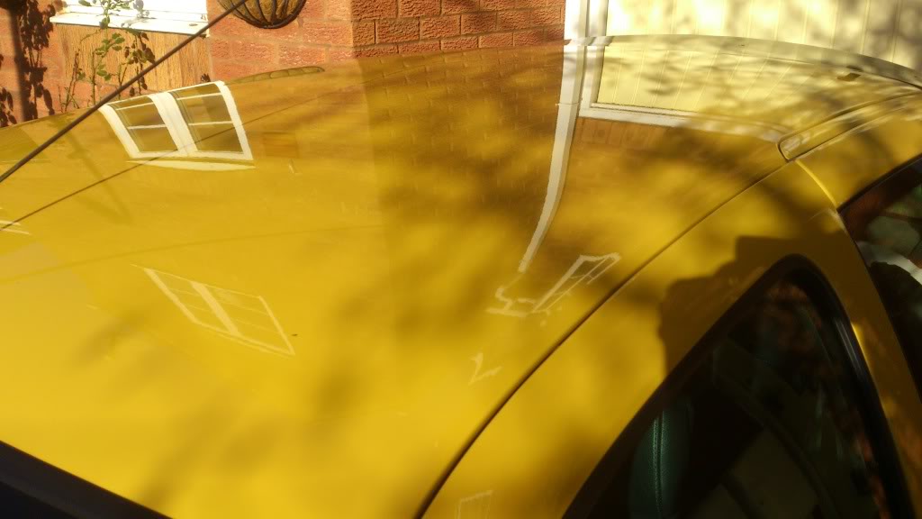

So impressions, Revitalise 2 has a thicker appearance to the Menz and almost more like the traditional G3 ‘mopping’ compound of old (yes guilty as charged but 15+years ago). On the first pass with the DA this spread across the panel nice and evenly and a little goes a long way. As the speed increased this broke down easily and as the speed then lowered back to level 2 the polish continued to clear. A final wipe down of the remaining residue and the results were pleasing. A nice crisp finish was left with a decent finish and most of the lighter swirls and scratches removed. Given another pass or with more familiarity I am confident of even better results.
For a keen amateur the results were fantastic, the paint felt wonderfully smooth, the colour richer and defects removed. What more could be asked.

As mentioned, my regular wax is Dodo Banana Amour and I find a few layers of this lasts a good season. The Spirit wax is about double the price of the dodo so I was interested to see the difference.
Initial impression was this was a much much softer wax. My first dap in the tub came out with a lot more wax than intended. Application was so easy, this has a really oily / buttery feel and spreads very easily and I was soon laying down a nice thin application. By comparison the DJ was a much ‘drier’ wax to apply.

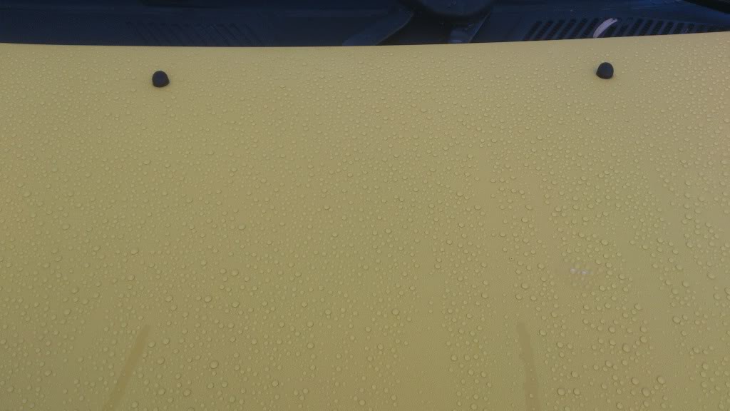

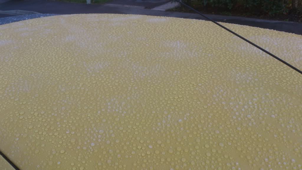

Unfortunately no beading shots yet, have to wait for the morning or the next rain shower.
