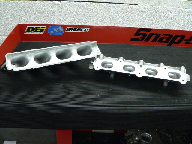

Going back to the car front, the stage 2 manifold. Is that a heavier worked inlet or the re modded plenum chamber ??
PLUS he still has aircon! lol

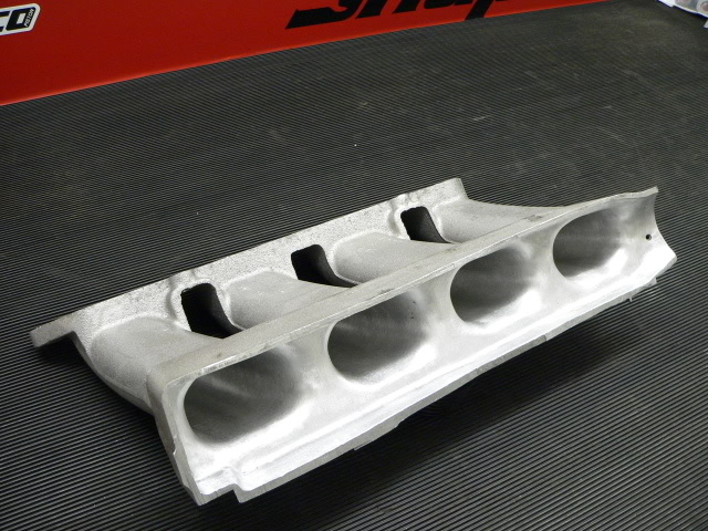

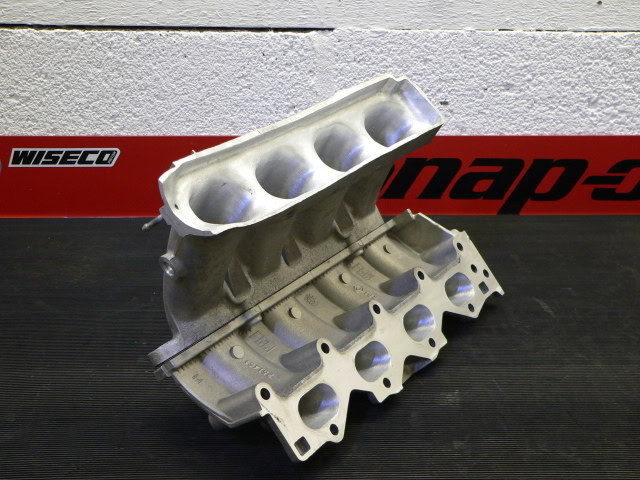

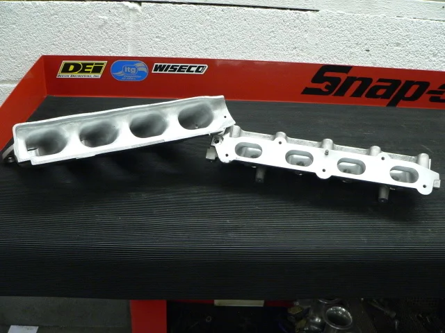

The stage 2 manifold is a frankenstein unit!

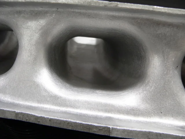

It is cut open and welded up to the hilt to fill the plenham, then i spend far too many of my hours grinding and grinding, shaping and smoothing to make the entries as efficient as they can be within the space available.
Then the FULL runners are reworked, opened up, reshaped, matched and flow substantially more than any std type inlet ever done.
Took a long time and was alot of work, so if anybody wants it being done again, it will require alot of pestering lol.

I do only do 2 stages.
However stage 2 i will no longer do for silly money like £400, there is just too much work involved.
Stage 2 when finished looks like a std inlet manifold and will work as one.

AngelWorks Technologies stage 2 manifold work

The stage 2 manifold and the omex are the only difference between what he had before at 208bhp and now. I predict that the manifold will support over 225bhp with a few tweeks as its still a std bottom end.

jon, the std inlet manifold cant be improved or worked on IMO, its a waste of time, it flows enough and you could probably get some good power if you could rev the thing high enough.
