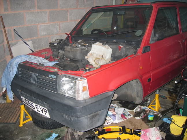

Fred2001Dynamic said:
Thin!!!!! bloody hell you do need your eye sight checking!!! its 4mm thick!!!
manfromhongkongbreakinret*****mould
engrishmanfix
rolly good
well you call it fixed........
Fred that Fiats talking longer to build than your own engine.
Can we put bets on the new engines power? Or better still its completion date? (I'll have 10/9/08).
