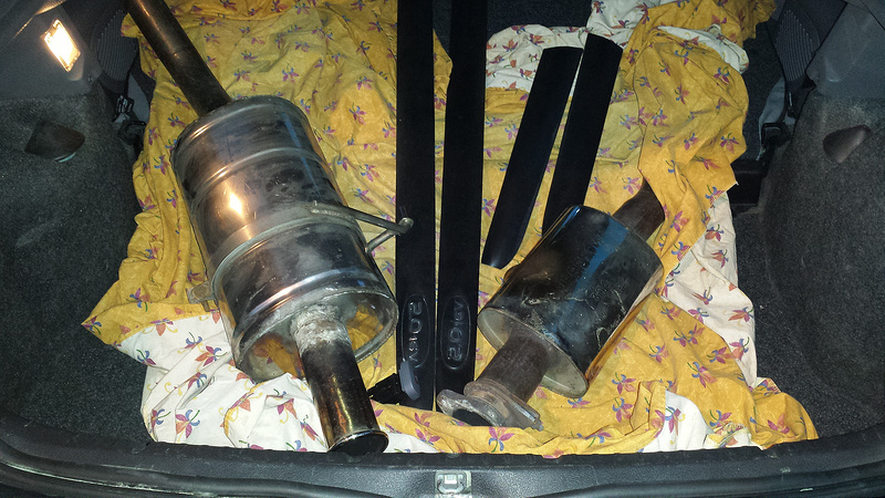

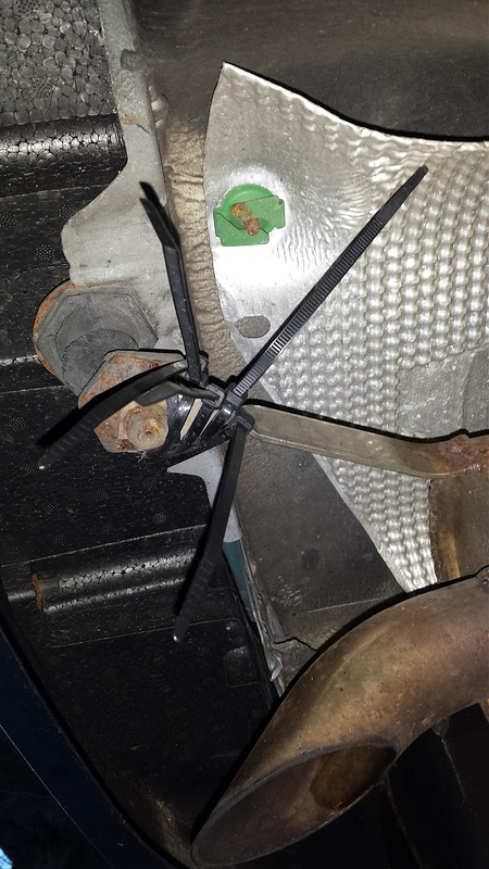

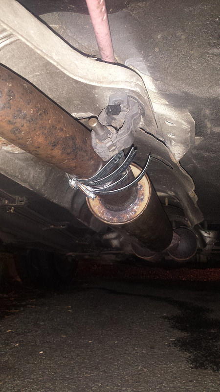

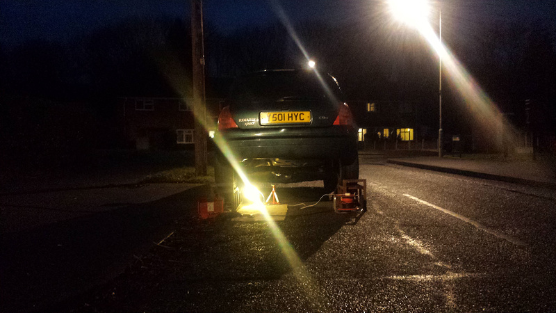

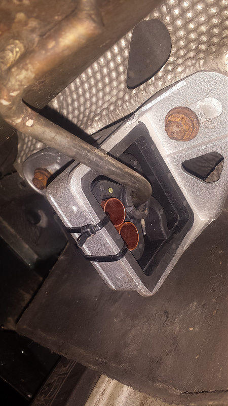

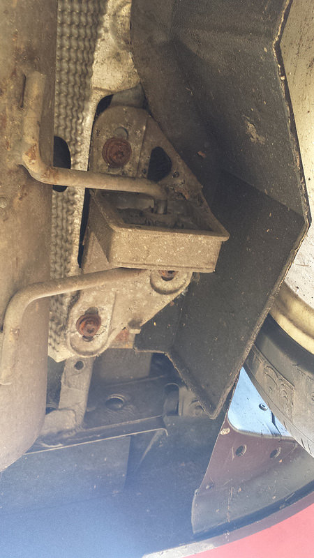

Used to rattle over bumps and vibrate (very loudly) at high revs, so got to looking at what was going on. Was all made obvious when I had a proper look.
Some awful bodge job of a bracket, that had since broke and been cable tied. This resulted in the backbox resting on the spring.
20150117_162857
by B-shaw55, on Flickr
This has now been removed, but it doesn't stop there. Swapping the mount I thought would be nice and simple, however I was wrong.
20150118_115908
No worries, I'll cut one off and that should be it, slip the new hanger on and job done.
NOPE 😂😂
Hanger for the mid section had snapped clean in half so wasn't doing anything. Didn't have any spare rod or a welder to hand, so the best I could come up with was this;
20150118_170840
Jubilee clips can save nearly anything, I tell you!
New mount on with some minor reinforcements;
20150118_170859
Had 3 pipe inserts but A. 3 wouldn't fit and B. probably better to allow a little movement anyway.
Went to view a 197 for a mate in the middle of doing this (turned out to be a shed) which meant I had to come back and finish it in the rain in the dark :down:
20150118_171051
Apart from a blow at the flange after the cat, the exhaust is now all kinda sorted.
Took it out for a spin and it no longer rattles and doesn't vibrate to high hell up in the revs. I can now enjoy all of the rev range without it sounding like something's about to explode.

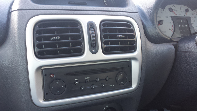

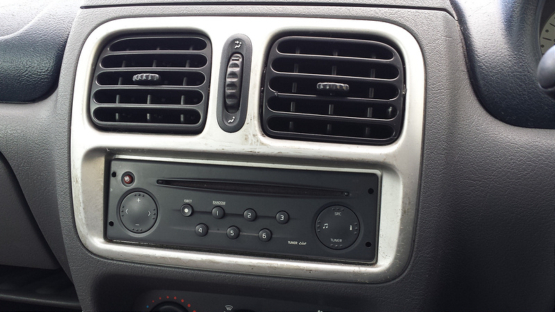

Gave this a good clean, God knows what this coating is all over the silver trim bits, but It's a pain in the arse haha

Bodged the vent too, was stuck on with silicone before, not used padded tape to hold it in, allows for movement too. CBA with swapping the entire surround for a new vent, far too much work for what It's worth

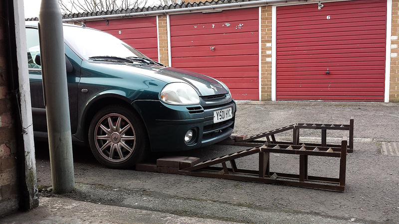

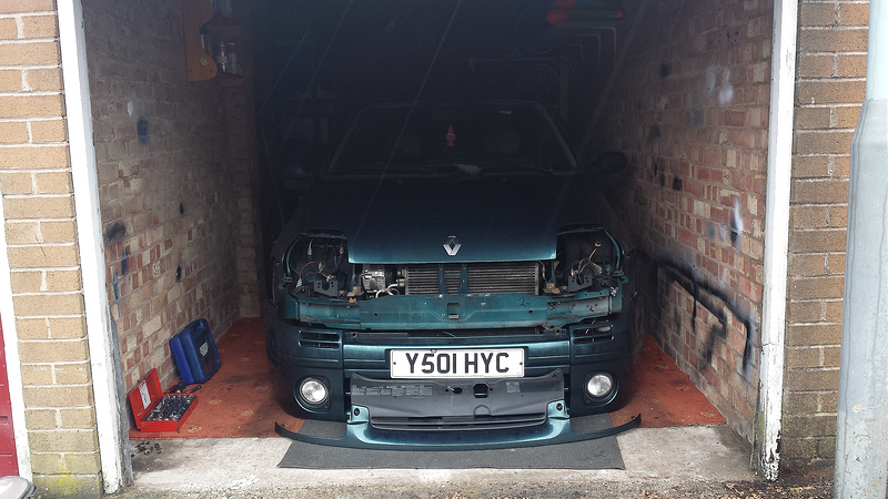

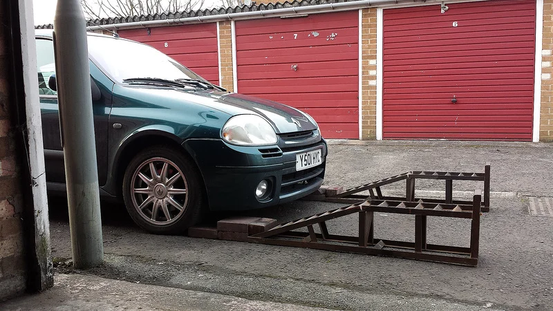

Found out the bumper is too low for my ramps still, thought these days were gone with the polo haha. Luckily bricks saved the day

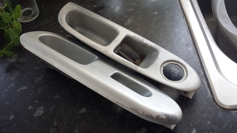

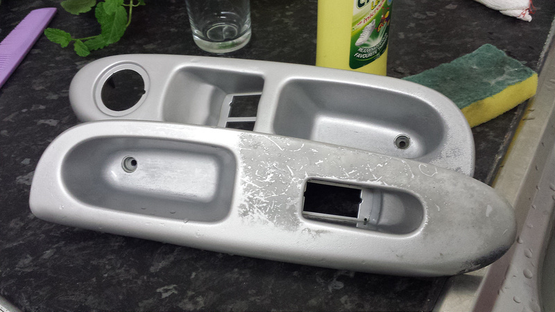

Couldn't live with them being vile any longer, so started on getting them painted this evening.
20150204_162128
Mid cleaning, this stuff takes the piss to get off, covered in blisters on my fingers from removing it haha
20150204_172749
All cleaned and sanded, ready for priming tomorrow
20150204_182011
Using up some paint I had left over from the polo....

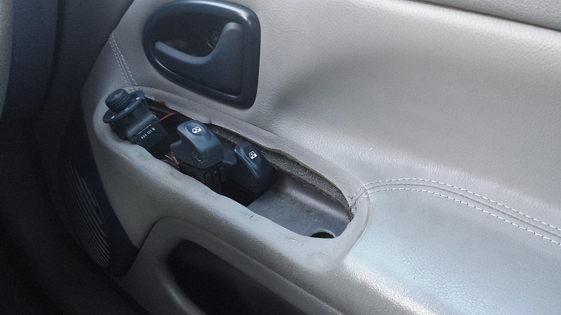

That stuff is like bloody glue! Took me ages to remove mine from my handles and center console but well worth it. I hate grubbiness. I used antibacterial wipes and my fingernails for the console. A good few hours it took but at least it smelt lemony fresh when I was doing it!
I think you need lower ramps if your getting Billies! Future plans sound good but it ain't gonna be cheap! #Moneypit.
Oh and you don't have to remove the center console to fit a new vent. Mine was snapped so I pulled it out and ordered a new one which pops in :smile:
lol yeah, or remove the bumper every time.
Joking about the vent? I asked on one of the FB pages and everyone was saying couldn't get them and had to replace the lot.
I'll drop Adam a msg, see if he can get a hold of one for us.
And yep, it took me hours to do the centre bit, and another hour n half on the handles today. Typing is a right mission, should see the blisters I have haha. Must have gone soft from not playing cars for a while.
My bumper came off all the time, only four bolts, and two of them don't really need to be in there!
I wouldn't believe everything you read on FB :wink:
I seem to remember seeing in Marks project thread the bit about replacing the vent.
The silver surround on the other hand is another matter! i think its plastic welded in hence the need to take the whole bottom dash out to repaint/replace it.

Will be finding out how easy the bumper comes off tomorrow. Going to remove so can get the headlights off for sanding/polishing.

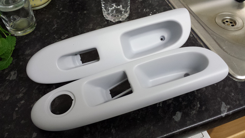

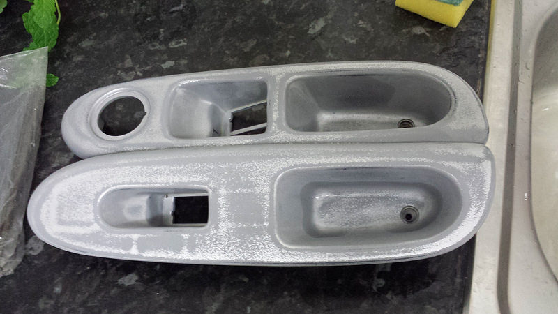

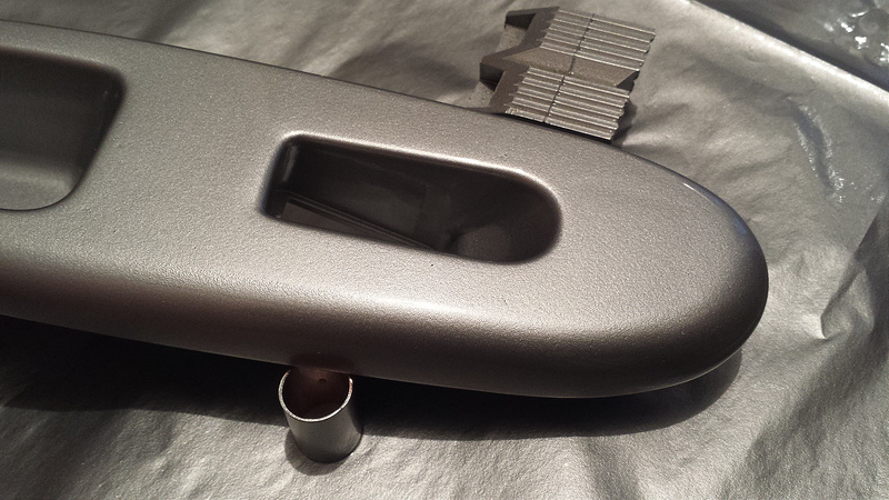

Primed handles today, 1st lot of plastic primer reacted with the plastic haha! useless.
So started again and used some standard high build primer I had knocking around.
20150205_182942
Rub them down tomorrow and paint/lacquer, hopefully ready to fit Saturday.

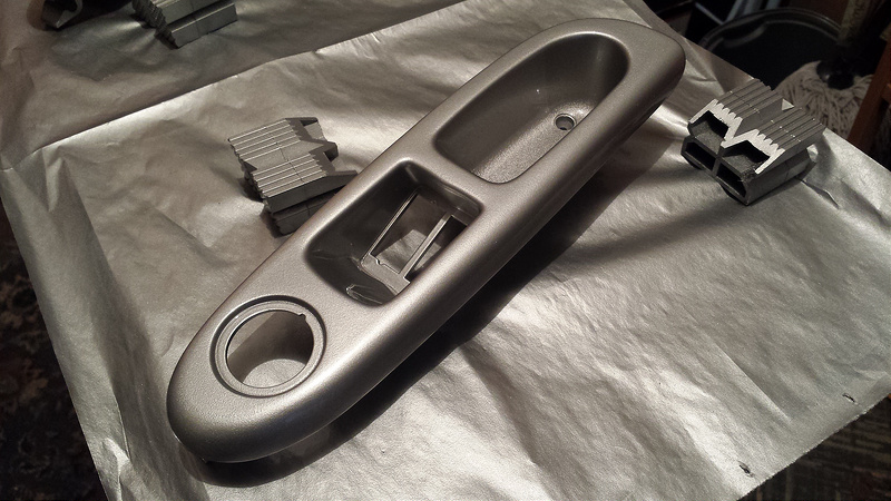

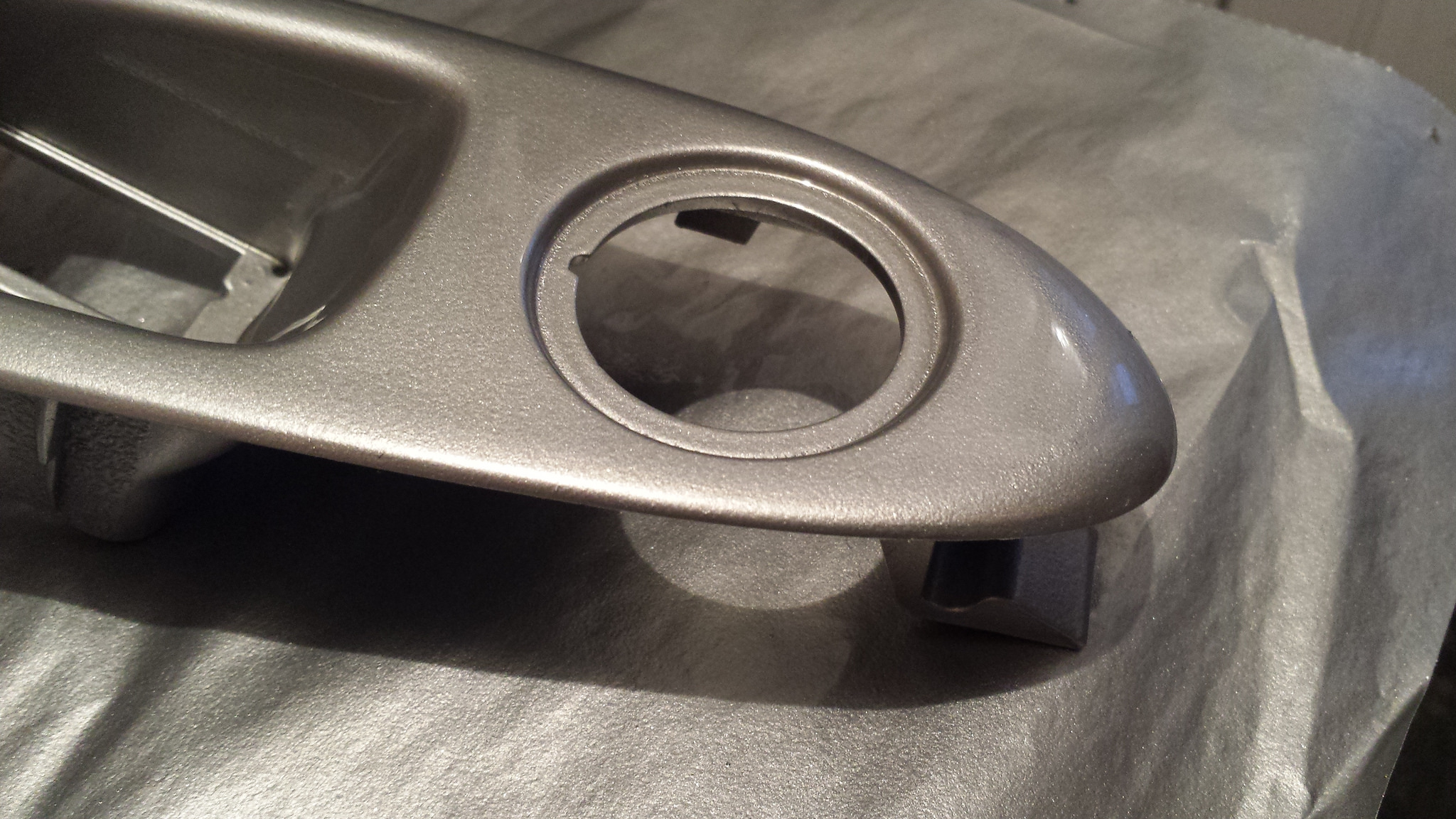

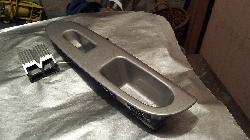

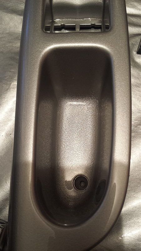

Painted...
Basecoat reacted when I put clearcoat on.. these handles just don't want to look pretty haha.
Still a massive improvement, enough to keep me happy.
Cannot believe how good a finish I've got out of a can with the lacquer, I amaze myself at times 😂

Such a shame it's reacted, else these would have been perfect!
Do like exclusives and this ones certainty gone to a good home and the handles look nice tbh going to keep an eye on this thread
Good work on painting the door handles :up: Huge improvement on them from before even with the paint reacting!
Cheers guys!
Get them fitted tomorrow once the paint has hardened more.

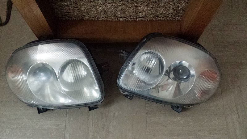

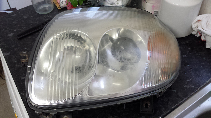

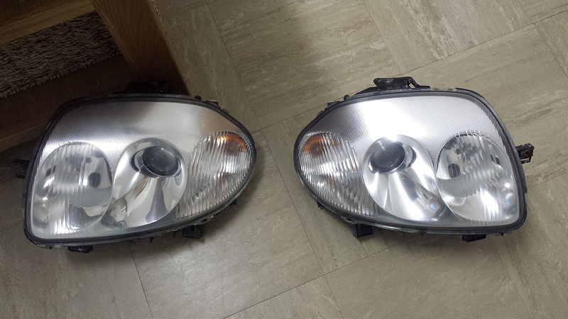

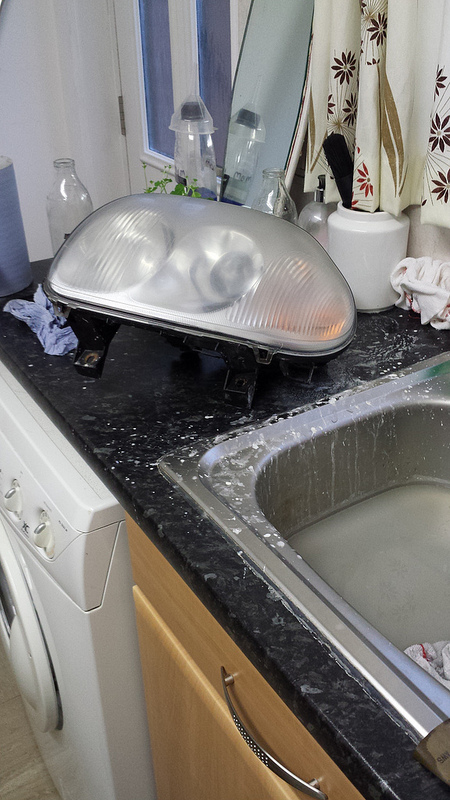

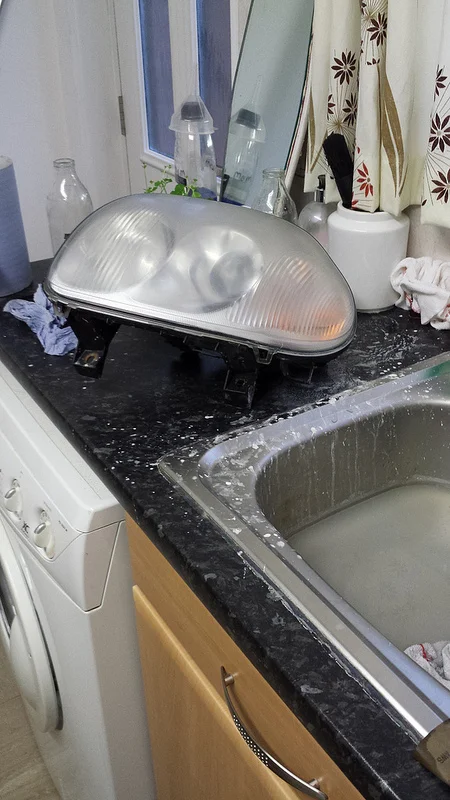

Had an extremely lazy week off, but slowly tackled the headlights.
Because I wanted to stay warm thought I'd do the headlights off the car inside... what an operation 😂
After much faffing and head scratching, eventually got there.
20150213_131742
Before:
20150211_150307
Making a mess of the kitchen
20150211_163720
Comparison
20150212_152616
Done
20150212_170348
Need polishing properly with a rotary, but it already looks so much better. I'm happy with them for now.
Done with 1200,2000,2500 grit papers and then a good going over with T-cut. Have literally no polish in the house thanks to owning a satin car previous haha.
Fitted & a game of spot the difference.
20150213_170440
20150213_170401

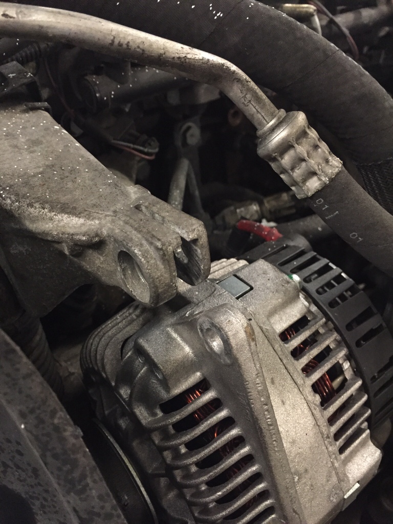

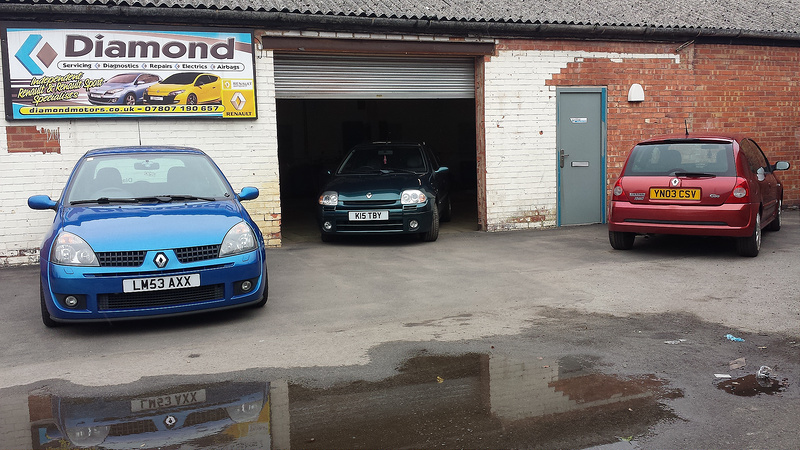

But yesterday I visited @MicKPM At Diamond Motors for a belt change.
The car was a bit of a t**t to him I think haha! Found a couple of bodges with alternator mounting/bracing and even a loose nut in the belt housing area.
Luckily he had the spare bits needed to sort them.
Really happy with the work done, and it's not often I say that about a garage.
Found a few other issues with the car, needs a new engine mount and plugs are past their best, so that's next up on the shopping list.
