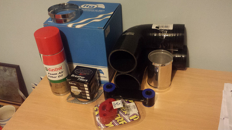

Yep, ordered it all last night. Always liked ITG stuff.
Going to get started this evening after work, wanted to start cycling to work again anyway, I'll have no choice now as It'll be up on stands for a few days.
Will sound completely different after this, new exhaust and intake!

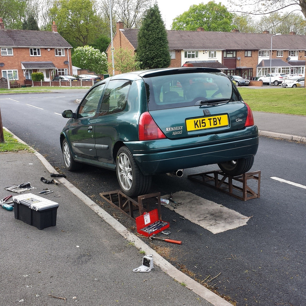

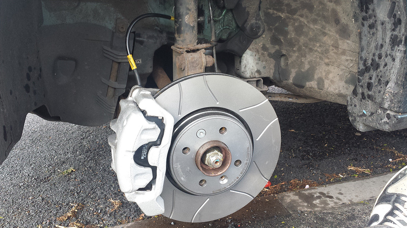

Went about doing the brakes, started on the rears, discovered they were near new... fresh mintex pads and what looked like new discs. Decided not to bother changing them, however did change the lines.
Niiice and easy they were, compared the fronts. Christ, had a right game.

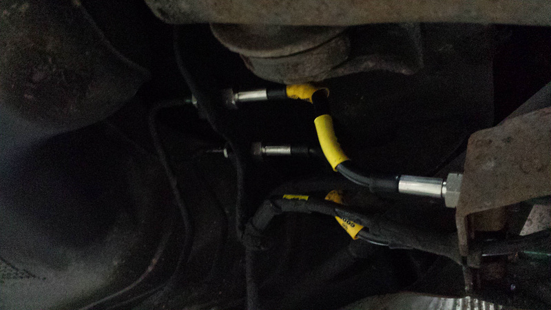

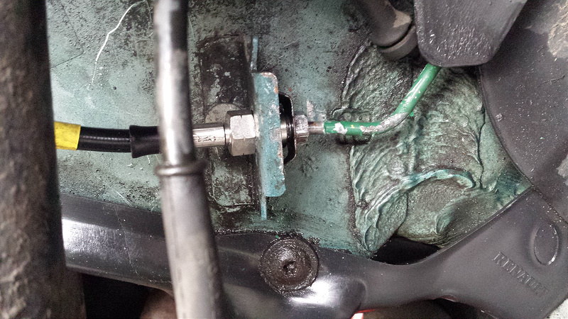

Undoing the flexi's, came out the calliper easy.. but then the solid line, undid all the way but it just would not free. kept spinning but was asif it was stuck. turned out the end of the nut had like, gone like a mushroom inside and wouldn't come off the final thread. lots of swearing and hammering and fluid loss later it finally came out. Filed the end down, tidied up the thread and was good to go inside the new braided line.... here's a picture of the b*****d, all be it once done. too much anger to photograph the actual problem lol.
Other side wasn't so bad, similar issue but came apart much easier.
The complete package
Got them all bled today, not been able to take for a test drive yet though, as I currently have no inlet manifold, off for painting.

Copied @Dr Jekyll 's air intake setup also, so have all that to fit.
Soon as all that's fitted, I'll be getting the exhaust on.
Busy week or so ahead, but should be a bit of a transformation, sound and stopping wise atleast.

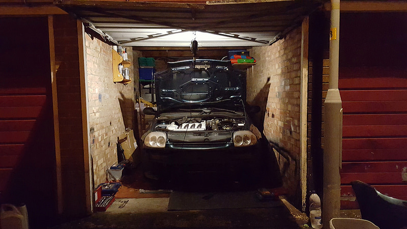

Managed to get the dogbone mount on, and drain the gearbox of oil, keeps sodding raining though. Haven't got enough time due to work commitments as it is, last thing I need is rain when I'm not at work haha. Shouldn't moan though, I'm off tomorrow.
Hope to get it back on all 4's, gearbox filled back up, inlet prepped and primed (possibly painted) tomorrow, then I can start getting things back on, in the engine bay.
Gearbox re-filled and the cars finally back on all 4 wheels again.

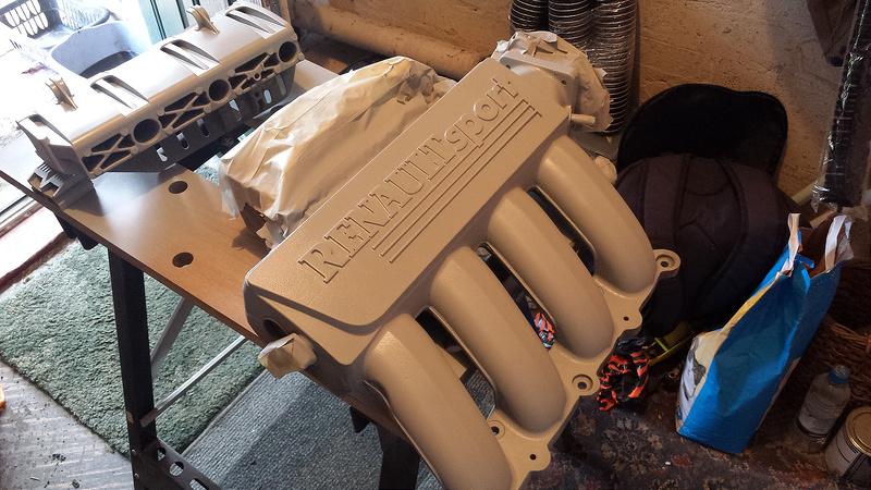

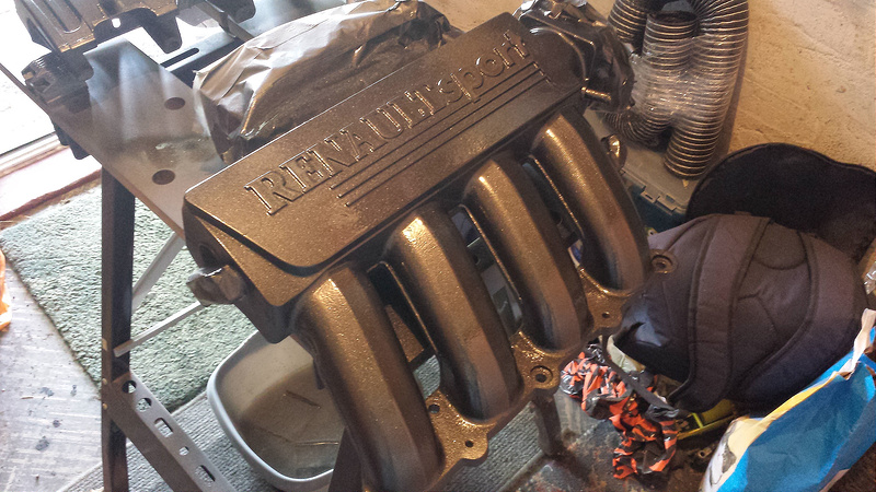

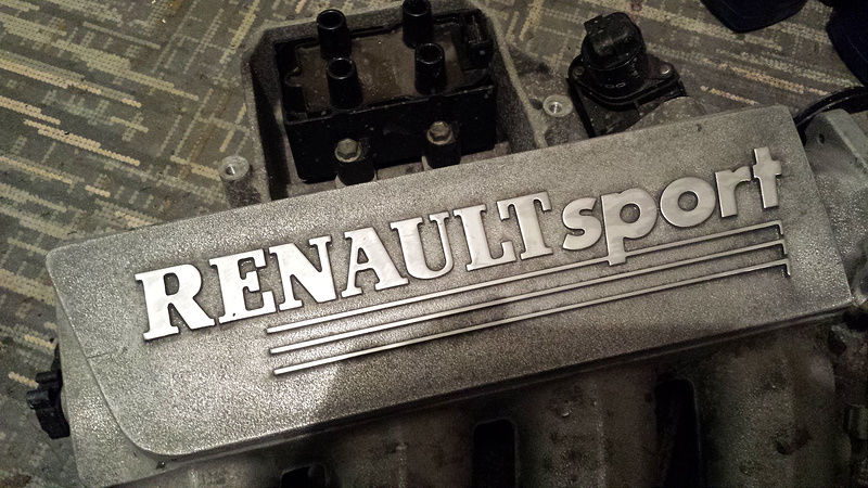

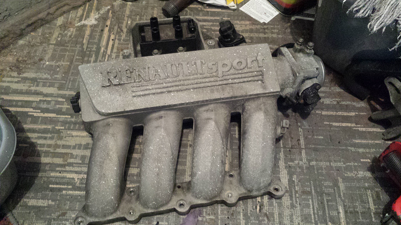

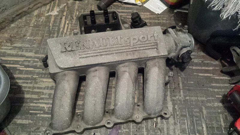

Been working on the inlet manifold past couple of days, how it was to begin with
After some prep, and working through the grades on the text
Primed
Painted, have used matt lacquer but this was when the paint was wet, so looks gloss.
Just need to sand the paint off the text and polish it properly, and it's good to go back on the car.

Scweeet! Love the inlet colour. I'd be tempted to leave it as it is rather than sanding the lettering off.
Wheel looks great too. I'm a bit unsure on the lettering, but snappys work is immense!
I cant make my mind up now on the inlet haha... they look good polished, but with the satin clearcoat it reflects the light differently on the text so already stands out a little more than usual.
Think I'll leave it as is for now, can sand it off whenever if I change my mind!
And really? I love the No076 on the wheel.
Jekyll
I like it, its just different. I guess it's because I haven't seen it done like that before. The workmanship is fantastic, as with all he's stuff.
Keep the "Renault Sport" as it is for now ;)

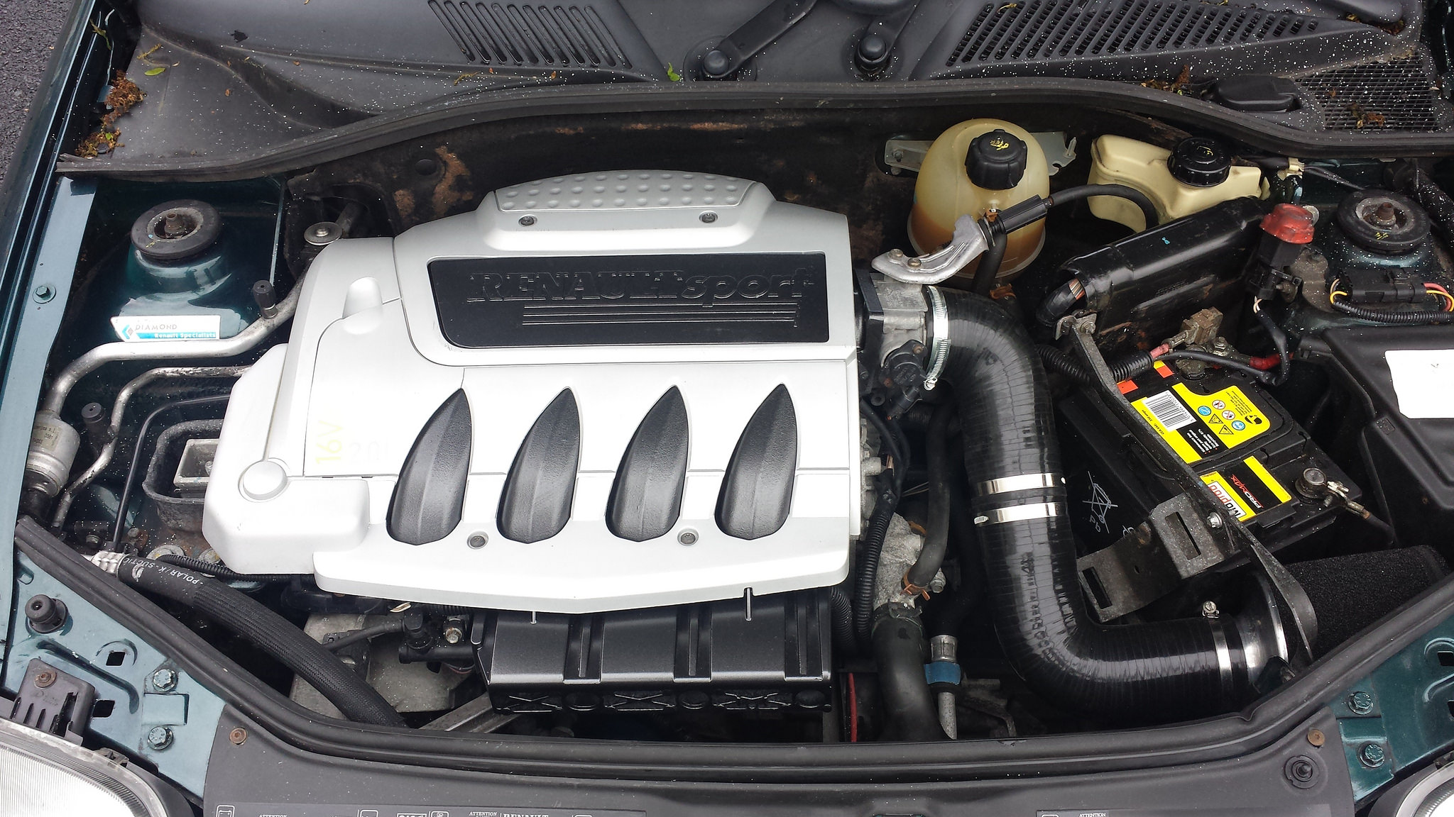

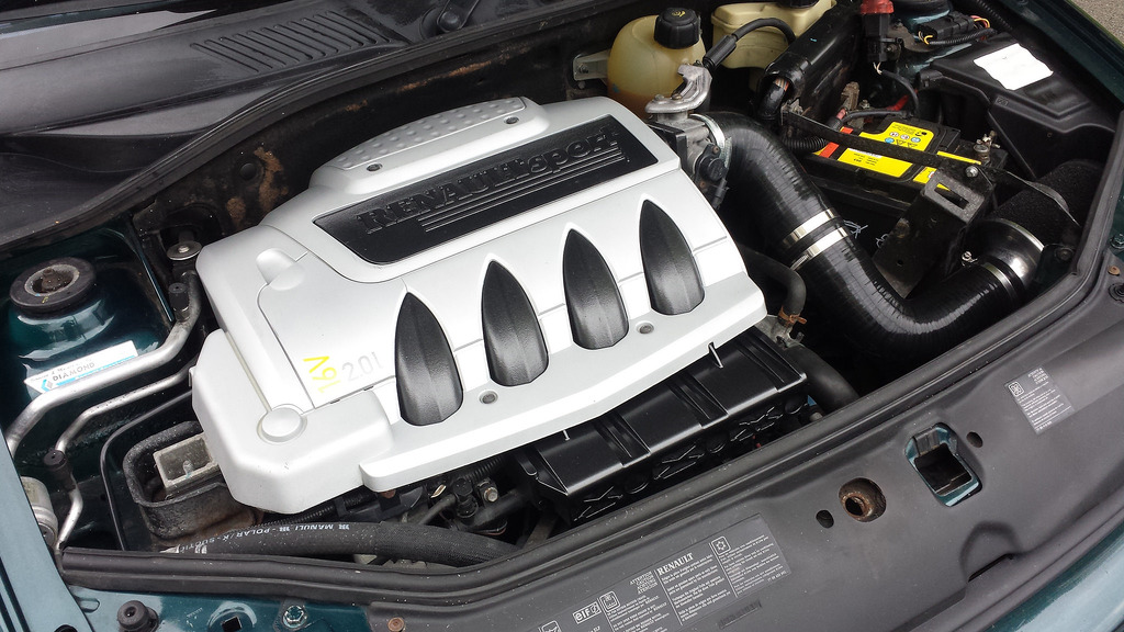

Inlet is back on, and I put the intake and filter on.... oh my gosh, the noise! Seriously overwhelmed by it, the 1st time I took it out, big smiles haha.
You guys weren't wrong about fuel economy going out the window haha!
Still got to give the bay a proper clean, get the engine cover back on and whatnot, but that's probably it for in the bay for a while.

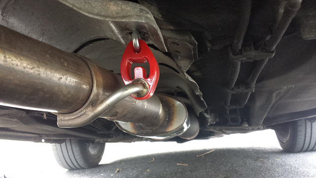

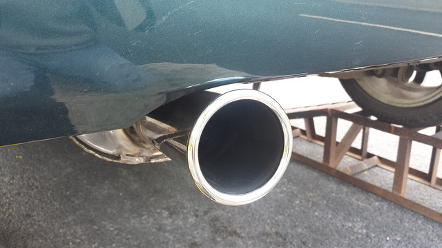

Today after work, I cracked on with the exhaust.
Polished the tip
My pikeytech middle exhaust hanger, idea stolen from someone on here.
LOVE how it looks! Cant get over how well it sits by the bumper! Really really happy with it @Ph1 Tom
Funny thing is, its quieter than the previous exhaust aha, from inside the car, I can't hear the exhaust over the induction noise, which I actually quite like.
Need to get someone to do a drive by for me, so I can hear what it sounds like from outside under load.

Glad you're happy with it. It's quieter in the car because it's not a stealth exhaust. The stealth ones just reverberate behind the bumper and the sound comes into the cabin.

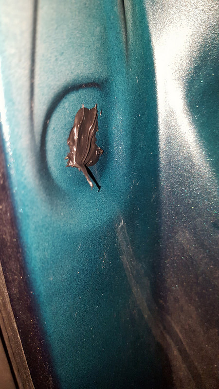

Started cleaning the bay, my biggest regret yet is polishing headlamps with bonnet open. Absolute nightmare getting rid of the polish that went everywhere. It's doing my head in haha.
Got rid of the best part of it anyway, just more cleaning to do when the weather goes nice again.

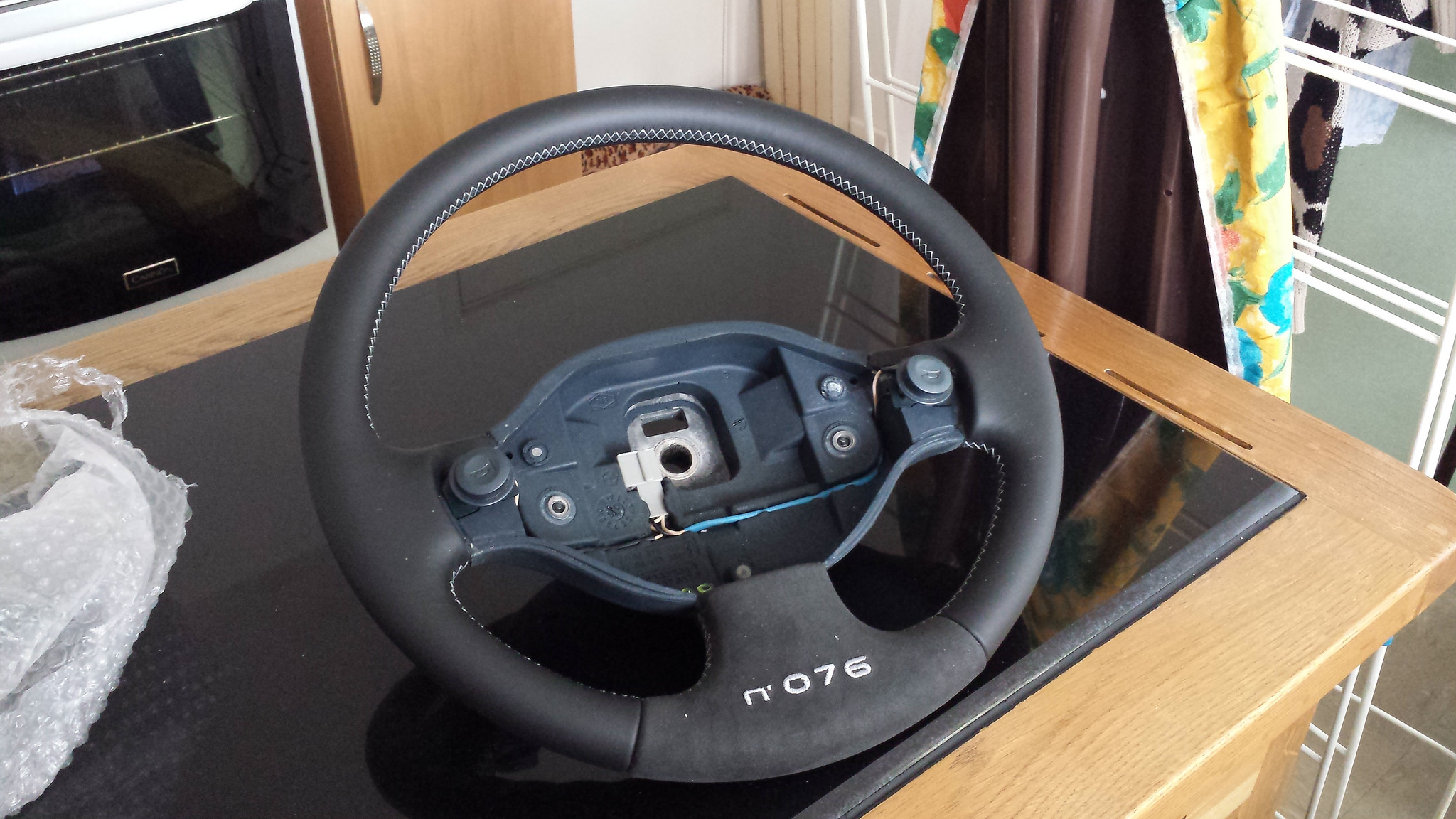

First up, switched out my hazard switch for one I got off Tom. Glad to say it's fixed the problem of them not working with the key out of the ignition

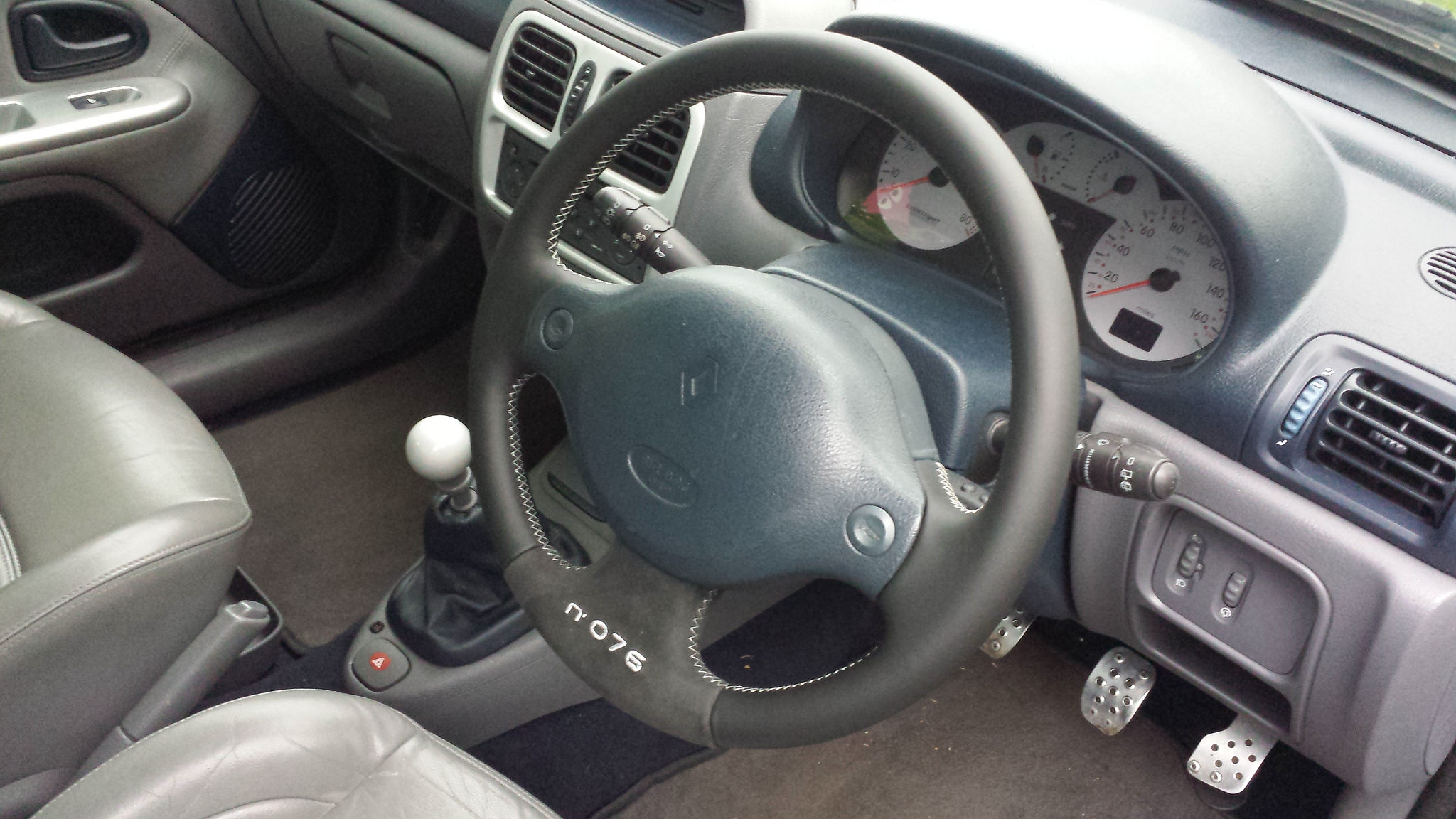

Next up, fitted the wheel :hearteyes::hearteyes:
Love it, well worth the money IMO
@MicKPM Picture fitted, I think it works with the blue tbf. Would just be better if all the blue, was black haha!
Next, finished cleaning the bay. It's far from immaculate, infact its still pretty dirty. But what the hell, used daily and hopefully, I'll hardly see under the bonnet haha.
Also removed the sound deadening from the bonnet, in the hope it makes the induction noise louder from outside lol! Saves some weight too I guess 😂

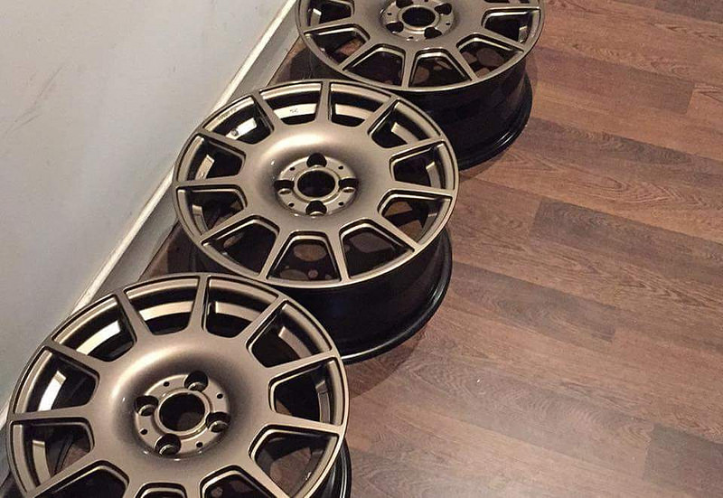

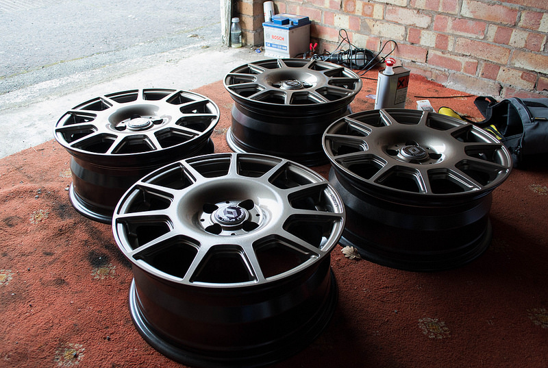

Got sent these pictures the other day.... Can't resist showing them
OZ Sparco 'Terra'
16x7
BMW Sepang Bronze
Cheers guys!
Is far from the best, but I'm working on that :wink: haha

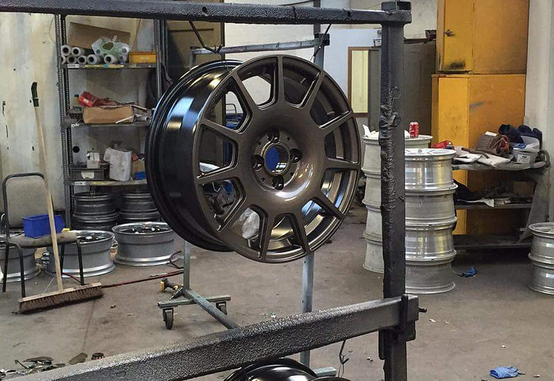

And yep, It took hours and hours to find a colour I was happy with. I think I've nailed it, but until I've got them to hand and test fitted, I wont know. Can but hope.
Also never seen these wheels on a clio so its new territory. From the images in my mind they should work well.
Just a shame they have skinted me out, going to be a long wait before they're fitted, need coilovers, tyres, spacers etc before I'll be getting them on. Probably be next year before they're on the car 😧

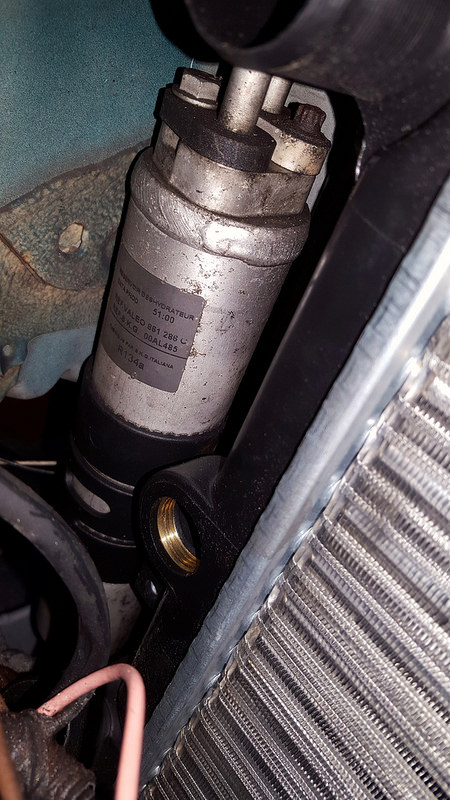

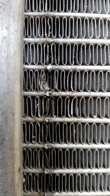

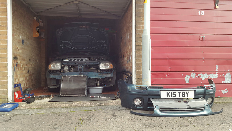

Not a lot has really happened in the past 6 months to the car. Radiator sprung a leak.... turned out to be the fan cowling had warped and was pressed against the rad. over time itd caused a few holes it seems.
Got a replacement radiator from euro car parts (I know, this was a silly choice)
Turned out it needed a blanking plug that it didnt come with.
Got all that fitted, trimmed the rad cowling straight so it's no longer in contact with the rad. All has been good with that since, touch wood.

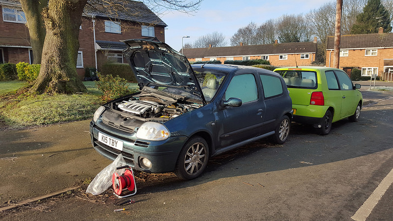

Then came the MOT, failed on a split steering arm boot. I was pissed off with cars (my moms lupo had been off the road a while with brake issues, fix one thing and two more broke) so I gave it to the garage for this. Unlike me but i was too angry and it was too cold haha.
Got that done and it passed with no advisories.
After getting my moms lupo sorted, finally, I had motivation to tackle some minor jobs on the clio that had been bugging me for some time.
1st up was the brake light switch, my brake lights werent coming on unless i was on the brakes hard. That was probably the easiest fix I've ever done on a car lol. Nice and simple.
Next up was the screen wash pump, it had gotten to the point where it wasnt even making it over the wipers, next to useless.
got a new pump and went about fitting that.
Passenger side wiper arm was a right b*****d, took 3 of us to get the bugger off on a frosty January evening outside my mates.
Following morning I ripped everything out, cleaned the tank and swapped the pump. For some reason it wouldn't work at 1st but then sprang into life after a couple of goes.
Was great to be able to clean the screen, don't realise how much you take it for granted.

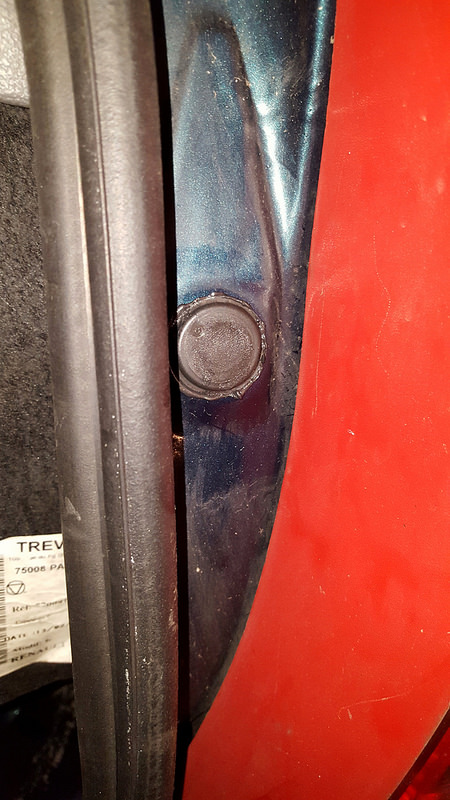

Next up was my annoying leaking boot. Took me forever to figure out where it was leaking from, finally found the suspects on my break at work after a downpour. Grommets that seem to have no point down either side.
Originally thought it was around the lights, as after the 1st hose test thats where it came in from. sealed that up thinking all was good. Following day i come out to a boot full of water again haha.
Broke a grommet on removal but just siliconed it back in place.
Still not sure its 100% cured it, but It's still dry for now.

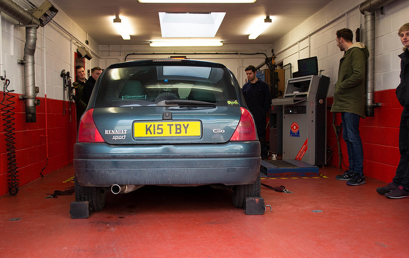

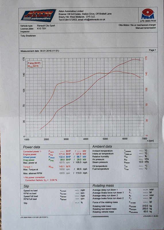

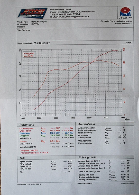

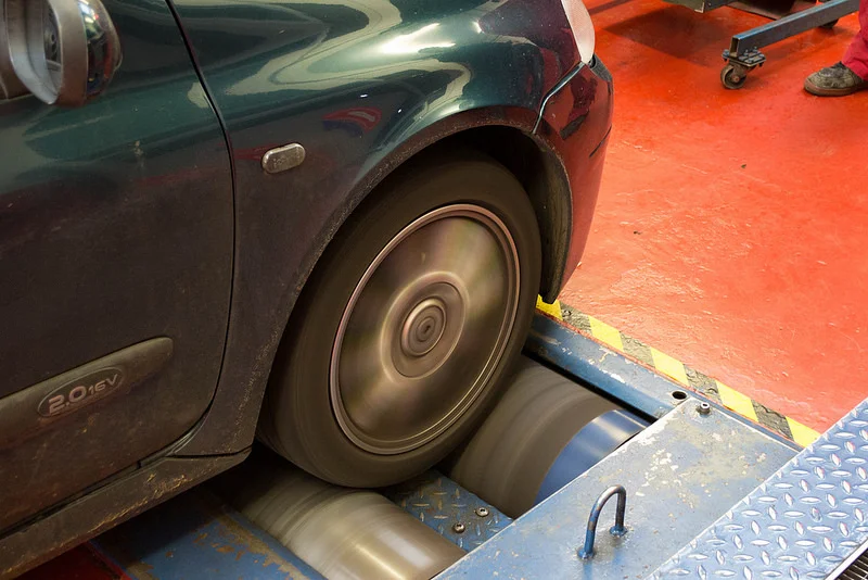

Went to the Club Polo Rolling road day at Aldon Automotive last weekend. Wasn't going to run it but I got talked into it after realising it was only £15 (those moderator privileges haha)
Glad I did do it, I was expecting around 160/165bhp at the most... what I got surprised everyone, including me and the guys at Aldon...
171.4bhp....
So an actual 172 with as near as it gets, 172bhp.
And on that Bombshell... Until next time.

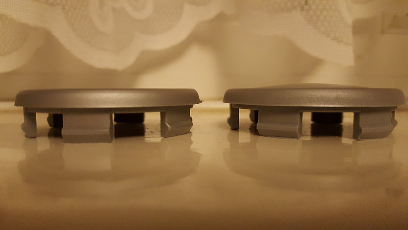

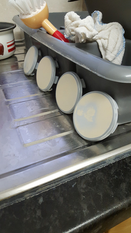

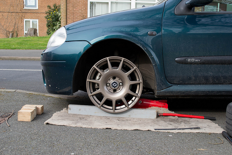

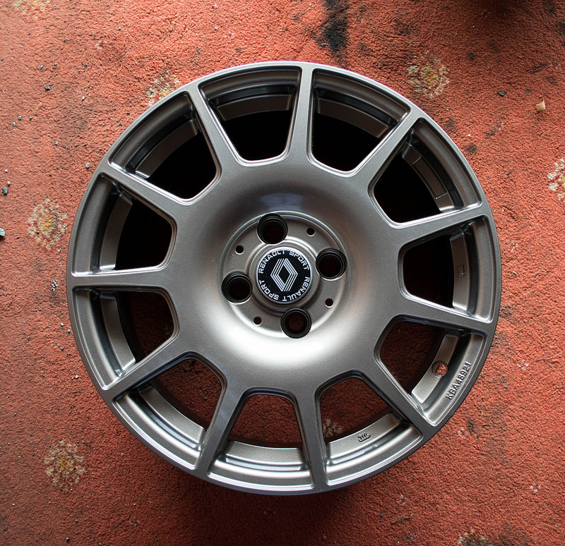

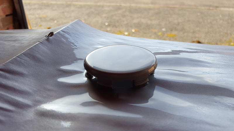

Got those Sparco wheels a while back, the guy lost the centre caps though, tried emailing OZ direct to get replacements but multiple emails got ignored, theyre not the most helpful people then haha!
Anyway, measured up what size I'd need and went about purchasing some ebay specials and some stickers to go with.
They arrived, but they were slightly domed, thought the stickers never going to stick to these so instead of returning them for a £5 refund i had a go at butchering them with the dremel instead lol!
Right is domed shape, left is after being shaved down with the Dremel
Skim of filler to get everything nice and flat
Paint (some leftover Porsche silver I had in a can)
Completed with these cool retro stickers I found

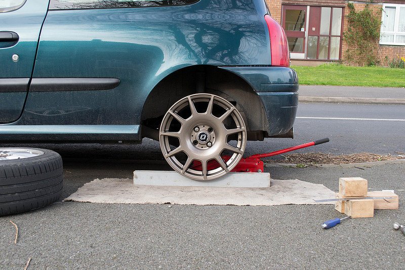

Got bored today and though I'd test fit to see if I can get an idea of what spacers I'll be needing.
Seeing them against the car, the colour combo I don't think I could have gotten any better, I'm so pleased with them!
Cannot wait to get them on the car, shame It's still going to be some time before that happens haha!
