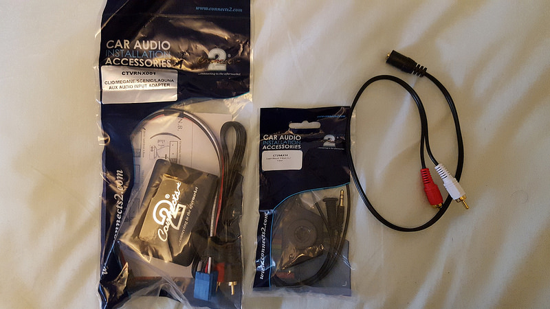

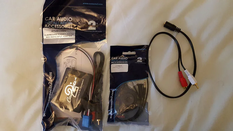

Think the only thing I really did last year was remove the CD changer and install an AUX in.
Pretty happy with it, looks as if its meant to be there.

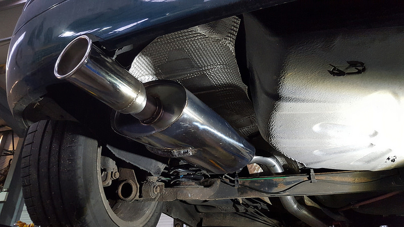

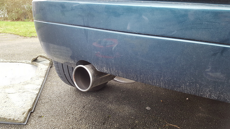

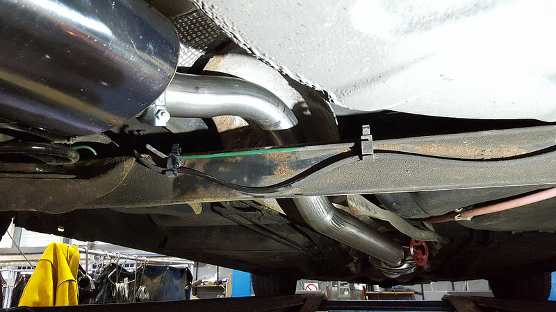

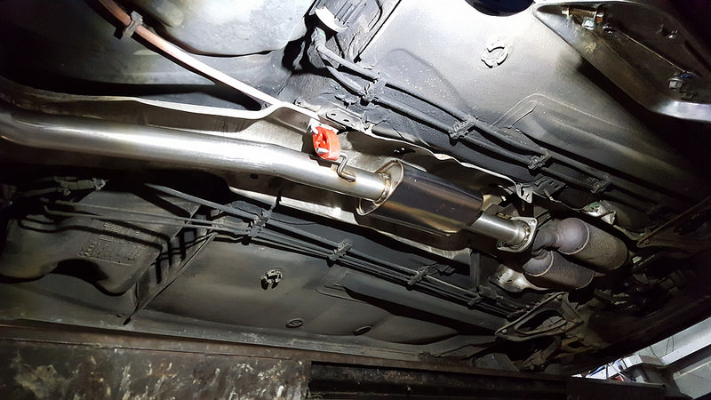

I was lucky enough to be able to make my own exhaust whilst I was down at Longlife HQ in Bridport on my training.
I didn't really want one, was happy with my setup I got off Tom... but it was a free exhaust so I couldn't turn it down haha.
Please bare in mind I'd never really even picked up a welder until 2 week prior to making this system, so the welding is pretty crap in places. Especially the hanger on the back box as I blew through and it warped to f**k haha.... But anyway, said system.
It's by no means perfect, but hey... how many people can say they literally made their own exhaust? haha.
Eventually I plan to do another, using only TIG welding with mandrel bends/pie cuts. This will come when I get around to turboing it. But that's a while off yet haha.

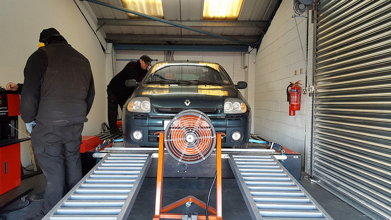

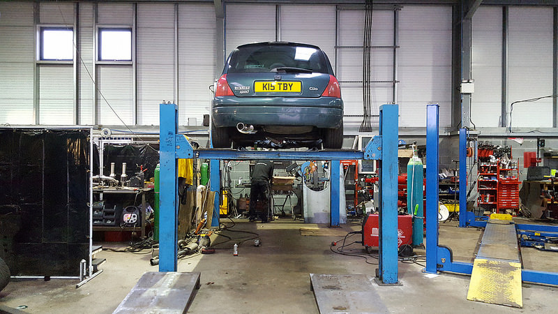

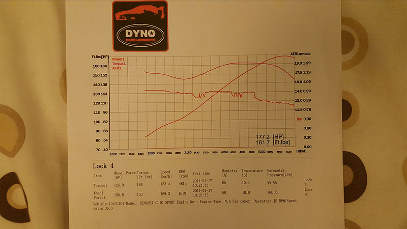

We then had a new toy installed at work, not something I really have anything to do with yet, but I did let them use the clio as a training mule...
Seems the new exhaust helped. We actually went a smaller bore than the Ktec system (2.25" instead of the 2.5")
Got consistently higher than the last time it was on a dyno, that was somewhere in the middle as they did about 8 power runs. Was also literally an hour or so after it was calibrated so it should be pretty much bang on.

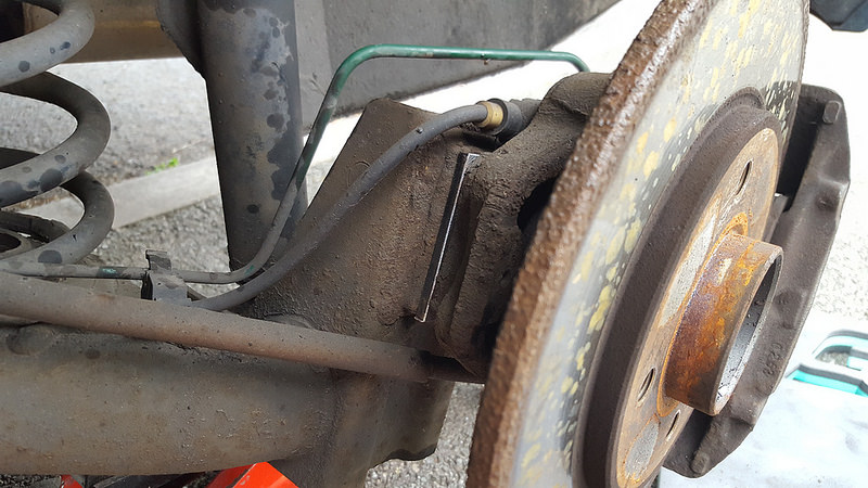

Had a few issues in the next month or so, needed another new track rod end, then it failed its mot with a brake fluid leak.
Must have started pretty much the week before the MOT, as it was the same side as the track rod we replaced and it certainly wasn't leaking then.
Had to loose both my front braided hoses, seems they'd cross threaded. Will get around to fitting new braided ones again eventually.

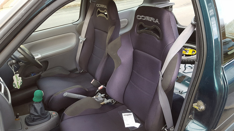

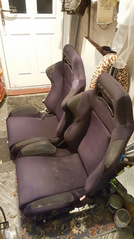

Picked these up for £260, on X-low subframes
Gave them a little clean and got them straight in on Saturday at work. God bless having use of a ramp at work, and a welder.

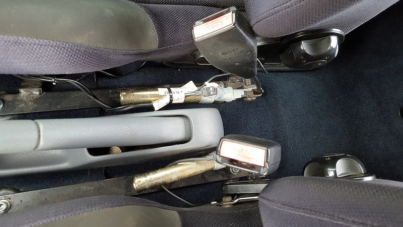

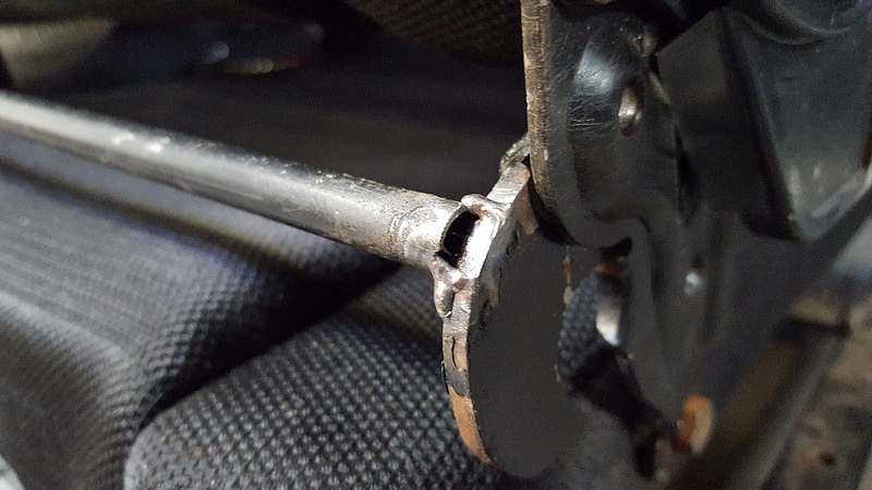

Noticed one of the recliner bars had snapped once I got them home, on the drivers seat.

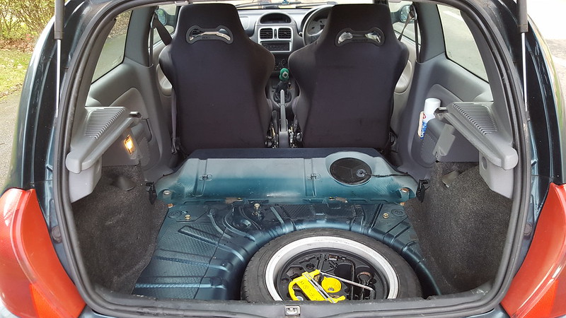

Removed the rear seats & belts too, just awaiting a mat that I ordered to tidy it up a little.
Need to get something sorted for these too, might get a trimmer to make something up for me, not sure yet.

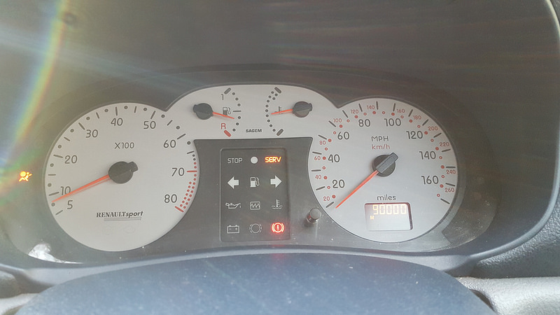

Hit 90K just after fitting them too, starting to get old.
Did the resistors today, didn't work, Maplins gave me the wrong ones (no surprise there)
Will try sort that tomorrow as I cannot stand having warning lights on the dash.
They have seriously transformed the car though, feels so different in these seats. Standard seats sit so high, these are really low in comparison, much much better.

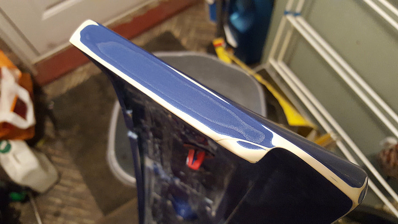

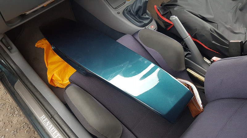

Bought a cup spoiler for cheap off here as it was damaged.
Touch wood, I've fixed this. All prepped for paint.

how'd you fix it mate? Mine has a damaged edge. Just be careful when fitting as mine due to a previous repair made it tight and then it cracked off when getting the spoiler sat right.

And some very strong glue. Should be any reason it'd make it any tighter on this, no extra material on the inside.

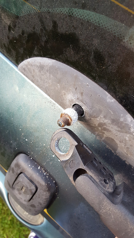

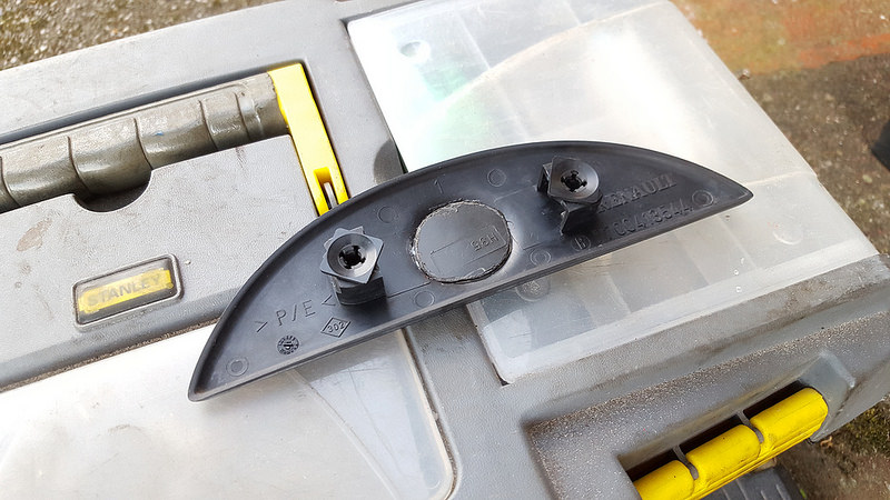

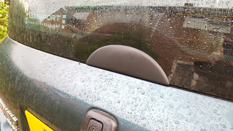

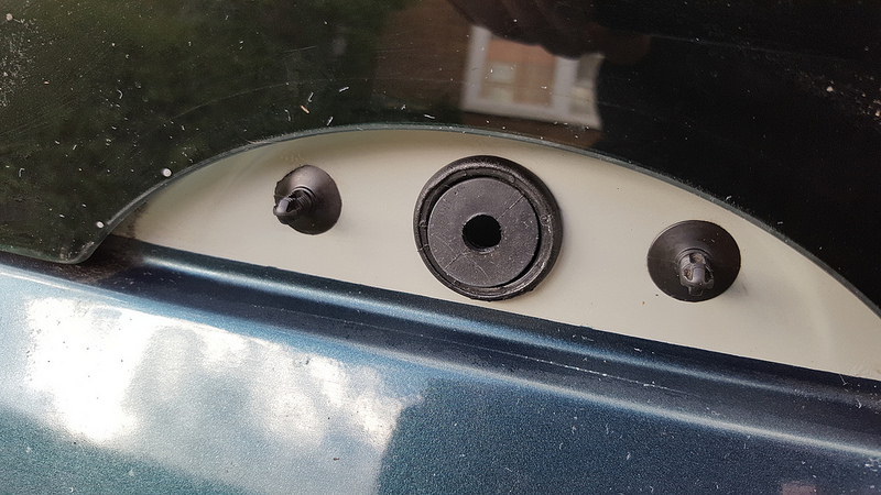

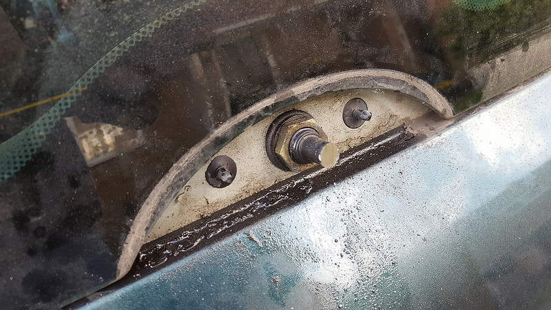

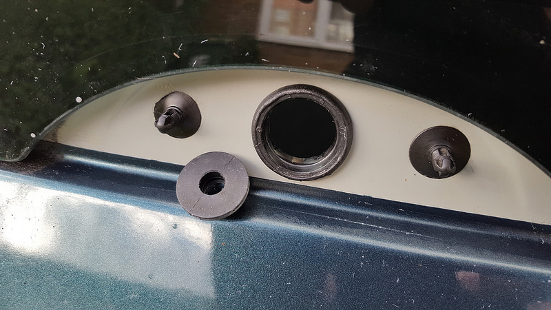

On Sunday I thought I'd tidy up something that has been bugging me since owning the car.
The little trim piece behind the rear wiper. Just wanted to remove it to give it some paint and pop it back on.
Nothing I had at home was cutting it to pull the wiper arm off, so off i popped to grab something to pull it off.

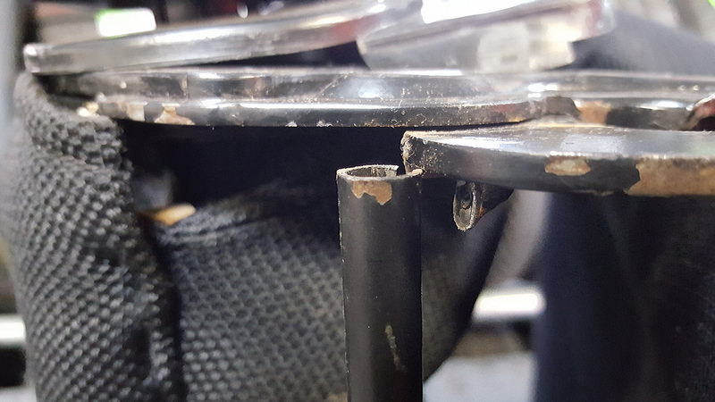

Handle snapped off it almost instantly, great. Out came the pipe grips.
Talking of snapped stuff....
Arm snapped off the actual spline bit, great stuff.
Still couldn't get the trim piece over this, time to resort to plan B
And off

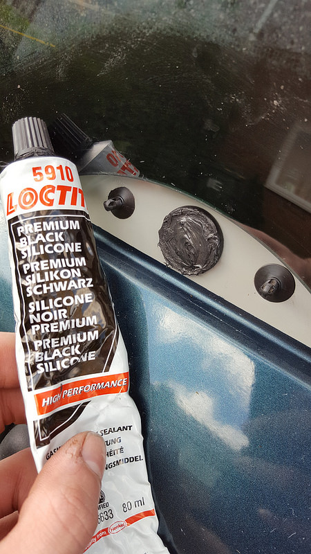

Next up, what happens when you don't have a grommet lying around that fits, and its about 5:30 on a Sunday

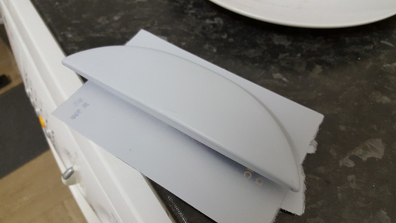

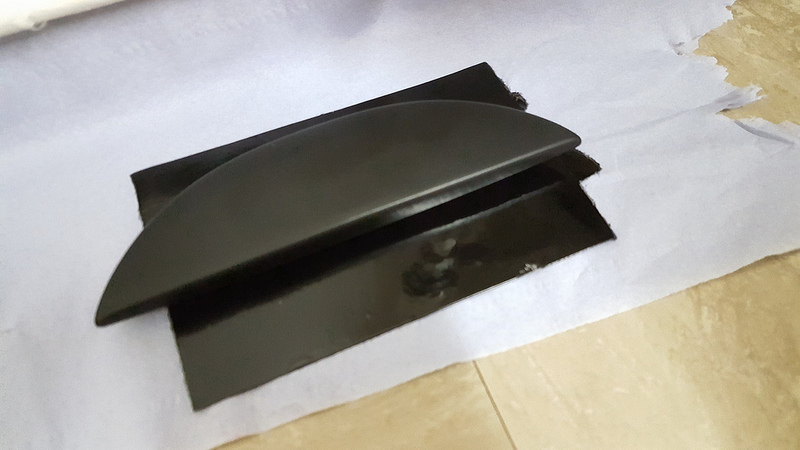

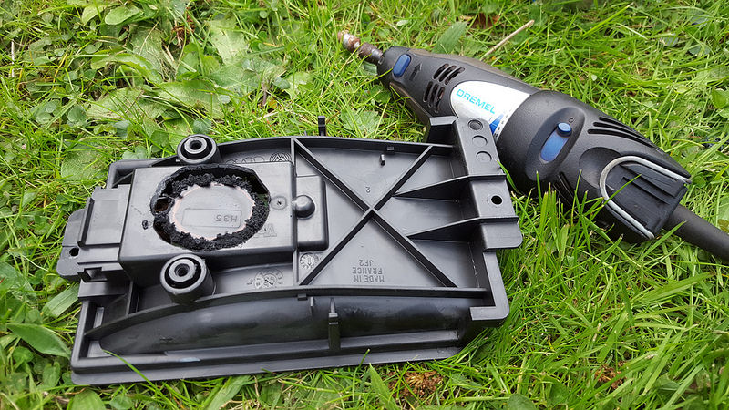

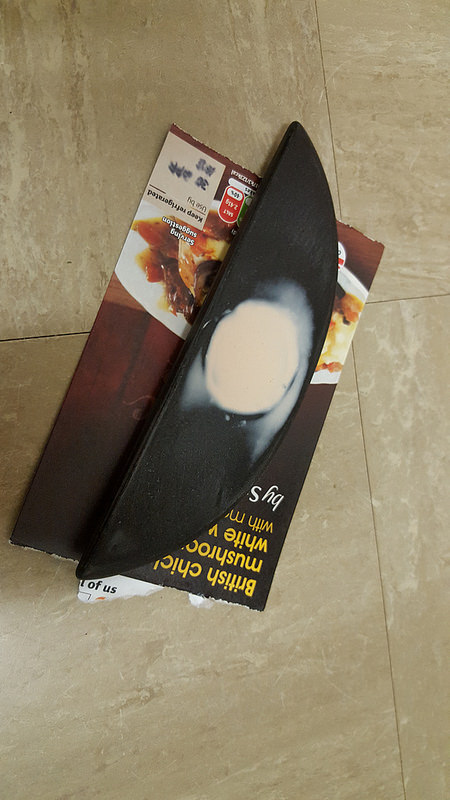

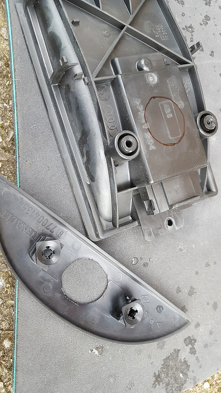

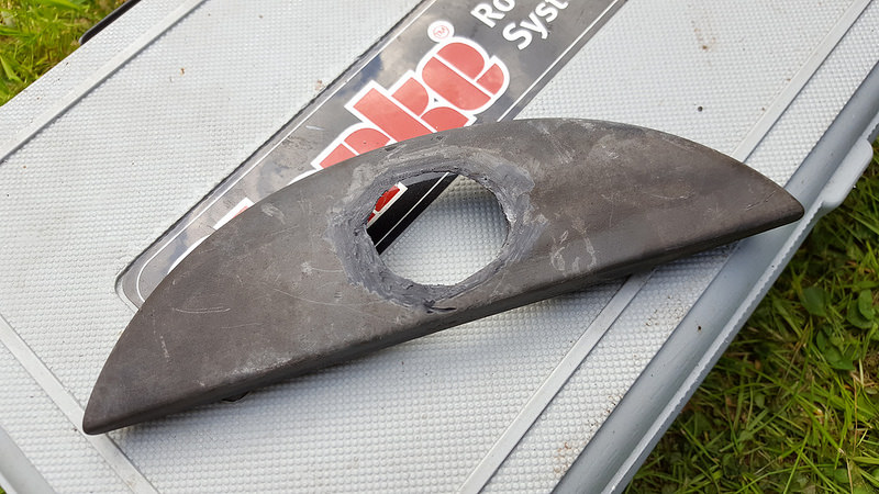

Next is what happens when you refuse to pay £30 odd for a blank, neither did I wish to wait for something to come.
Removed all material that protruded

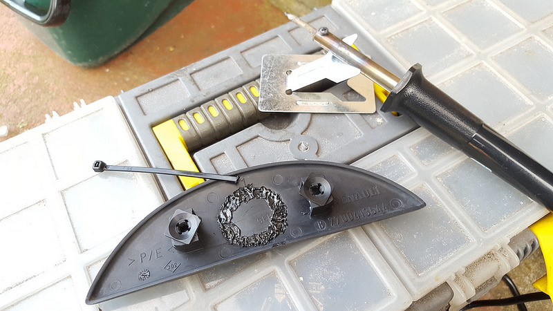

Pulled this out the bin (literally) for plastic, it's a heater resistor panel thing from my moms Lupo that I replaced the other day.
Drew around it, 'cut' it out
Used some tape to hold it in position
Plastic welded, using a soldering iron and a cable tie as filler rod.

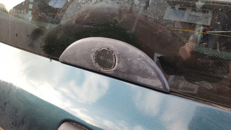

Trial fit
Filler
Primer
Satin Black

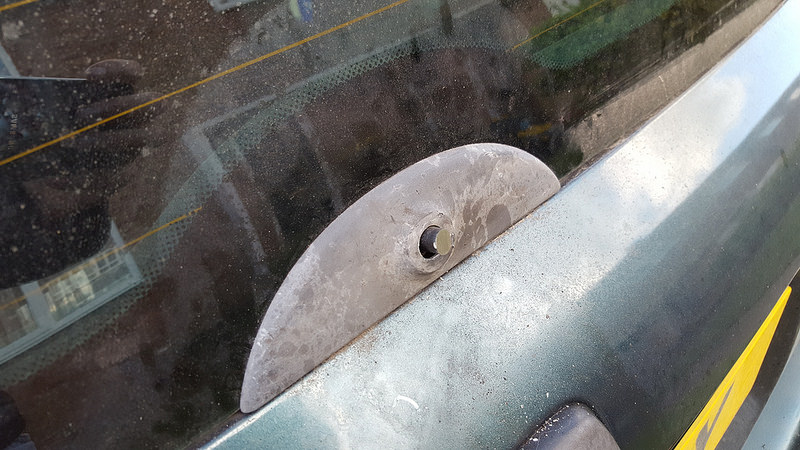

And fitted the following morning
Could've done with another skim of filler to fill some little air pockets but I wanted it done and on for the following morning and really didn't have time.
I'm happy with it though, considering all I used was stuff I had lying around, essentially it cost me nothing :cool:
May go over it in gloss black at some point, or possibly body coloured when I get spoiler and other bits painted. Not sure yet.

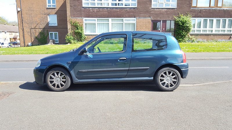

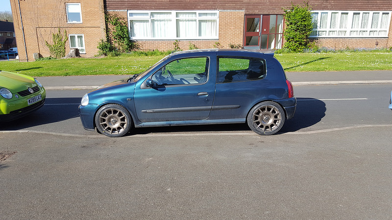

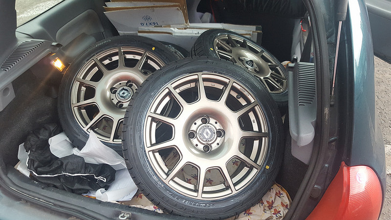

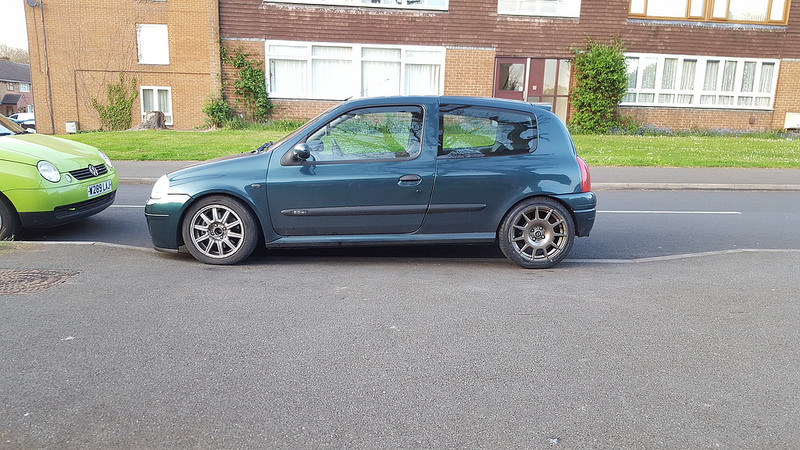

What wheels are they?!?

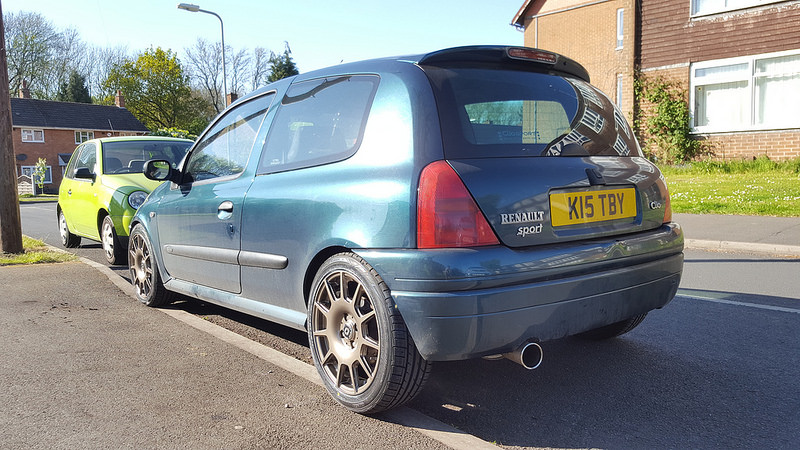

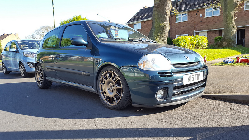

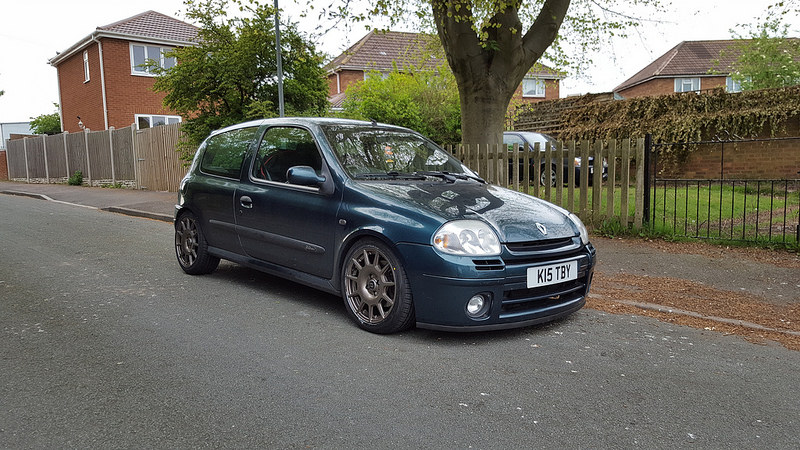

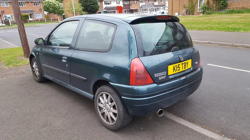

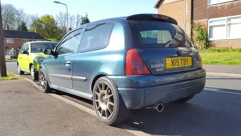

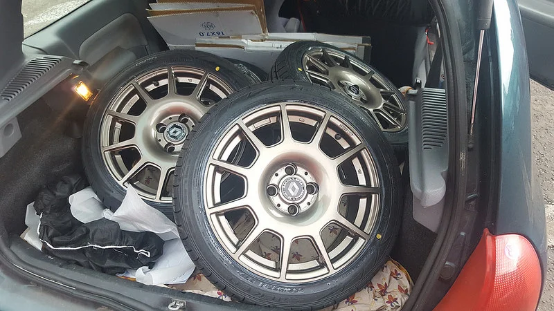

Wheels are Sparco Terra (made by OZ) 16x7
Gone with 205/45/16 Falken's on them. Was so difficult making the choice on tyres, kinda just went with what the boys at work with run, and rate for the price.

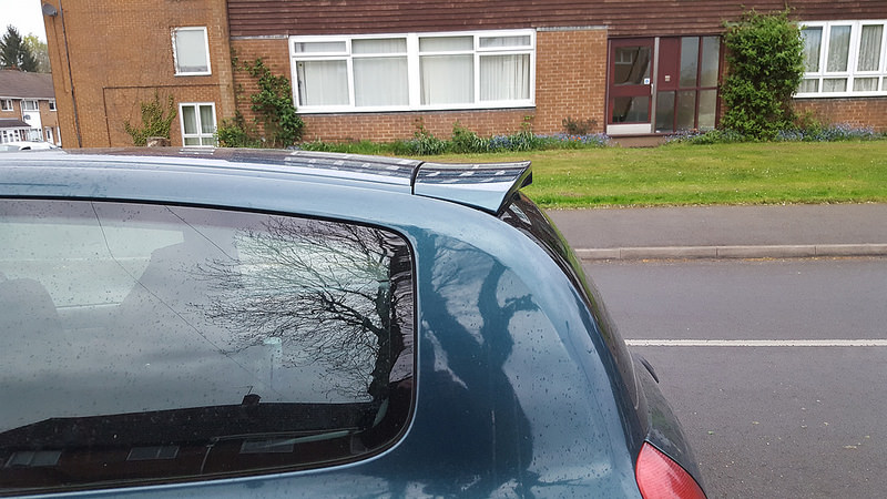

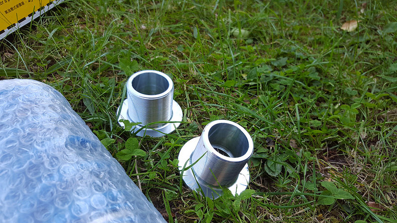

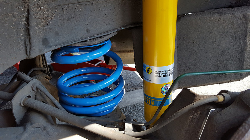

Did a few bits today, Fitted rear axle spacers, cup spoiler and some cool little lock covers.
All little things, spacers aren't really even noticeable currently, but hopefully will have it spot on with the new wheels/ride height.
Just went with 5mm ones each side, they also have half a degree of camber.

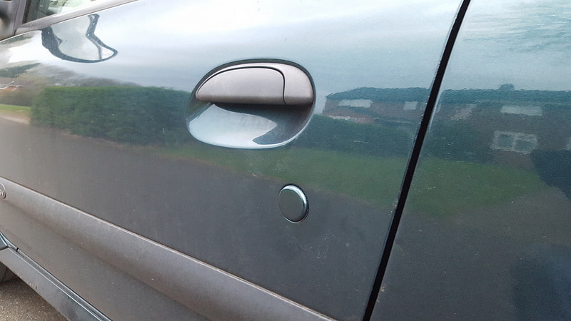

Cup spoiler makes such a difference though, as do those lock covers weirdly.
Used to bug me, the big silver locks (most people wouldn't even notice them I bet) from a side on view they make it look so much cleaner.

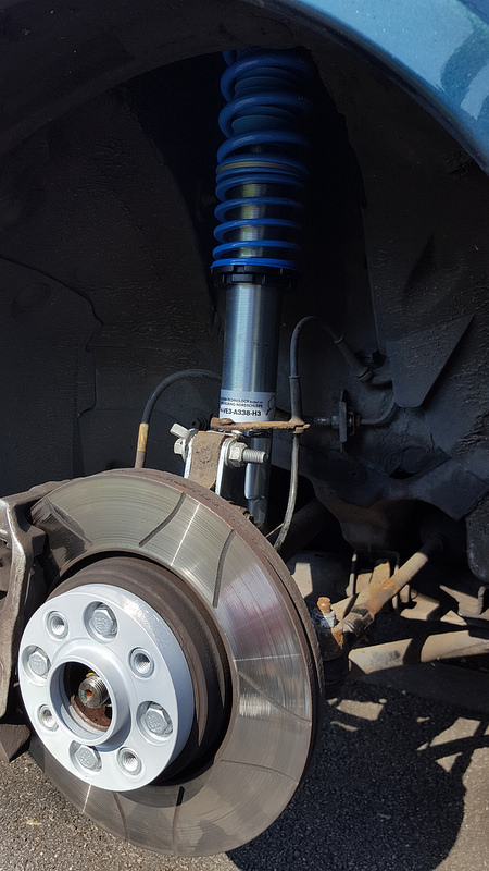

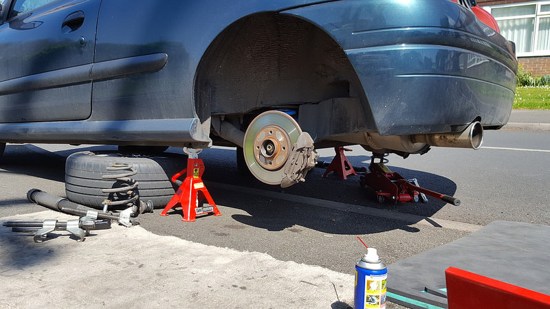

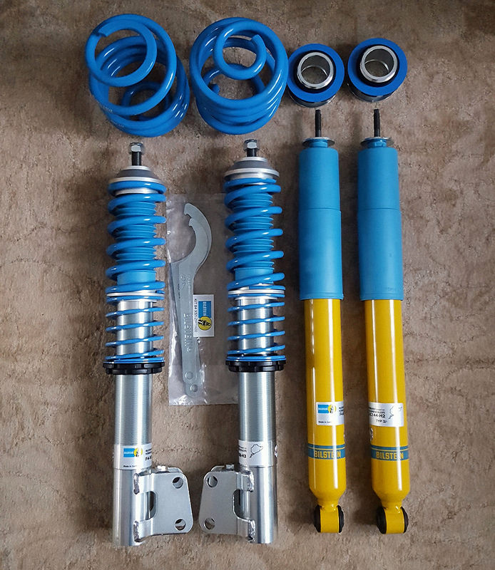

Inner ARB bushes, camber bolts, front H&R bolt on spacers and coilover socks all on order. Best get here before next weekend.
More to come tomorrow :cool:

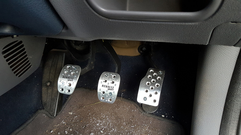

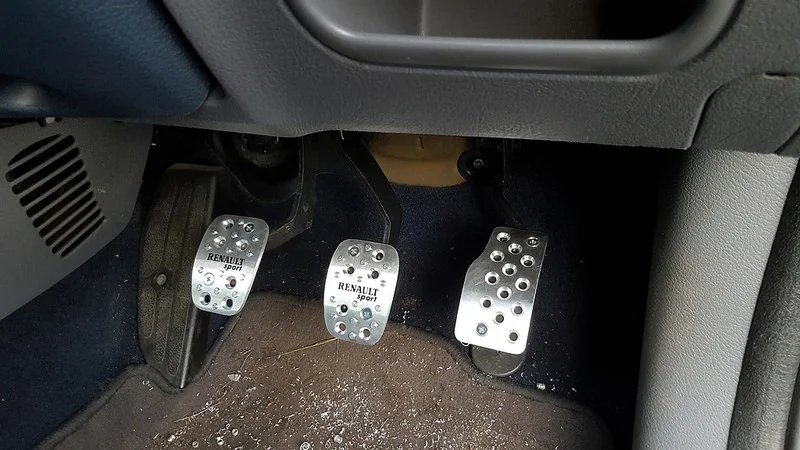

They're of a good quality it seems, just annoying that they don't fit the original holes in the pedals.
I managed to make them work using one original hole and drilling another hole. Would have just been better if they were a simple bolt on affair than having to drill new holes.

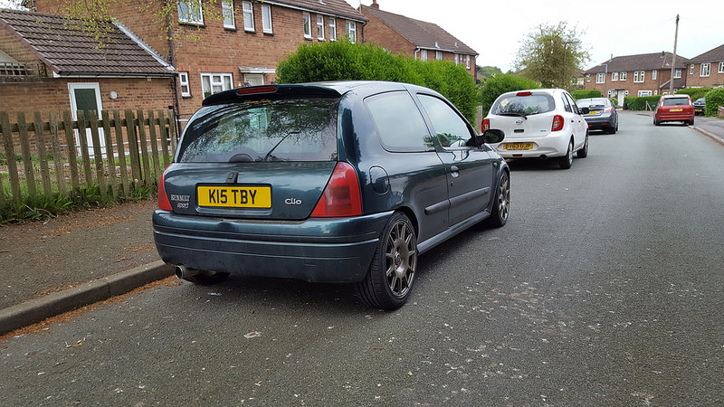

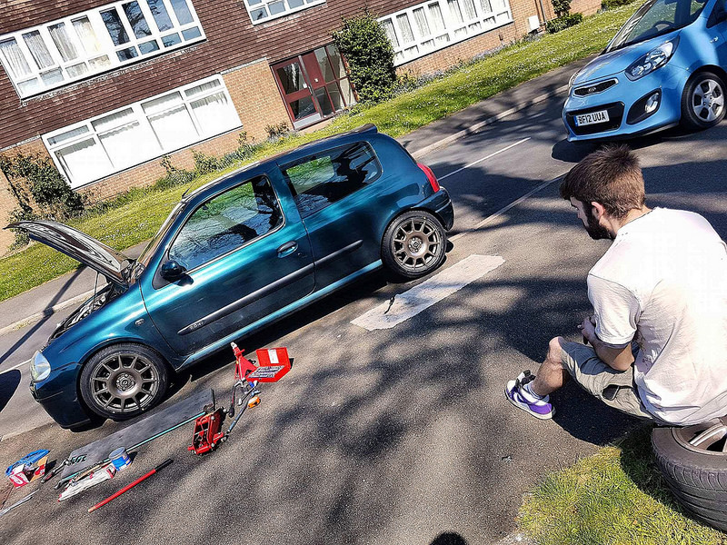

So glad the weather was sick today, normally it rains when I want to do stuff
Anyway, I did stuff
Started off like this..
Took some stuff off
Fucked this stuff off after seeing @Dr Jekyll without them
Added some new shiny stuff
More shiny stuff
Then after even more stuff, it looked like I'd done stuff to it
(ignore the million degrees of positive camber in the last pic, I adjusted it after with camber adjusting stuff)
A mate caught me admiring my stuff
Put some old stuff back on the front as the tracking seems pretty bad, will do to get me to work where I can bang it on the Hunter tomorrow.
I'm quite happy with it :grinning::cool::hearteyes:

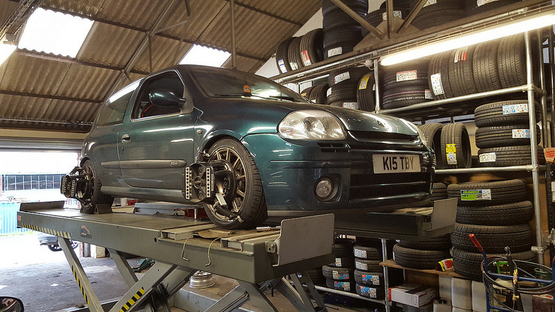

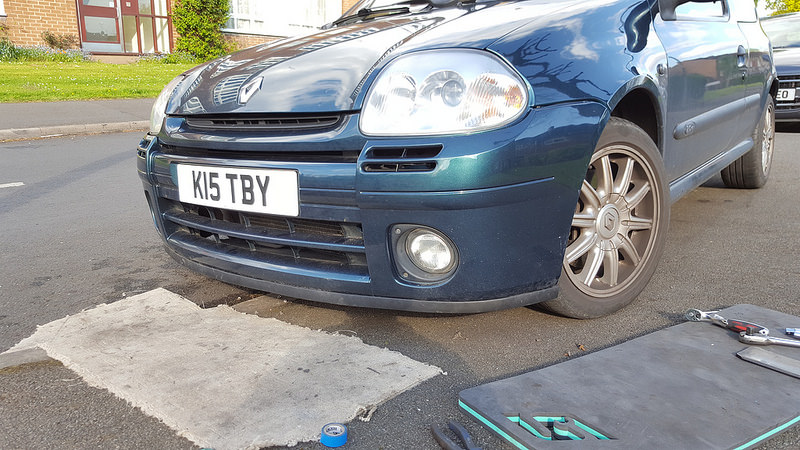

Did the tracking at work Monday night
Front's are catching the inner arch whenever I turn sharp, think I need to bring it up a touch tbh.
Couple of pics of how it is now:
