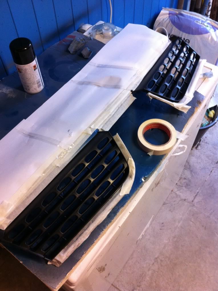

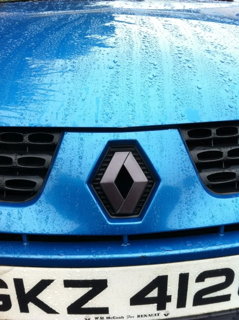

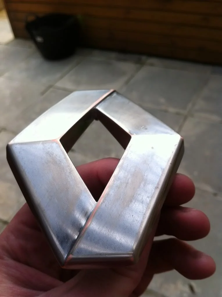

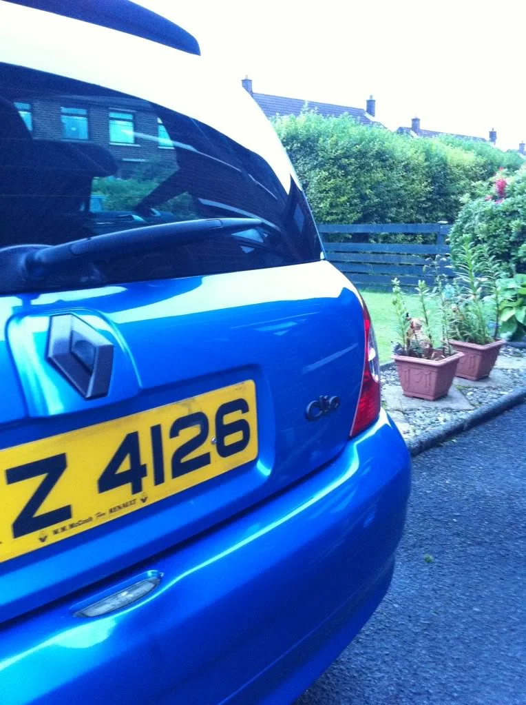

Decided to spray my front and back diamond badges and my four diamonds on my alloys. Hope you like

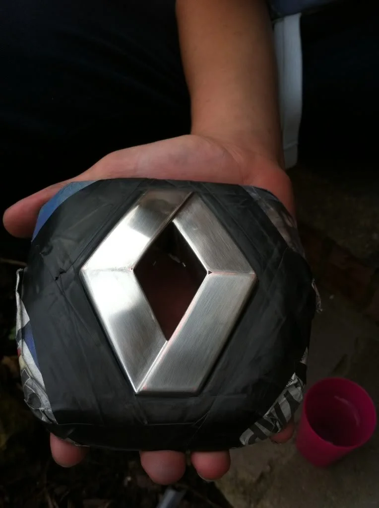

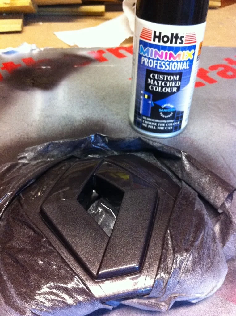

Started by sanding the badges down

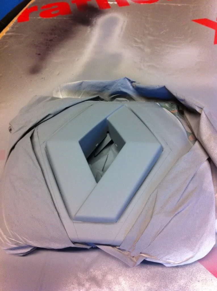

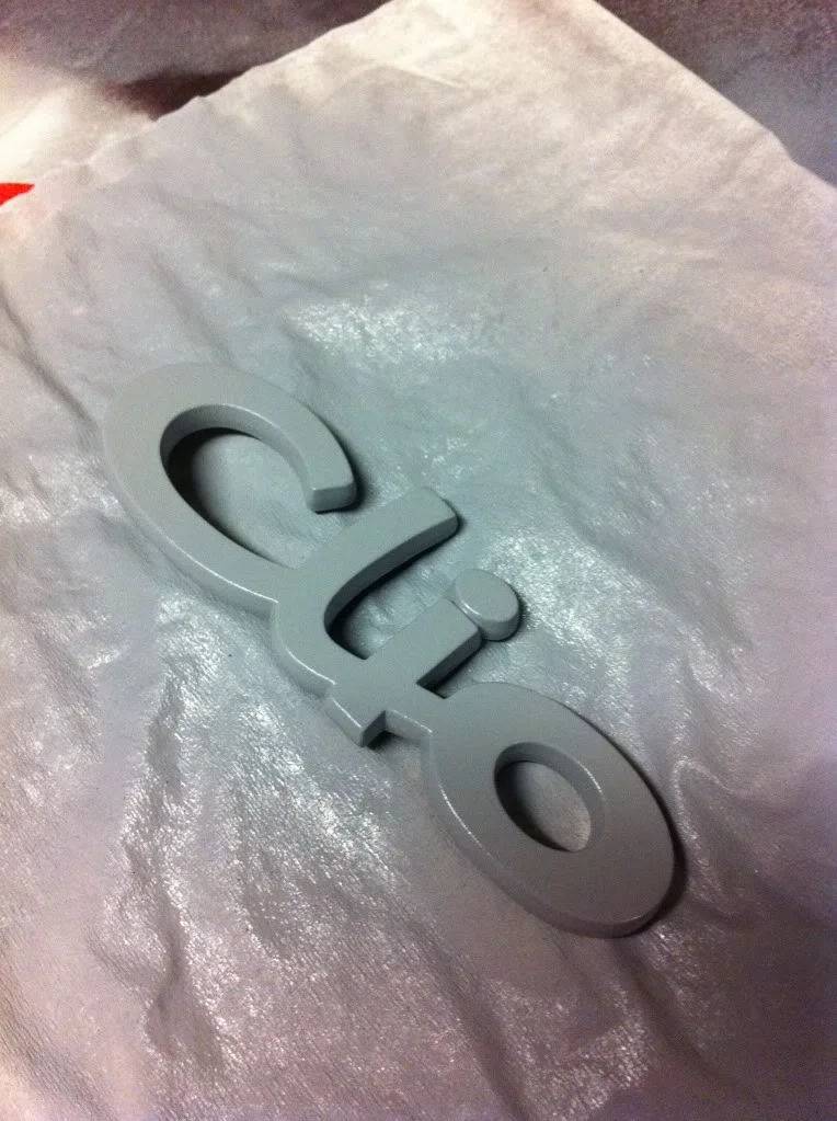

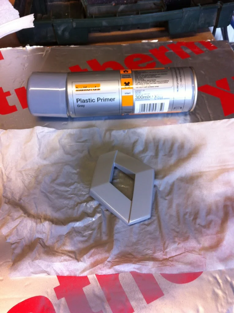

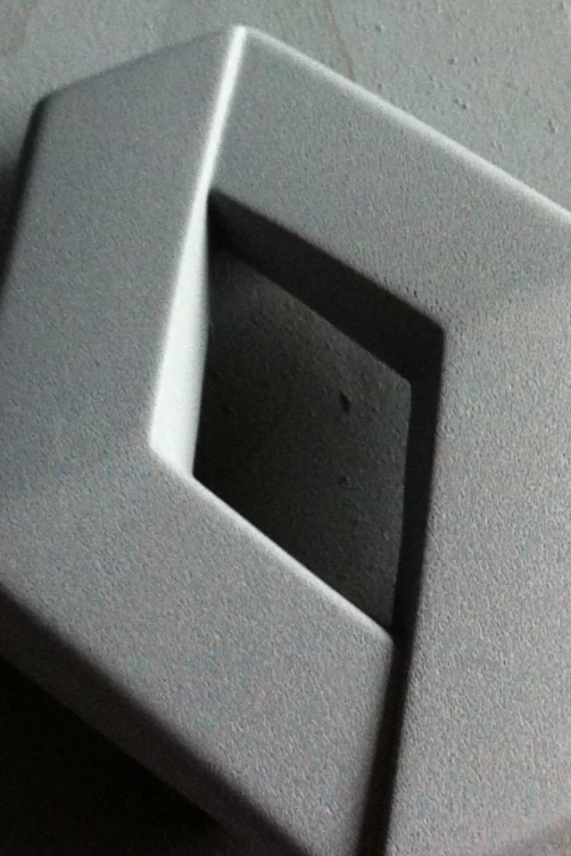

Primer...

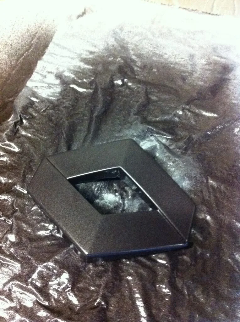

Done 3 coats of primer every 15-20mins, waited 2 hours then moved onto first coat of paint...

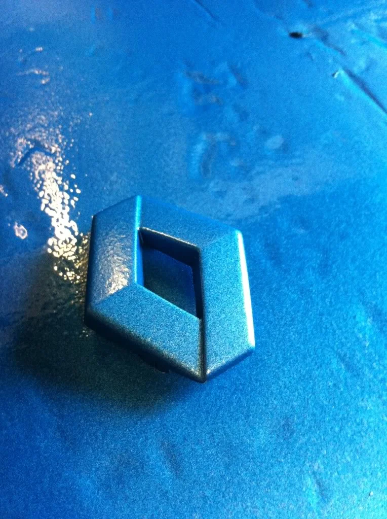

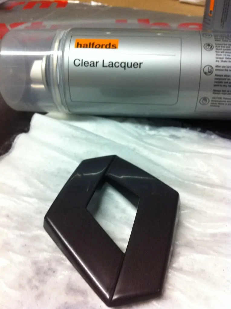

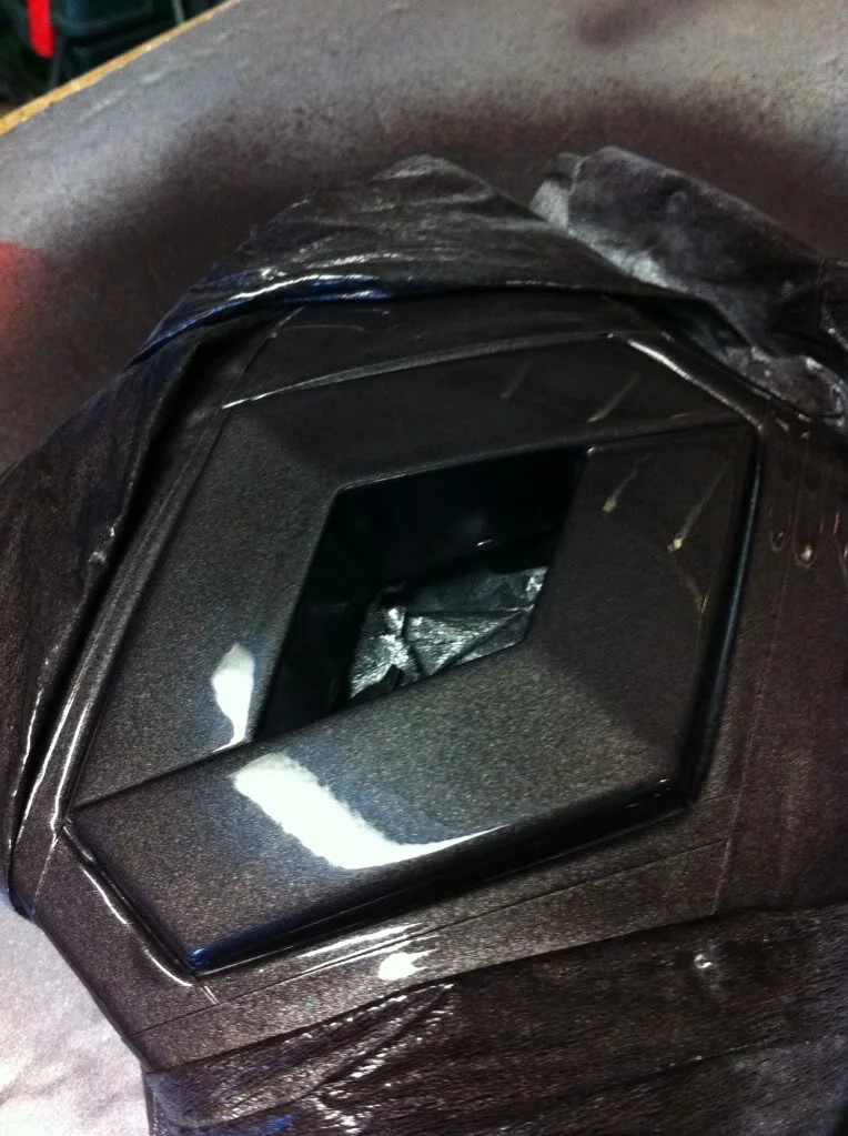

Left for 1Hour then laquer...

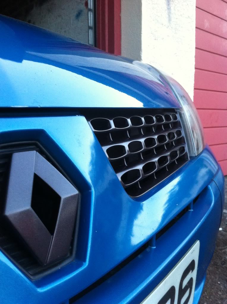

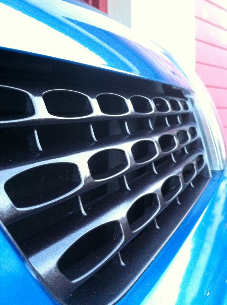

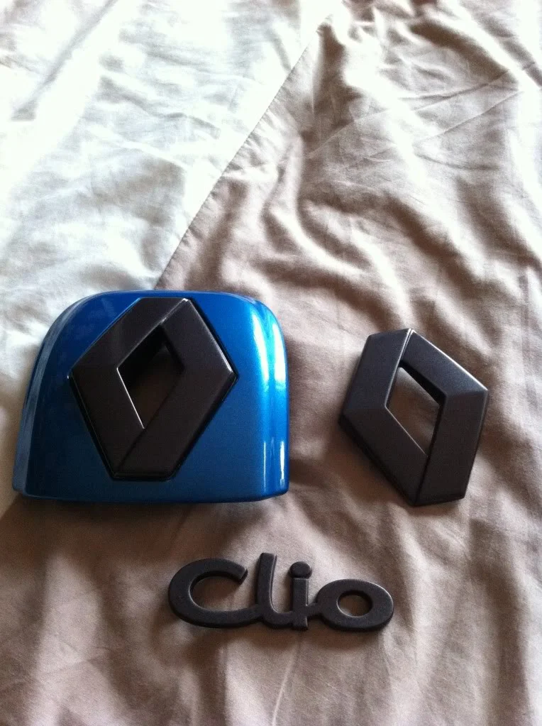

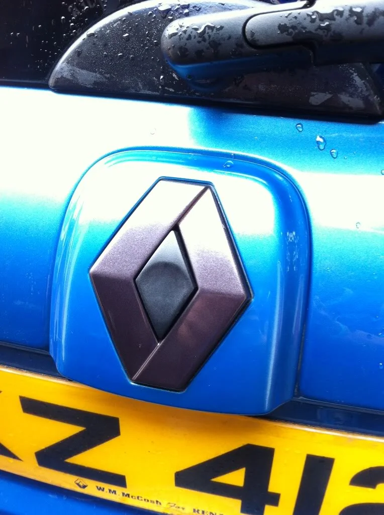

Finished...

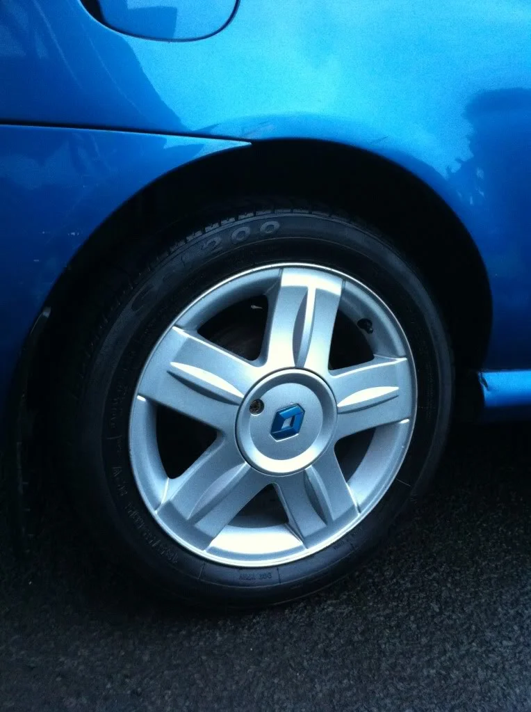

Done the same process with alloy diamonds...
Sorry for the amount of photos :)
Looks good that mate. I really want to do my alloys satin black, but I haven't got the balls, worried I'll mess it up!!
Looks pretty gid.
Why didn't you remove the rear badge? Take the glue off with a knife then push the badge through and out it pops. Simples.
