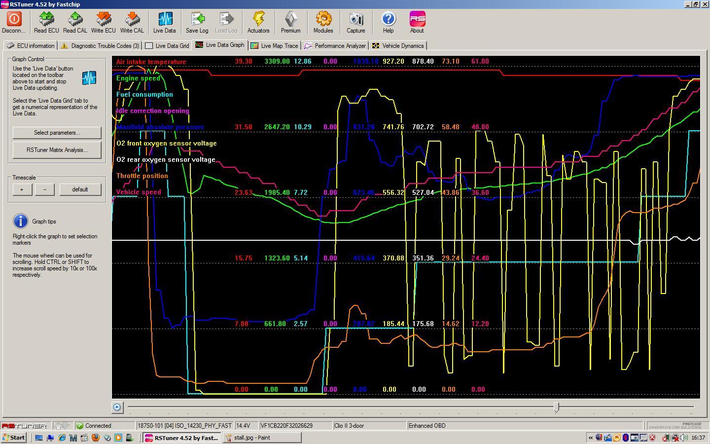

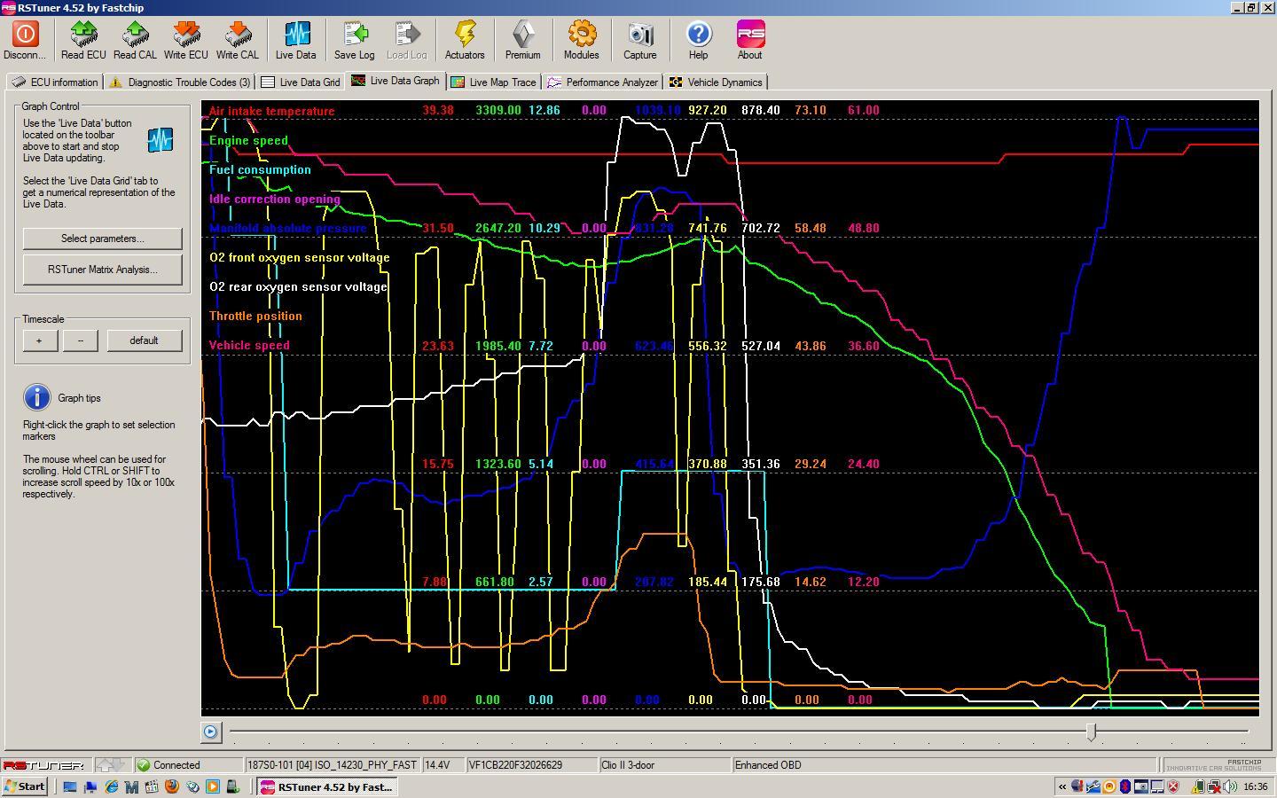

I took these live map images, which I found a little interesting. This is when the car cut out:
Note the rear oxygen sensor going nuts at that point? Well, I'm not mechanical minded, but looking back at the entire journey map, the rear oxygen sensor did absolutely nothing right up until it came to the car cutting out - completely flatlined until the cut out. This is prior to the car cutting out:
Now I have a decat so I'm presuming the lambda (rear oxygen sensor) has been taped up and isn't being used. Is that a good assumption, considering the level line all the way until the stall? If so, then why does it go nuts just before the car cuts out?
If anyone who can read these things has any other input, please offer your assistance. If there's any other map data you require, give me some info and I'll set it up for next time. I tried to include as many factors as I could in the above. Maybe I'm missing one or two needed to diagnose a bit better.

I suspect the rear o2 might be a red herring.
Nothing to do with anything on the map screenshot, but have you tried upping turning the base idle setting on the TB up to see if that can catch it for now?
Its weird the way the ICV opening is dropping even when the engine speed is clearly below the RPM set point, it just sort of fades out to nothing.
