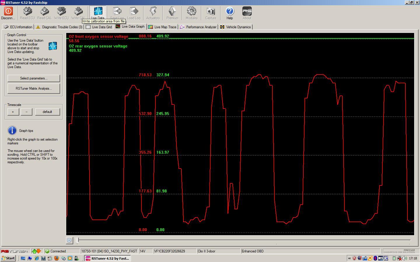

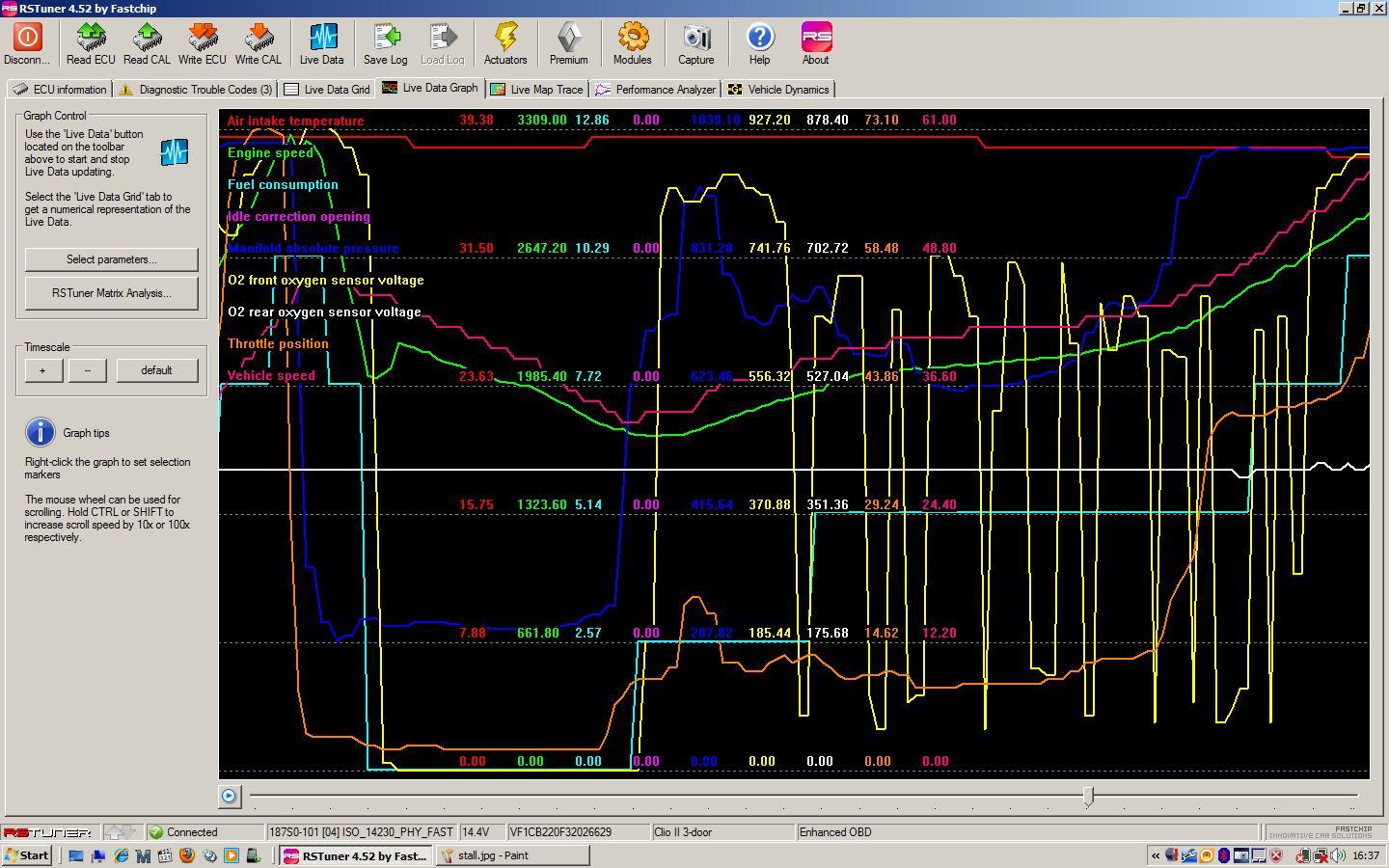

You can test the lambda sensor off the car with a multimeter and blow torch, heat up the sensor and take a voltage reading. I can't remember what voltage but when it gets hot the voltage rises fairly quick. Maybe the garage could test it?
When I did the live data reading on both lambda's, the front gave a low voltage reading until I revved the car, thus increasing it's reading before settling again. The rear, however, was a set voltage figure of around 492 and no matter how hard I revved the car, it did not change one iota. I'd have thought both sensors would have given identical readouts, no? The rear lambda, like I said, didn't even flicker.
Here's the graph readout again:
This is prior to cut out. You can see the rear lambda is doing f*ck all.
However, when the car cuts out:
Erm, what's it doing now? I think I've got a duff lambda, which may or may not be causing me problems.

Didnt you say the rear one wasnt in the exhaust anymore? if so I would expect its value to be pretty consistant if its stuck in fresh air.
  UR R26R.5, VW Golf R
The mechanic said it's connected mate. Apparently both are.
With what you said in mind though, surely if it was disconnected and a consistent and set value, it wouldn't shoot up when the car stalls?
Like you also said, it could well be a red herring, in truth.

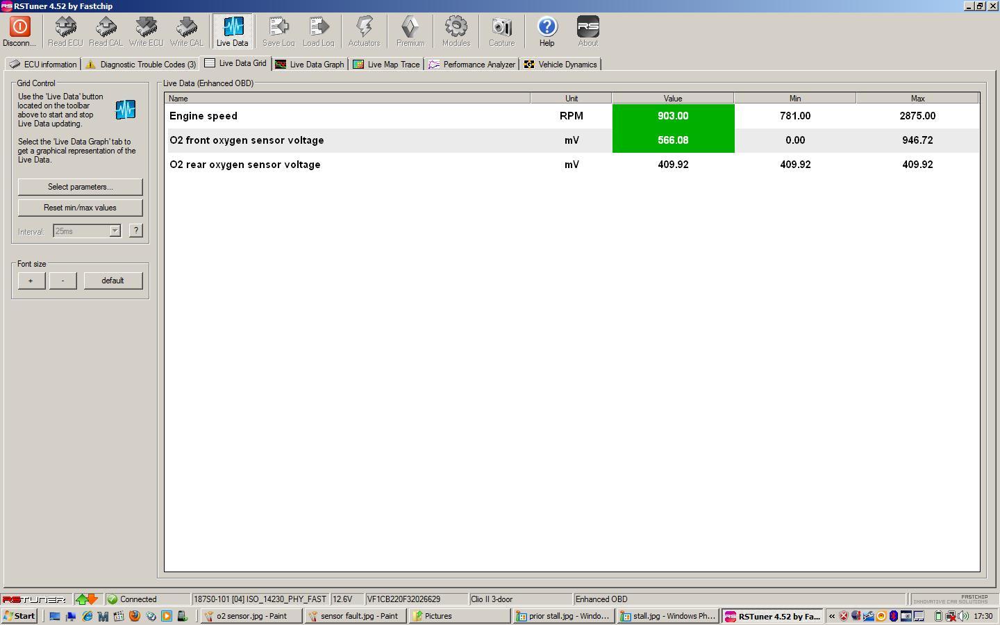

Right. Here is the image of the o2 sensors (lambda sensors) in operation with the car running, live data:
See how the rear sensor is doing absolutely nothing. I checked and it's both connected to the ECU via the loom and plugged into the decat.
Other image showing data grid. Bear in mind the front sensor was fluctuating up and down constantly, I merely snapped this shot at random. The rear didn't budge once:

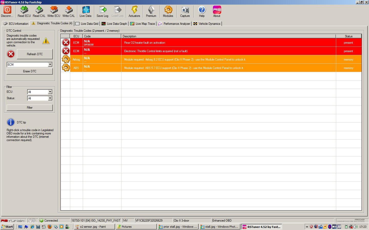

Interestingly, I then got under the car and disconnected the rear sensor. I didn't remove the lambda from the decat, but instead just unplugged the cable connector from it's housing to the main loom. I figured this would do the same job as just removing the lambda from the decat?
Anyway, I then checked the RSTuner diagnostics again and got this error:
(Rear o2 heater fault on activation if you can't view the image) It had picked up that the rear sensor wasn't activated. Even more interesting/alarming was that the front sensor didn't work with the back sensor disconnected. I just got two flatlines when going to live data view. Surely the front sensor should still work if the back one is unplugged?!
Could make this into a novel, but I will get to the bottom of this problem!
