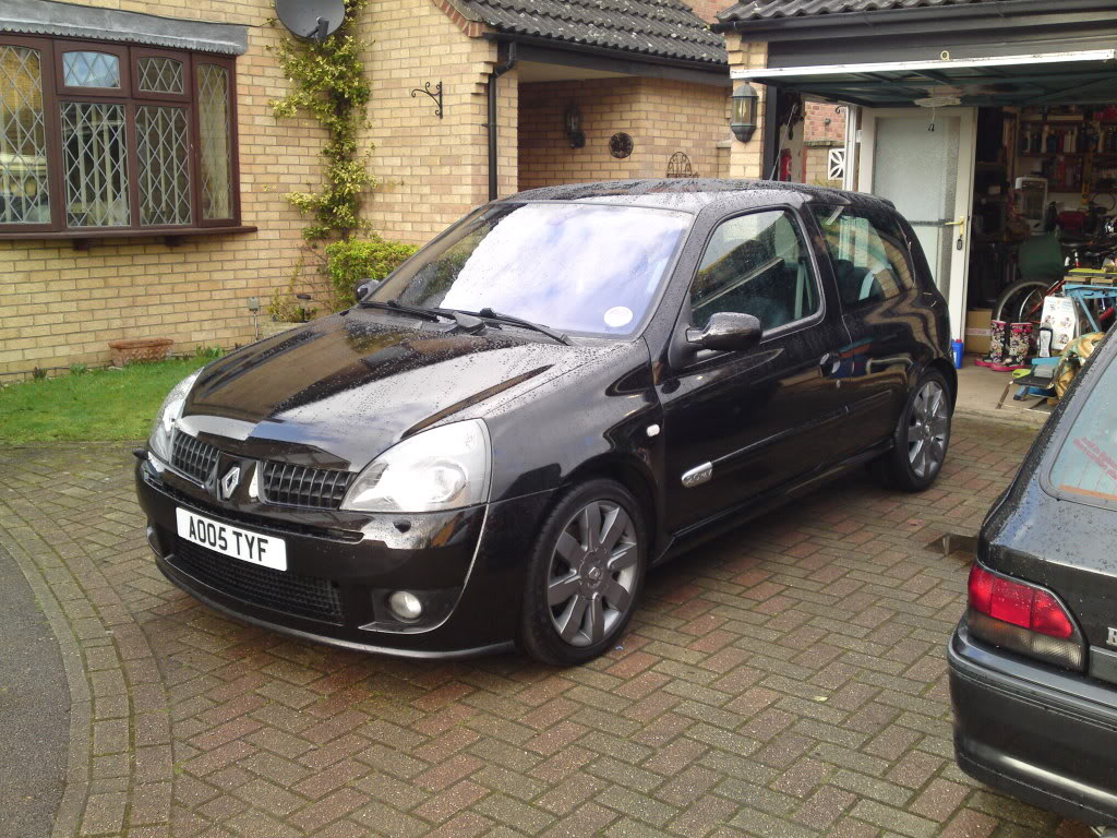

i was very pleased with the Spec and the history of the vehicle :approve: so after a good roadtest and good check over (not that it was really needed as everything was tip top and been to the likes of 519automotive, JMS and wests reanult), i handed dean the £4300 and set out on my trip home :)
the drive home was faultless, it was such a smooth drive! seemed very powerful and even though i didnt want to push my luck yet, it seemed to just grip and grip around roundabouts! and still managed 39mpg :O which was alot better than my valver lol
the car just after i had bought it:

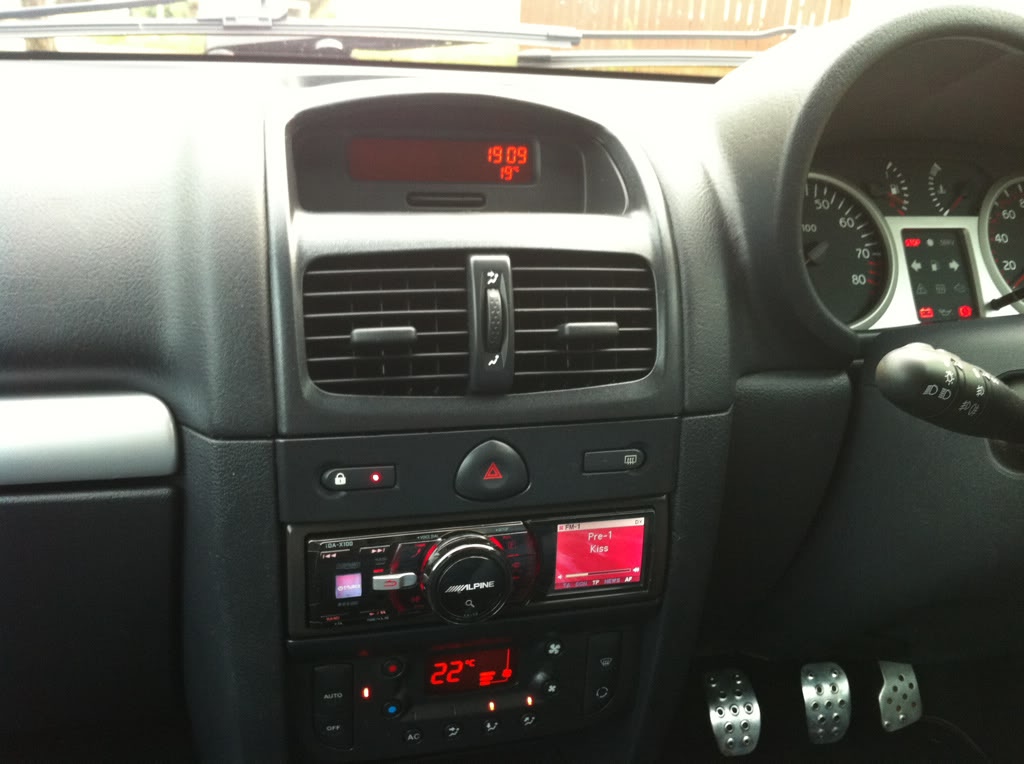

a week later although i loved the OEM radio and that i decided that i would JUST TRY my old headunit out as it had FULL ipod controls built in, and only a matter of swapping it back if i didnt like it...or so i thought :dapprove:
when i came to remove the original head unit all the clips were mangled and it was all held in with silicone :S so once i had started, it needed to be removed. the clips were beyond repair so i had no choice but to fit my old alpine headunit. :(
luckily it all lit up red so wasnt far off of the OEM orange bulbs throughout the rest of the interior :)
after fitting the alpine headunit, the sound quality was not as good as the original and i thought it was lacking from the rear especially...so i got in there, pulled the rear speaker grilles off and 'OH' no speakers lol but the wires had been joined from either side and a cable going into the boot that wasnt connected! luckily i had some speakers in the garage and they fitted straight in after re wiring the loom! much better having surround from all around :p

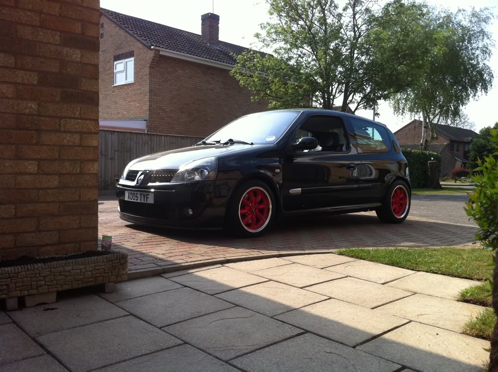

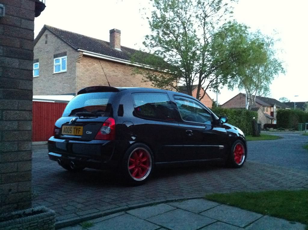

after a few more weeks i decided that my 182 was looking a little 'LOST' in all the other BG 182's on Cliosport as all BG's seem to have the anthracite wheels and cup packs (not saying theres anything wrong with that :rasp: just i like to be different :D)
so next on the agenda was colour choice...

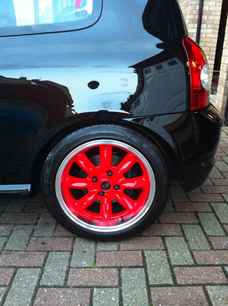

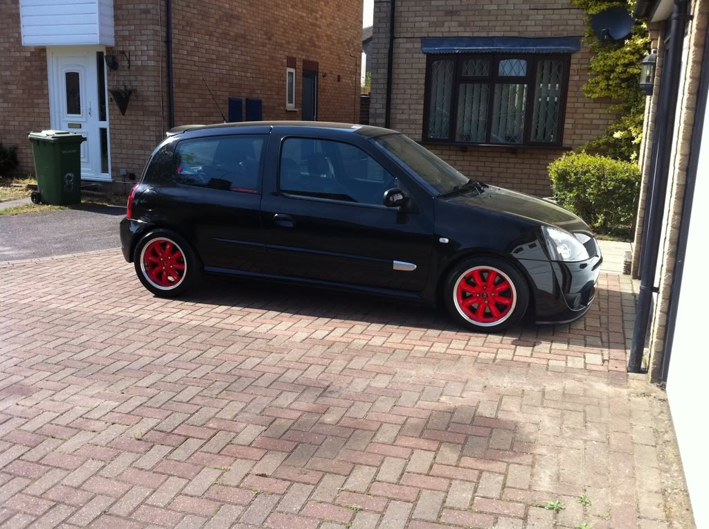

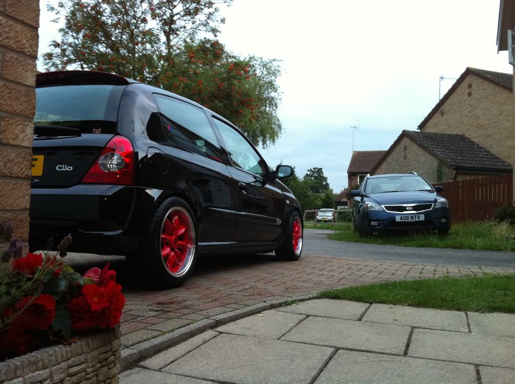

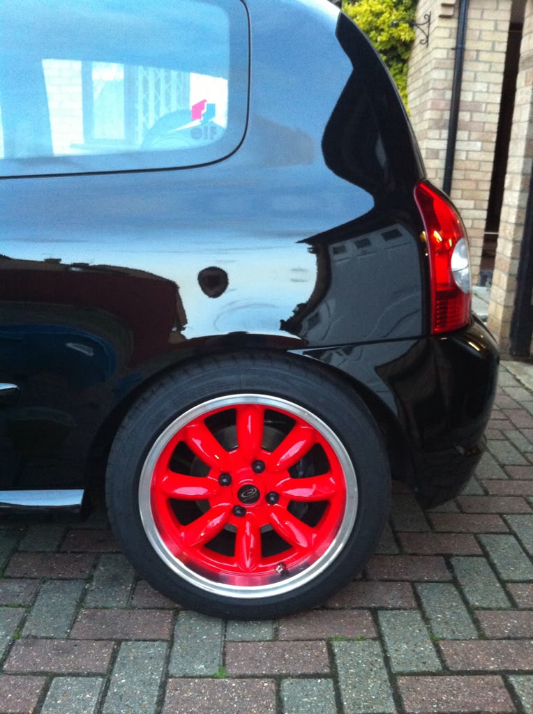

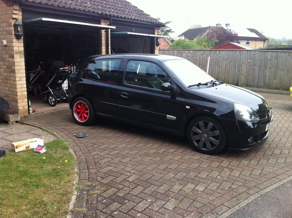

i decided that as my old ROTA RB's were red and the colour combination worked well on the valver, i'd go down this route :)

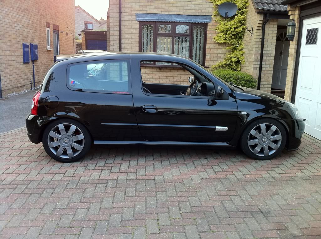

my old wheels were ROTA RB in red, 15x7 and ET30
i trial fitted the ROTA's on but due to them being offset 30, they foul the calipers so it definately going to need spacers, so itll have to wait until two new spacers have been ordered to be sitting pretty but you get the idea from these pictures :rasp:
in my opinion the standard 182 alloys sat too far inside the arches so heres the comparison between standard 182 wheels and my ROTA's (obviously rota's have spacers too)
Fronts:
Rear:
unfortunately i needed 2 new spacers, 2 new tyres and some majors lows to pull these wheels off! so they had to put them on hold for now :(

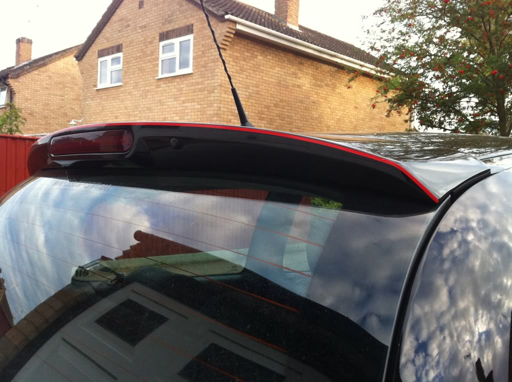

first up was the spoiler stripe - i can almost guarantee i was the first with this, although a few others have followed suit! (YOU SHEEP BAHHH!!! :rasp: lol)

Car looks really good, what did you use for the red stripe on the spoiler, oh and whats with a pedo bear sticker bit odd ????

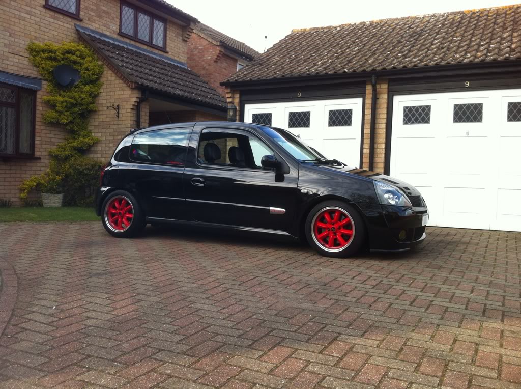

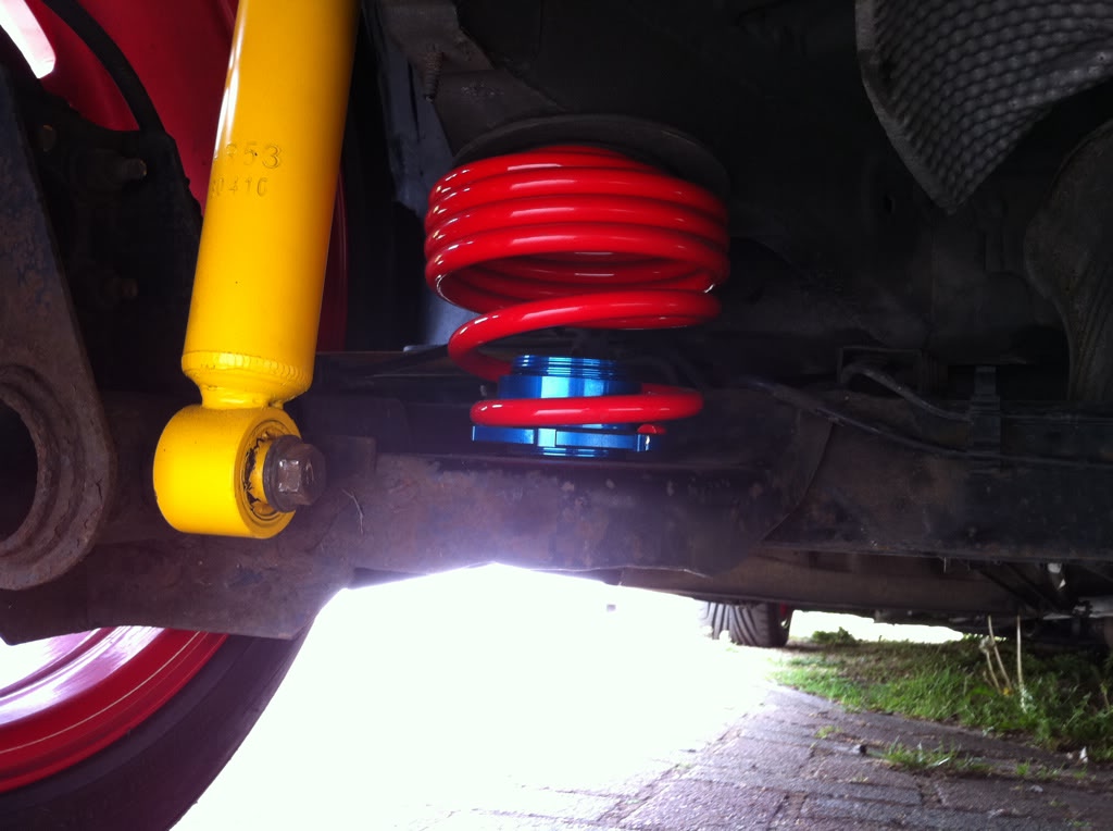

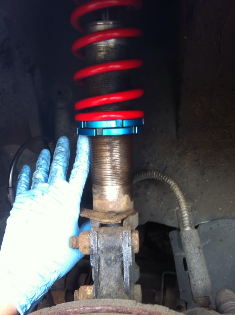

so after searching here there and everywhere and getting info on all different sets of coilovers...i realised that cup packs were a B*****D to buy for and money would not allow for me to buy some 'decent' coilovers!
so in the end, i settle for some Vmaxx and ordered up a set of these and a set of extra spacers!
Vmaxx coilovers 60mm bolt spacing
and 15mm hubcentric delta mic spacers
when the coilovers turned up i got stuck into fitting them at work during my lunch hour :rasp: they were fairly straight forward to do on a clio so when i got home from work...
i thought it was sitting very well considering i had not set any of them up properly...literally just would them to the same level and fitted them haha

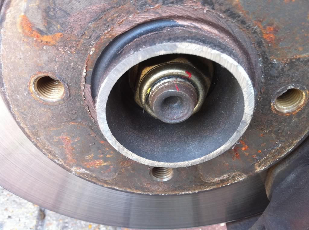

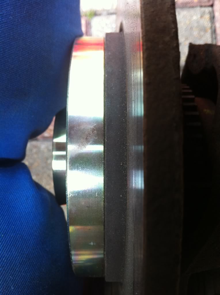

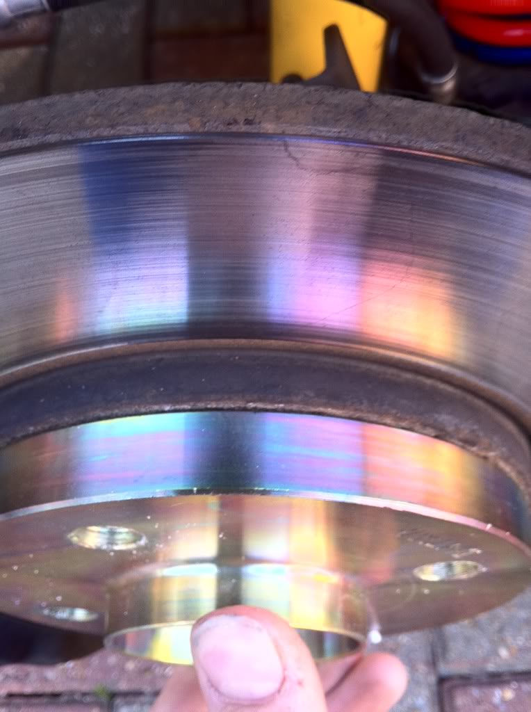

a few days later the spacers turned up, but many people were saying that the bolts were breaking on these particular ones and when fitting i found out why!
it was as though they were not bored out far enough

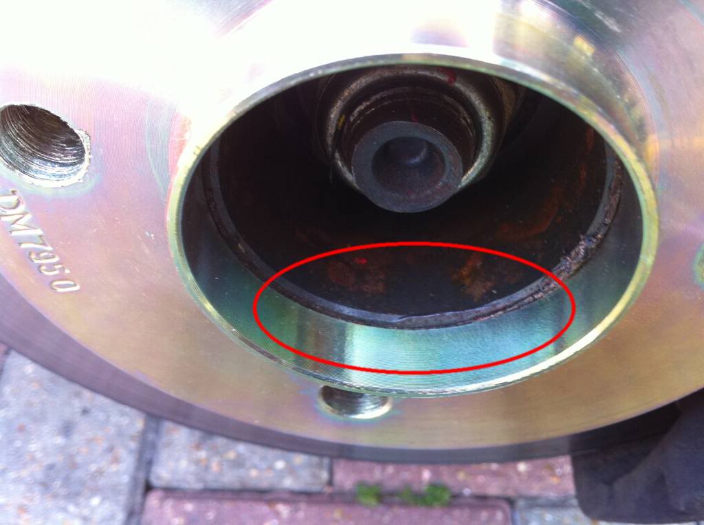

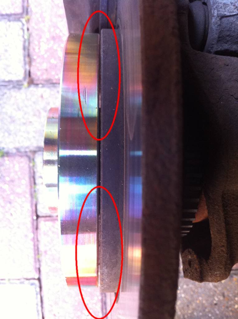

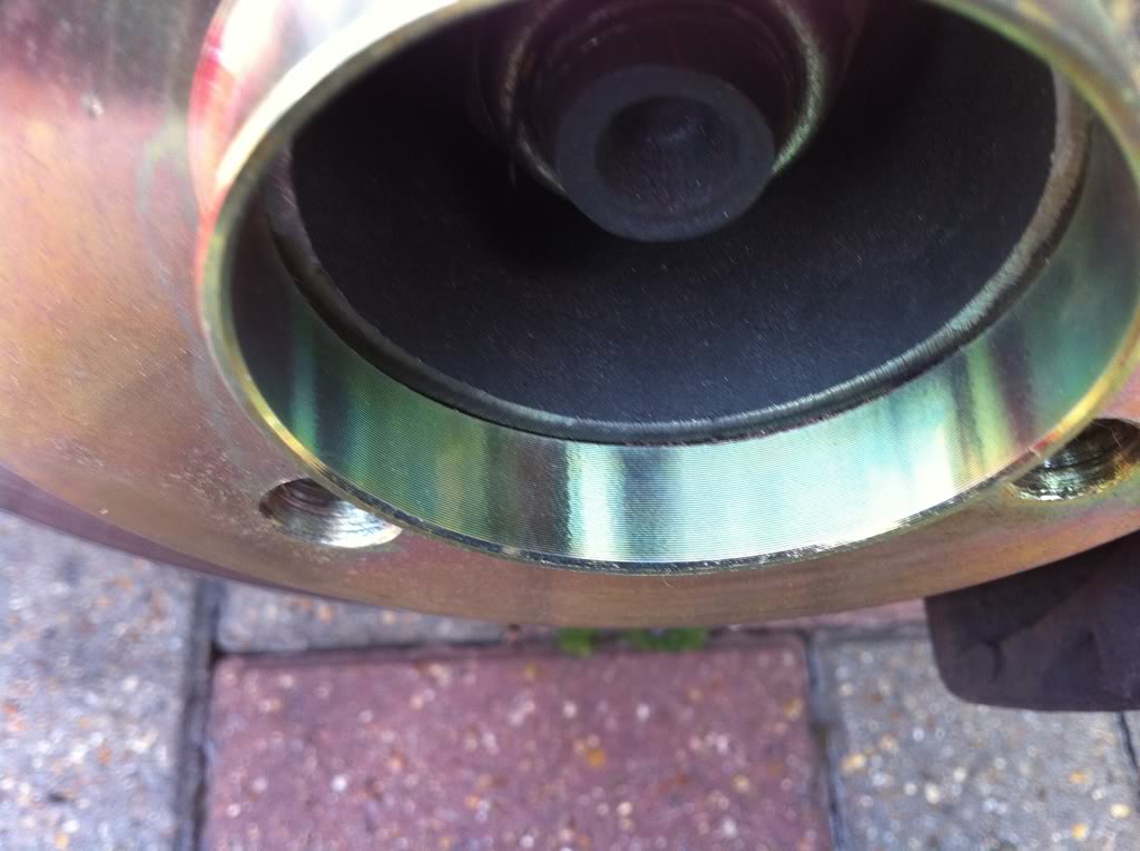

when fitting the spacer i found it wasnt sitting flush with the disc face!! therefore when the bolts are tightened, it is slightly stressing the spacer inwards and when driven this gap is allowing the bolts to work loose and eventually snap with the stresses being put on them.
what the problem is, is that the center bore isnt bored deep enough into the spacer therefore making it push against the spigot instead of the disc face!
what i done was grinded a small amount of of the spigot face (hub center) back allowing these to push in closer to the disc!
did this on my valver and had no problem...
pics
note that there is a small gap between spacer and disc
better pic showing this (air gap-can see the floor between the two)
spigot and spacer touching
heres what i grinded
and now how the spacer sits
and the spigot and spacer
after doing this and i was 100% on them sitting flush to the disc hub i set about fitting them and FINALLY able to get my wheels on yay! :clap:

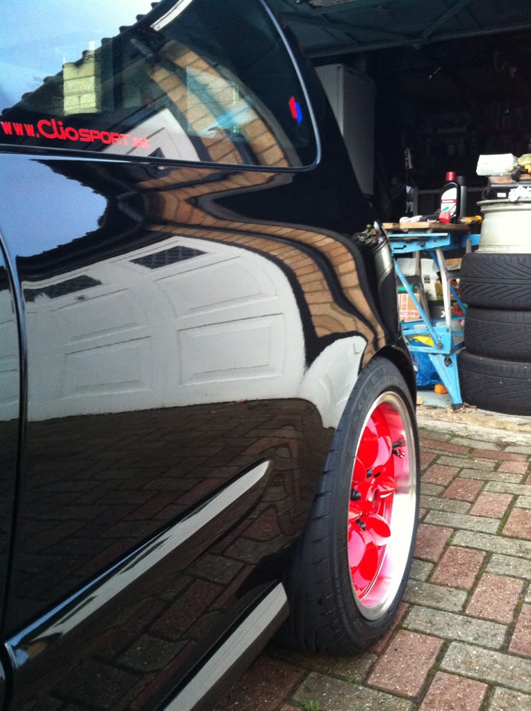

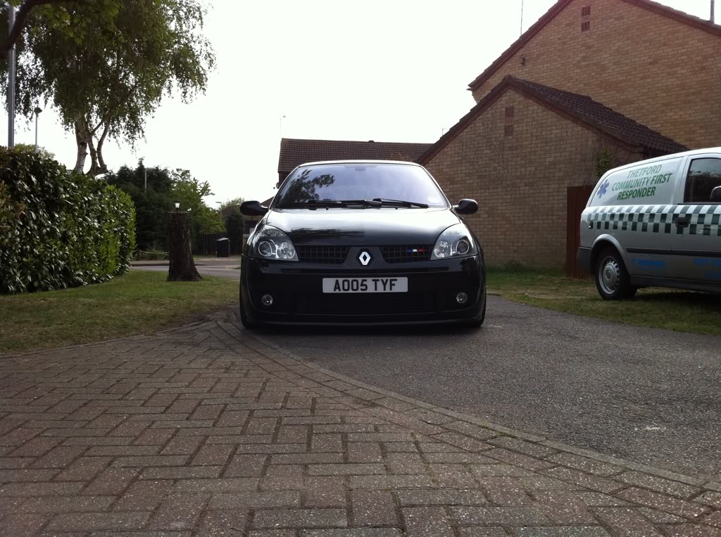

needless to say...i was VERY VERY happy with the outcome of this! it was sitting absolutely perfect!

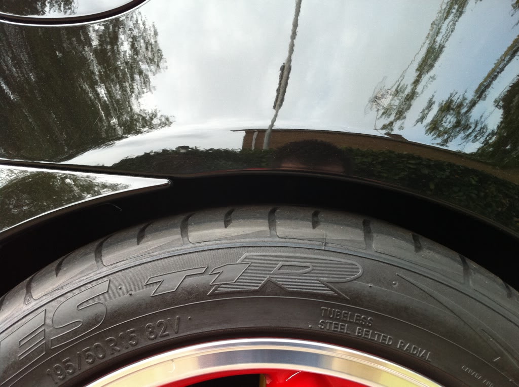

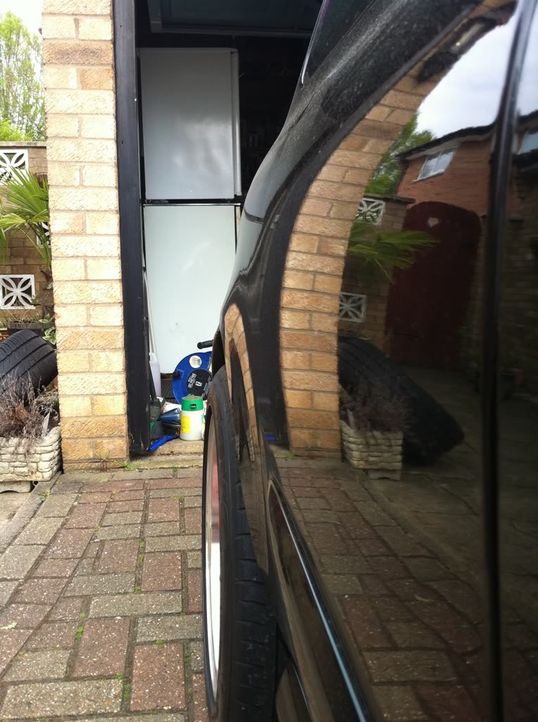

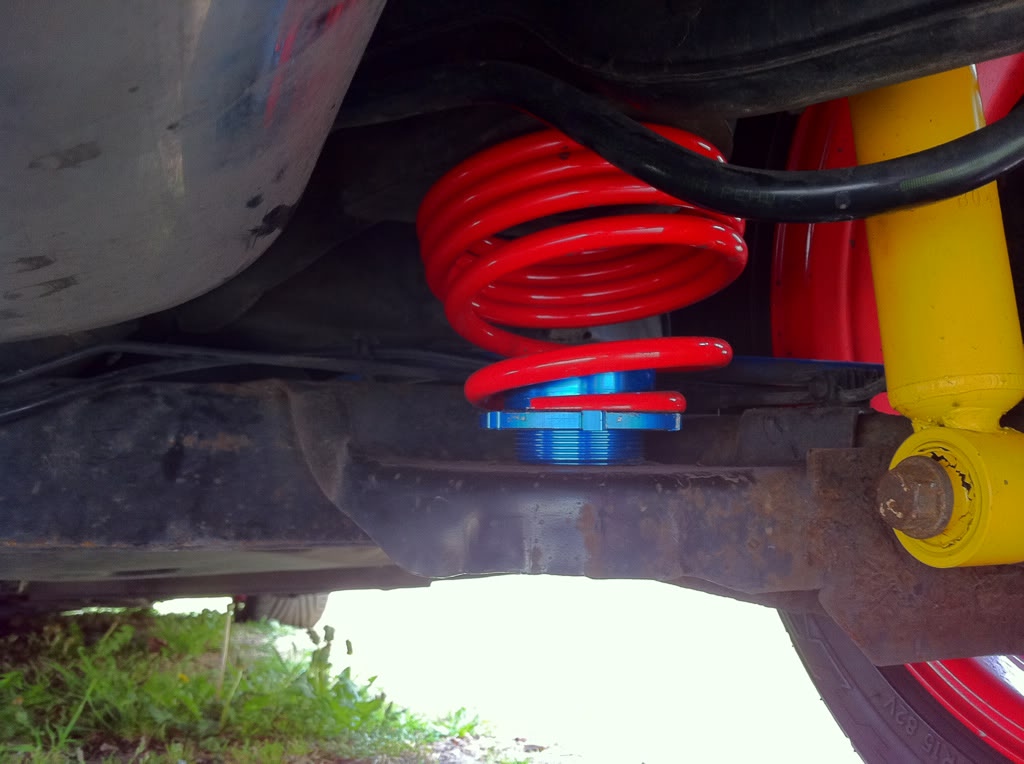

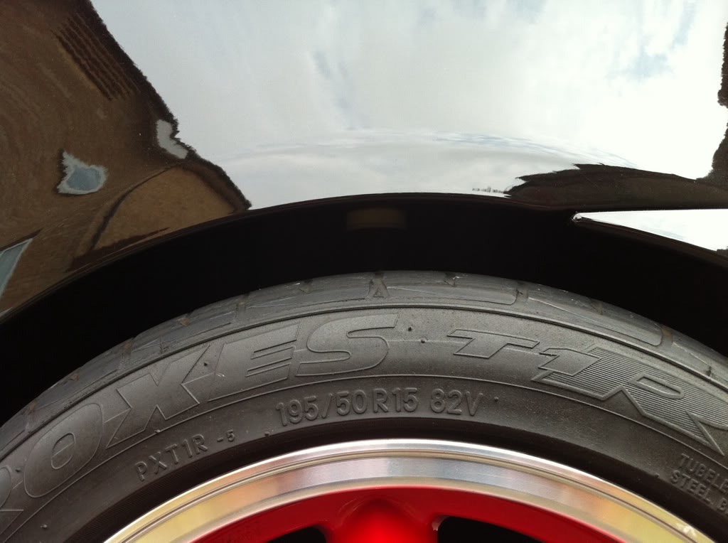

then i realised that the O/S/R tyre kept rubbing the arch when cornering and/or accelerating which was doing my head in! (i know the wheels are wide but they were staying) i done a little investigating and found that the o/s/r was sitting lower than the other side despite being exactly the same level on the rear adjusters :S
a few emails to FRED and him explaining that i need to set the o/s/f approx 7mm higher due to engine weights ect. i had it sitting a little better but i still had to have the adjusters wound unevenly
eventually got to the bottom of it...the spring had turned when i put it in and for some reason this was affecting the height issue! once sorted...i adjusted them as low as possible (with adjusters still in) and it was sitting perfect :D
the thing with the Vmaxx coilovers is that the fronts seems alot stiffer than the rears as when you accelerate (even really gently) they make the rear 'squat' down and thus, causing the rubbing where my wheels are so wide ;)
so...i must invest in some new coilovers in the near future! lol

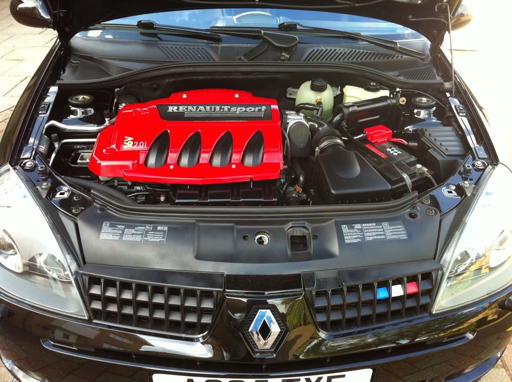

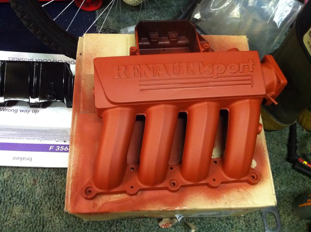

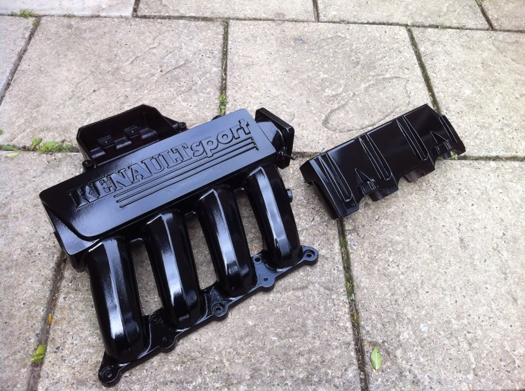

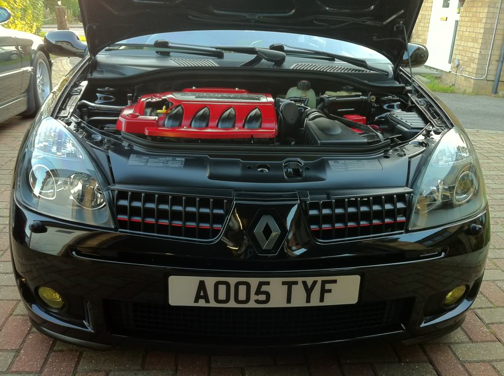

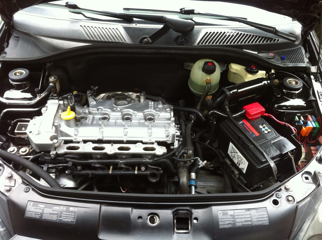

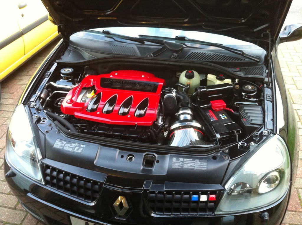

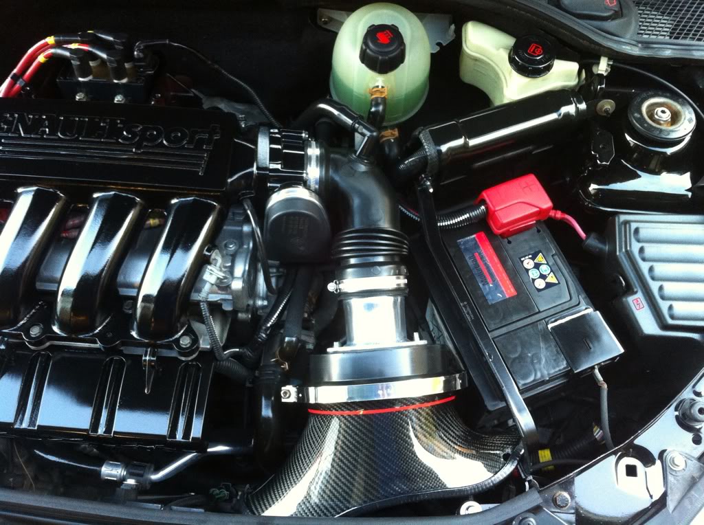

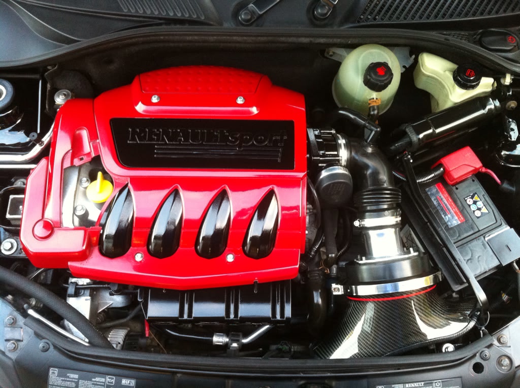

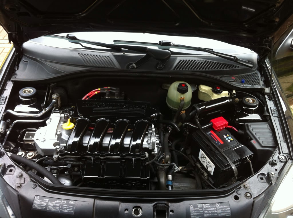

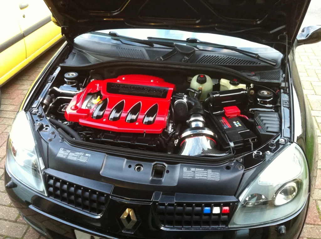

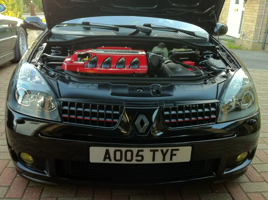

everything was coming together really well...until you opened the engine bay! it just seemed really 'drab', silver cover, oxidised aluminium inlet + fuel rail guard and just general dirt!

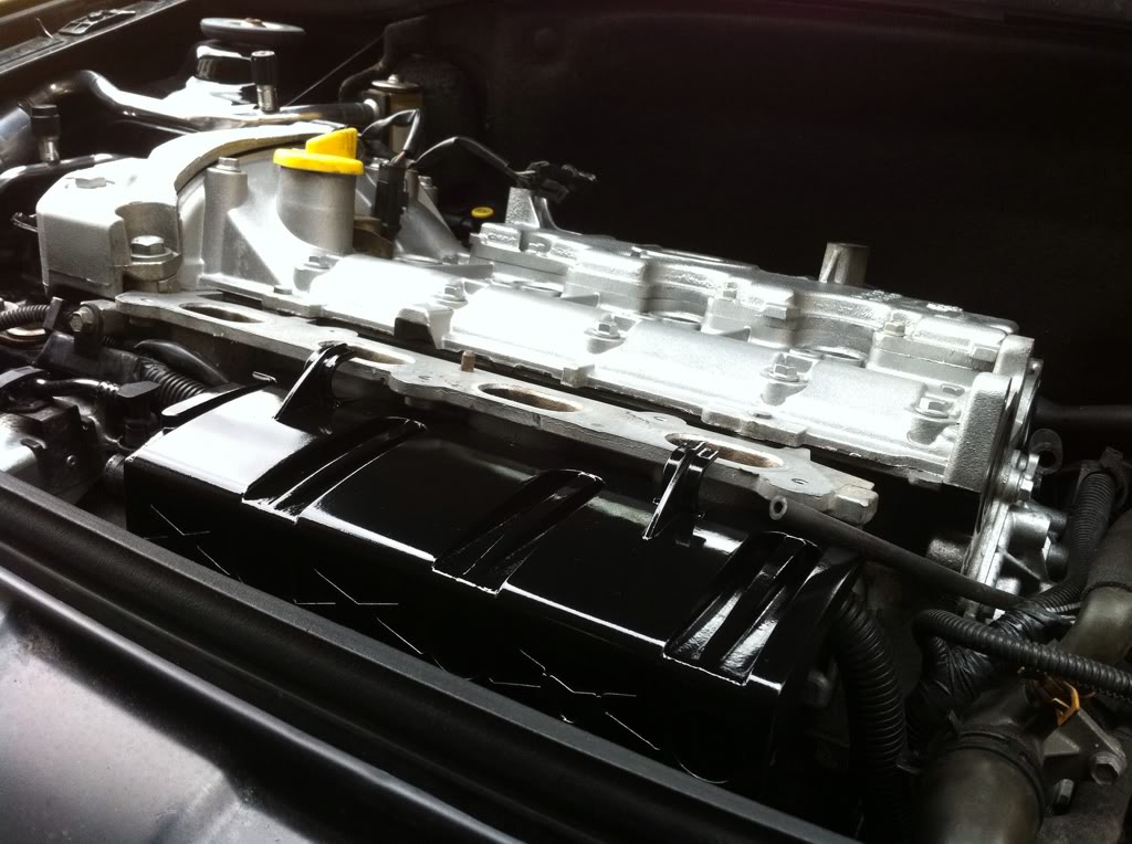

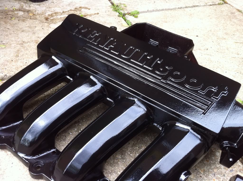

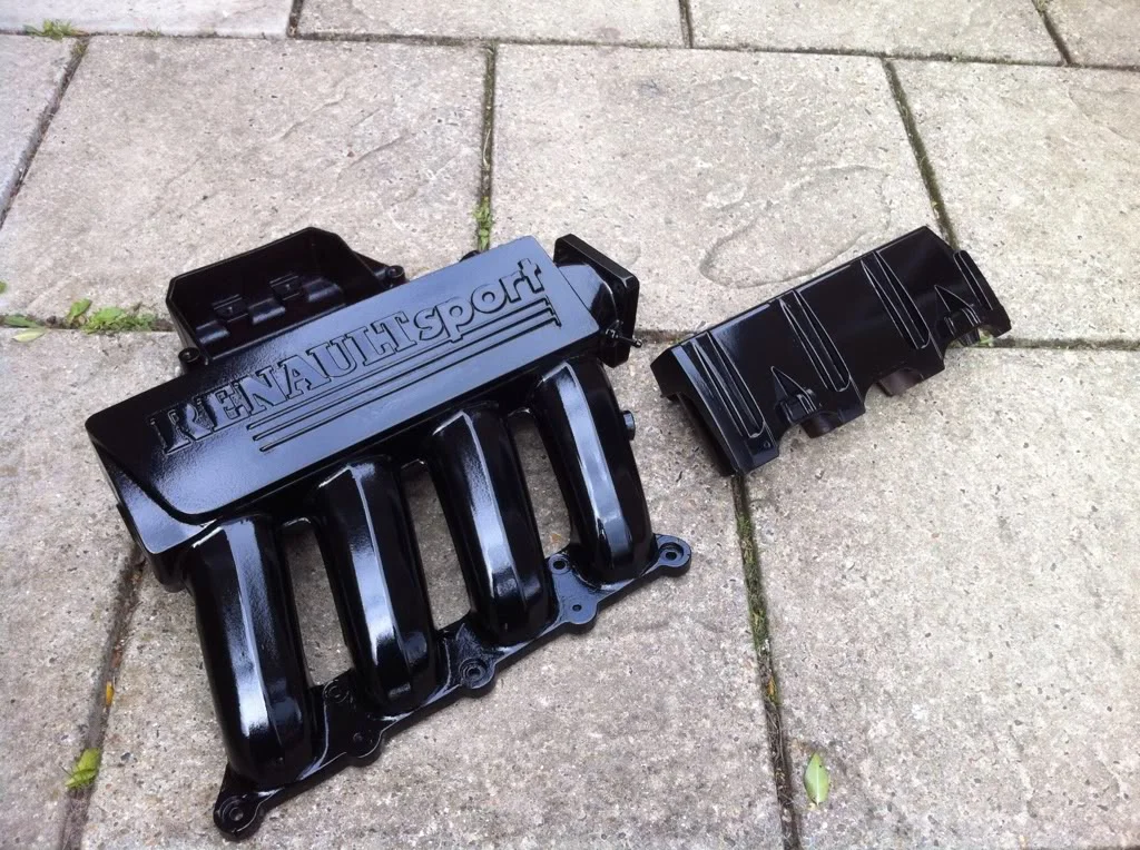

so next on my list was the inlet, rail guard and engine cover.
i bought mini chilli red paint - for the cover
and satin black paint for the inlets.
i took the inlet off for this as it was much easier to get into all the nooks and crannys and less risk of overspray.
i then cleaned it down using auto glym engine degreaser, dried off then 'keyed' it using 800 grit wet and dry paper, then cleaned again before setting about it with paint. i primered it using ordinary primer and then just satin blacked it with ordinary primer (it doesnt get that hot up top)
once dry i polished off the 'RENAULT SPORT' logo and refitted with NEW gaskets as there wasnt any previously :S
same deal on the fuel rail guard! then i took the engine cover and give it the same preparation techniques. then sprayed it all in 'mini chilli red' :D
i was pleased with the outcome although it needed the '2.0 16v' sticker for the oil cap cover :)
so ordered one up! :)
also fitted a new Motorcraft Ford battery with a red label...just to be anal :p and polished the air con pipes to a high shine ;) although the pic dont really show this lol

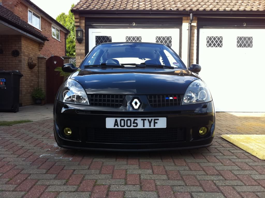

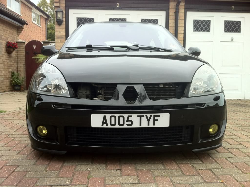

i then thought that the fog light covers could do with a lick of paint as well as the top grille and rear bumper insert as they had been sprayed poorly by someone previously and started to 'chip'
so i went and bought some more satin paint...removed the fog trims and rear bumper insert sanded them down, cleaned, primed, rubbed down again, cleaned, primed (repeated this until it was all level and no chips showing through) then painted!
its amazing how much difference something like this makes!
unfortunately the top grille is going to take a little longer to do so this is still on the waiting list...considering buying a new grille as a better 'base'

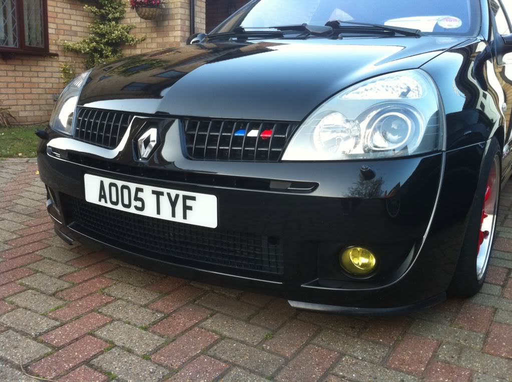

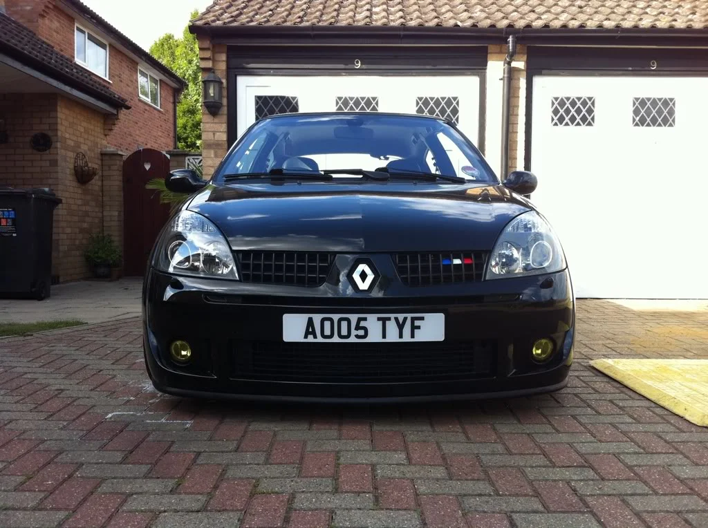

but i did introduce ANOTHER new craze to hit Cliosport! THE FRENCH FLAGGED GRILLE lol its only elctrical tape for now but it will be painted on when the grille gets painted :D
i also bought some new OEM grille stickers to tidy the bay up.
grille stickers and french flag:

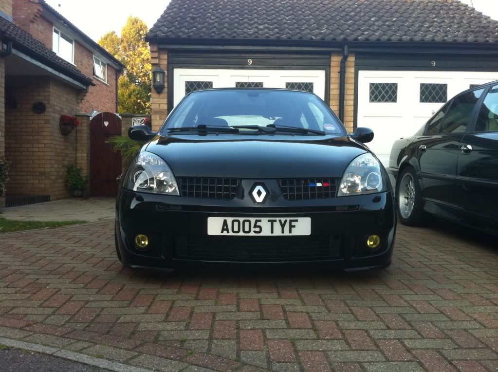

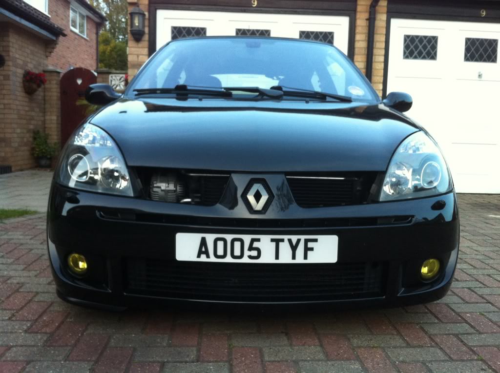

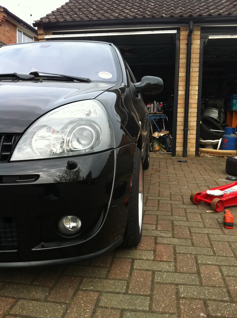

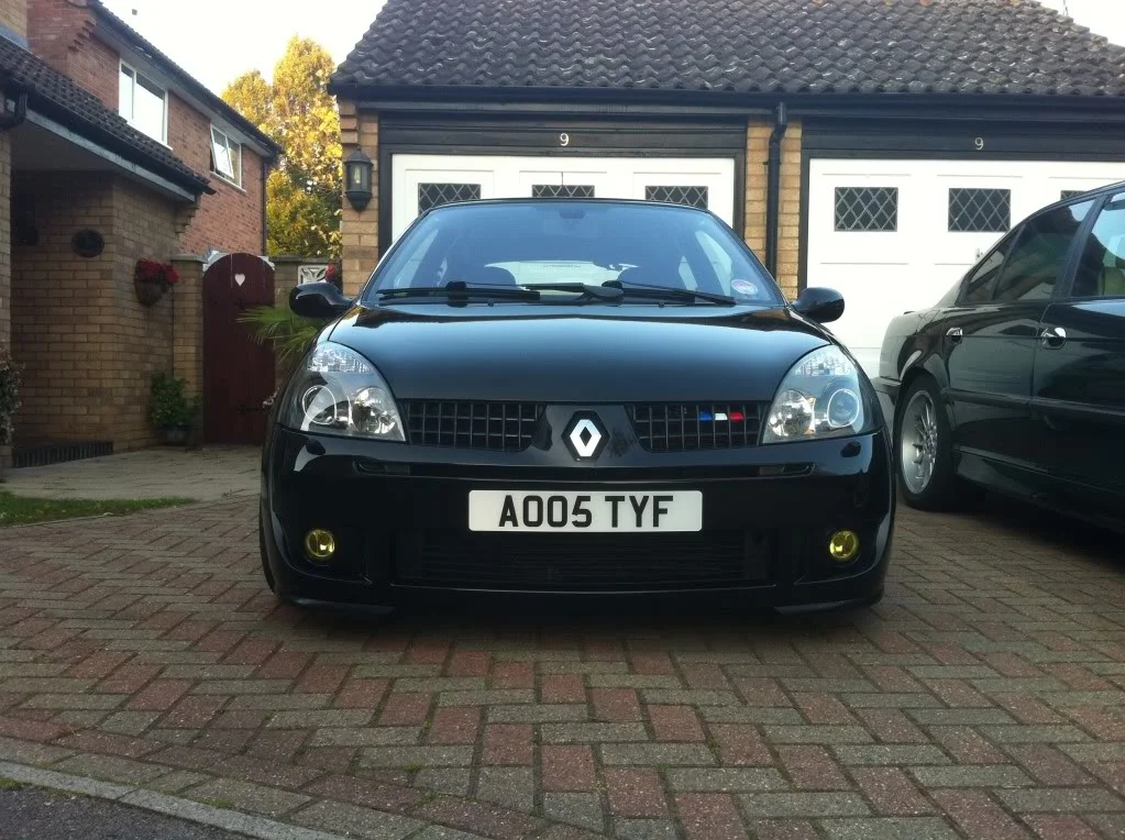

next up was the fogs, i decided that i loved my old valvers yellow fogs so i was straight onto ebay and picked myself up a sheet of lamin-x for £12. this was very simple to do, i literally just popped the fog trims off. cut the lamin-x to the correct size (but square) cleaned the lenses, centralised and smoothed the film on. at this point i thought 'crap how am i going to bend it round the edge' but i got the heat gun out and it just kinda formed arounf the fog with a little help :D
was very impressed with the ease of installation!
so, from this:
to this:
i also bought some 3000k Xenon bulbswhick i think look really good, and should (i say that very loosely) be legal! according to the VOSA handbook!
lol just depends on the copper if i do get pulled...

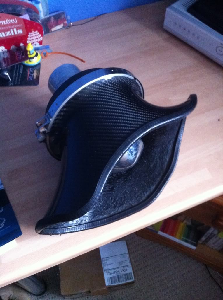

i bought a piperX panel filter and replaced the original filter, which i must say...i didnt really notice the difference. just a placebo effect that you now have a 'better' filter lol

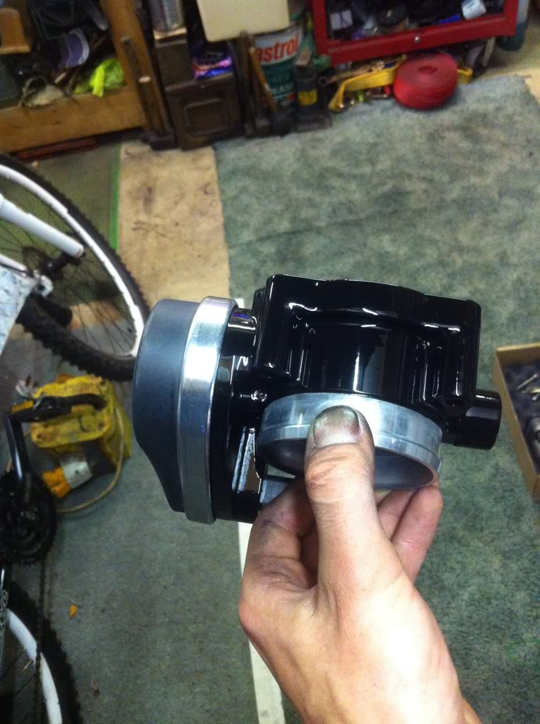

then it was onto bigger stuff and i recently thought about how much the CAT could be restricting the exhaust system (althogh its got a modified CAT outlet to help) and i wanted to hear a few pops from time to time
:eek: so i bought a Milltek decat pipe to complete the system :D and only cost £46 off of ebay brand new.
it turn up very quickly but i was waiting for the gasket set from renault for a few days :( so when it finnaly all turned up i fitted it at work! its definately changed how it sounds but im not too keen on the RASP :/
it also may have a small blow but we will see.
ideally i would like to go down the Throttle body route or SC route but i will just enjoy it for now :)
A cool little mod too tbh. Yes im a sheep and yes i saw it here first! :eek:

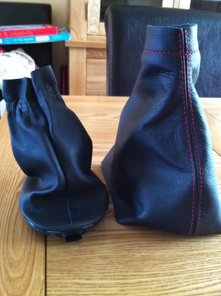

right, todays little update :)

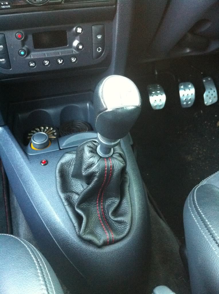

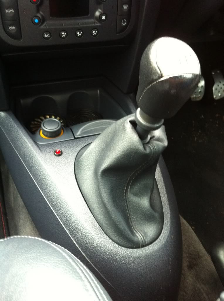

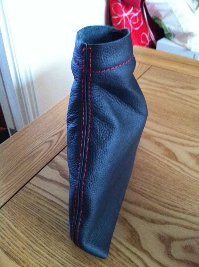

i decided that the standed gear stick gaitor looked a little 'cheap' and drab :dead:
so i decided that i would buy a new leather gaitor from eBay :D
i went for the black leather with red stiching to keep in with the colour scheme of things :)
in all honesty...it was a royal pain in the asre to fit as when it turned up, it was approx and 1 1/2 inchs taller and alot wider than the original.
but i persevered and got on with it, picking all the old staples out of the original plastic ring and making a few cuts here and there :p then it came to stapling (if your gonna do this...get a decent staple gun! its tough!!) where i nearly stapled my fingers many times as its a little difficult to hold lol
but i got it finished and fitted!
and this was the outcome :) :
its still growing on me but i do like it better than the original thats for sure! and the leather still needs to settle in as its still trying to 'rest' properly lol

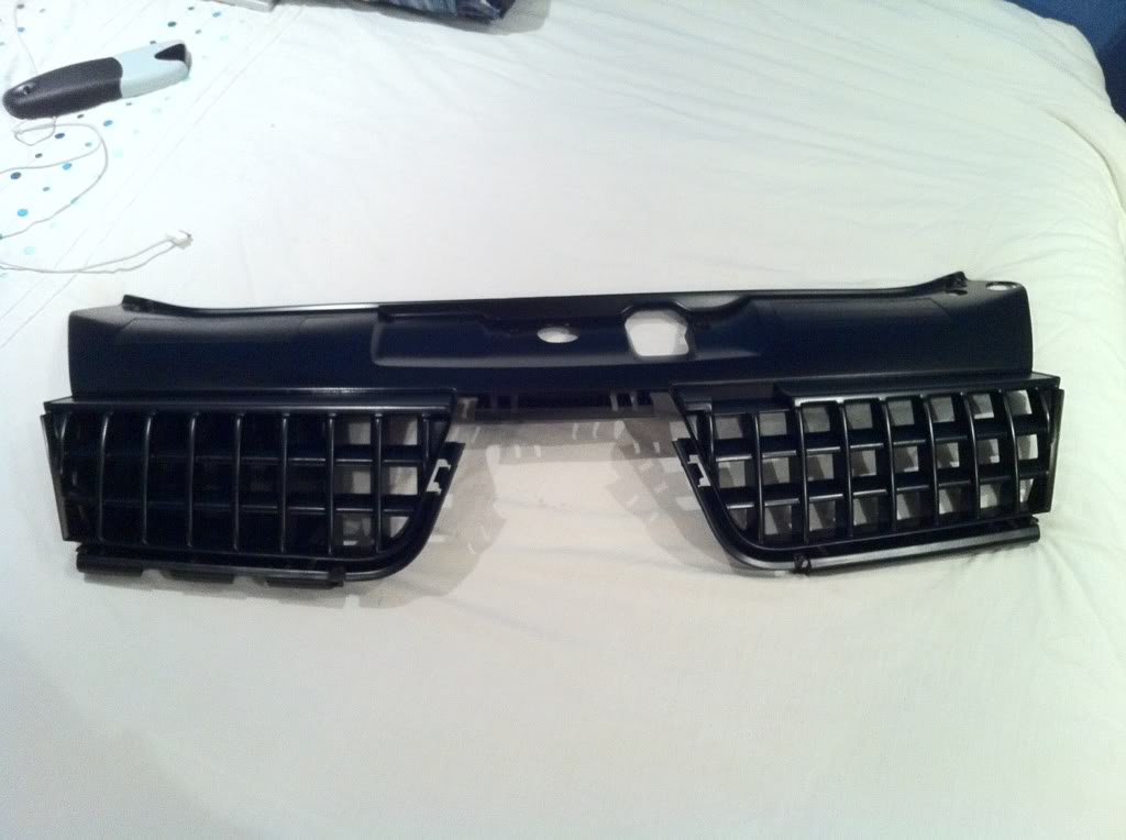

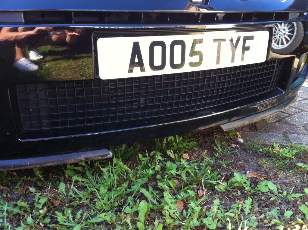

a couple of weekends ago i was fed up of the previously painted grille and the splitters flaking due to stone chips, so i took the grille out ready for painting as well as took the splitters off and badge surround.
this had to be done quickly as i hated driving around in a car that looks broken lol
and although it is hidden, it is still kind of in view so whilst the grille was out i decided that the A/C condensor (aircon radiator to those not in the know) was looking rather cack so i decided i would give this a quick lick of paint (as well as the alternator)
to this:
(also notice..being sad i also polished the A/C pipe running along the top :rasp: )

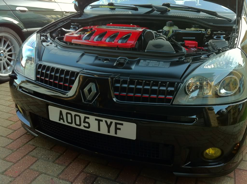

finished my grille (for now)
and finally got the grill and badges all back in and decided on something a little different whilst i await parts (paint) to do the french flag again

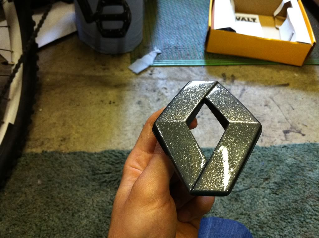

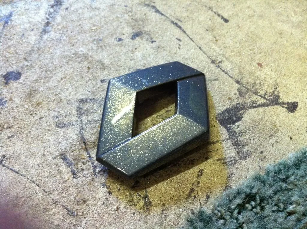

also fitted my spare badge that i sprayed ages ago (grey with a glitter laquer lol) i fit it when im in the mood and remove it again when i feel in a chrome mood lol
banderson
  05' BG 182FF
(heres one for Dr Jekyll ;) )

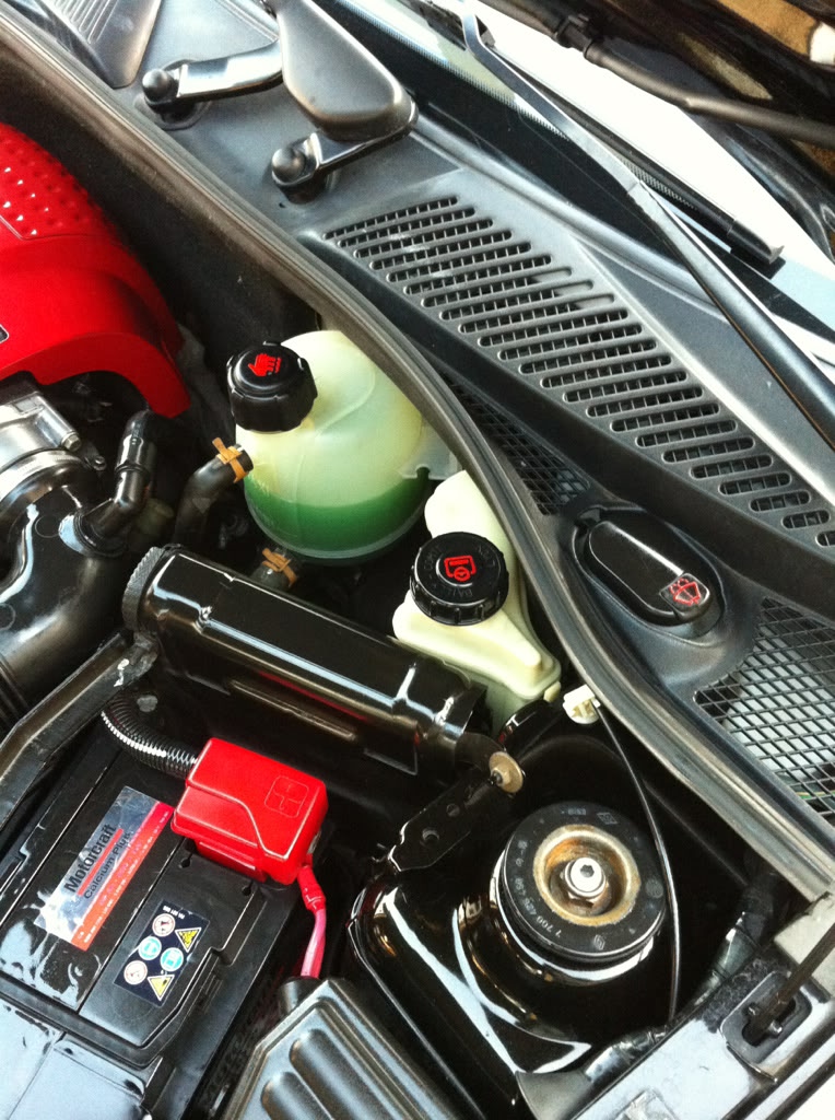

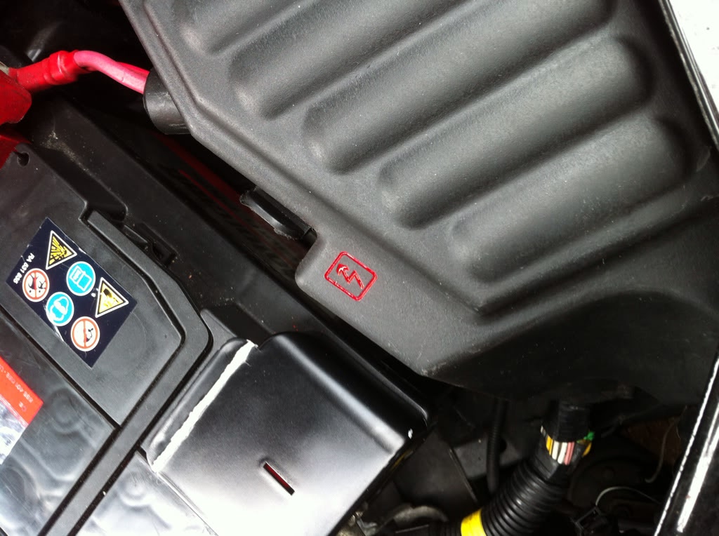

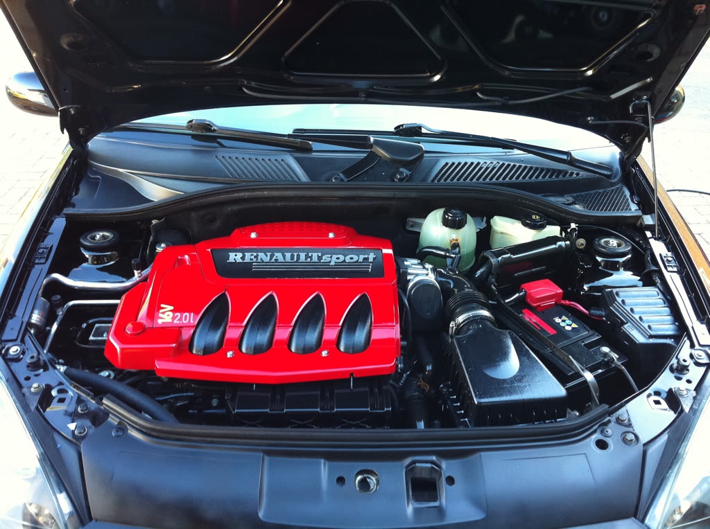

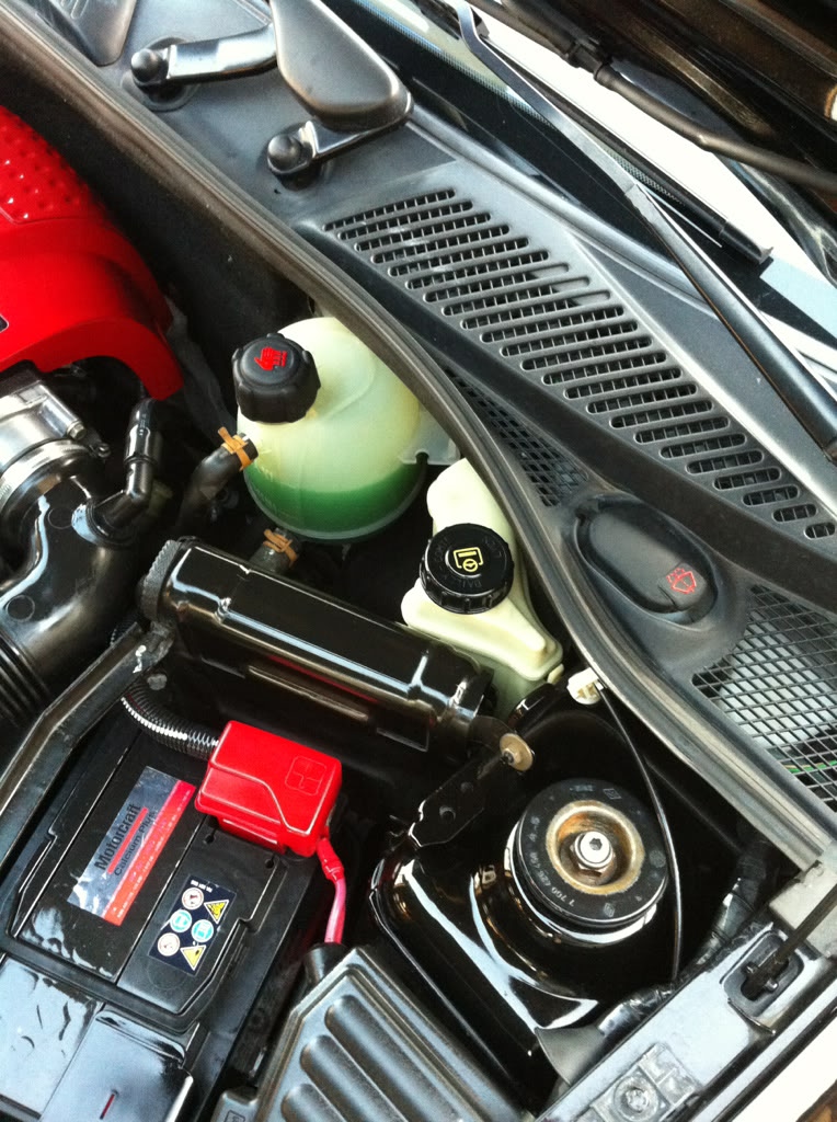

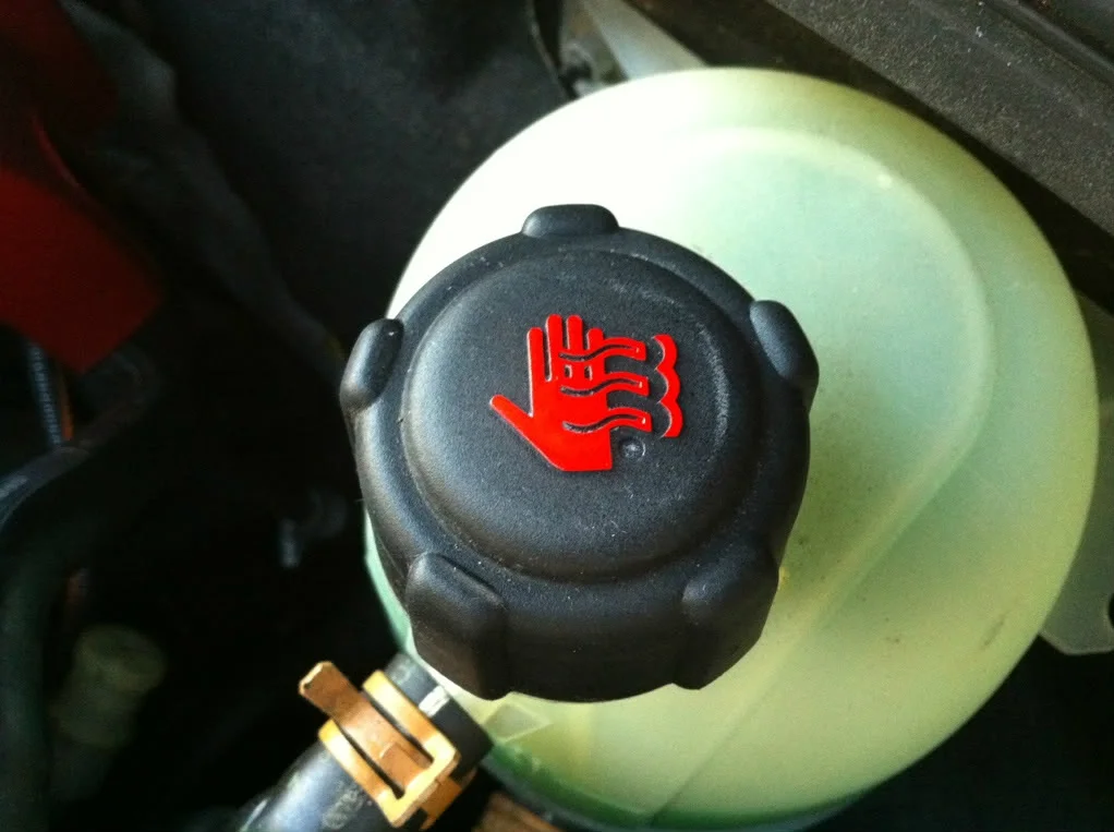

i also got bored of the engine bay and decided the yellow 'warning' symbols were not in keeping with the black and red colour theme, so out came the red tyre pen i bought and started painting lol
the most difficult was the PAS cap as there isnt a raised edge to do...so it was just a steady hand for that one but heres the out come :)
also sprayed myself a 'negative' battery terminal cover in satin black and painted the terminal itself red to show through the " - " symbol window lol (its okay i wont get it mixed up with the possitive) but i didnt quite get this in the pic lol

Fantastic little touches!
Quick question... How did you go about painting the alternator without getting paint inside?
banderson
  05' BG 182FF
i didnt :rasp: haha it wasnt a proper spray job...just literally gave it about 2 squirts just to brighten it up (not visible with grille in) should be fine!

Small updates:

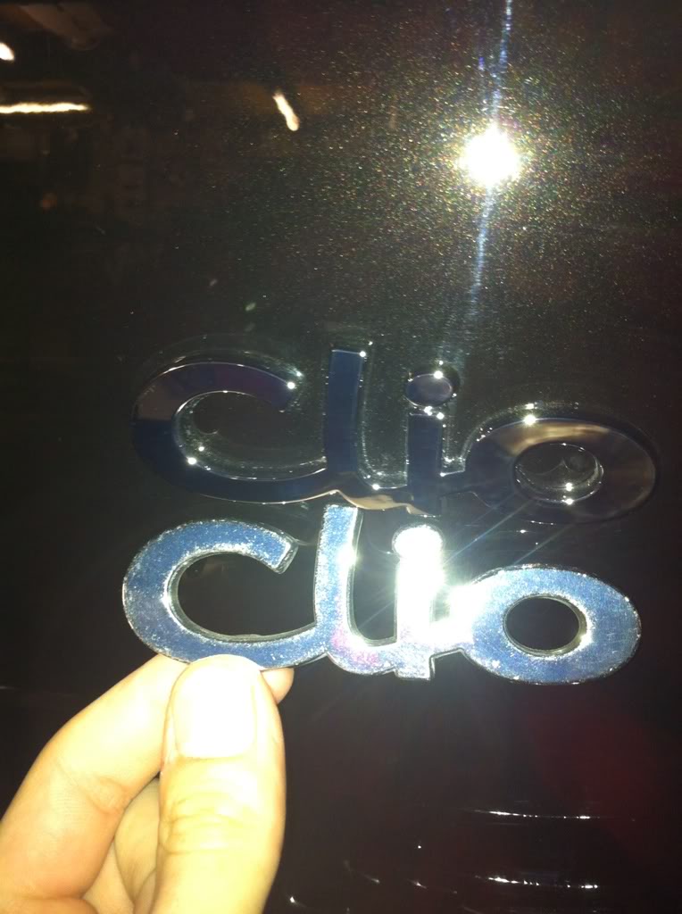

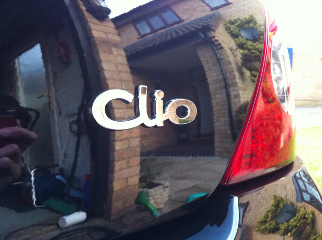

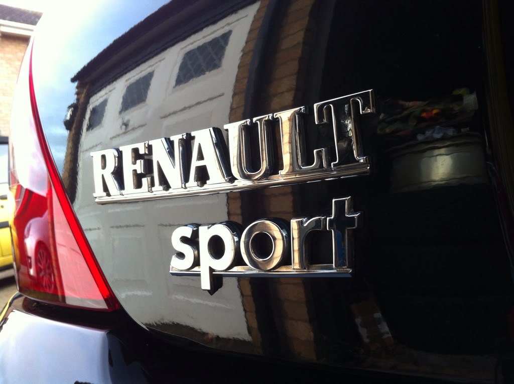

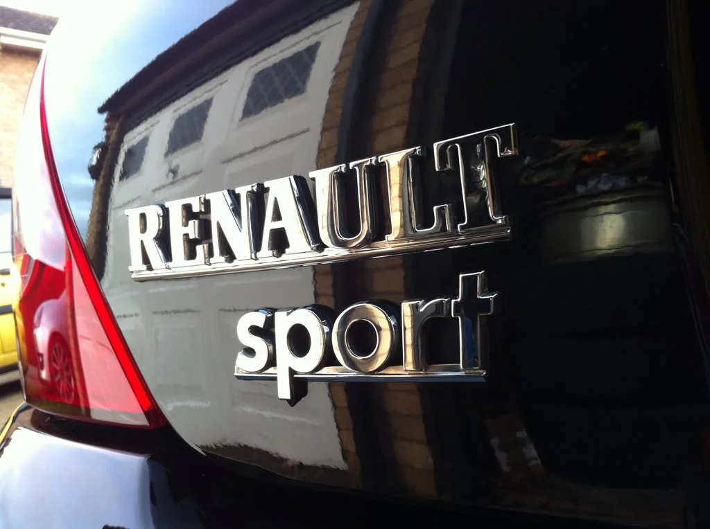

Few months ago i Decided I'd get a new 'clio' badge to replace the tarnished one...not a big change but makes all the difference to a clean shiny car ;)
And a few reflections ;)

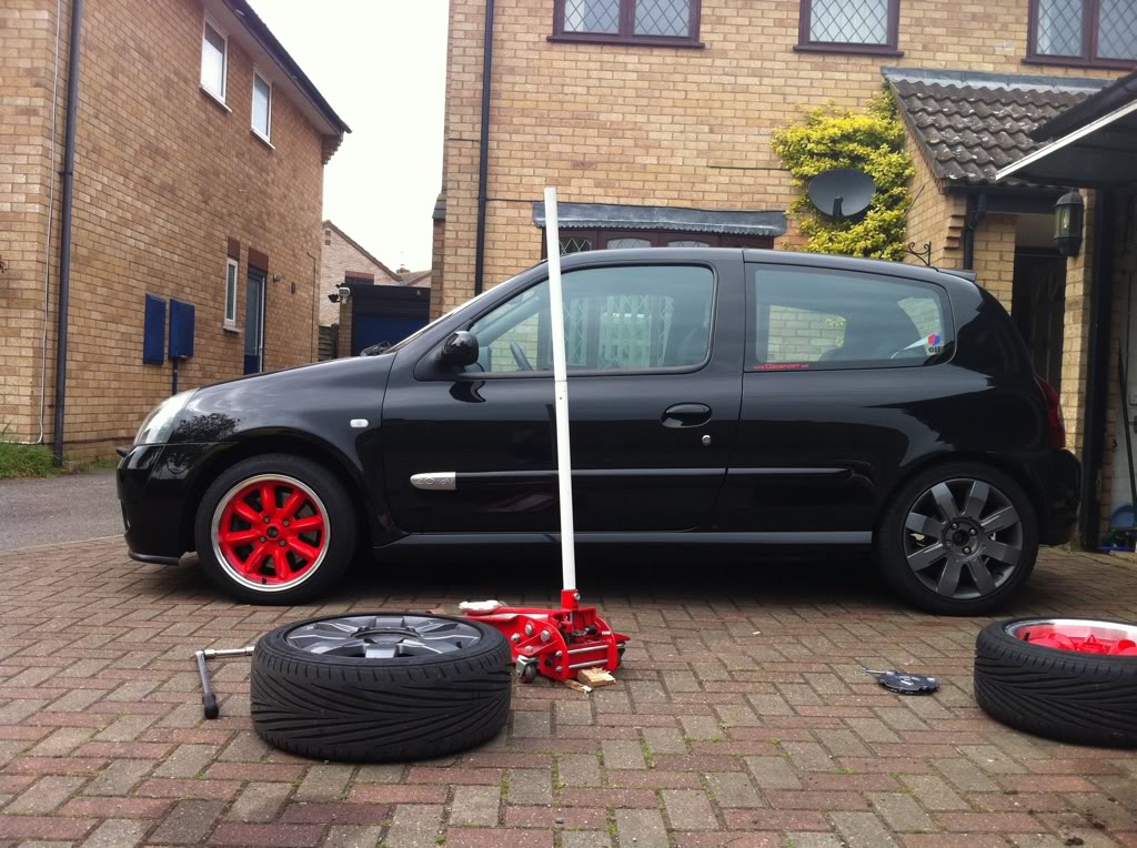

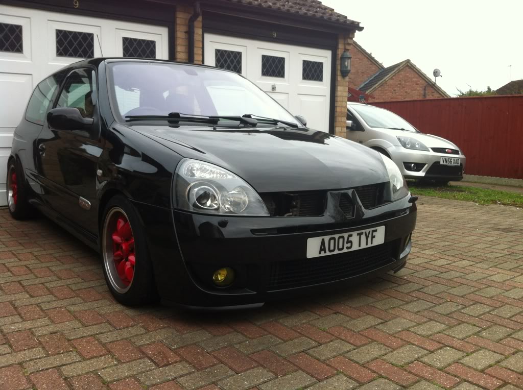

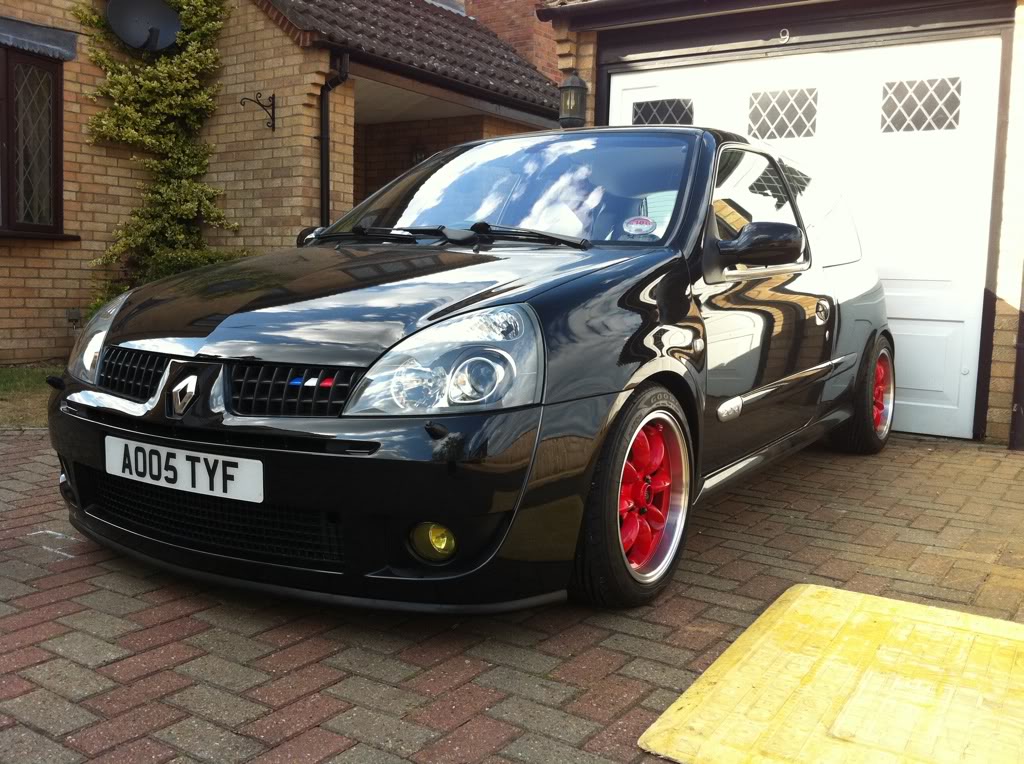

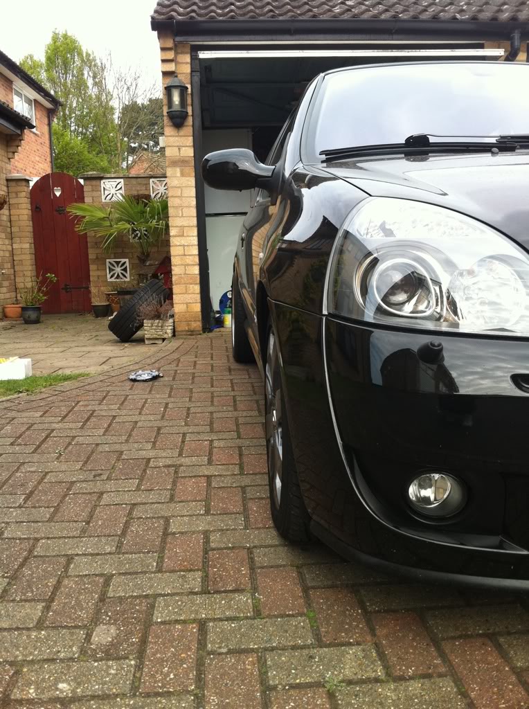

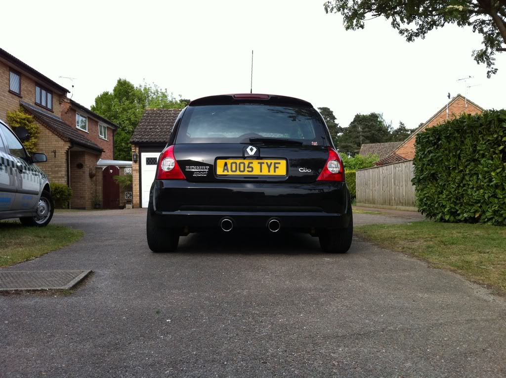

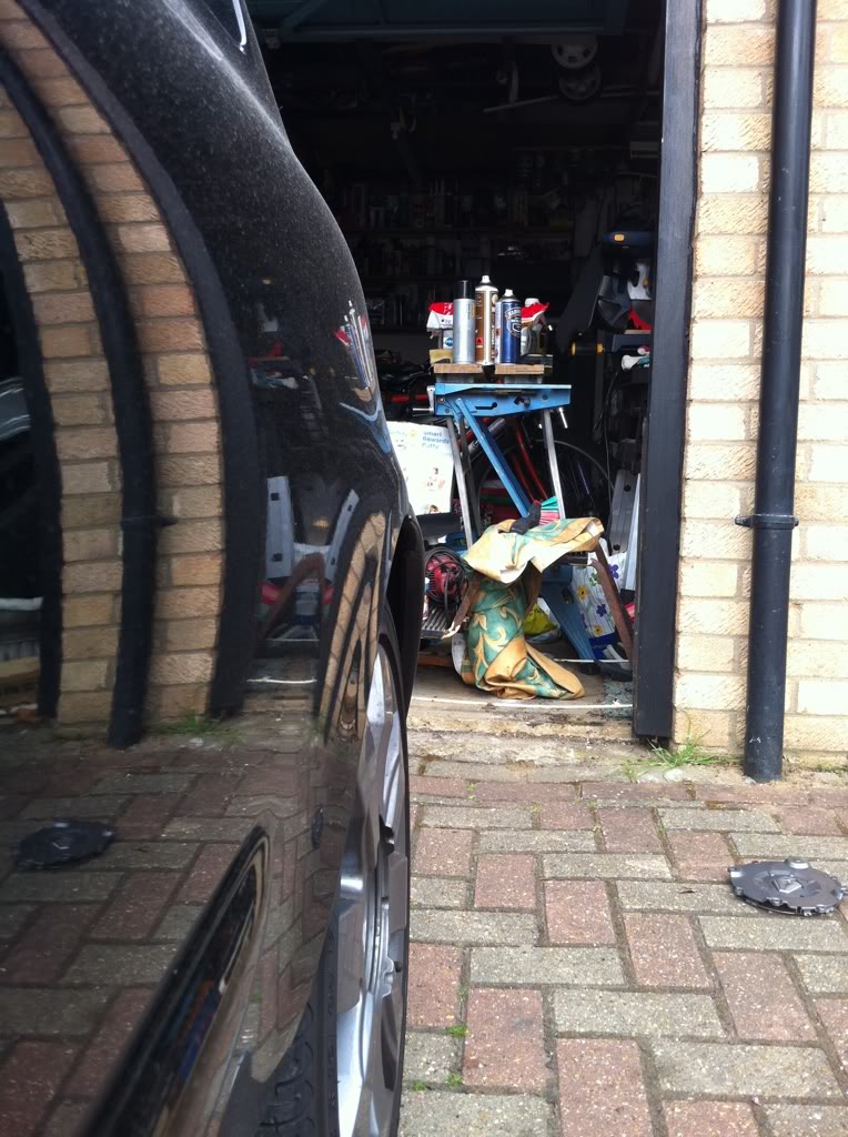

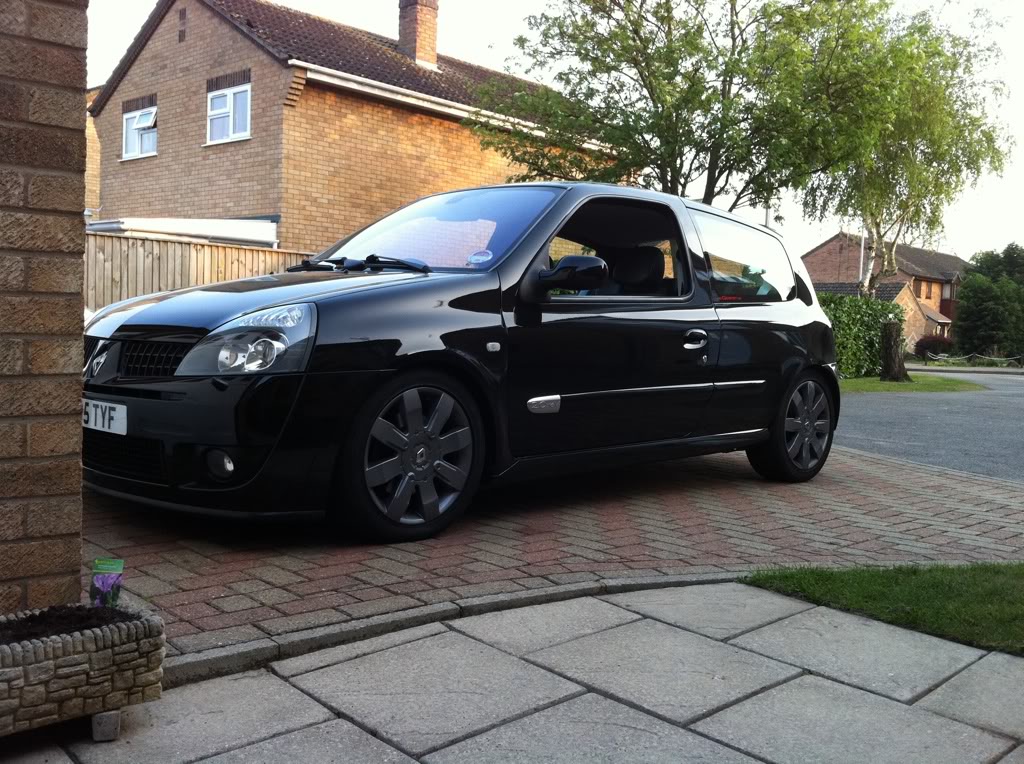

decided to lower the front a little more to 'level' up the arch gaps between front and rear,
luckily the coilovers were still in good shape and just undone (but I still decided to give them a little maintenance whilst under there ;) )
Although I have this much to play with on the front:
I decided I'd go for a suitable 7mm drop :p but I'm unsure wether I have to much 'rake'! It'll do for now though haha

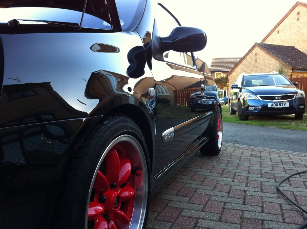

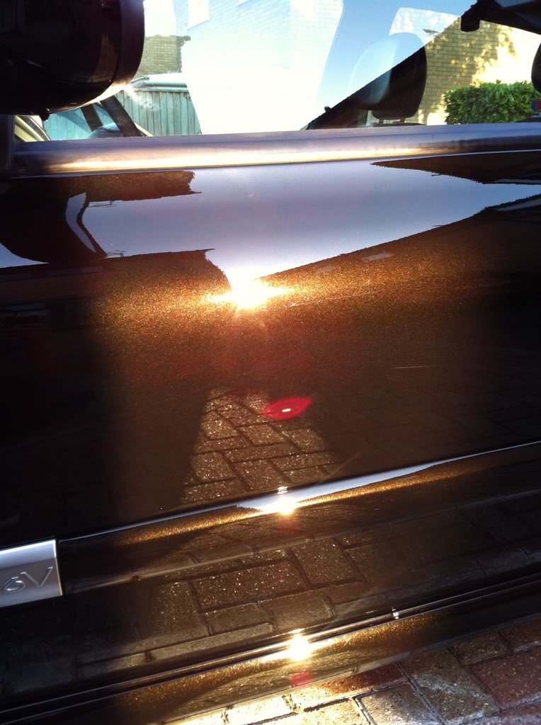

Next was just the usual, enjoy, clean, enjoy clean and so on...but I'd just like to demonstrate the importance of tyre shine when keeping an immaculate car!
Its amazing how it actually makes the paintwork look so much deeper even though it's not part of the paintwork :p

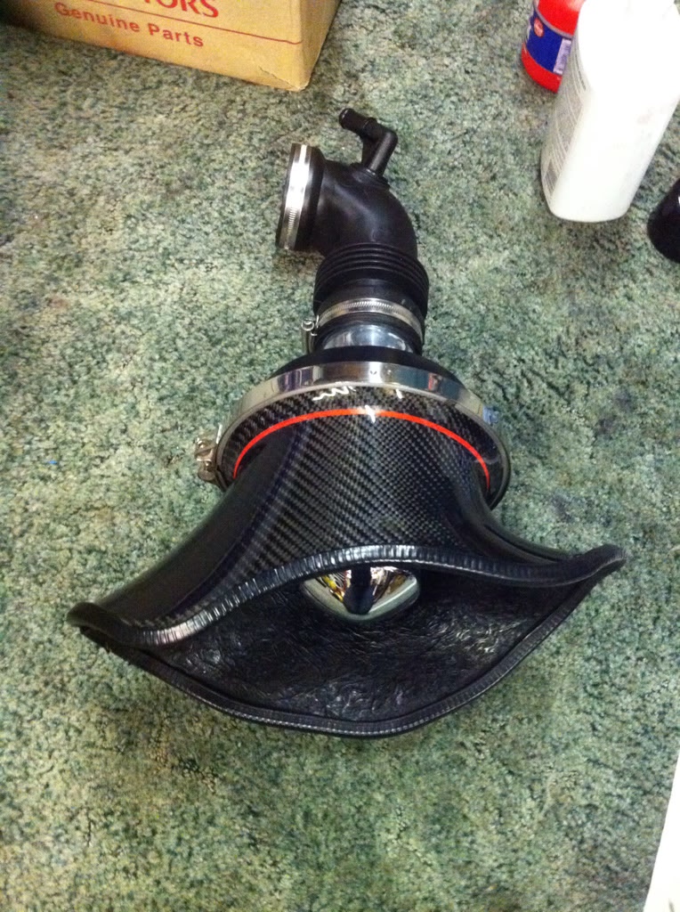

I then started to get a little bored of the Clio (not in general, just the fact I wasn't changing much) Always love it when it's clean but hate it when it's dirty! Lol

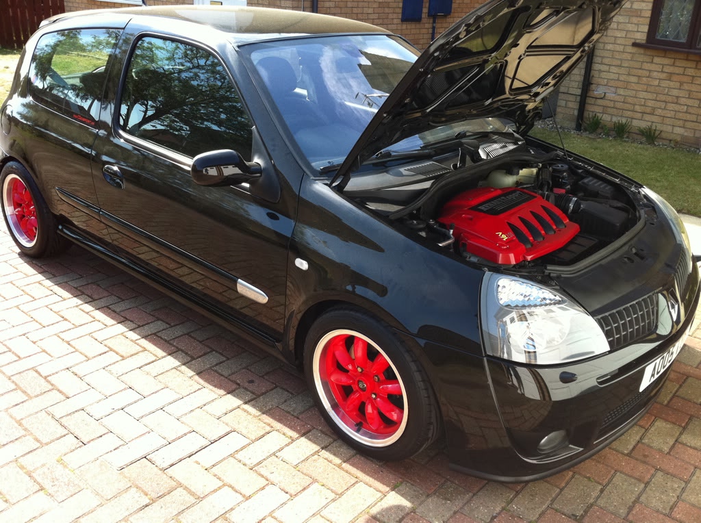

so even though there are conflicting opinions about them, I decided I would get an induction kit! I Was looking around for a few weeks, had my heart set on a BMC filter but when watching them on eBay, the prices always shot up to more than I was willing to pay at the last minute!! :(
then a simota aeroform came up... Heard these sound fapping awesome so I immediately started to watch it and with 5 odd days left still sat at starting price...then looked at lunch that day and it had sold :( owner had received an email from someone and decided to put a 'buy it now' on it :mad: lol anyways fired off an email to ask about it but not a lot I could do...
then I got an email back the next day saying the customer had messed him about and it's back up for sale with the same 'buy it now' price :D !! In the end paid £70 for it which I though was reasonable!
Got it fitted the night it arrived (no pics unfortunately) and all I can say is WOW, WHAT A NOISE!! :evil: haha!!

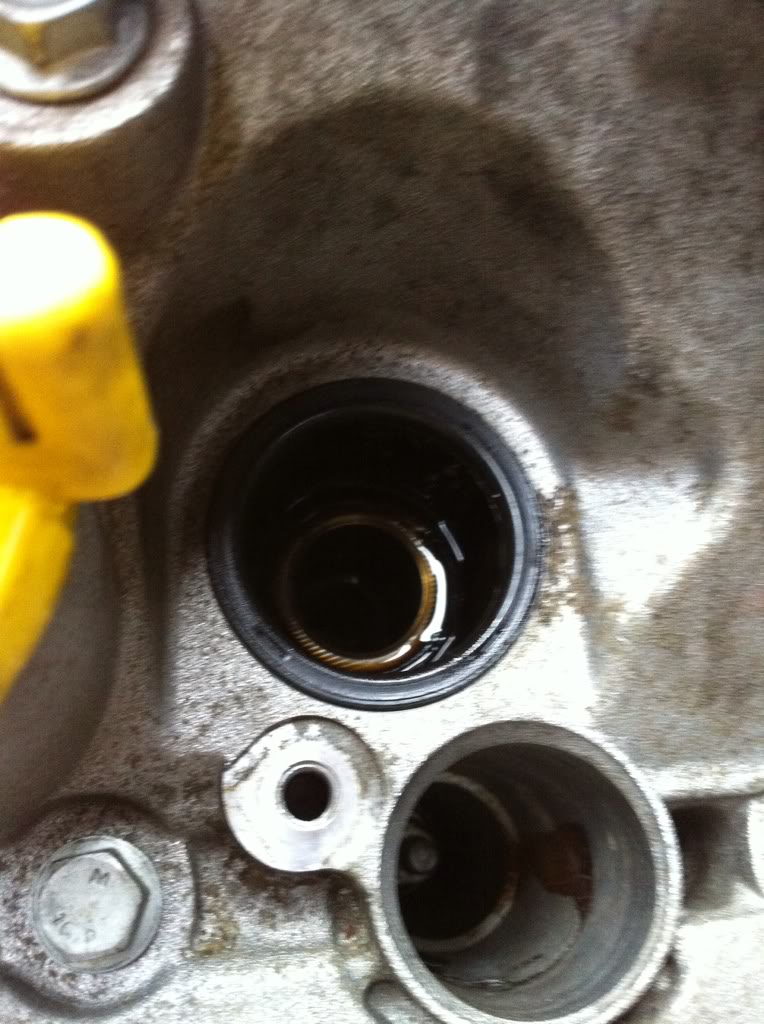

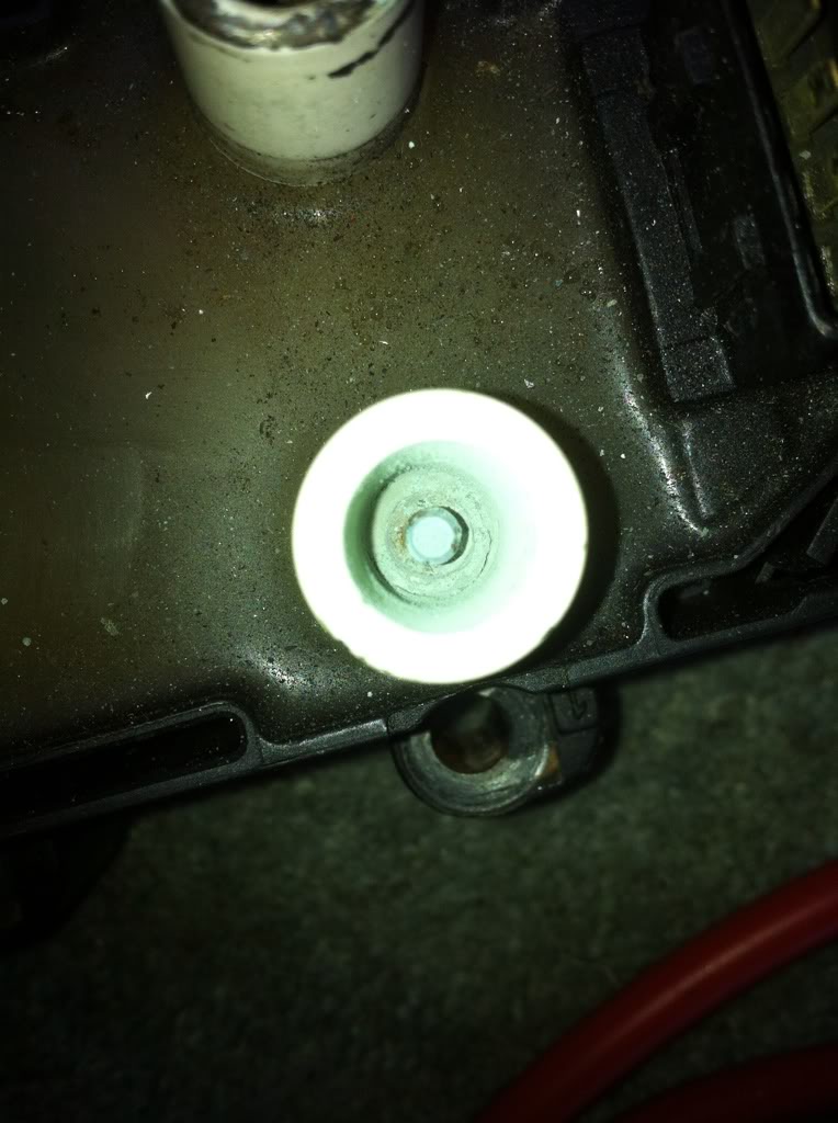

So whilst i wait for all my parts i started to strip the inlet top off to get at them, only to find an oil weep around the top of plug hole number 4 next to my Vvt solenoid! :( sh*t!!! under further inspection I found that someone had used silicone sealer around the Vvt solenoid top and shoulder previously to stop the leak. But obviously this didn't fix it! :mad:
So cleaned it all down, posted up on here and see what sealing it should have, turns out it only needed the one oil seal!
So phoned Renault and got this seal in question for around £7 :D but it was going to take a few extra days :( Booo!!!!
So then I decided to start cleaning up the engine bay...started with the maybe ore plug leads as they were looking really grotty! Lol only to then find that the coilpack needed replacing due to one of the plug lead terminals corroding...so to not cause further damage I ordered a new (second hand 30k) one! Lol
I was happy nothing else needed doing so set about the bay once again! Cleaned and sprayed up the cam cover in silver to make it look fresh again :)
Next was the inlet itself...sprayed this ages ago in satin black but fancied some more shiny shiny :D so sanded that and the fuel rail guard down and bought some gloss black paint!
First attemp, must have been silicone in the air as it reacted with the paint! So sanded down and tried again, to my annoyance...same again! So third very infuriating attempt later, It can out spot on :)
Ive still got to sand back the 'Renaultsport' on the top half but I'm happy with the outcome :) can't wait to get it all back together!!

Finally Picked up my oil seal and bonnet cable today and got the seal fitted :) old one was worn badly and slimmer, so this should fix the leak!

I was now happy with everything so far so put my inlet and fuel rail guard etc back in for a 'mock up' :)
Despite me still needing to sand down the 'Renaultsport' I was over the moon with the results :D

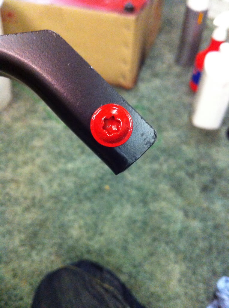

Last bit for this post :) I decided to add to my red engine details and paint the fuse box cover 'lightning' logo :D (still need to shine the plastic up though)

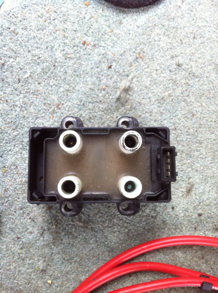

Some more updates :)
This is why I was replacing the coil pack :)

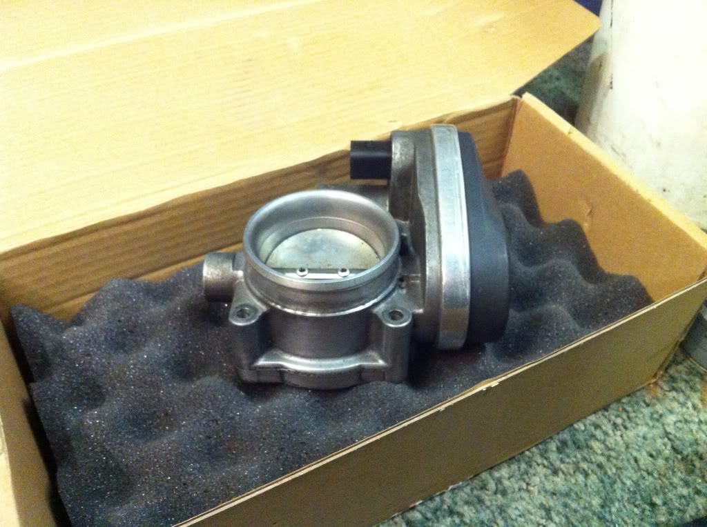

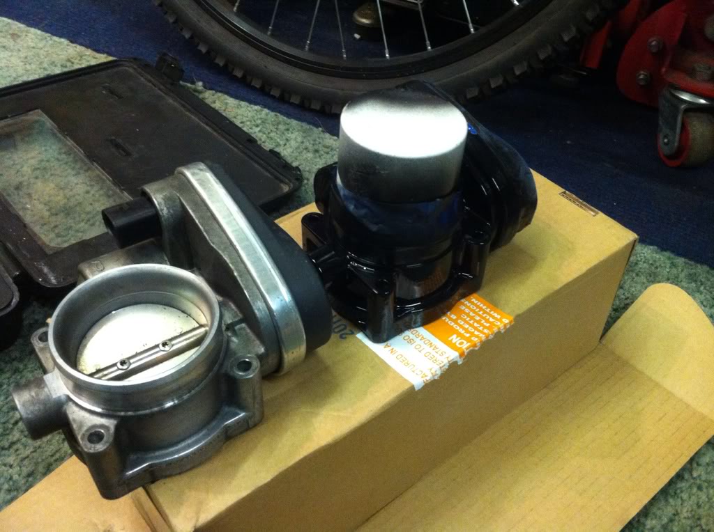

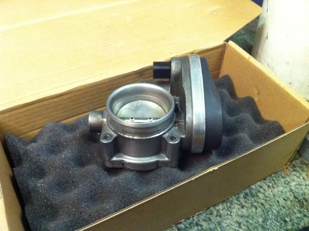

Throttle body finally turned up,

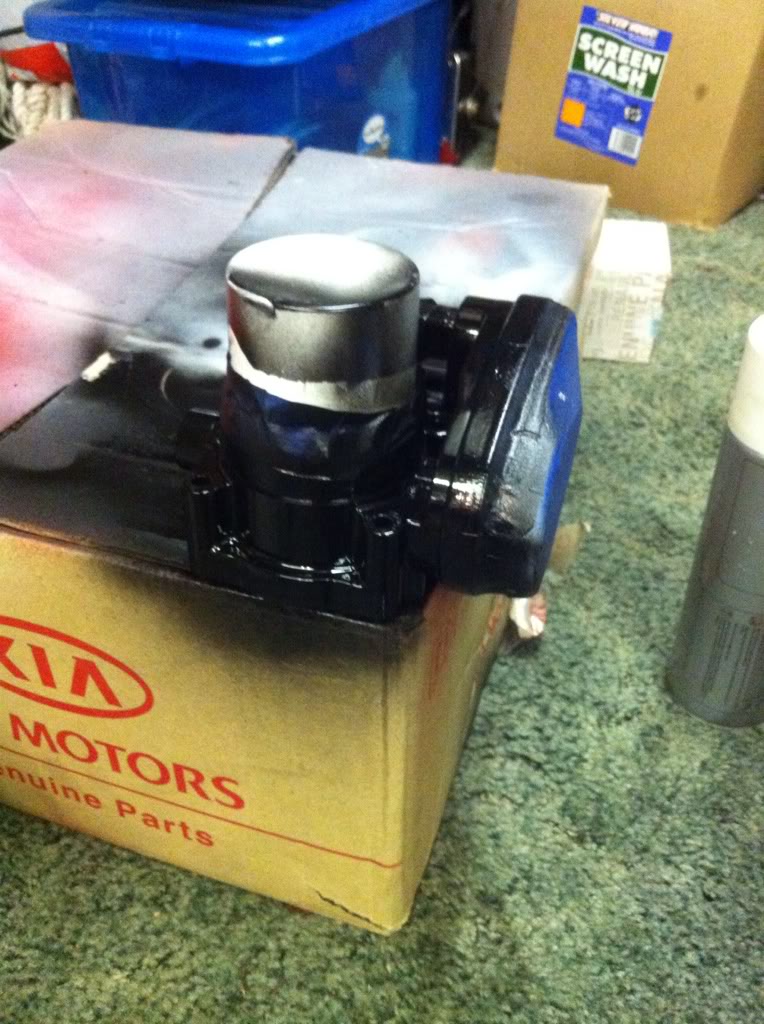

So after a quick trial fit to make sure all was okay, I set about painting it up :)
All done :)
Getting there :)
