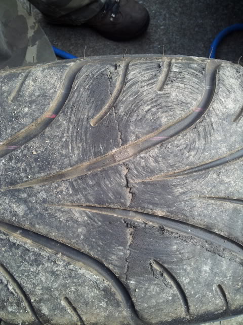

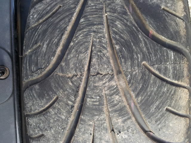

Just inspected mine today. 80 motorway miles and 20 odd laps round Oulton park not exactly giving it death either.....
  Cup In bits
Eeeek are they getting close to markers in the middle? I am due to get mine fitted tomorrow.
Nothing to worry about from all reports, can't help but think some testers would knock this line in some cases.
Ade T
  Clio 182 FF
No its just the pictures the tyres are like new! I fitted brand new tyres then drove to oulton park did around 20 laps then drove home.
