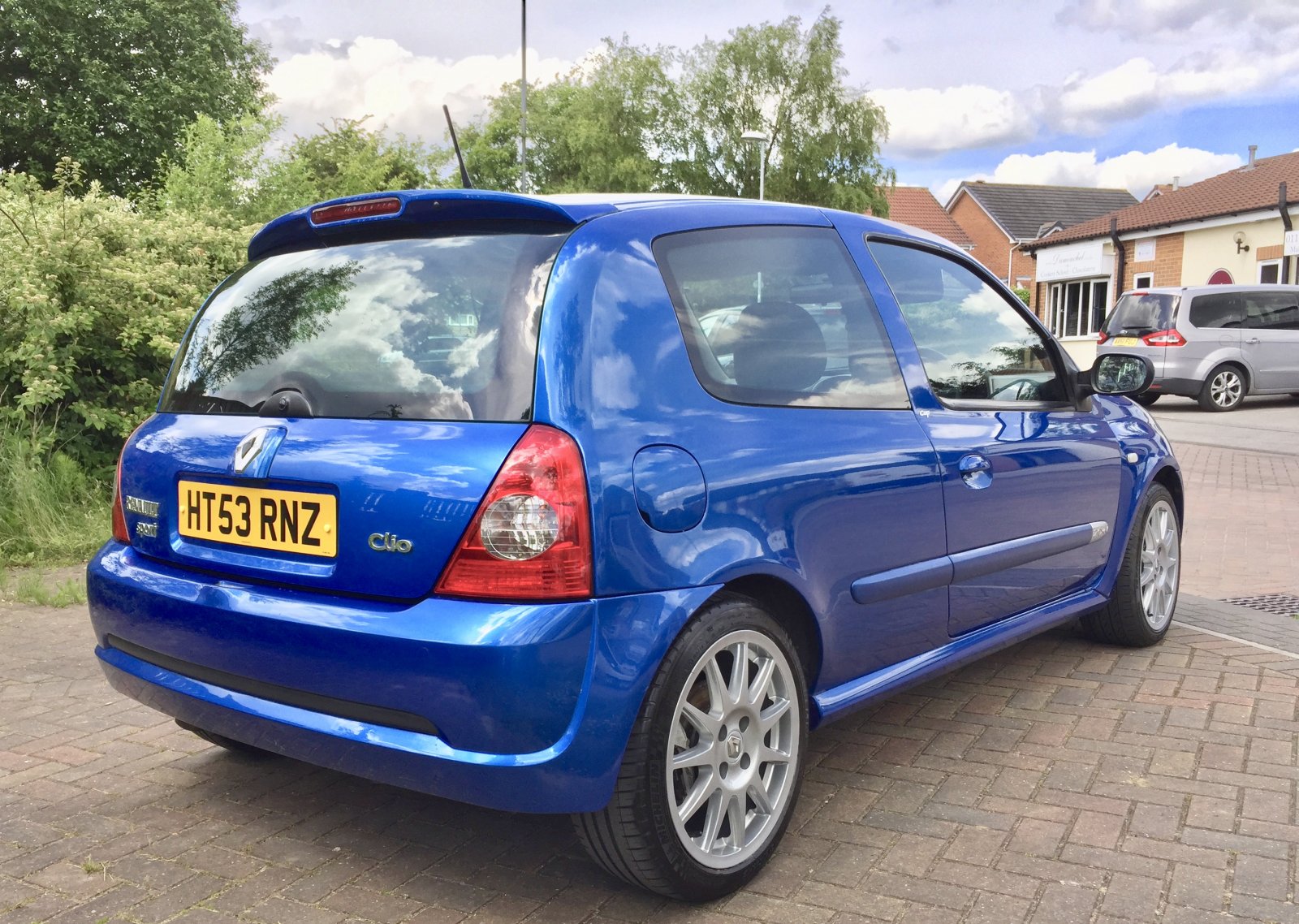

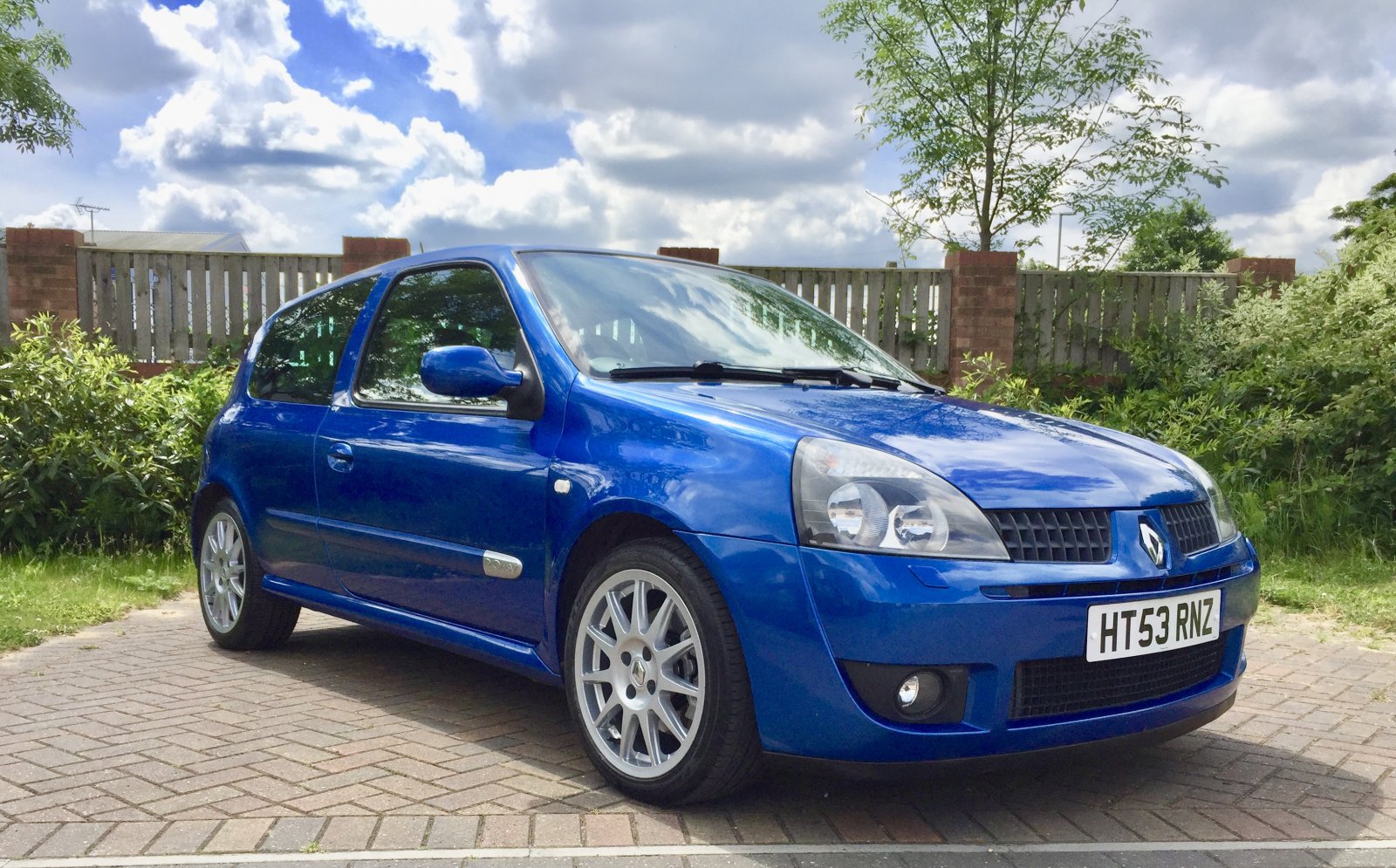

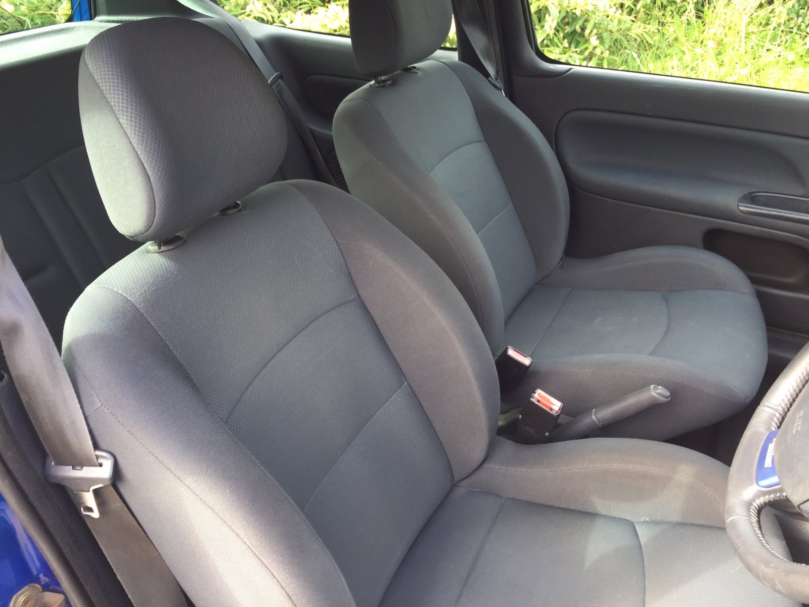

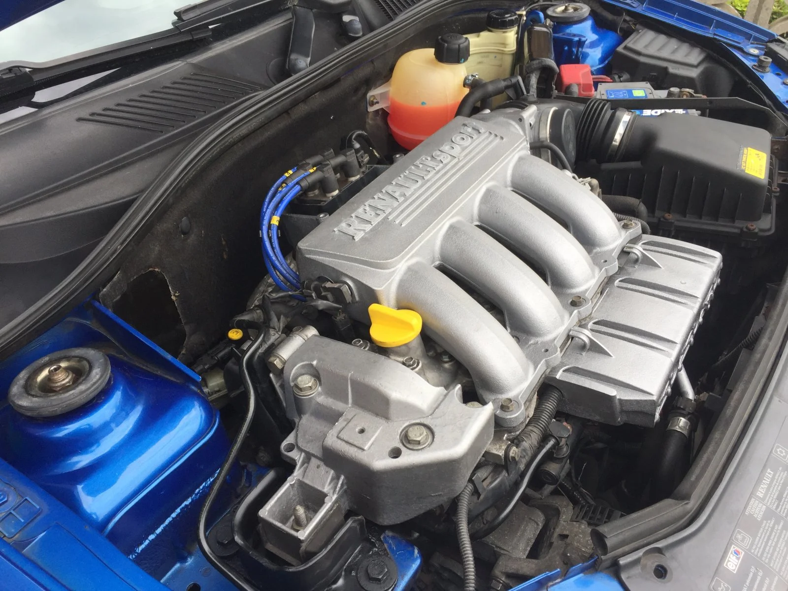

Here she is after the initial deep clean

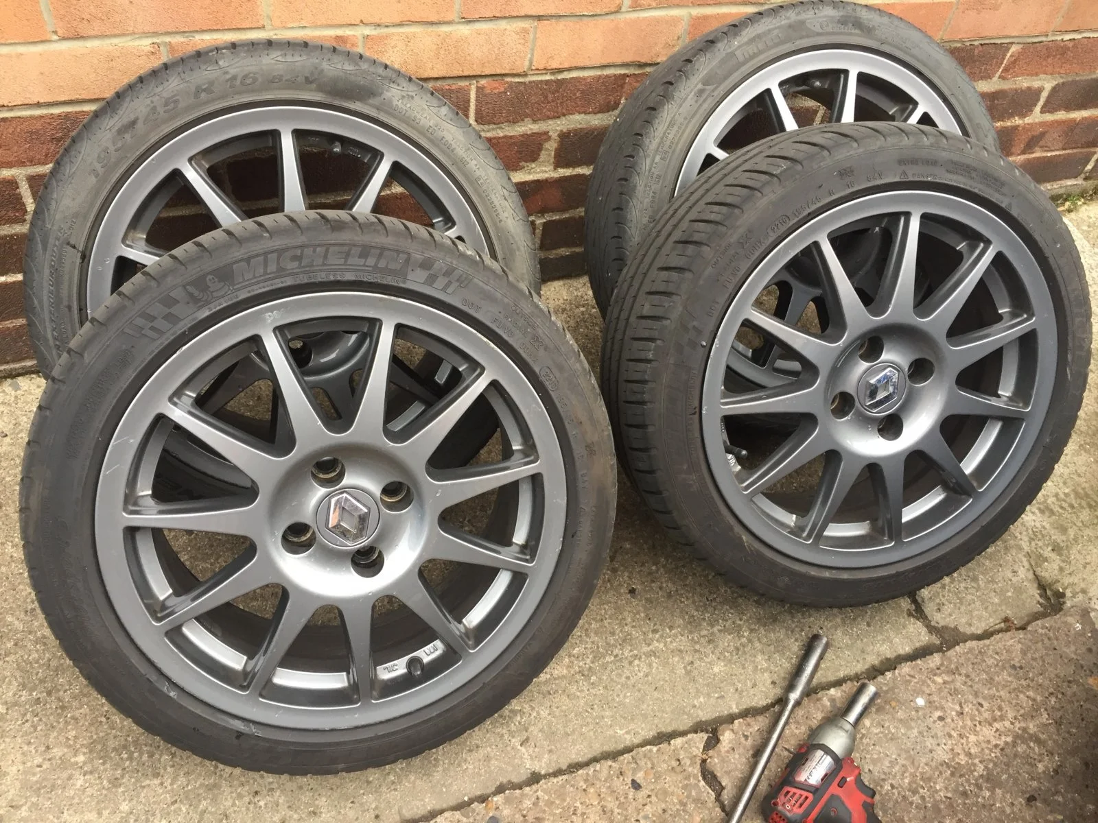

- A better, used sport wheel as the old one was melting very badly and let the interior down

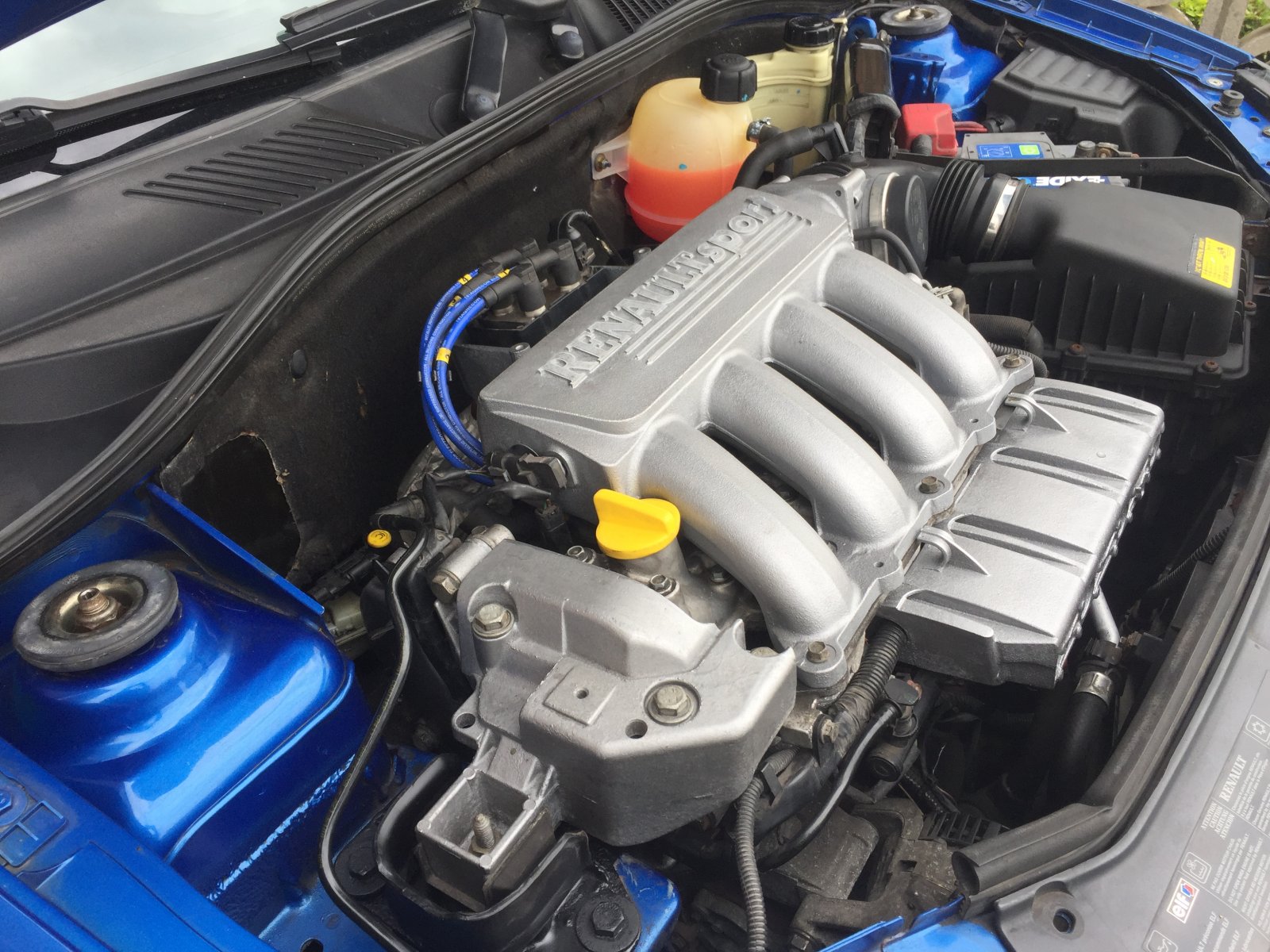

- Cleaned the engine bay

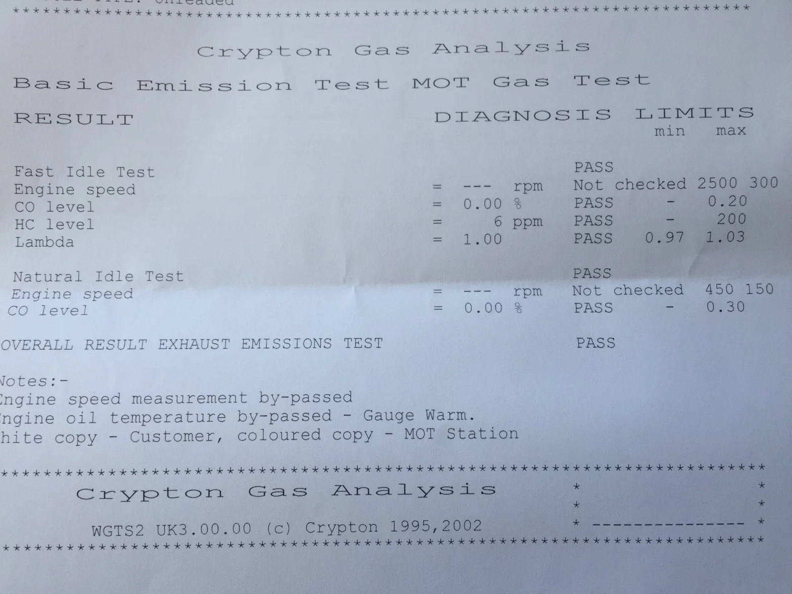

- Mot'ed (unbelievably clean running engine on the emissions at 1.00 lambda, 0% CO2, 6ppm HC)

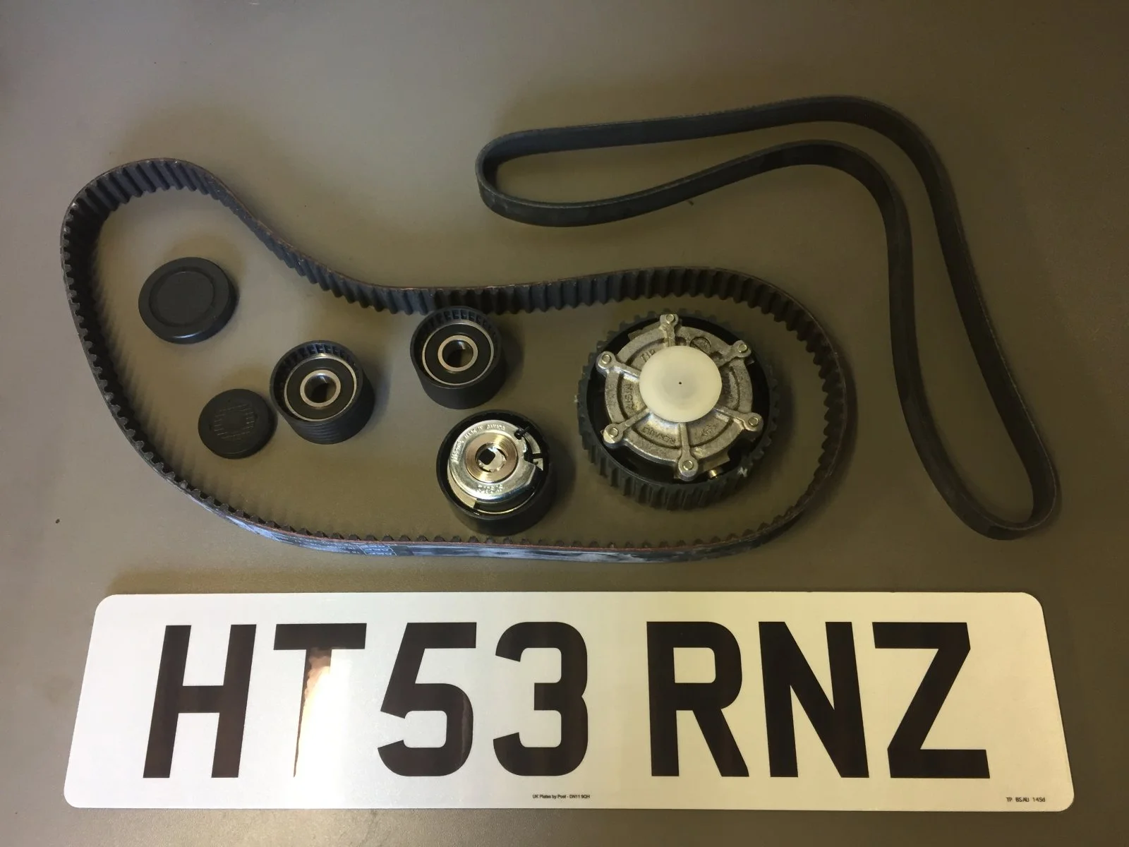

-new Timing & Auxiliary belt & dephaser pulley
-New number plates

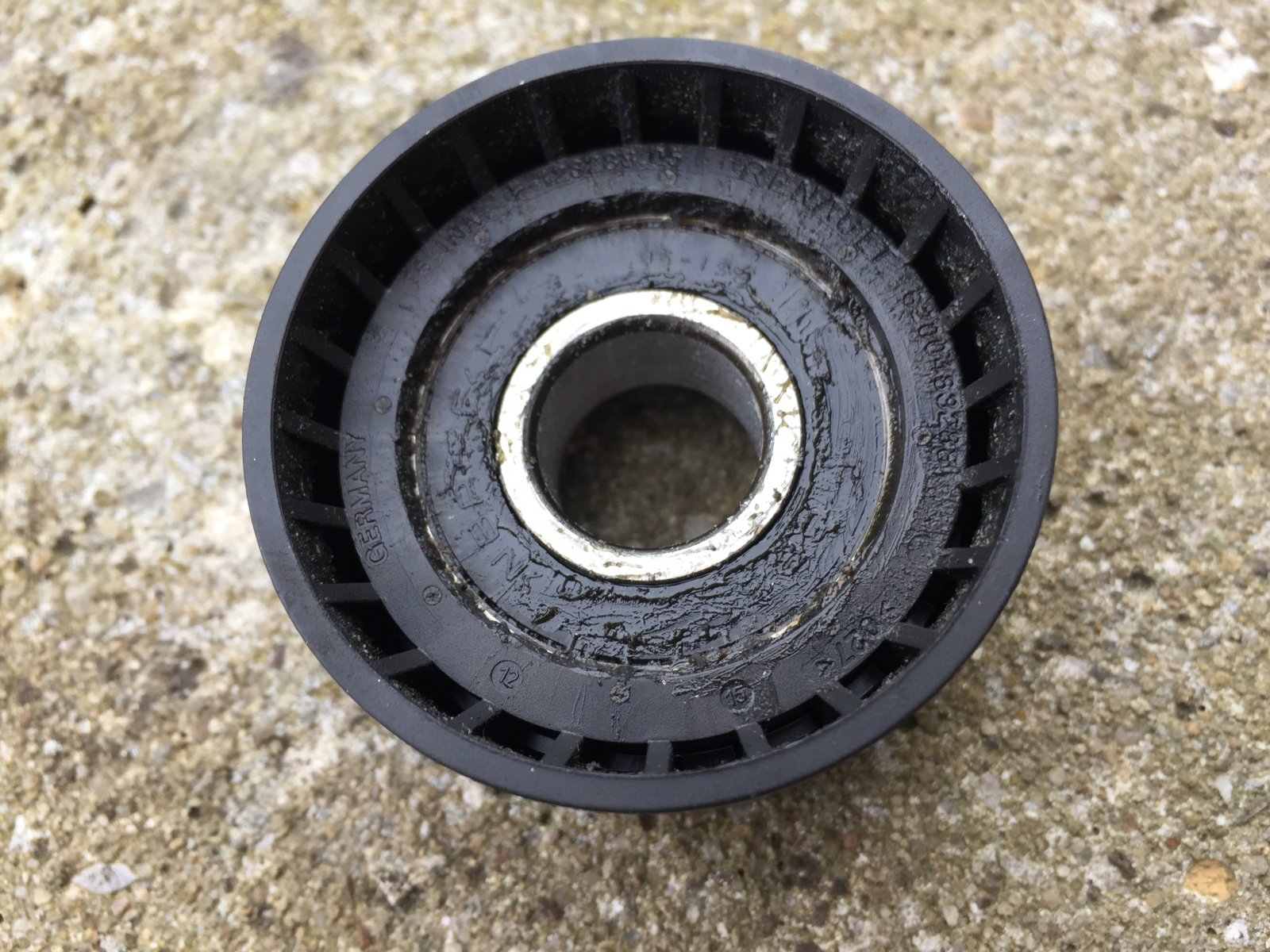

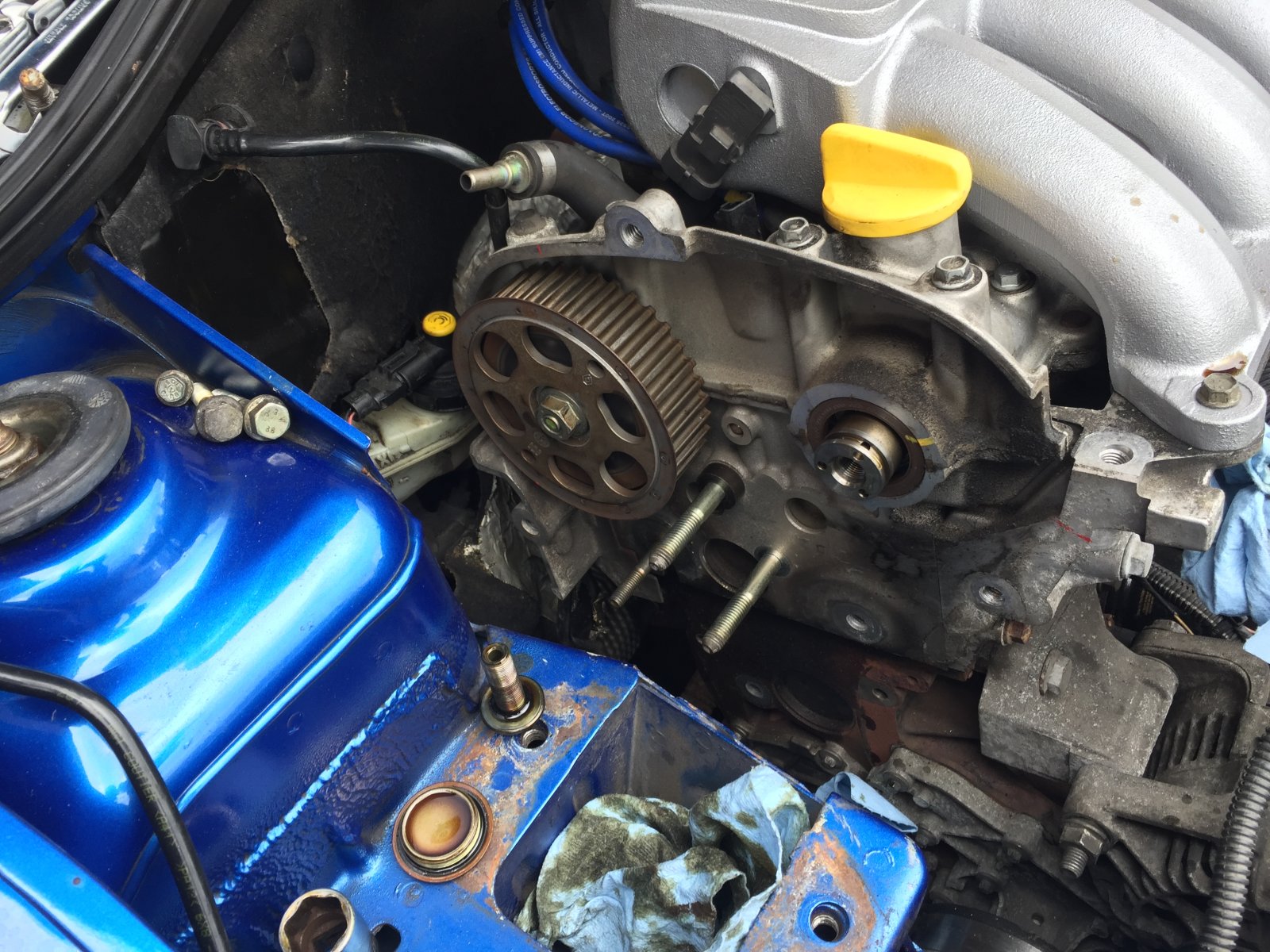

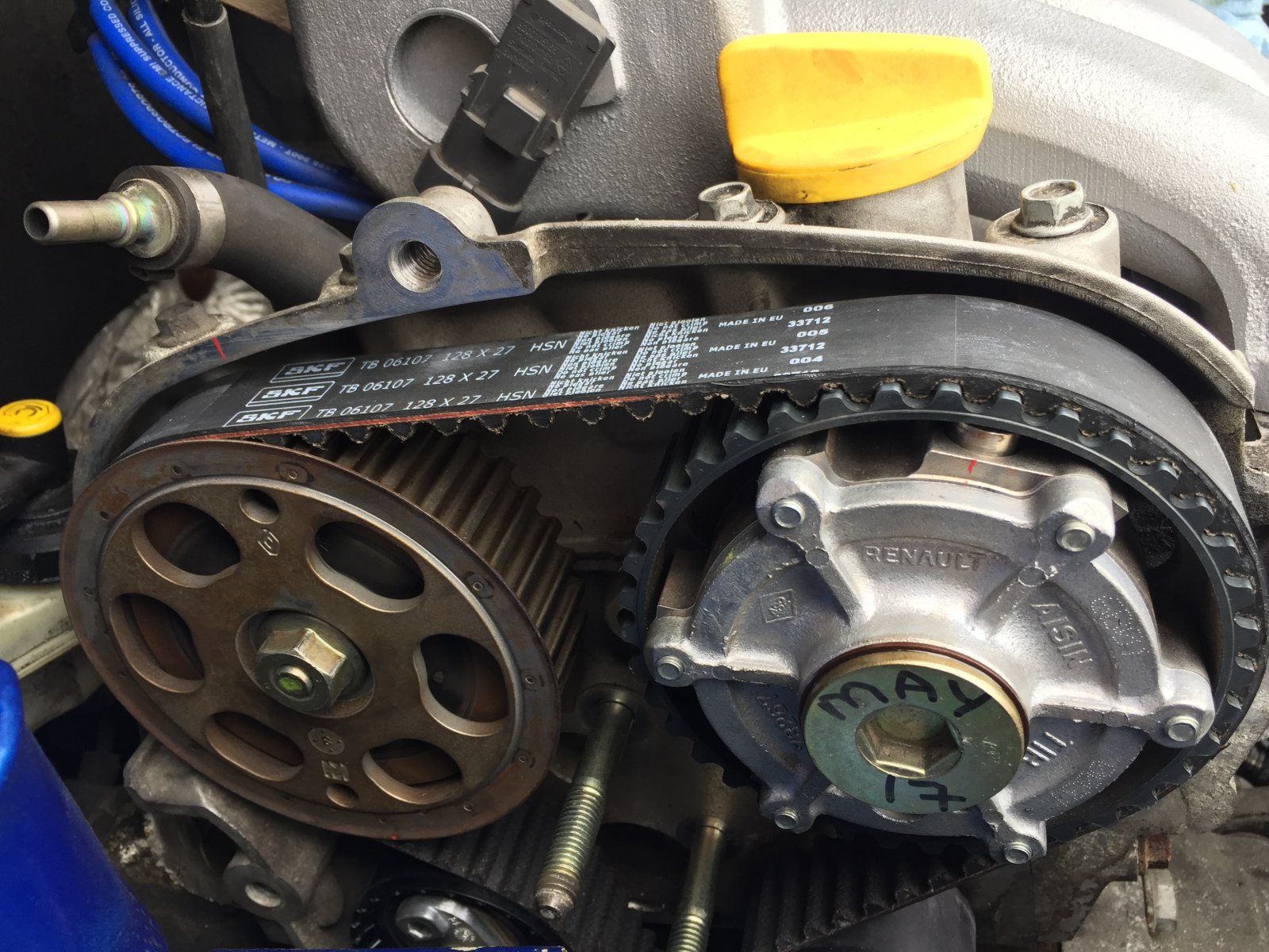

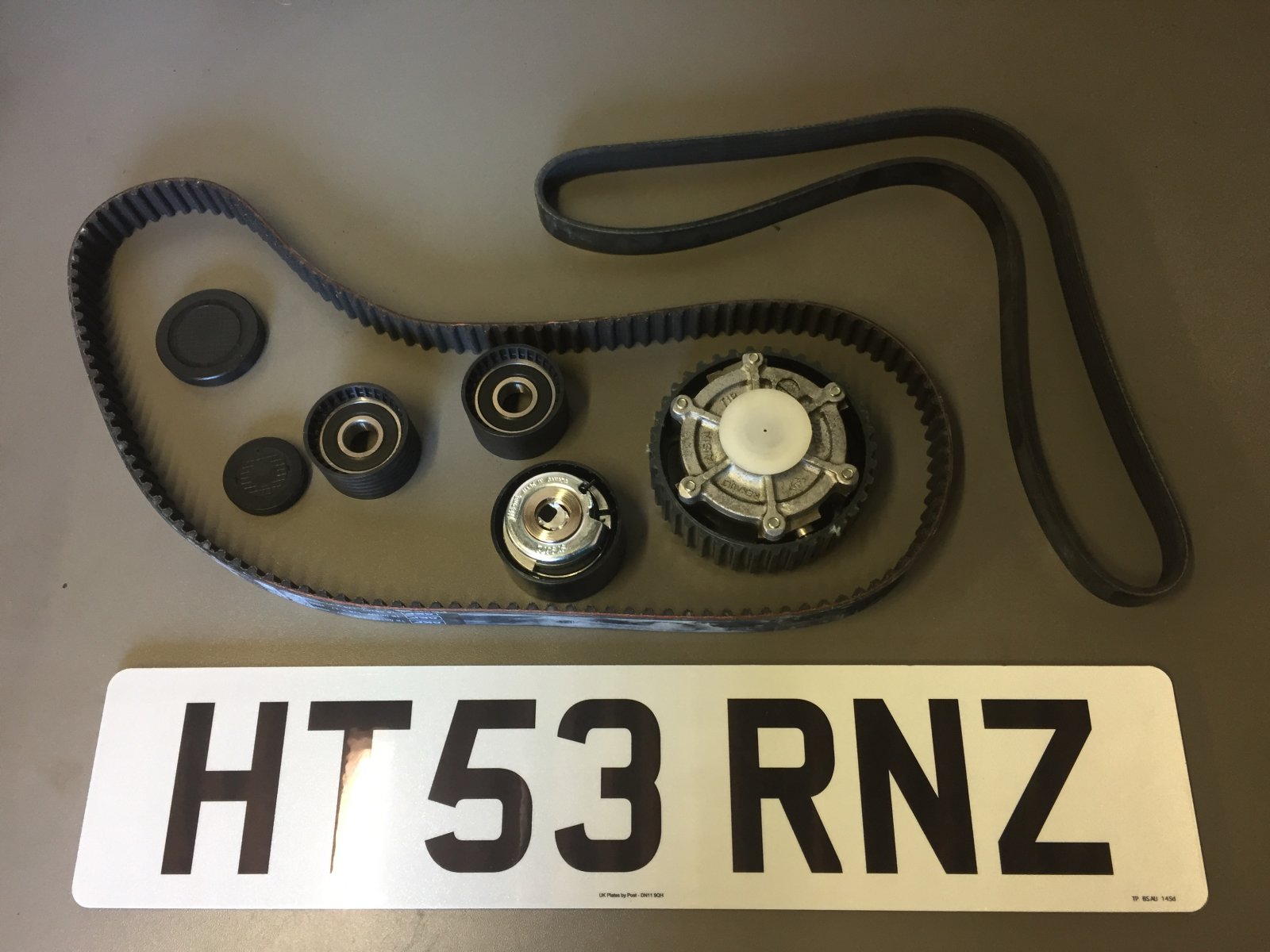

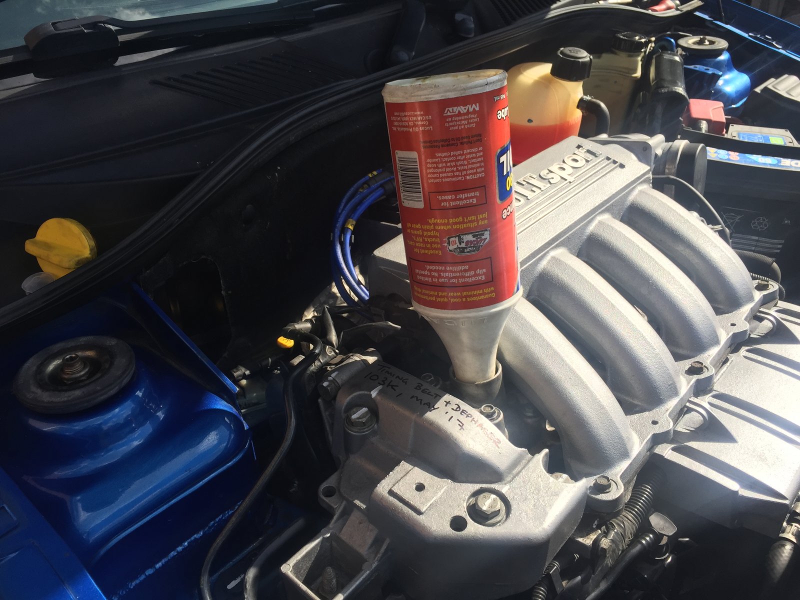

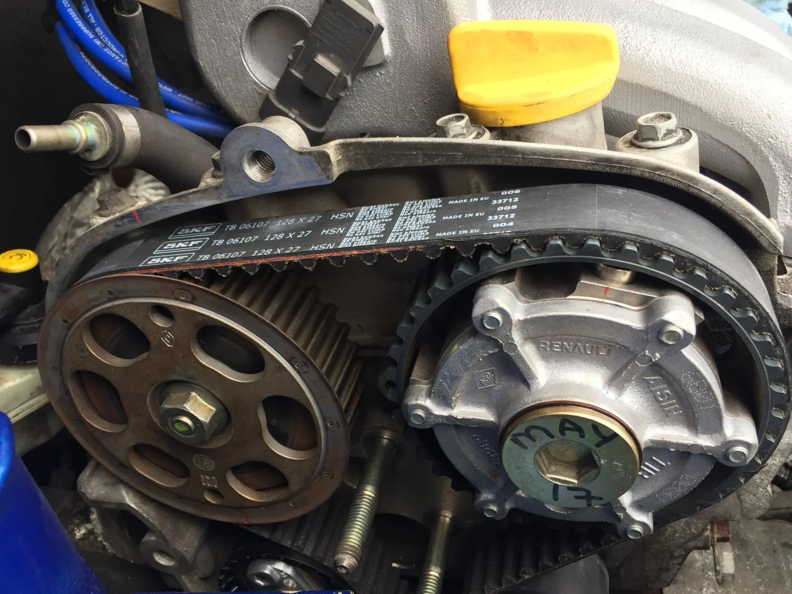

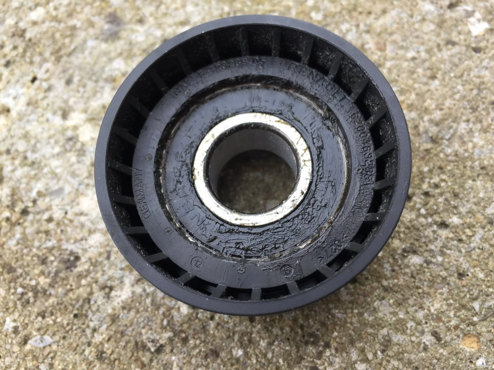

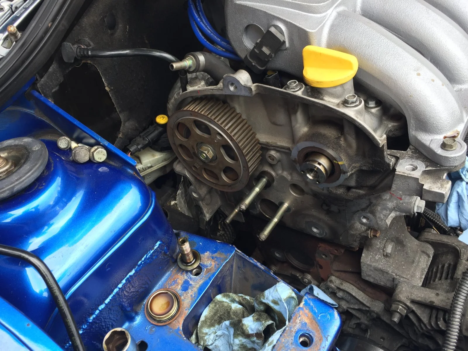

I changed the Timing Belt (SKF Kit) and Dephaser this morning, It's a good job I did as despite the belt only being replaced 18 months ago with a genuine Renault kit one of the idlers had started to fail.
The dephaser pulley bolt was ridiculously tight but other than that it was a quickish and straight forward job,
the Car has 103k miles on the clocks so now isn't due until 175k or May 2022, but ideally 163k, May 2021 (seems a very long way into the future when you write it!)

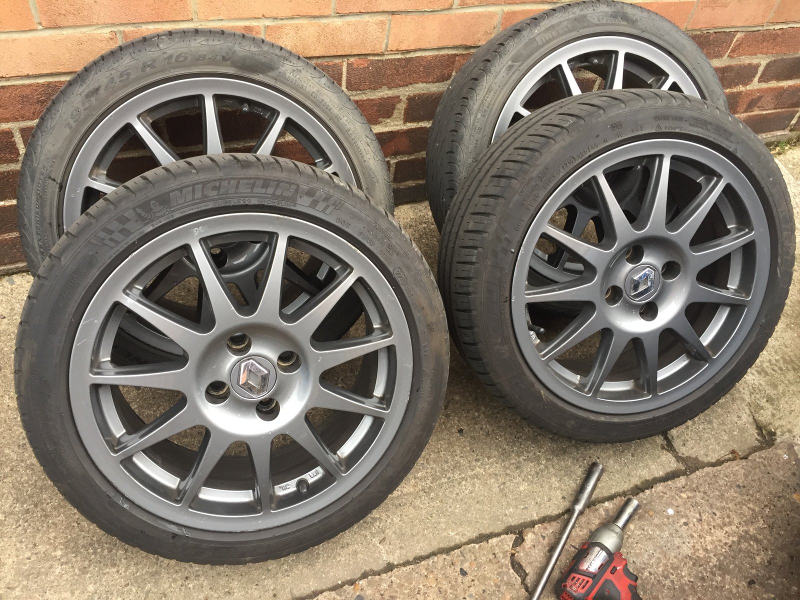

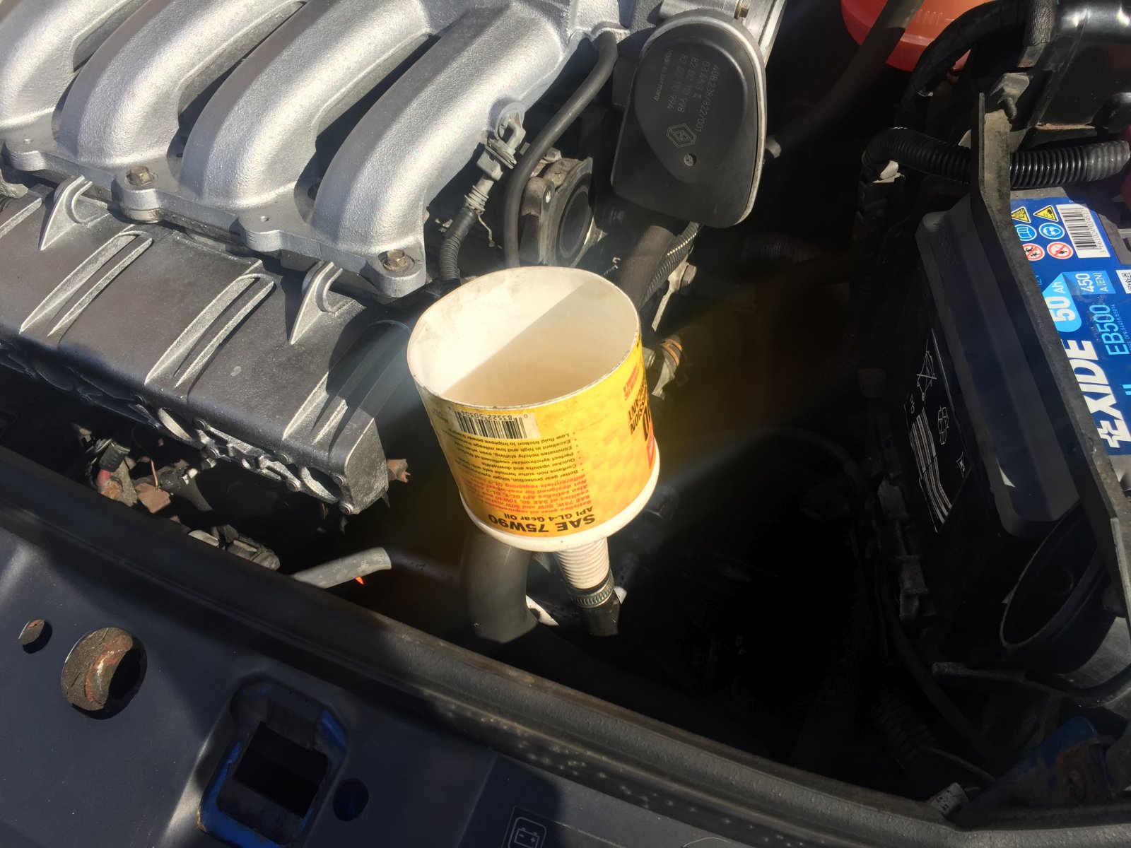

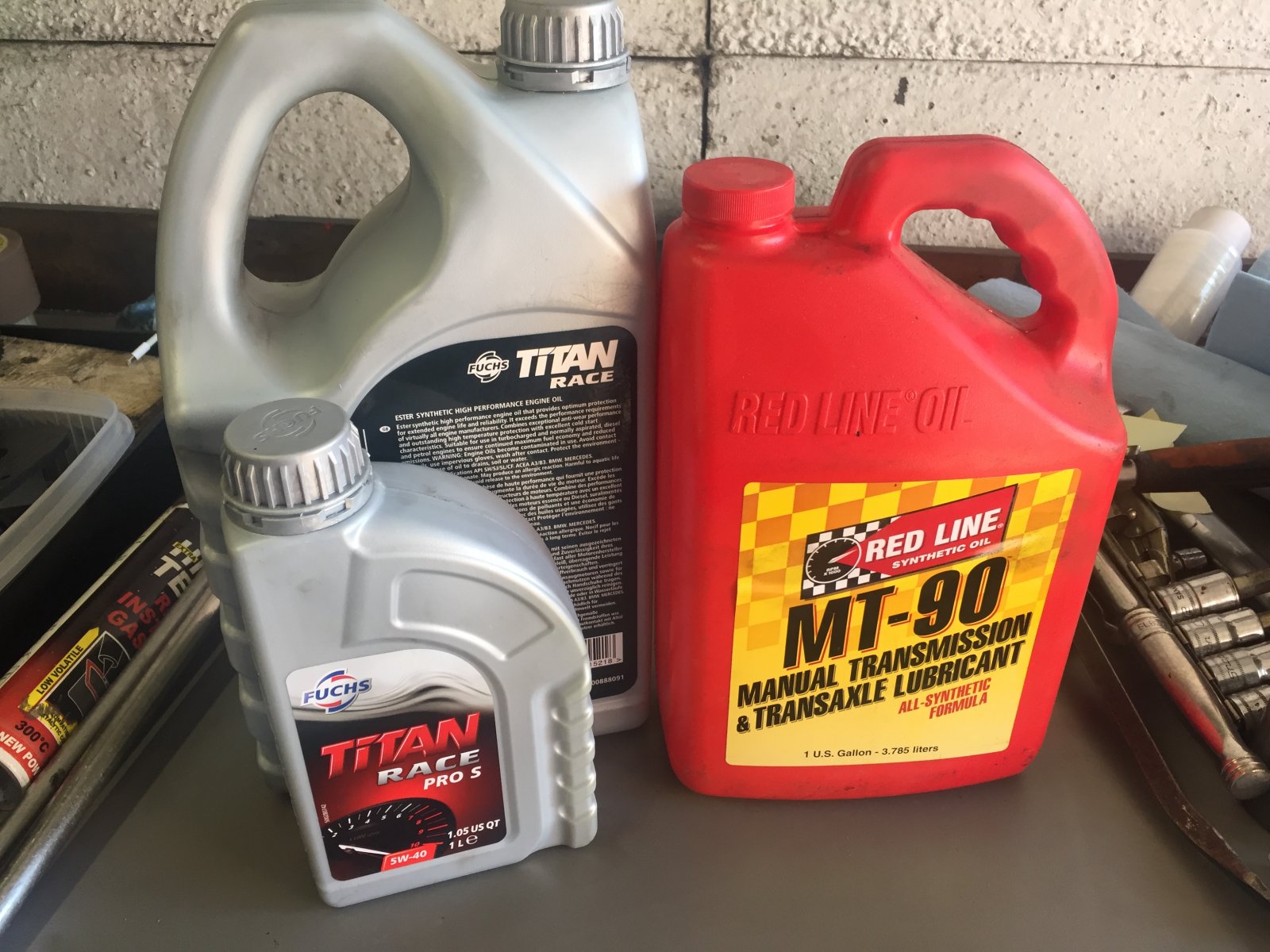

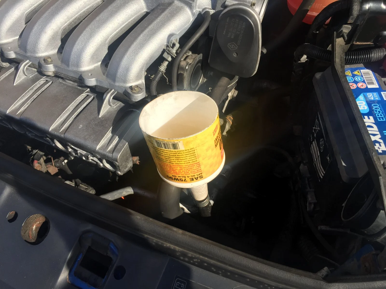

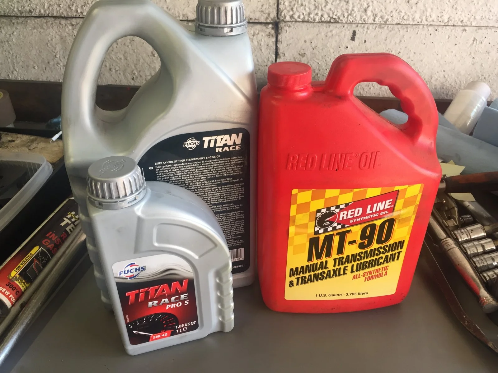

Engine & Gearbox Oil change this afternoon, I really don't know what to do regarding the Turini's colour, as if I get them done silver I may just keep them for the 182.

Yes turinis in silver make it look fresh,glad i got mine refurbed.

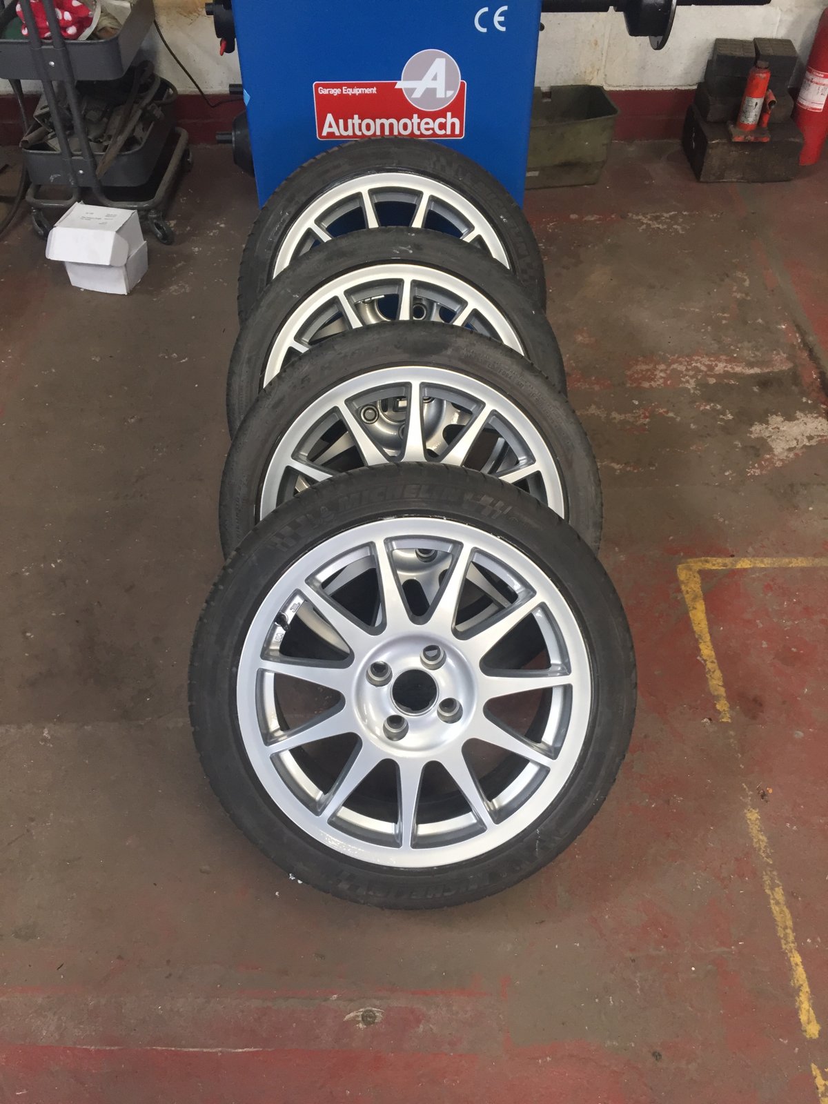

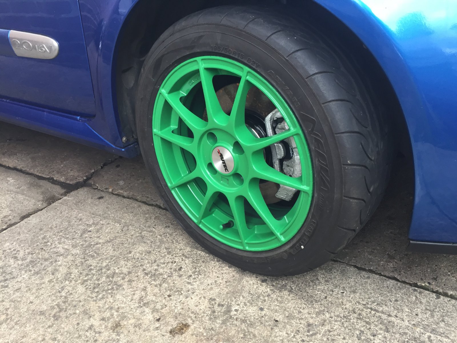

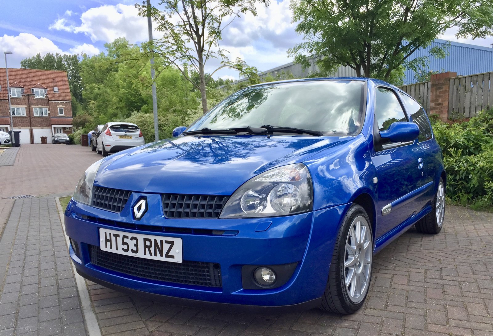

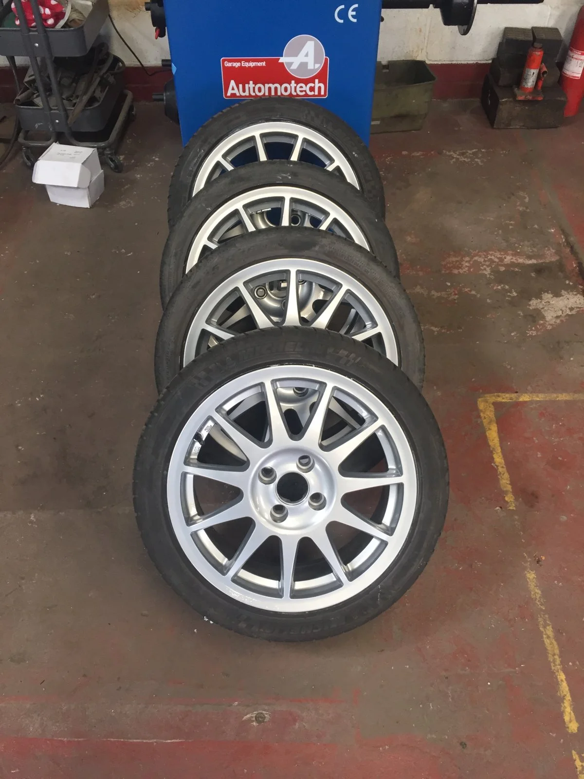

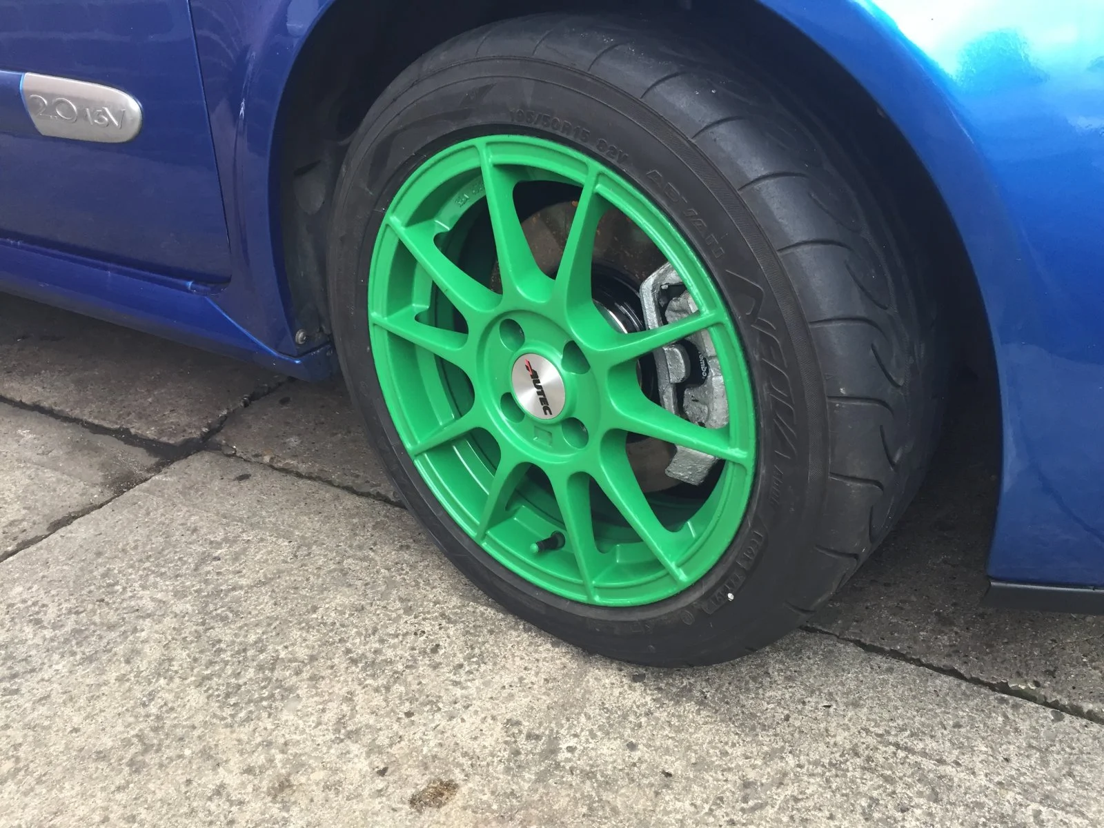

It's coming together nicely now, Yesterday I dropped the wheels off at the coaters,
then this afternoon I fitted the new number plates which always freshens up the look nicely,
the passenger wing mirror had seen some action so I replaced it with a mint used one from @Mbeau, thanks buddy

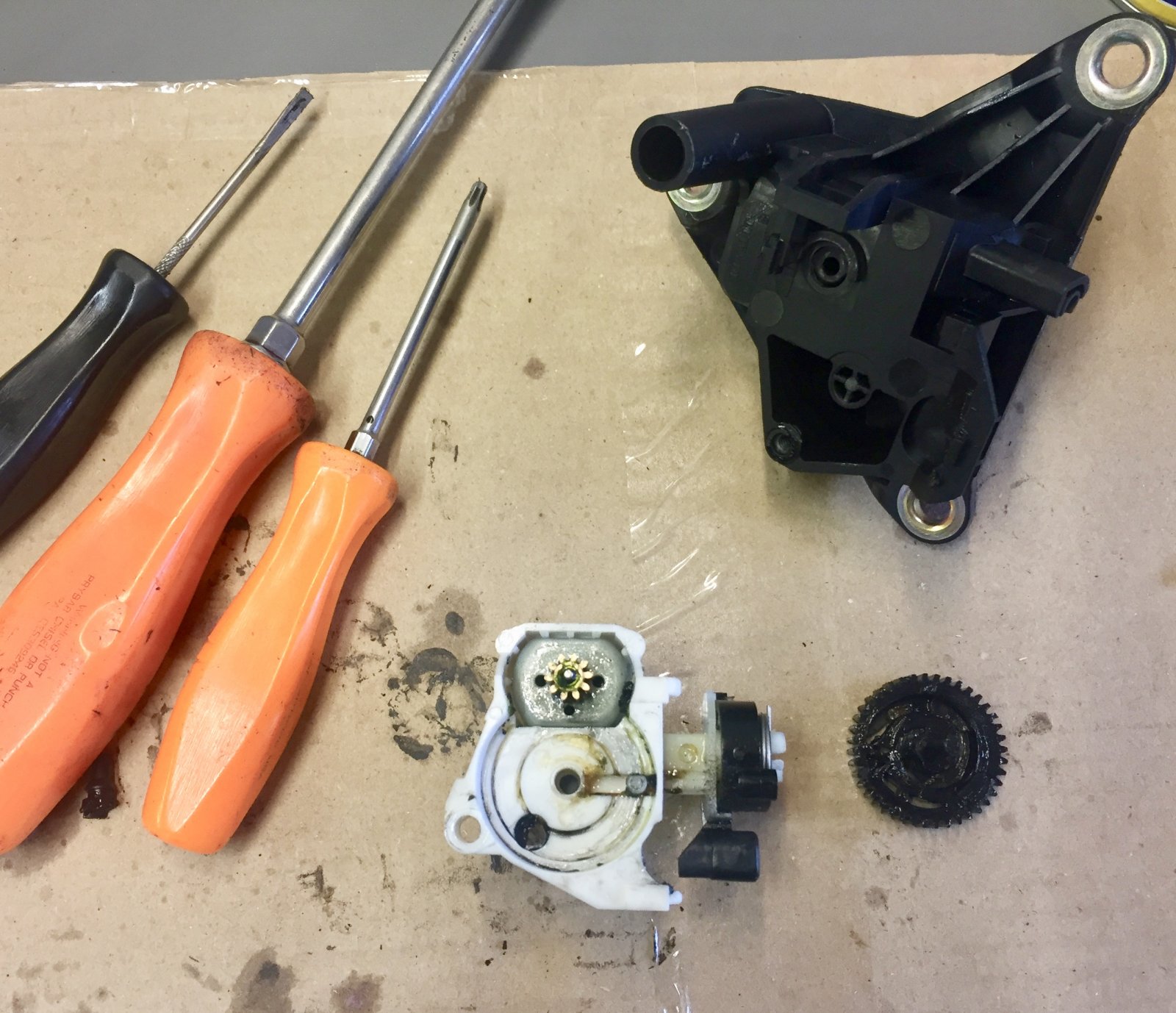

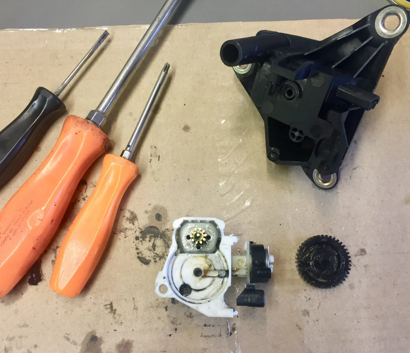

Also found the boot lid wasn't working with the rest of the central locking, a quick investigation showed that it was simply the drive gears in the lock motor sticking, the grease had gone hard so cleaned, lubed, tested, all's SWEEEEEEEETTT
All finished,
