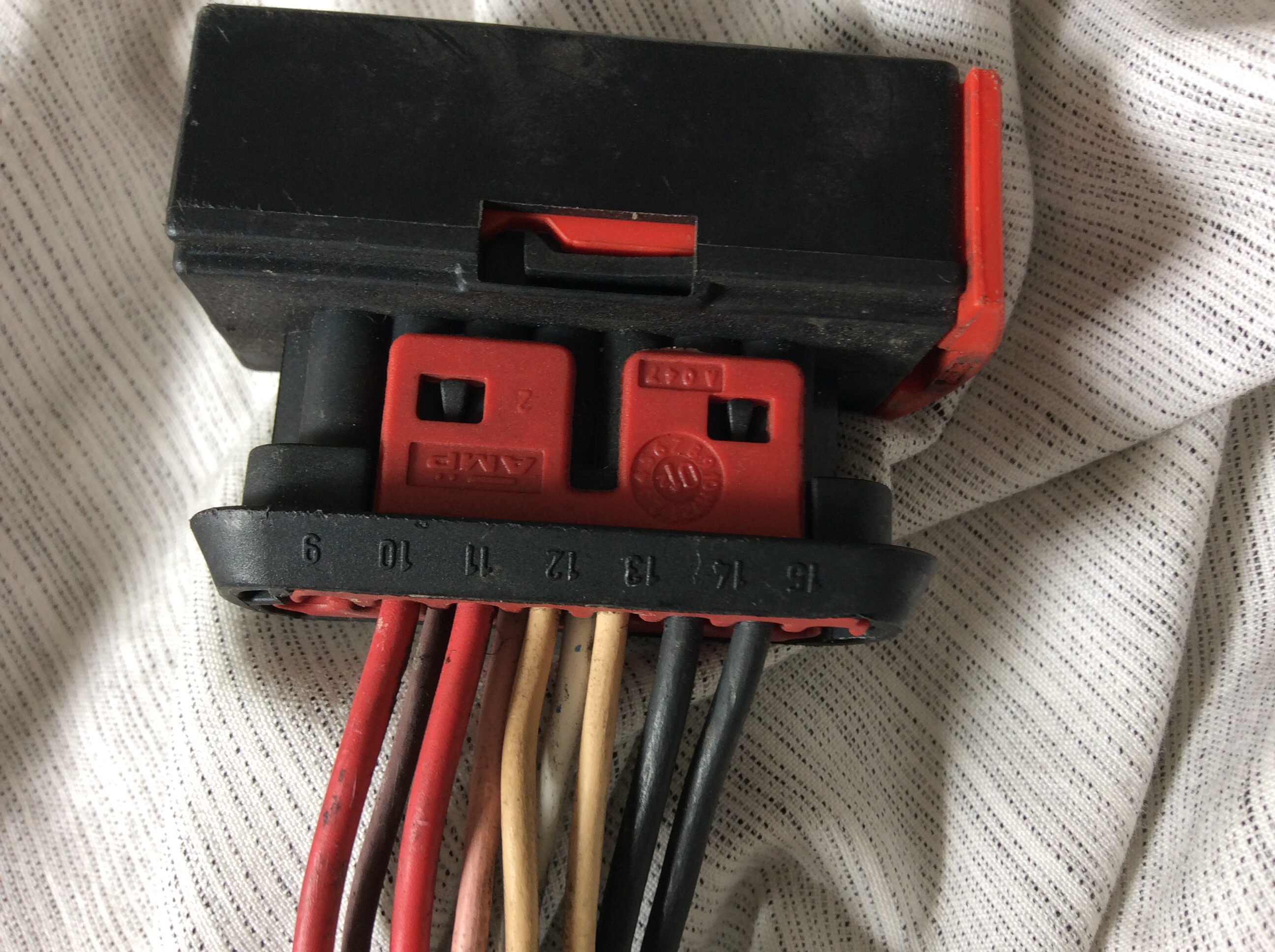

So Basically, The track car having wiring done, using original blower for demister only, just want to know which wires run the motor on full ?
I used one of the thick red wires, ran a multimeter over the plug to find the permanent 12v power and then ran it through a toggle switch and up to the blower, so it's basically either on max speed or off
