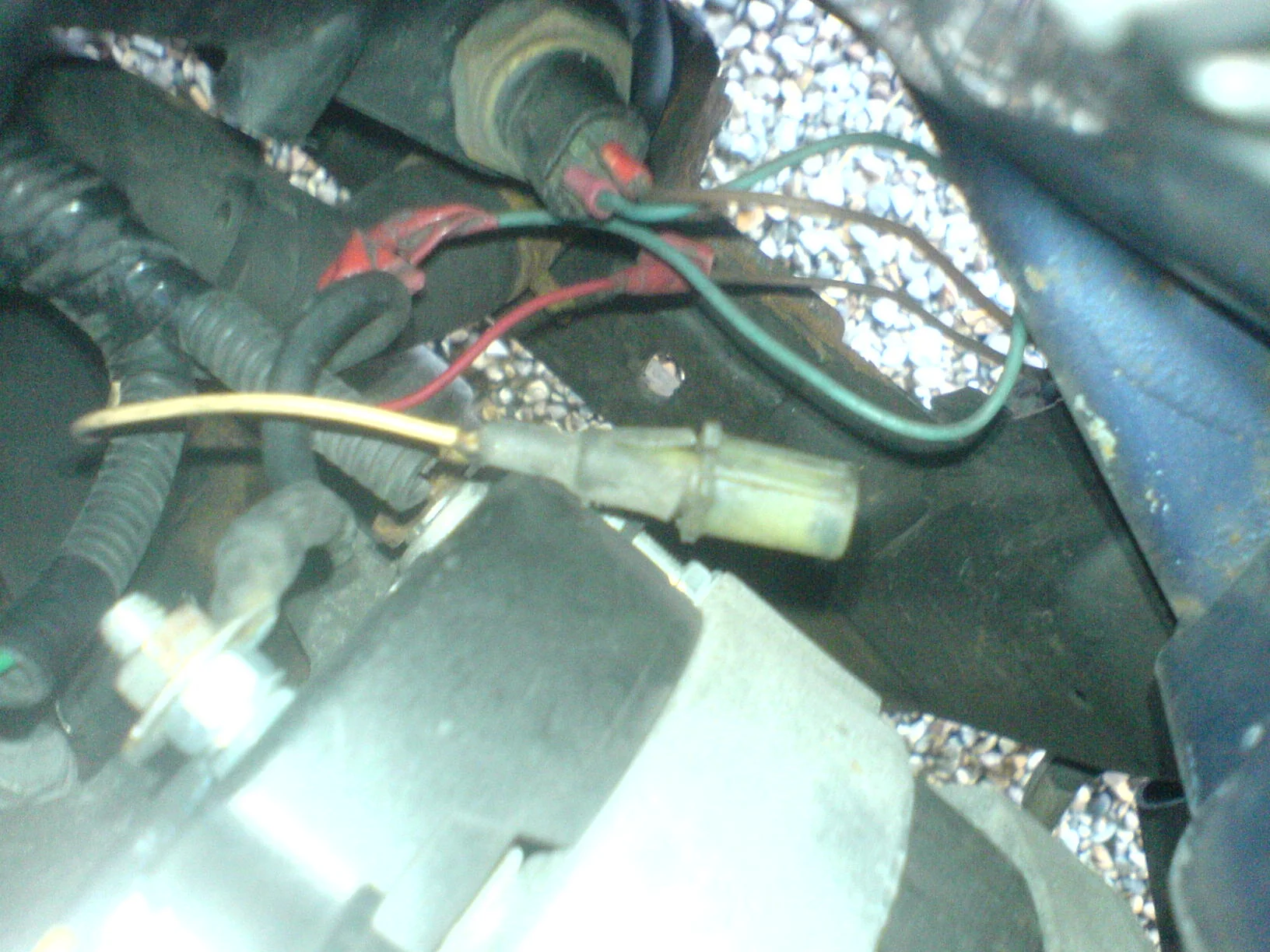

this started last night after i went around a corner quite sharp (not sure if this has anything to do with it?) anyway now when im driving it is constantly flashing untill i let the car sit at idle then it seems to go away but not always??? i checked the voltage on the battery and its at 12.4v when engine off and 12.4v when on so its not charging! alternator is only 3 months old though!!! any1 got any ideas what to check?
oh and also at first i thought my earth strap to the body was bad so when i checked it, it sanpped off in my hands, but i have just fitted a new 1 and i still have the problem!
i just found this plug type thing hanging around next to the alternator? should it be plugged in somewhere?

i just checked the voltage across the b+ on the alternator and the negative of the battery and got 12.5v again, also there is no cable connected to b- terminal on the alternator???
oh and i found where that yellow plug goes and i put it back but it didnt seem 2 do much?
Only 1 cable (red on mine) is connected, that's true.
That plastic thing also isn't connected in my 182
