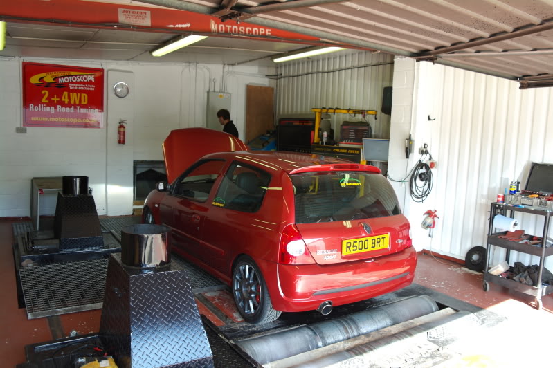

I nearly always use Motoscope in Northallerton as the cooling is fantastic and results always seem to be very accurate.
On the rolling road with Rich about to start the session;

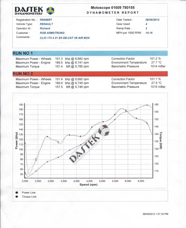

And the results - 189bhp and 157Ib/ft;
Loads still to do as target is 200-250bhp but unsure of what I want - forced induction or ITB's

189 on a pretty much stock engine! Certainly reading high, wonder what it would of produced if you told him it was standard my guess is 172? Go back tell him you have matched the inlets and gas flowed the head. Bet you miraculously get 195.

Honestly pal, I had the same mods on my old 172 Cup (No aircon) plus matched inlets and an RSTuner map on a corker of an engine and it only made 181bhp / 167lb/ft torque. Realistically with a strong engine that will be making between 175-180bhp, for a staring point having all them modifications wont give you a true reflection if/when you go forced induction/ITB's.
Not trying to cause offence obviously, just some rolling roads read too high and thats mainly down to the person using them.

My 172 made 151 at the wheels at the RR day I went to with the West Mids lot,
taking into account a 15% or so loss through the drive train,
my flywheel power only worked out 173bhp, or is my maths sh*t?
Mine's got, V6 box, matched inlets, Piper exhaust, Fastchip remap.
How have they worked out the engine power on yours?
My ph1 running 182 manifold, decat and yozza stealth with itg panel filter did 179bhp gotta agree with others that yours is reading kinda high at 189 I'm afraid

Focus RS's only make 275.
You lost 48bhp through a clio gearbox?
Did you accidentally fill it with readymix concrete instead of gearbox oil or are the rollers just literally printing completely random numbers?

This was my old car and I got it rolling roaded with a 197 at the same time and the 197 got 192 and this Clio got 185

I put mine on the rollers in andover with 2.25 cat back and pipercross panel and got 159.7at the wheels :) does seem a lil high at 189 :/
