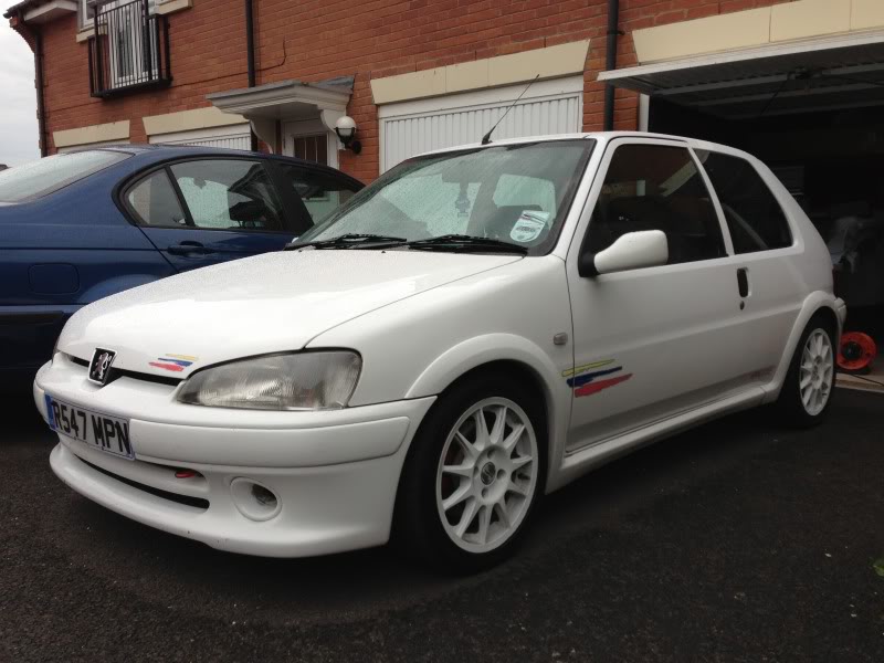

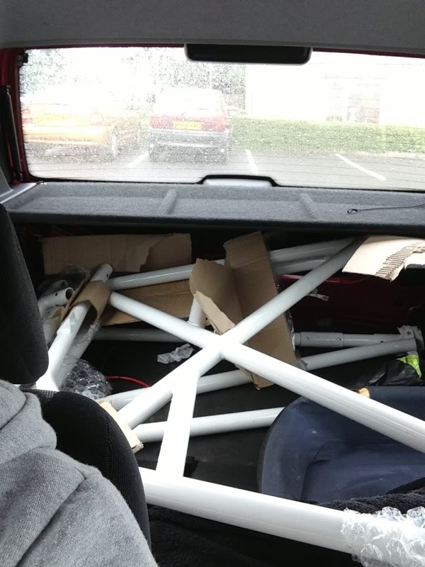

so on Saturday i jumped the gun and went and collected a 12 point safety devices cage.

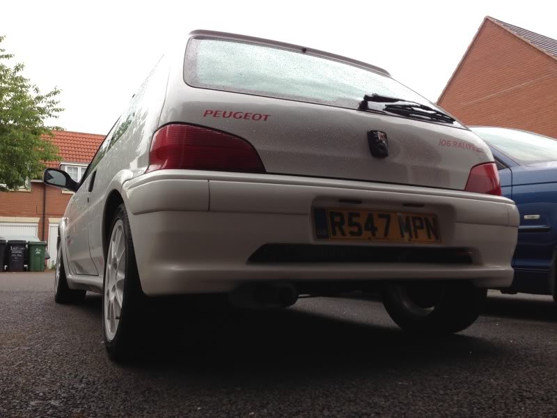

On the Sunday i collected the car. On the outside it looks pretty good but underneath it needs some work. not much of a problem for me ill get them patched up and get down to the important stuff, driving.

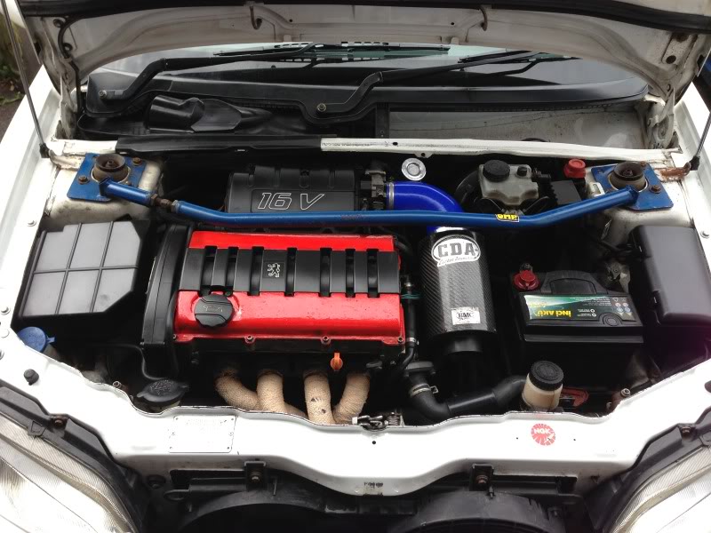

A quick check over and the cars mods are
omp upper and lower braces
266mm brakes
15 inch turinis
raceland manifold
2 inch pugsport
b&m quickshift
CDA carbon induction kit
lowering springs unsure what, look like standard dampers. all of which are being sold to hopefully recoup the majority of the cost of the car.

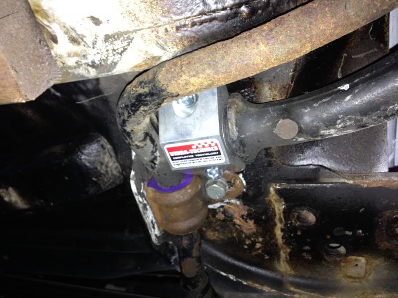

full set of polybushed
group n engine mounts

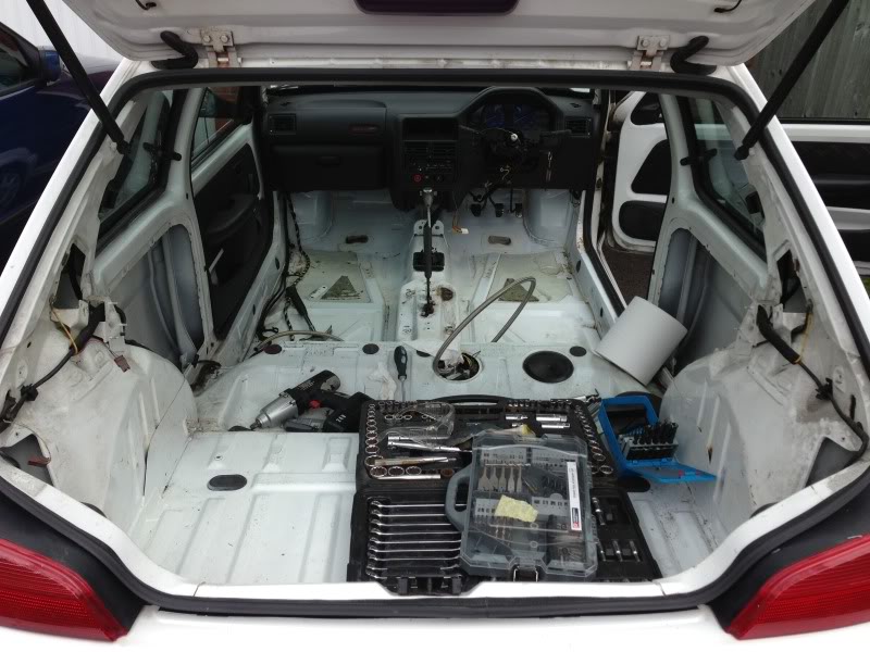

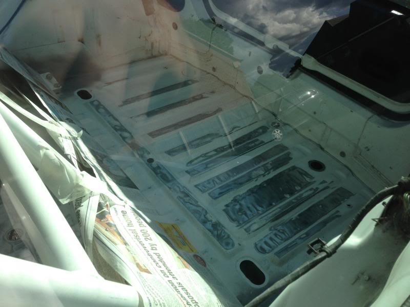

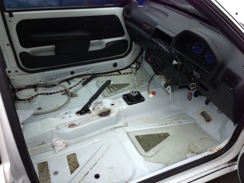

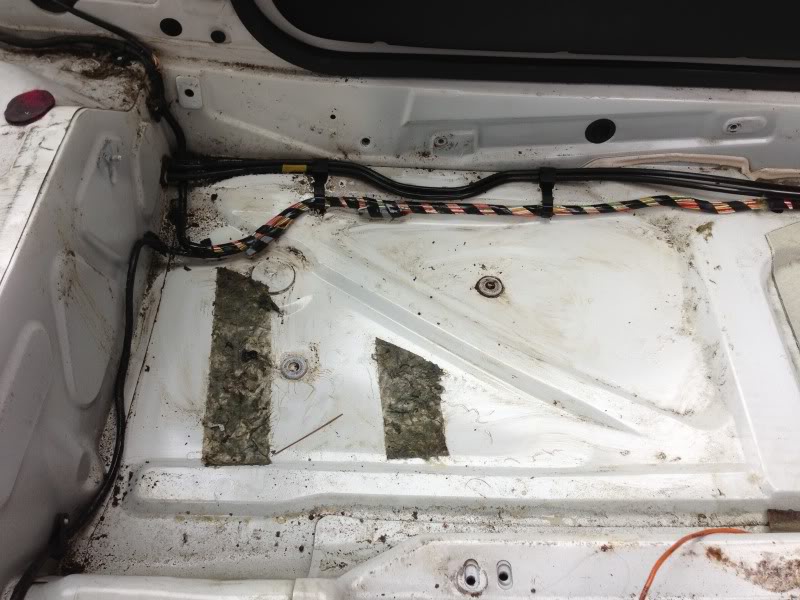

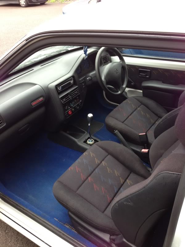

First thing first was for me to start getting the interior out.
It was the first time id took a interior out of a 106 that had obviously not been taken out before all the fitting where still there, felt strange lol.

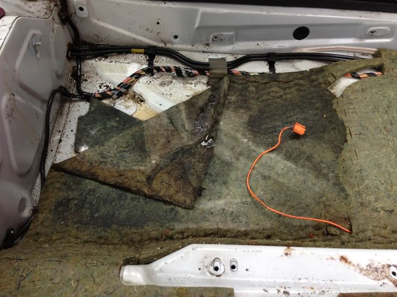

Whilst stripping it seemed like there was petrol under the carpet, not sure how the lines seemed alright unless one had been taken off previously and the petrol not cleaned.
It was abit grim but it cleaned up alright

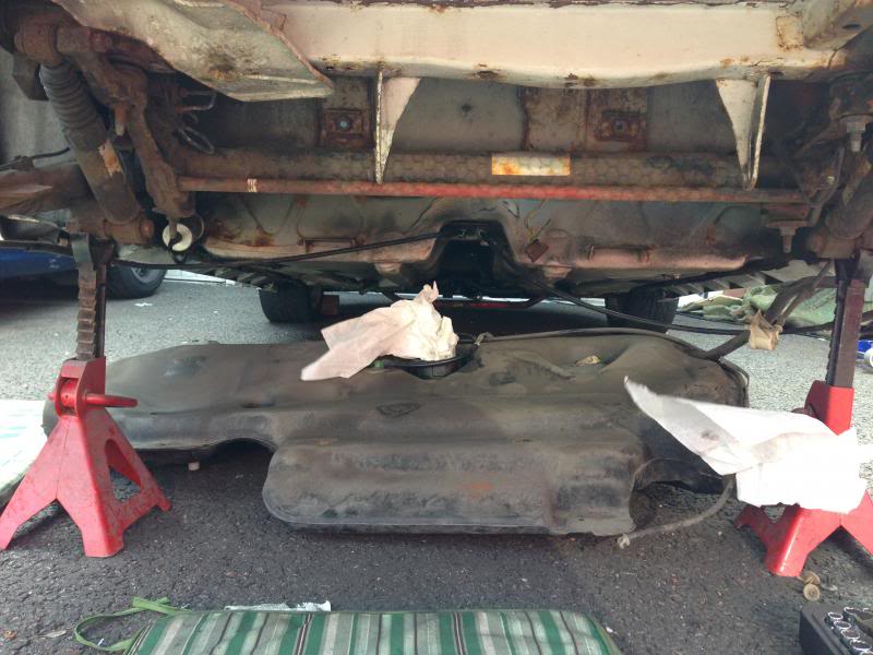

At the end of the day id removed most of the fuel from the tank as it was going to be removed for the cage plates being welded in. id removed the roof brace for the cage to fit. and got most the interior and sound deadening removed (still the tar stuff to tackle) id also trimmed the dash for room for the satchshift to work.
It doesn't seem like id done much today but only had half a day on it due to going into work. Also a couple of deliveries turned up. some oil from opie oils and some hel braided lines.

Started off taking the exhaust off then the tank fairly straight forward, i cut the fuel lines so it seems im going to need to use my fuel system, no bother would just of been nice to have the money rather than need to use it.

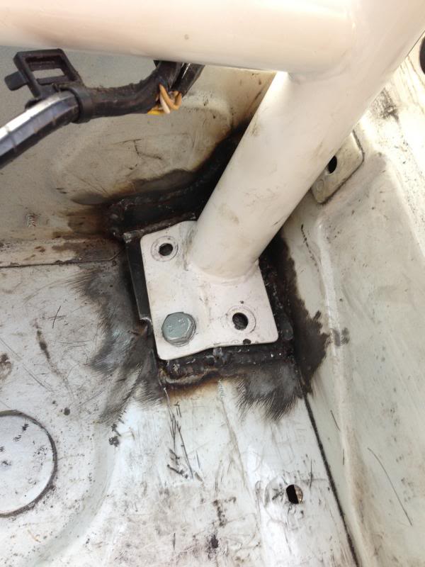

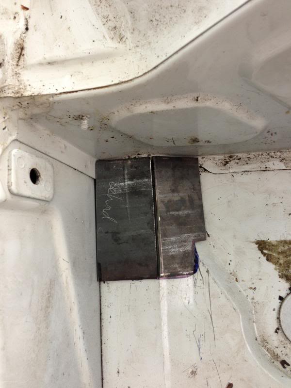

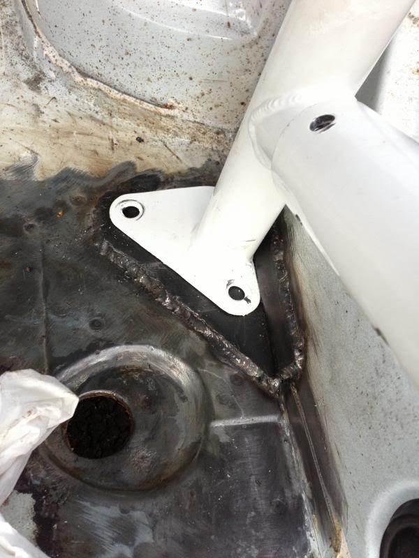

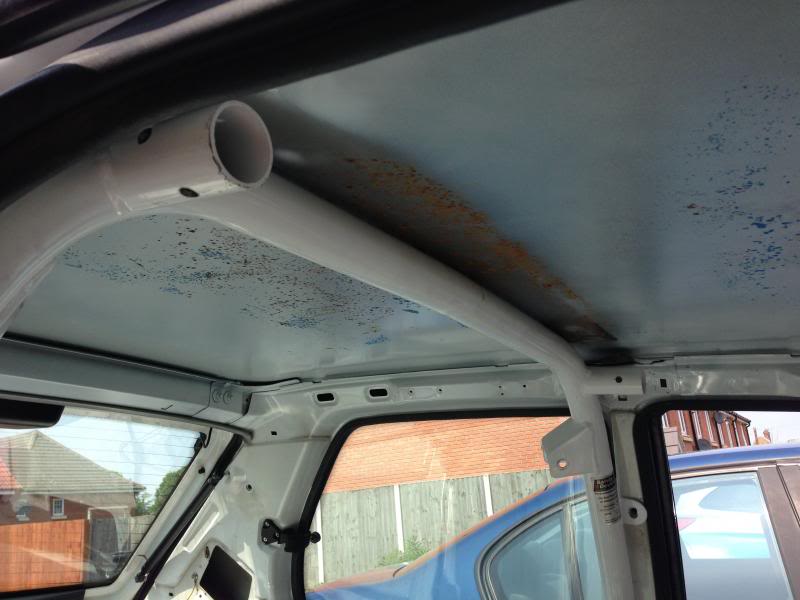

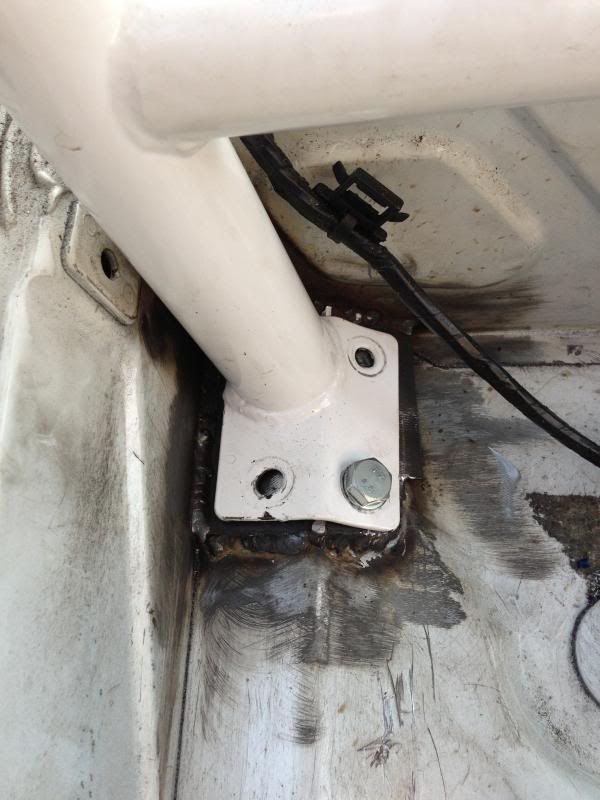

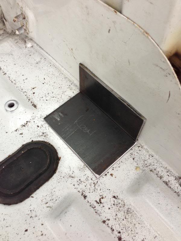

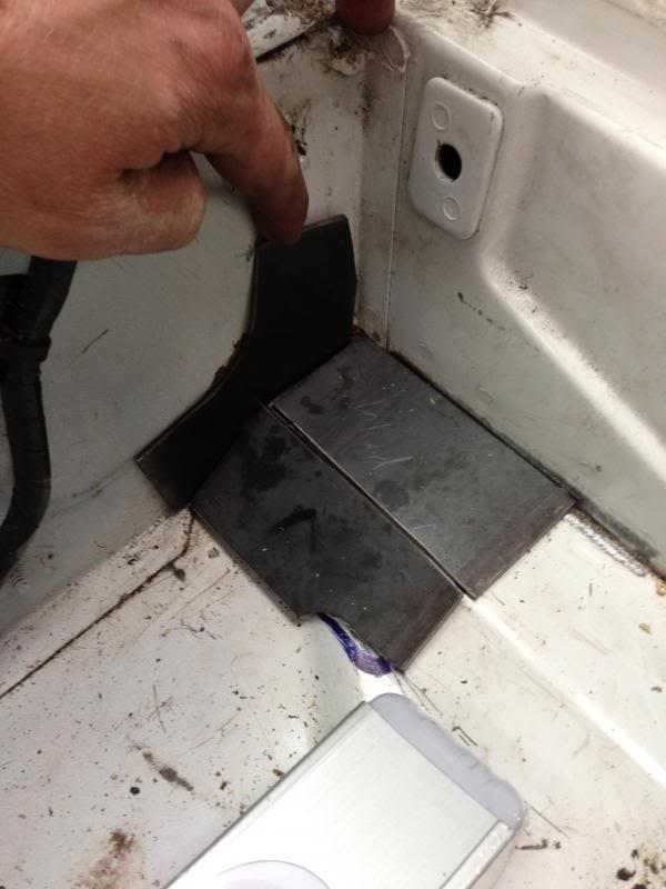

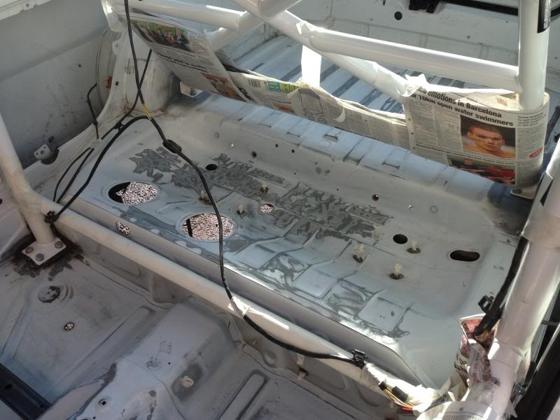

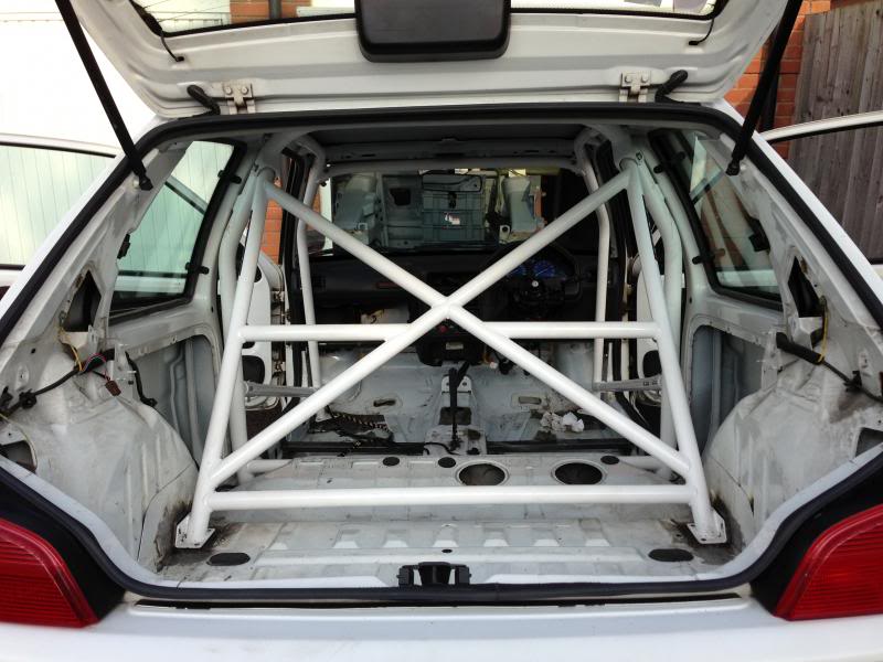

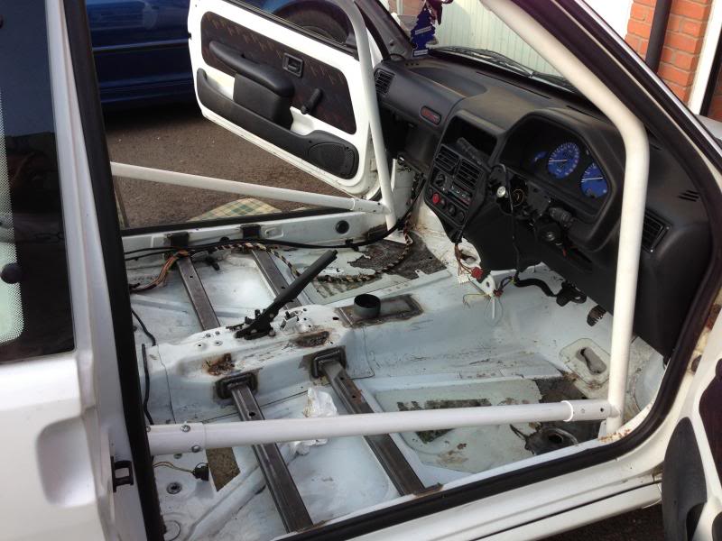

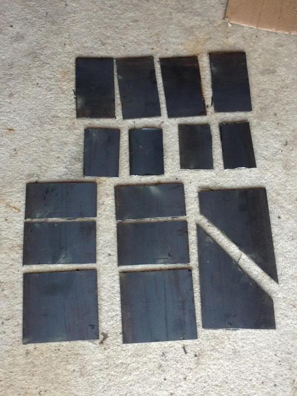

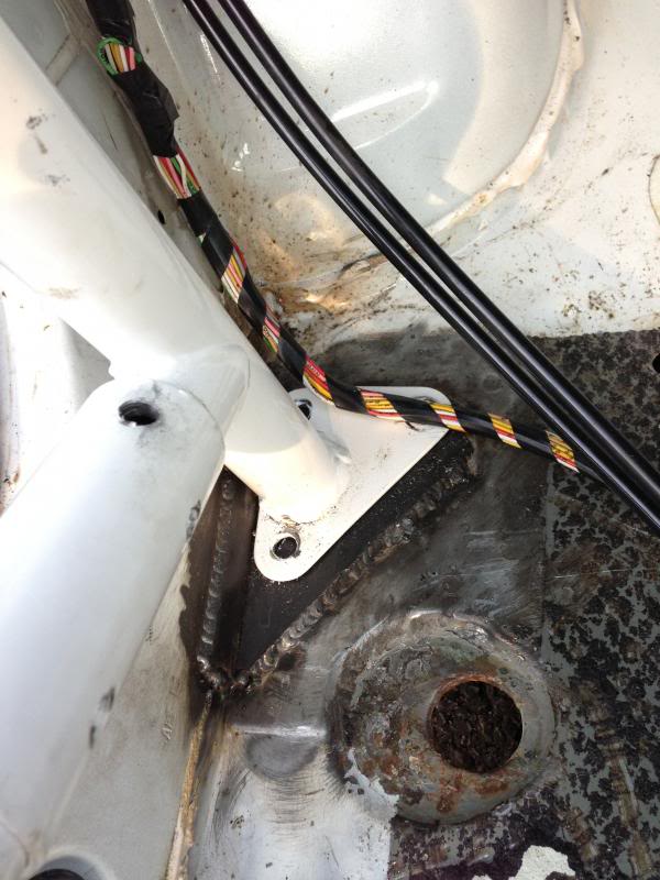

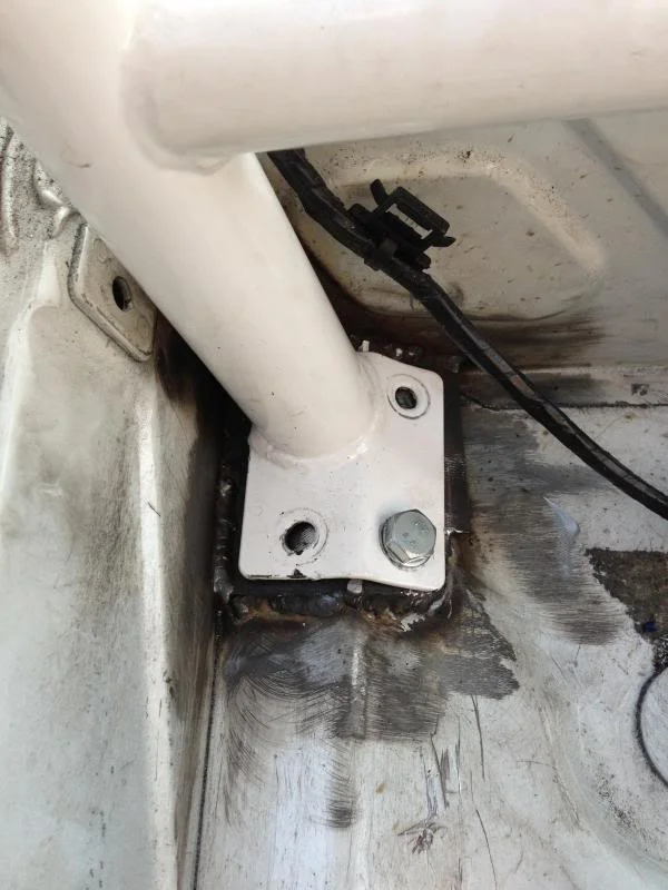

Next was to make some plates up for the cage. instead of paying £70 for some already made up plates i thought id make my own. now i don't really have anything to bend 3mm sheet metal so i thought id cut tack then weld any bends in. the metal cost me £7 and as a complete guess at the length i was surprised to see i had 2cm left over. chuffed lol.

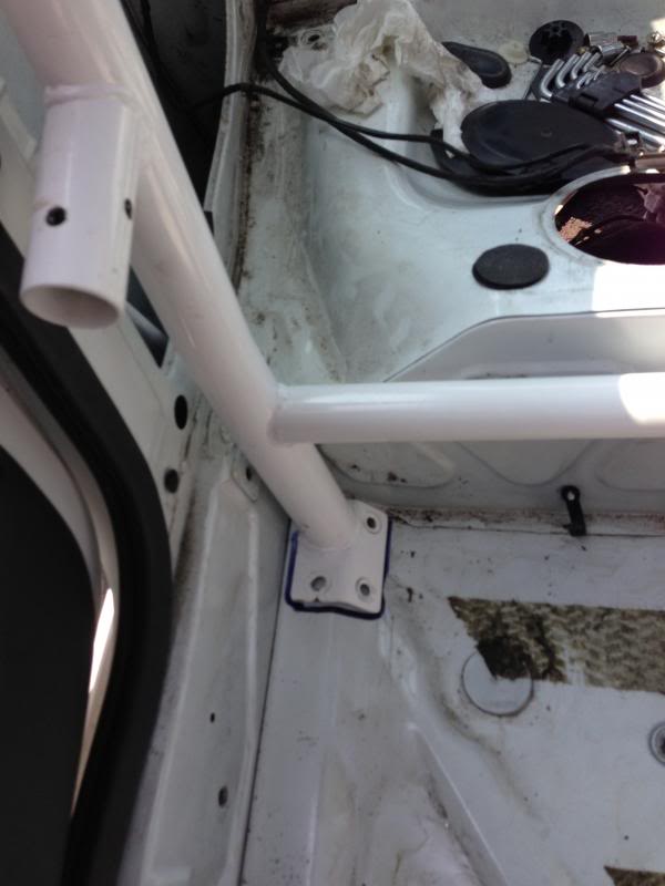

The two rear mounts

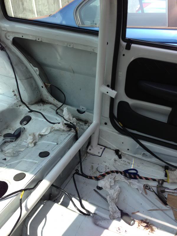

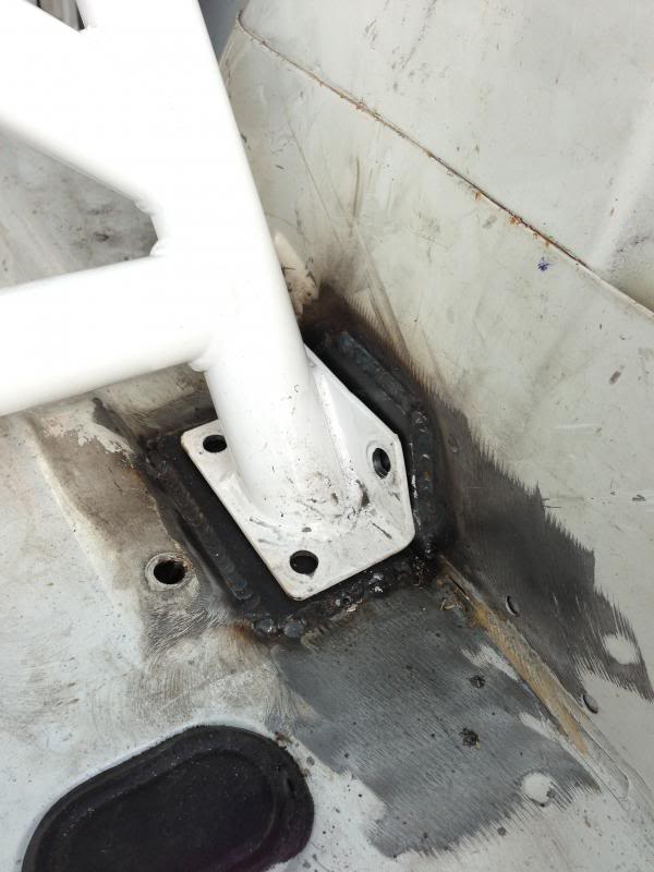

I had to stick the main loop of the cage in to see what mounting it would be like as the floor is uneven and the cage didn't seem to be shaped to fit, what have other people done here? ive just shaped it to fit.
A pic with the main hoop fitted showing the roof brace removed that i did yesterday.

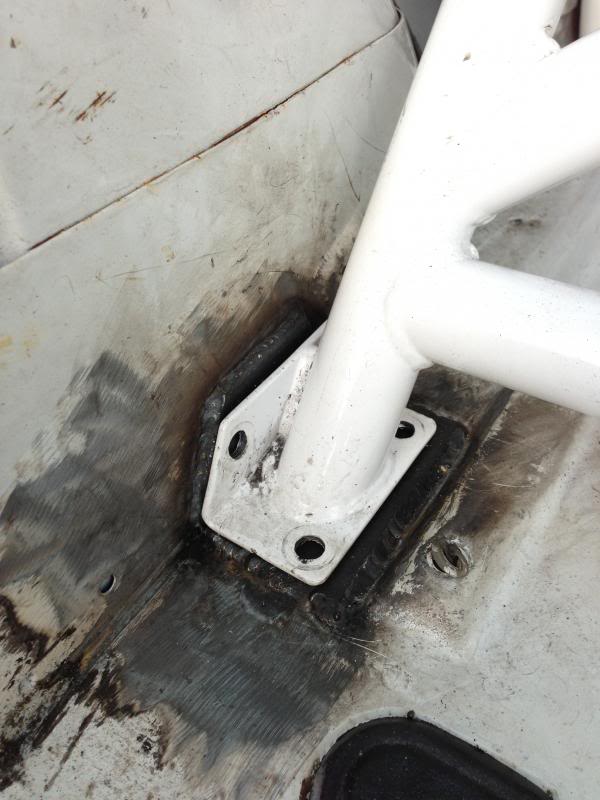

The two middle mounts and one with a plate to cover the fuel line holes.
The two front ones are yet to be trimmed and fitted.

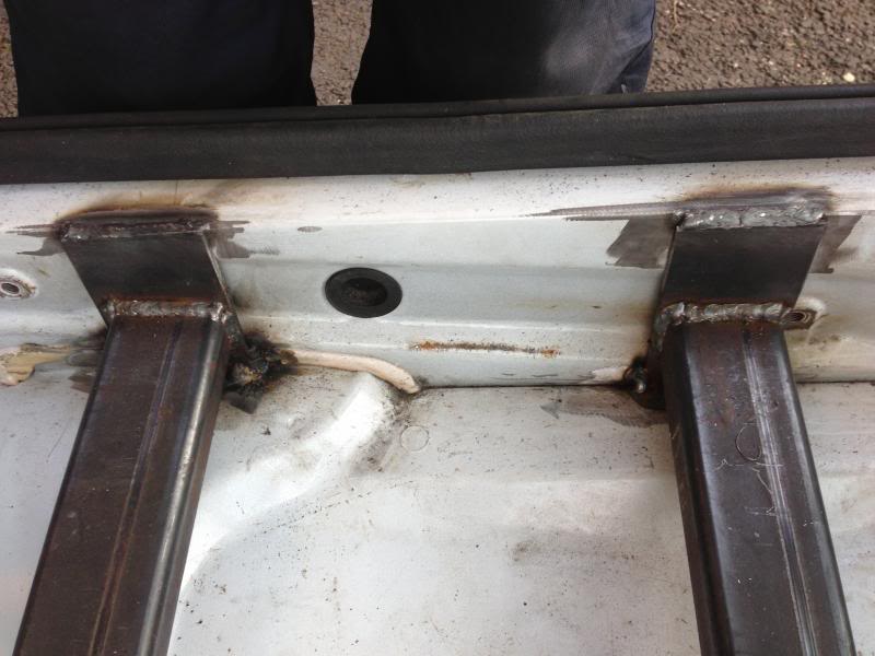

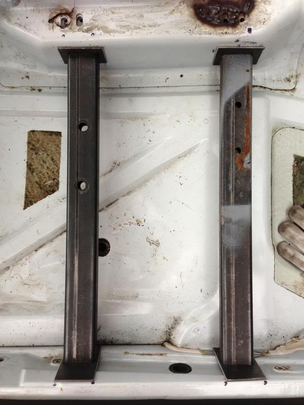

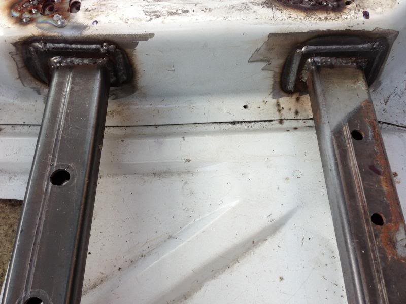

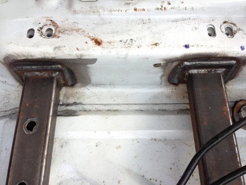

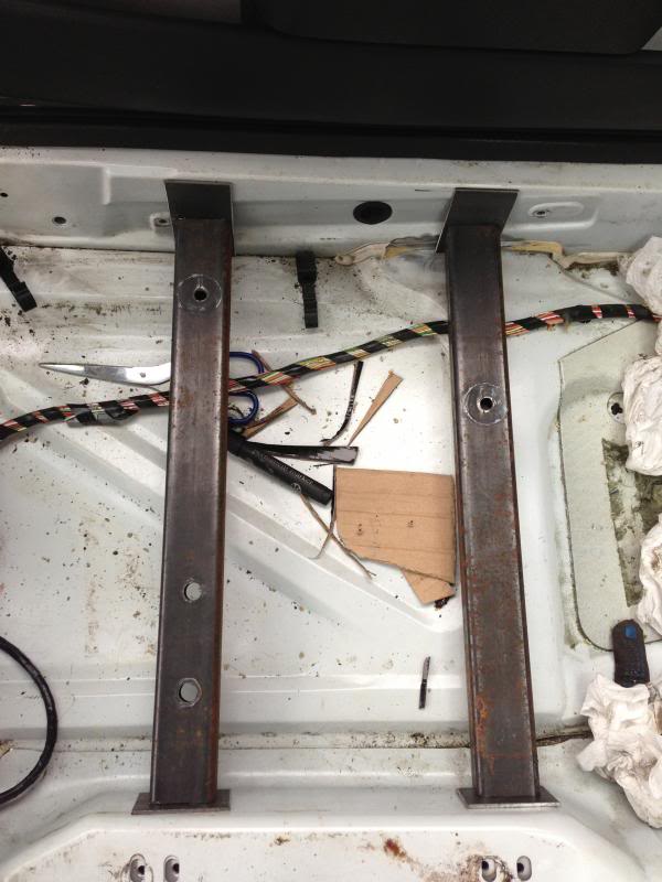

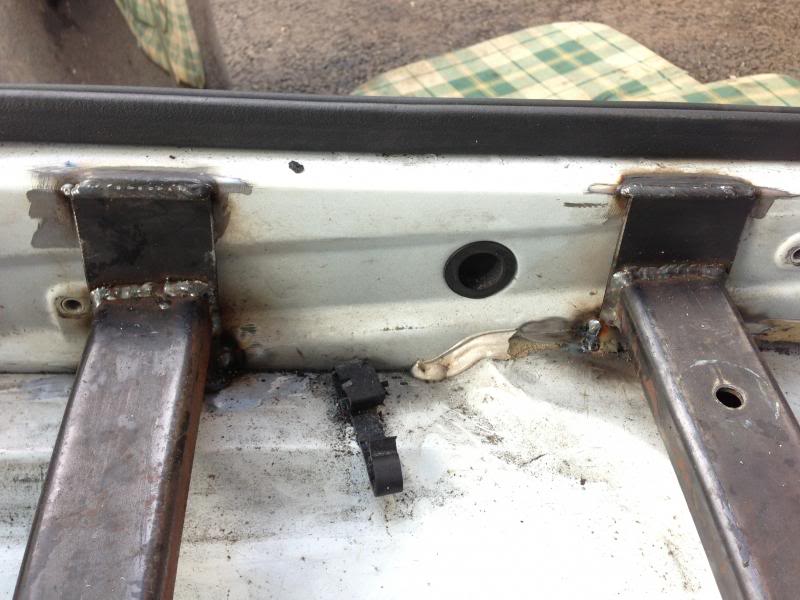

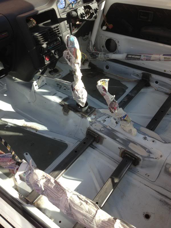

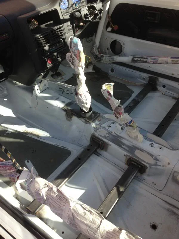

Lastly i made some seat rails up using some left over metal 3mm thick and 5x1cm ish so plenty up to the job.
hopefully have the cage in and seat rails in tomorrow.

​Well bugger me todays been a long one. felt like its been non stop infact thats what its been. bit of a nightmare with the cage trying to get it all lined up its been in and out more times times than i care to remember.
it isnt quite in, it needs the holes drilling then its in. and its staying in if i have to get the dash out i think ill cry. ill let the pics do the talking.
Front legs
Middle legs
Rears
Seat rails
Couple of bigger pictures. you can see i had the satchshift base welded in.

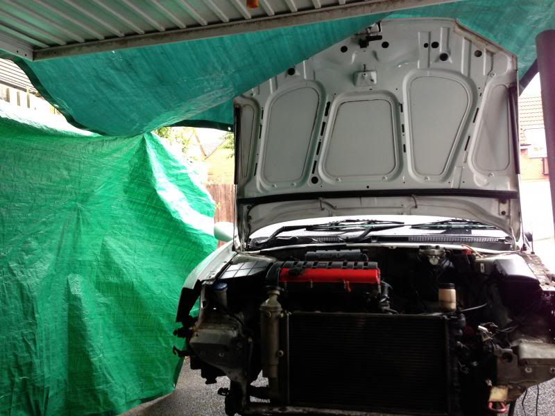

A full day of non stop rain didnt hold me and a mate back, we did what we could with the little shelter we had.

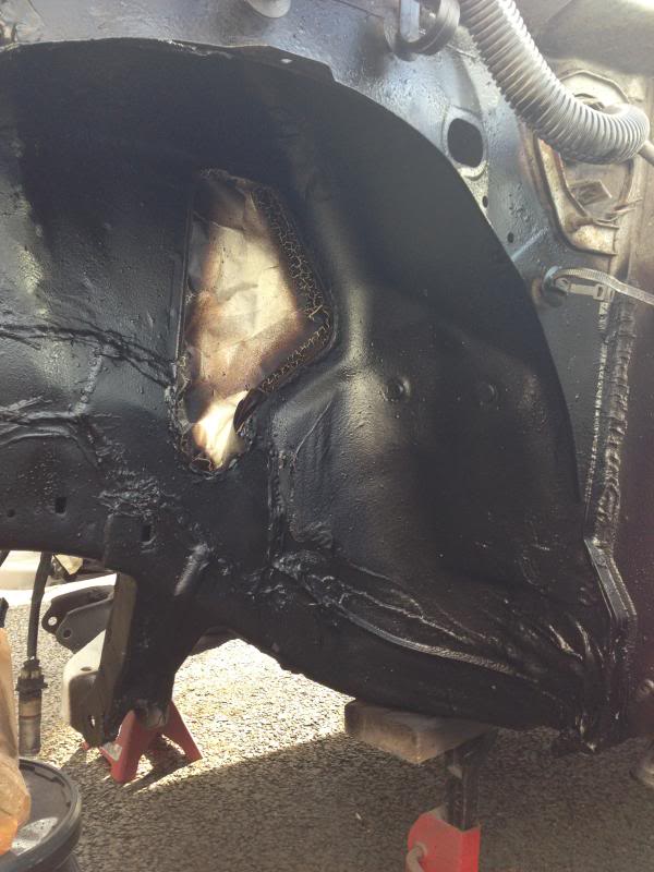

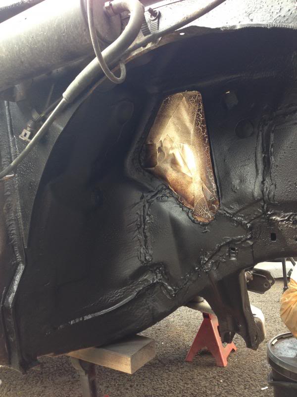

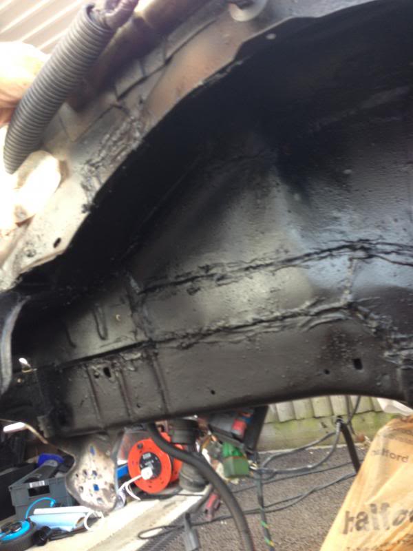

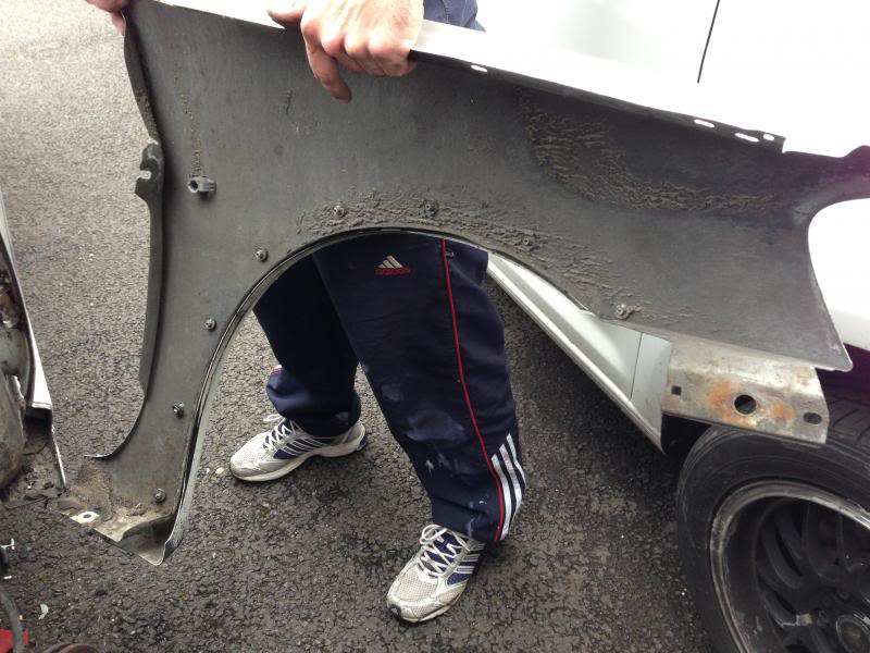

The front has been stripped back so i can start patch the rust holes. the car was ran without inner arch liners so it was rather dirty.

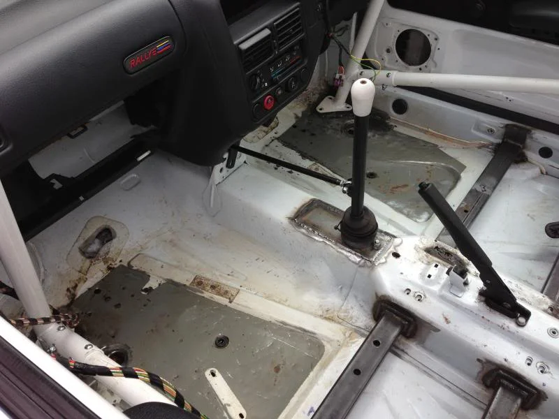

Tar removed, that job never gets any better. Shifter fitted. Unfortunately the gearbox shifter fork is missing the ball i need to get the shifter working as it should so im on the hunt for a new one.
Basically every job so far has taken 3 times longer than it should all the bolts have been rusty and most have snapped meaning they needed drilling out and re tapping. Removing the slam panel and drill the holes took 1.45 hours that's 4 bolts so a massive drain on time.
I wanted most of it done this week but the more i strip it back the more i see it'll be a matter of weeks not days to have it sorted, just wish i had more time.

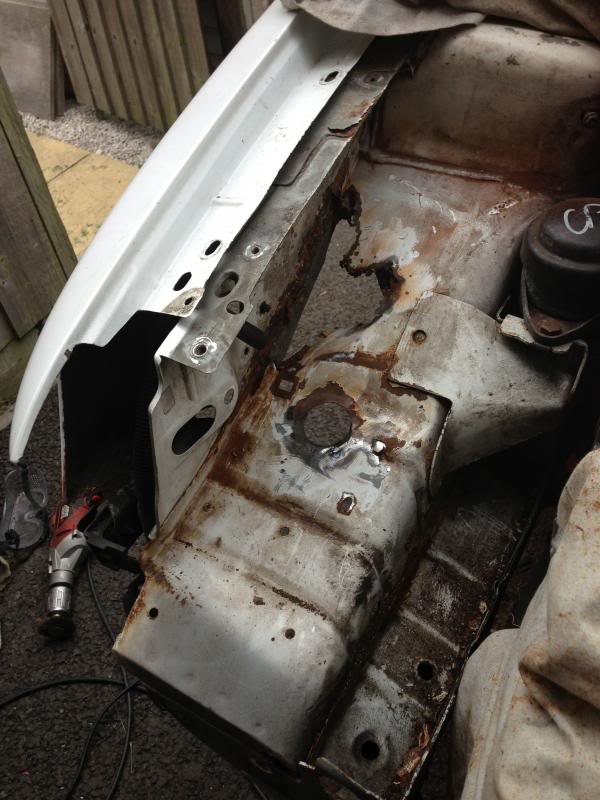

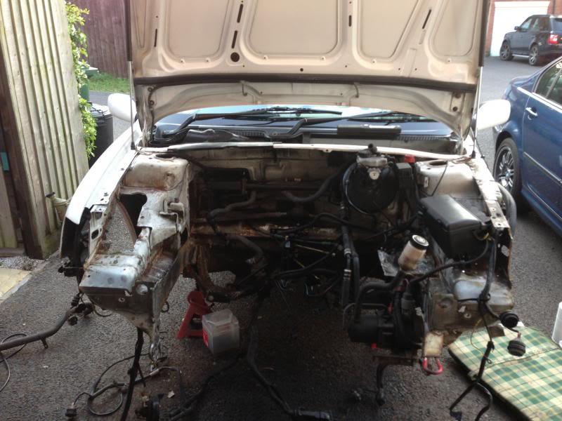

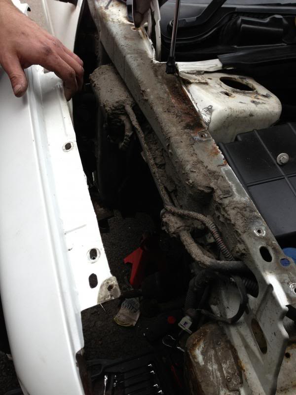

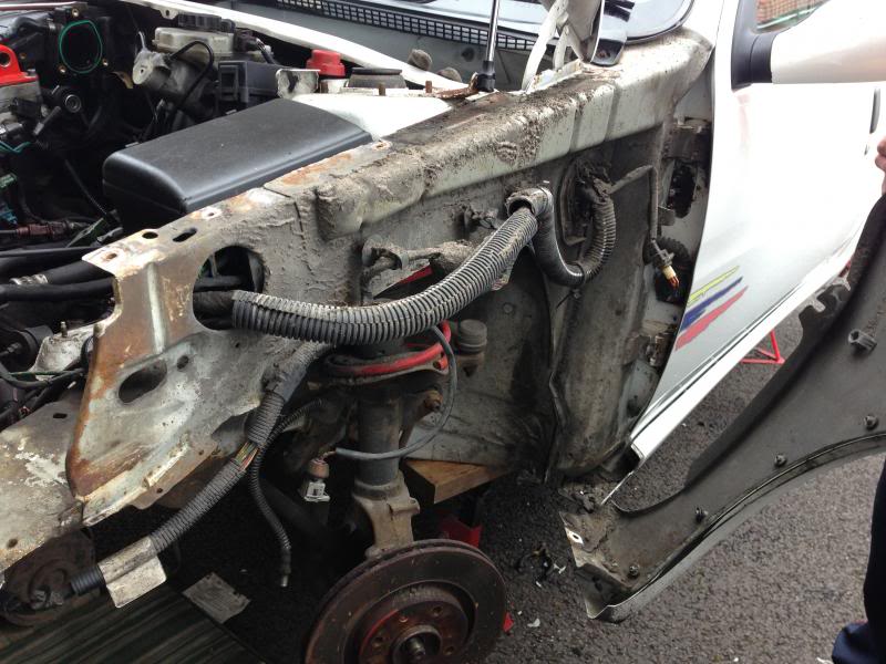

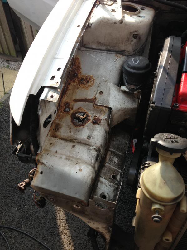

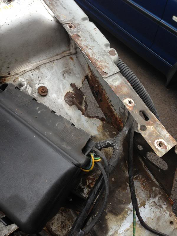

​Well i had a early finish at work today so started prodding the rust.
When i got the car it didnt look so bad a easy job to patch but inevitably the more you look for rust on these the more you will find.
I then got to the point of f**k this lets get the engine out so i can do it properly theres no point sorting rust but leaving it in other places.
im once again digging another hole but im trying my best not to go mad just get the basics done.

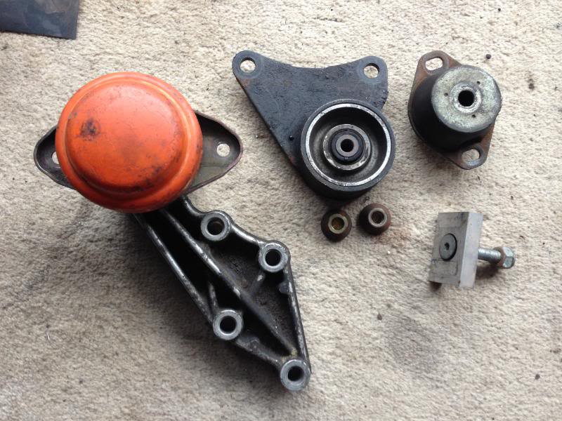

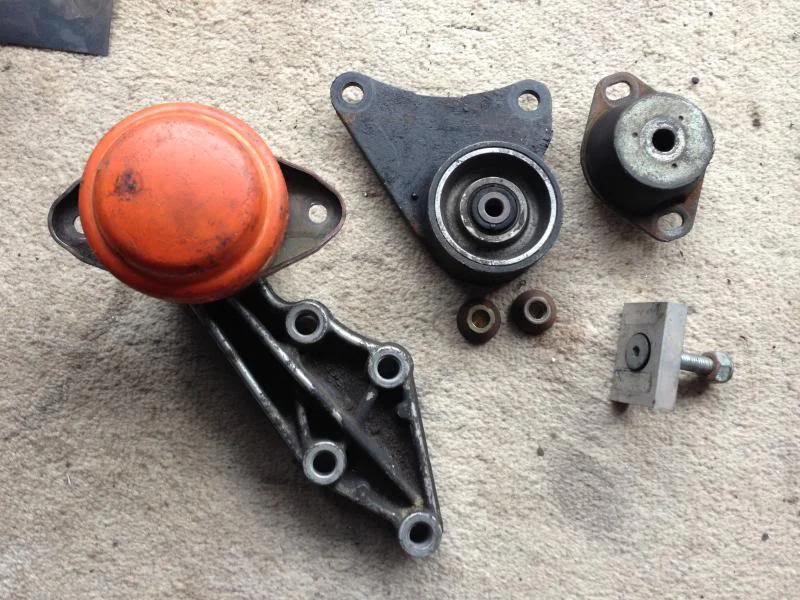

firstly some new bits, group a Peugeot sport engine mounts.

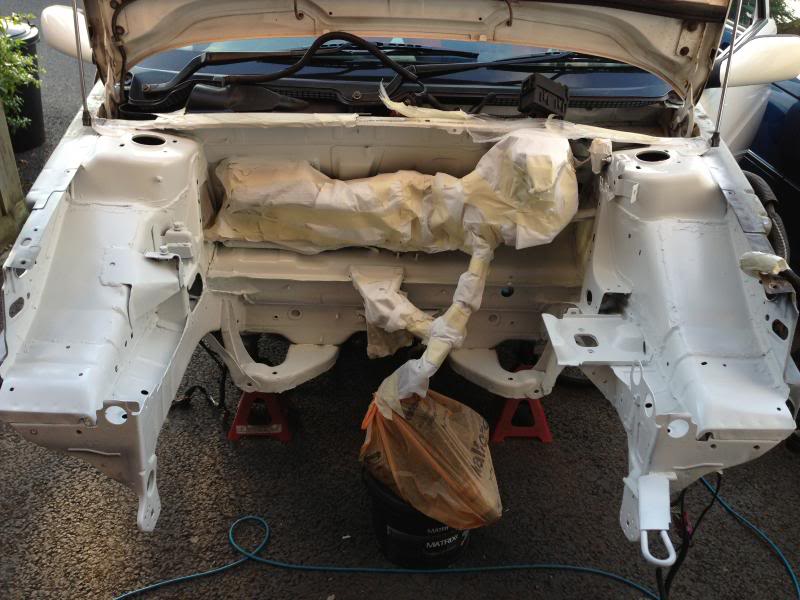

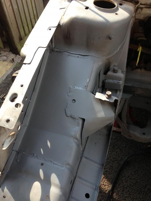

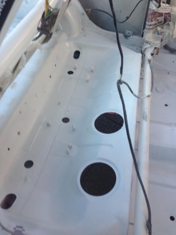

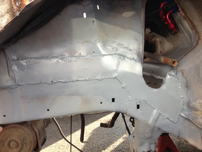

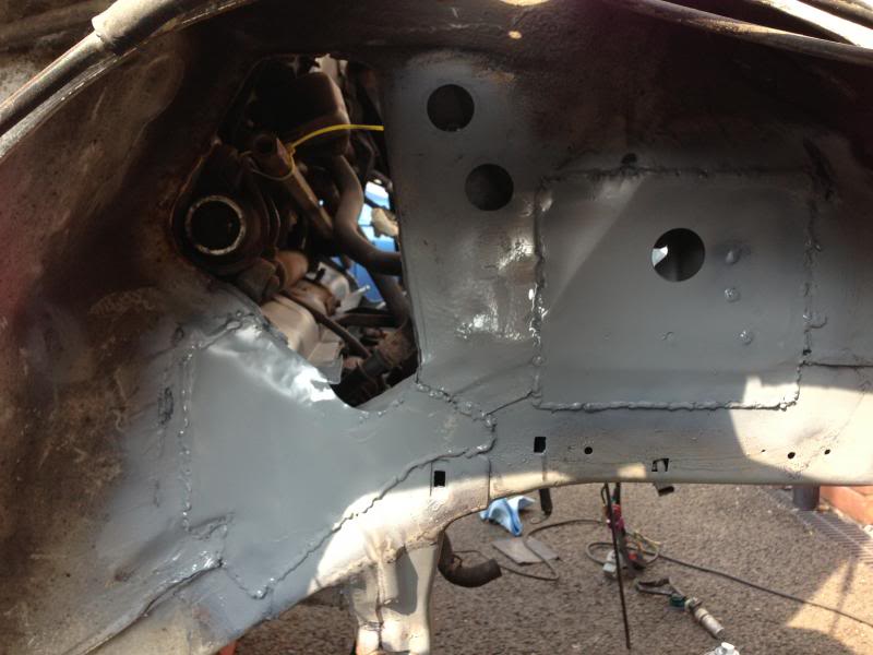

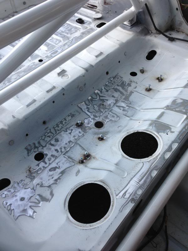

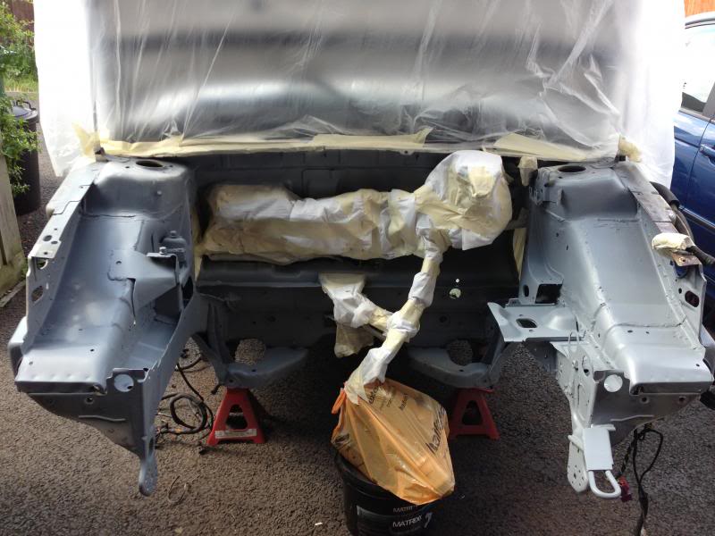

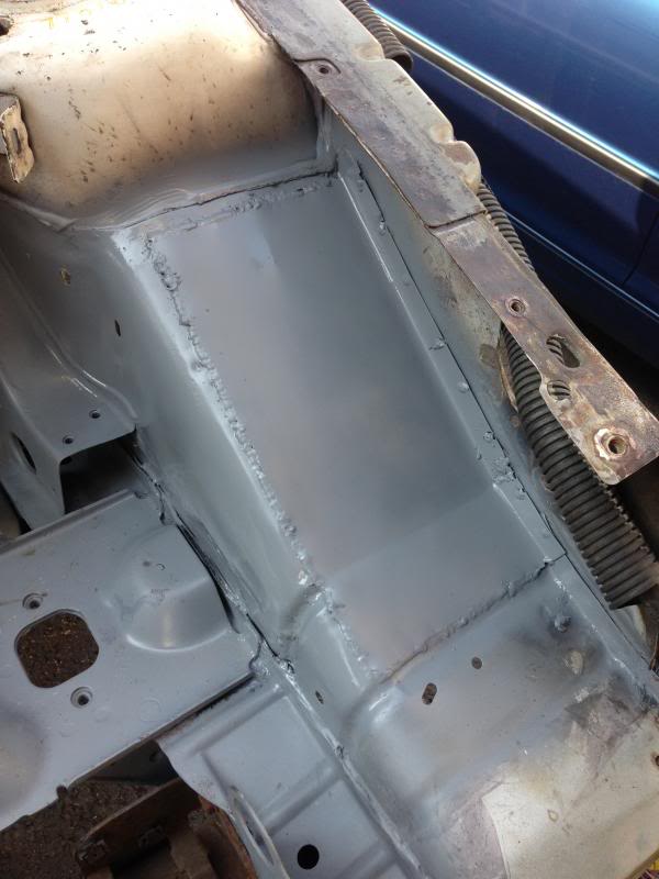

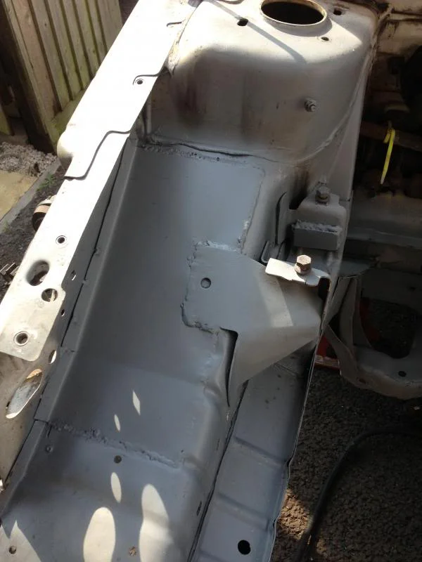

the shell is now is decent enough shape the rust from the engine bay has been removed and fresh metal has been put in its place. how long untill its back is anyones guess.
i made some panels up and had them welded in, again it was tricky to weld due to the poor metal conditions but its certainly better than before.
with them welded in i stuck some some seam sealer down to seal the joins.
and with one last coat of primer it was ready to paint.
after about 3 coats of paint.

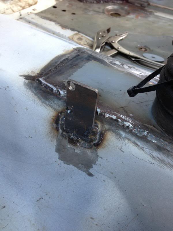

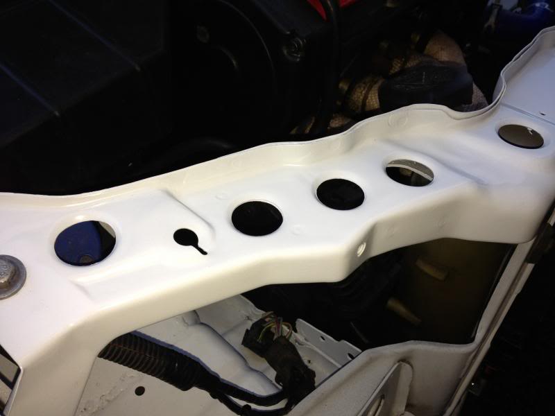

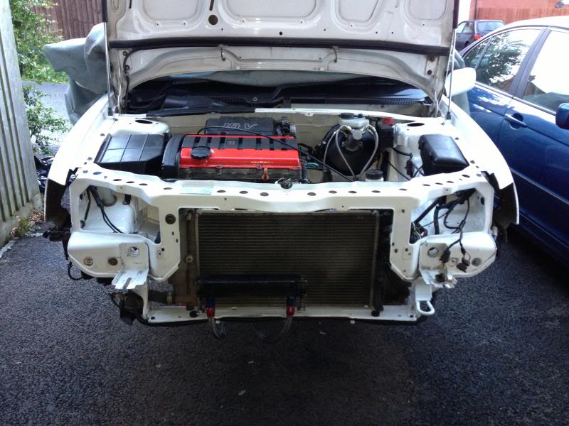

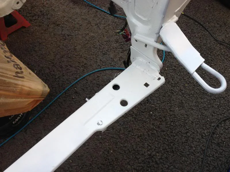

I also made the front radiator panel removable. some 3mm sheet metal was used for the end plates i shaped them up and had them welded to the panel, it will make taking the engine out in future much easier.

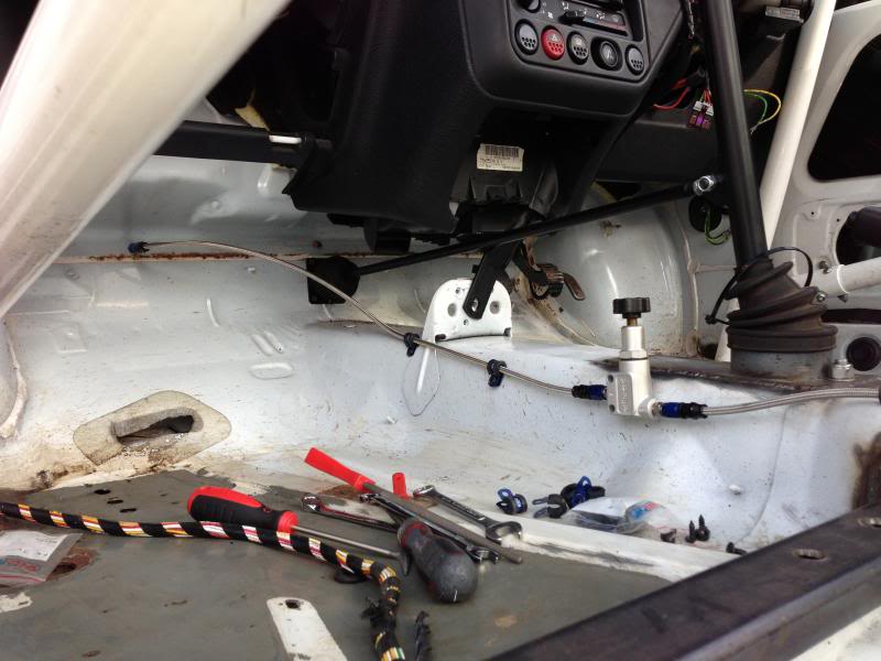

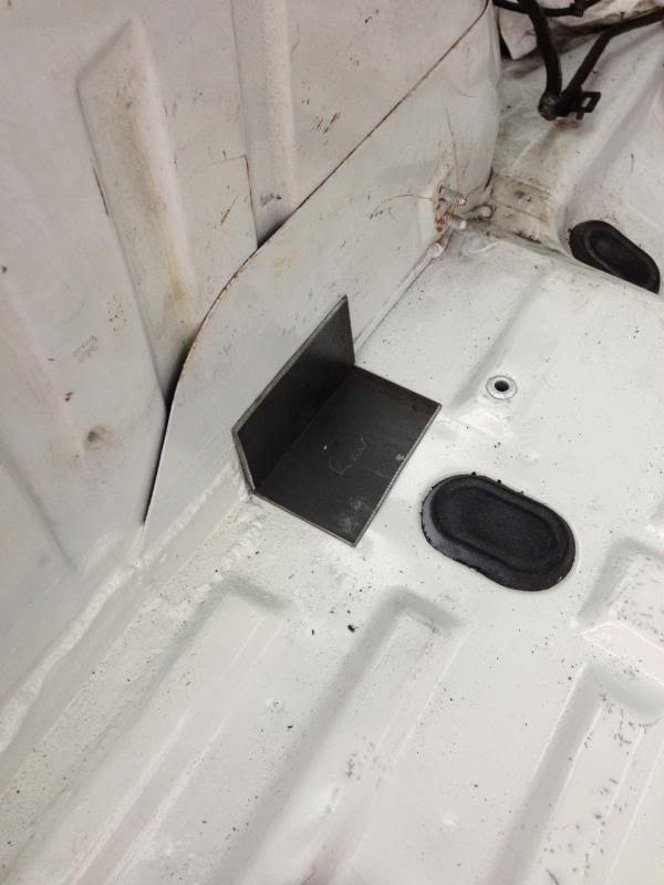

on the inside i had a tab made up for the brake bias valve
I had some bolts welded on for the battery cage.
And more bolts welded through the floor for the fuel system.

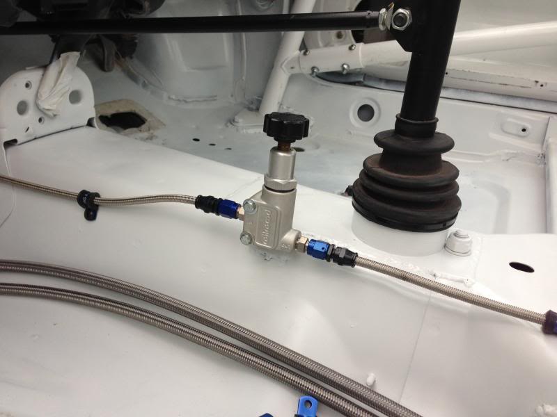

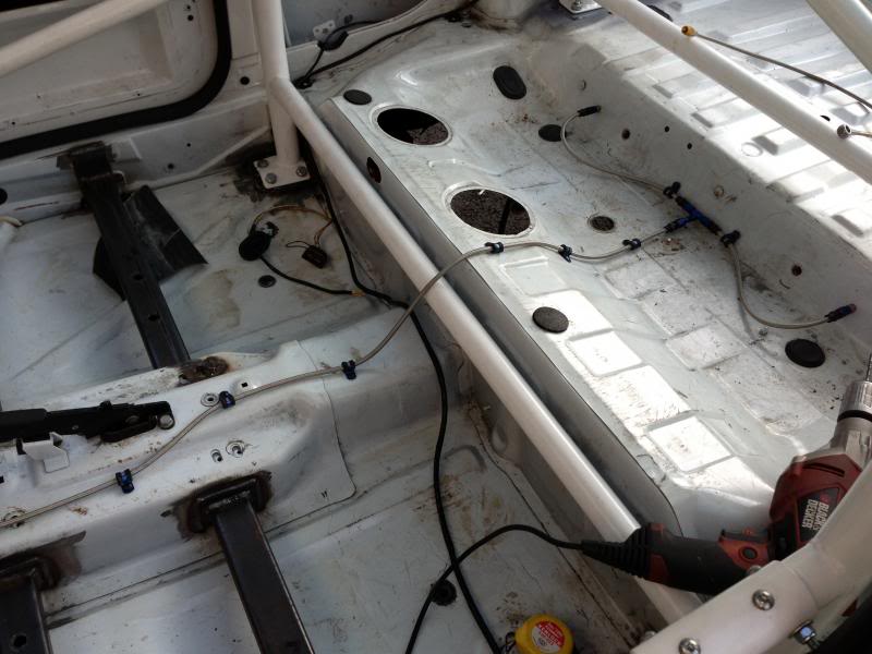

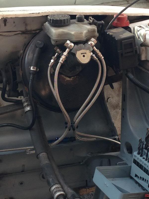

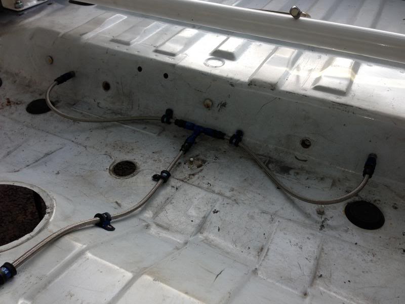

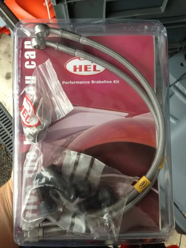

​previously i had dry fitted my brake lines.
i had made up two little bits for the fuel system and bonnet pull cable as im running the sytem through the bulkhead in its standard location i had to blank the hole. this will go through the bulkhead with a plate either side.

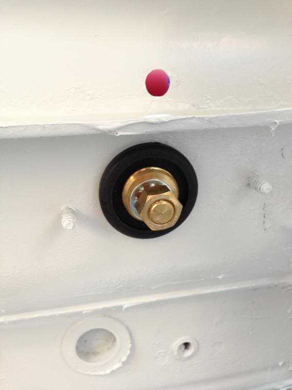

Also i had fitted the bulkhead fitting for the battery cable.
i decided to fit the seat rails before i paint it or else id mark the fresh paint.

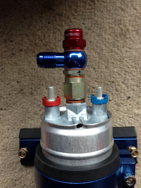

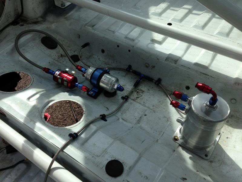

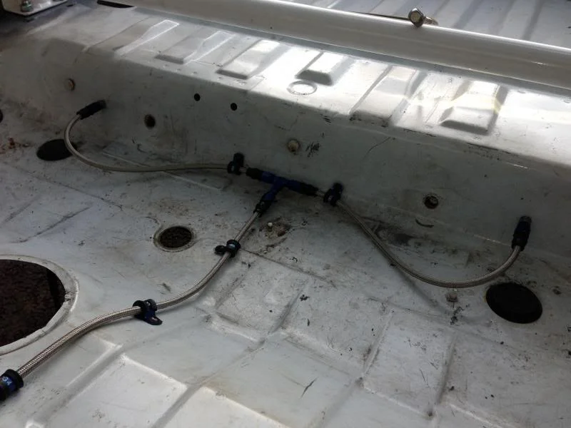

id also started to fit my fuel system along with my brake lines to get a idea of how it would go, i fitted the first line to see how the bend would go, i didnt like it and it turned out i had to buy a banjo for the fuel pump as id taken off a valve on the end that keeps the pressure in the system and aids starting.
the wasted fitting, money down the drain.
The new banjo fitting including the valve.

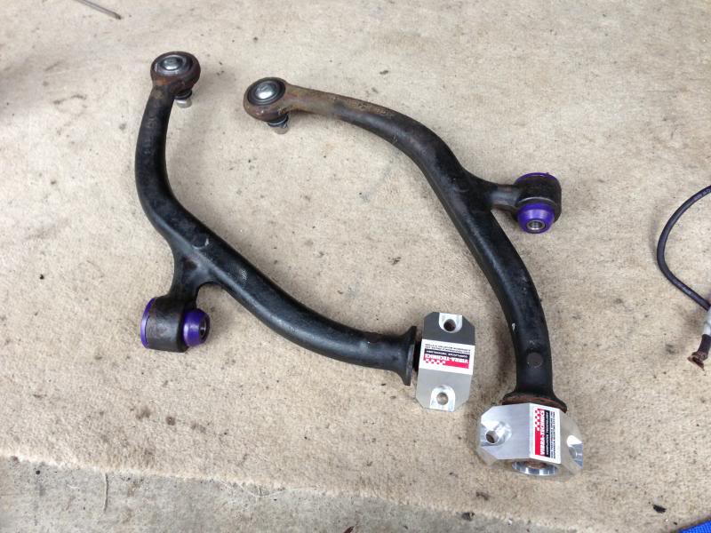

ive also built up my front suspension and started on the wishbones (ballache)

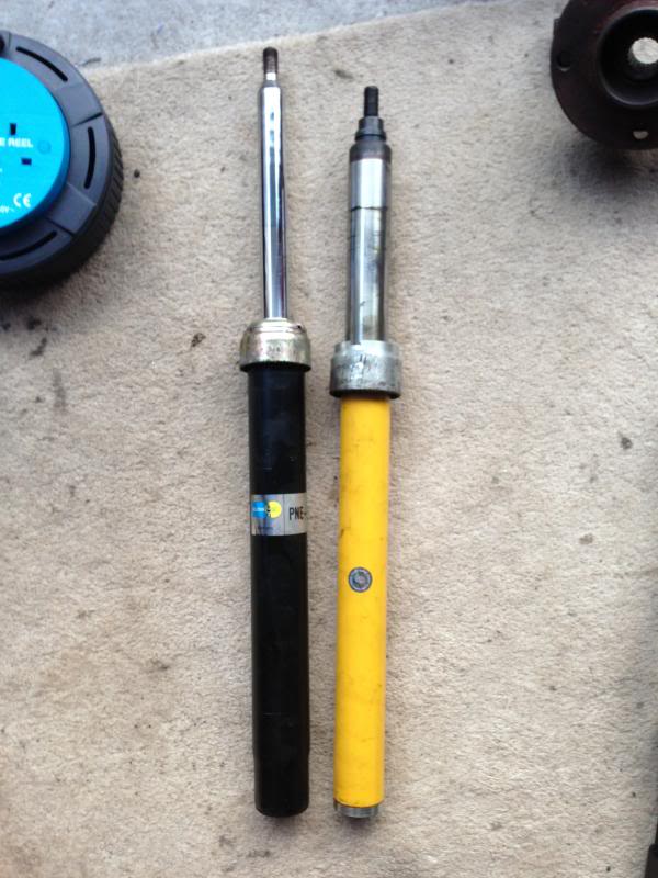

turns out the car had b4 front dampers here they are in comparison to the b8s that have gone on.

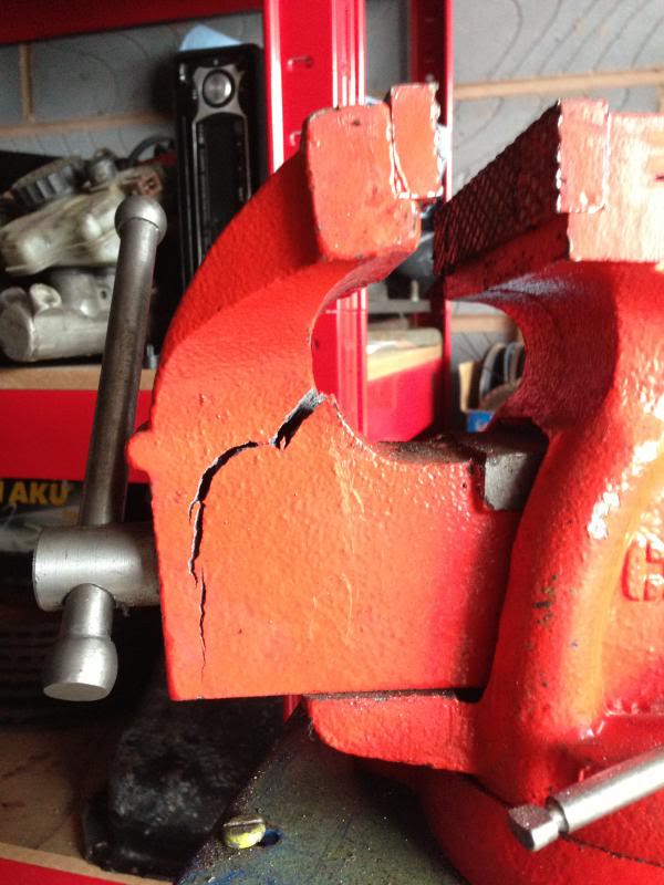

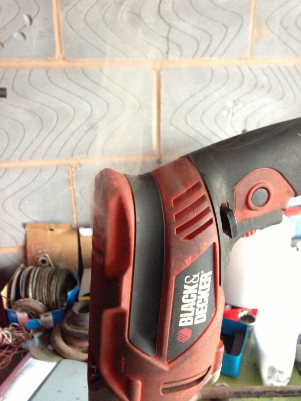

And with all this work ive destroyed my newish vice around 2 months old. and burnt out my drill. new one ordered and turned up today and it was 110v and not the 240v i need.

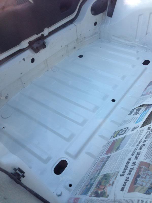

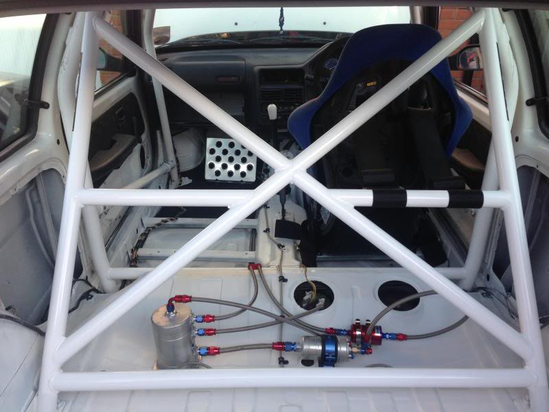

​Managed to get a few bits sorted before i leave for tenerife for a week. I started with under sealing the front arches.

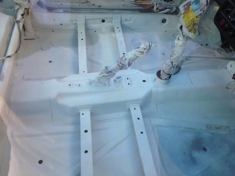

Then i started to prep the inside for a quick blast of paint.
a few quick coats. it isnt perfect but its still looking pretty good.

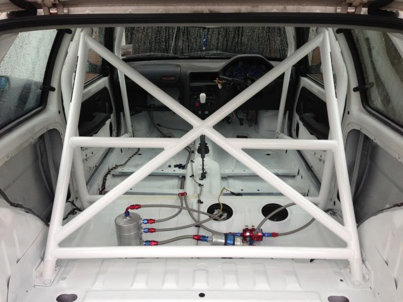

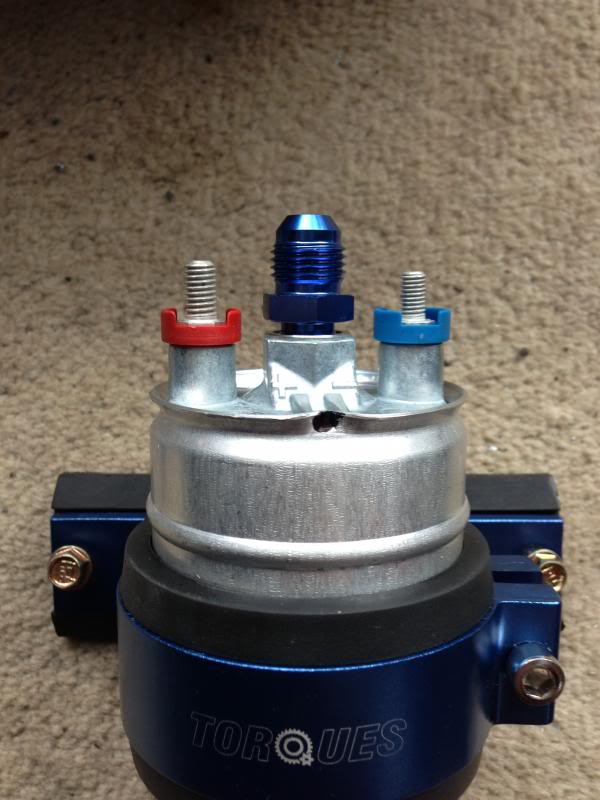

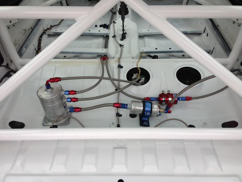

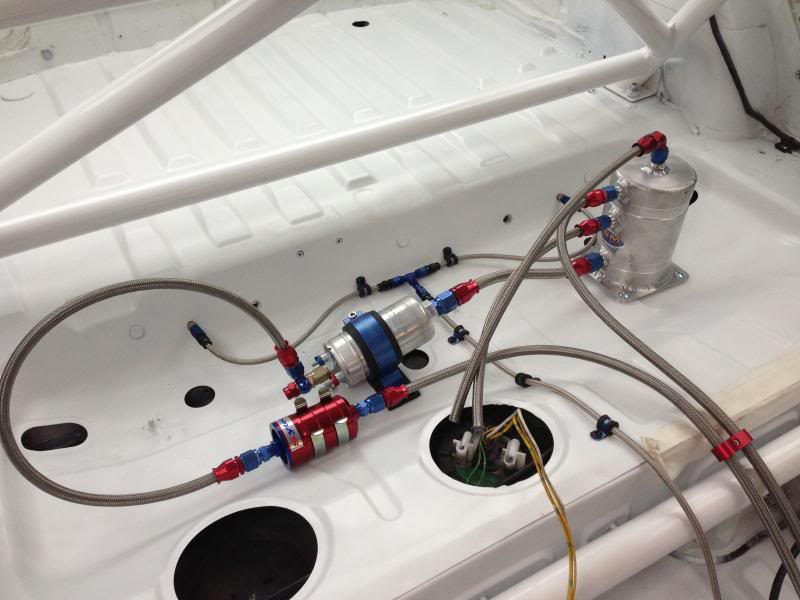

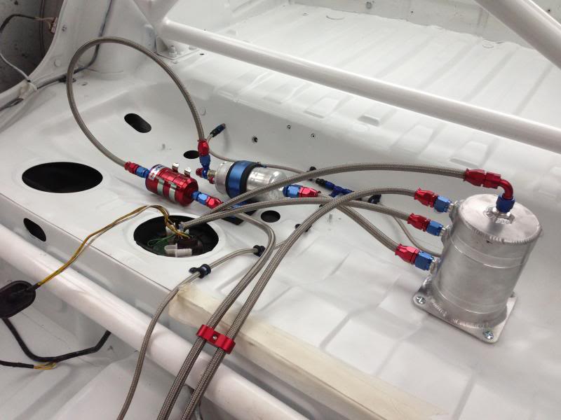

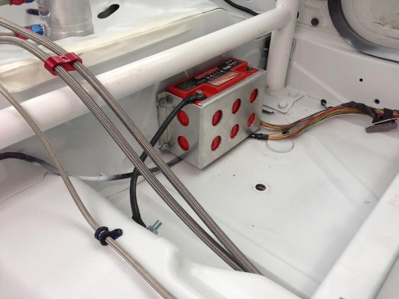

Then it was onto fitting bits. finished up with the brake lines in, swirl pot, filter and pump. ended up making all the fuel lines up the -6 fittings where effortless to make but the -8 from the pot to pump took 5 attempts.
its abit messy but nothings screwed down yet.
The battery's in and earthed

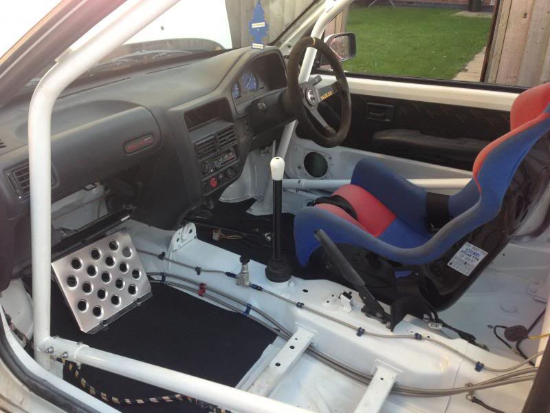

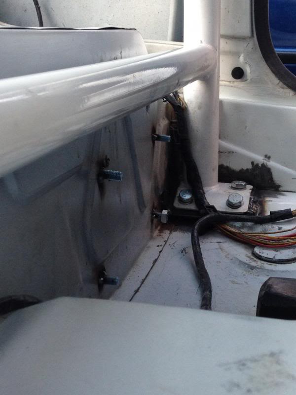

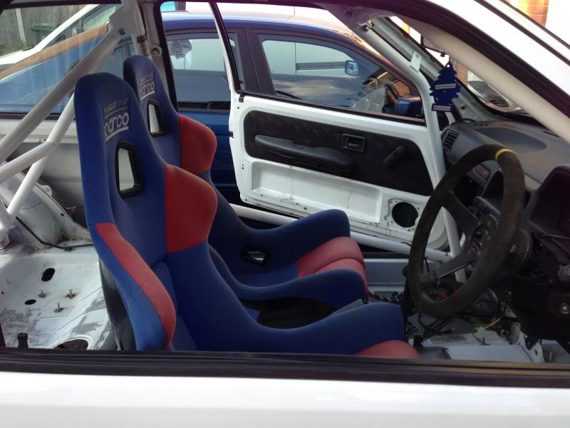

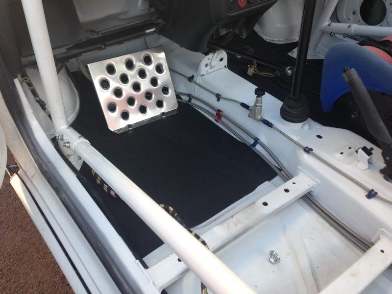

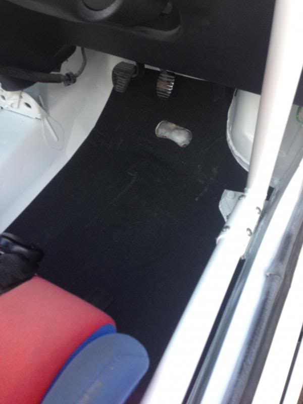

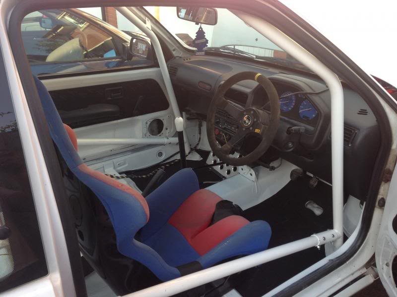

​a few updates of the progress ive made over the last few days. i got some grip tape and done both front footwells a proper ball ache to get a decent job done with this stuff.
i put the drivers seat in and fitted the harness, also shortened the hose from swirl pot to the pump.
i bought a footrest to protect the fuel lines brake lines and the battery cable.

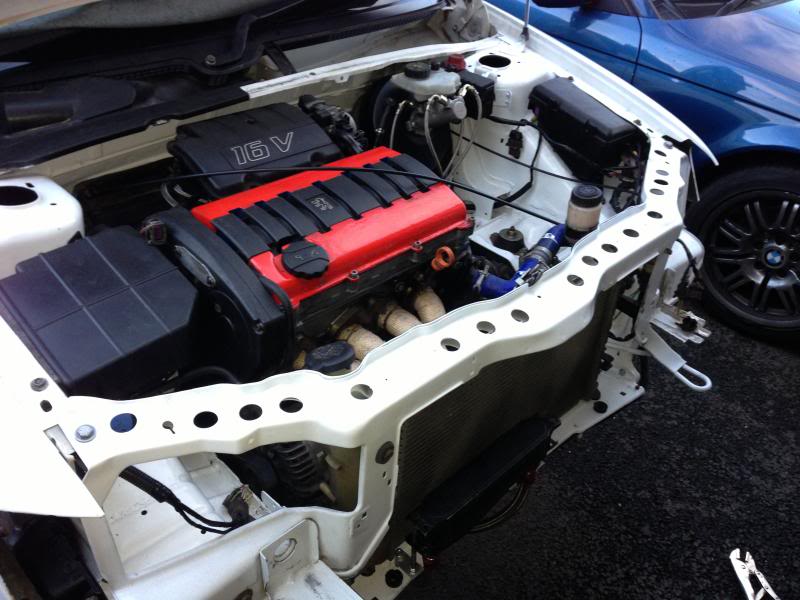

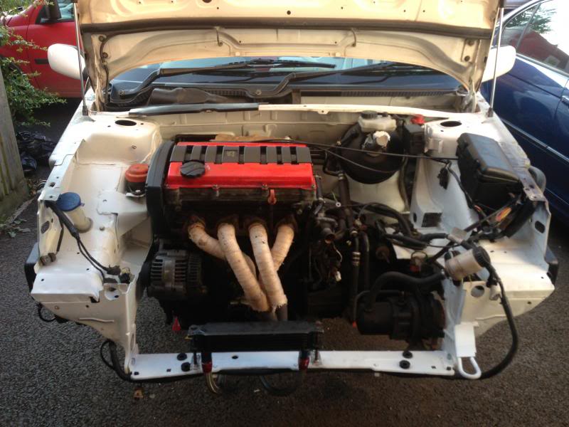

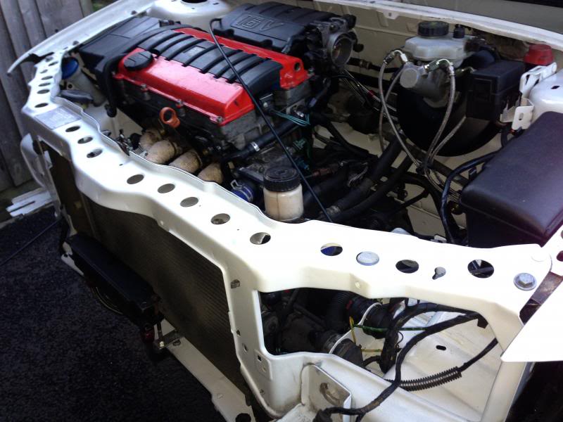

also got the engine back in and on its new mounts, also done about a million other little jobs that arnt worth mentioning but heres how the bays looking atm.

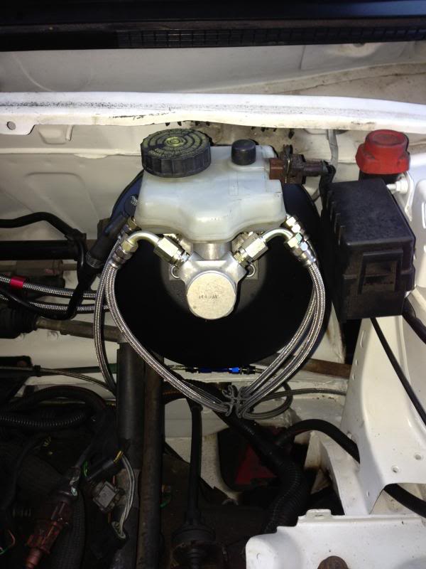

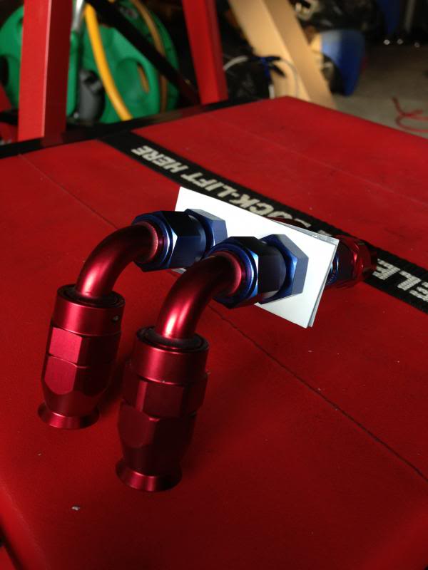

I had to replace the banjos from the brake lines for 90 degree fittings for the master cylinder a unfortunate expense. so i made the new lines up.

I made up my wishbones. thanks to rob at constella for letting me use his press.

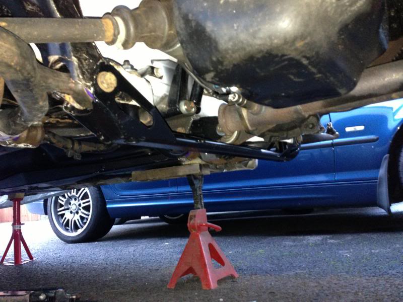

And got them fitted along with the satchell lower brace which was a ball ache due to nothing wanting to line up. and the ARB with polybushes

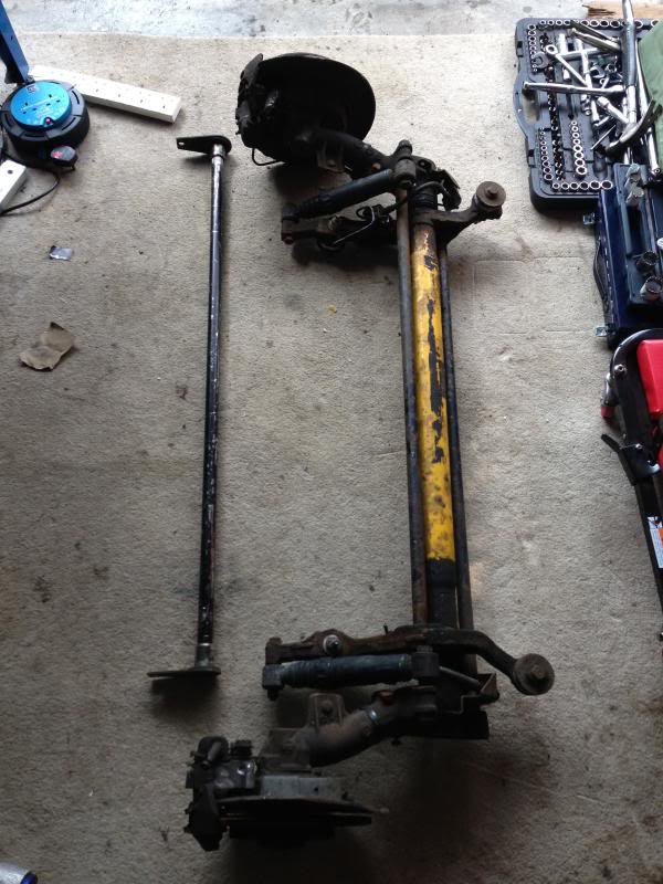

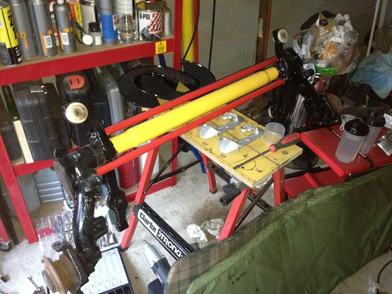

I bought a reconditioned rear axle with a 25mm anti roll bar and 23mm torsion bars and solid baker bm mounts it had new bearings etc but wasnt very clean. so i gave it a spruce up. along with the disk covers. tried to refurb the calipers (i have 4 now) and all 4 caipers bleed screws have snapped. all solid easy outs dont work so look like ill need some more.
