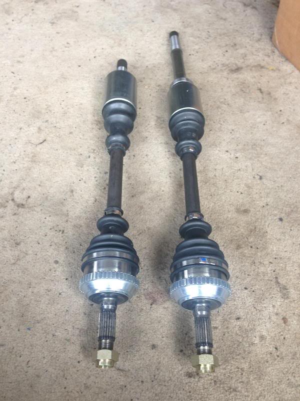

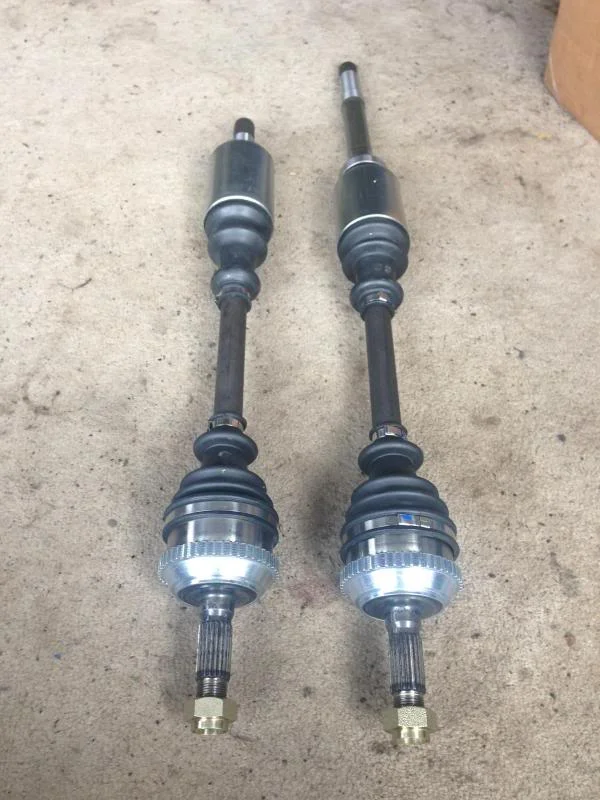

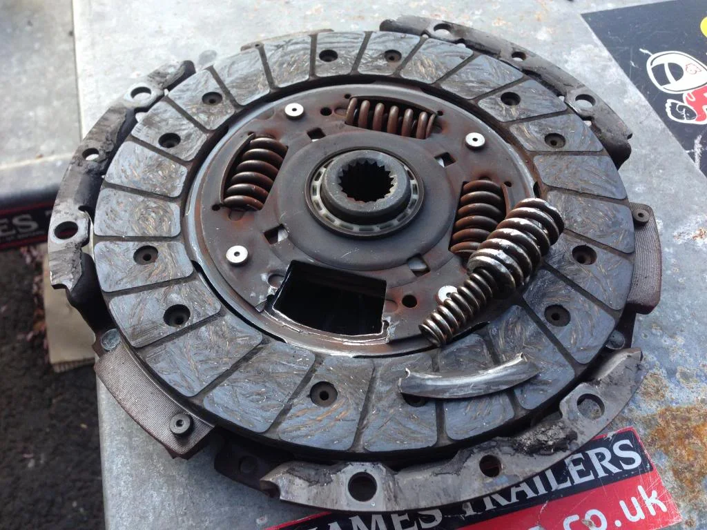

Well some recent updates after the drive shaft issue at donington i ordered some gripper shafts.
they feel like decent quality items

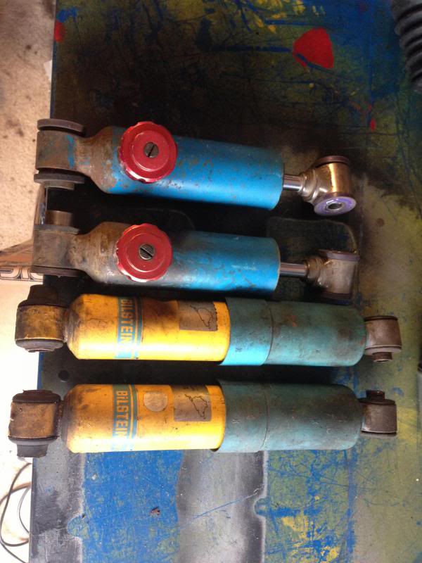

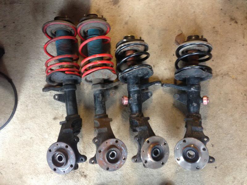

id been eyeing up some ledas for a while and finally went through with buying them. hopefully these should help improve the car on track.
bilsteins and ledas

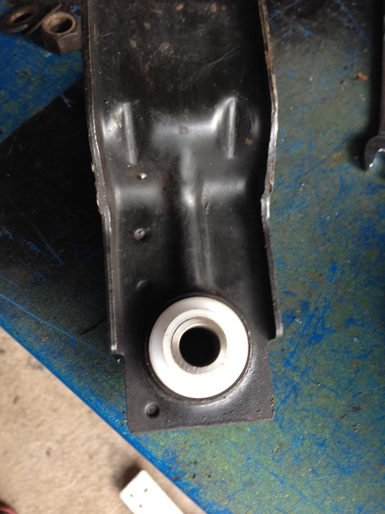

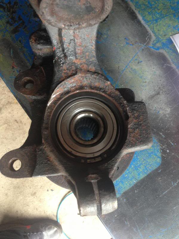

One of the bearings didnt look to good so had it replaced.

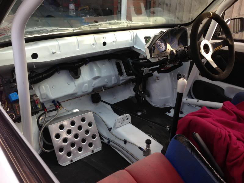

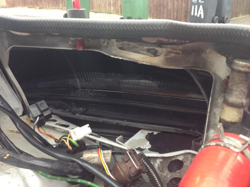

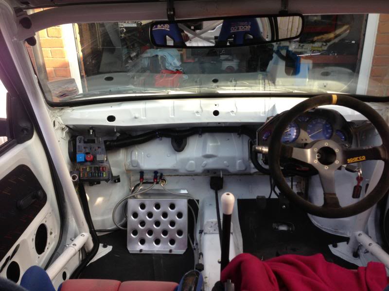

I decided more weight needed to go so out came the dash heater matrix and lots of loom.

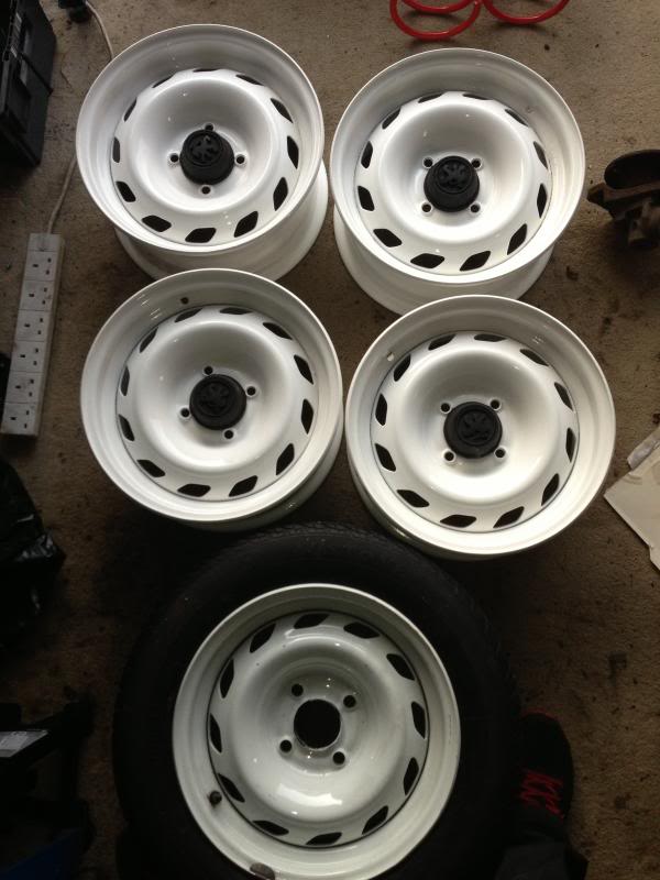

i picked up some s2 steels with fresh powder coat caps and bolts for a bargain 80 quid i may stick some tyres on and use them for road use and sell the turinis or wait till the a048s are dead and use them as the track wheel. unsure atm tho.
a couple of the car now. seems the ledas have added camber.

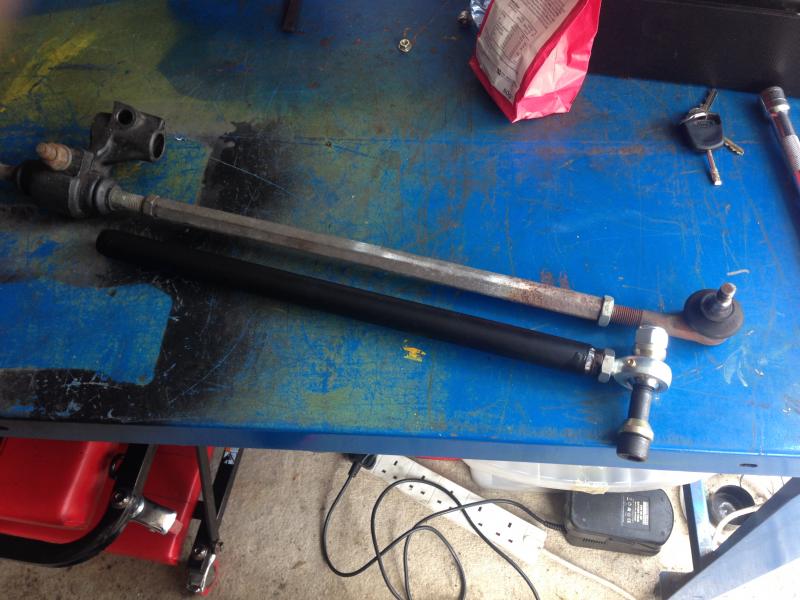

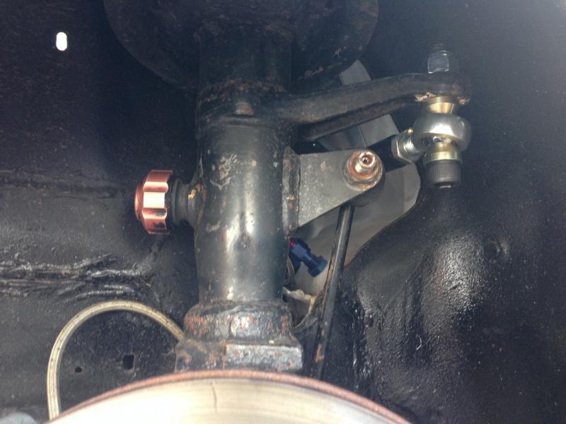

to fit the ledas the track rod ends needed to be swapped from either side. i guessed the tracking and it turned out for the second time in my life i got it spot on and no adjustments where needed.

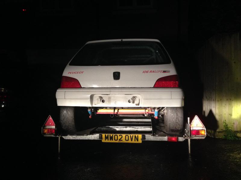

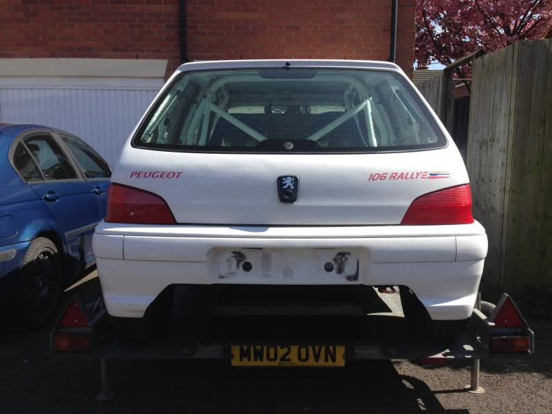

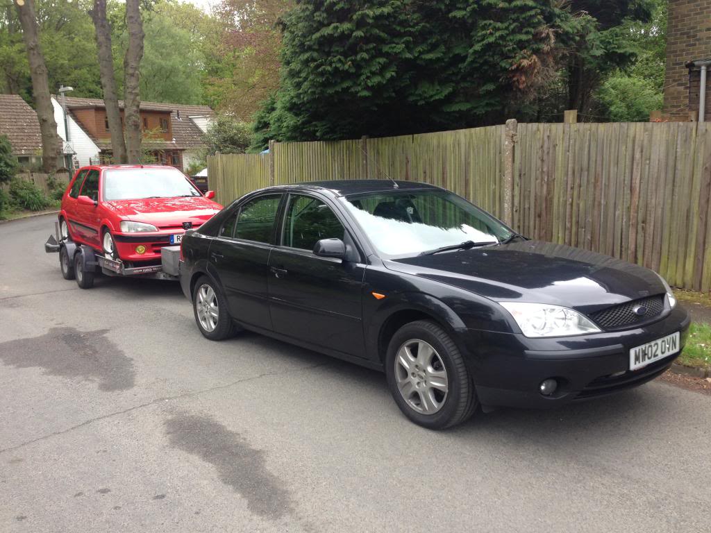

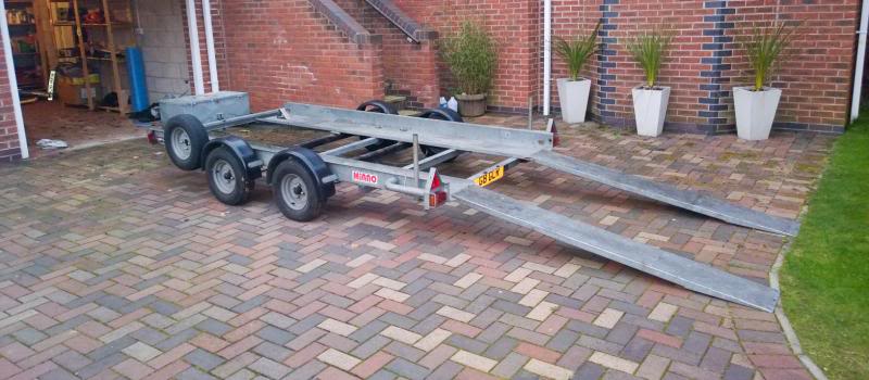

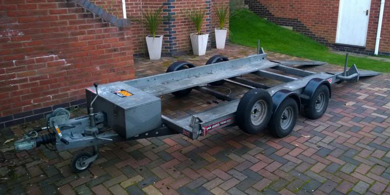

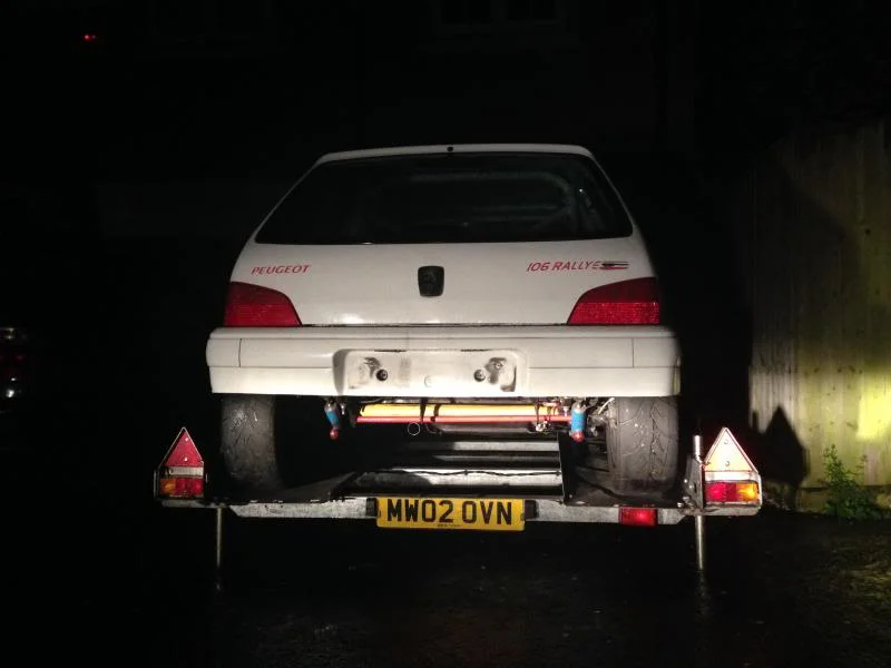

I knew at some point i was going to have to buy a trailer i couldn't do this every time i had a track day. luckily i found a bargain trailer and went to stick a deposit on it before anyone else could snatch it away.
luckily i have just about enough room to keep it at home.

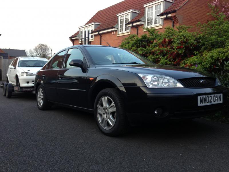

I needed a tow car so i had to sell the clio, gutted i loved that car. found a mondeo in ghia spec years mot 2 owners and 91k for £980 bargain! but boring.

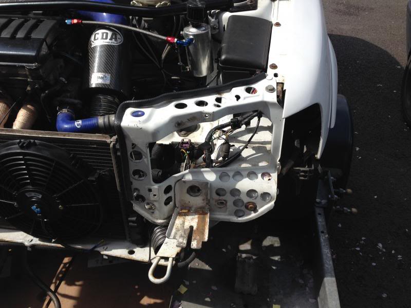

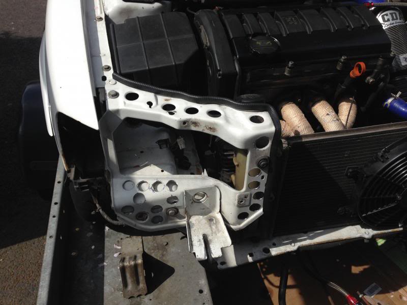

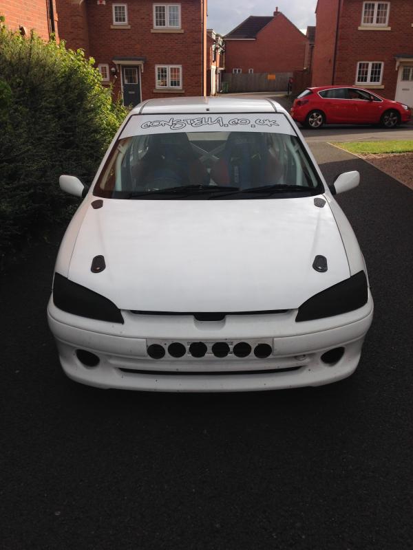

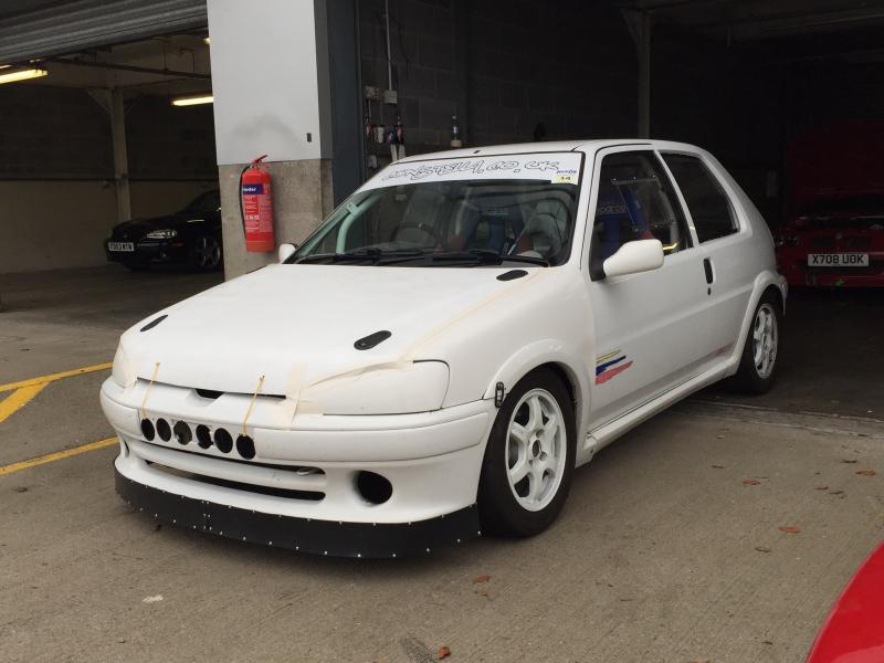

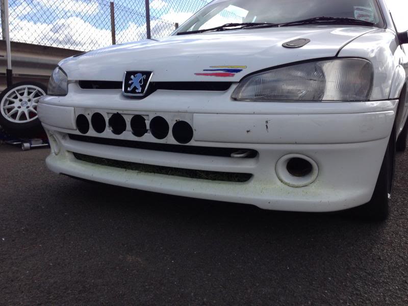

one was a bumper chop, id seen it done before and thought why the hell not. i gave the bumper a trim and it didnt seem to bad.
Then i thought lets try it a little more extreme, might look a little daft but the idea is to reduce drag, i know ill never create any real down force with a diffuser but i may give it a go making one to improve the look.

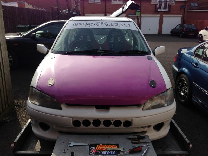

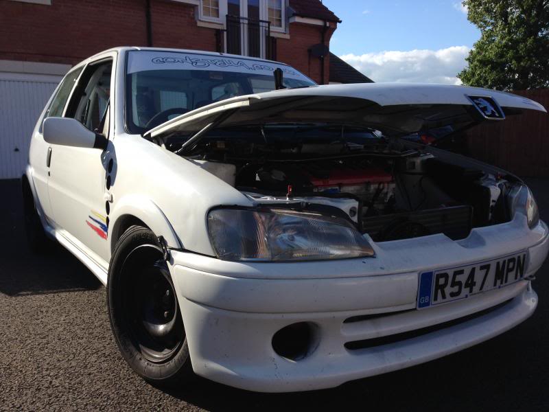

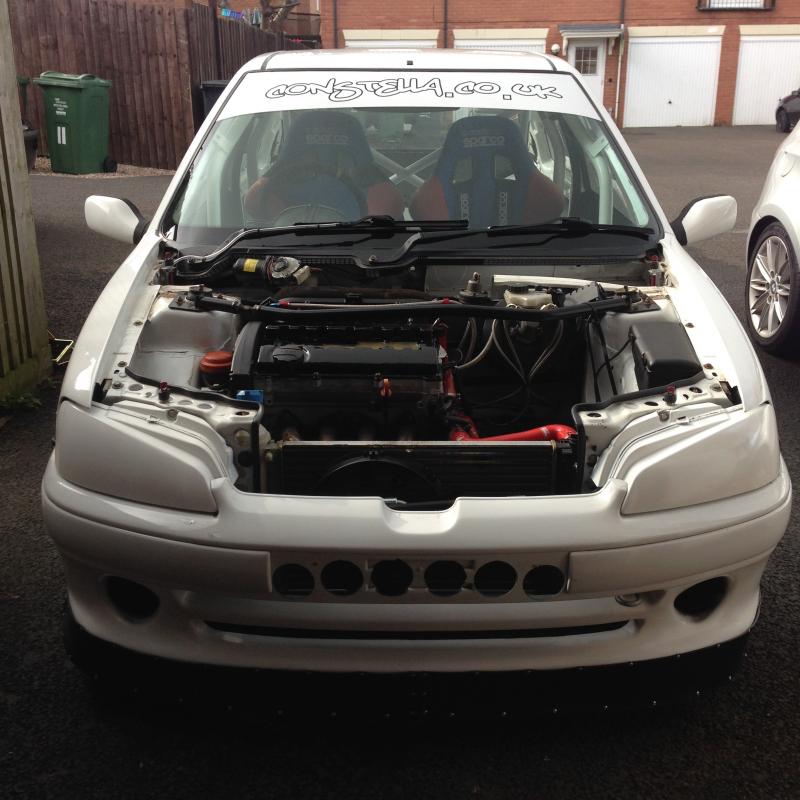

Now the front end previously looked like this,

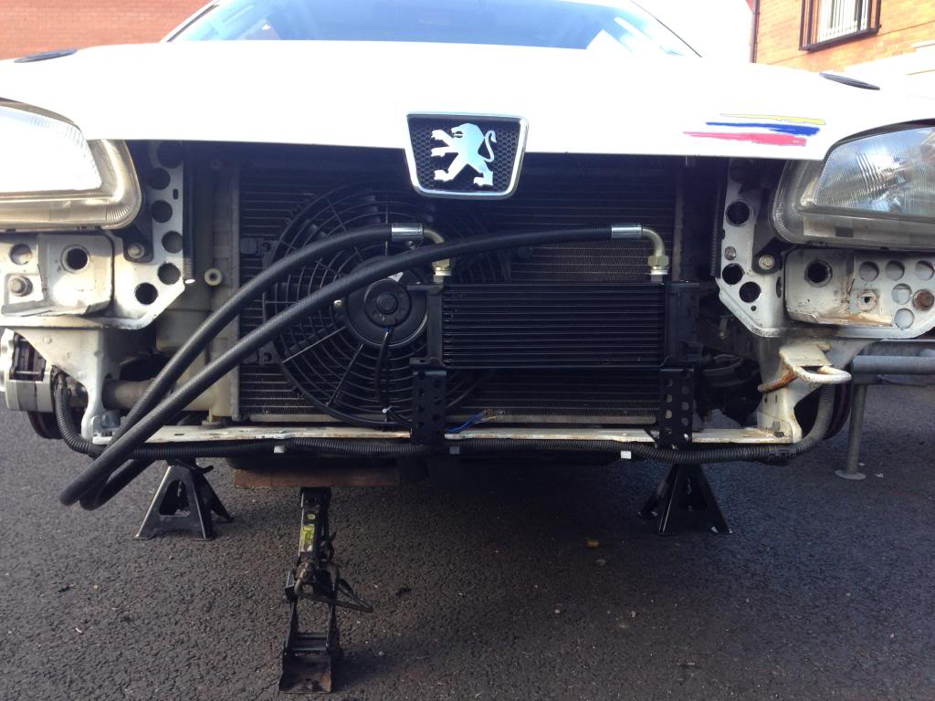

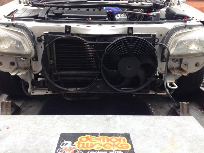

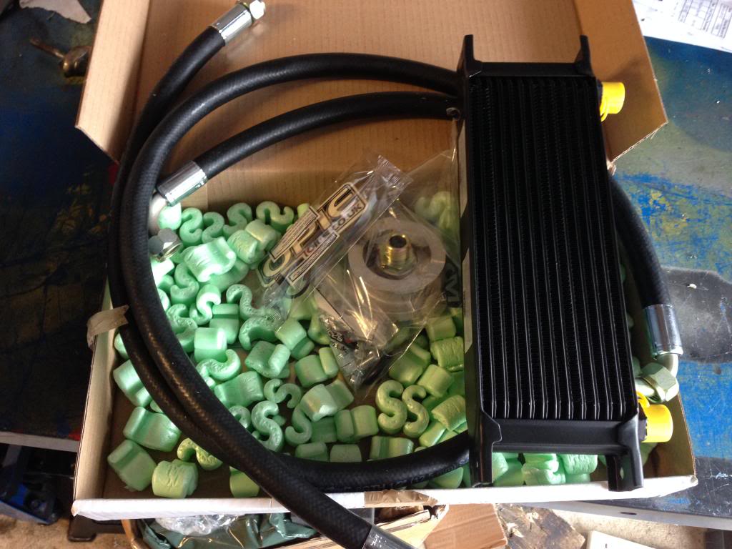

The smaller oil cooler had been fine but id started to get a leak from a fitting (probably just needed tightening up) so i replaced it with a new cooler, 13 row this time.
Coupled with a slimline fan hopefully for better cooling and also its lighter

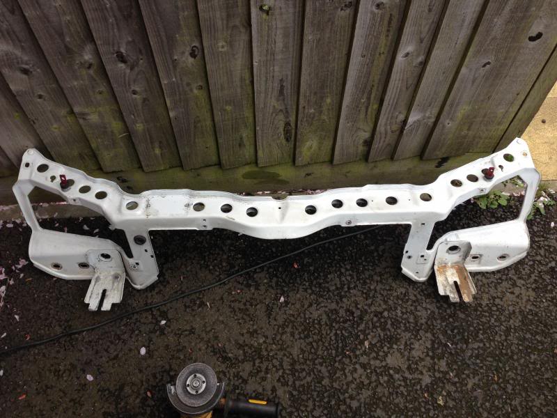

Whilst i was at it i gave the slam panel more of a trim, if you cant tell im now on a mission to same as much weight as possible.
Before
After

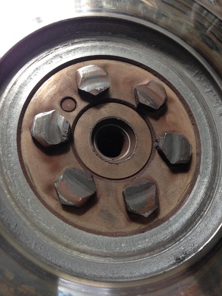

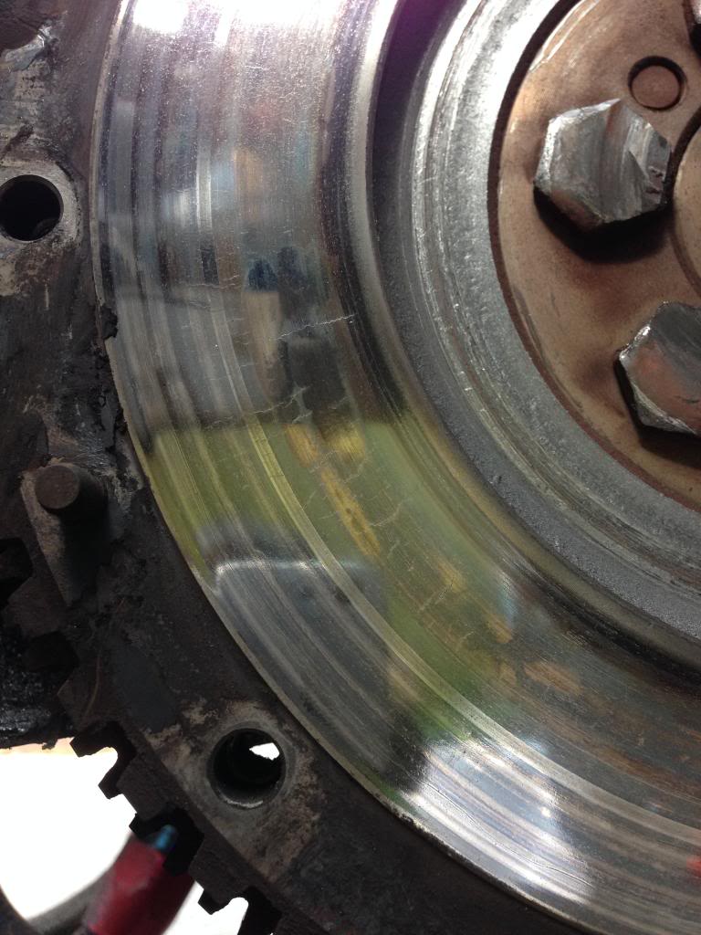

The flywheel didnt look the best so whipped it off nipped to Constella and Rob advised a skim and whilst i was there asked about a little lightening and balancing.
Looks like the flywheel bolts took a battering
I should have the flywheel back next week and ill probably have it built back up over the weekend.

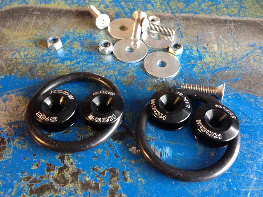

Made a few little purchases also. some bumper mounts to save undoing the two 10mm bolts so itll be a 2 second job to remove the bumper.

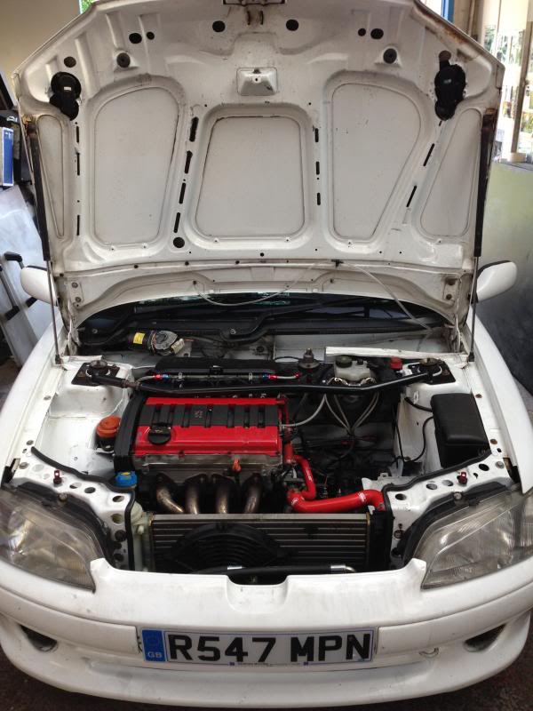

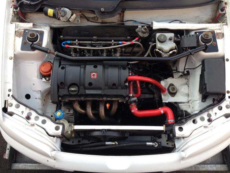

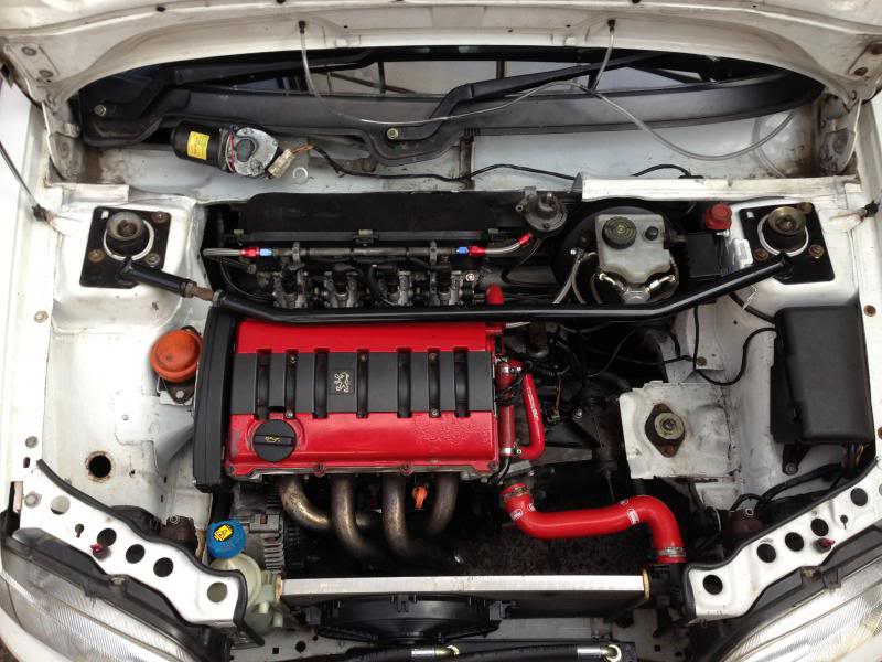

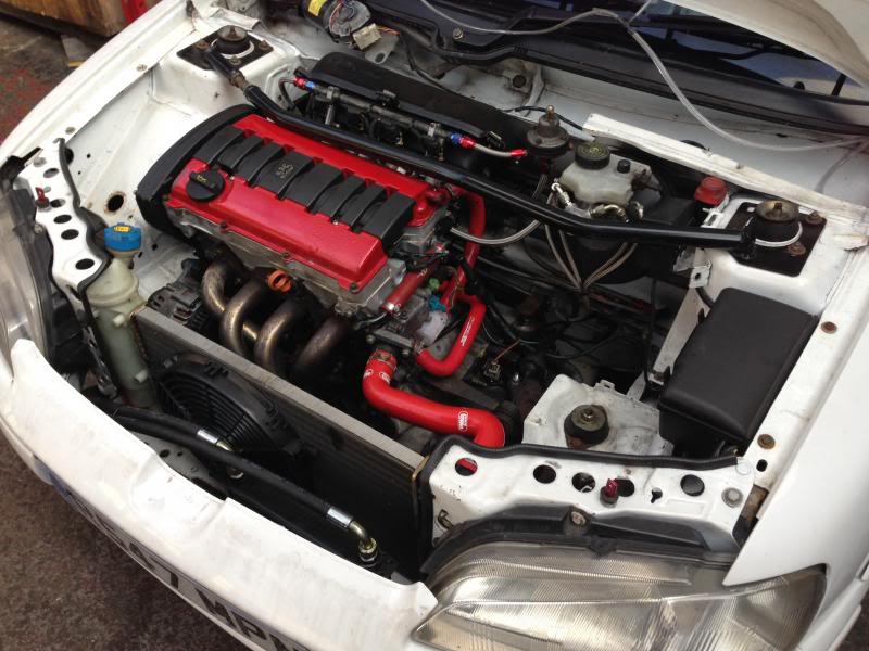

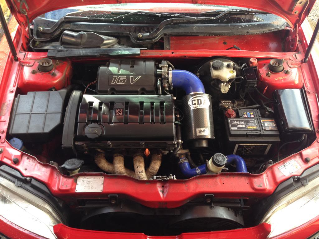

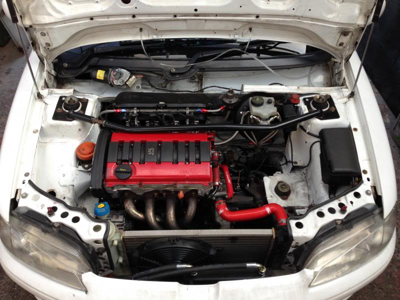

Bit of a update, a car i had previously had my eye on for the engine came up for sale again and this time i had to have it. i only wanted the engine, it isnt too special but spot on for what i need.
The engine had previously been sorted with a new head gasket, individual jenveys, jenvey filter, injectors, 708s and a emerald ecu. good for 160bhp and some rather nice noises.
On the Sunday i collected the car, had a rather scary moment on the m25 where a ramp decided to leave the trailer and skid along the inside lane at 60mph. thankfully no one hurt and easily retrieved. thinking what could of happened was very scary.
Id arrived home at 4pm and by 9 the engine was out and the old one out the rallye was put in, sunday morning came and the car was pieced back together.
a few pics taken and up for sale Sunday night. by Tuesday it had sold for £1600 meaning the engine and a few other goodies had cost me £800 all in. bargain!

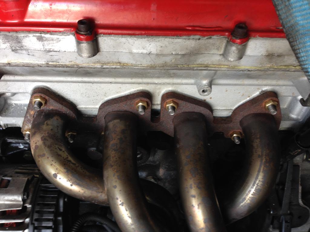

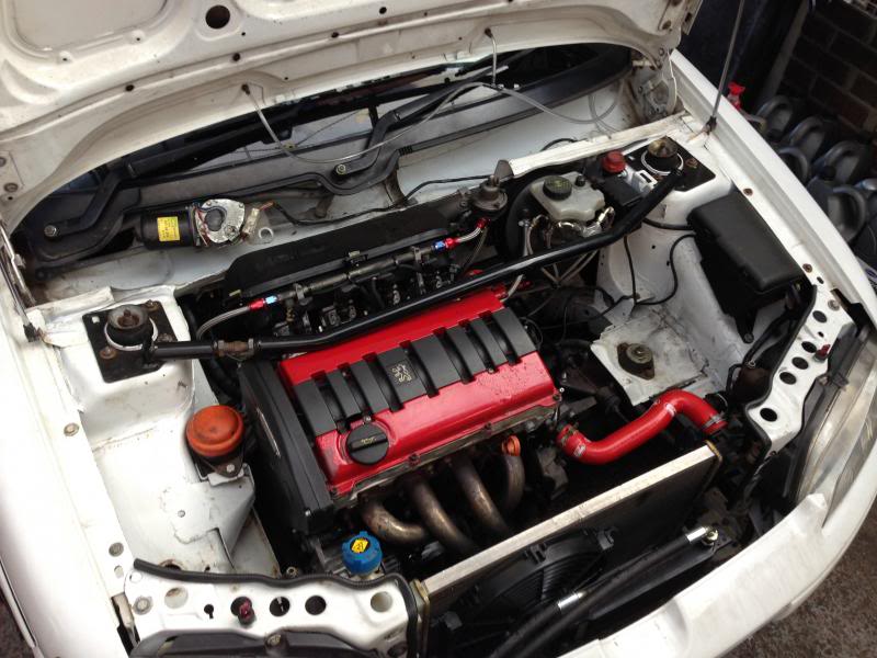

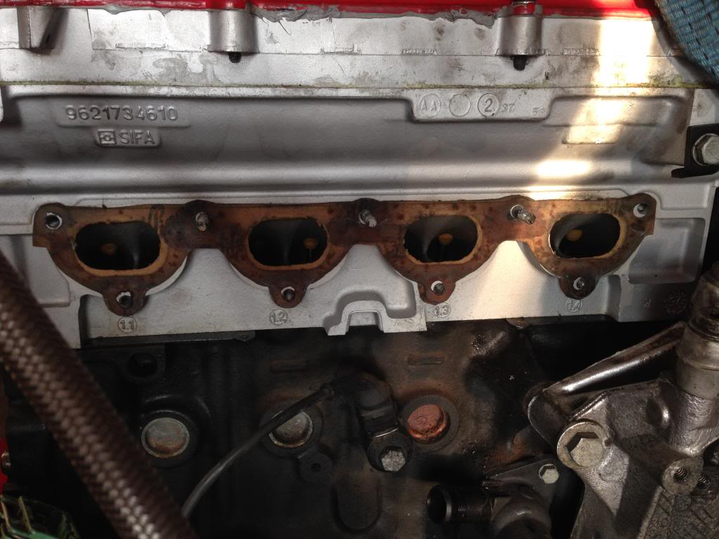

Onto the Rallye, the car was ready for the engine to be dropped in but firstly i wanted to check a few things over.

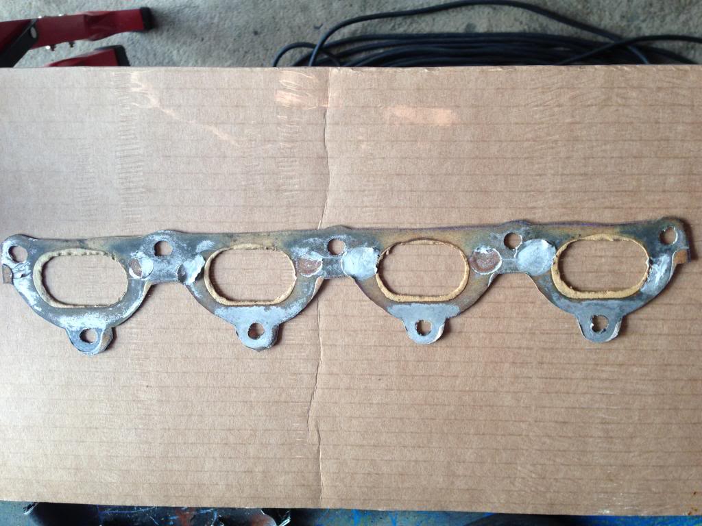

first thing i noticed was the incredibly poor inlet manifold gasket. shocking!
I replaced it, i wonder how much power that would of sapped?

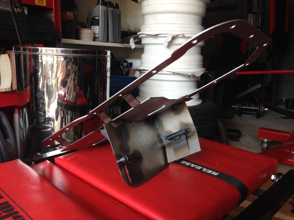

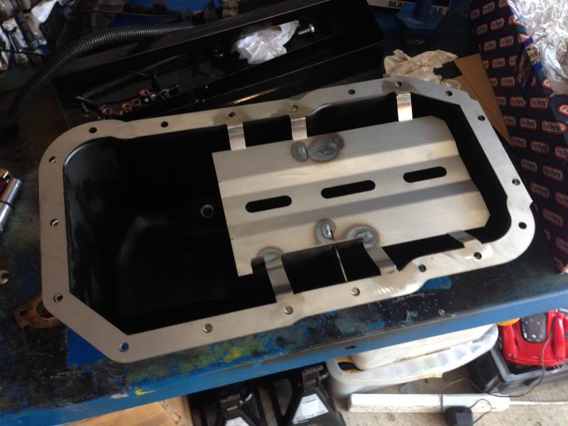

Next i got Rob at Constella to knock me up a sump baffle kit, i thought as it was easy to get to now with the manifold off and engine on a crane i might as well of.
The manifold stud's and nuts where all replaced. the only ones where a bit rusty.

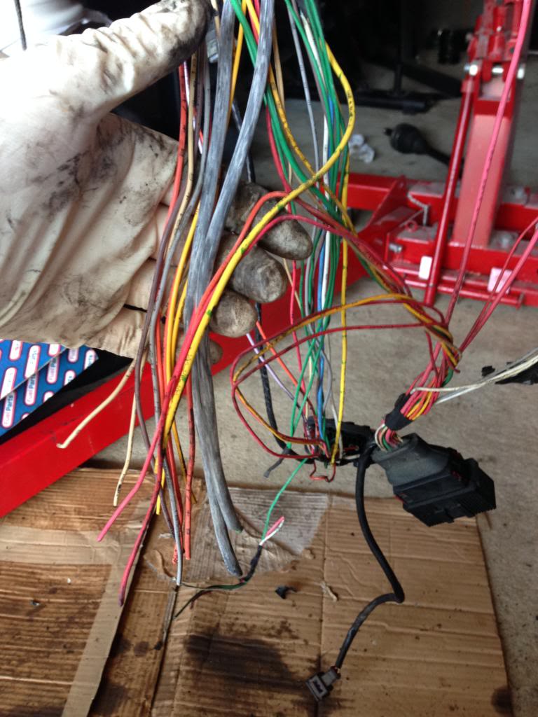

Next i decided the loom needed looking at, when the conversion was done they just snipped the wires they didn't need, it was a little untidy so i stripped the loom right back.
i found 3 lambda sensors, two in the manifold not plugged in and one tapped up and plugged into the loom. weird.
just some of the unused wires.

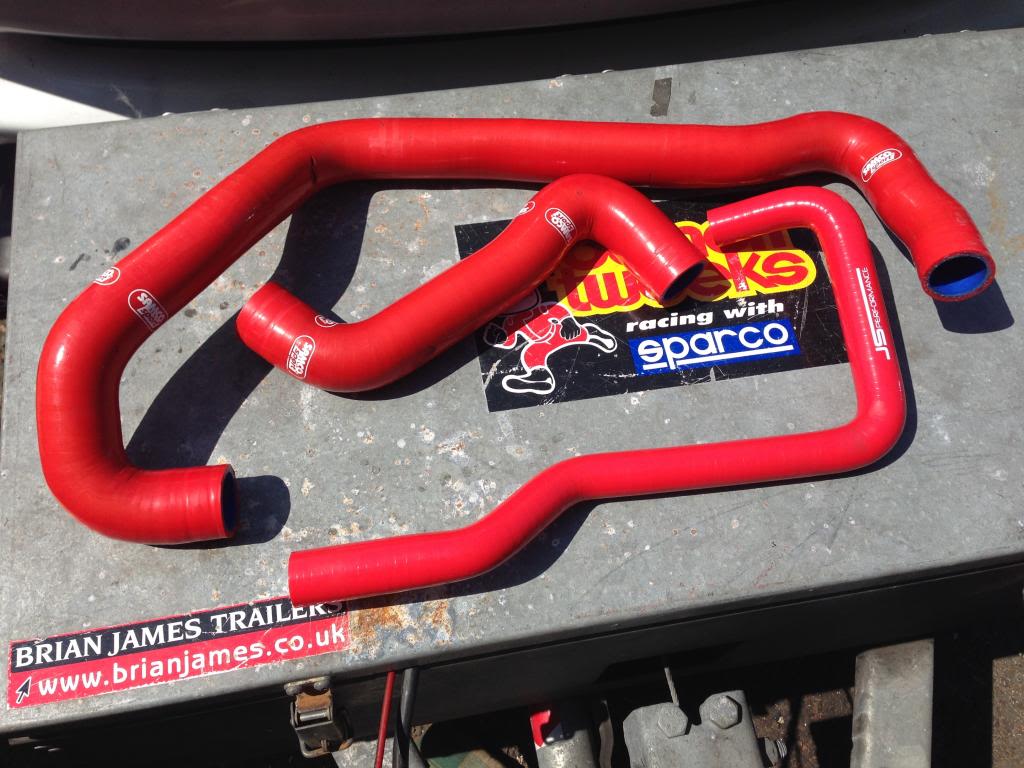

I managed to keep hold of the newer radiator from the gti and its silicone hoses. much nicer than the old tattered ones i previously had. i also bought a heater matrix bypass hose off ebay, again much better than the home made jobby i previously had.
By the end of today i had the loom loosely connected just to check it would fire up with all the wires id removed. i want to mount it in the car so will look at what to do with that.

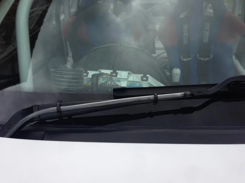

i managed to sort the loom after two attempts, i was running it a different route to how it was previously built so took some time.
ive mounted the ecu inside the car for a couple reasons, to avoid damage that may occur in the engine bay and to neated the bay up. i do like the ecu and fuseboxless engine bays.
there is a few things id like to do in the future. a custom loom, no doubt theres alot of things that can be removed and neatened up.

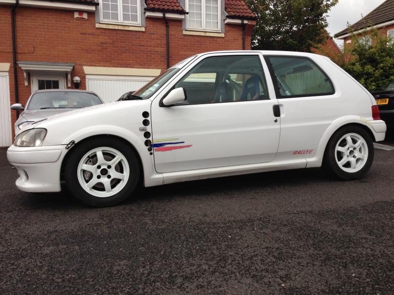

some pics
and a couple of poor ones of the car.

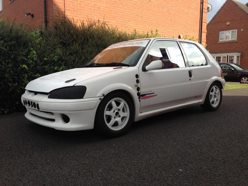

A few little updates..

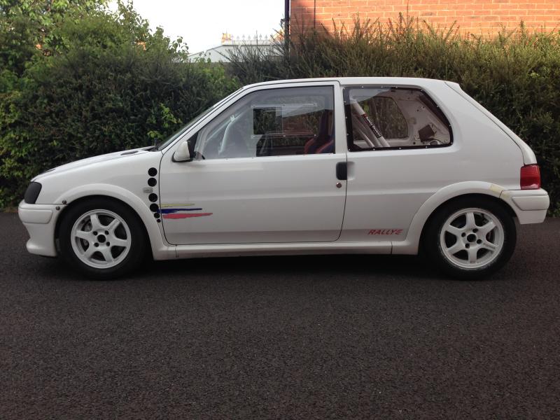

I found some new wheels up for sale locally with a048s so went and picked them up so i had a couple sets of wheels. look a little better imo. im still undecided if ill stay with 14s cheap used 13s and 15s are very tempting.
And sadly the cars tax was up so i took it for its last drive before it became sorn.
the cars just fantastic with the bodies and diff.
(steels on the rear because they had more tread)

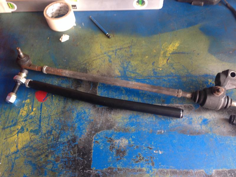

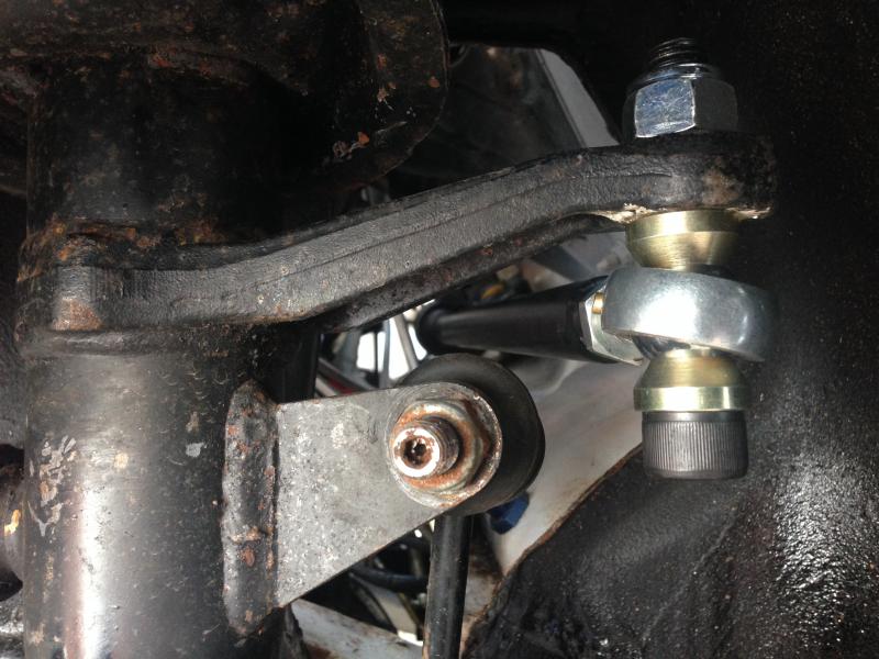

ive had some of tommys steering arms for about a month and finally got around to fitting them.

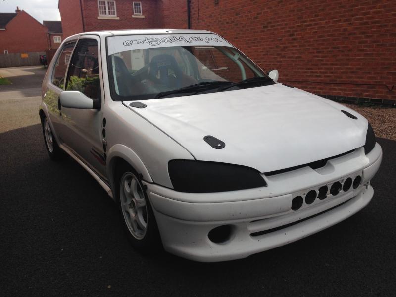

Last weekend i got bored and decided to get handy with a grinder.
this left it a little flexible and still to heavy so a drunken ebay session left me with a single skin fiberglass bonnet from spoox ordered. much lighter but still a little flixible.

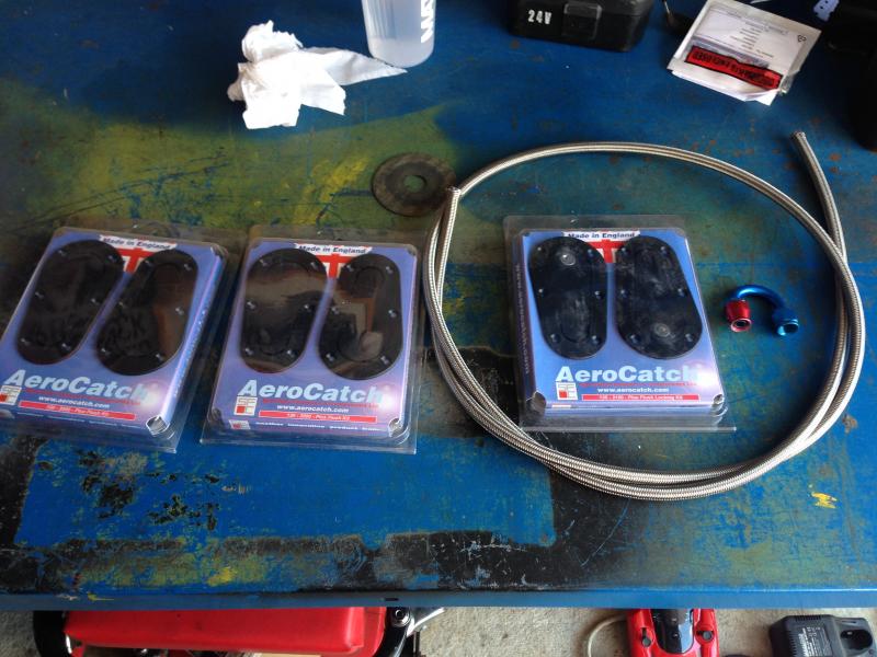

i also picked up a 180 degree fuel line fitting and some new teflon braided hose to replace whats currently on the car. (bulkhead to fuel rail)
and more aero catches for the fiberglass boot i also ordered these along with polcarbs that are currently being made for me should see the car a few kg lighter.

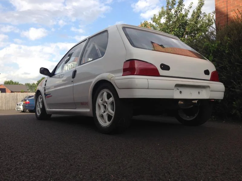

Back with another update, a few days of fitting new bits and painting bits has left the car looking pretty good imo.

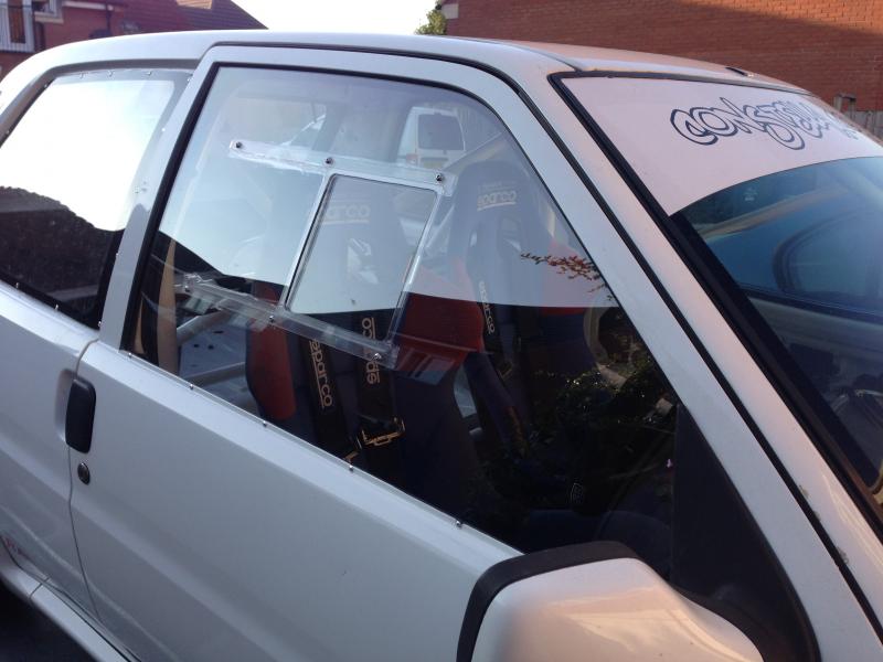

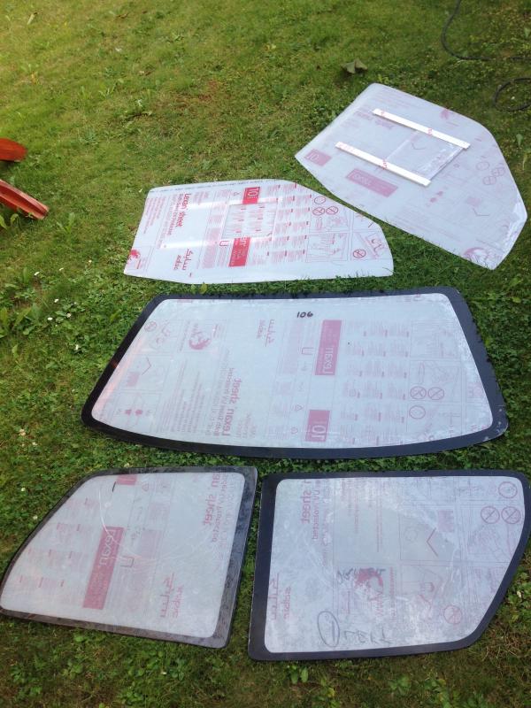

I had my polycarb window kit turn up from templar motorsport. Its a decent kit and pretty cool having the black border, certainly makes fitting it neater.
Id fitted the new fuel line and 180 degree fitting, its much better than previous.

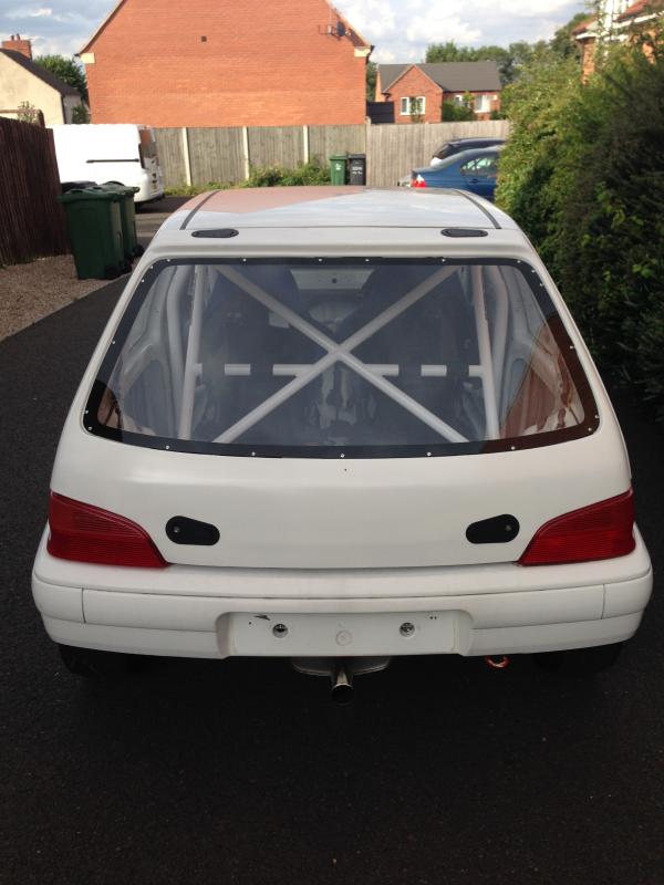

I got the boot through the post, it wasnt the best quality but thats not a problem. All that matters is its nice and light. 5kg if i remember correctly.

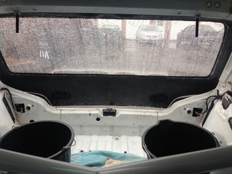

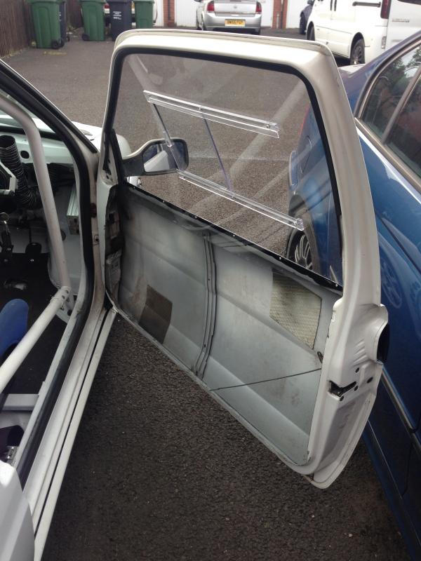

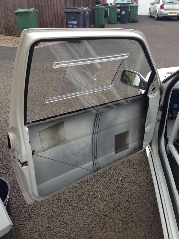

i fitted the polycarb window and the aero catches and made some tabs up.
The panel gaps where interesting lol

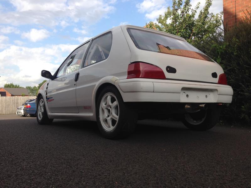

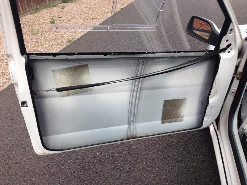

I got the front windows in and gutted the doors, saved a nice bit of weight here.
I just need to make some kind of door latch.

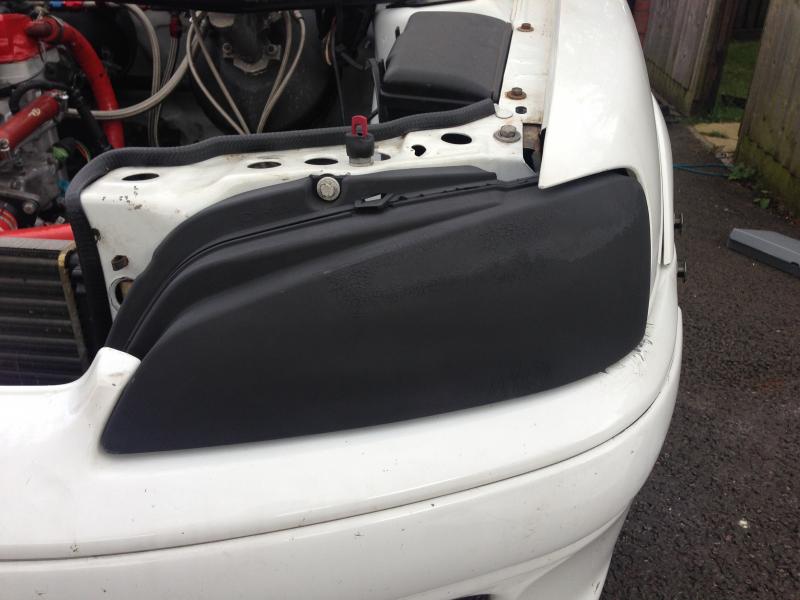

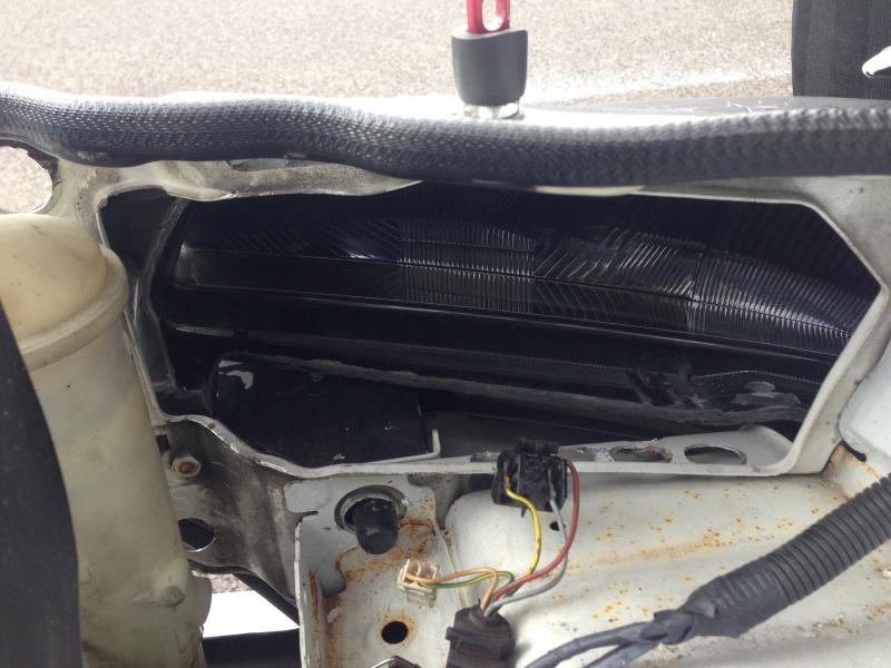

Next i gutted the front lights so basically its just the lense and a black trim that bolts up to the body. i gave them a lick of paint and its reacted leaving the finish poor. Im unsure if ill keep them black i may go white.

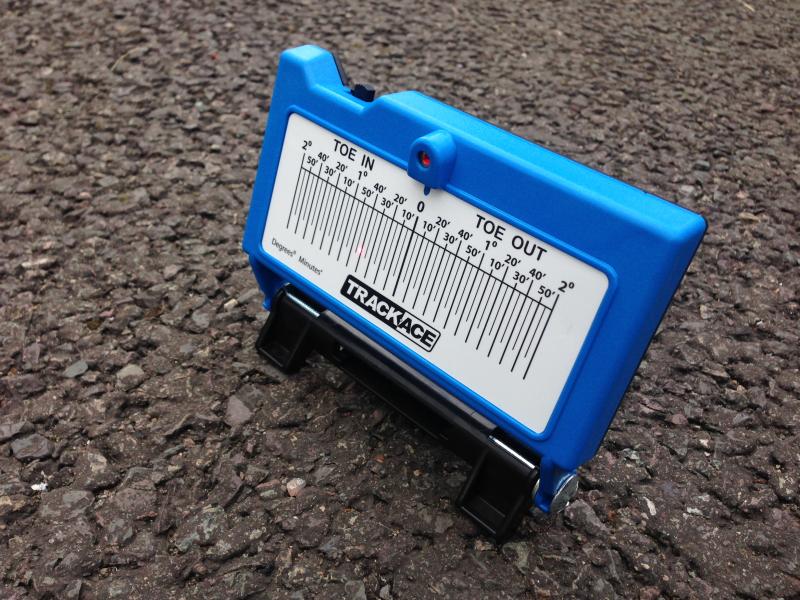

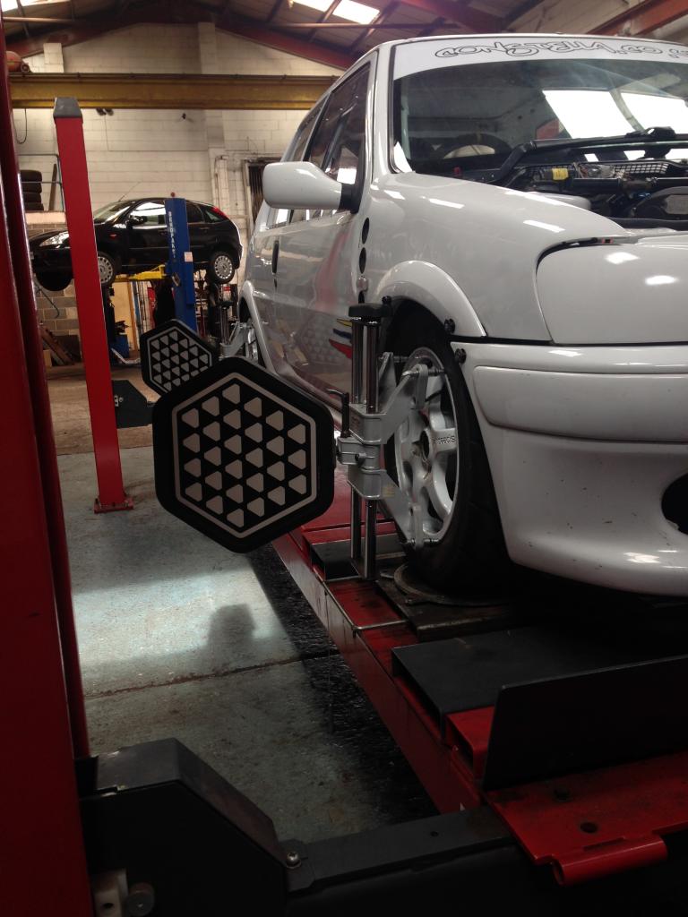

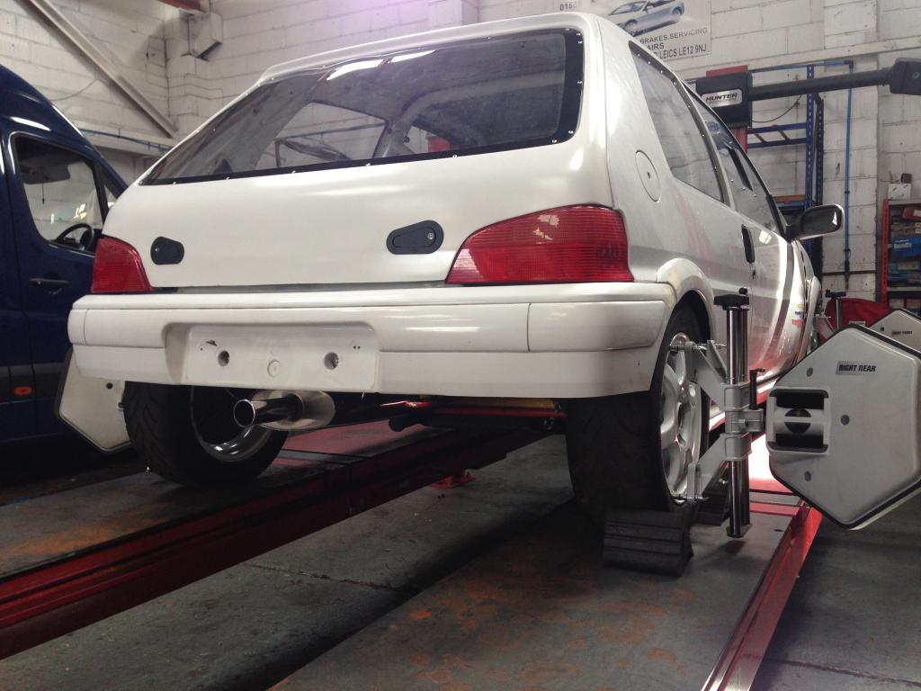

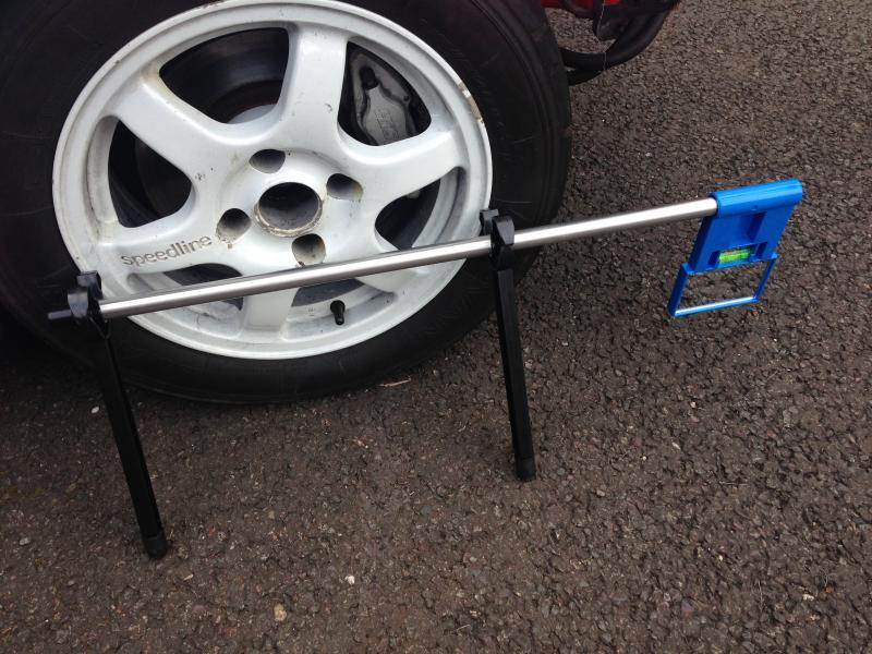

The other day i fitted my new steering arms and this meant it needed tracking so i ordered a track ace kit for future use. it should pay for itself soon enough.
I set it up and its slightly out
You can see its toeing in quite abit.
Some final pics of the boot and bonnet fitted and painted along with the polycarbs.

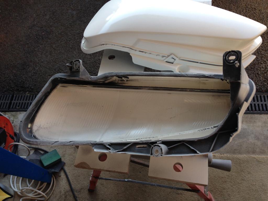

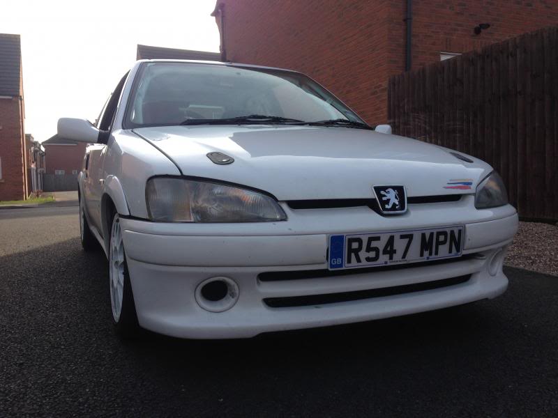

Firstly i painted the lights, the black was just to see how it looked and i wasn't keen so went with bianca white. a little better imo.
And a better pic of how ive chopped them up, i could of done a neater job.

The car now having tommys steering arms needed the wheel pointing in the right direction.
With that all done it drove great. i cant wait for Donington now.

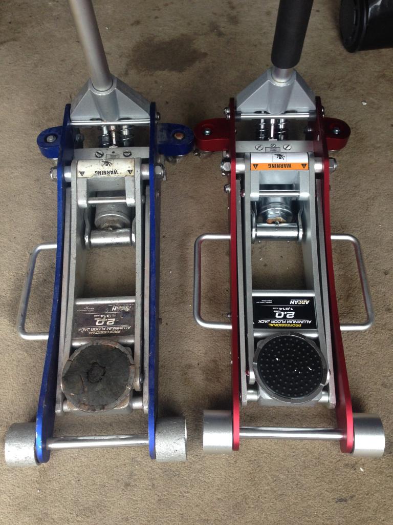

Unfortunately my jack died. id had mine for about 9 years and its been spot on so choosing a replacement was easy enough.

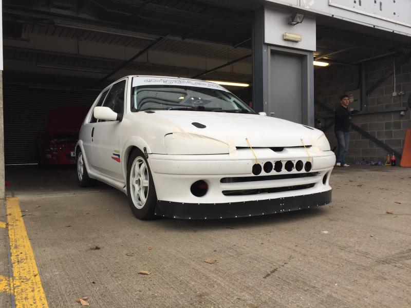

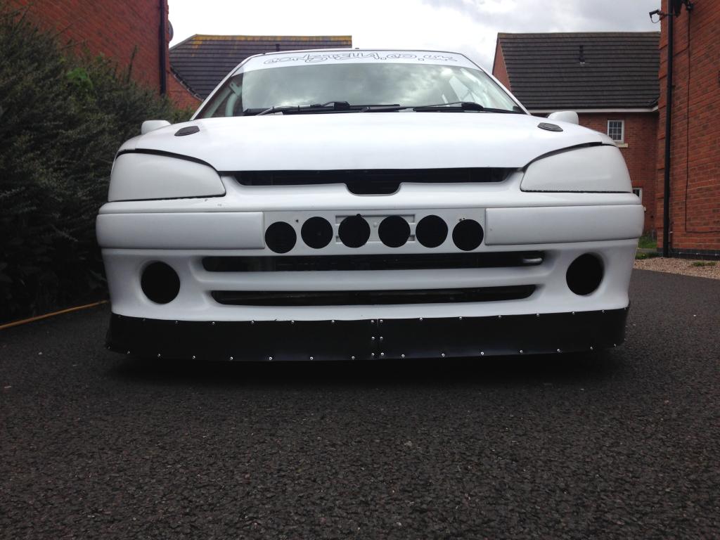

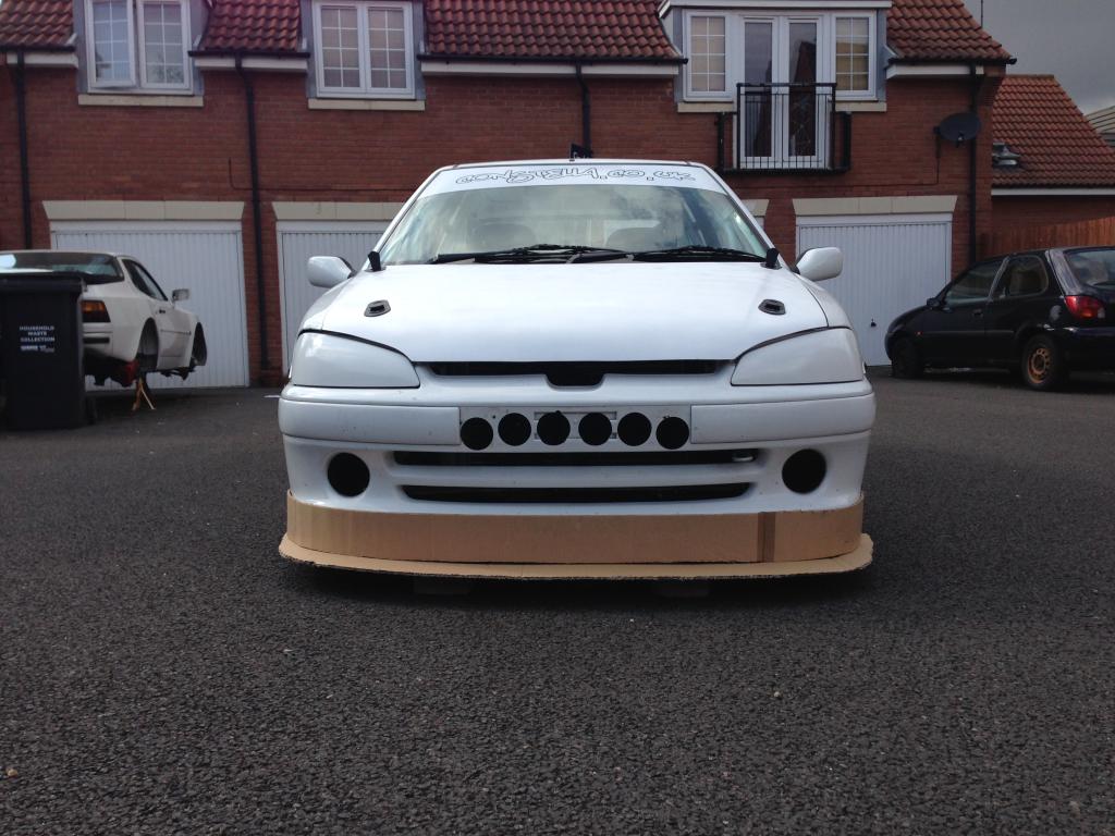

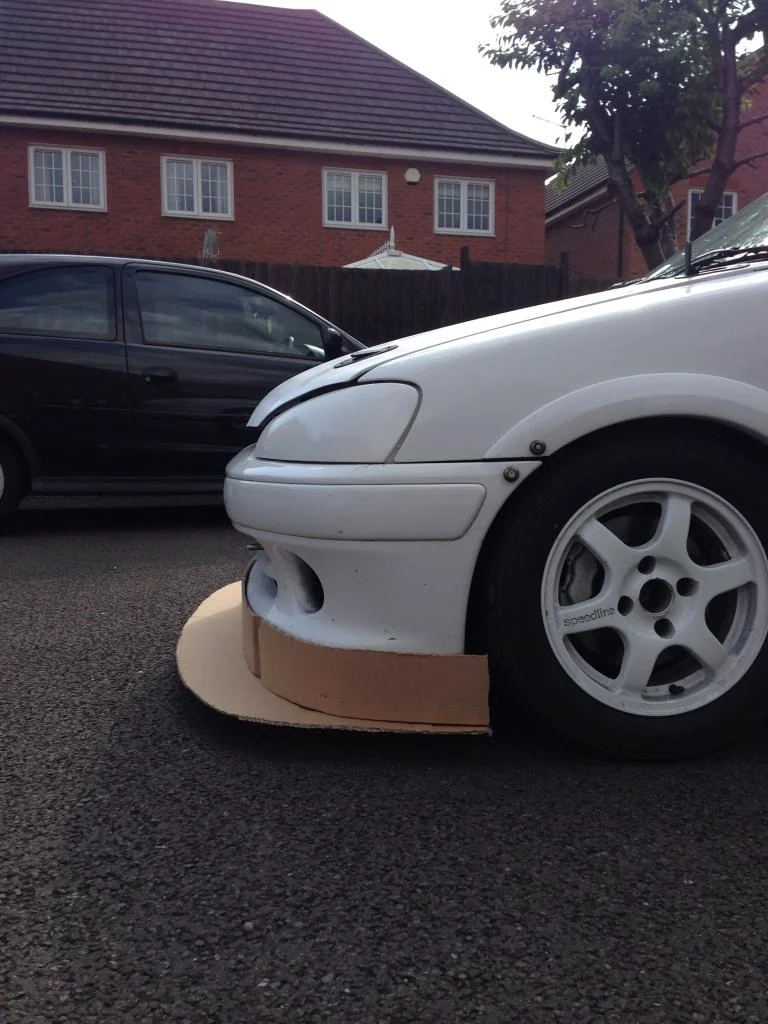

With my plan for the splitter made up i started on making the first bit up. now the splitter needs to be made removable so i can get it on my trailer so i need to do some thinking before making it up. here is what ive made so far.

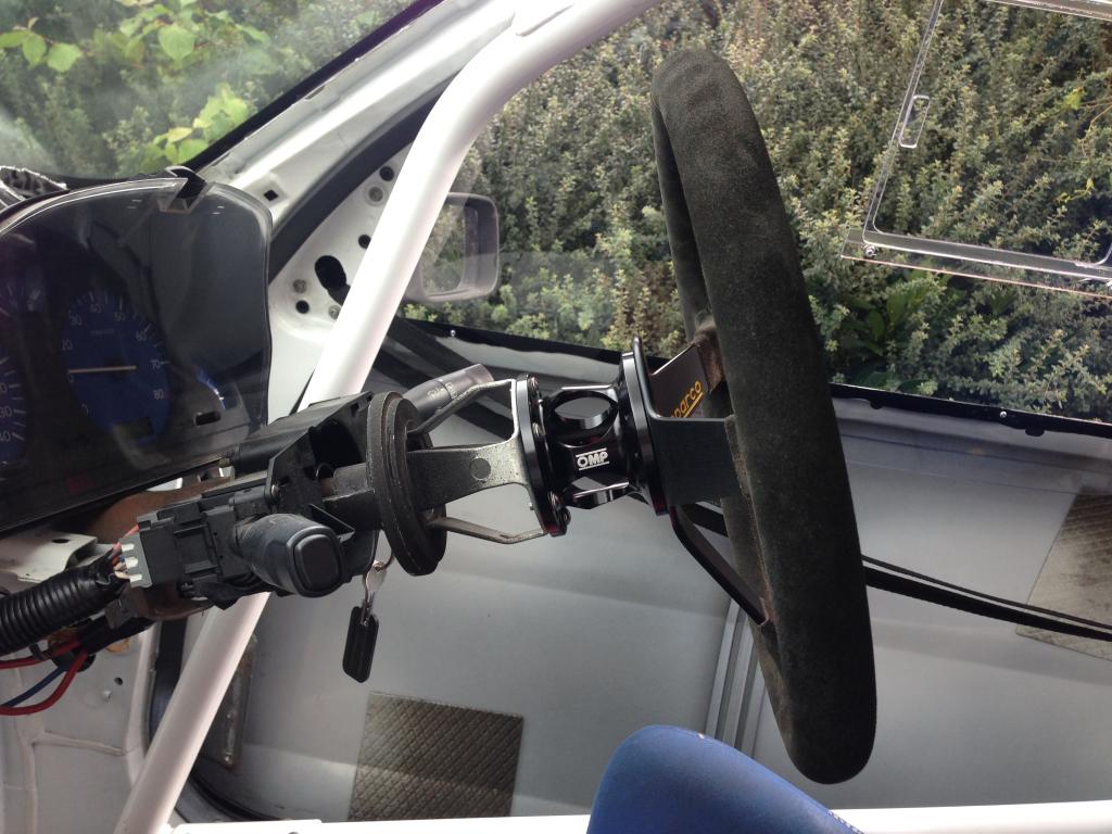

Ive needed a steering wheel spacer for some time now and bite the bullet and splashed out on a omp spacer.

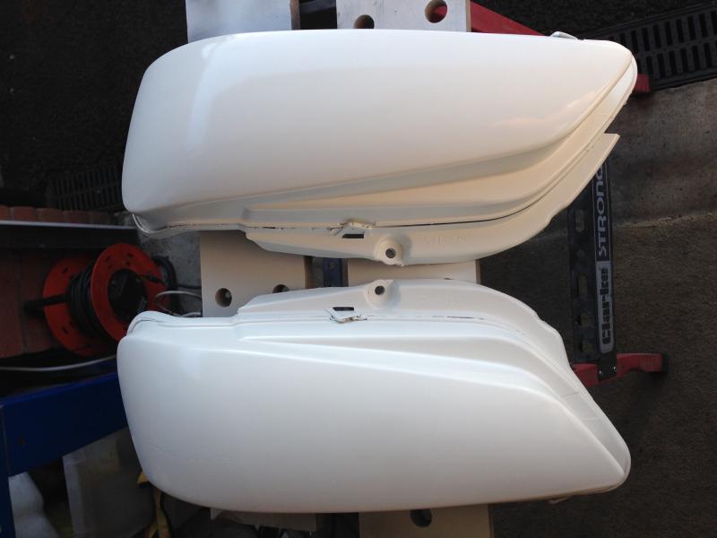

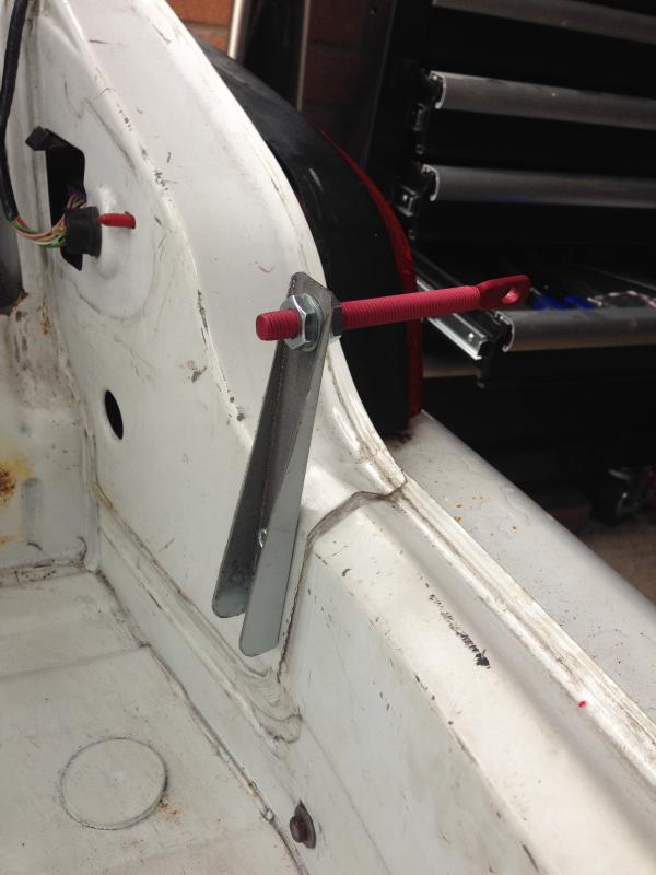

With me having a single skin fiberglass bonnet now and it needing to be completely removed when needing access to the engine bay i needed a solution to the washer jets. i came up with this.
I gave the rockers a lick of hammerite, the colour is better but the finish is shocking lol. ive been waiting for the satchell rocker covers for ages, they need to hurry up lol
And finally i needed a way to open the door and came up with this.

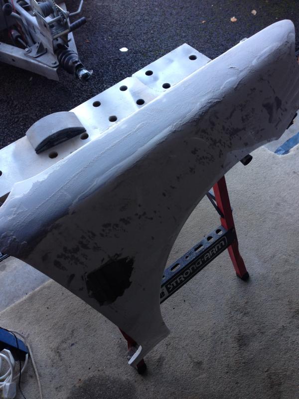

and the holes in the wings needed to go, but i dodnt want to just replace them, i believe the idea is right so went for the idea of spacing the wings out. abit of cutting welding and some filler later i had a gap.

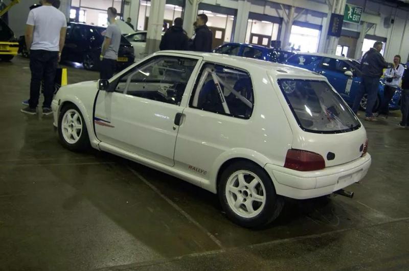

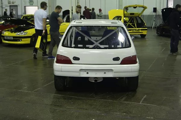

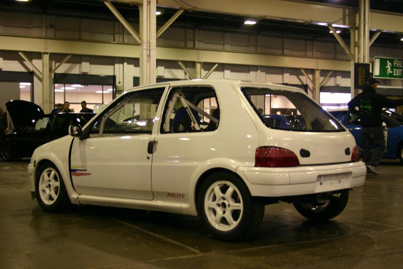

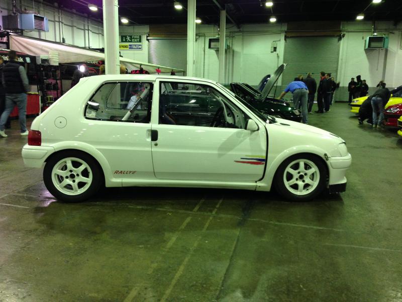

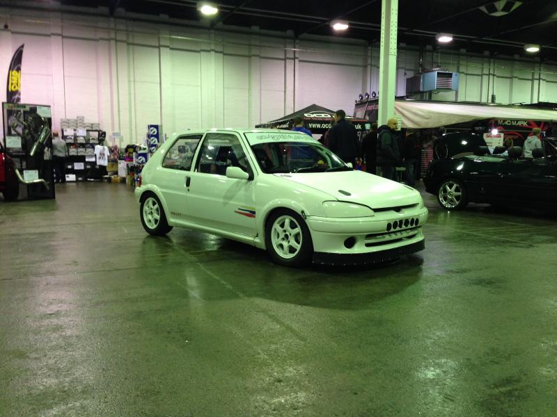

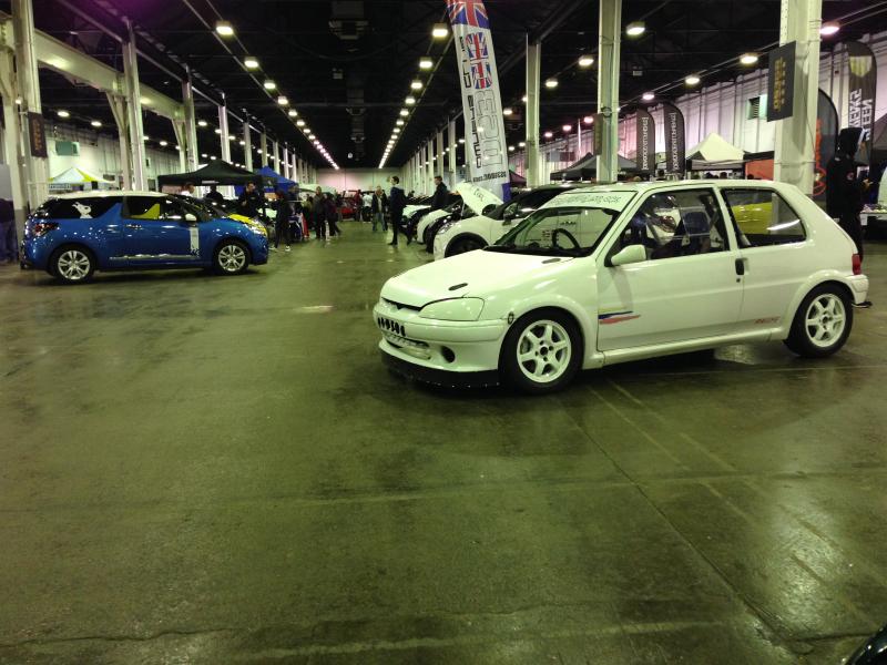

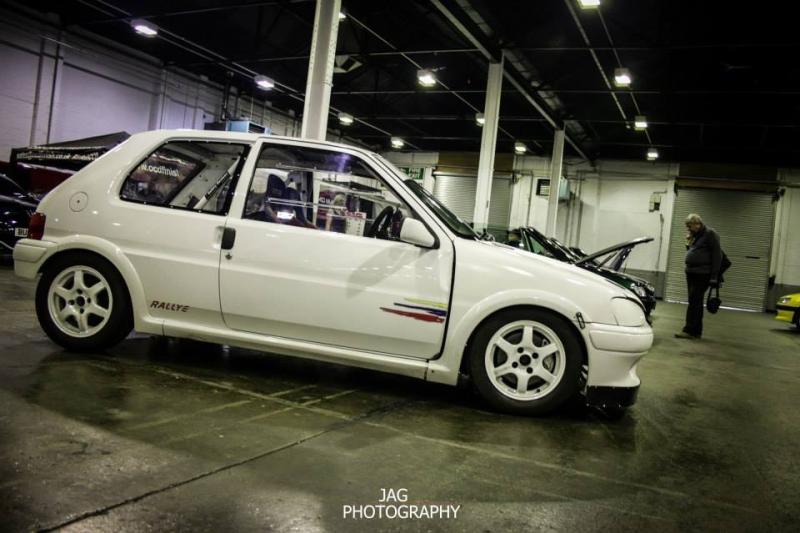

and you can see the space in the shots of the car from the pfc indoor expo. i was the only rallye register member to take a car. a shame as i was hoping to have a nosey around a few cars.
a couple images borrowed from other people but most are mine.

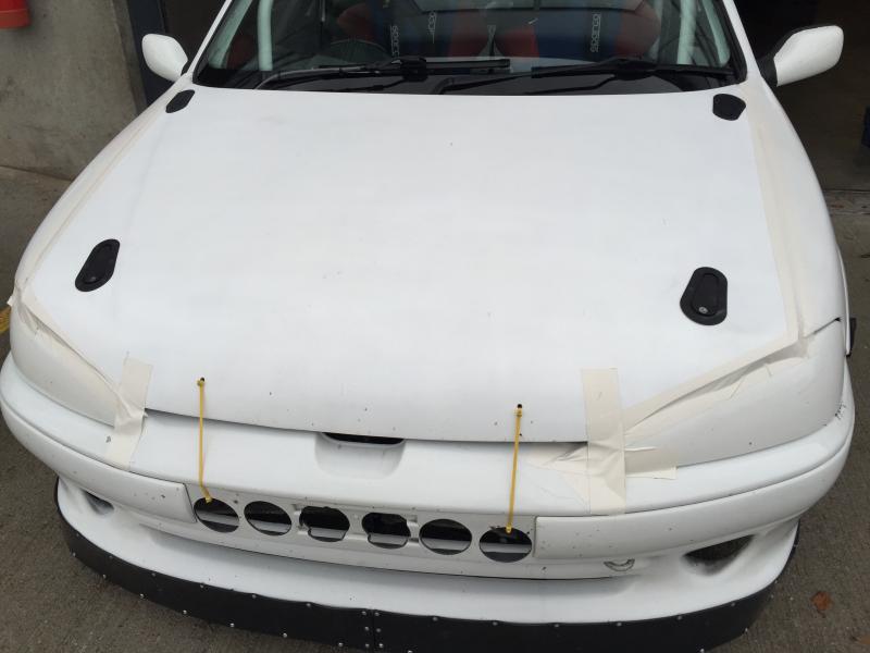

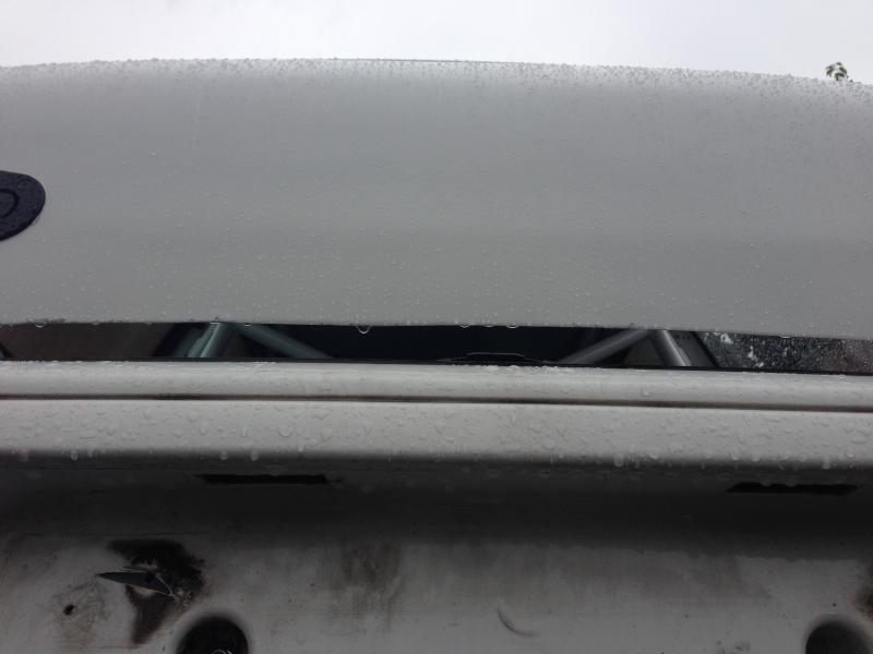

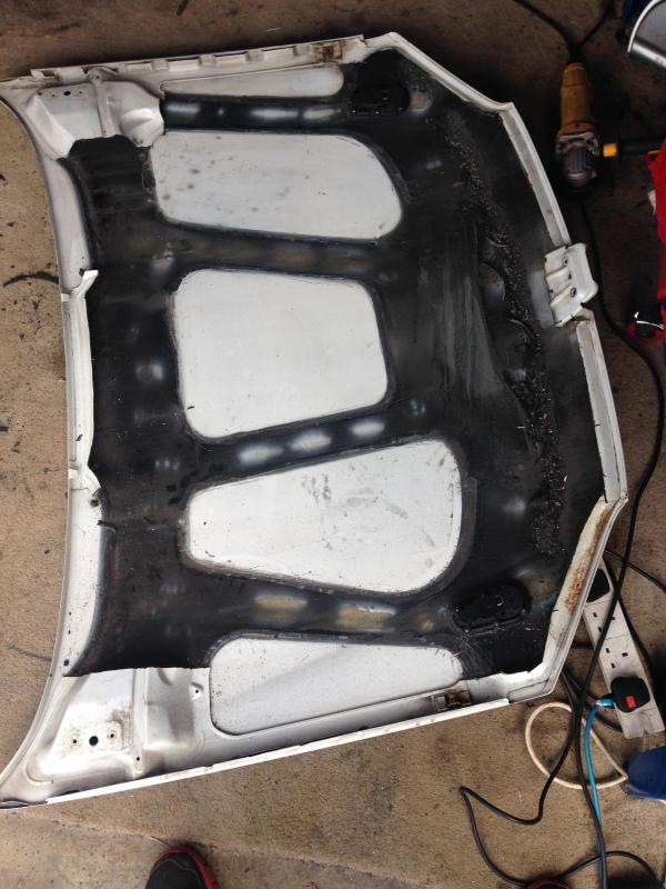

on the siting lap it was evident something needed to happen with the bonnet it was very unstable and just flapped about even at 50-60mph
once the bonnet was sorted i went out for some sessions the car felt great and i just picked the pace up throughout the day. it felt awesome the diff felt great and the noise was pretty special. i did end up with a stonking headache tho.

The bonnet fix

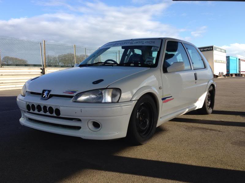

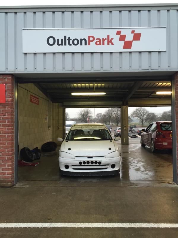

I did oulton at the weekend what a cracking track, the conditions where slippy to say the least tho. ive never been on a track thats been so slippy it made things interesting. id love to go back when its dry for some proper laps.
The day didnt go without faults tho, when i put the wets on with the rallye steels the brake fluid boiled just as it did at blyton. luckily theres a shop at the circuit so i was able to buy some decent stuff and get the brakes re bled. they felt awesome after.
The steering arms kept coming loose ive found them to be abit of a nightmare tbh tightening them up is hard work. think they need some loctite on them
other than that the bonnet reinforcement worked and the car felt quick.

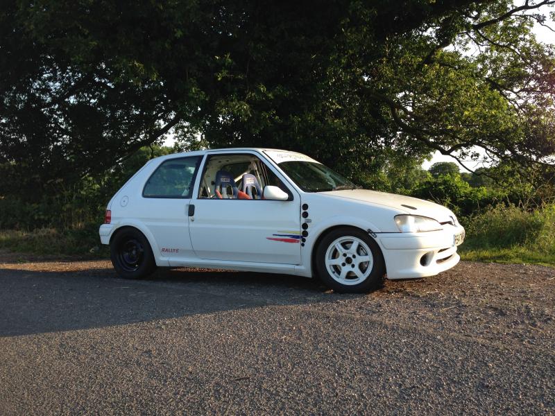

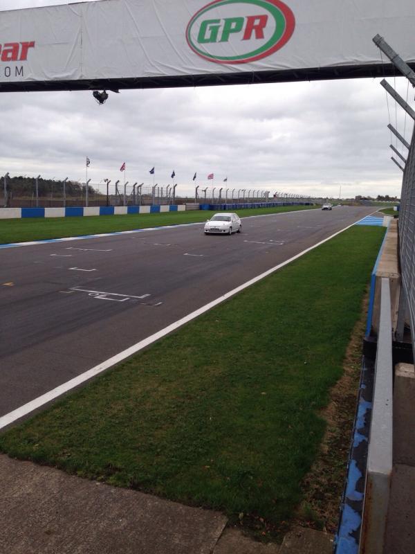

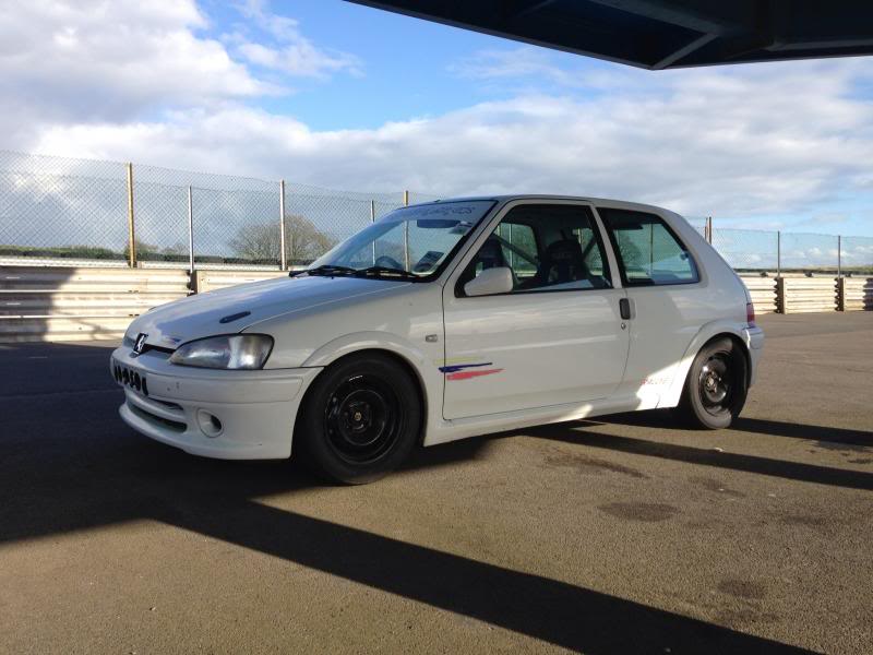

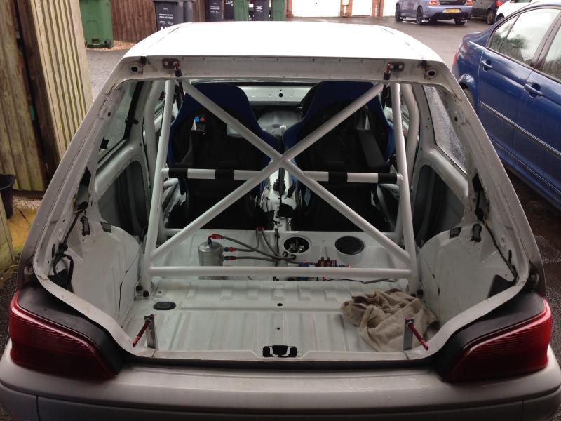

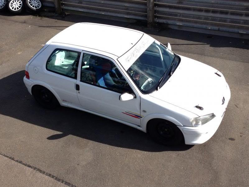

Heres some pics and a couple of vids.
