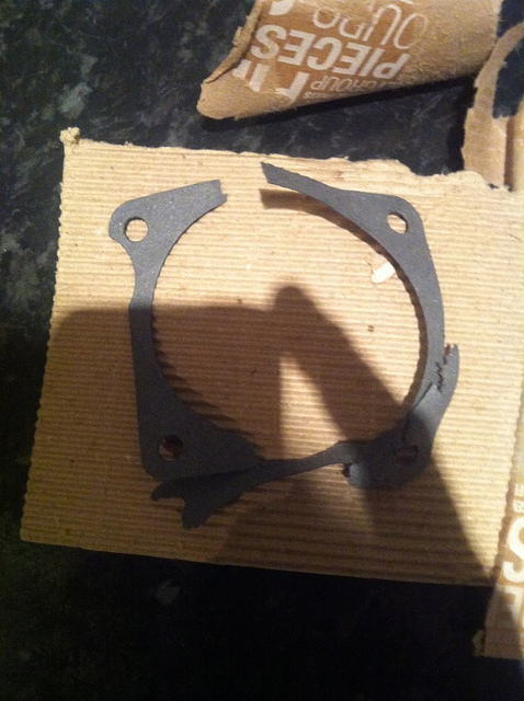

Turns out I'd pinched the new O-Ring as I was putting it on, it was a bit over-sized in fairness which probably didn't help. Luckily I work at an engineering company and I managed to find a replacement o-ring in the stores that was the right size and Nitrile material to boot, so it should be fine in contact with petrol.
Parents visiting put a long weekend of car-work on hold, but Sunday evening I did start thinking about trying to fix the sticky throttle once again. I bought a replacement throttle body from potter88 and a new gasket from Renault. Renault's gasket packaging is frankly ridiculous using sticky plastic!!!!!

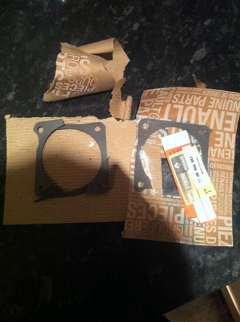

I took ages trying to get it out in one piece, and this is the best I achieved....
Yes, that's about 1/3 the thickness of the gasket still stuck to the plastic packaging. It was in 3 bits by the time I extracted most of it...
Stupidity! Anyhow, luckily the existing gasket seemed in pretty good nick, so I just used that.
Cracked on the new TB and...... THROTTLE FIXED!!!! RESULT!

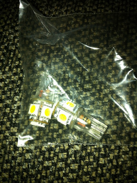

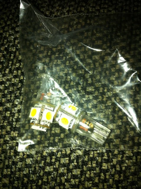

Along with some new LED sidelights to match the colour of the HID kit (6000k)...

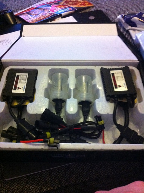

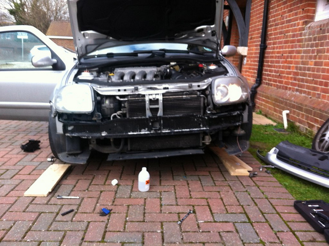

First off, I got to work on the HID kit. After doing it, I reckon it would have actually been possible without removing any bodywork at all, but because I was going to fit the brake cooling ducts and remove the foglights, I decided to remove the bumper and grille anyway. I have to say, this made it much easier, and I could mount the ballasts nicely out of the way in places you wouldn't be able to get to with the headlights still in place.
Here's one side done :
And then the car assembled again!

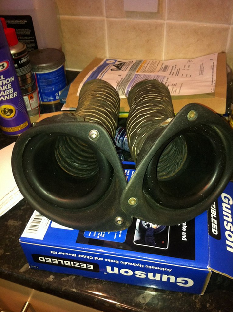

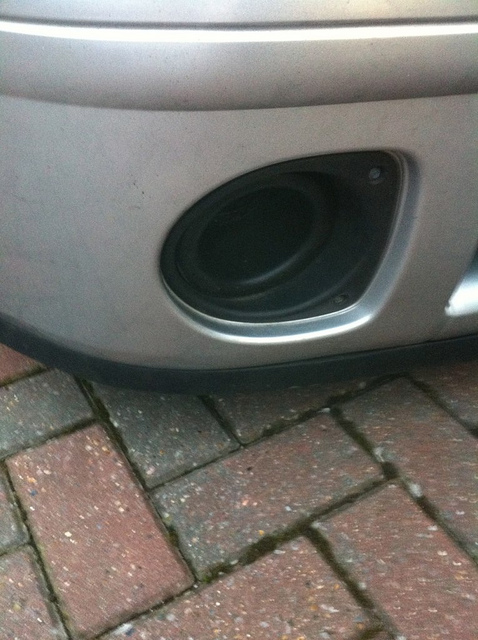

Complete with new brake ducts....

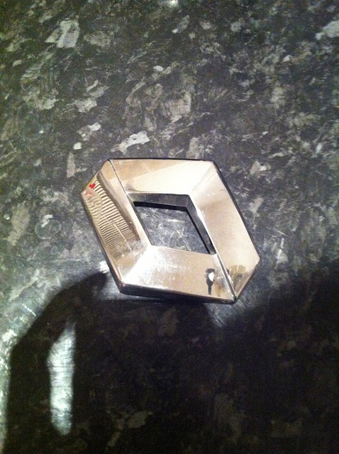

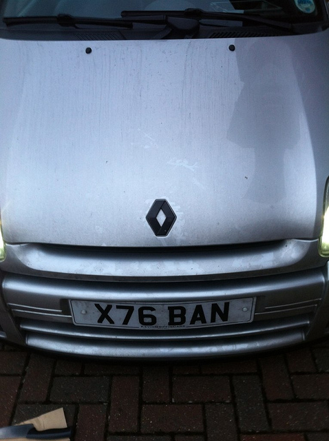

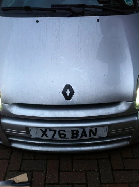

I also wanted to replace the black Renault logo on the bonnet for an original silver one...
Unfortunately, the one I got seems to be slightly more curved than the old one. Can anyone confirm that part number 7700824625 is the correct diamond for the front of a 172 Ph1? I'm thinking it could be the rear badge from a 172 Ph2/182/V6 instead :(

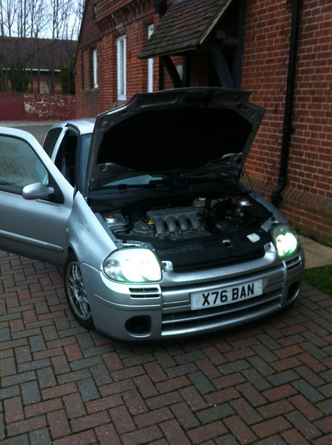

I have to say the LED sidelights and HID dipped beam are absolutely brilliant. In the projector lens of the 172 dual optic headlights, the beam pattern is very good and I drove around tonight to check alignment and didn't get a single flash. I also ran behind a police car for a good couple of miles with no interest, so I'm happy :)
The 35W 6000k kit is a great option, I can't imagine the 55W kits are really necessary to be honest!

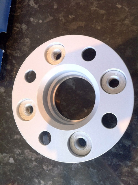

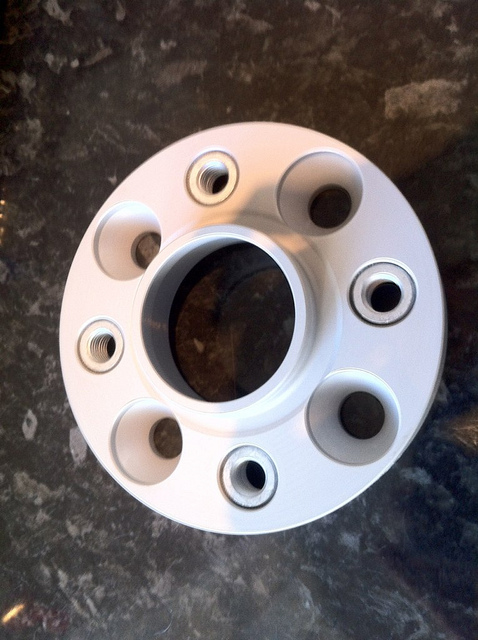

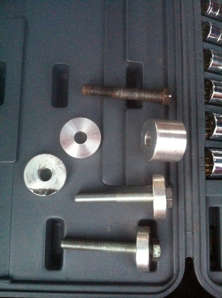

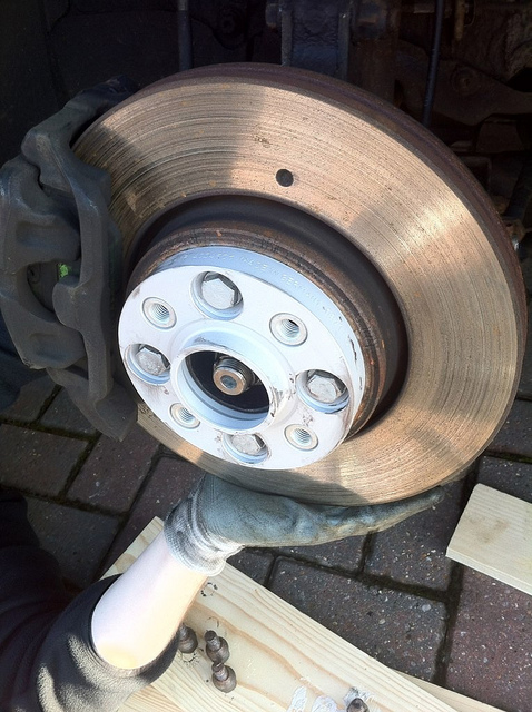

Took the wheels off to find that the threaded hole in one of the FK Spacers was completely stripped. Frankly, for the cost of them, the engineering is pretty piss poor. In my opinion, they should have at least been helicoiled as soft aluminium versus steel bolts was always going to be an issue over time.
Anyway, a bit of research and 2 days later these turned up...
Decided to stay with 40mm overall widening, so each spacer is 20mm. The advantage of these over the FK spacers are that they use proper stainless inserts for the wheel bolts to go into. Should be much harder to strip threads....
As you can see, the inserts are top-hat shaped to prevent them ever coming loose and pulling out...nice bit of engineering.
Unfortunately with all the crappy weather and still early darkness, I had to drive around in the V6 until the weekend came around.

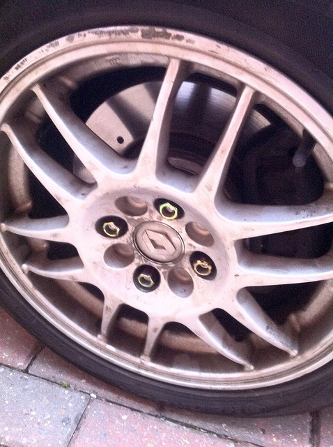

Got stuck in...old ones came off no bother (breaker bar needed for the bolts). Thankfully Nickson had copper greased the back of the spacer so it didn't stick to the hub.
New ones on....
Unfortunately, it seemed some of the bolts were a bit knackered too. I had to go and buy a McGard locking bolt set of the appropriate length to ensure a good tight wheel!!

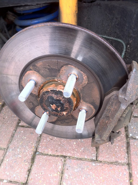

So, car back on the road...no clicking noises...all good. Apart from I wanted to go one better. I always find it a bit of a pain putting the wheels back on as the wheel tends to slip off the spacer until you have 2 bolts fairly well in.

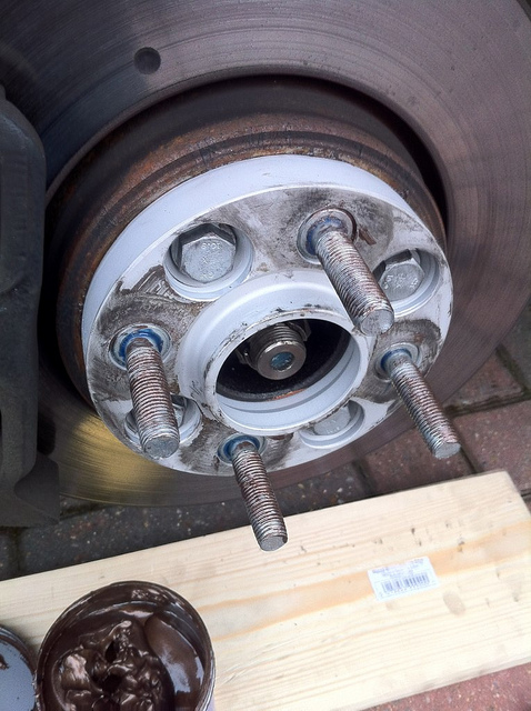

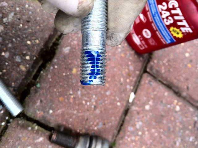

So, quick scout around on ebay and I found some appropriate M12 x 1.5 conversion studs. The appropriate length for the standard OZ F1's is 60mm overall length, which gives you 43mm of exposed thread.
Cost about £17 all in from JJC Race & Rally...not too bad really!
Bit of Loctite on the end of the stud to prevent it spinning out with the nuts next time I take the wheels off...
All in....bit of copper grease on wheel mating surface and on the studs...looking good.
Rears in too...

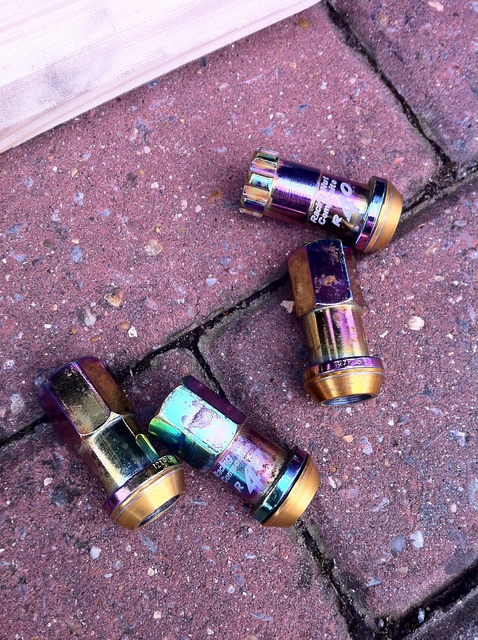

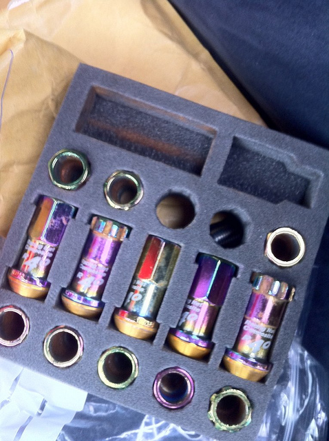

Now what nuts to buy? Luckily JamesT87 put some nice ones up in the For Sale section which I snapped up pronto. These things are mega-bucks new and they look pretty cool too. Really light weight also...
And job done!!!!!
(I know they STILL need an urgent refurb!)
Got to say, studs make getting the wheels on (and off) an absolute breeze. Definitely recommended!!!

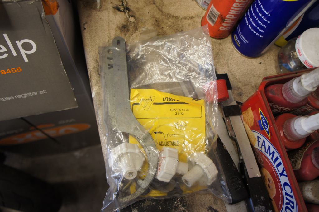

I found something you may find useful today whilst clearing the garage.
Probably something that should have been in the boot of the Clio as you drove off!
Woops!! :eek:

Aaaaahhhhh.....funny that I wondered where the c-spanners were. Found one in the box of bits but it's a raceland one!
Don't suppose you found the handle for the car jack at the same time??

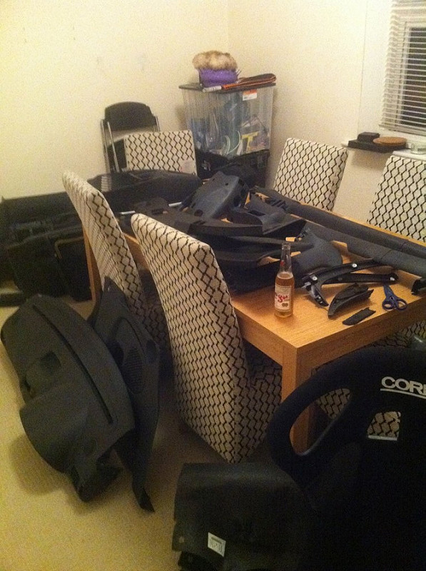

Luckily I borrowed work's van to pick everything up from Slough, as when laid out it's quite a lot of stuff!!! This is only part of it....
I basically lost use of one room in my house for a few days...
What's that at the bottom of the photo you say? They'd be the new seats which will be going in post-interior change. Corbeau Revolutions, bloody narrow but having done a few events in them in another car, I knew that they're actualy supremely comfortable for these kind of seats.

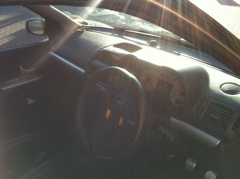

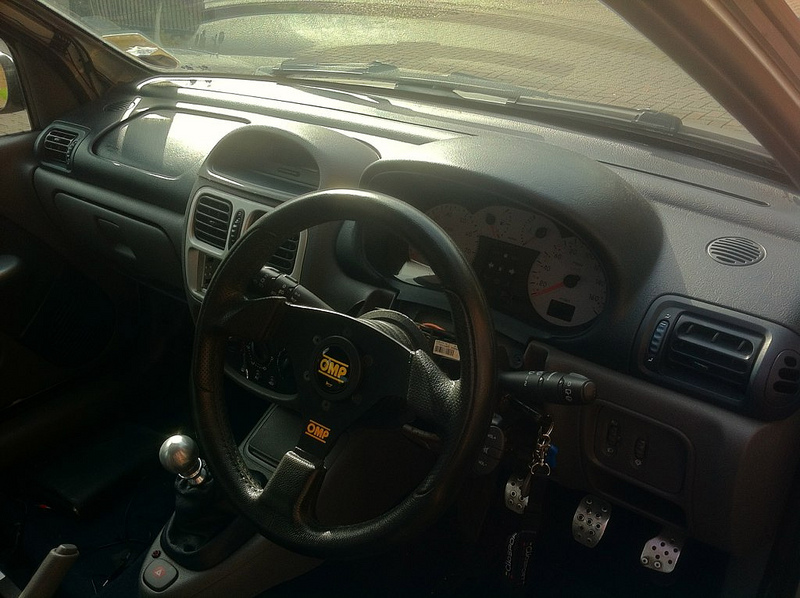

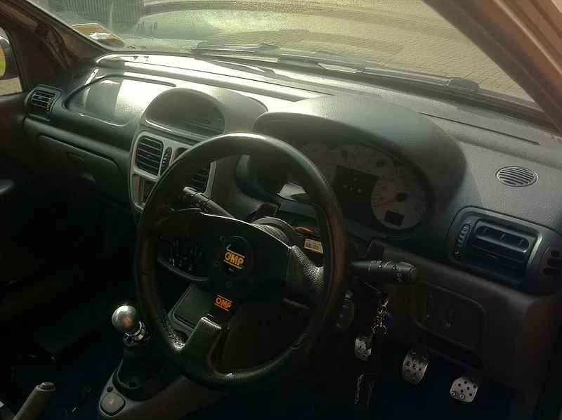

This is how she started, standard apart from the OMP wheel..

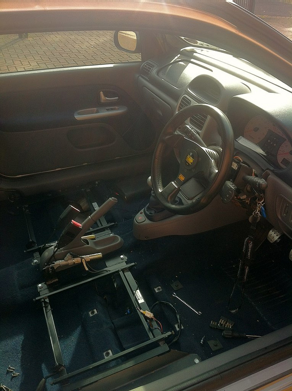

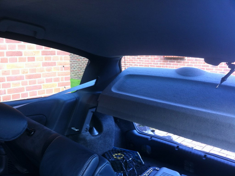

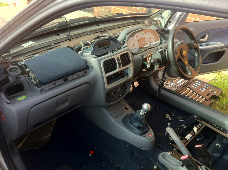

First things first, pulled out the seats. In this photo I'd laid in a couple of subframes which I didn't end up using. I still can't believe you have to undo the exhaust post-cat to get to the passenger seat bolts. Is that normal or something to do with having an aftermarket exhaust??

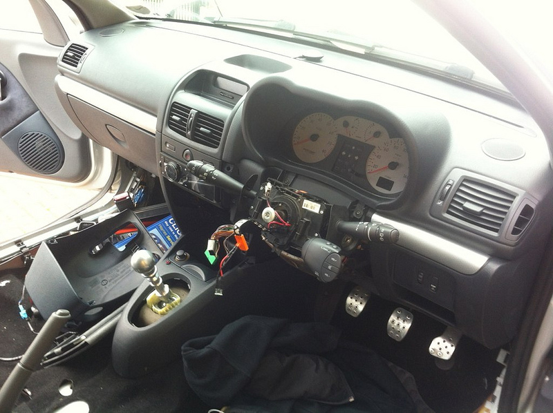

Next up, dash top off...all pretty smooth sailing so far and nothing particularly challenging.
Wheel off, much harder than it should have been, it was well and truly wedged on!

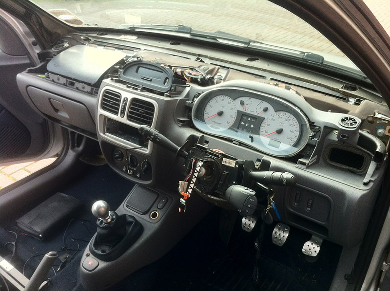

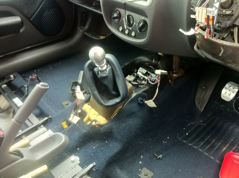

Centre console out and diagnostics socket bracket removed.

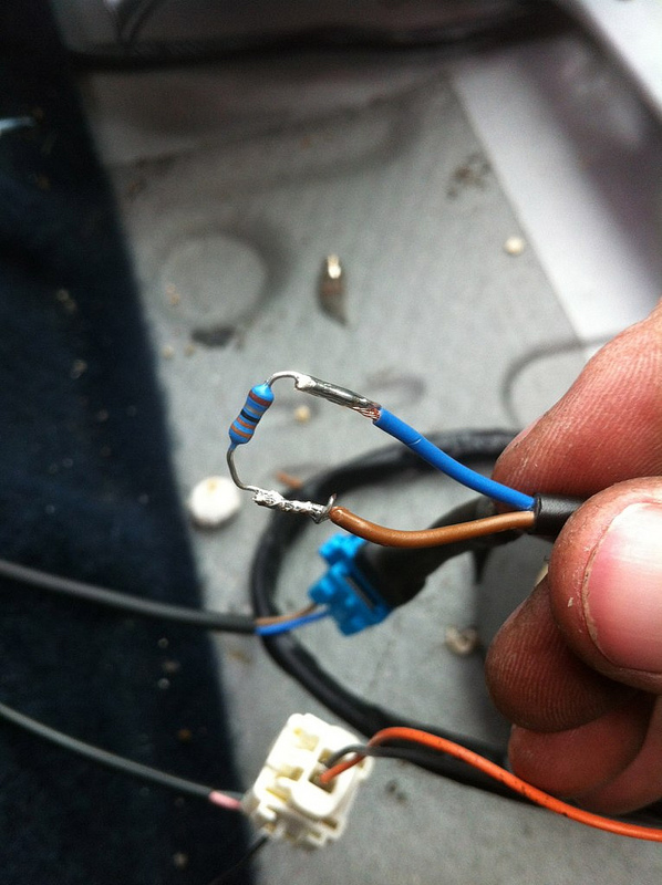

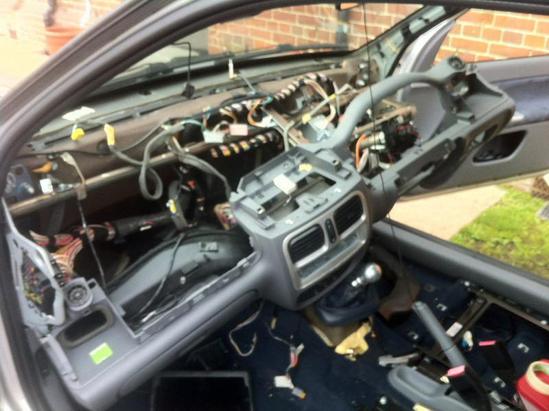

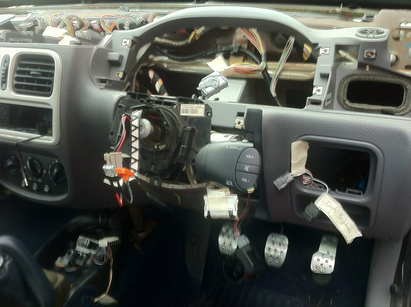

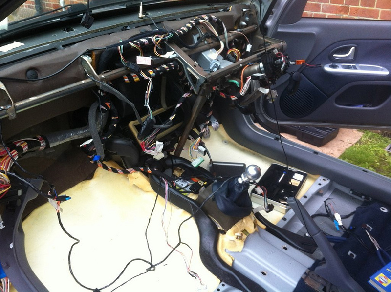

Clocks out, stalks removed. As you can see, I was pretty meticulous with labelling wires. This project could go horribly wrong if you don't.
Lower dash coming out...not too difficult but would be easier with two people to lift it off the rear mounting points.
One thing you soon realise when doing this is that there's a couple of random plugs which aren't connected to anything. This one was in the centre console area, just in front of the gearstick. No idea what it does or would do if connected...anyone know? I found another one of similar shape and size behind the clock in the central dash.

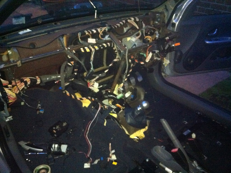

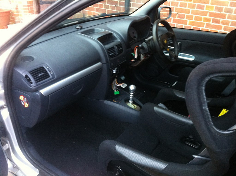

And this is the end of day 1's progress. I have to say, looking at it like this before leaving it for the night...I did wonder if I'd bitten off more than I could chew.

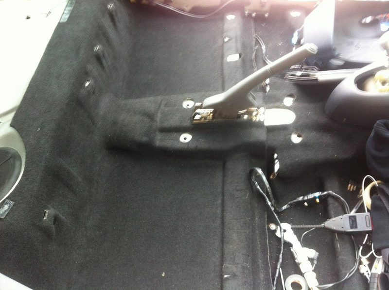

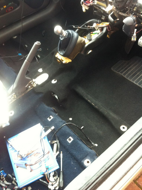

So next morning, bright and breezy. First thing I tackled was the carpets as these would have to be all replaced before I could get on with replacing anything else.

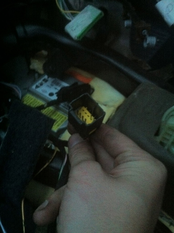

Before that though, I decided to do a proper job of all the airbag connectors which wouldn't be used anymore. 3.3 Ohm resistors from Maplins do the trick.....

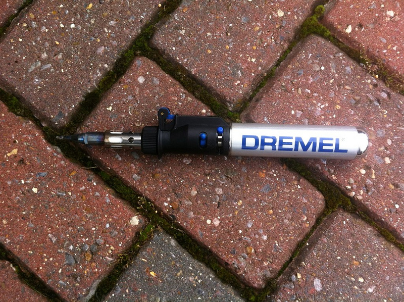

....and this was worth its weigh in gold! Does an awesome job of soldering in the car. Highly recommended.
So, this was a good feeling. Finally making progress. Out with the god awful blue, and some nice neutral black. You can clearly see the difference between front and rear....
Rear carpet in too....good stuff!

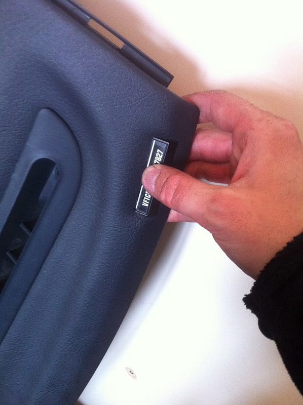

Now, wanting to do as good a job as I could, I removed the VIN plaque from my old dash and transferred it onto the new one. It's different shape slightly and the Ph2 plaque's are heat welded onto the dash. Therefore a bit of glue came in handy.
The photos reduced in quantity at this point as the heavens opened. The next parts of the job well truly awful as I was inside the car with all the door shuts trying to get on with it. I did come across quite a few discrepancies between my reality and Rob's guide. Particularly the alarm. Mine has a red flashy light which had been spliced into the loom and made some of the wire relocations even more tricky. Anyway, once I understood what Renault UK had done it wasn't too bad. But a warning to others contemplating doing the swap, it isn't quite paint by numbers!
Getting the lower dash back in was a real arse. I could push it back far enough to get it to locate onto the 3 main points. I couldn't really see what was stopping it, but it seemed to be the main loom. I took a dremel to the back of the dash and cut away some material at this point. This fixed it and it went relatively smoothly from there.
A load of j-clips come in very useful. For instance, there's no holes for the passenger side upper dash to secure. J-clips allow those fixing points to be used (with a bit of dremel work) which should keep rattles to a minimum.

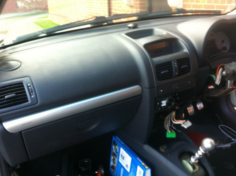

Once the dash was in, work continued...changing out all the light grey/blue plastics to the newer charcoal/dark grey may seem easy but is very time consuming!

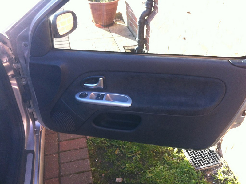

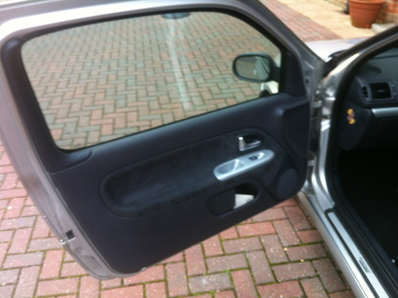

Door cards changed too, makes a massive difference to the looks.

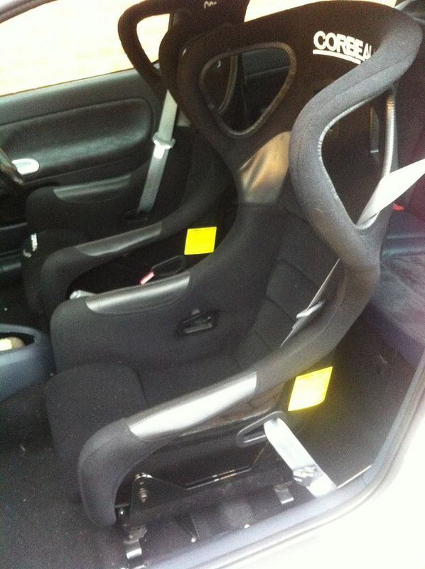

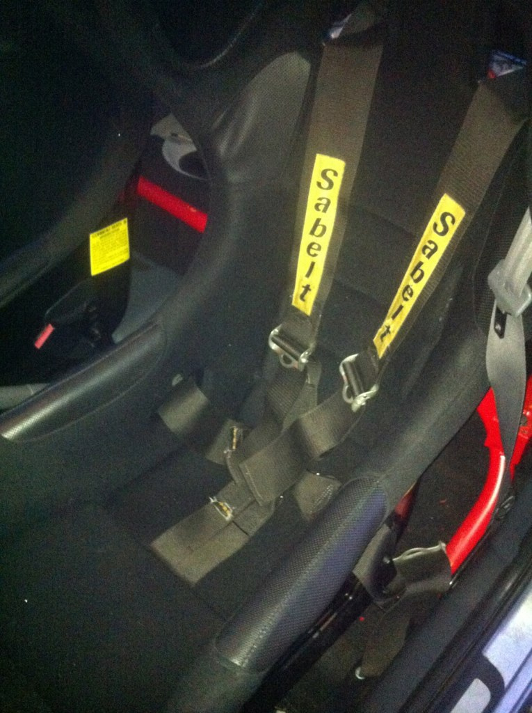

New seats in too....on fixed subframes for now but looking to add sliders soon...
Purposeful... :)
And that's pretty much how she stands now.

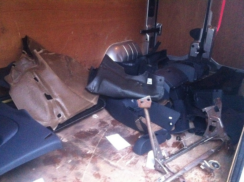

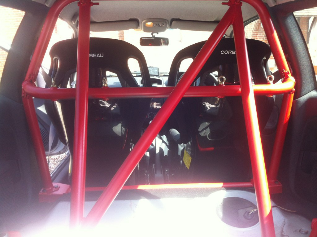

I sold off my old interior (although still got all the plastics and carpet if anyone wants them??) so the rear is stripped at the moment.

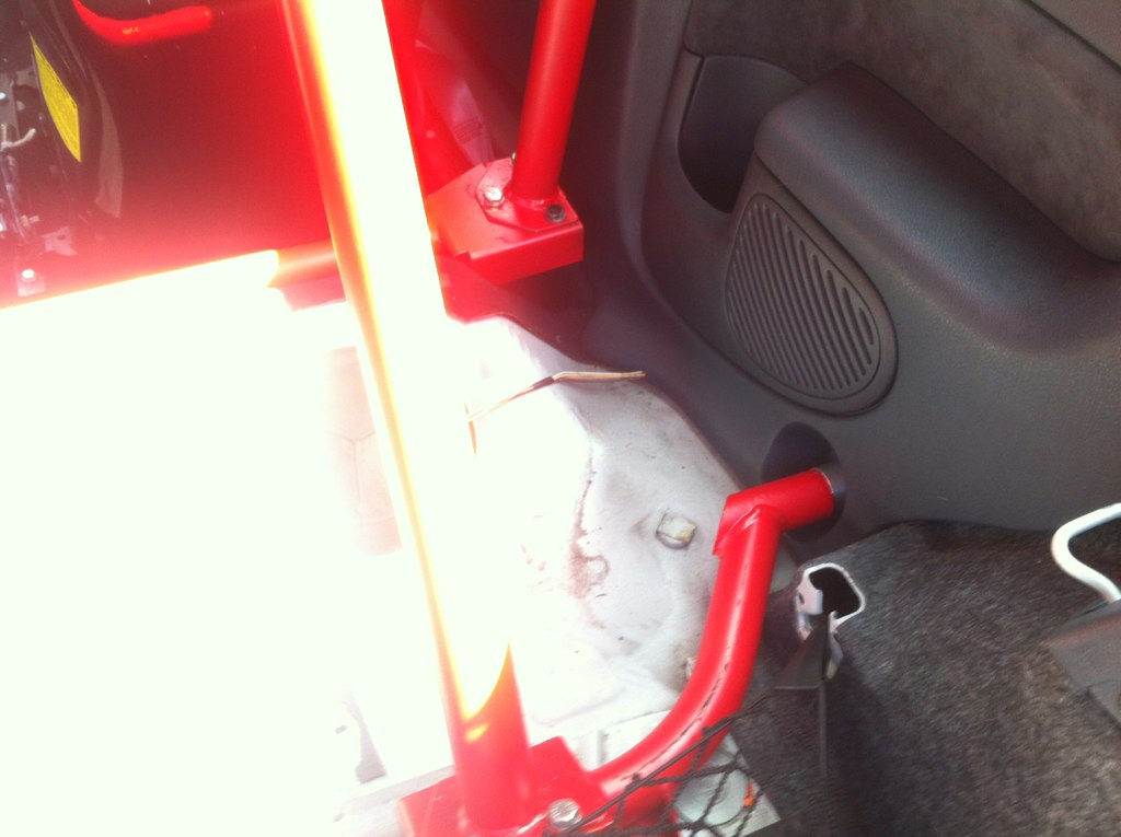

I'm torn between getting harnesses and leaving the rear stripped, or getting tilting subframes and a phase 2 rear bench. What do you guys reckon?

The other good news is that I've decided to man up. With that in mind, I'm off to pick up a rear cage tomorrow (K-Tec bolt in with harness bar), I just bought some 6 point harnesses on eBay too.
I've got the rear attachment points sorted (obviously), my seat subframes have a hole for fixing the inner lap belt (near handbrake) and I've sourced some M10 eyebolts for the outer lap belt eyes which will screw into the existing lower seatbelt bracket hole.
Question : has anyone fitted 6 point harnesses? How did you go about making a fixing point for the crutch straps??

Right....it's been an absolute age since my last update and plenty has been done.
As per my last post, I went and picked up a Ktec bolt-in rear cage. It's a great design and I'd highly recommend one to anyone wanting to fit harnesses as it puts the harness bar exactly where you would want it.
It basically utilises two subframes, front and rear, which bolt into existing holes (seatbelt/seatbelt buckle mounting points). Bolts and spacers to clear interior trims are included, so there's no need to botch or remove any interior plastics....Unfortunately when I got back I found one bolt and one of the fat spacers for the rear subframe was missing, but James quickly posted them down to me so I only lost a couple of days in getting it fitted.
Here you can see how the rear subframe bolts to the rear seatbelt point utilising the fat spacer to ensure a good tight fastening...
The subframes are easy enough to get in, but I tried to get the cage in through the boot...I did eventually manage it but I've since learnt that you should take the front seats out and install it through one of the front doors instead. Had I known this at the time, I would definitely have done that as I was ready to give up after an hour of jiggling and pushing.
Anyway, 8 bolts later and the cage was in and looking awesome :)
Now that I had a suitable mounting point, and my head wouldn't get flattened in the event of a roll, I decided to fit some proper harnesses. I found some 6-point 3" Sabelts on ebay for a decent price.
I decided to loop the harnesses around the harness bar instead of using the supplied eye-bolts as my engineering head says that should reduce point loading. For the lap belts I used the Schroth dog-bone style fixings. The outboard one is sandwiched between the cage spacer and original seatbelt fixing point. The inner one comes off the pre-tensioner mounting point on the seat subframe. The crutch straps will be fitted to an eyebolt fastened through the car using an FIA approved spreader plate, although I haven't gotten around to doing this yet.
For anyone interested, my work manufactures some good, suitable M10 eyebolts (plenty of thread) and I would be happy to get some to you at cost if you PM me.
So, the seats now look like this...
I left the original front seatbelts fitted for convenience when just nipping to the shops. I have to say though, harnesses make such a difference to spirited driving, pulling them tight you feel every movement of the car and I use them whenever I know I'll be hitting some nice B roads now.
