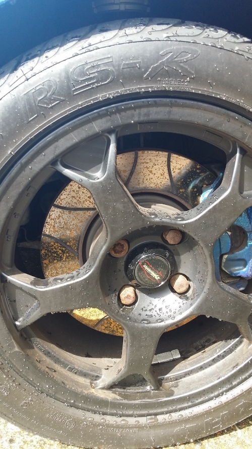

The reason being is that i am building my car for hillclimbs and sprints and the set up i have at the moment takes a HUGE amount of time to get warm and useless untill they are! I'm not 100% on the set up i have at the moment(setup was on the car when i brought it) but i think i have Brembo HES grooved discs with some form of Ferodo Pad?
Heres a picture of the disc
So i suppose what i am asking is, Would standard pads on the same discs tick my boxes?
Yes they're Brembo HC Max discs Rob, if you send me a photo of the back of the pads I will be able to tell you what Ferodo Racing compound is fitted (if the part number are still visible) . The DS2500 work well from cold and people run them in sprint/hill climb cars

would you not say that chances are that's what pads are fitted in at the moment? - bit of pointless question, i know!
guessing you couldn't tell from a picture of the pads inside the caliper? :tongueout:
