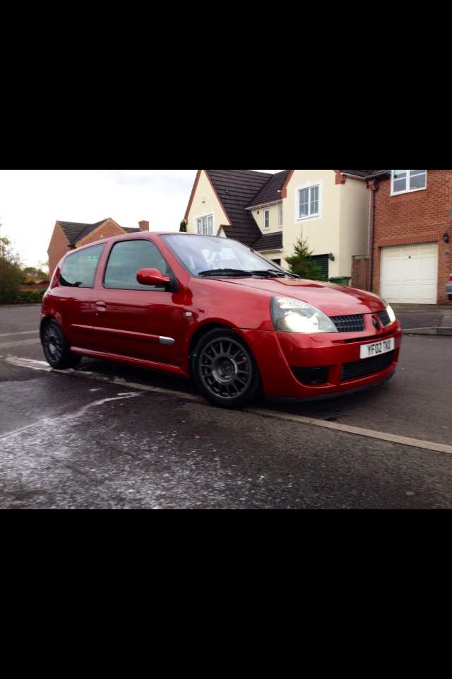

  Clio 172, Jaguar XJR
Certainly don't have to have coil overs. I just really like the way the car sits currently even if it is rubbish to drive!
If this can be achieved on springs at a presumably lower cost then I'm all for that.
Pic for reference.
  Transit & Death trap
I don't think you'll get those sort of lows from Eibachs.
Tbh, any coilover that is wound down really low, is gonna handle rubbish (not be comfortable) imo.
