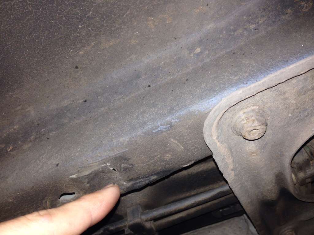

I'll have a look later but not 100% on where you're on about.
Jared- the jacking point? There will be a jack there!

Never use the sills or enless you want to have a rotten sill from the seams coming apart, i allways use the trianglar brace plates to the front on the nuts to stop it from slipping.
  A special one.
I use the chassis rails, just behind the bolt on triangular braces.

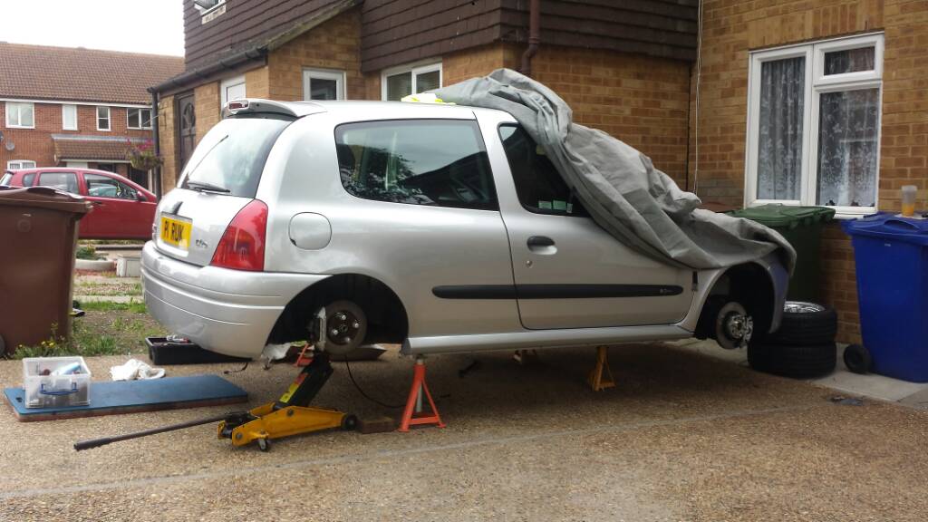

My rears are on my sills as my beam has been removed.

Lol, yeah there, but like fred says, get as near to the triangle bit as you can.
And accept that you should probably touch the underseal up every few years if doing so a lot as its going to get chipped off.
