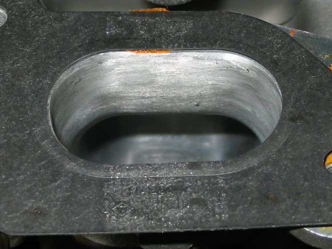

for those that were asking... this is a pic of bens inlet work... its also been refinded a bit since this pic which was about a yr ago...
its on Ross's car, 1st set of inlet mods..
Just to be a pain in the ass, would be interesting to post a before pic aswell. So to compare.........

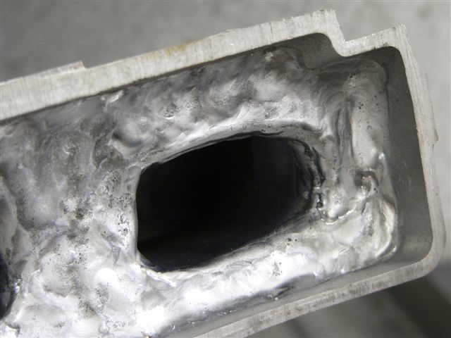

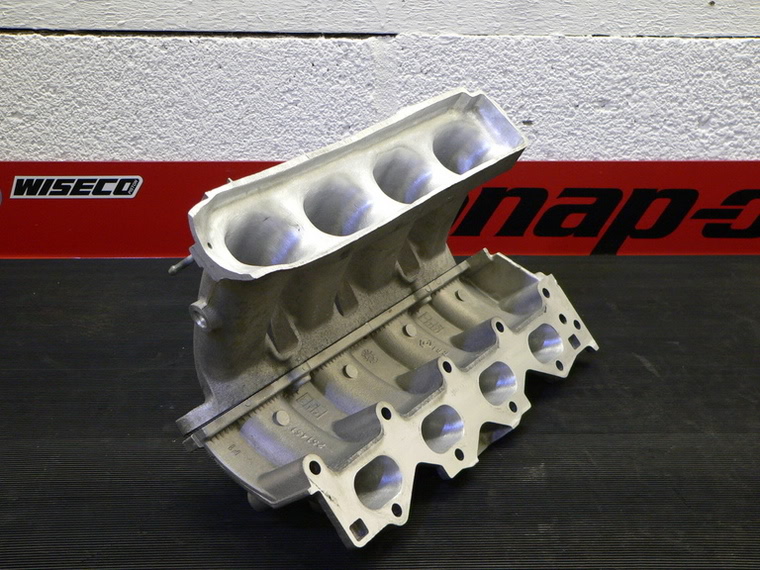

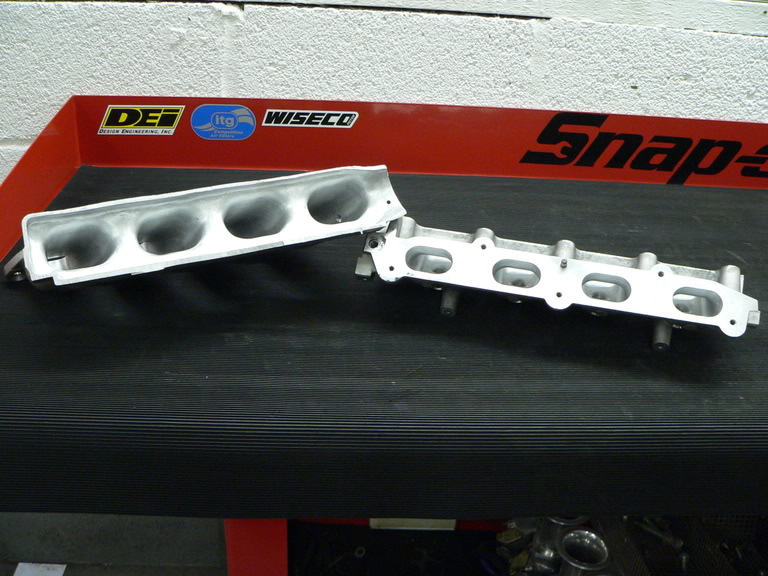

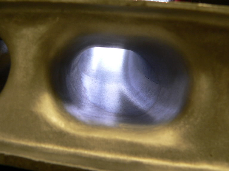

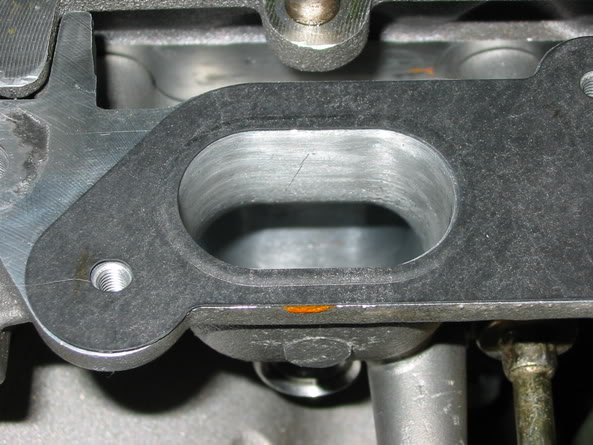

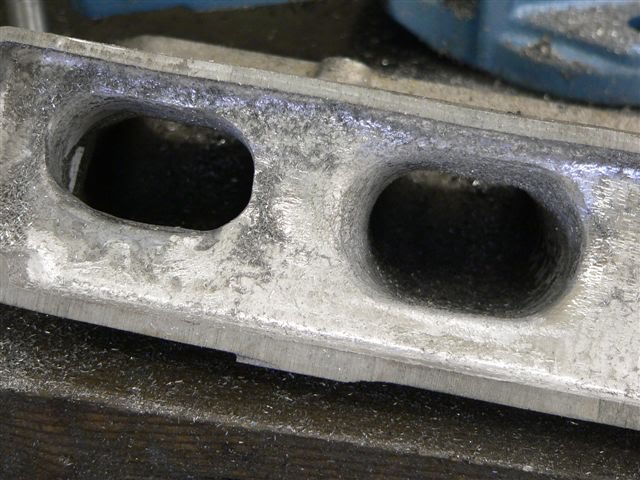

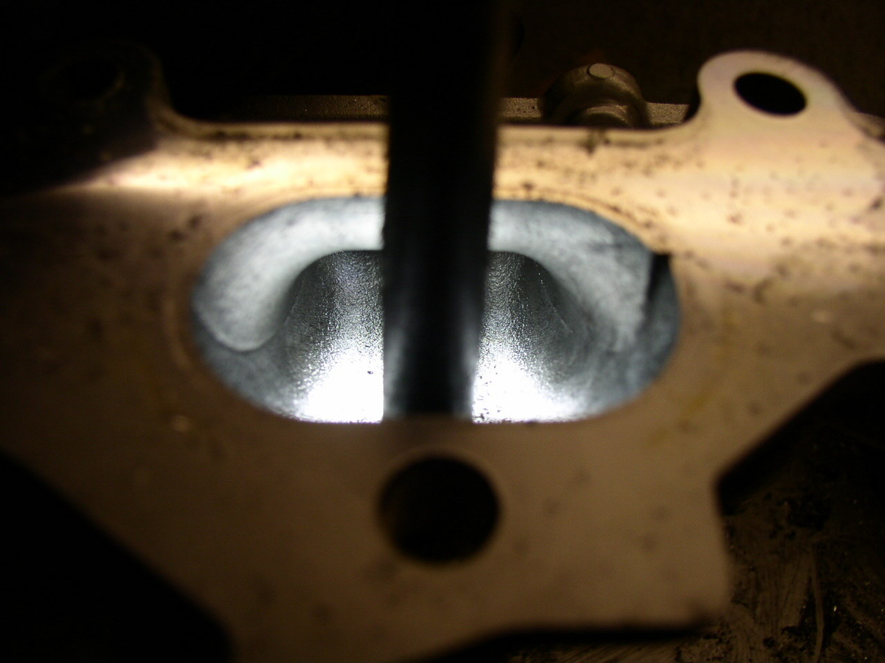

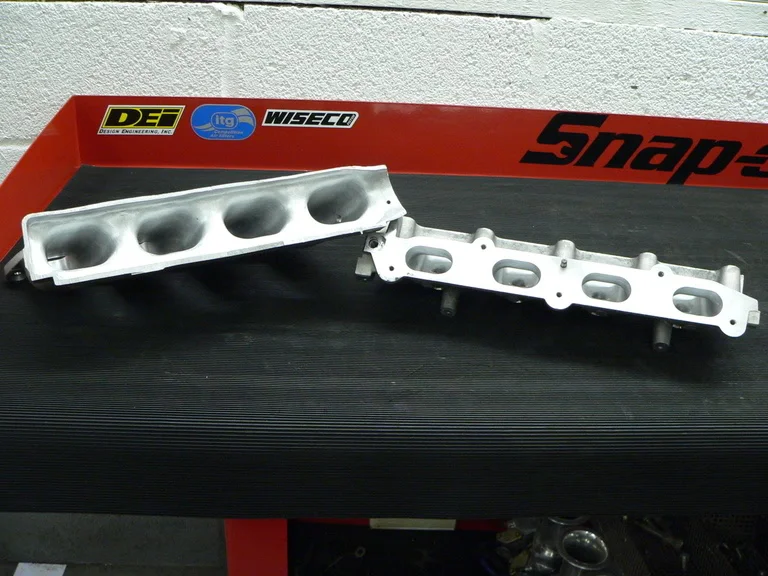

There are the only pics i have really.
Only pic i have of a std manifold face, hard to see but you can just make out the problem with std manifolds.
The rest is the geneal modification stages and the finish achieved. It is of the heavy manifold rework, but just so you can get an idea of things.
