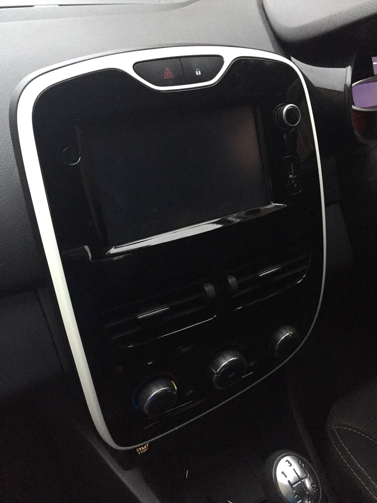

we have just put a deposit down on a 2016 clio Mk4 at a dealers and all the trim inside is fine (just needs a valet) but there is one thing letting down in the looks department and thats the chrome trim around the centre consul / media nav etc .. a lot of it has peeled of and just left the unpainted/unchrome plastic underneath - real shame .
Wondered what would be the best way to refurbish it? - mask it all up with masking tape and spray it? - or fine artist brush and paint it with silver/chrome paint? or anything self-adhesive could be applied maybe?

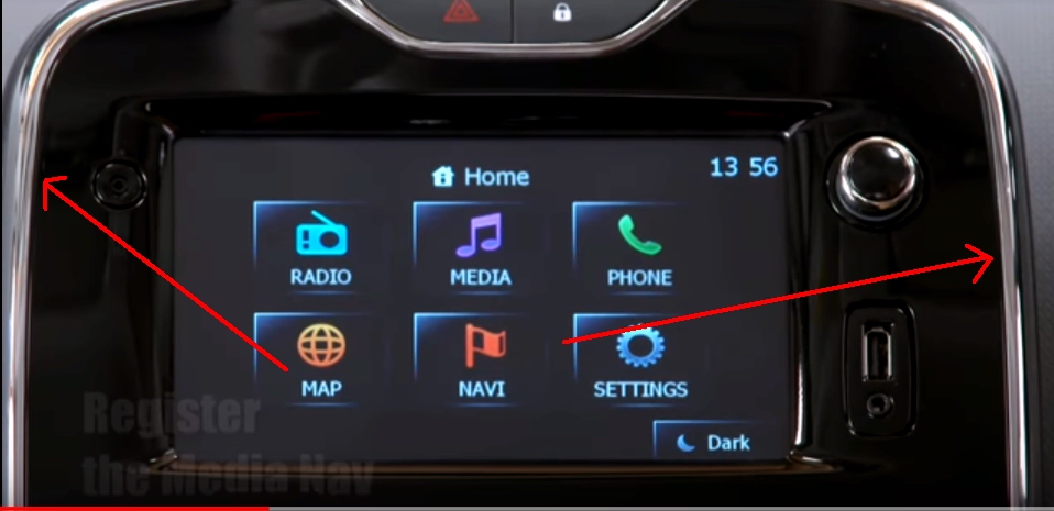

I have just found this on youtube, quite handy video is - I dunno what a bojo tool is but I dont have one anyway :)

Swap it with a 66 plate onwards with the Matt finish looks much better than the tacky chrome.
There was a facelift surround with the much nicer centre vents that went for £25 last week on eBay I just missed it for our banger
thanks for replies everyone - the dealer peeled off all the peeling chrome and left it with the white plastic underneath - dont look too bad actually now - i suppose one day I could still change it.

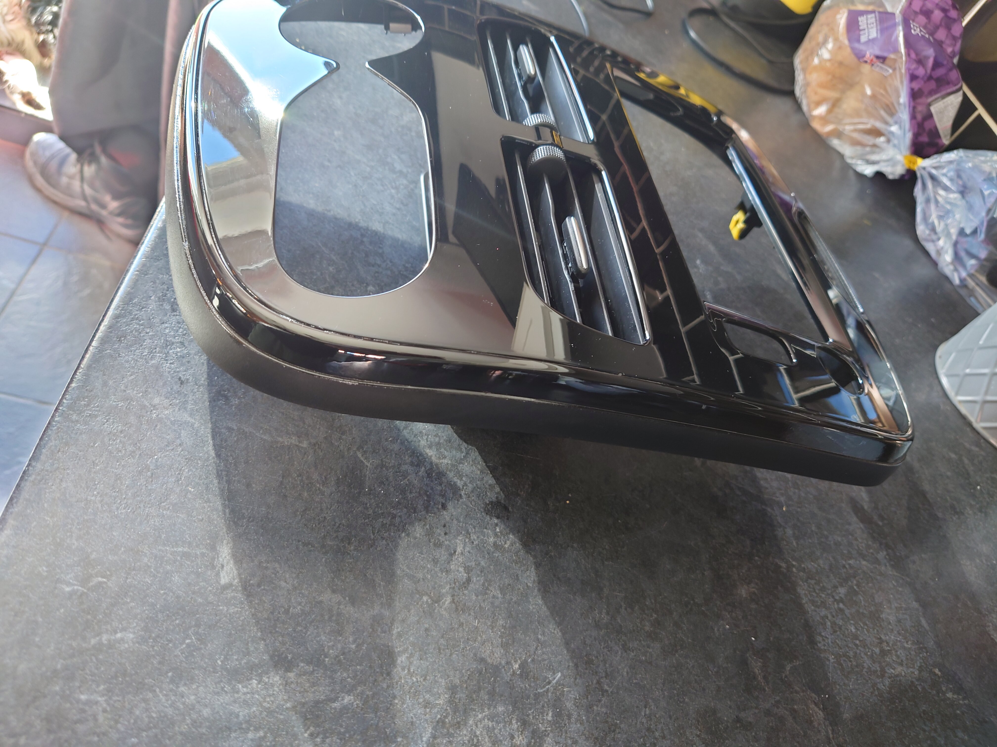

Old thread but should you too stumble across this common problem, I found it best to use a general hosuehold degreaser (elbow grease) and spray it on the chrome trim, then letting it soak in. This bubbled the trim and allowed it to be removed pretty easily using a plastic scraper (Plastic bike tyre leaver). All of this done with it removed from the car. Still required a bit of patience but looks far better than before.

Hi, I had the chrome issue. Cleaned it off using Cif and some places a 6" rule to scrap.
Masked it and sprayed with Plastikote Gloss Black.
Needs a sand down and re-coat but it's do-
able
