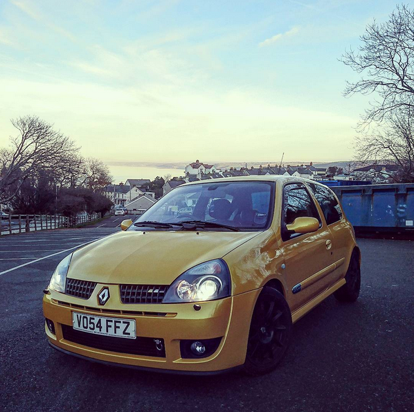

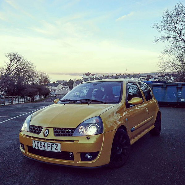

Funny enough iv just bought this. And it is in really good nick. The service history is full Renault, even the belts. I knew about the history before buying and got it for a good price. I do plan on giving it some love. It’s also having a forged engine put in at some point next year, along with a turbo setup. But no joke, it drives beautiful. It’s a credit to previous owners. No doubt given to a garage at some point who pulled the wool and fitted whatever they could find.

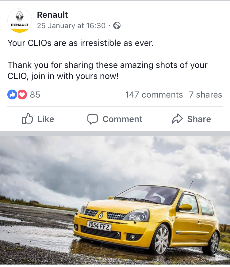

Strangely enough, the official Renault facebook page posted this the other day (the page with nearly 19,000,000 likes ?)
