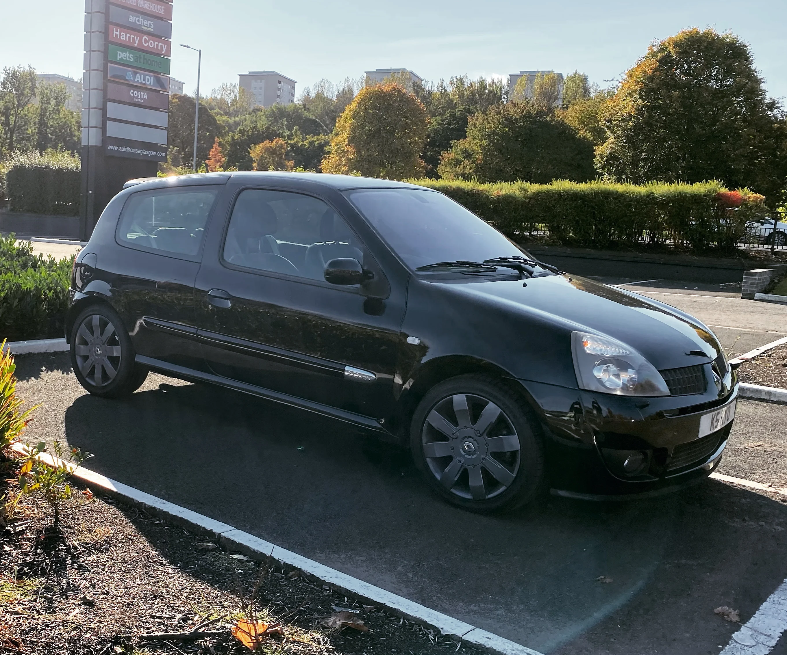

Just starting this thread off as I've recently acquired a Clio 182 after looking for the best part of 9 months for the right one. I'll update with a full introduction of myself and the car along with my intentions but for now here are a few pictures and some idea of what I've done, going to do and wants for the car.
2004 Black Gold 182 with Cup Suspension option? (need to confirm hub spacing as the spec sheets suggest it was an option on the car)
Scorpion Srn019 ? (single back box)
Royal Retrim With Yellow center marker
List of things done over the past month
  • Retrofitted a Cup Spoiler
  • De fluff Alcantara
  • Gutter and Rubbers scrubbed
  • Cleaned out engine bay scuttle
  • AUX Belt & Pulley replaced due to failing pulley
  • replacement rear boot struts
  • Replaced Dash inserts back to Standard
  • Small Front Plate
List of Things to go on the car
  • Bluetooth phone/ iPod Integration for standard Radio (more on this to come)
  • 172 Black Seatbelts
  • Replacement Centre Console Radio Display
  • New Battery Terminal Cover
  • ReplacemenLower Front Bumper Grill
Maintenance Tasks to do
  • Full underside clean and underseal with Bilt-Hamber products
  • Protect the plastic/rubbers
  • Inspect internal rear quarter panels
List of things I want for the car
  • Coilovers B14's? (something for the best road use)
  • Turini Wheels
  • New Exhaust System (quieter the better)
  • Replacement ECU Bracket.

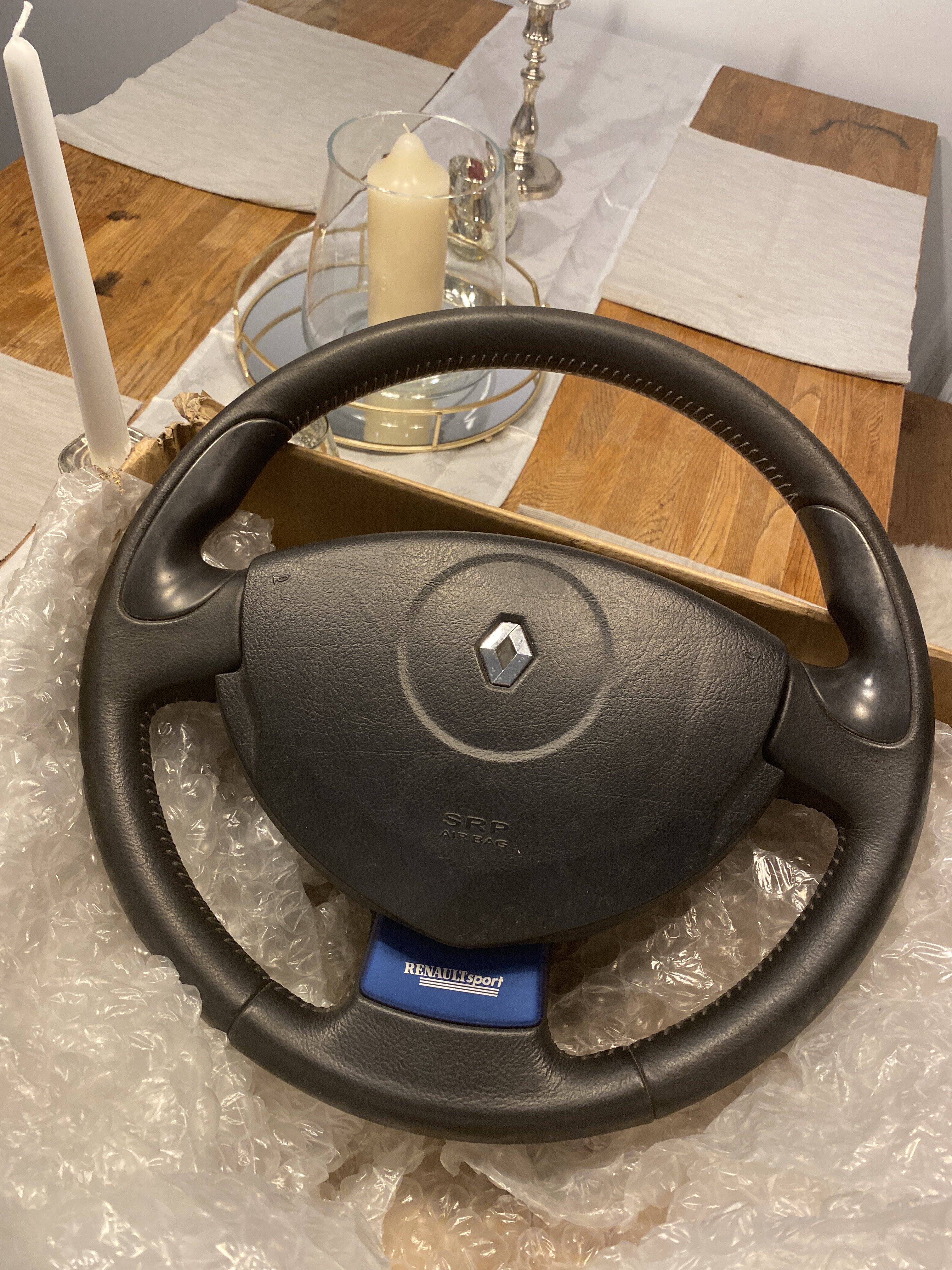

Picked up an original good condition 172 Steering wheel courtesy of @Braveheart

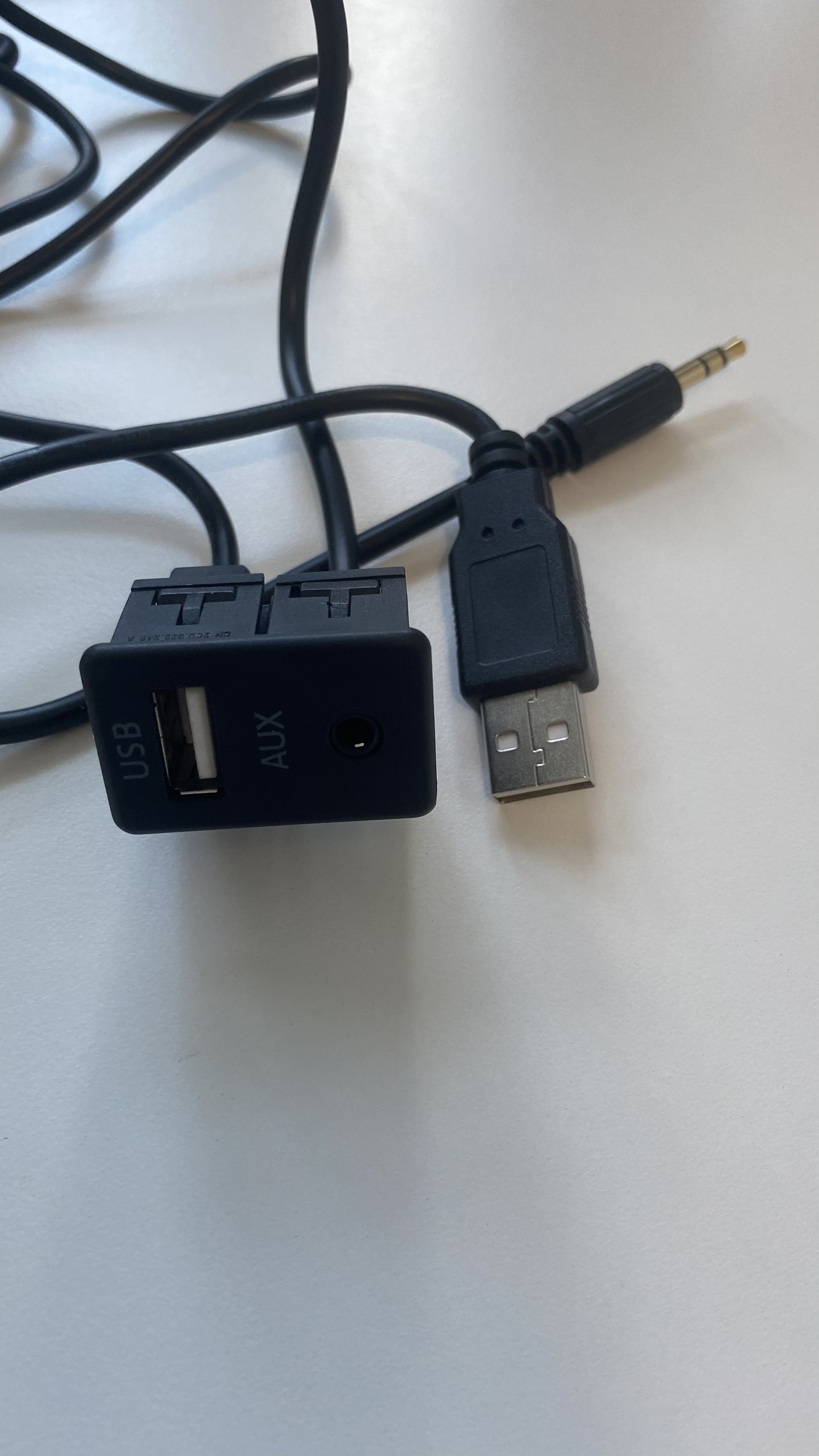

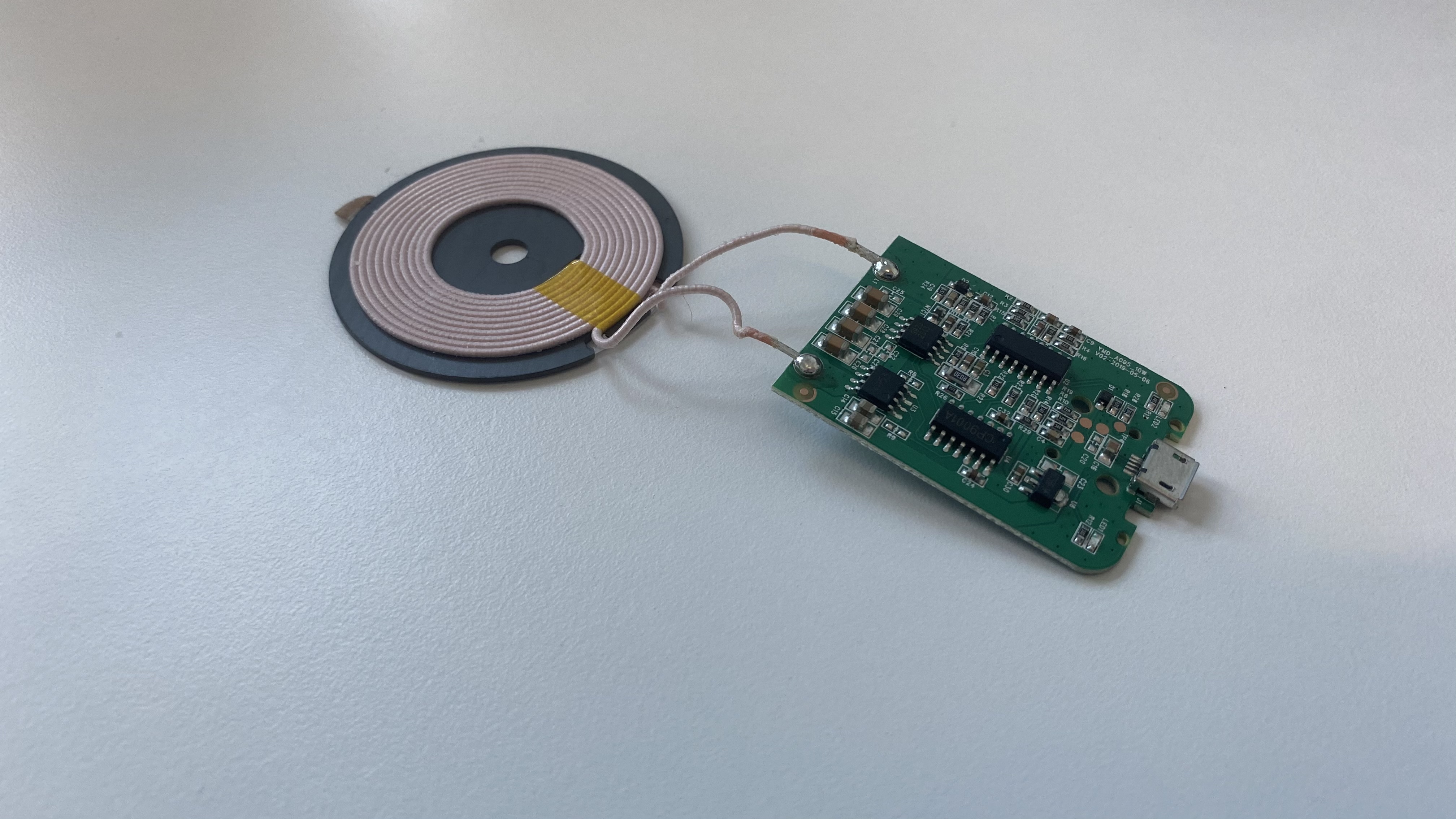

Small update today- few things arrived in the post .
1)USB 5w wireless charger internals.
2)USB & Aux connection and plate
Plan is to modernise the interior and add wireless charging and usb/ aux input along with Bluetooth for calls and music all whilst looking OEM.

Cars looking nice and like the plans. Interested to know details on the wireless charging plan if you don’t mind, where the bits are from etc.
ksixx
@PP172 not a 100% sure yet, thinking of mounting it somewhere like the top dash behind the centre display or make a fitment of somesort for where the ”cup holder” are. Got them of ali express few quid each.

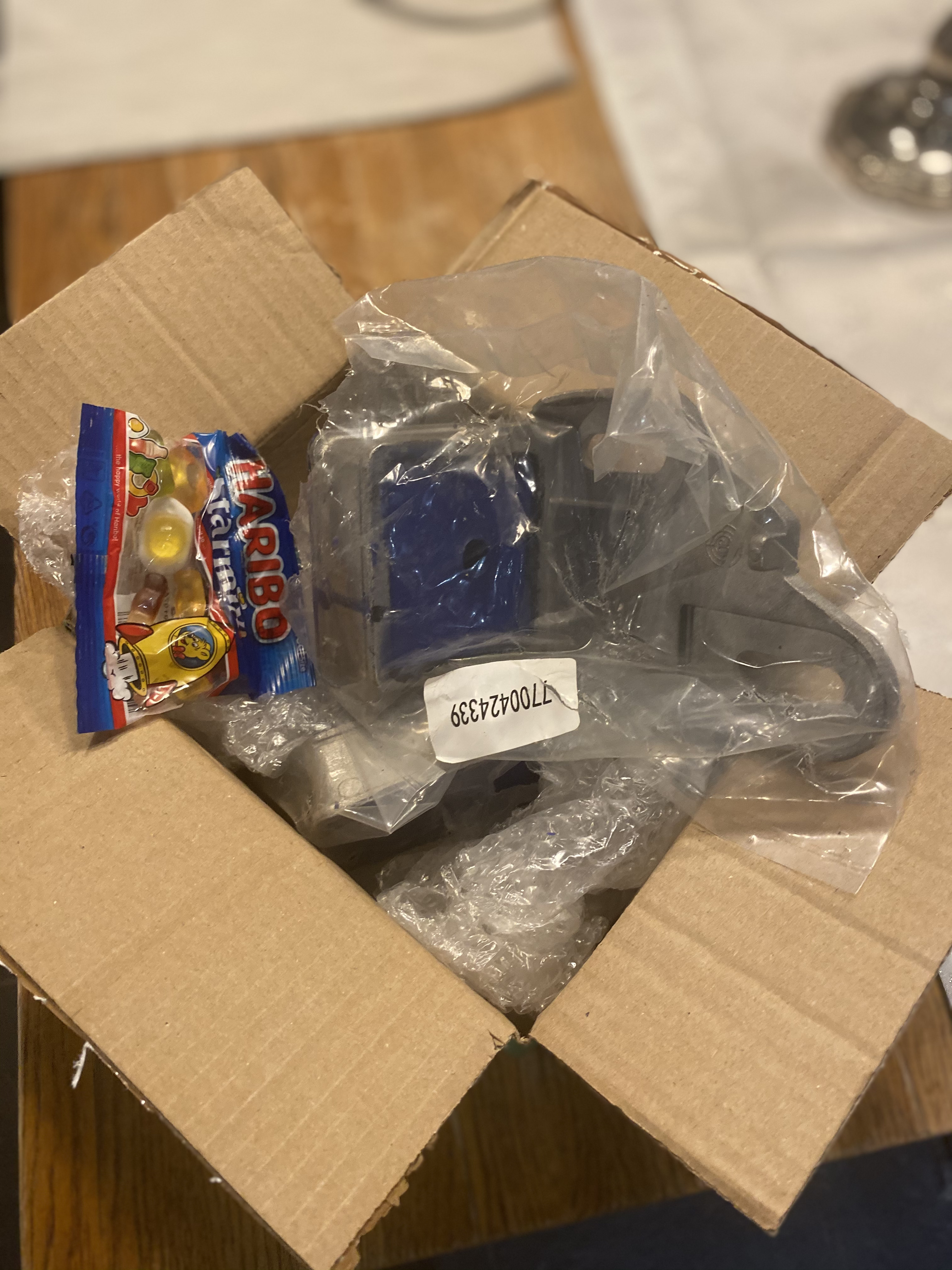

Parts are starting to pile up for the little clio. Newest arrival this week is polybushed exhaust mount kit from BBT Motorsport.
Will go nicely with my Christmas present to myself the Scorpion 192 thats all boxed up in the garage.

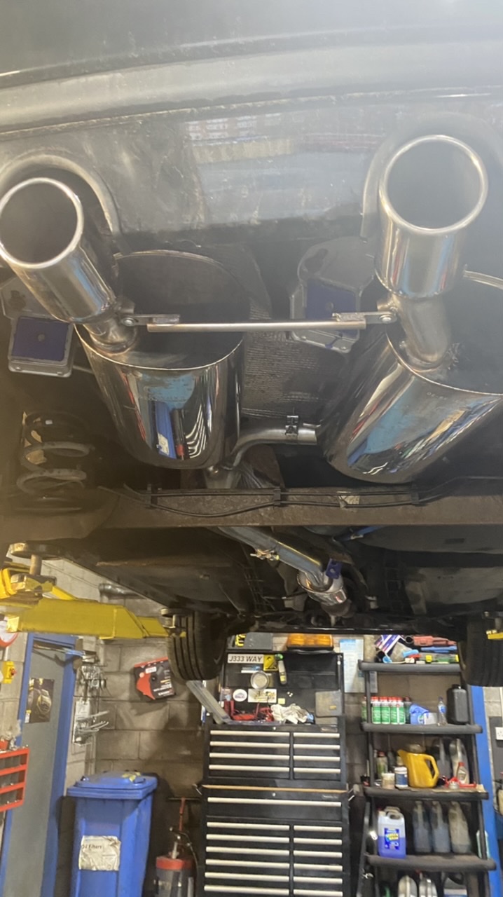

Any tips on removing aftermarket exhaust?

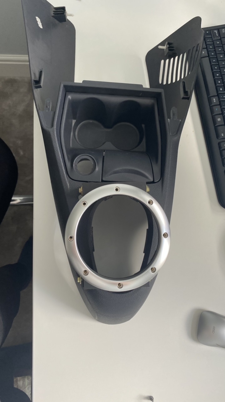

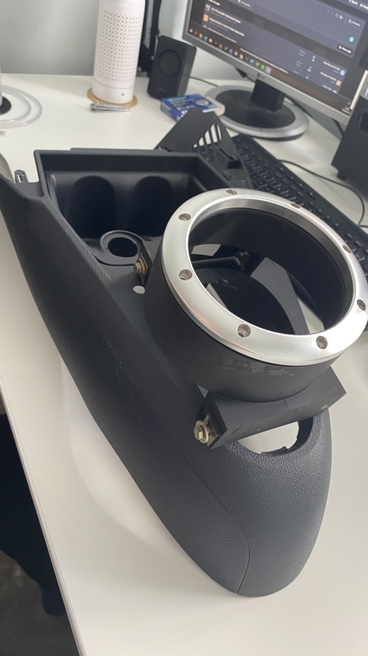

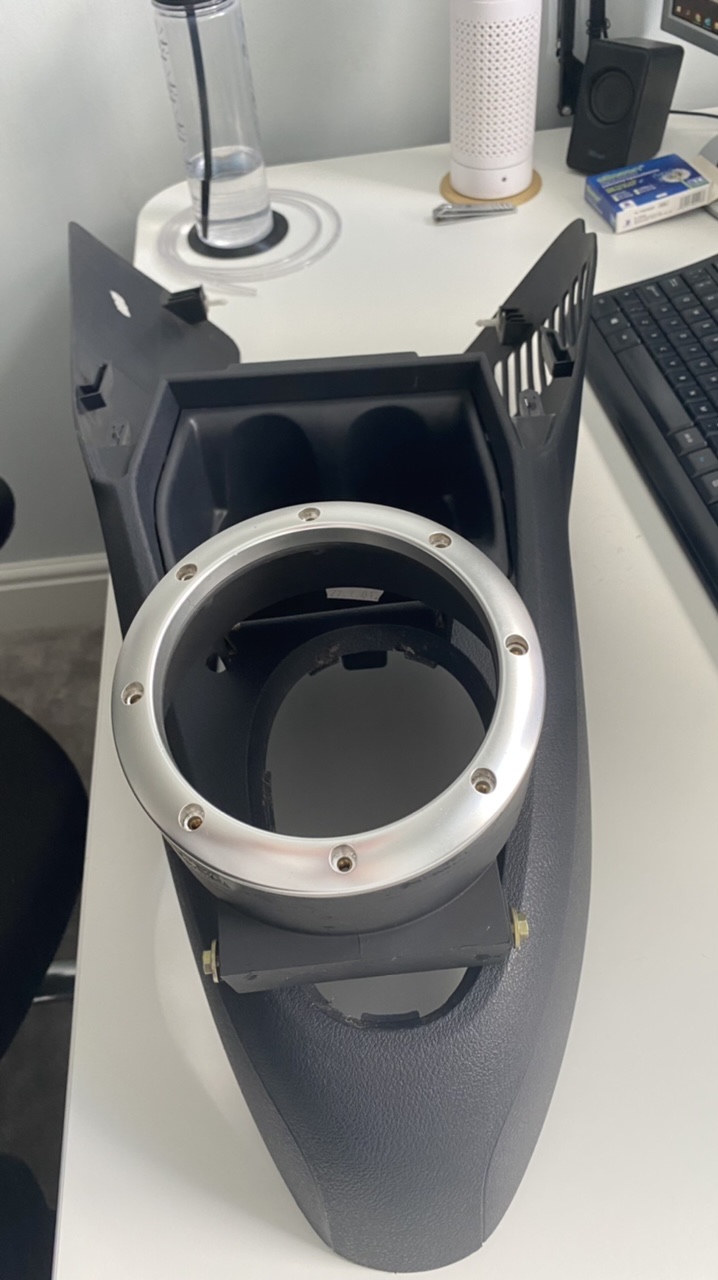

Mini project for this weekend🤯
is to look into making my own v6 inspired lower centre console, have anyone else tried something like this?
Picked up a spare centre consle end of last year and was intending on painting up similar to V6 anyways and then thought about gated manuals etc and the adaptor plate you can get for the MK1 Audi TT and then 🤯BAM🤯 it came to me! to use the gear base from a TT MK1 to create a similar V6 look.
Will have a play around and then get to the cutting once it looks like it might line up correctly. The idea is to mount from the underside and lose some of the height and then go the painted finish similar to v6, to make it look like one complete unit.
