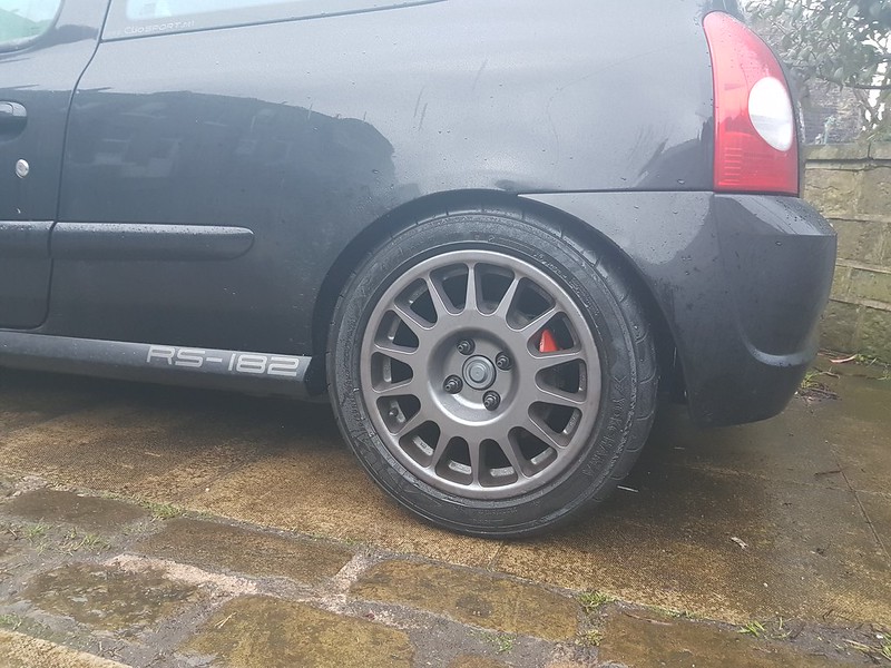

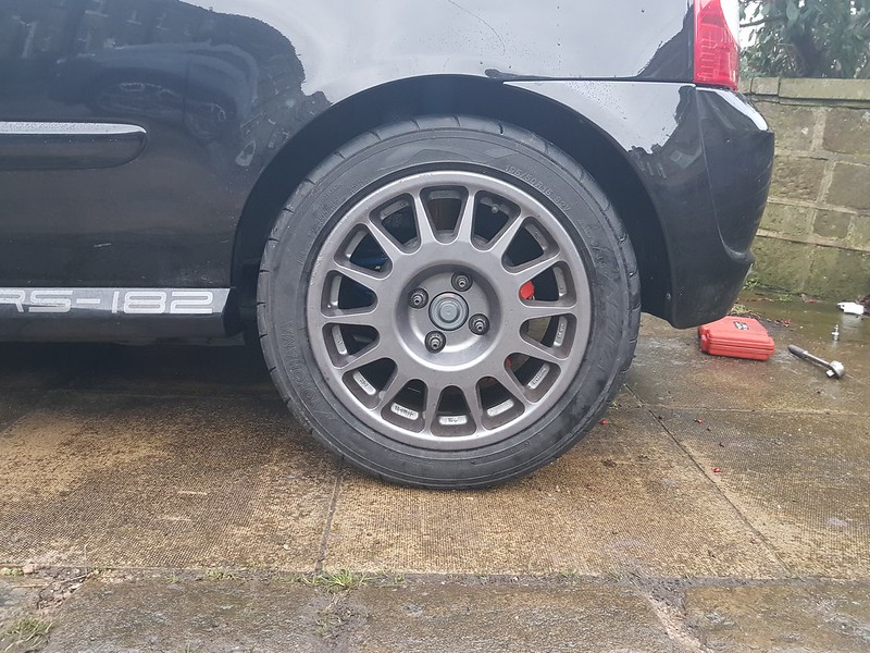

On my journey to work last week I noticed the front end was scrubbing on lock even when at low speed. Having read a fair few threads and when looking underneath today, it was clear it was scrubbing on the part of the arch liner where the bumper bracket sits underneath. Few taps with a hammer and bending the arch liner in has hopefully solved this!
I also adjusted the camber slightly as I was running nearly maximum on both sides which won't have been helping the scrub! Motamec covers are serving their purpose well during these wet January days (even though it's only been a week) .

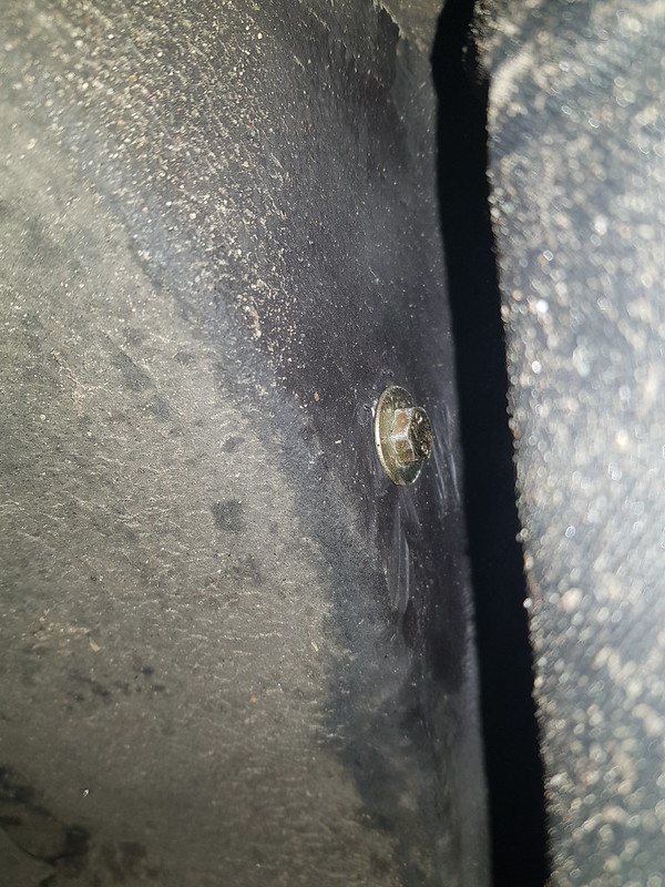

Photo of the gearbox cage turret fix

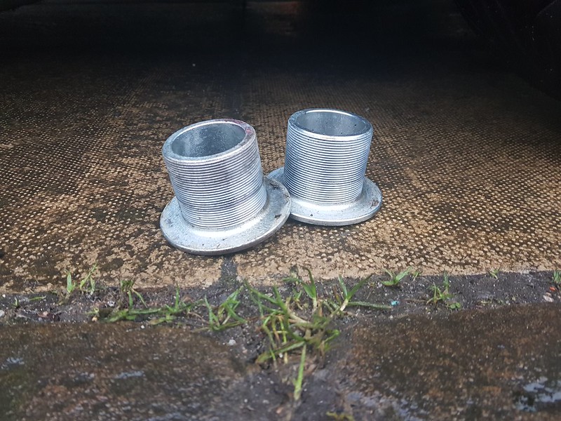

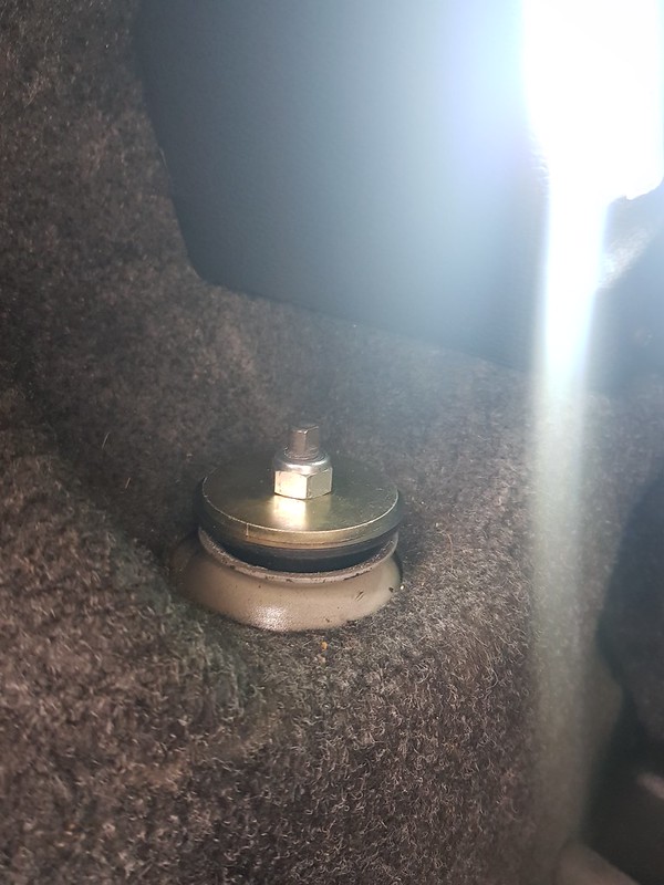

Had no luck finding any M9 x 1 nyloc nuts at any of the major fastener companies, so shot bilstein a message and for the sum of £8 they sent me a pair over. Pricey for a couple of nuts, but worth it! In preparation for knackered rear top mount bushes @George@RTR_Parts sorted me out with some black series bushes. I know they don't do too much at the back, but better safe than sorry.

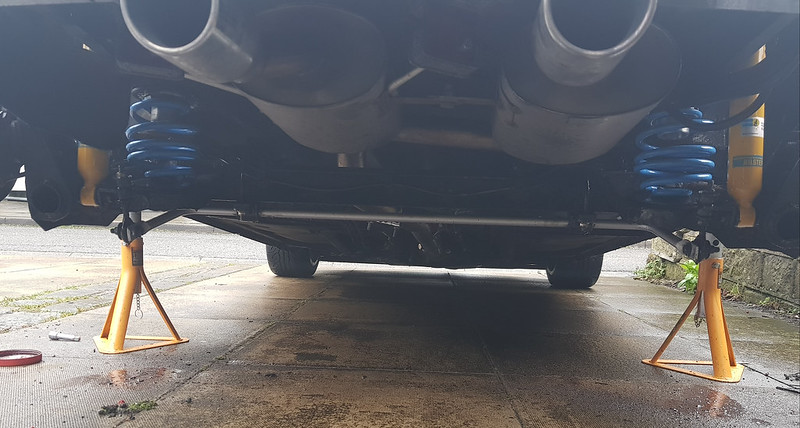

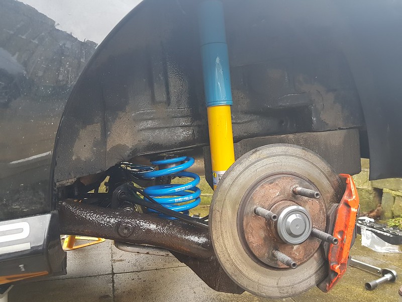

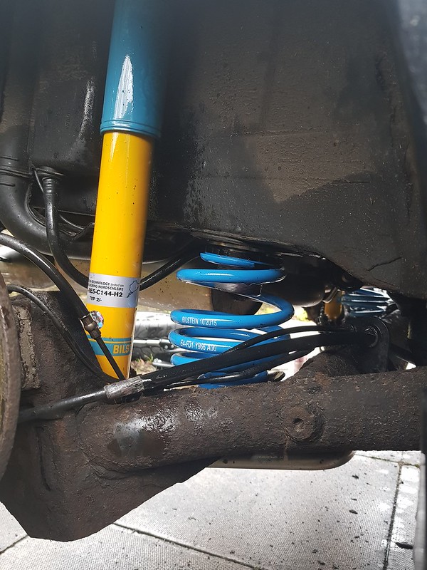

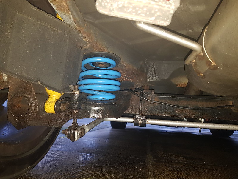

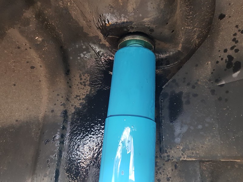

All went relatively smoothly when it came to fitting the bilsteins at the back! I wound the adjusters right back and left both rubber spring pads top and bottom.
20180127_143904 by Louis Walker, on Flickr
20180127_143952 by Louis Walker, on Flickr
20180127_143932 by Louis Walker, on Flickr
20180127_143916 by Louis Walker, on Flickr
Everything received a coating of ACF50 in order to keep it all tip top and rust free. Vital at this time of year!
Whilst I had the back end jacked up, I straightened up the exhaust (Tips just need raising up now) and I fitted some 3/8 nuts to my U clamps from the whiteline ARB. I had been running metric nuts but they kept loosening off. This all got doused in ACF50.

I havn't had chance to actually drive the car, but i'm hoping it settles more and no longer scrubs! I intend to lower it slightly more at the front end, but I don't want it to be completely undriveable as the roads around here are pretty bad with lots of speed bumps.
The rear end sits pretty high straight off the jack!
20180127_161518 by Louis Walker, on Flickr
20180127_161522 by Louis Walker, on Flickr
The rake looks pretty good, so fingers crossed after a drive it sits nicely.
20180127_161503 by Louis Walker, on Flickr
I will just keep adjusting it until I get it sat perfectly, then i have some other bits and pieces to do before I take it in for alignment. Can't wait for nice warm days to come :smile:

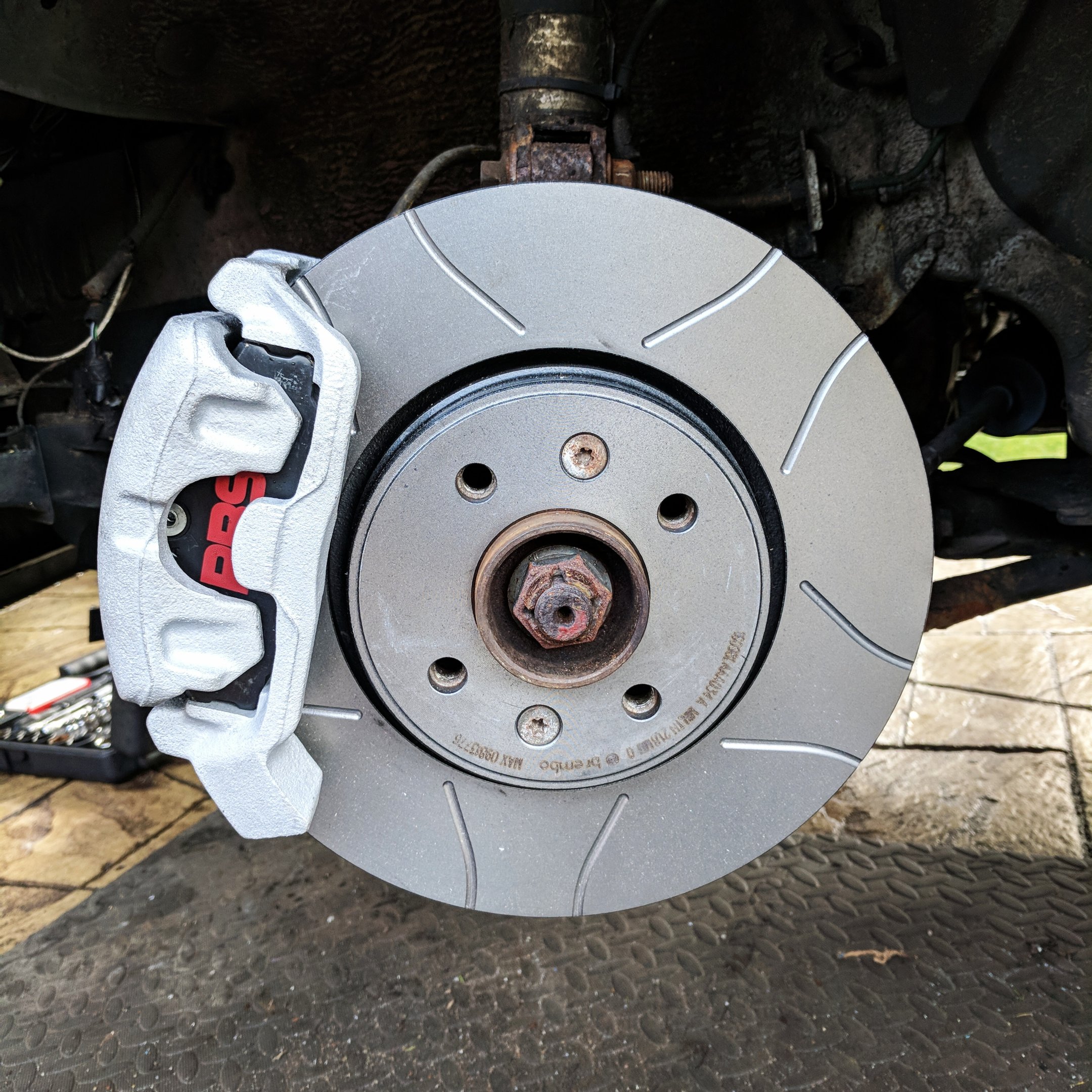

Fitted my rebuilt calipers too with new PBS pads.

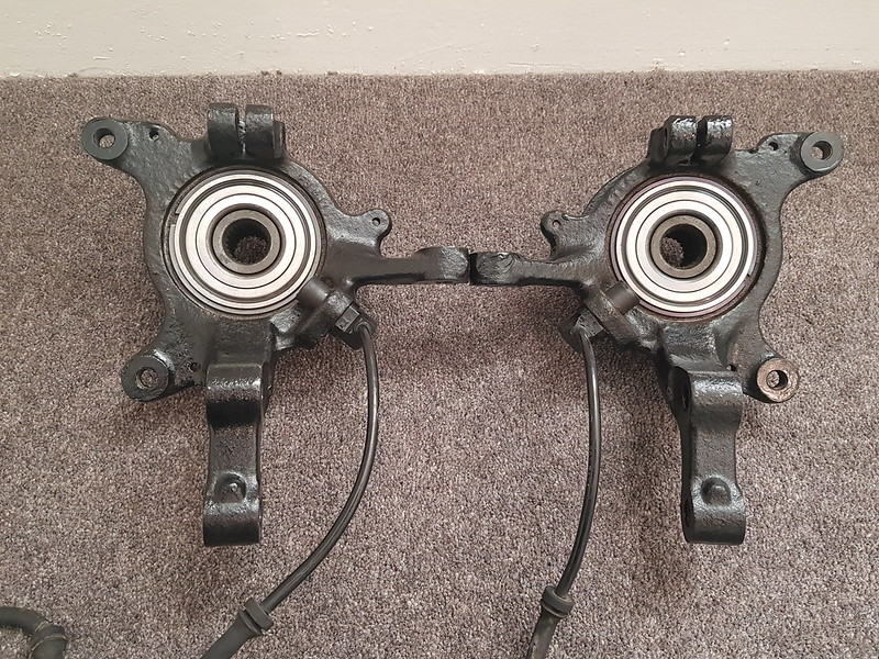

Popper over to @overboost and had some new SNR bearings pressed into my previously painted hubs. Andy struggled with removing the old bearings, but I had soaked them in deox c, then left them for a few weeks so led to believe that seized them up more! He got there in the end, so happy days!
20180204_093410 by Louis Walker, on Flickr
I then used Sunday to fit them onto the car. My current bearings seemed absolutely fine, but I wanted to get them changed as I don't know when they were last. It would just be my luck that i'd go for tracking, then a few weeks later the bearing would need doing.
20180204_162411 by Louis Walker, on Flickr

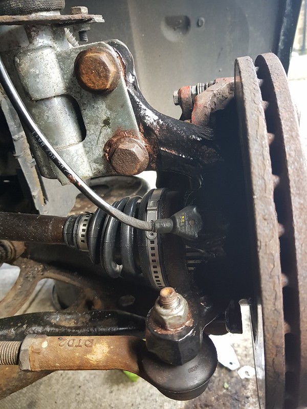

Whilst there I changed the offside driveshaft boot. Just a cheap JR one, but seemed to do the job! Old one was split slightly and the grease inside looked fairly old and very green.
20180204_150111 by Louis Walker, on Flickr
I swapped over the studs from the old hubs which came out surprisingly easily with a blowtorch and the double nut method. Cleaned the threads out on the new hub flange then re-threadlocked the new studs in. Had to wait for it to cure, so tucked it all up and walked to work the next day.
20180204_172454 by Louis Walker, on Flickr

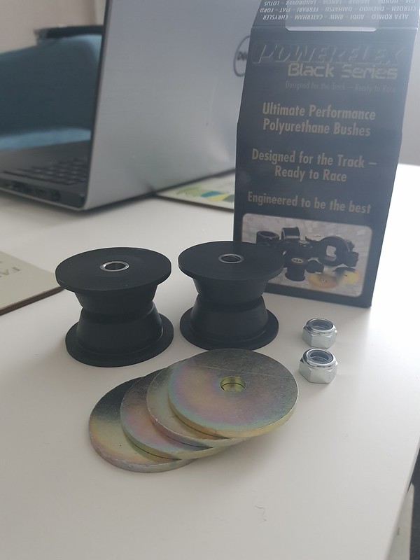

I'm going to press in the black series wishbone bushes tomorrow at work, then get them fitted this weekend. Hoping to get booked in with bramracing on Monday as i'm travelling to wales on monday and want all the alignment to be spot on! Going to remove the rear spring adjusters as it's quite high still. Not sure whether to remove the black adjuster part or the other threaded section?

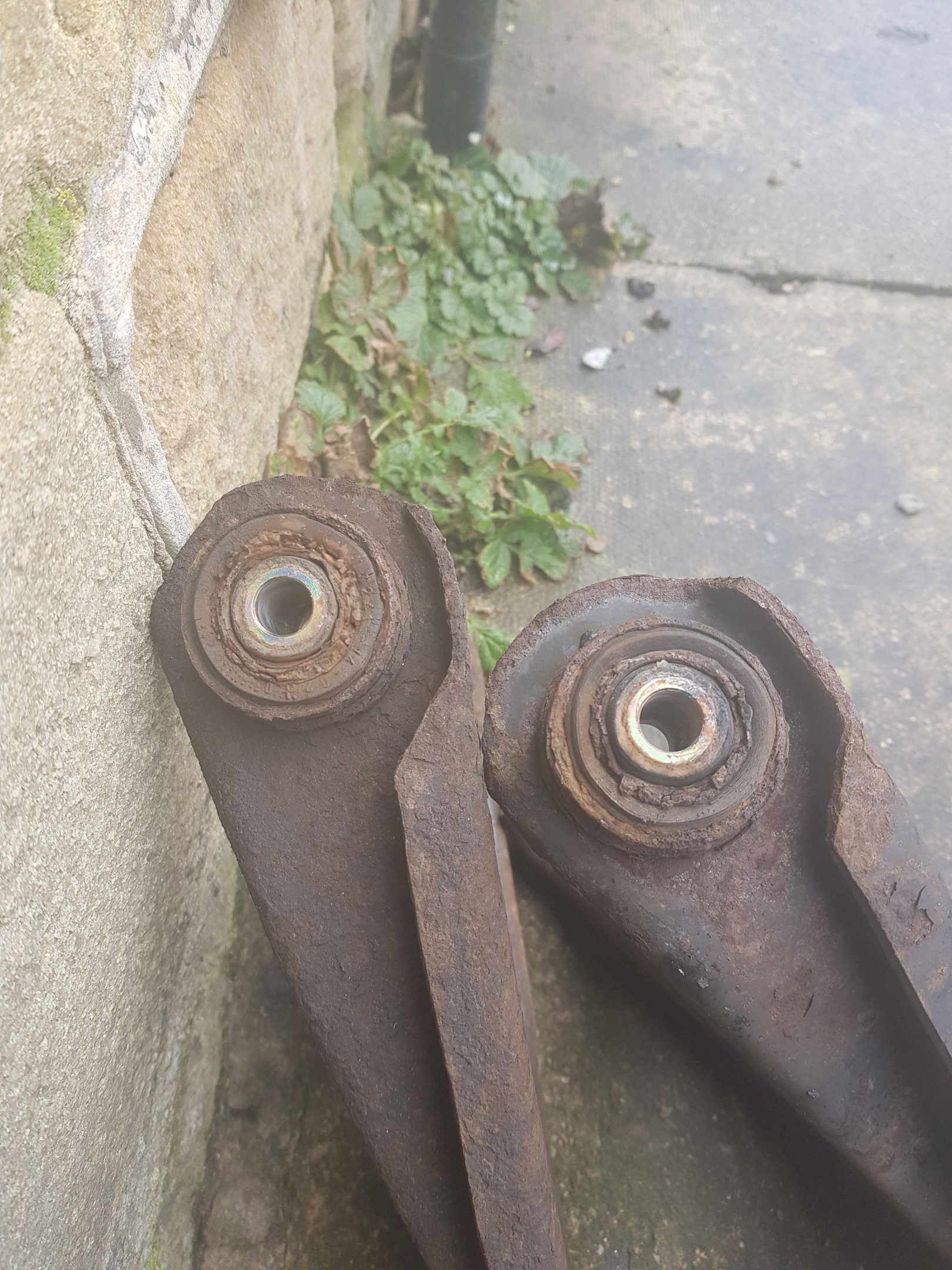

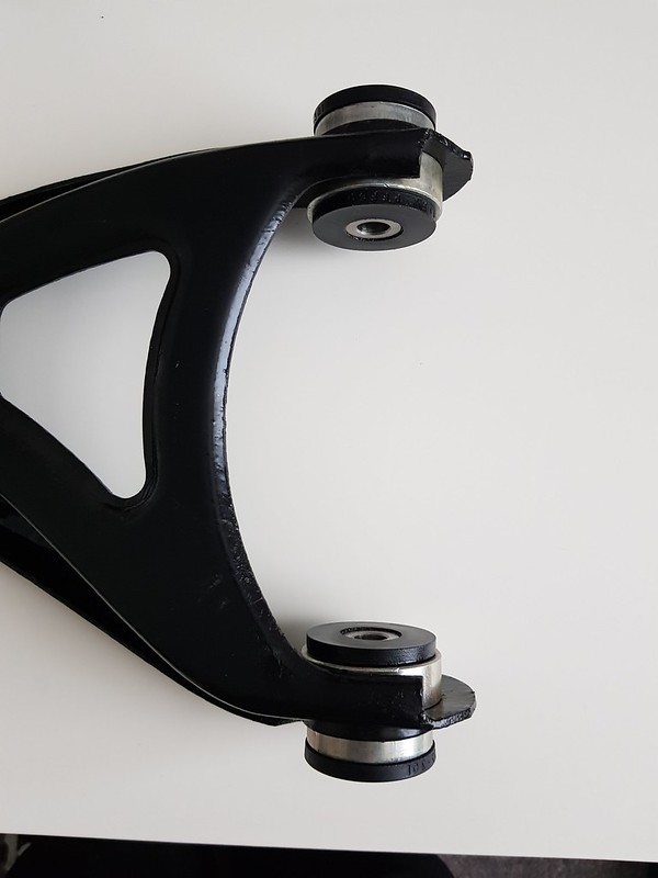

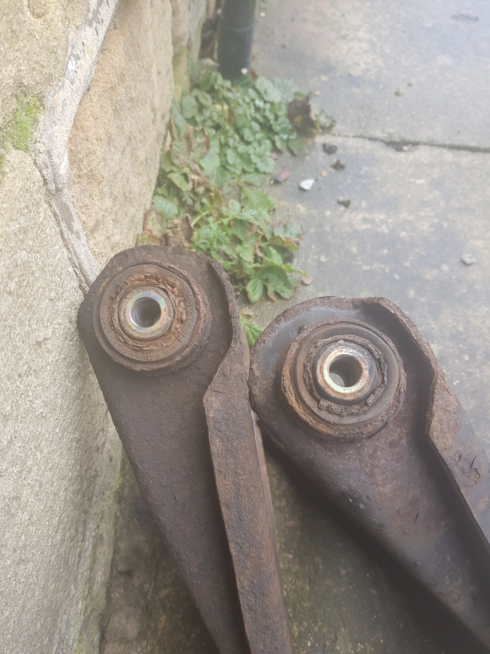

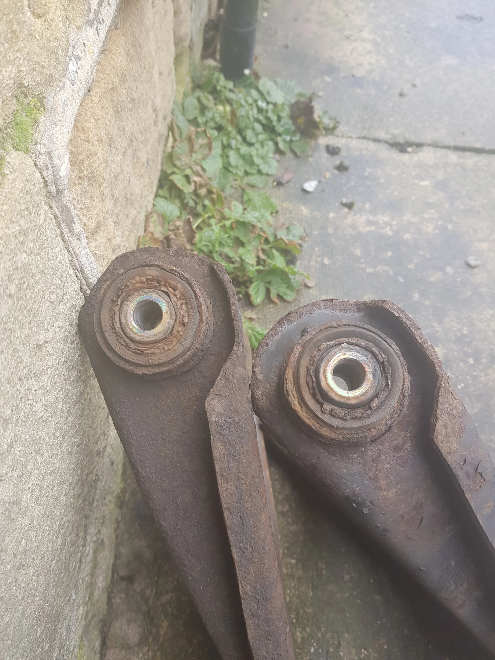

Wishbones that @Dr Jekyll kindly sent me had the old bushes removed and new black series ones pressed in at my brothers work. These were again sourced through @George@RTR_Parts. Highly recommend him for parts as they are usually better priced than other places and have such a quick delivery turnaround!
They also had a quick lick of paint prior to the bushes being pressed at an attempt to keep them looking good! Won't last long in this weather 😧

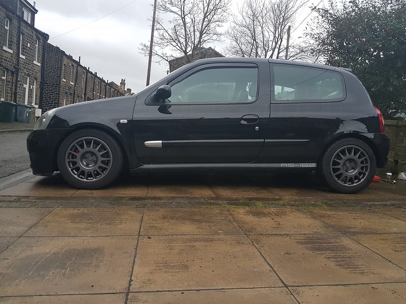

After letting the rear suspension settle for a couple of weeks I decided I wasn't very happy with the height and decided to remove the threaded collared part of the adjuster. Simple enough job, and I just removed the rear top nuts as I wanted to avoid removing the bottom bolts as aligning the ARB brackets is always a proper pain. (Excuse how filthy the underside is).
20180210_162355 by Louis Walker, on Flickr
20180210_162414 by Louis Walker, on Flickr
And the height after a few minutes of it settling off the jack
20180210_162949 by Louis Walker, on Flickr
20180210_162941 by Louis Walker, on Flickr
Better! Hoping it'll settle a little bit more, but it's pretty perfect now. I'll be raising the front coilovers slightly (3-4mm ish) tomorrow as the scrubbing is getting annoying.

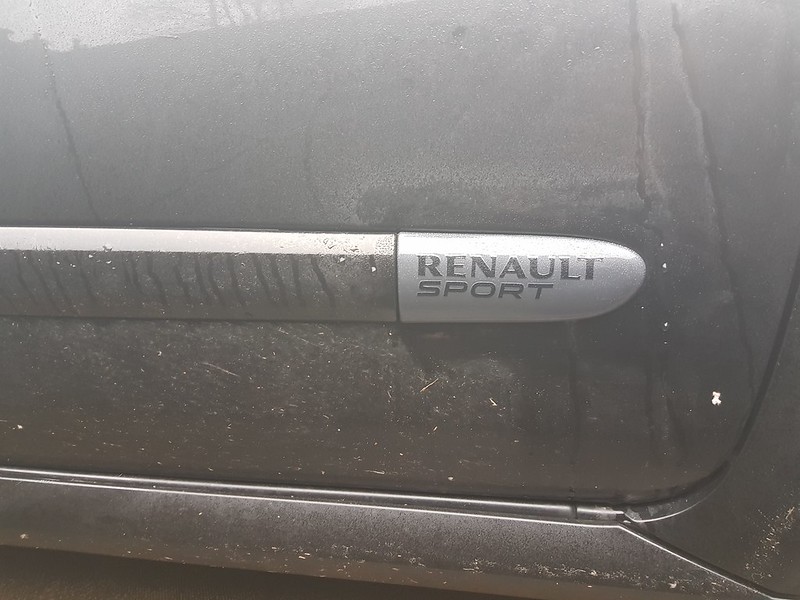

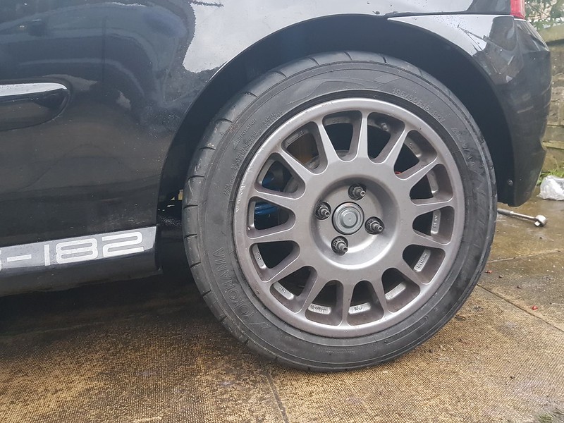

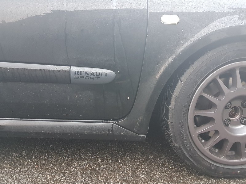

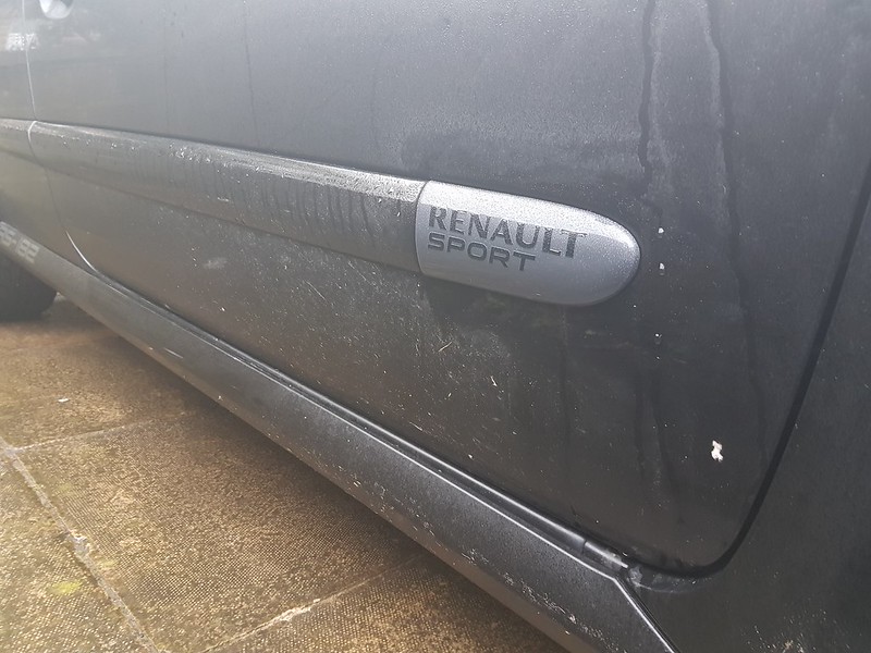

Another thing I ended up fitting are my freshly painted bullets. At the minute i'm not sure on them! In daylight they're more bluey grey than I was hoping/expecting them to be. I had wanted them to match the 2118's or the rear skirt decals but they do neither.
Have to see how they look when the cars clean. The nearside one snapped a clip which was annoying so i'll be double sided taping it on. If they don't grow on me I will likely sell them on and start over on some new bullets.
Opinions welcomed!
20180210_162745 by Louis Walker, on Flickr
20180210_162739 by Louis Walker, on Flickr
20180210_163045 by Louis Walker, on Flickr

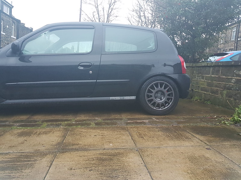

The ride height looks absolutely spot on now!! Love how that is sitting................... bullets, ummmm to be honest they don't look bad at all there, got any other pics at different angles?
Louis
I Love Ed Sheeran
Once it's all setup properly and had a decent wash i'll get some proper photos of it. Many of the ones I take on my bit of parking are pretty unflattering!
Here's another pic
20180210_163059 by Louis Walker, on Flickr
It's just how they're a completely different colour in daylight that's thrown me! They look identical colour wise to the wheels when in the house haha
Ahh ok maybe its the photo making it look more like the wheels than they are then, from here looks a good colour match!
Good idea though, especially with the Renault Sport wording - if you can get them looking the same colour, will look great!

Looks great mate and the ride height looks perfect.
I would have to put original side bullets on to be honest but that's me being me, lol.

Side bullets wise, I'm still not sure myself! Quite fancy a change from silver as they don't really match

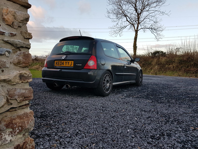

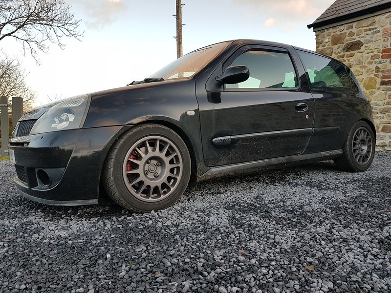

Well we made it! Took around 5 hours, but was pretty good time in the scheme of things. Roads were great, but at times very slippy or icy which was a shame. Followed a transit van who was proper giving it some down the country roads so that was actually pretty fun. Seemed like he knew the roads fairly well, but he was proper chucking it about! Fair play.
20180213_133213 by Louis Walker, on Flickr
20180213_155524 by Louis Walker, on Flickr
I do like Wales, especially when sunny.

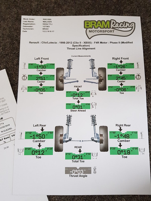

Before travelling down I popped over to bramracing and got my alignment done. Brad took lots of time to ensure my camber bolts were all setup properly, taking it for a drive twice during the setup just to ensure it was settled properly. Unfortunately it still pulls slightly left but i'll be heading back next week to have it re-tweaked. I might take a look at all the sliders as well but they were all replaced last year.
20180212_122044 by Louis Walker, on Flickr
Rear end is pretty straight so i'm happy about that!

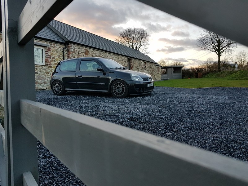

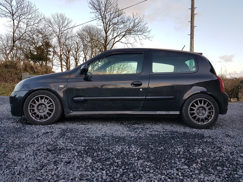

The car's also filthy, but I took a couple of snaps to show the ride height now and the new bullets. They're growing on me actually! Wont get chance to wash it for a couple of weeks now. Love how the car sits and also heard the milltek when Brad took it for a drive and it sounds ace! Proper chuffed.
20180213_170325 by Louis Walker, on Flickr
20180213_170606 by Louis Walker, on Flickr
20180213_171052 by Louis Walker, on Flickr
20180213_170638 by Louis Walker, on Flickr
20180213_170430 by Louis Walker, on Flickr
20180213_170302 by Louis Walker, on Flickr
20180213_170251 by Louis Walker, on Flickr
20180213_165738 by Louis Walker, on Flickr

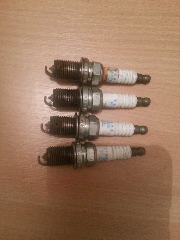

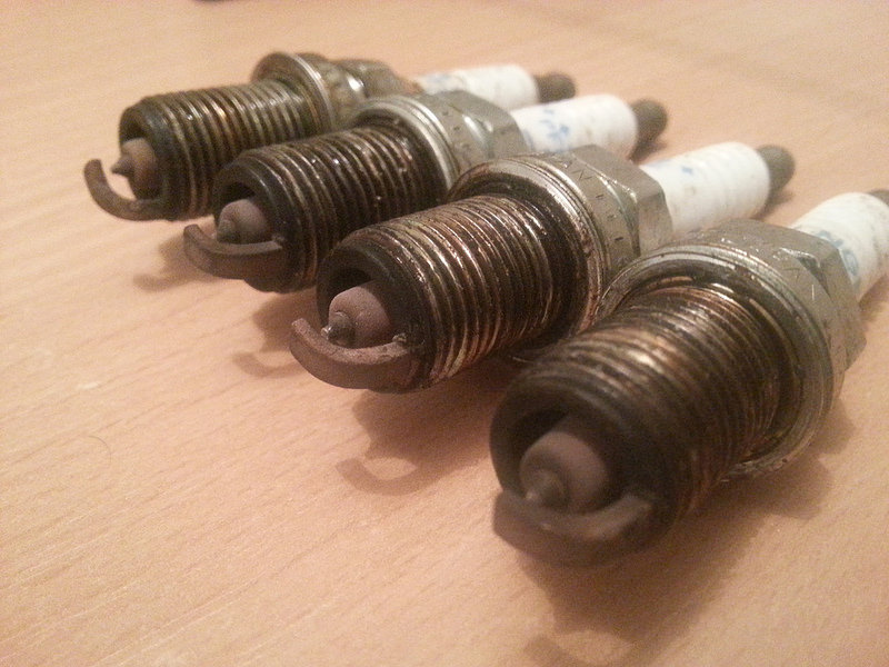

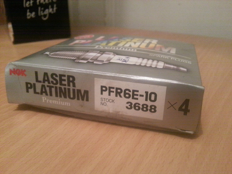

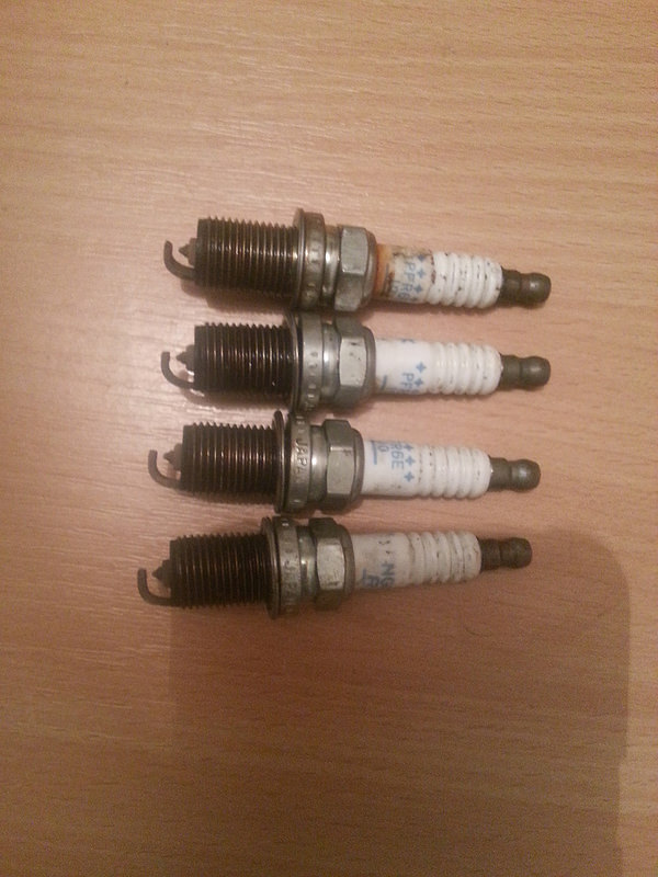

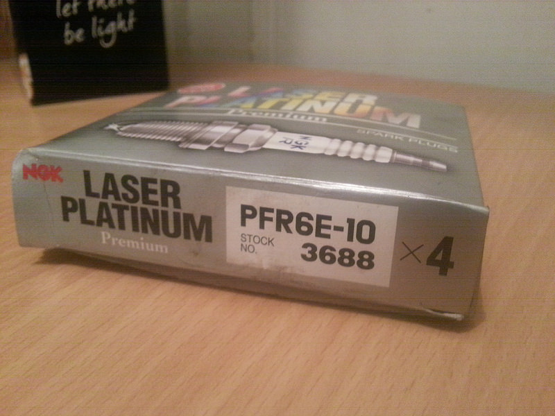

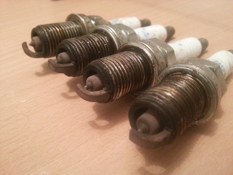

Removed my inlet tonight and fitted my new spark plugs. Had been meaning to do this since I got the belts done, but just haven't had chance although I've not put that many miles on yet anyway!
The old plugs were well worth changing! But was nice to see they were NGK, however old.
View attachment 131299320170310_194325 by Louis Walker, on Flickr
View attachment 131299420170310_194314 by Louis Walker, on Flickr
And the new ones that went in.
View attachment 131299520170310_194346 by Louis Walker, on Flickr
Car started up fine with the new plugs and seem to idle slightly better too. It also seems that the EML light I had earlier has now disappeared! Good old french electrics but I'm counting it as a win.

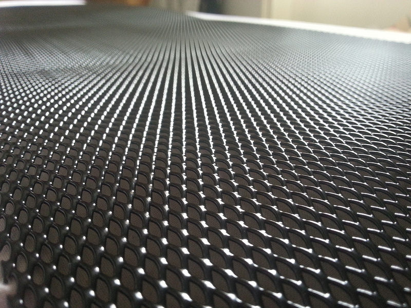

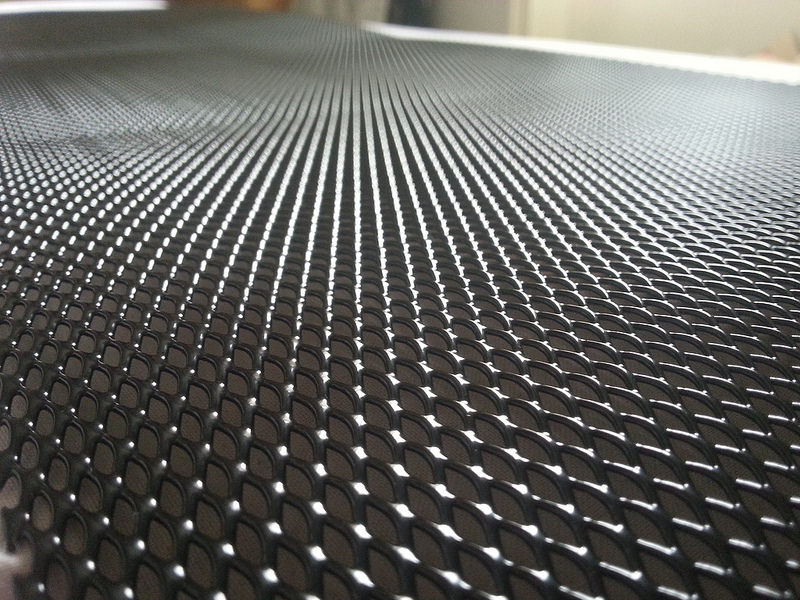

My grill mesh also arrived today from Germany, and i'll get that cut up for my brake ducts in the not so distant future.

Where did you get the mesh grille from, what website?

Thanks chaps! I'm very happy with it now it's raised up 5mm as it doesn't scrub as bad on full lock and sits perfectly.
It's a lovely place and wasn't actually too expensive for 4 nights!

The mesh was from eBay. I believe I just searched for some black aluminium mesh at the time, I'll try dig out the link when I'm back with my laptop.
May have had a link sent by @Dr Jekyll as we split the mesh as there was way too much. I might actually have some leftover.
