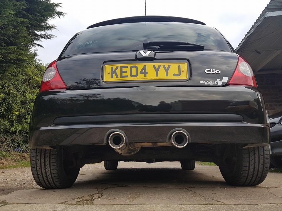

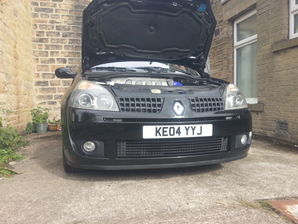

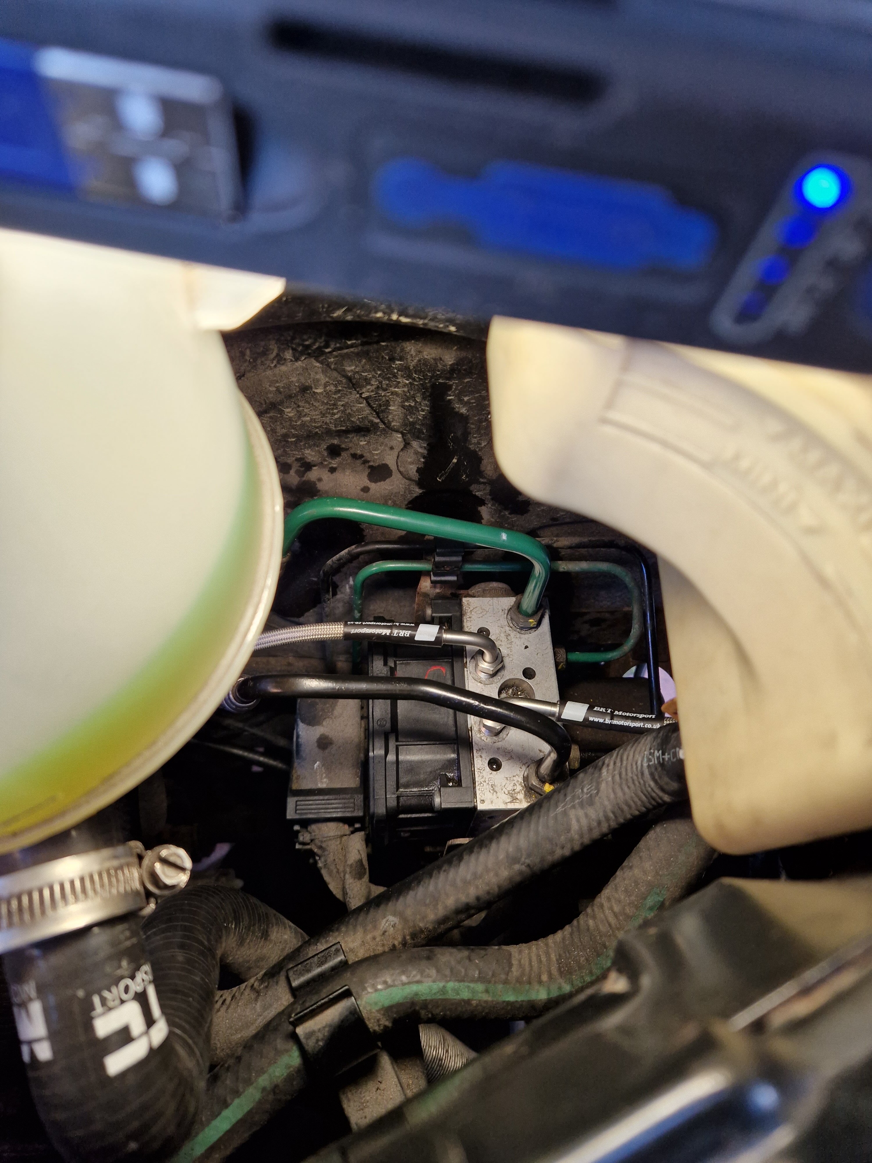

What a day.

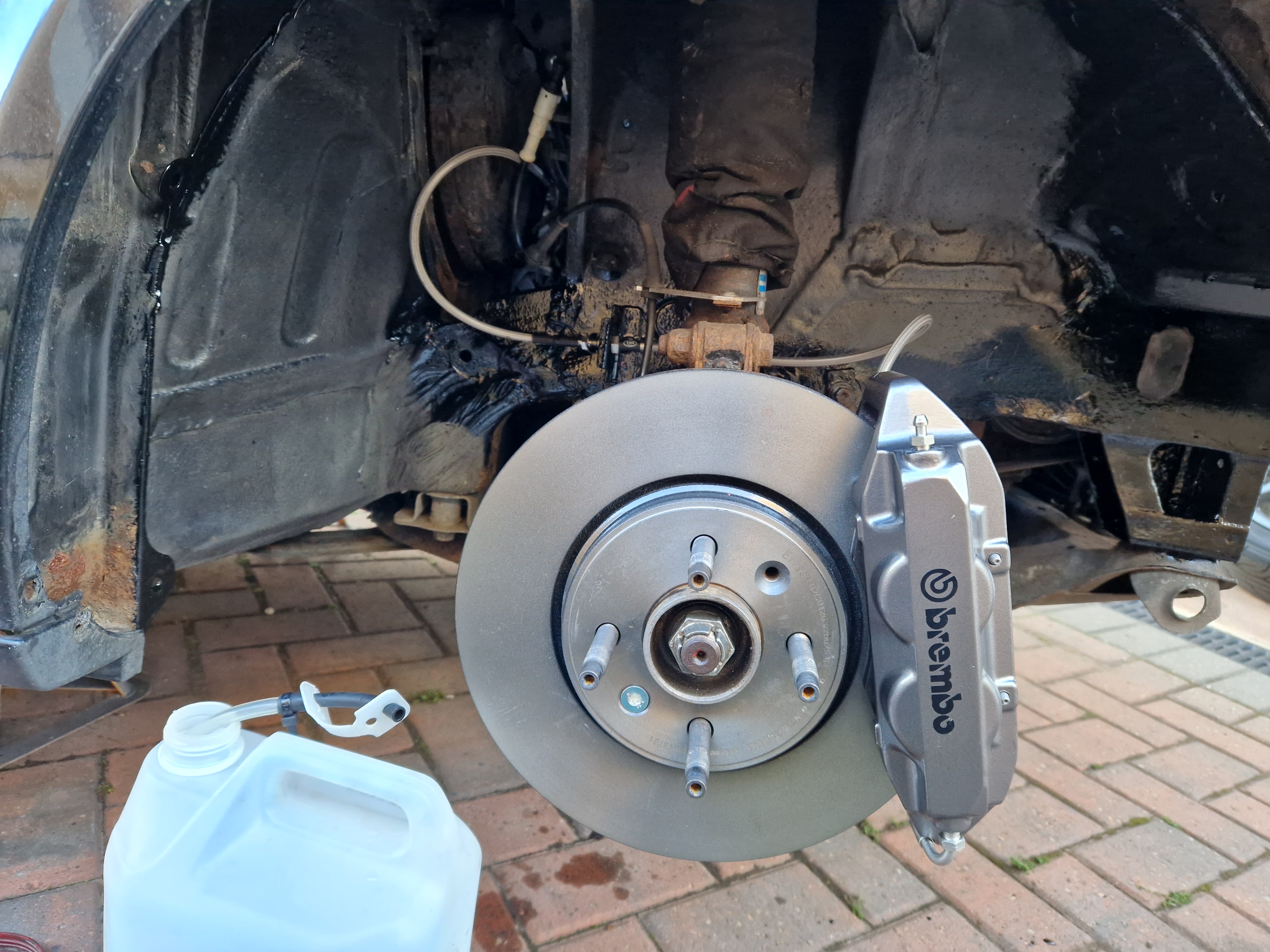

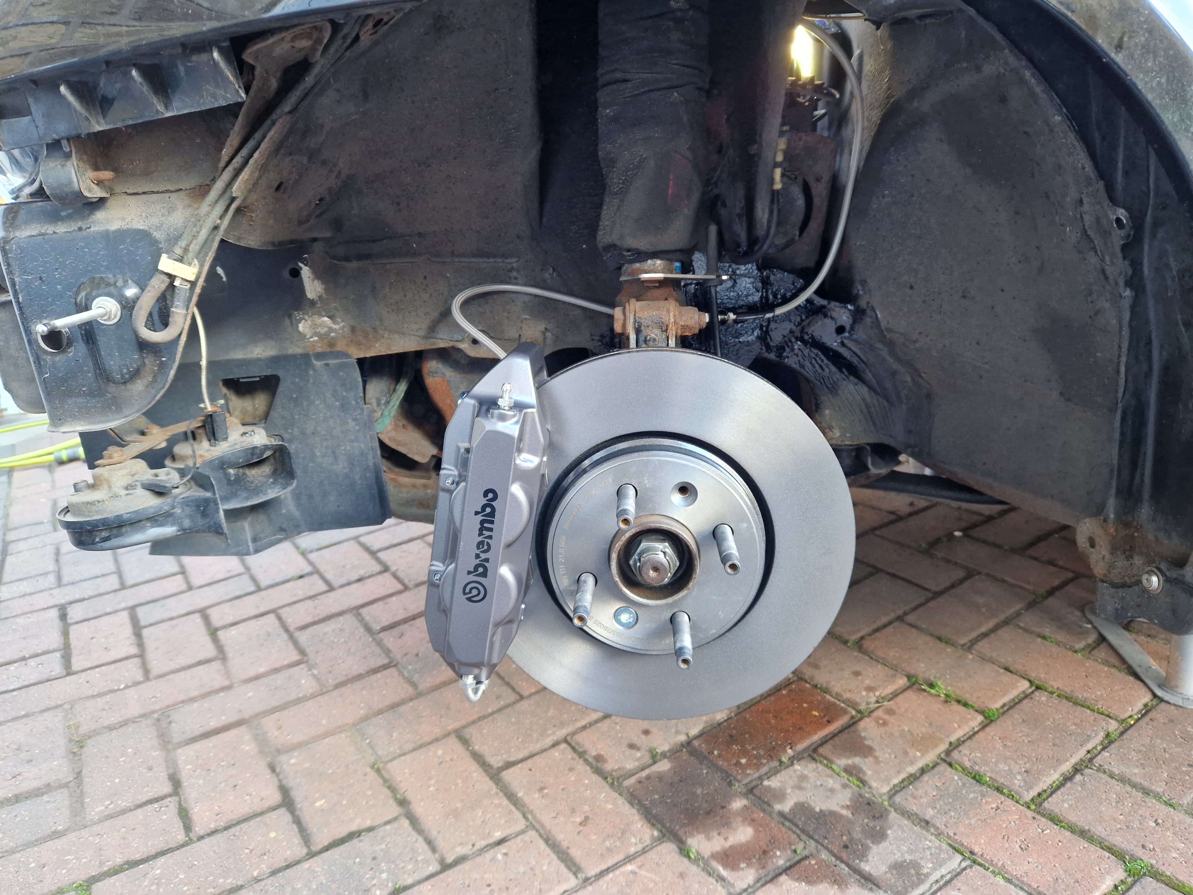

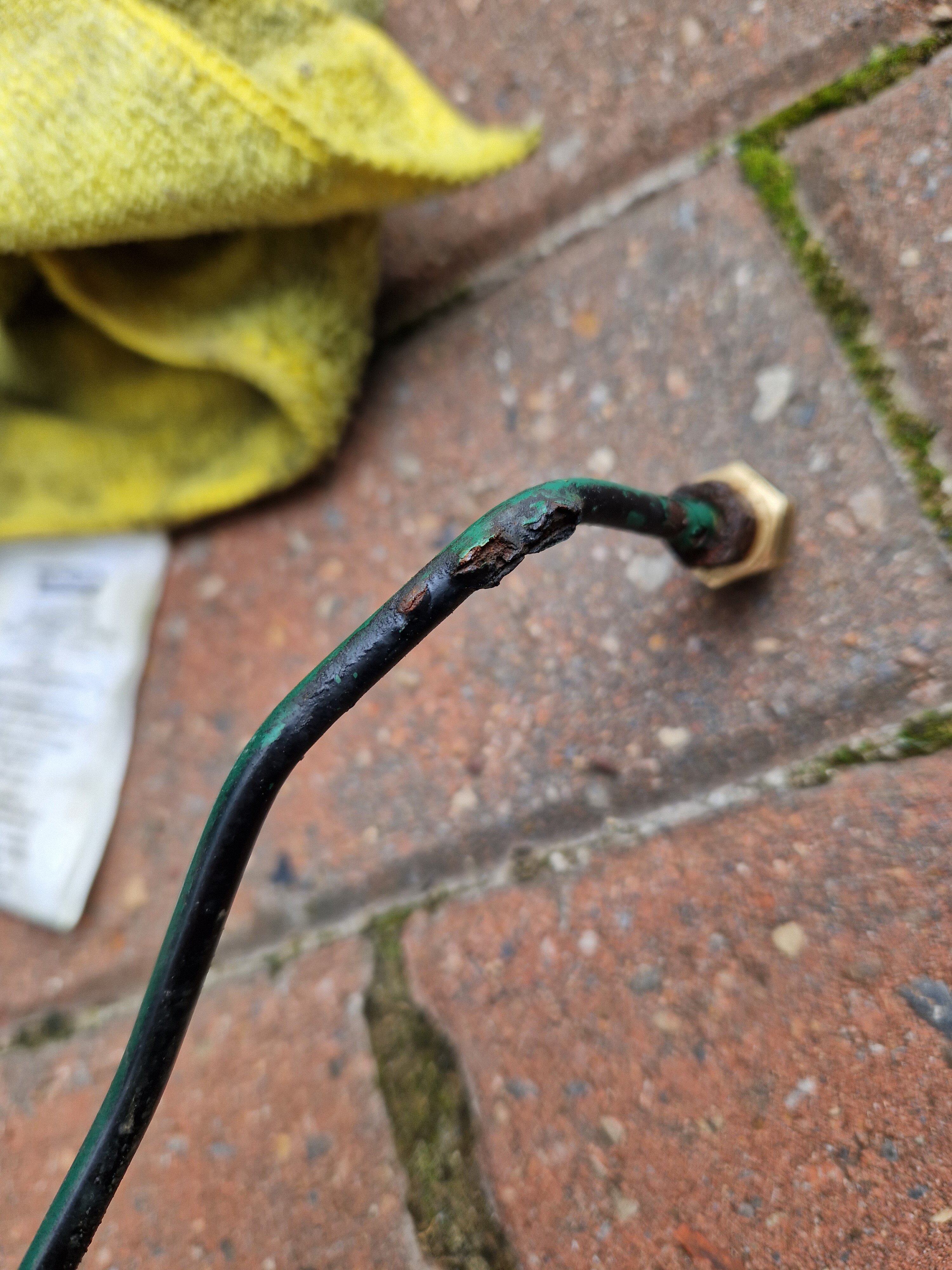

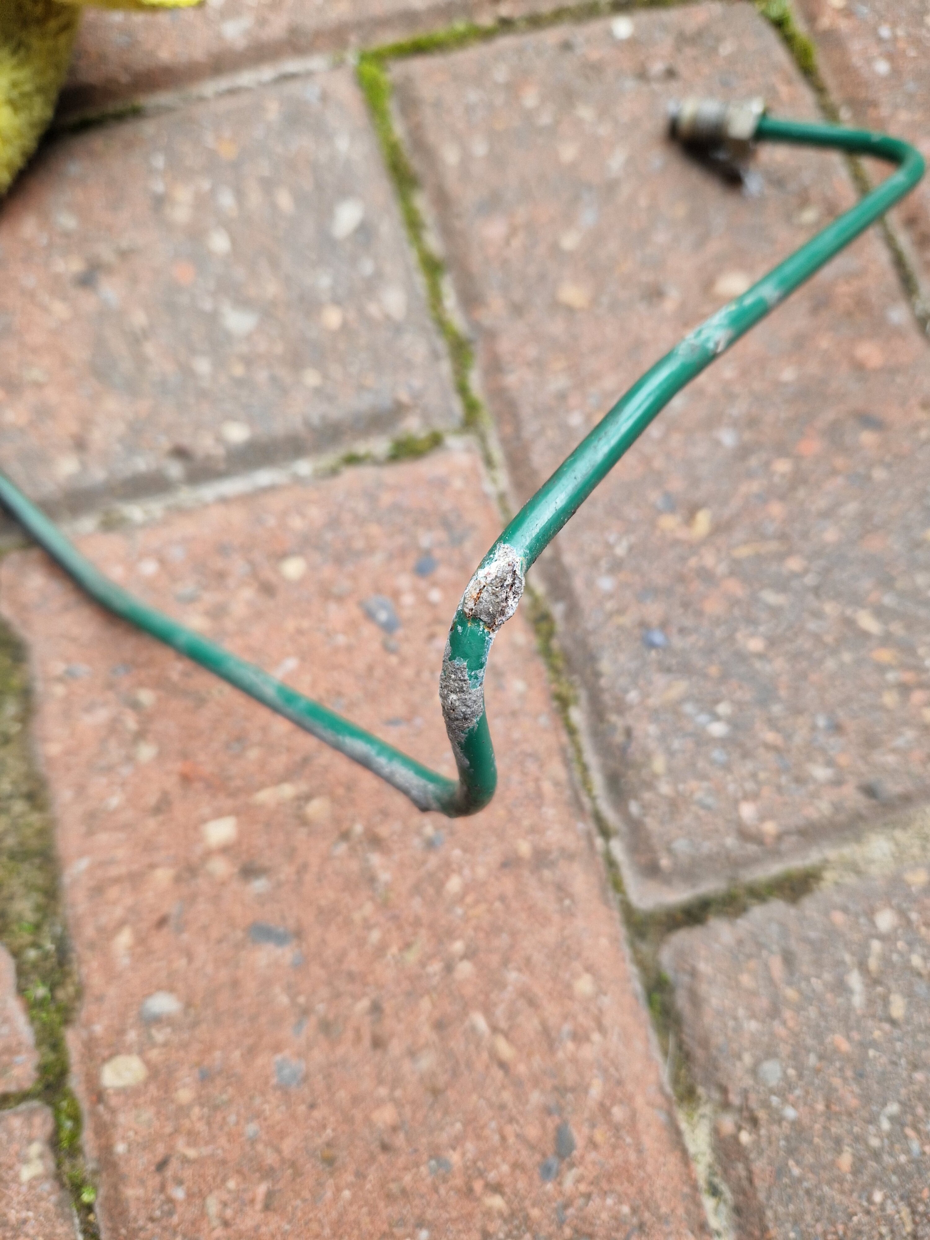

Decided I was going to make use of the good weather and fit my brembos today. Unfortunately my hardlines were rusty (obviously) so I needed to replace them. Spoke to BRT motorsport and with help from @Touring_Rob , @RichValver and using catcar I got the dims needed. Had a pair of braided lines made up and cracked on with fitting them.

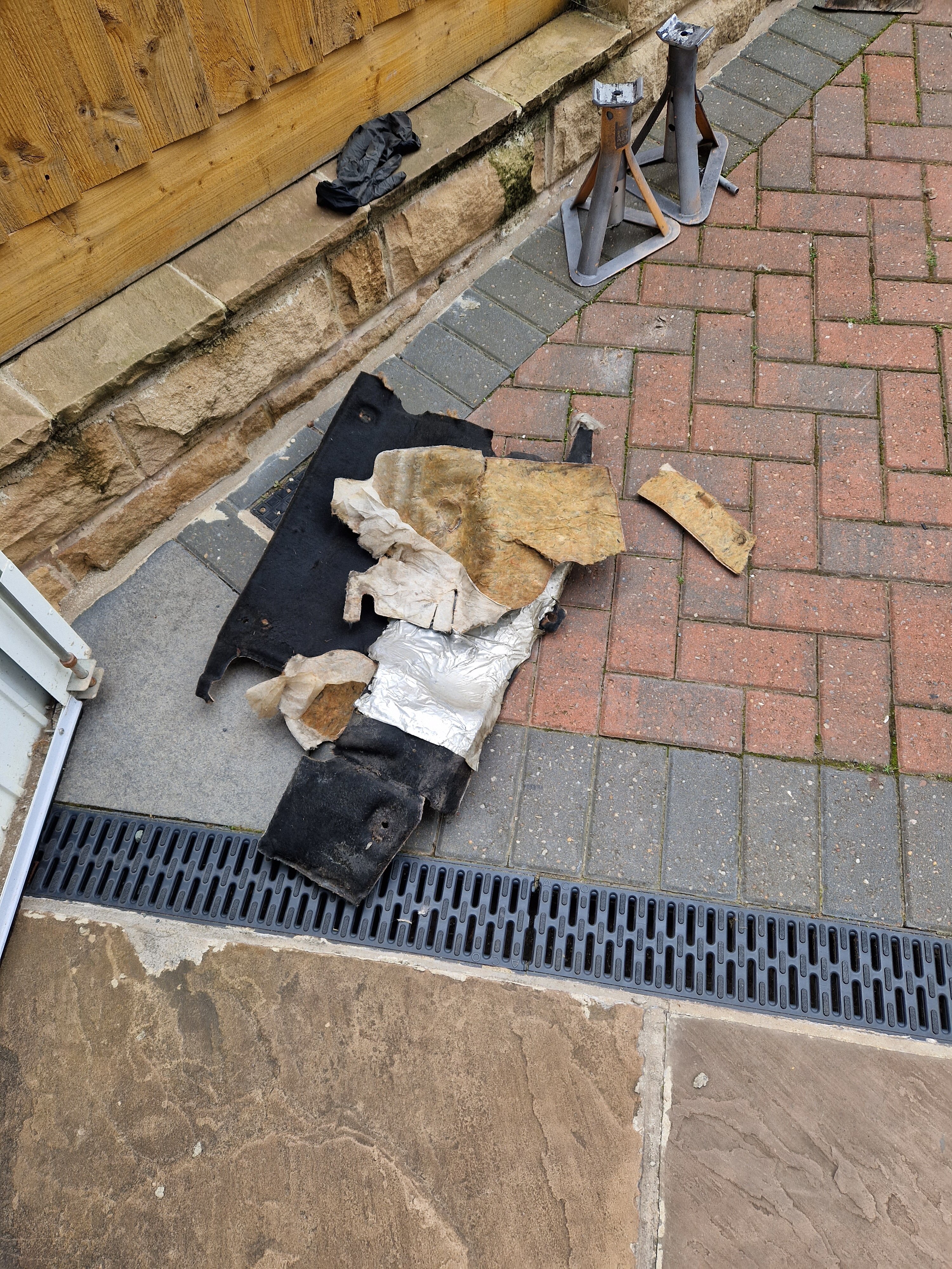

Now this isn't easy with the engine in place so I had to tear out the fabric heatshield to gain access.
I disconnected the hardlines from the calipers and plugged them with some blank m10x1 plugs. Absolute game changer!
Hardlines out and ABS pump plugged this is where I was at.
View attachment 1606380View attachment 1606381View attachment 1606382
Old lines were fucked! Now routing the new lines was a pain but got there in the end and basically got the lines clipped into all of the oem guides.
Much better! View attachment 1606387
Whilst I was here i decided to attack the rust. Now there's a fair bit in the arches and I definitely didn't get it all, but it's a start. Used my die grinder, wire brush and flap discs to attack the rust. Coated with hydrate 80 then some epoxy mastic. Now I still have other areas to go on but I ran out of time. Plan is to get the rest then gravitex and dynax ub it.
Fitted the brembos and needed to tighten pretty much every fitting. Getting the lines to seal on the pump was tough as there's not much space for leverage but got there eventually.
Brembos were bled but will definitely need doing again.
Some quality machining got the ds1.1.1.111s in the perfect position.
Fingers crossed no leaks in the night!
View attachment 1606386View attachment 1606385
