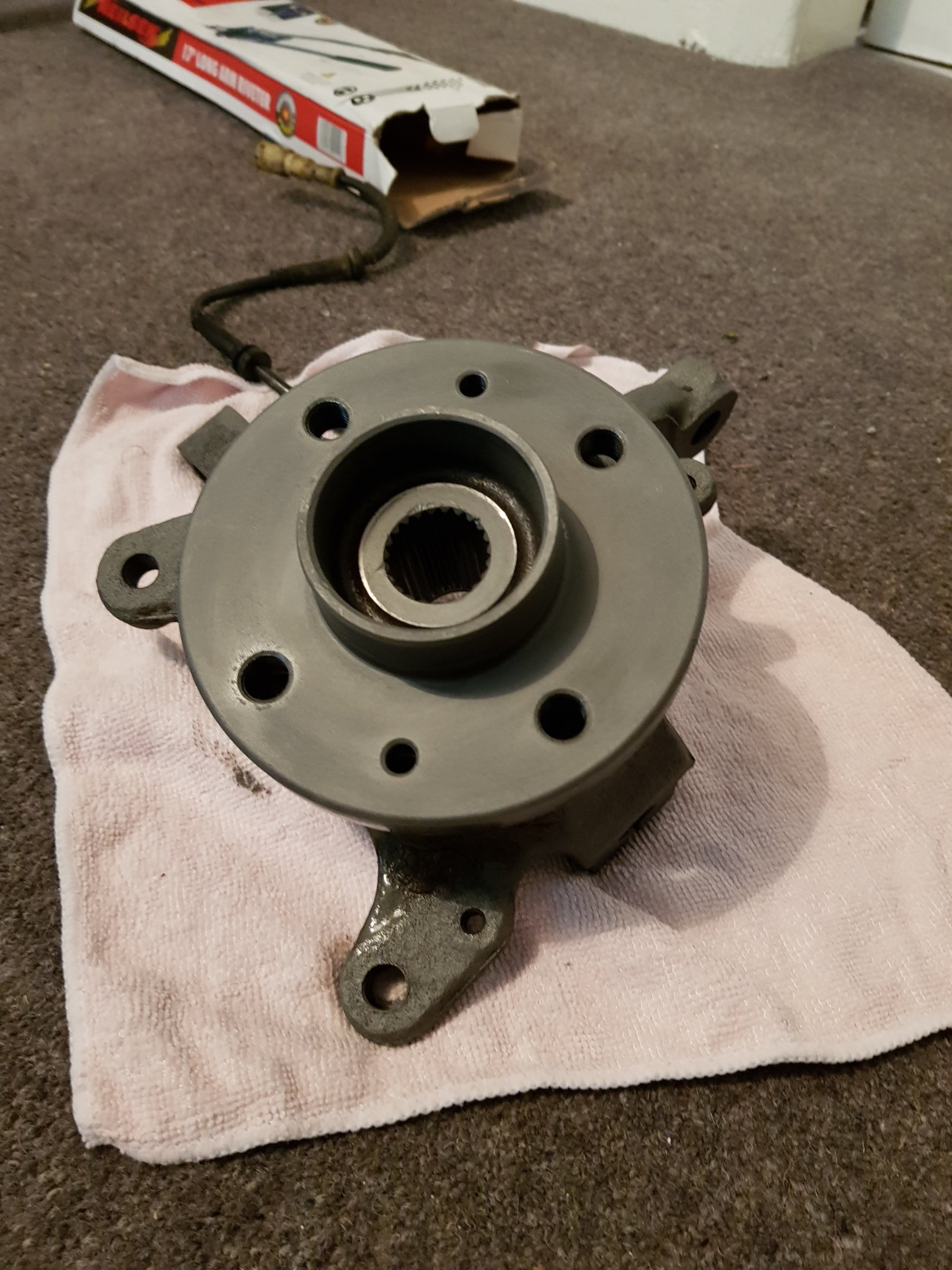

I bought some used 60mm hubs that needed bearings and after advice from @Gus i soaked them in deox c.
Bearings still need pressing out but this stuff is insane! Works much quicker if kept warm too but I had it in a cold cellar.

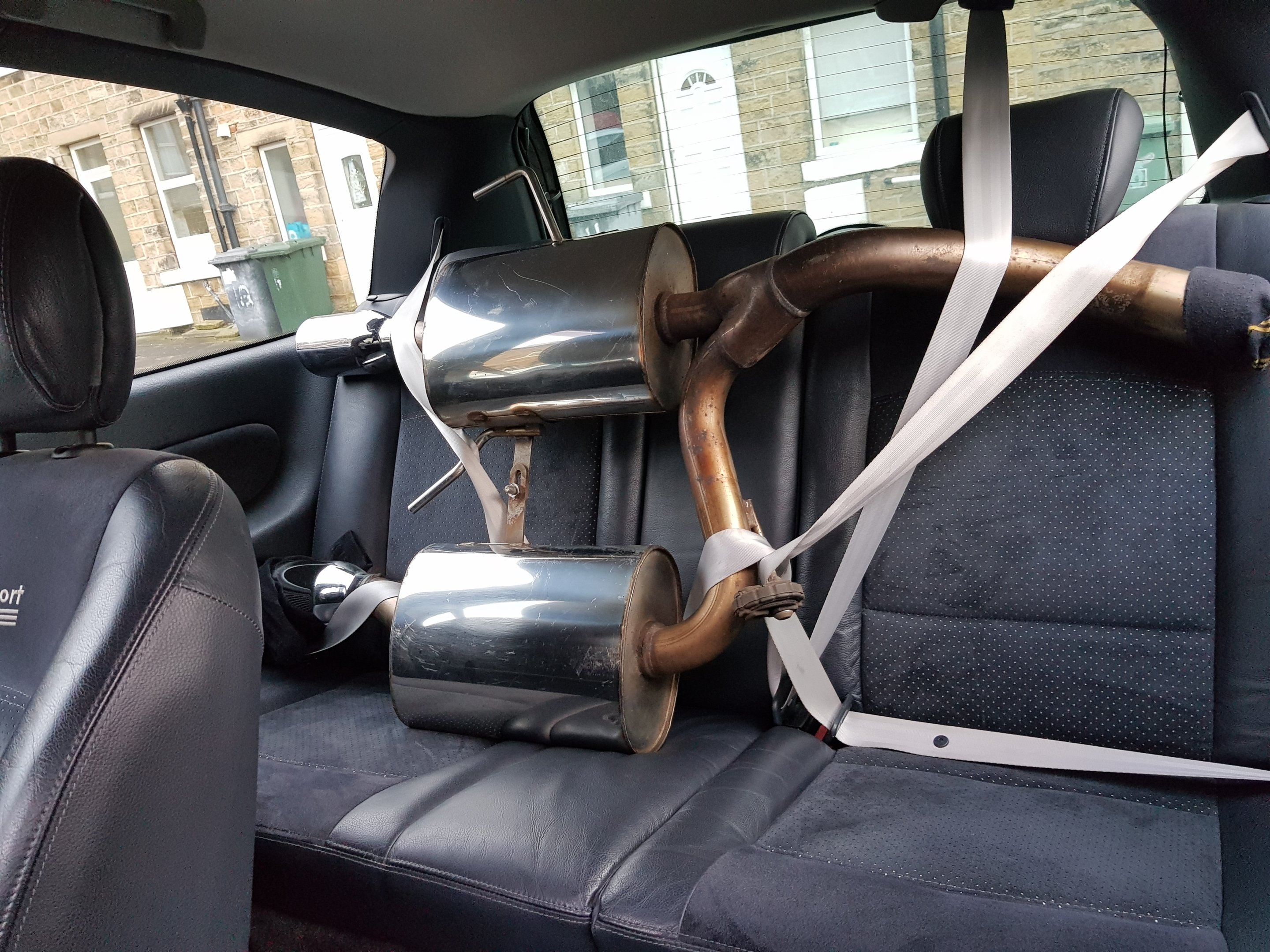

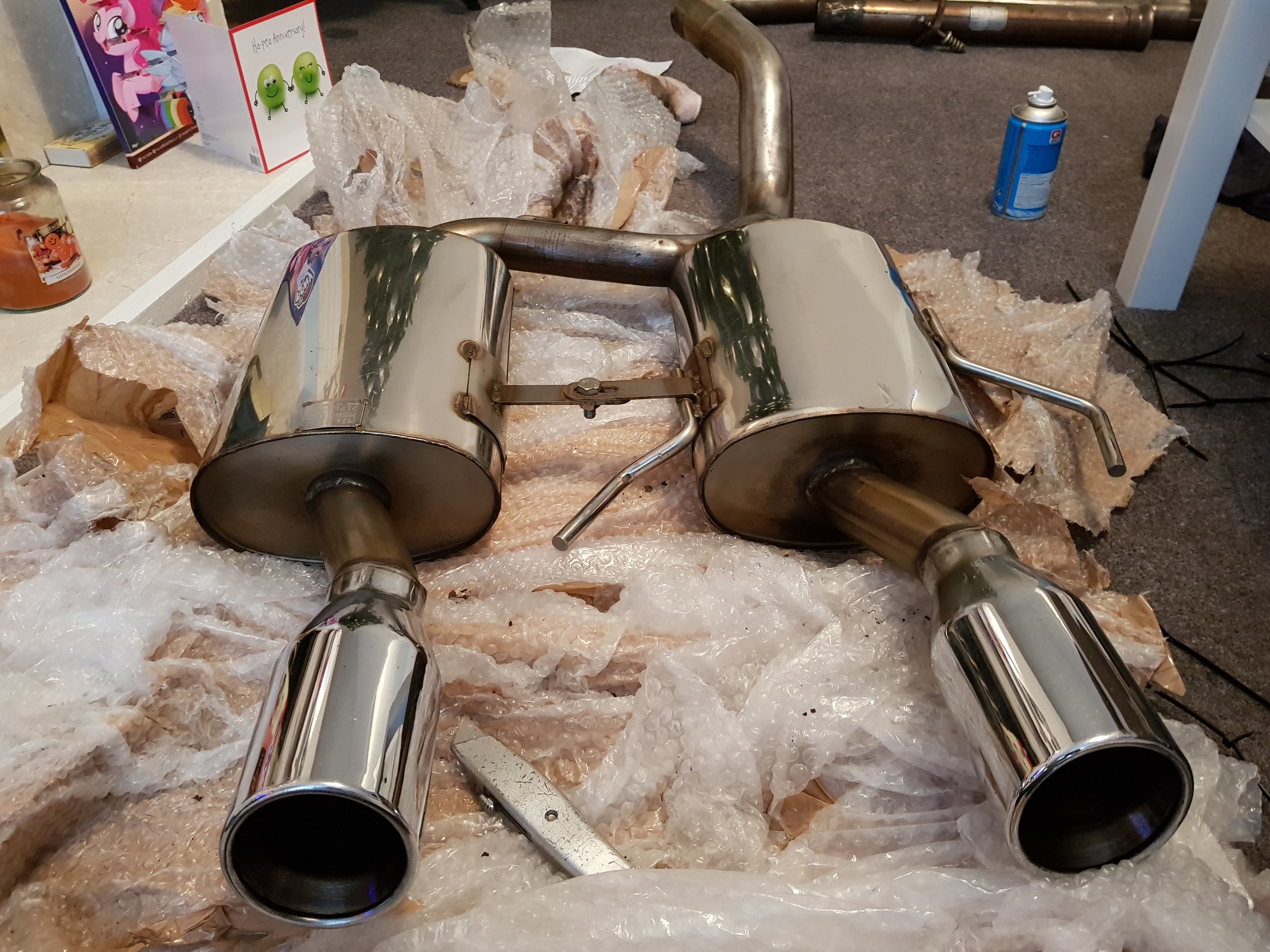

My milltek also arrived and I gave it a wipe with brake cleaner then a quick polish.
I will be fitting this on boxing day most likely! Had to strap it in for my journey to my mum's house 😂

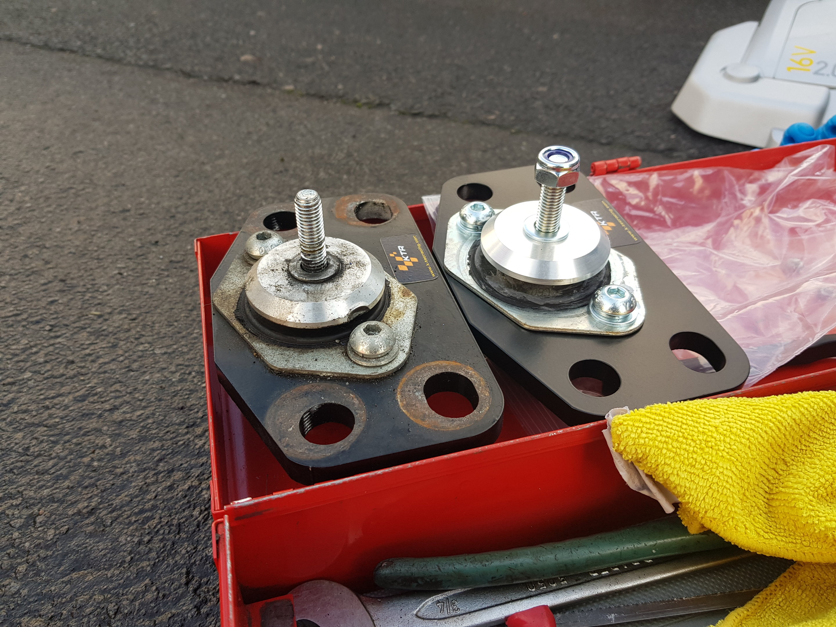

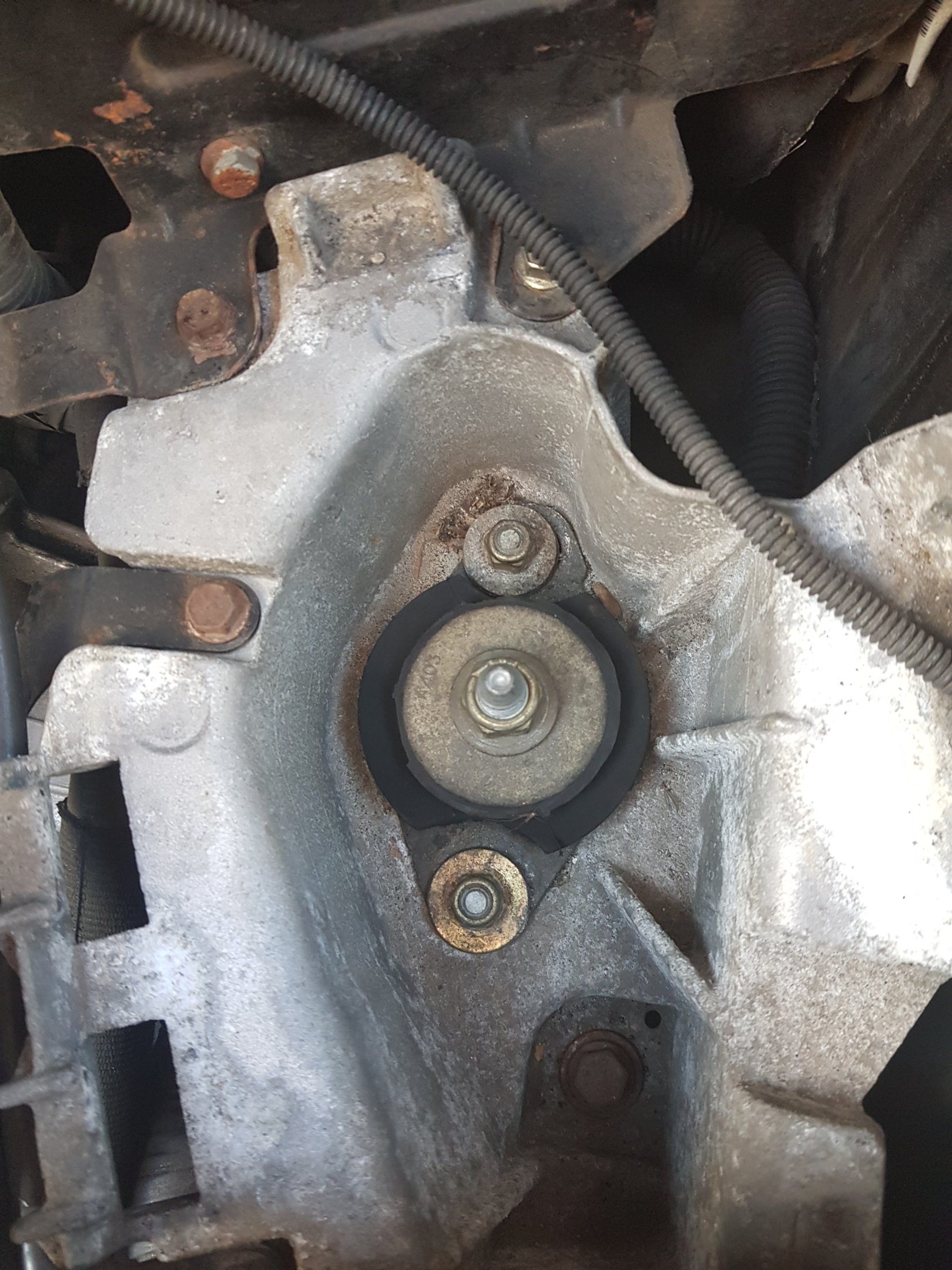

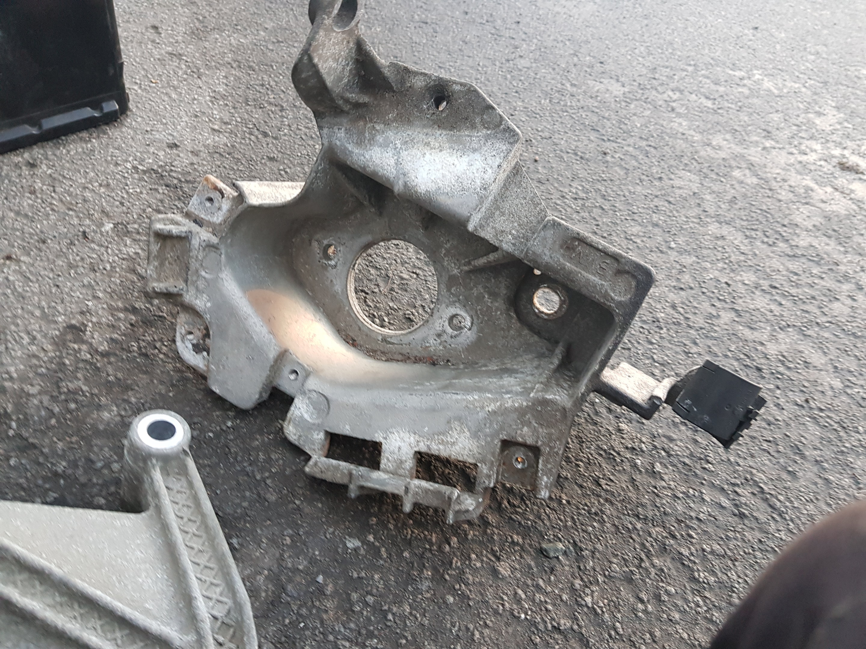

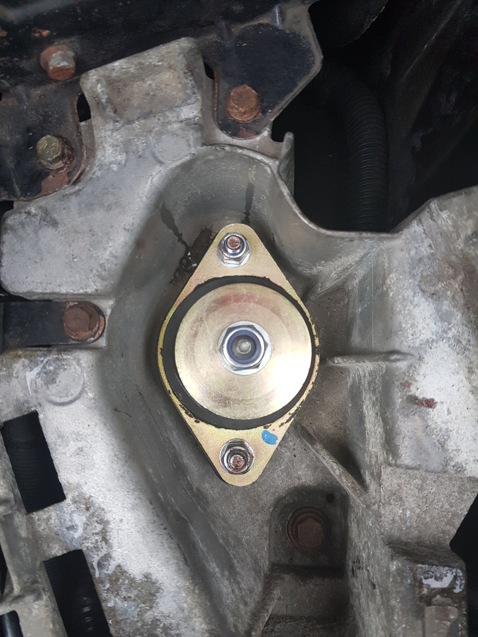

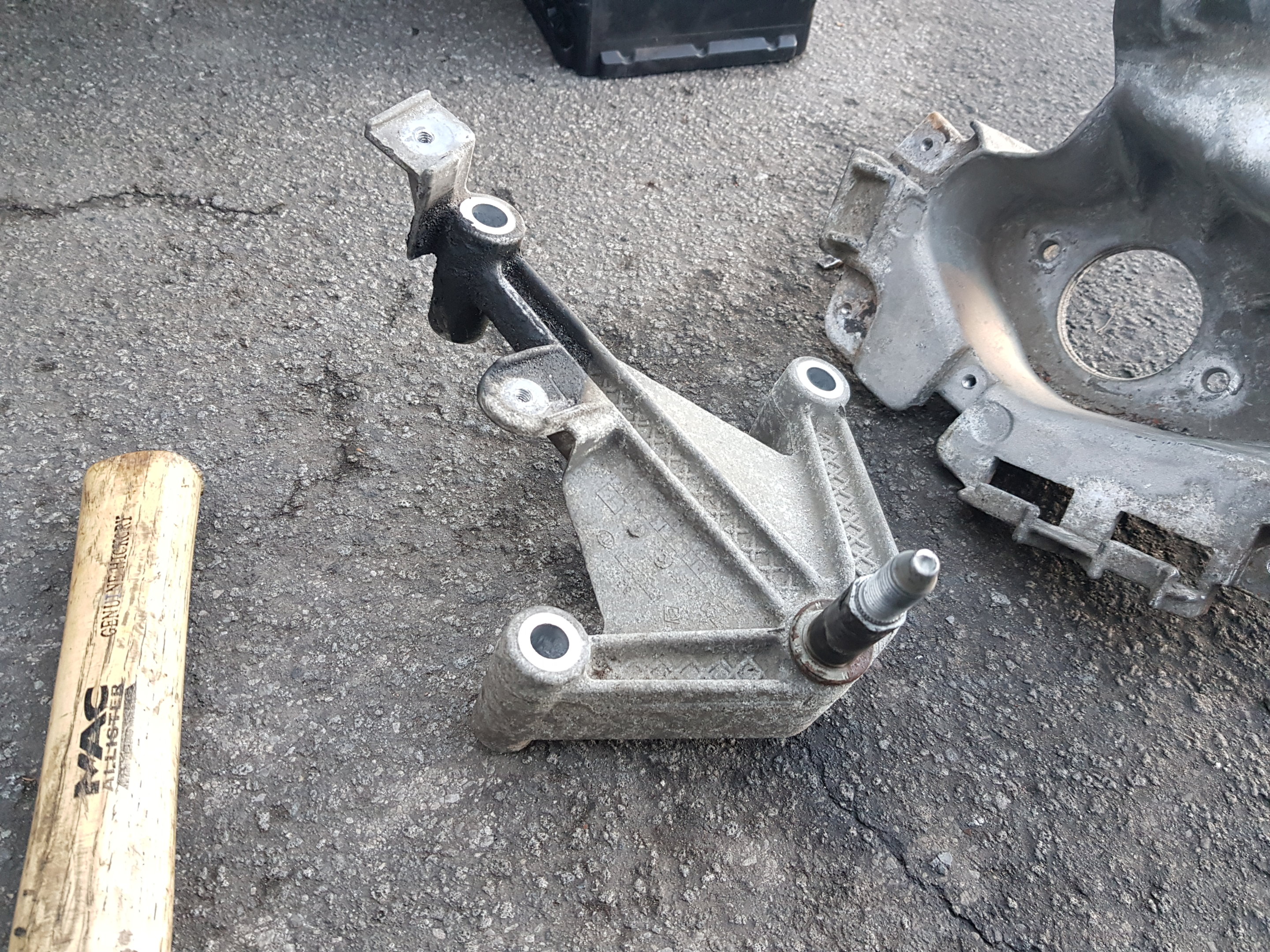

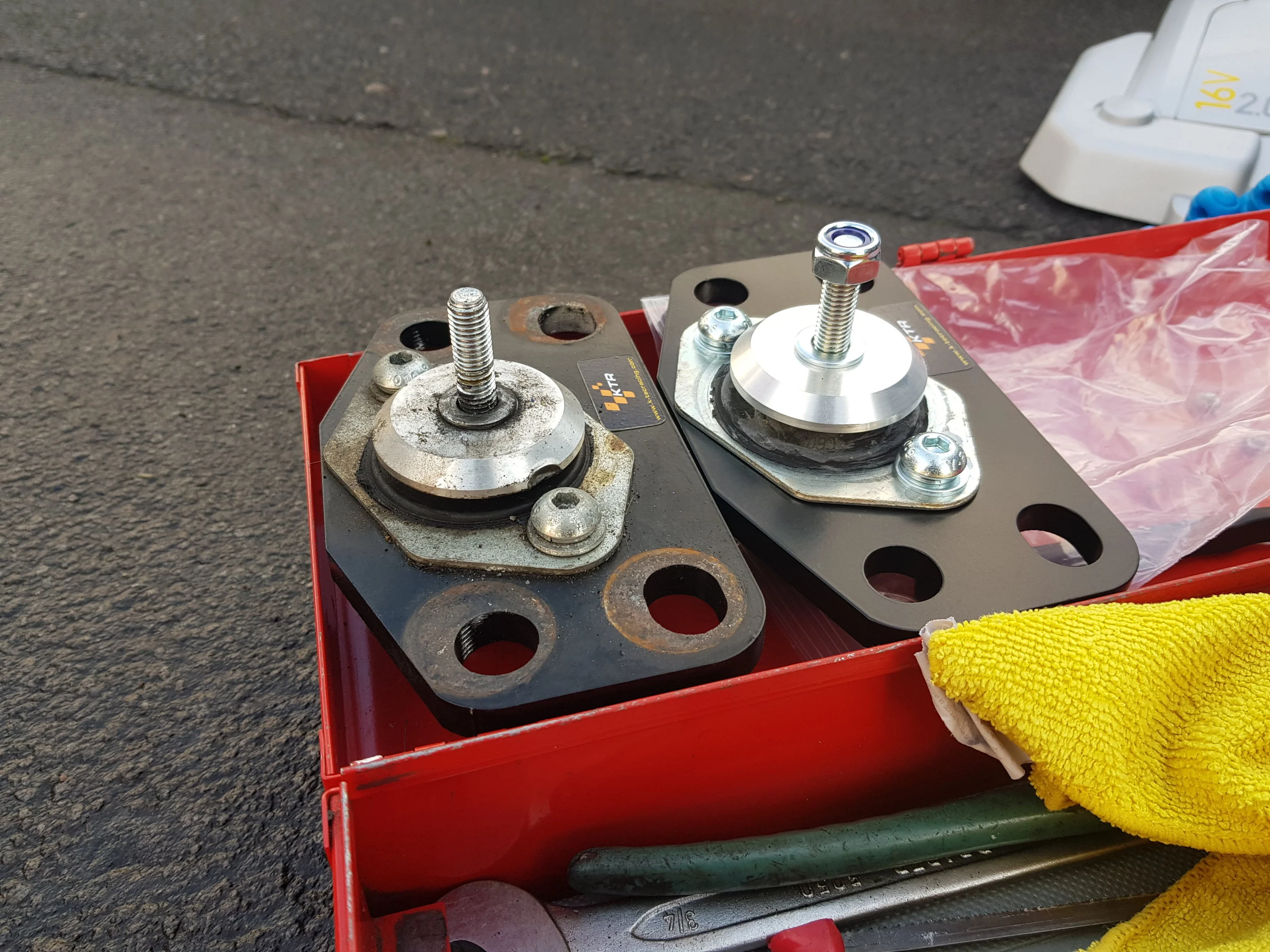

Made a start on fitting some new engine and gearbox mounts. I had a receipt for a gearbox mount bought by a PO but when I removed the battery this is what I found
A standard gearbox mount. Who knows what happened to the solid one!
Rather than buying just a vibratechnic gearbox mount it made sense to buy the whole kit with dogbone, engine and gearbox mounts to refresh everything.

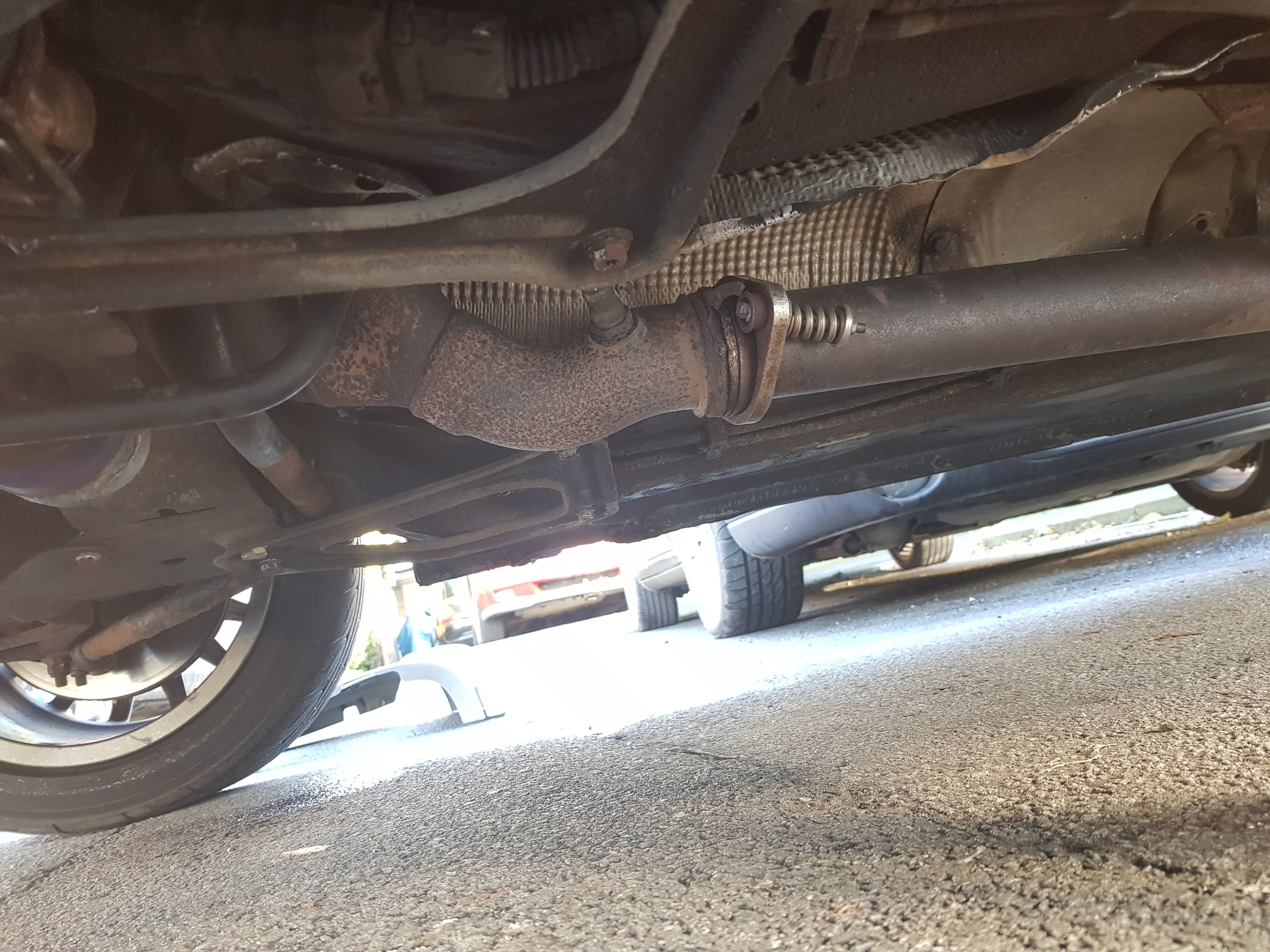

Whilst jacking up the car I noticed this...
That'll explain the blow then! I'm going to try weld some new tabs on otherwise it's a whole new manifold jobby which isn't what I want. Puts off fitting my milltek for the time being.

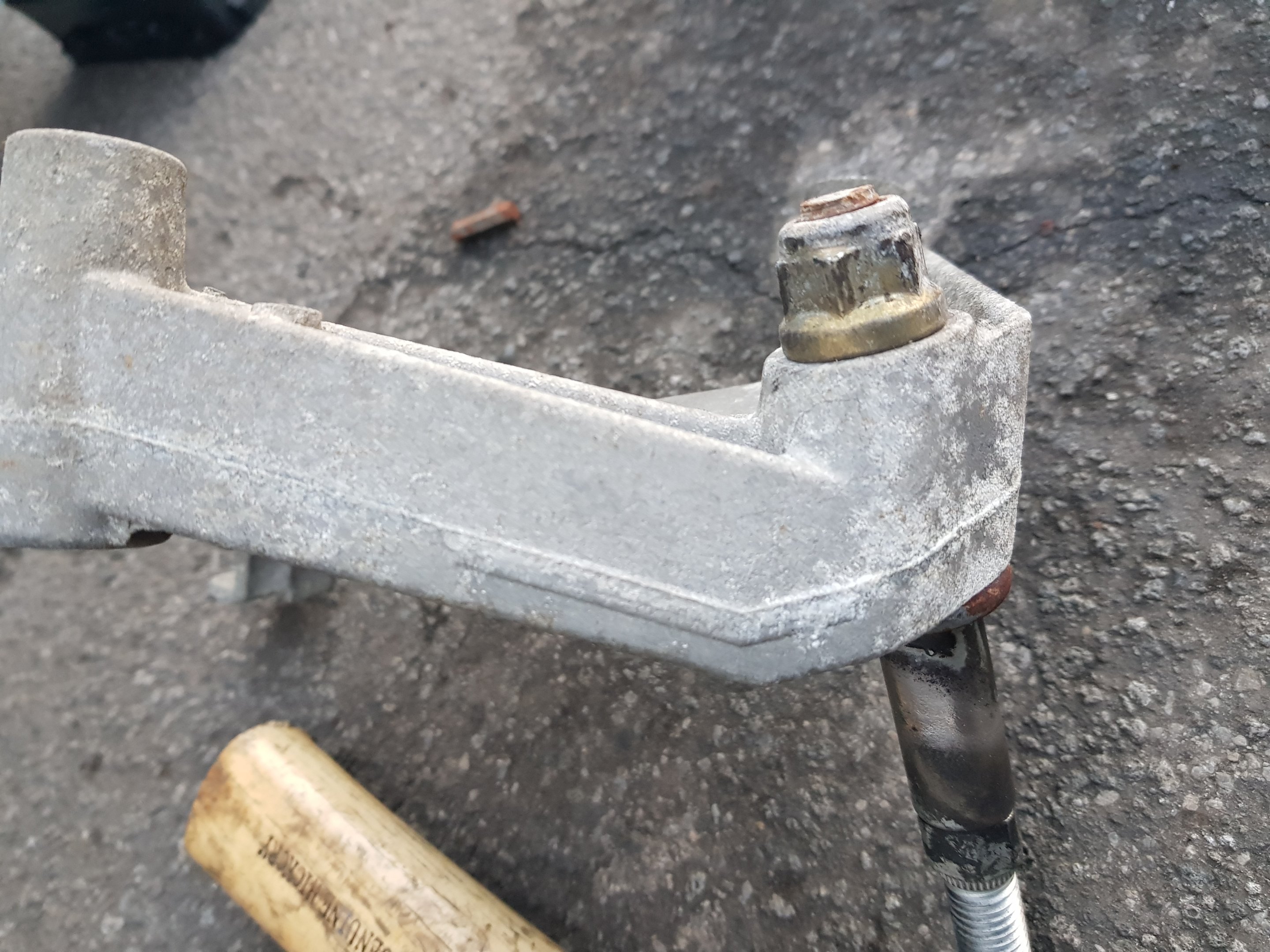

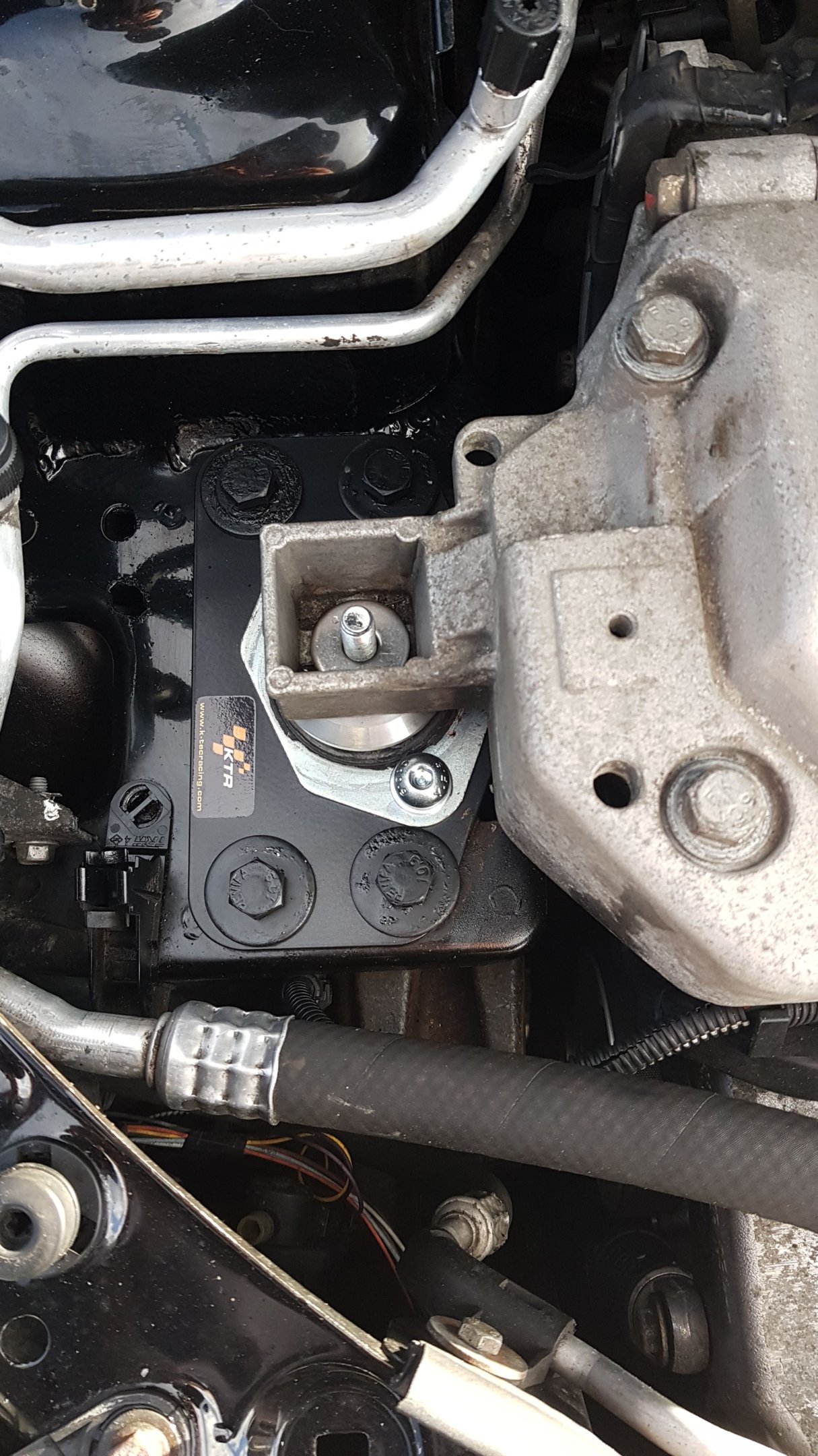

Cracked on with the engine mount and changed this
Levered the whole engine forward and loctited on the centre nut. Will be respraying everything in the summer but a quick spray of satin will do for now on the bolts to freshen up slightly!
I also removed the gearbox mount cage and spider cage to make sure the spindle nut and bolt was fully tightened.

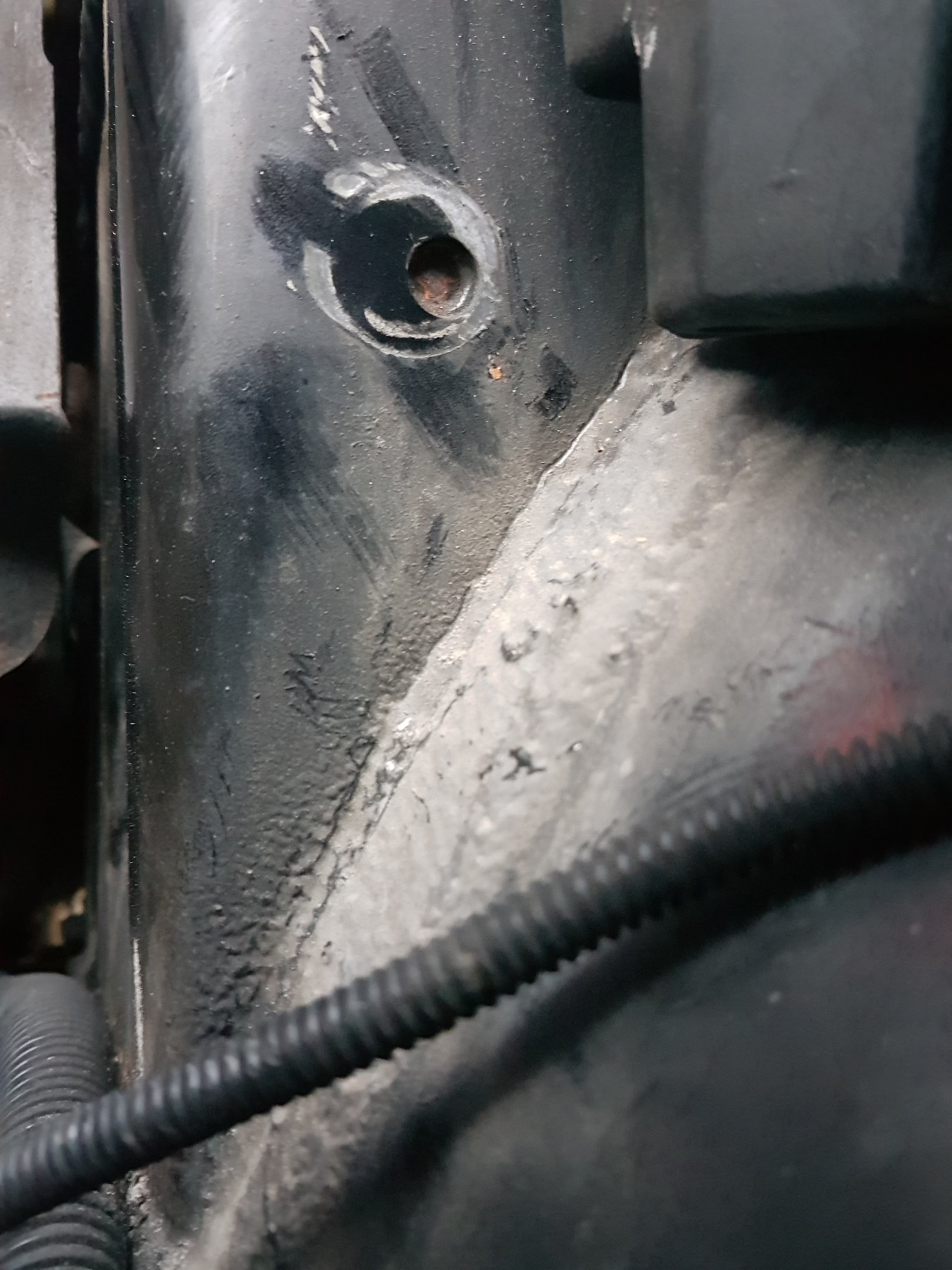

Annoyingly a previous owner had snapped this bolt in the turret. I'll be trying to weld a nut onto the back to remove this otherwise it's drilling it all out.

Fitted the gearbox mount and went for a little drive and it all feels so much tighter. Less movement in the gearstick too with hardly any more vibrations. Just need to sort out that snapped bolt eventually.

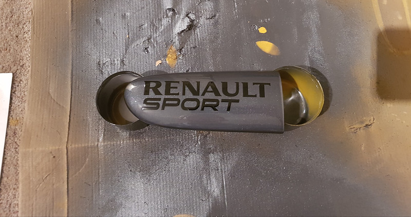

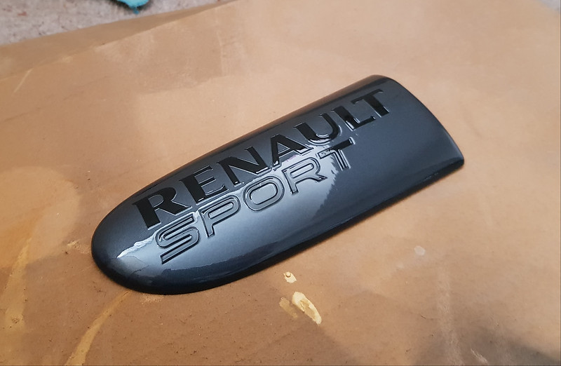

In the past week I had a bit of spare time after work so decided to paint my bullets that I had previously sanded smooth.
20180120_111628 by Louis Walker, on Flickr
20180119_230132 by Louis Walker, on Flickr
Pretty happy with how they turned out, but i do kind of wish the sticker was slightly smaller but i'll see once they're on!

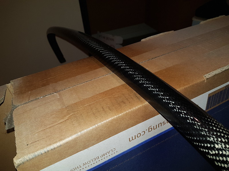

Whilst I had the lacquer out, i sanded back my matt cf splitter and gave it around 5 coats.
20180106_195404 by Louis Walker, on Flickr
Glossy!... Not bad for £60! Just hope I don't smash it off in a week 😅

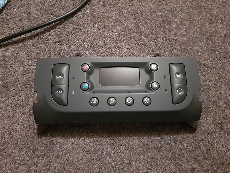

Also managed to get my hands on a non sport climate control panel to remove the sticky one that's in place at the minute.

For a start I dealt with the snapped stud in the turret by grinding off the captive nut on the inside of the arch. I then just used an M8 nut and bolt with a large washer to spread out the load. Saved any messing around drilling it out. I'll grab some photos next time i'm out.

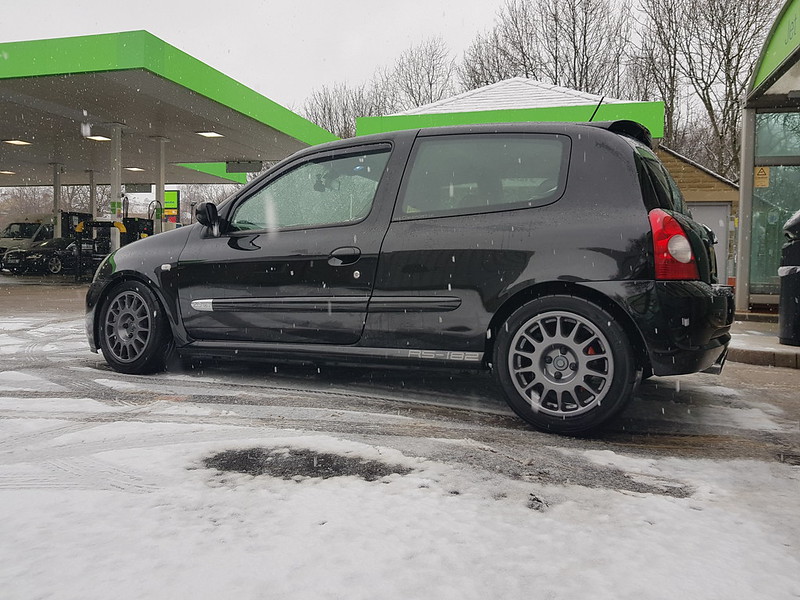

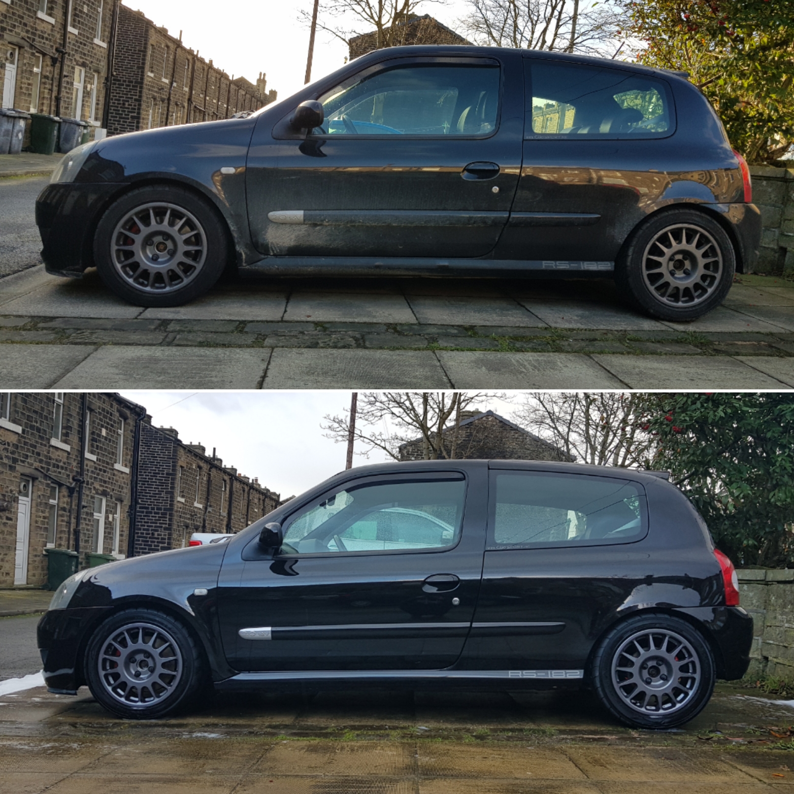

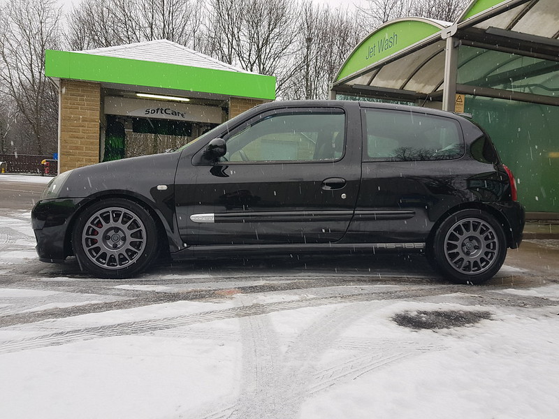

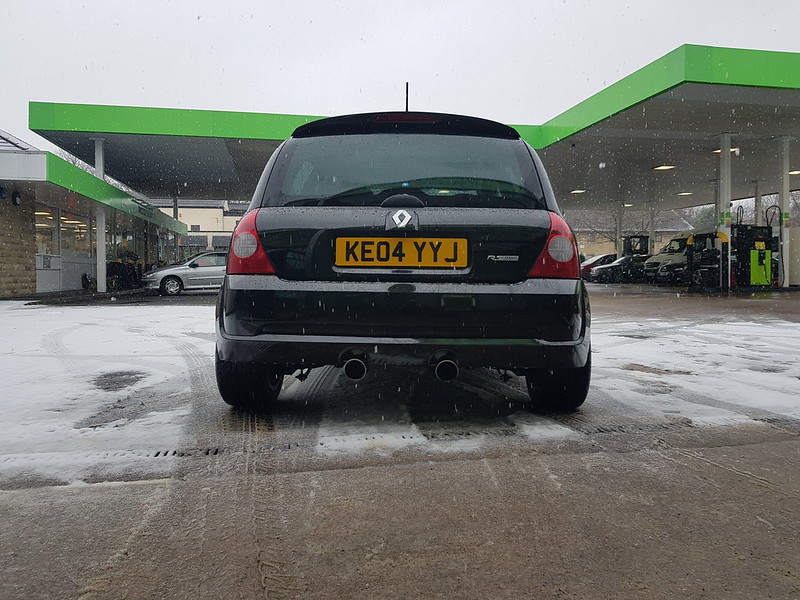

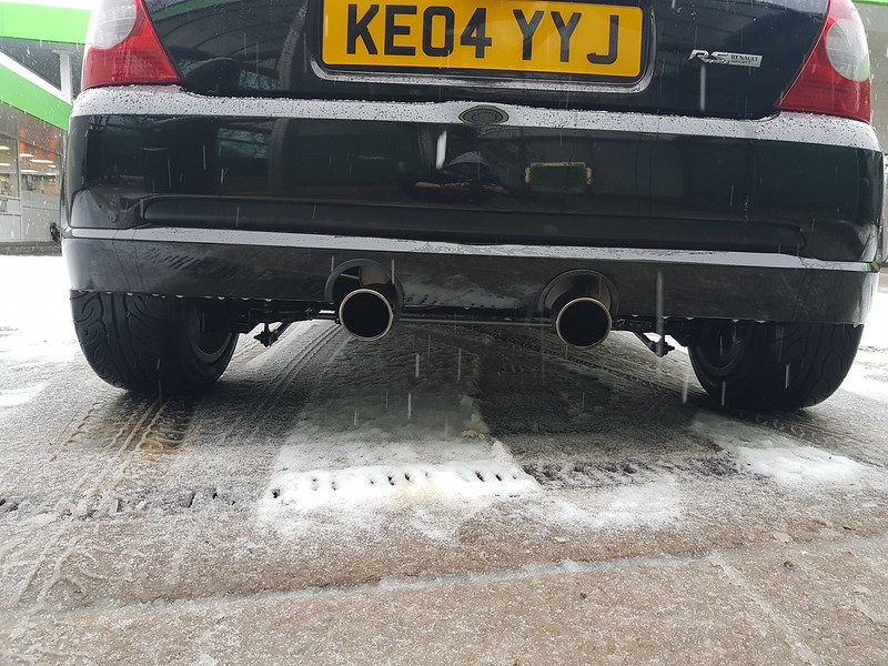

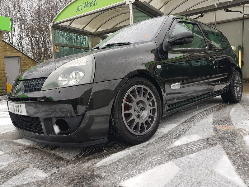

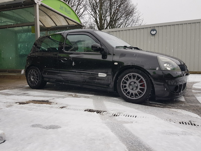

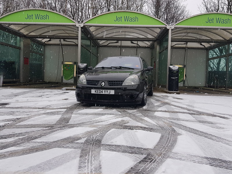

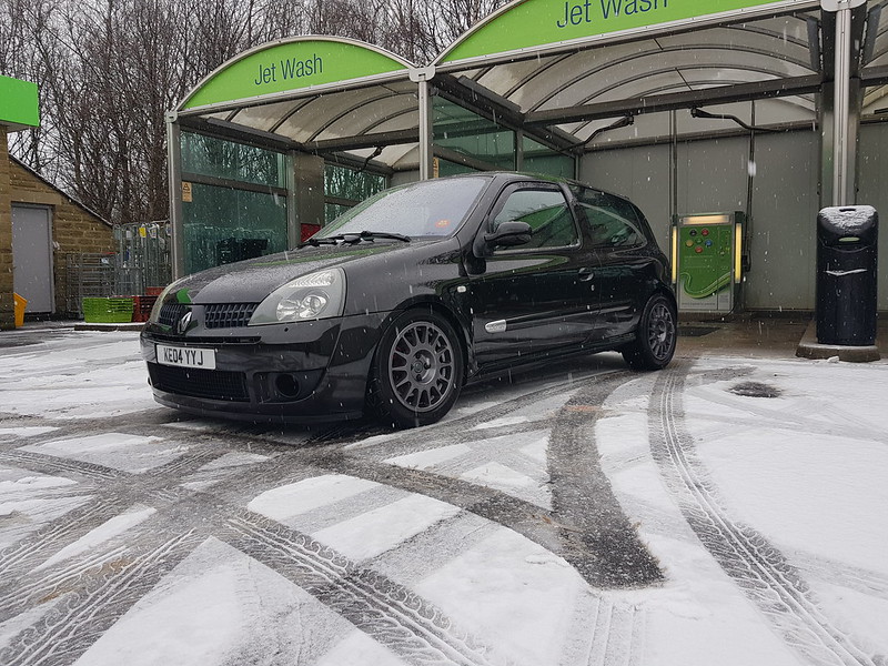

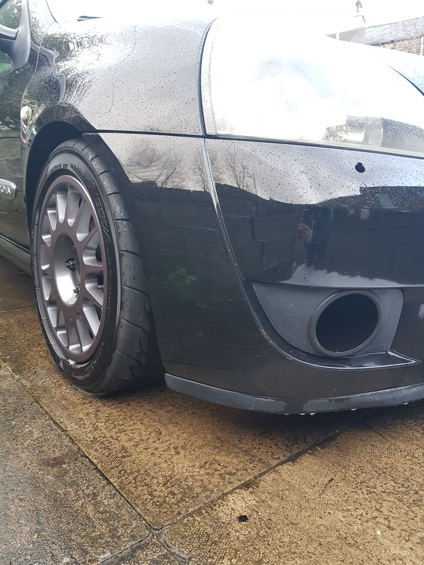

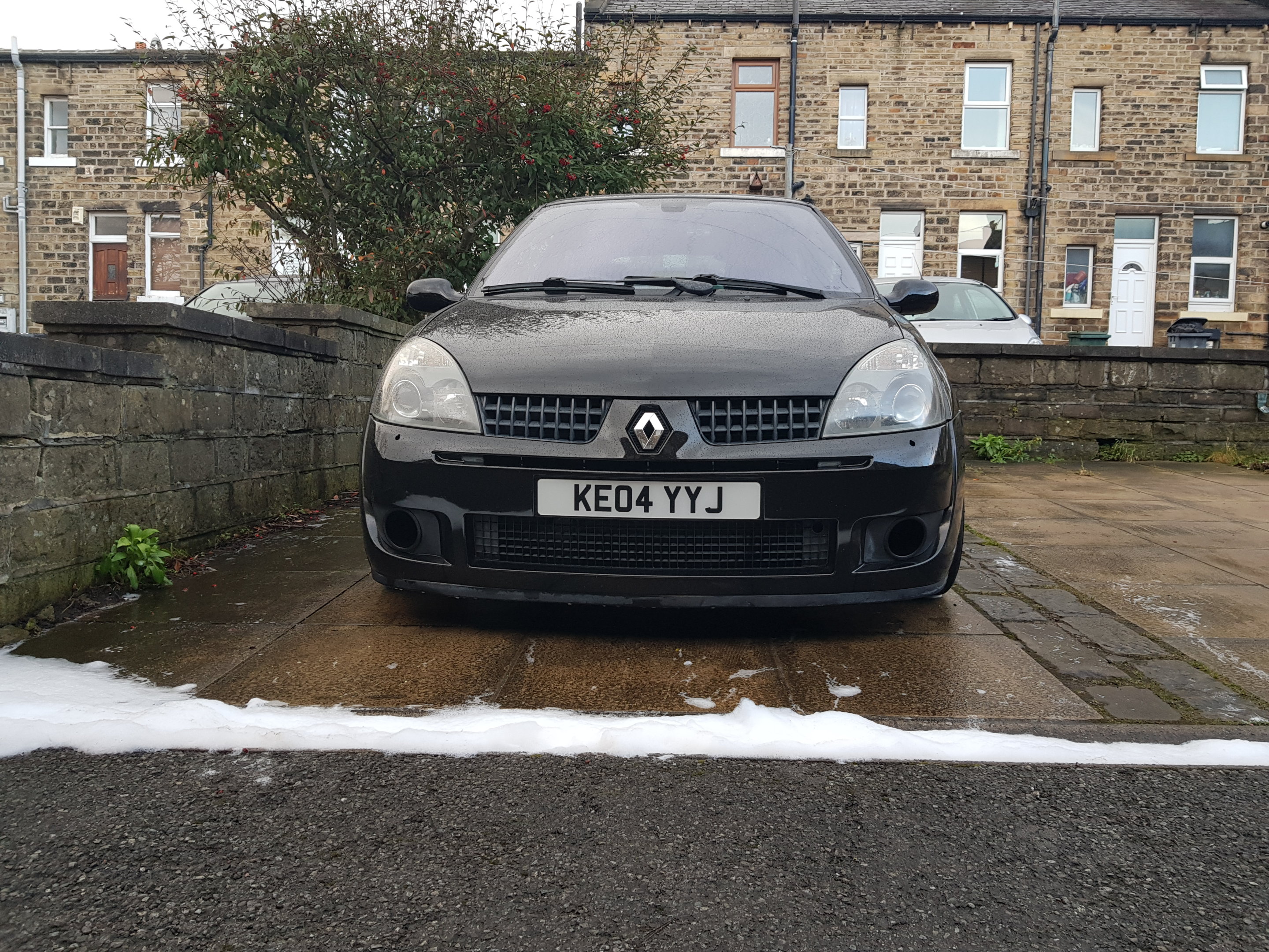

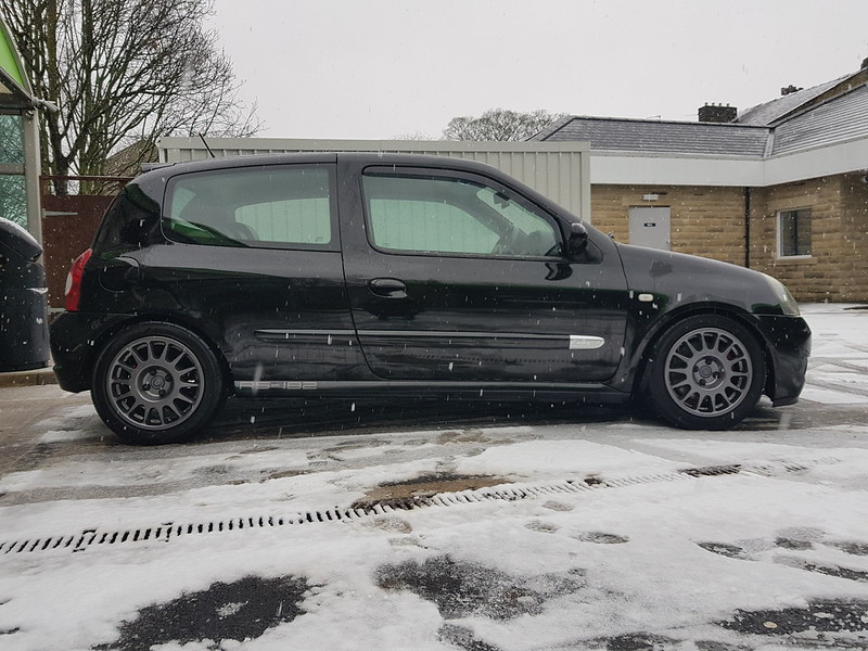

I woke up to snow this morning, but having seen all the salt on my front bumper the night before I had to give it a wash! Excuse the mad camber and rake, but this will soon be sorted.
20180121_122742 by Louis Walker, on Flickr
20180121_122749 by Louis Walker, on Flickr
20180121_122757(0) by Louis Walker, on Flickr
20180121_122805 by Louis Walker, on Flickr
20180121_122704 by Louis Walker, on Flickr
20180121_122728 by Louis Walker, on Flickr

On the milltek front, i'm still in need of sorting out the manifold flange as it's blowing a fair bit. Mainly noticed with a full car and the engine under load! It also needs adjusting at the back... maybe a job for the warmer days 😂

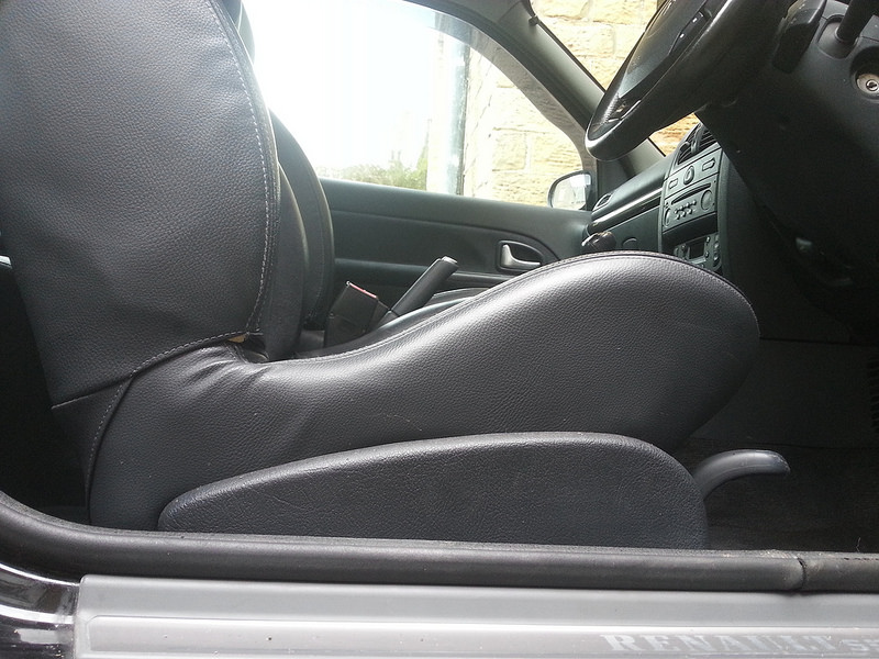

  Clio RS
  Clio RS

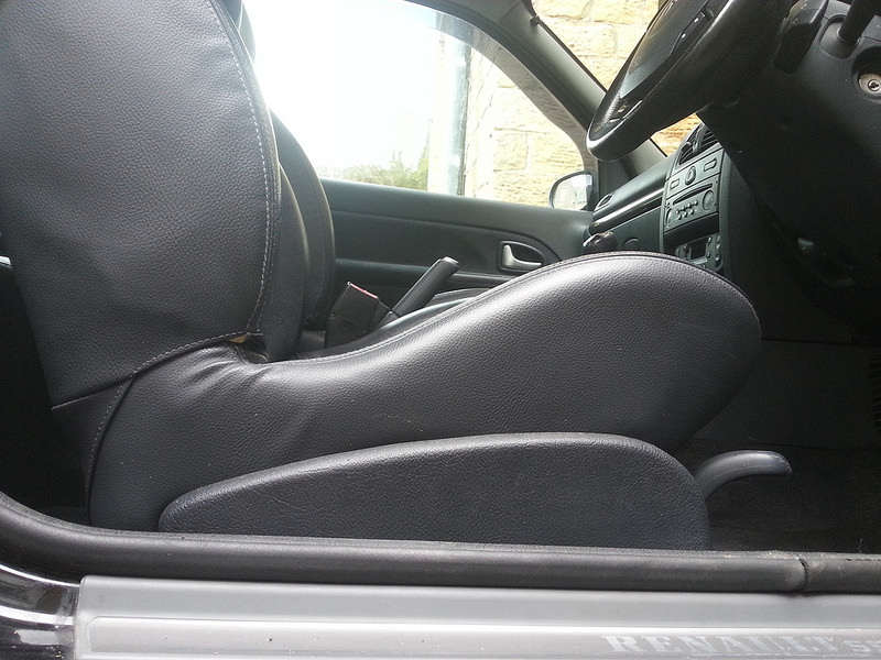

So there are spacers outside and inside. Each Bolt has one?
I have to reinstall my seats and im not shure if there are also spacers in the two (4) holes in midle of the car for both seats.
Sorry for the question.
Louis
I Love Ed Sheeran
Yeah spacers inside and outside of each seat. 4 per seat.
