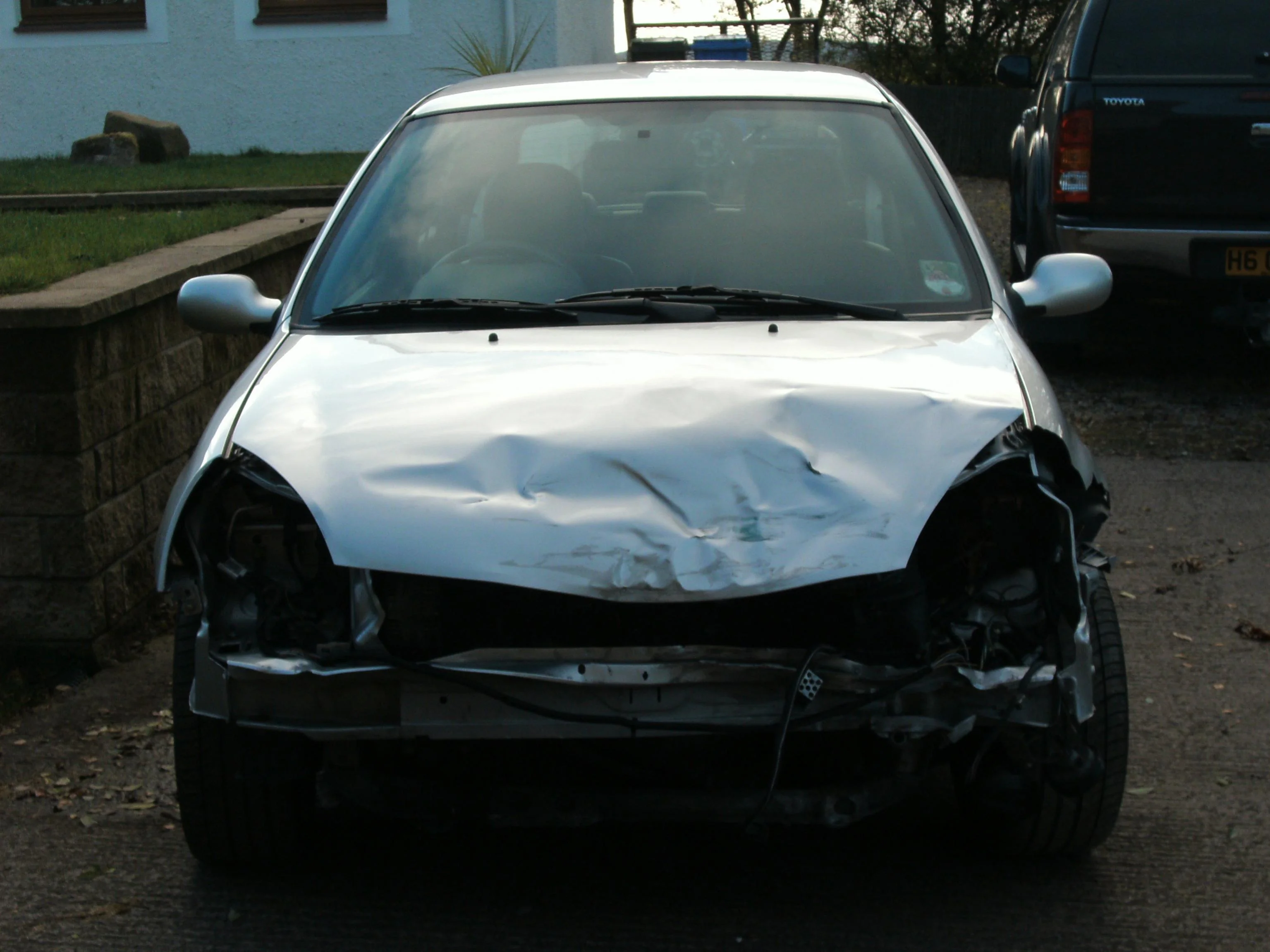

That when I started looking on ebay for something more challenging, after a while I found this,

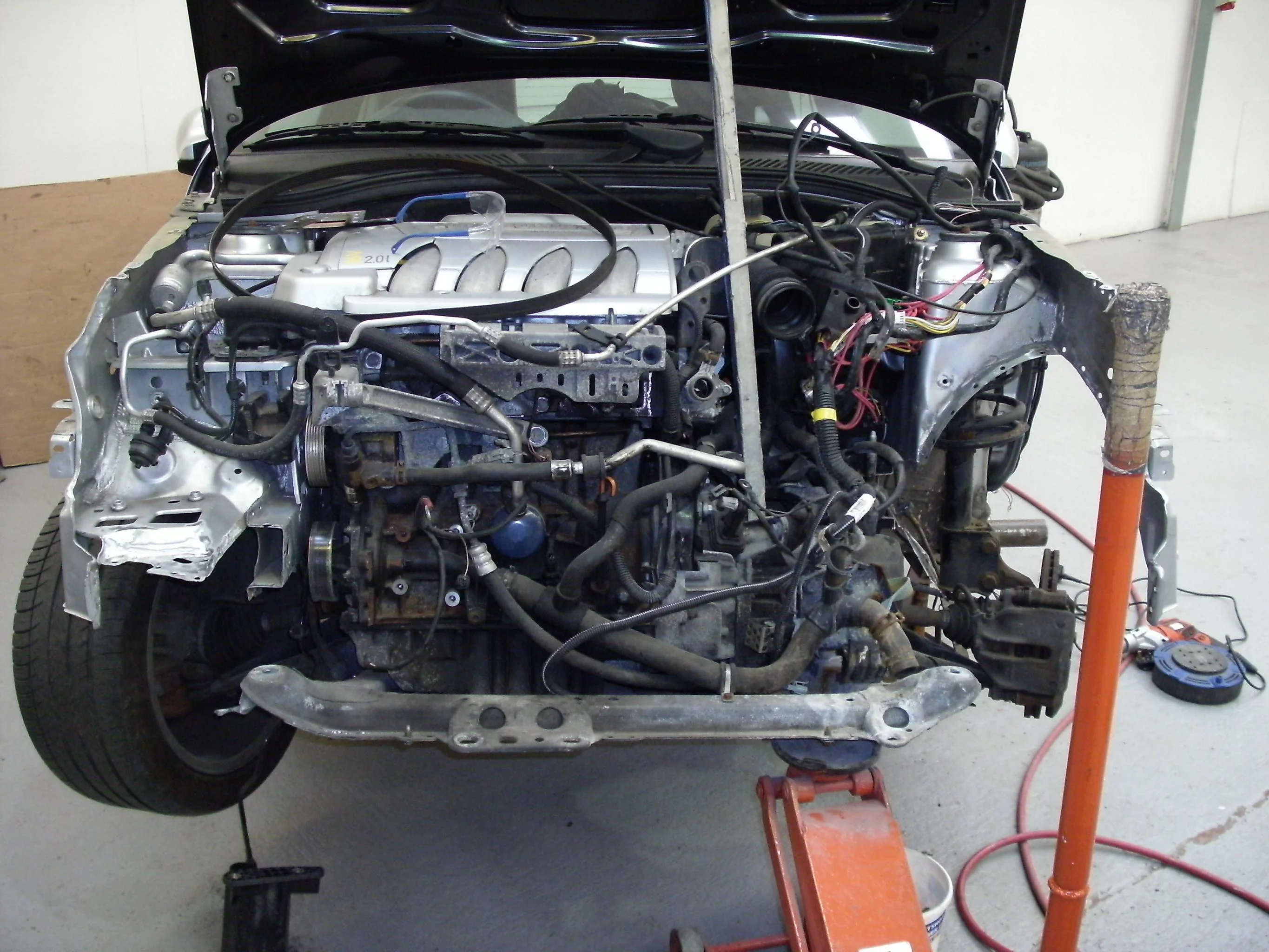

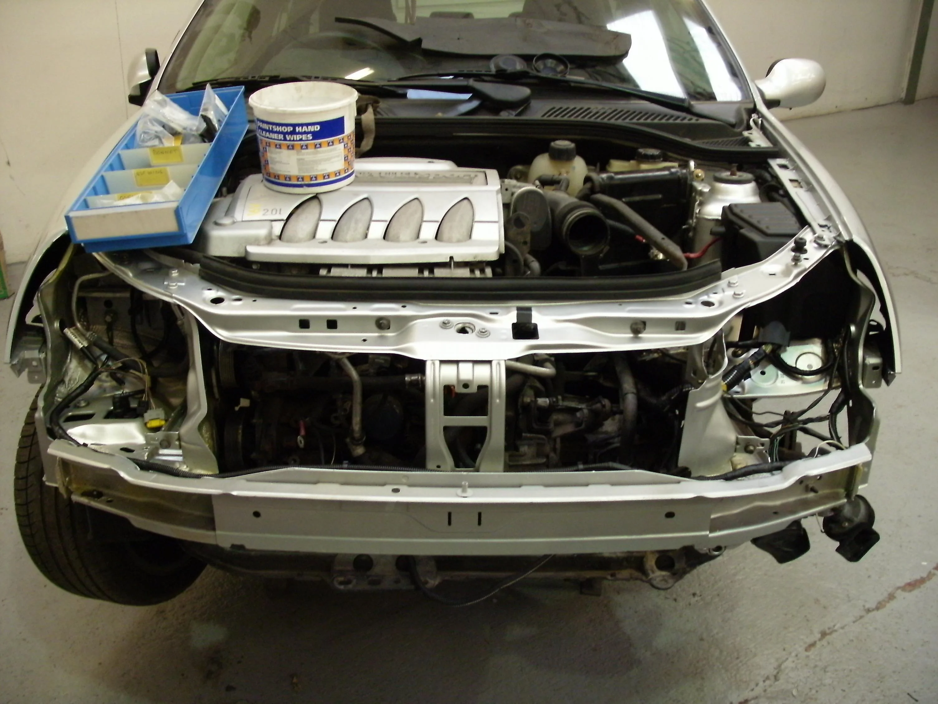

It was a 55 plate 182, after joining cliosport.net worked out with everyones help it was a 182 full fat with suspension cup pack. First job was to assess the damage. I'd driven down to Peterbourgh to get the car and it drove onto the trailer but had no radiator, AC rad, headlights etc. I stripped evrything off to allow the coachworks easier access. Used a friend in Kilmarnock who runs a very clean shop and does very good work.
They knew the car was a project so only work on it when the shop was quiet but did a great job, cutting the front legs off and fitting a whole new front end. I was very pleased with the results.

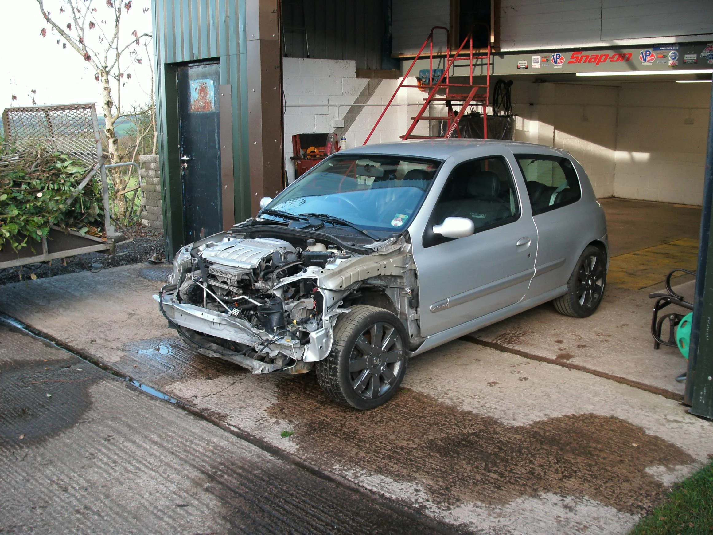

So far I've stripped out everything inside including the dreaded tar patches. The wheels have been refurbished by another friend with a powder coating business (Carrick engineering) and are on the 1.4. Next was to order a cage. Again using CS members advice and previous experiance I decided against my first choice of a Custom Cages cage and have ordered an Oreca race cage from Ktec. I deleted the AC and changed the alterator to a cup spec, relocating the PAS pump in the process. The power steering hose sensor was hitting the new cup radiator so rather than just bend the pipe, I bought the correct cup hose and spent 6 hours change it over!! sore knuckles!
The 1.4 now has a complete 182 interior bar the dash and the head cloth. The airbag lights were a head scratcher but again CS was a good source of info and the resistors are in and the lights are off.
About to take the windscreen out - another new experiance and will fit a heated version once the cage etc is installed. All the blower unit, climate control, AC etc is in the workshop complete if anyone needs it. Heres the state of the car at the weekend, sometimes wonder if I should have left it alone!

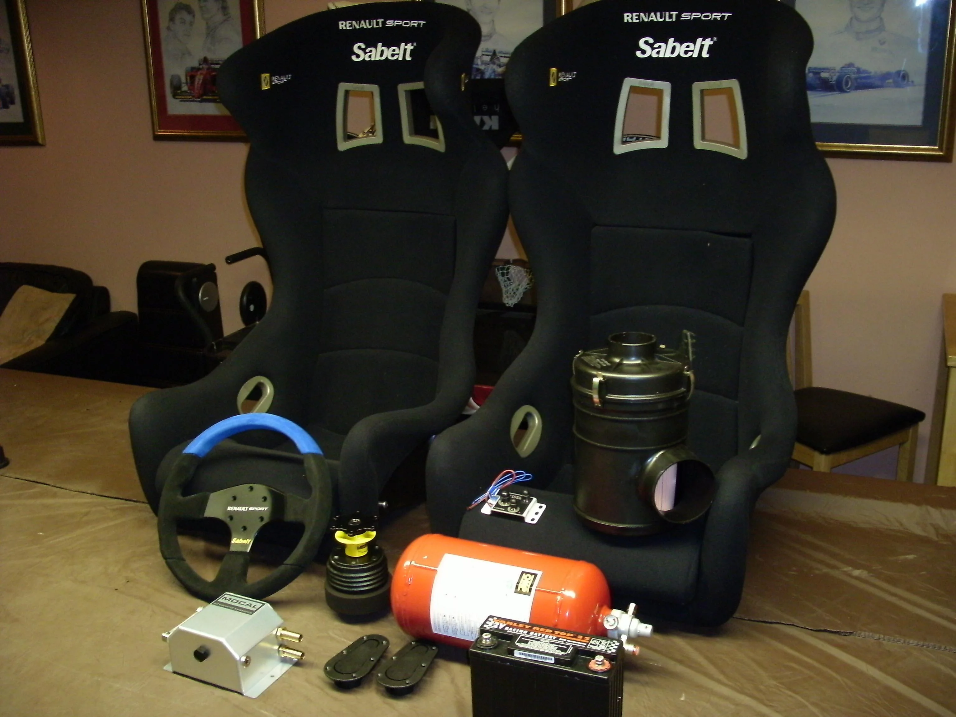

The postman arrived today with some goodies :D. Unfortunately the cage is still in France so it may be the end of next week before it arrives. Collected my V6 airbox - only £60 including a filter! and also picked up a new header tank cap to finish off the new stainless header tank when it arrives.
Much to do this weekend as I can now work out where the seats, steering column and gearlever are going in relation to each other. Also need to make a template up to mount the ECU back to back with the oil catch tank. Then work out the best place for the dry battery and electrical cut out.
Here's a picture of deliveries so far...

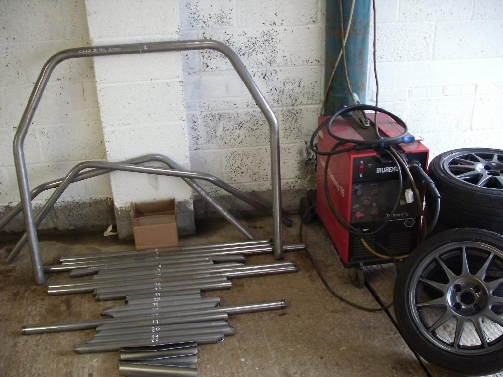

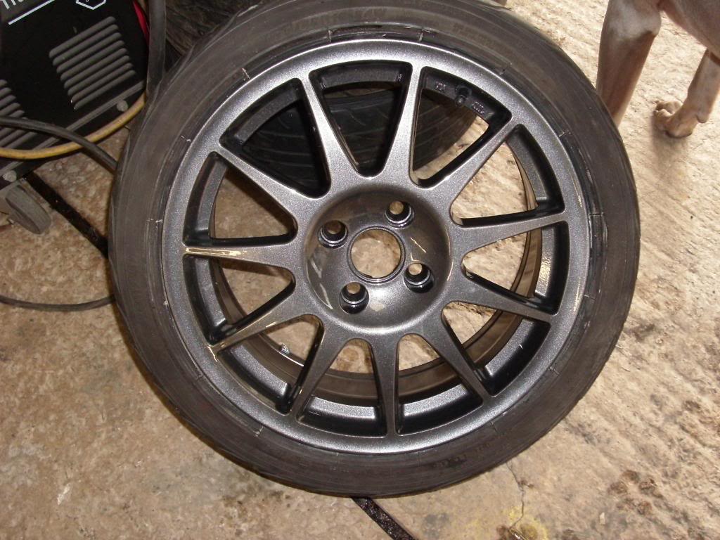

Had another delivery! My cage arrived from Ktec, the wheels are back from the powder coaters and the welder has arrived so it's been a busy week for parcels!
Going to start tacking in the cage tomorrow
Is that the oreca cage dude? Interesting to see if it just welds together nicely or needs a bit of work to it. Another nice delivery :)
Yes they were. Stuart had to acid strip the old powder coat off so I wasn't popular but a bottle of whisky always cheers him up!

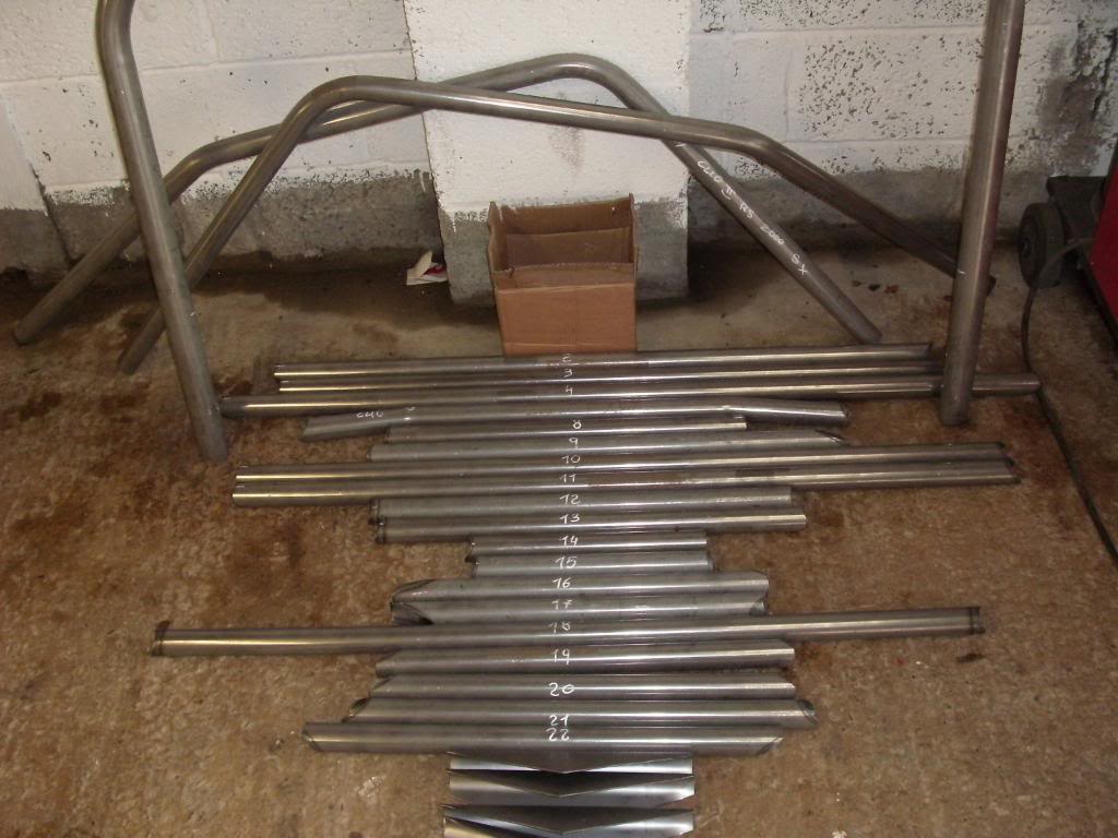

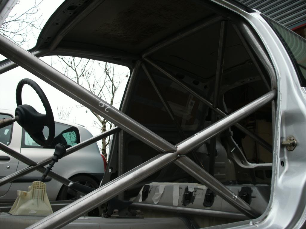

Yes it's an Oreca cage. So far it has been just a case of putting the bars in and tacking them in place. Before I bought it one of the other CS members told me about his probs with custom cages and every bar needing extra work. That put me off CC and I went for this Oreca race cage from Ktec which was actually cheaper at around £650.
Nice stuff, get some pics up of it all tacked together. Is there a harness bar or are you putting one in? Looks decent if it all goes together the way you say, do they supply feet and that or are you welding in?
They supplied three different types of feet and bolts if you want to bolt it in but it requires welding so once it's in it ain't coming back out. Came with a diagram and all the tubes numbered but no wordage. It's not rocket sience so fairly straight forward. I'm tacking it in then Stuart at Carrick Engineering will do the rest as he's a coded welder. Then it's all getting painted white a la cup racer.
Just finished in the garage and most of the cage is tacked in. The tube lengths were all perfect and it was relatively straight forward. Kit didn't come with a harness bar but I'll make one up to go in once the cross has been checked for squareness.
Need to order A and B post gussets and make up the seat mounts next.

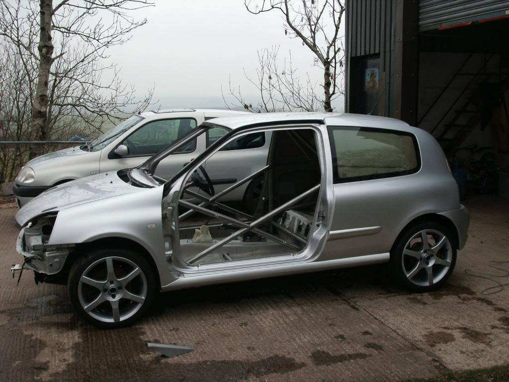

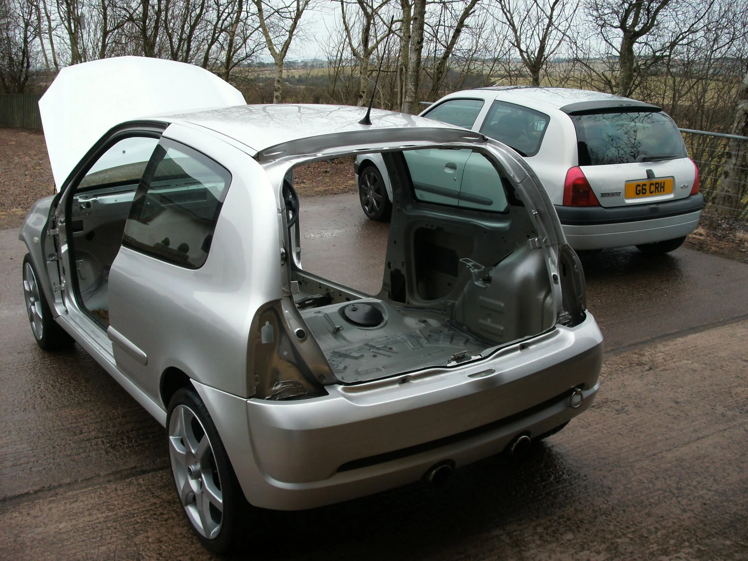

Bit of an update from the weekend.

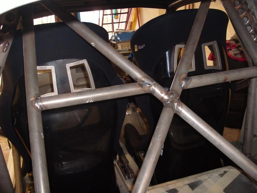

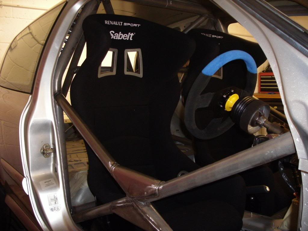

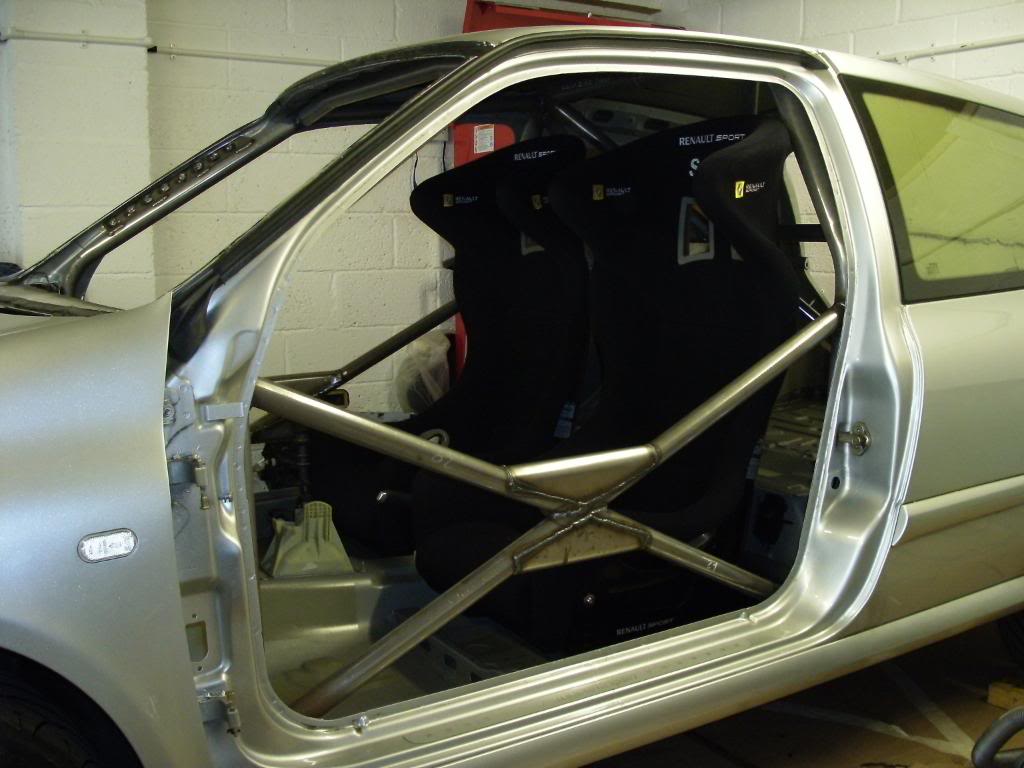

I had the cage which was tacked in properly welded up. While Stuart was doing that I made up seat brackets for the floor with M8 bolts welded in to sit the seat side mounts onto. Also cut and shaped some extra tubing for a harness bar. After a quick clean up I've started a test fit of everything inside to made sure it fits and has just enough brackets bolts and holes. The rest will be cut off prior to paint. Also need to work out where the battery, extingisher and cut-out switch are all going. Then remove evrything and prep for paint.

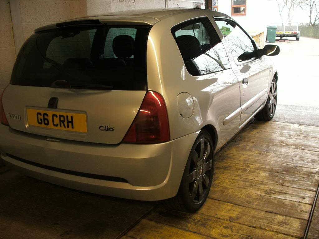

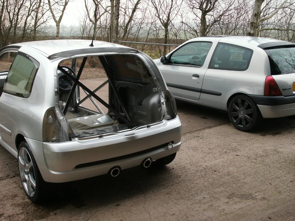

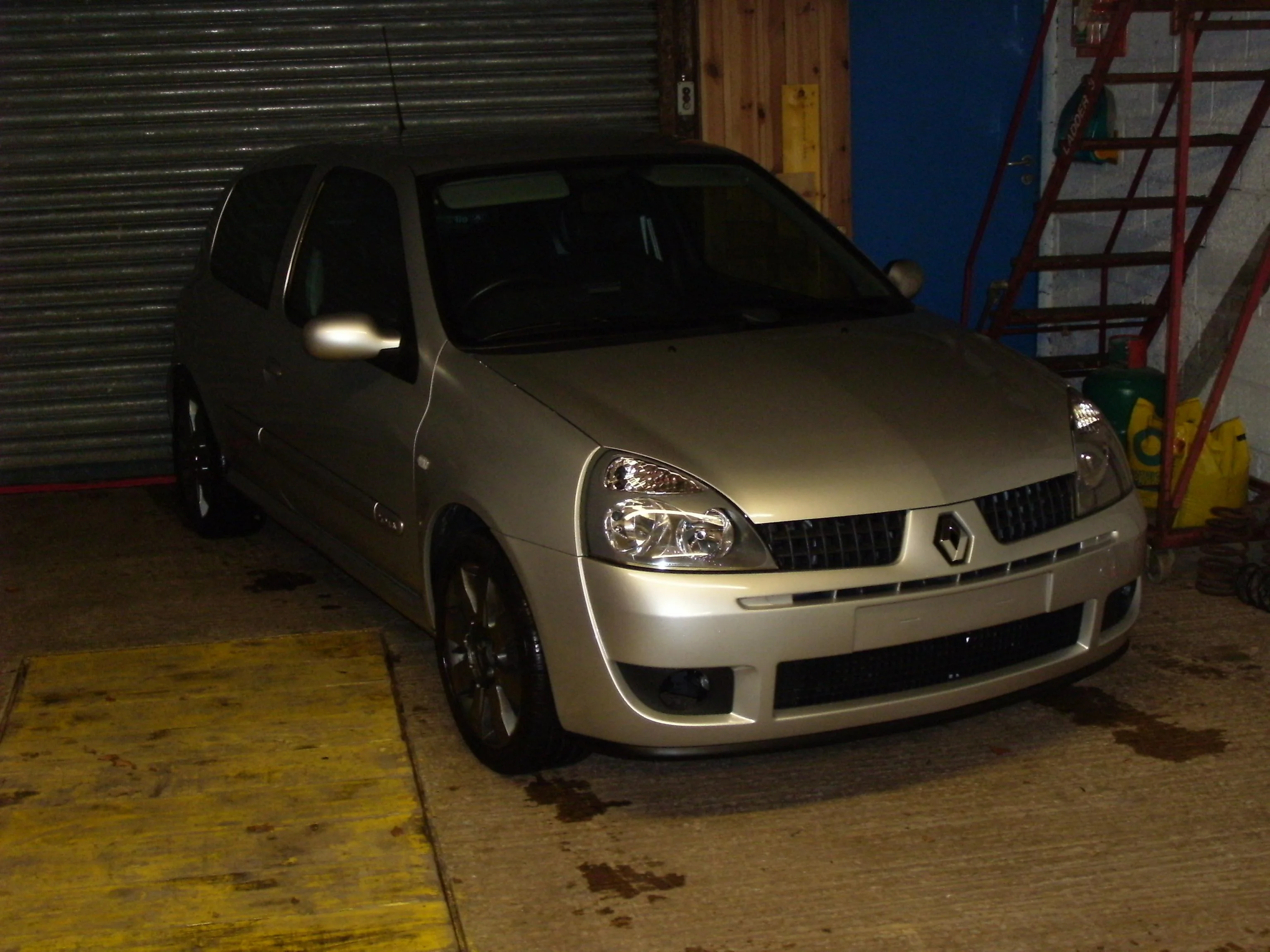

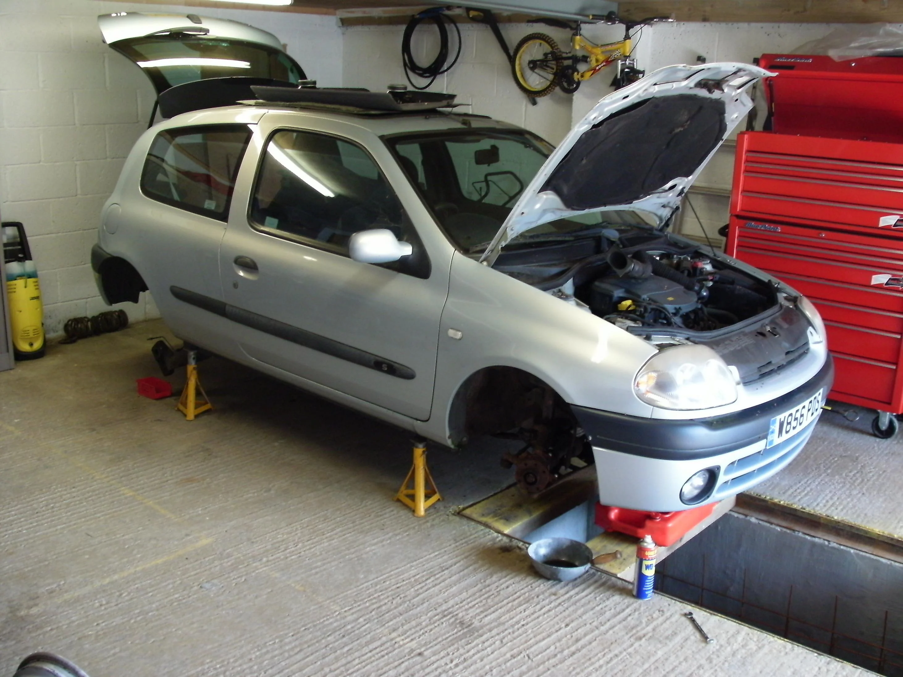

Did a bit of work on the 1.4s as well,
Before,
After,
Bit of a mix but now has 182 roof spoiler and side mouldings and 172 rear bumper. I've the 172 front bumper, wings and skirt painted and still to be fitted.
