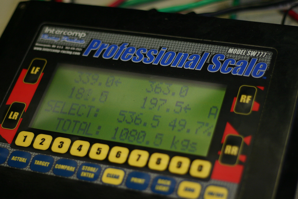

Sorry I will disagree there. The B14's are much much better then standard shocks and sportlines.
You'll agree with me also when I say that corner weighting makes a MASSIVE diifference ;)
Was that sarcastic? I genuinely don't understand how it can make a difference? Unless you are including taking weight from one corner/axle and spreading it more evenly to the others? Battery is one example I was given by a friend.
Corner weighting means the diagonal spread is a perfect 50/50 balance. Made such a difference on my LCR. As Emma has confirmed when I convinced her to go and get hers done too, she agreed when on track it makes all the difference.

In layman's terms it is done so that all four corners have a fair share of all weight, the result of one corner working harder than the other is bad handling...simples

I had mine corner weighted and although I never noticed a big difference the car felt very well balanced.
I get what it is. But I can't come to terms with it. Lets say for example on my car. Obviously it's going to be a lot more weighted on the front corners than the rear. But then how do you change that? I can understand moving small things like the battery to the rear. But what else is there to do? Can you actually get a perfect 50/50 spread as you say Dan?
Errrr coilovers? lol
You raise the front and lower the back which shifts the weight distribution to the rear wheels
But no you can't get 50/50 front/rear on a clio - but you can try to get 50/50 left to right and 60/40 front to rear
Again it's kinda pointless though when you throw a 100kg passenger in the car and it all shifts to the left
What about if you put a 50kg passenger in the boot lol!
In all seriousness, is it not possible then without having adjustable coilovers?
nope its not , and some people set up cars to be across the diagonals for balance , and some will go for across the axles , it depends on the cars initial front rear distribution and whats important .

actually i will muddy the waters , you can corner weight a car without coilovers , but it would involve physically moving weight around the car ,and placing lead (or another ballast weight to even things up ) but the manufacturuer will have done this in the design process as a best compromise
hence why we use height adjustable suspension .

You can get 50/50. Emma.'s is 49.9/50.1 iirc.

Emmas results ->
702kg front, 379kg rear - so a 65/35 split
Pretty much what I expected from a Clio
Ohhhhhh sorry somewhere in the conversation it had switched to front:back
Yes it's a good diagonal split
I suspect mine would be fairly close with battery in rear passenger side and cage over rear wheels etc..
