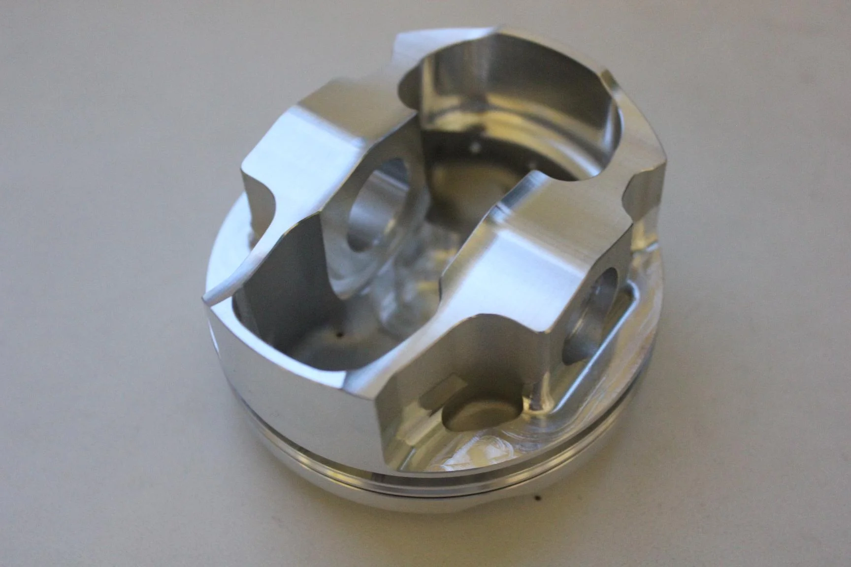

Already got most of parts for new build. Now I need do decide what to do:
1) Bore 83mm with Woessner piston and all other standard parts
2) Bore 84mm with Clio Maxi pistons and +4mm ConRods

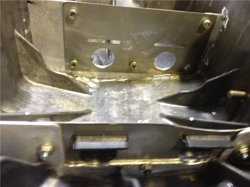

3) Bought some Sodemo F4R engine from Formula 3 car - with dry sump etc. But need to buy more parts for dry sump: pump, tank etc and it is out of my budjet now :(

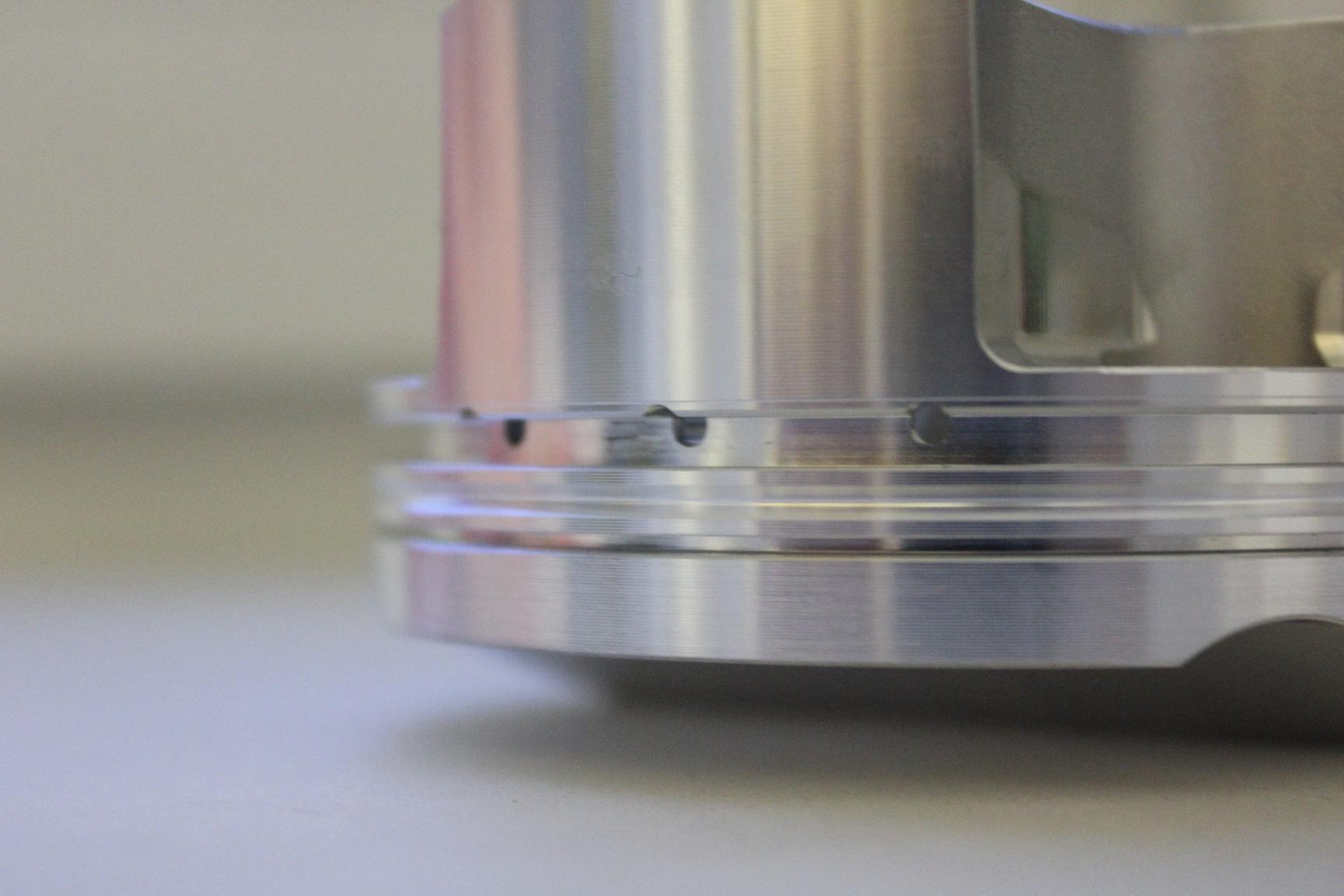

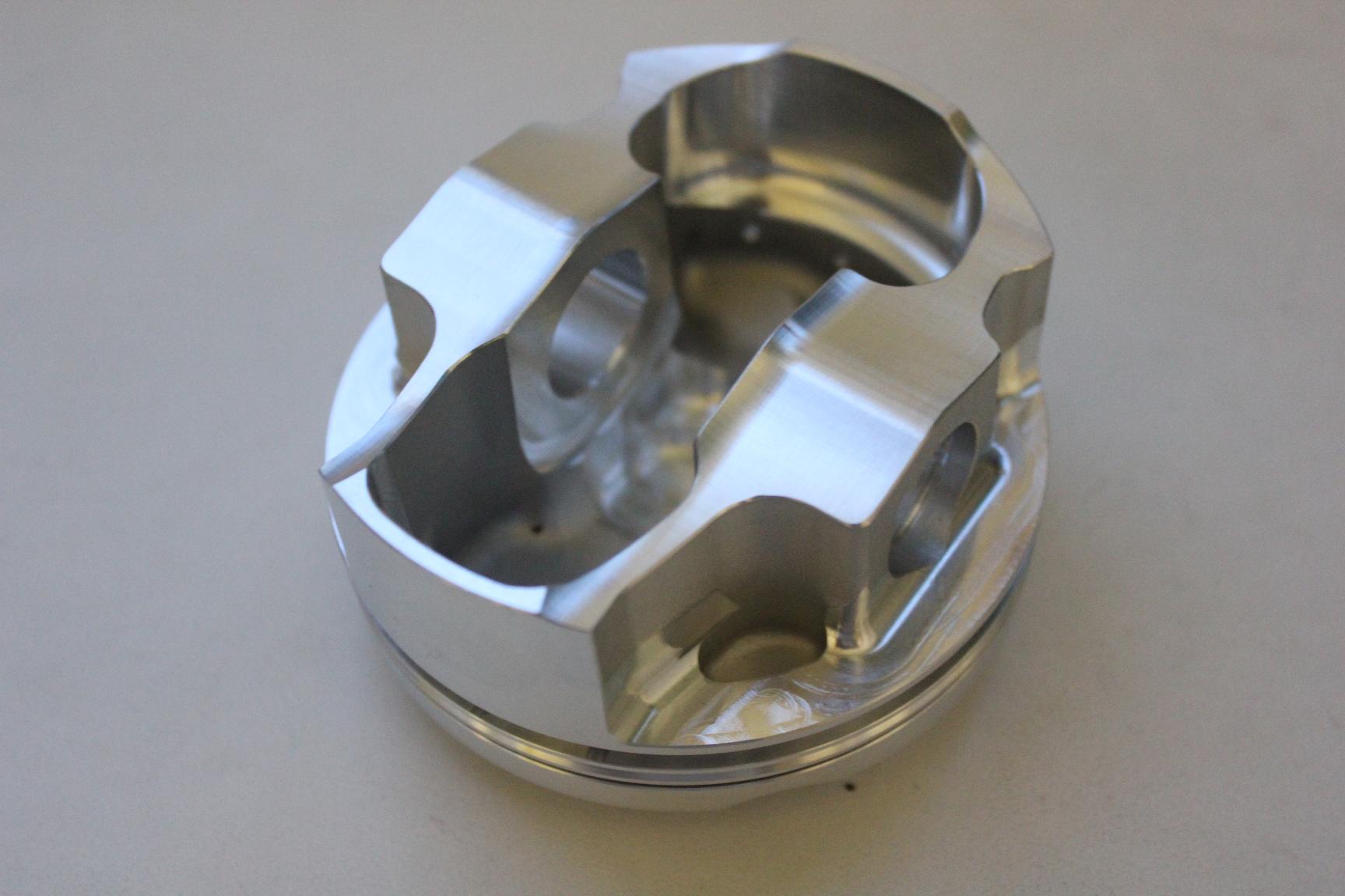

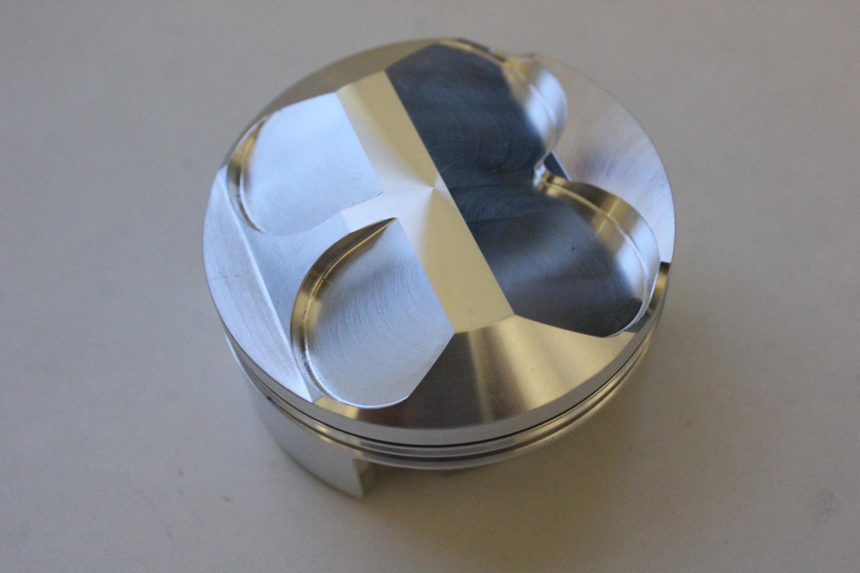

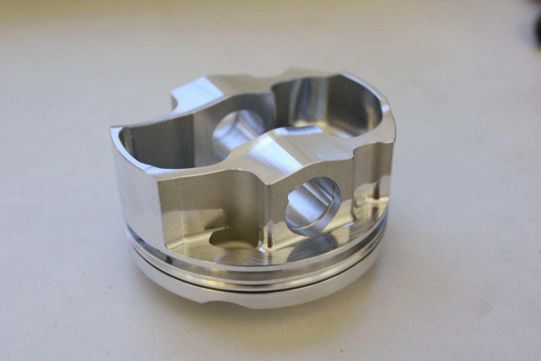

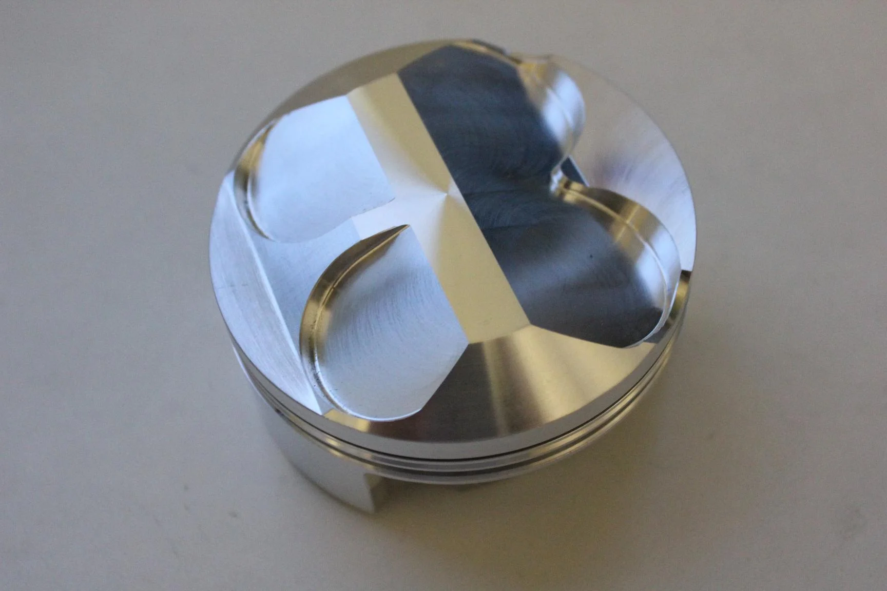

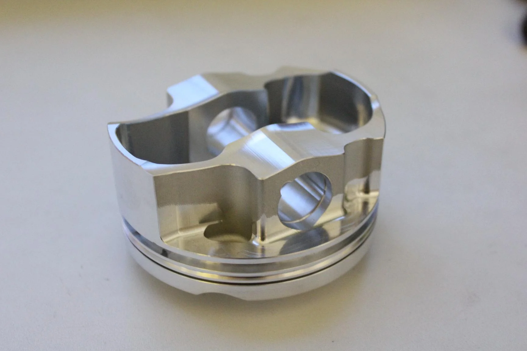

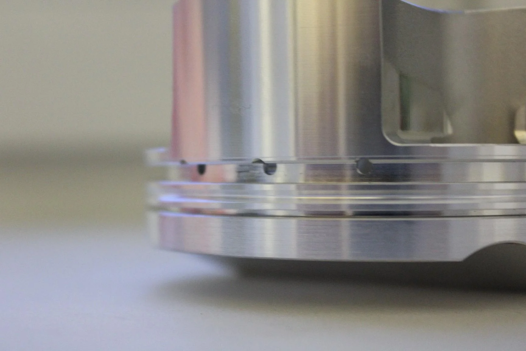

JE Pistons from Clio Maxi

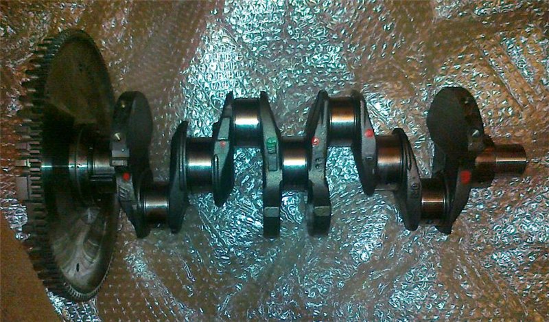

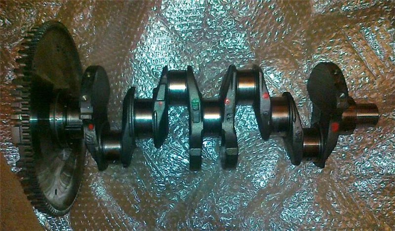

Any ideas about Renault's F4P engine? It seems the only difference is the cranckshaft and pistons, isn't it?
Some bad news from our local timeattack championship ... It seems that I need more then 100kg of weight with my current 2.0L engine. Or build some new 1.8L engine :(
Ive only got experience of the F7P vs F7R, but in that instance the bore is slightly smaller as well as the shorter stroke.
The stroke is shorter, hoever I have +4 mm com rods. I am not worry about pistons at all as soon as I can easily make the custom pistons. The main question is the crank - the custom crank is very expensive ...

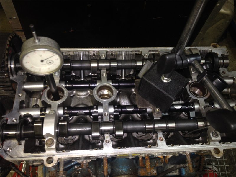

Got some Sodemo F4R-based engine (seems from some Formula 3 car). The bottom is very ddifferent, however the head seems to fit the standard bottom well. So will try to build the new engine with this head:

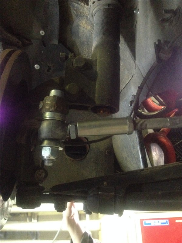

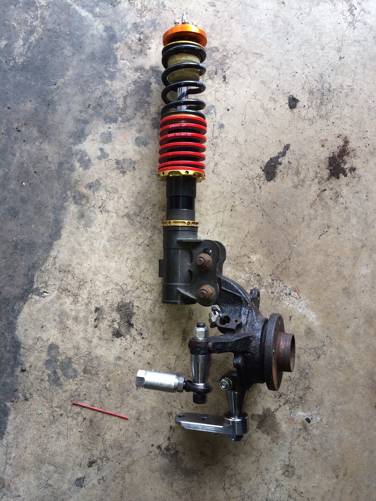

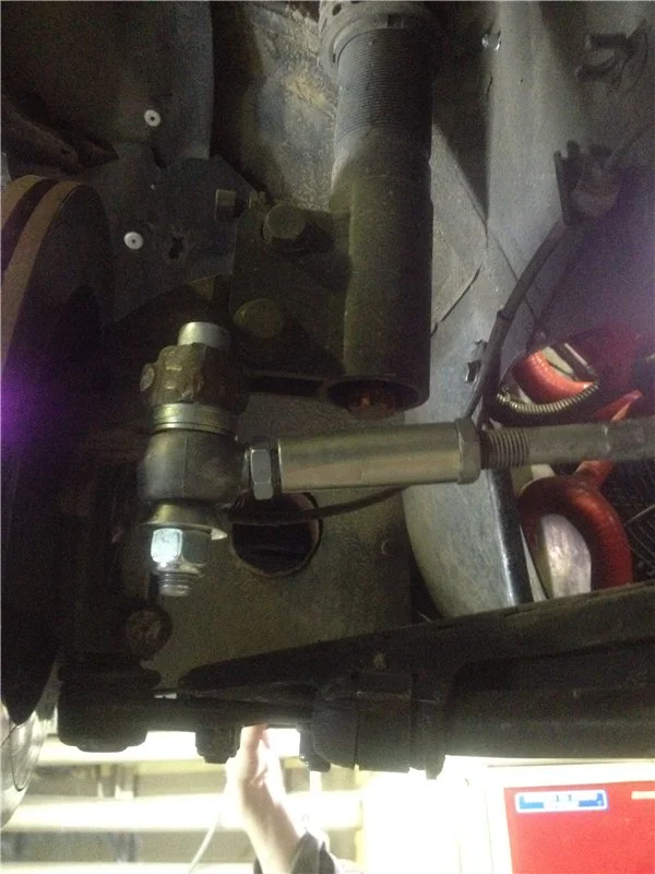

Have you considered going a bit further and going for the rollcentre kit a couple of the lads on here do, rather than just bump steer correction?
If you are running the car low the wishbone angles are really poor and I was amazed at the handling difference from the roll centre correctors.
Like this:
Yes, this is close to what I want to do - make it lower and wider. However I want to do this with PM's wishbones, so I need to buy Lanuna uprights and hubs etc - to small time as soon as our local championship will start it two weeks and I have a lot of things to do before this (including 150 mm con rods etc)...

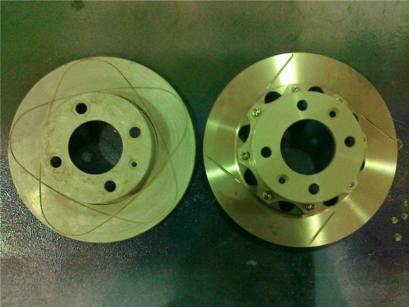

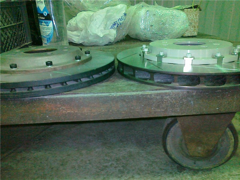

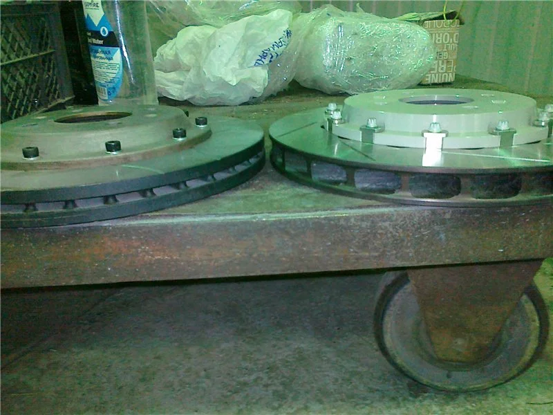

Make new brake disks, with AP Racing rotors and floating mount (right) - size is near the same (285mmx25.4 mm) but with bigger P.S.D. and Air Gap. Will weight both tomorrow (forgot my scales today):

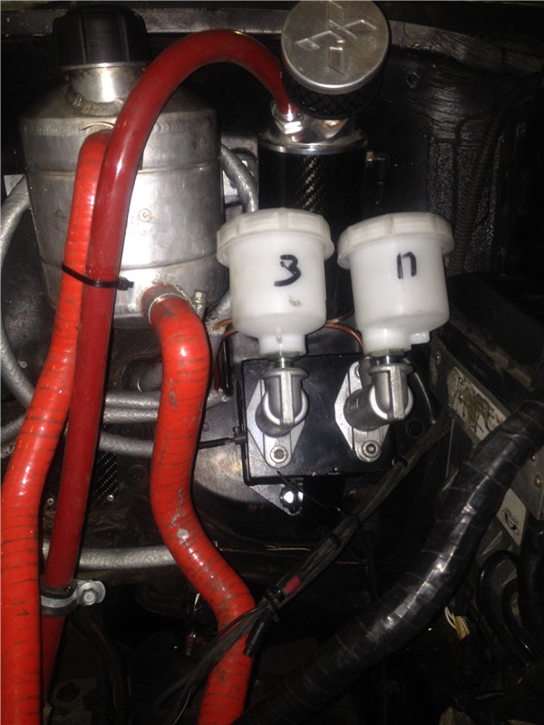

I personally dont race at the moment, just do trackdays so no such rules, but yes a lot of our championships here which the clios are eligable to do not allow in car adjustable bias.
I take part only in some local semi-professional timeattack championship, however I have two garage neiborhoods - one take partin RTCC, another one take part in RRC - and both use in car adjustable bias. Really I hope that as soon as I will select of true front/rear master cylinders (currently I have both 0.625") - then I will no longer need balahce bar, just proportioning valve will be enouth!!!
And what about Proportioning Valves - are they allowed in UK?
Re brake disks above. Left is 5.5kg (12.125 lbs), Right is 4 kg (8.82 lbs). The original like Brembo High Carbon is 7.25kg (16 lbs).
Usual thing is that they are allowed so long as not within drivers reach and there is normally a minimum amount of bias that the rears must have as well.
