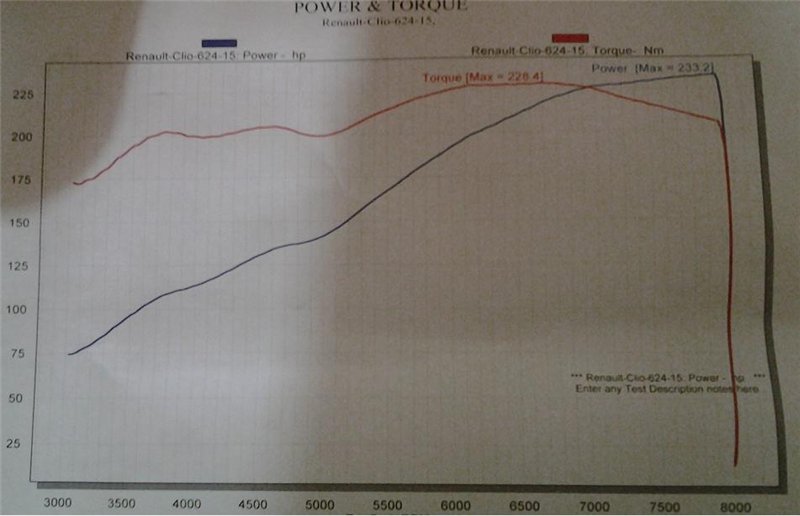

233 bhp 228Nm dyno results:
this has to be the highest on the road NA example of the f4r to date? :eek: how have you got the torque so high?!
  182/RS2/ Turbo/Mk1
By measuring it in NM mate ;)
224NM is 165lbft
With his longer rods and new exhaust manifold etc, I bet there is a significant gain still to come though.

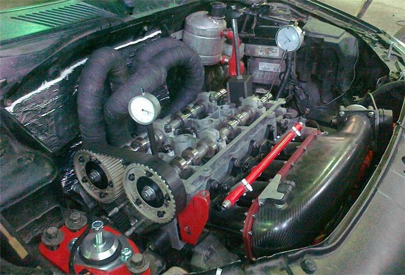

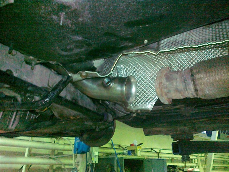

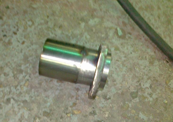

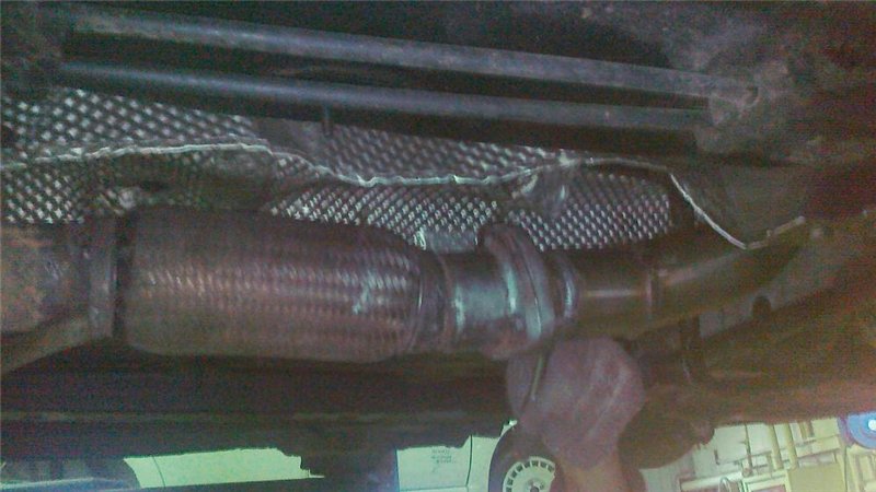

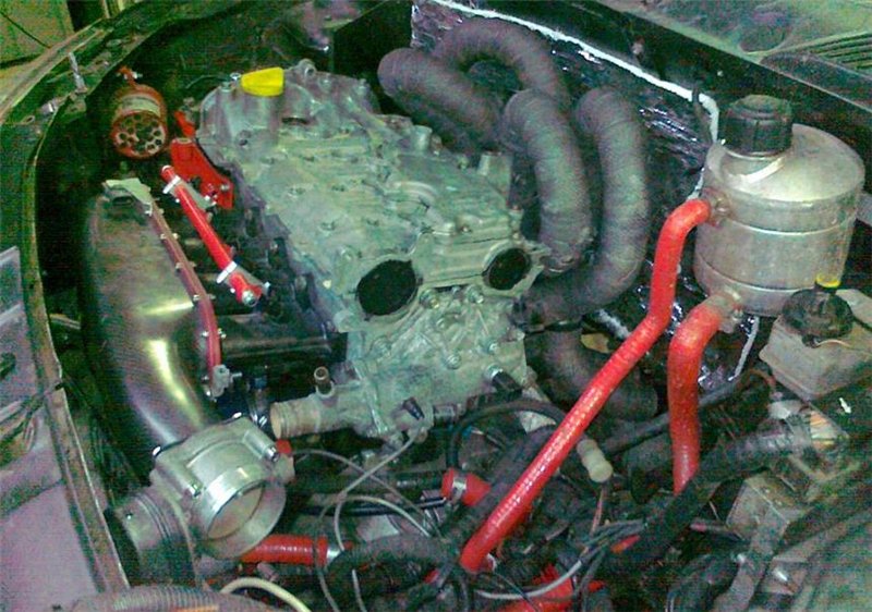

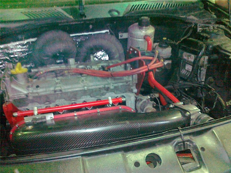

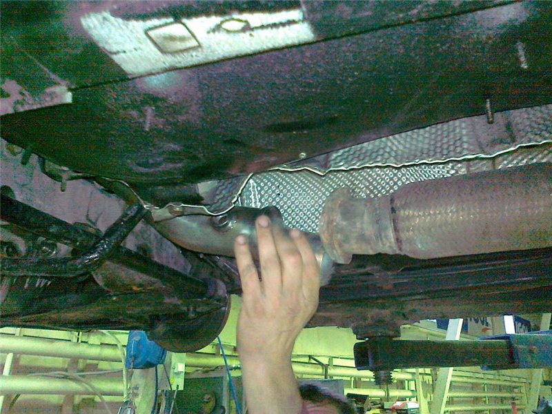

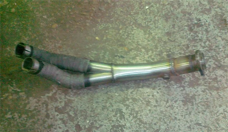

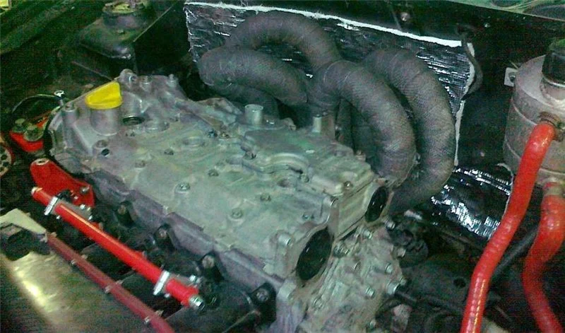

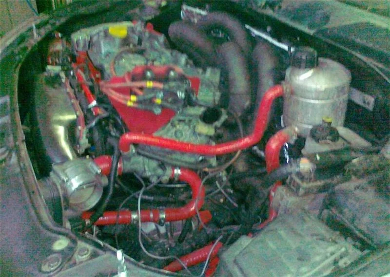

So, new PM's exhaust manifold was installed at Friday. First of all - I found that it is 64mm (2.5") while my current exhaust is 60mm - so I will need to make totally new exhaust ... later =)
  Clio 172 ph2

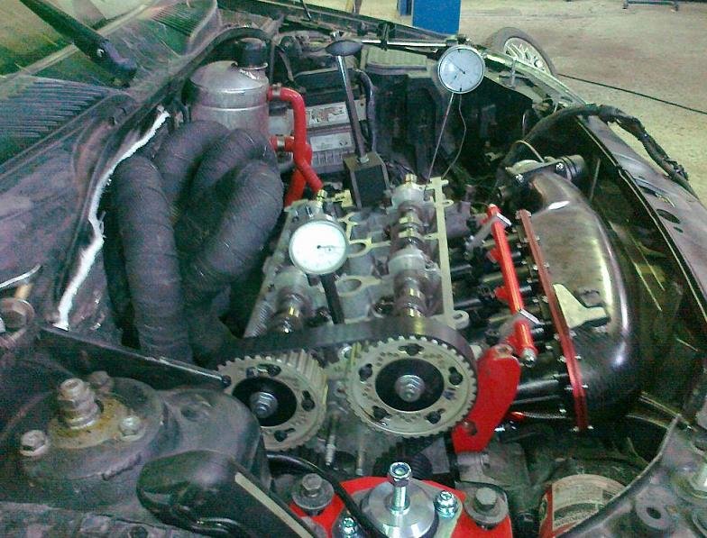

The second what I found that to install the PM manifold I need to take-off the engine ... or cylinder head. Otherwise it will not fit. And I need to reallocate ignition coil pack. oil catch tank etc...
  Pink Cup Racer
Depends what power you actually want to tune to, while an F4R isnt too hard to get to 240, you hit a bit of a wall not far from there really, getting 280 for example is far easier on the XE and even more so on an S2000 or Duratec.
Its like I said, solid lifters are only 300 quid for an XE, and no rockers to worry about, so it means you can get the revs up and revving an engine is useful if you want to make power. So its thousands cheaper to get a decent spec head on an XE than on a F4R.
You can just fit solid lifters in the f4r and cap at 8k, xe would need dry sump for8k plus anyhow. Be interesting what JRE would want for a similar output to the PM Sandys engine. Don't think you will find the xe's cheapest.

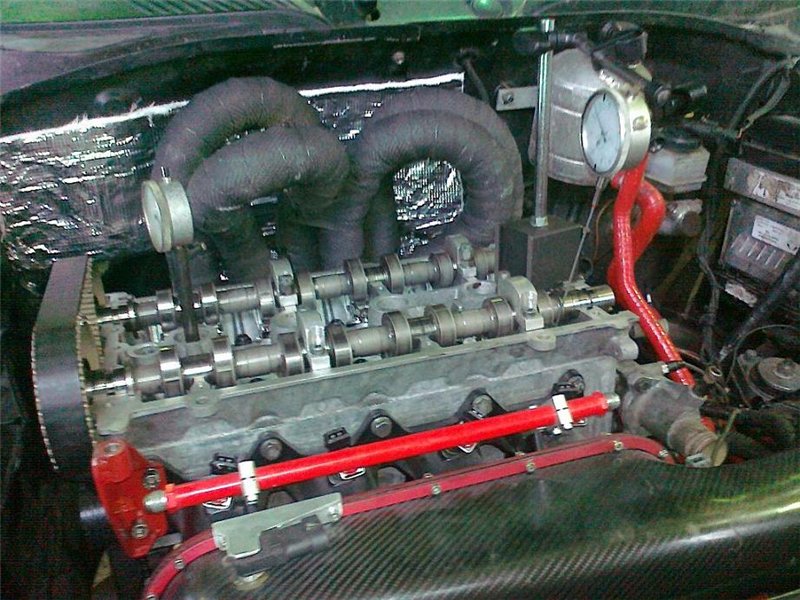

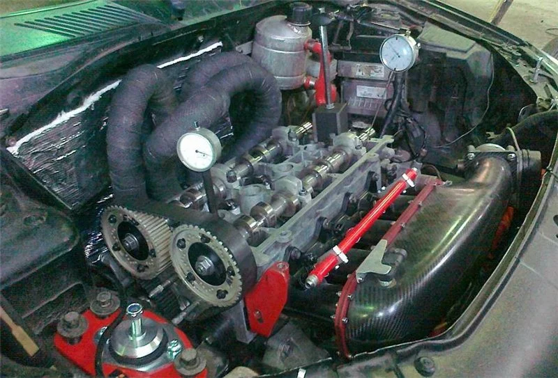

  Clio 172 ph2
What did you to the cam cover to fit the exhaust?
Also was you changing the cam timing?
We take off the head, bolt the exhaust manifold to the head, then put the head back, and set the timing again. Otherwise it was not possible to install the manifold to its place ...
  Cup In bits
Ah okay, I get what your saying. I thought you just had to remove the cam cover.
Looks good, did you make your own cam caps for timing the camshafts to the engine?

Also Morgan, to dial the cams in you just need an old cam cover and drill 2 big holes in it. That way you can set the cams in the normal way. Obviously you need to fabricate a solid lifter as well to get it correct.
