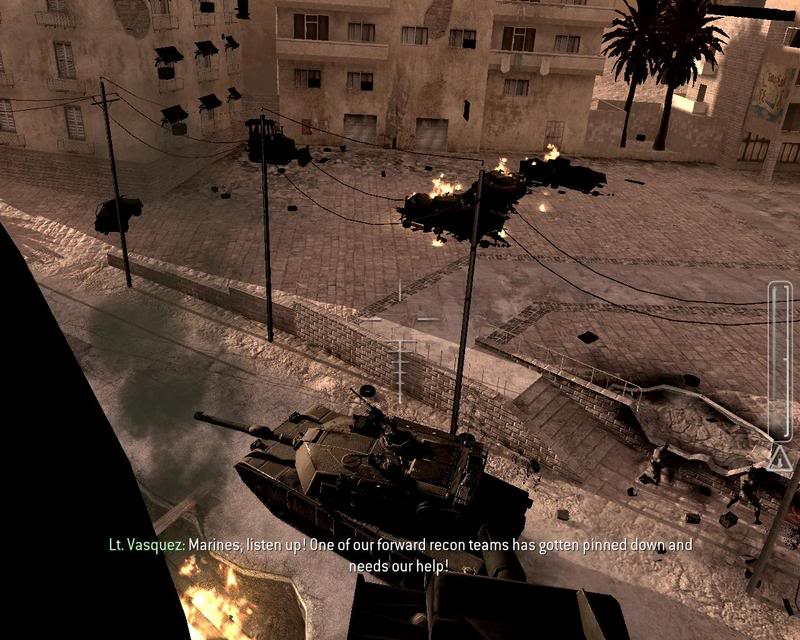

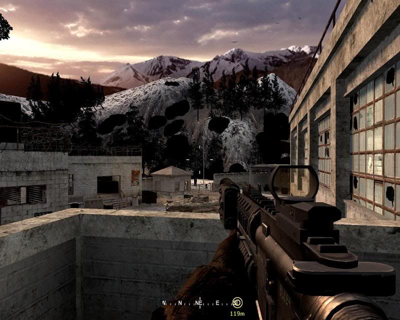

Calling all PC techies - any idea what could be causing the blackness in the pic attached? On some levels of COD4 it looked really bad - like I was playing in monochrome. :(

Another effect it does is rapidly flicker the 'black' sections - almost like on and off. Only does it at certain times - but it's really off-putting, legging it after your team who are flashing on and off! ;)

Appears to be memory related - not overly familiar with the settings on COD4 but can you turn down draw distance (not much at all) - it doesn't appear to be SLIing properly so it's sticking all the textures in one card then not getting the rest.
Managed to have another 'mess' before I saw your post above. It's definitely SLi related (now there's a surprise :rolleyes:) as COD4 comes with a option for Dual Cards.
It's off by default and the game plays fine. When I activate it, that's when I get the issues as seen above. I wonder if the issue therefore is some confusion between SLi and COD's Dual Card mode? By that, they conflict with each other?
I wonder if with the PC set to SLi mode, the O/S handles the dual cards itself and ignores the COD software to do the same job? In ticking the Dual Cards option box in COD, this makes the game try to force-run both cards when the O/S is already handling that bit fine - hence the graphical issues?
