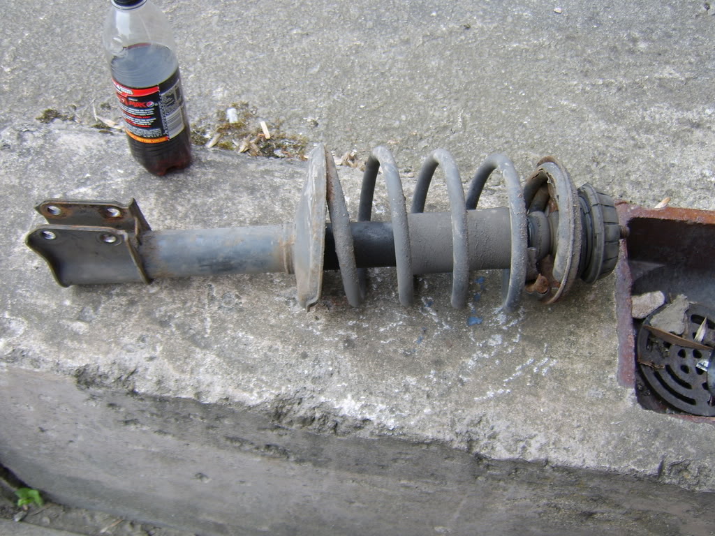

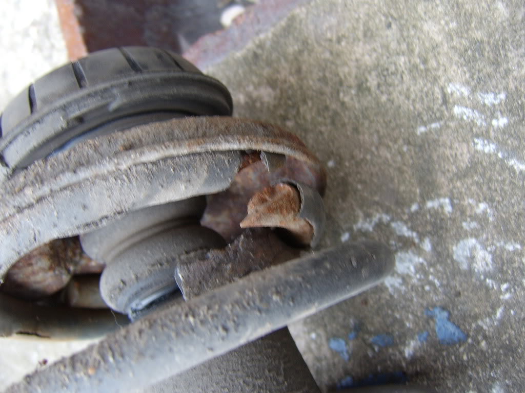

had a little bit of knocking from the front right a while ago but couldn't find the problem when i looked over the car, then the knocking stopped and didn't think much of it.
whilst i was doing some "upgrading" on the car today i finally found out what the knocking was
at least they are being "upgraded"

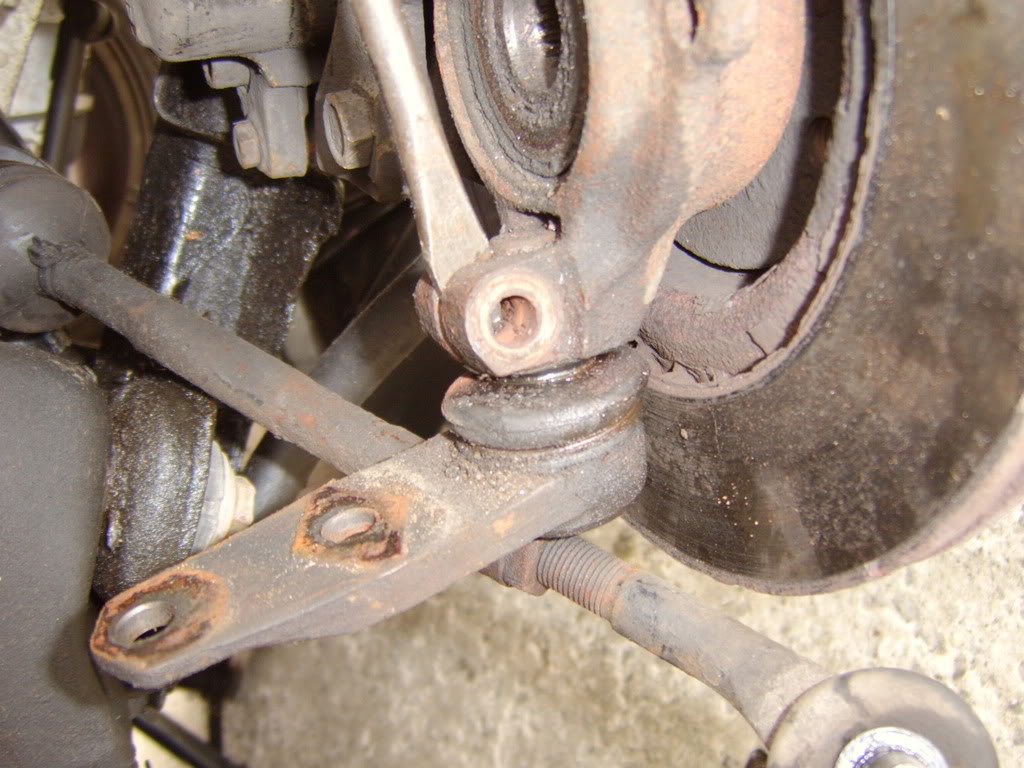

also whilst up "upgrading" I've hit a wall. for the life of me i can't get this ball joint of the hub I've tried spreading the hub to release it put no luck.
would a fork ball joint separator definitely get it off
  ITB'd MK1
use a fork type balljoint splitter, or even better as you have the driveshaft out the way, just hit the top of the balljointwith a hammer and drift. I've used an air hammer on this in the past when they're really rusted up

ball joint splitter did the trick both hubs are now off and half of the new stuff is on. will finish the rest off tomorrow. then I'll do a full update.
