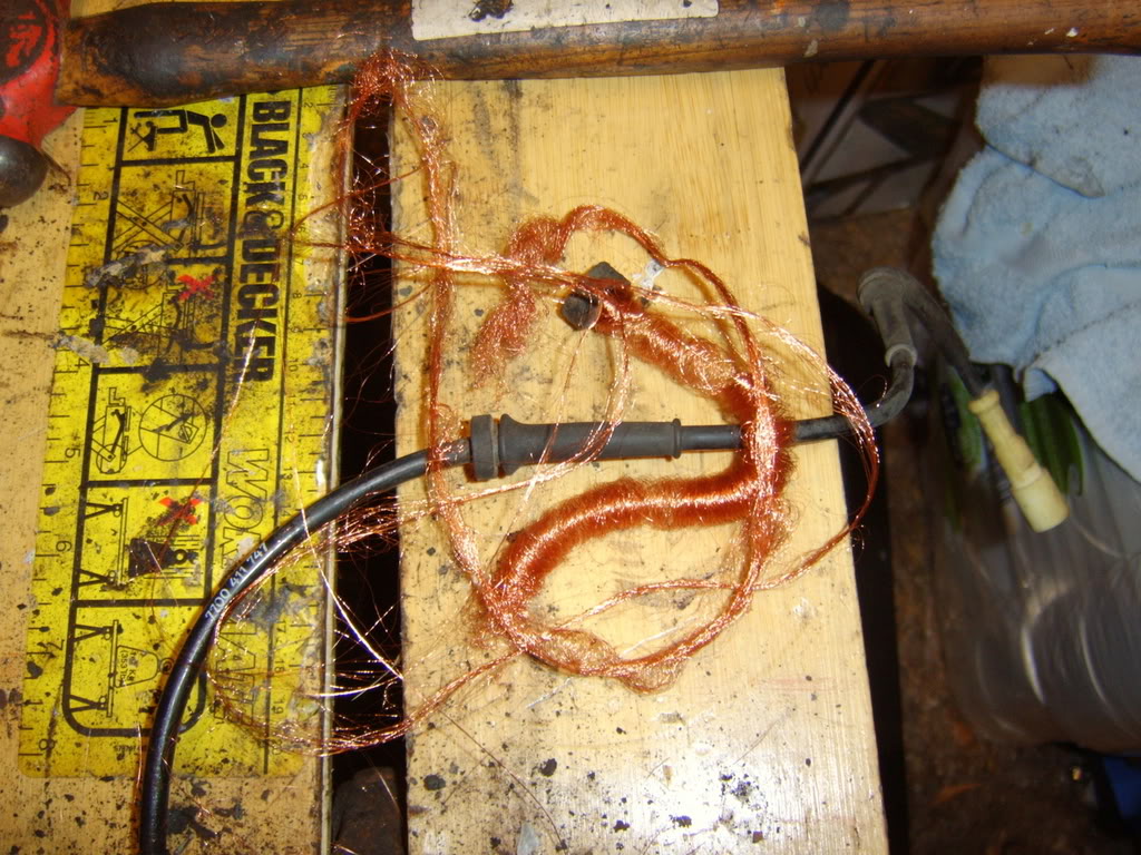

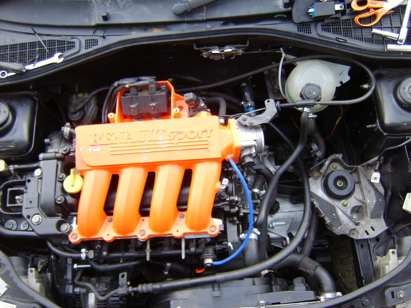

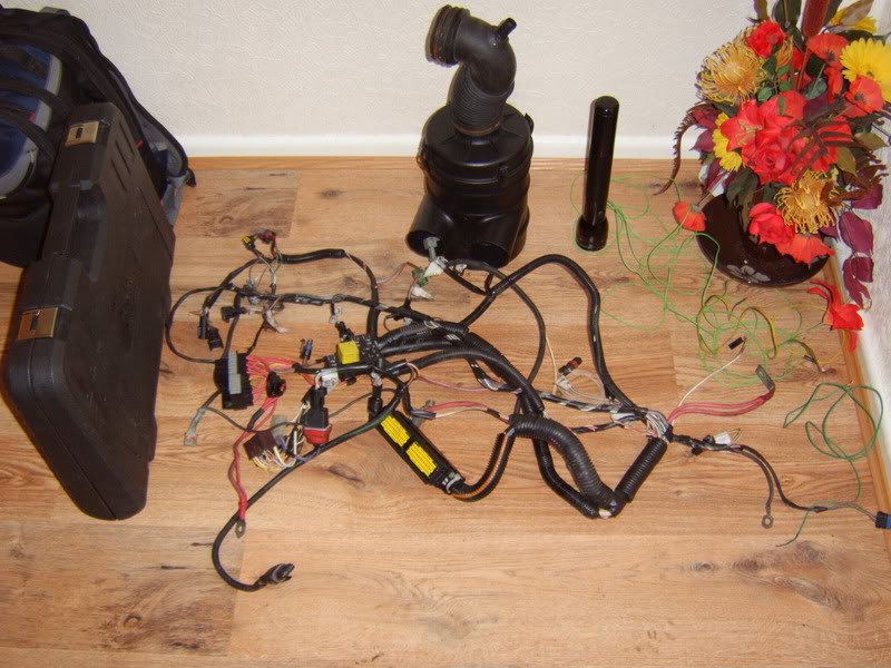

just removed the loom,didn't take as long as i thought it might. allot easier to remove the injector plug compared to the original valver loom
the bay look very minimal, wish it could look like this all the time.
the loom
now the fun begins :(:dapprove:

been chasing wires like a mad mad and have a conclusion on what might be causing the problem and this is a big might... the coil pack
after chasing he fuel pump wires they go brown connector to relay it has two connectors to the relay sharing the same pin then to the coil pack.
and because the coil pack is in original place under the bonnet vent its been getting wet and could have blown the coil pack. but honestly i don't know I'm clutching at straws cos i can't see any other faults on the loom.
could that be the problem? or am i talking utter s**t.
Ive got a spare coil pack mate if you want to try it.... and the brown wires that go to that relay are the ones that the immobiliser relay protects IIRC (earths for injectors/coilpack)...
When it was on the car would it crank on the key but obviously have no fuel pump etc? I still think something isnt right as the ECU should prime the pump and at least one of the small black relays should click, along with the idle control valve making a noise...
wilky19
  Leon FR 184
ive got a spare but thanks mate.
there is no brown wire that goes into this relay(L) it has a red permanent live(red), ignition live(yellow), pump/coil pack(white) ant the a(orange wire) that goes to pin 69

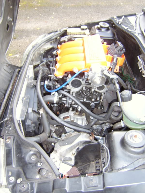

some new stoppers
hopping to brake them down this weekend so can get the hubs machined soon. there going to be paired with a willy widetrack but going to do it with a 172 anti roll bar to help with exhaust clearance.
also i slipped with the grinder:evil:
more pic when its finished and painted
(also for 10 points who old inlets were they?)

They look so much neater with the coilpack bracket chopped off, don't know who started that trend :approve:
i haven't got a clue ;) but as i said i accidentally slipped with the grinder but yes they do and it means i can put the rain catcher back on.

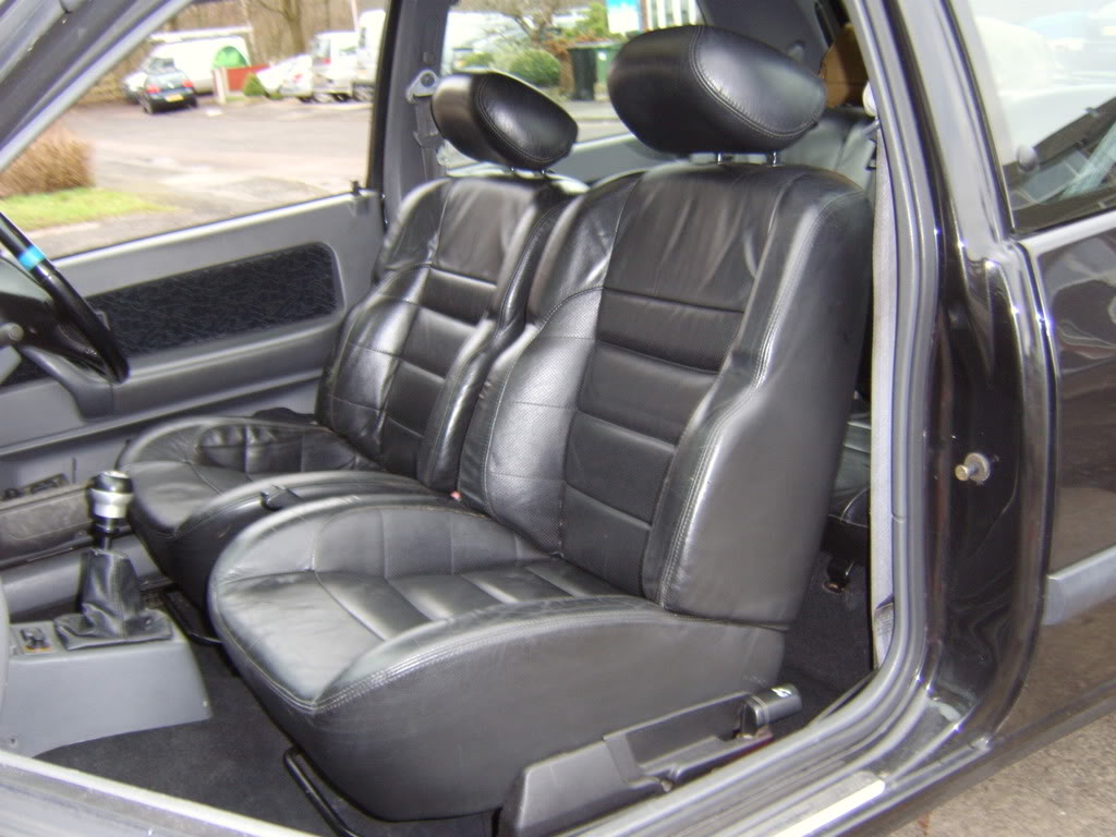

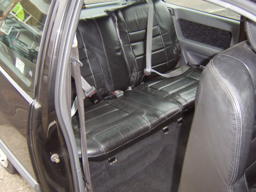

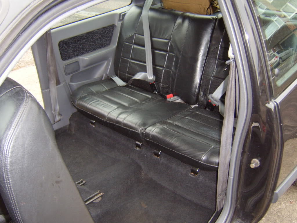

just realised i haven't put any pics up off the new carpet and interior so whilst give it a hoover i grabbed some snaps.
its a leather interior from a Renault 19 16v
the fronts are a direct but the rears are to wide, they look to be a retrim of valver rear seats using the r19's leather. ideally i need to re do them so they fit better. the whole leathers need a good deep clean and dying.

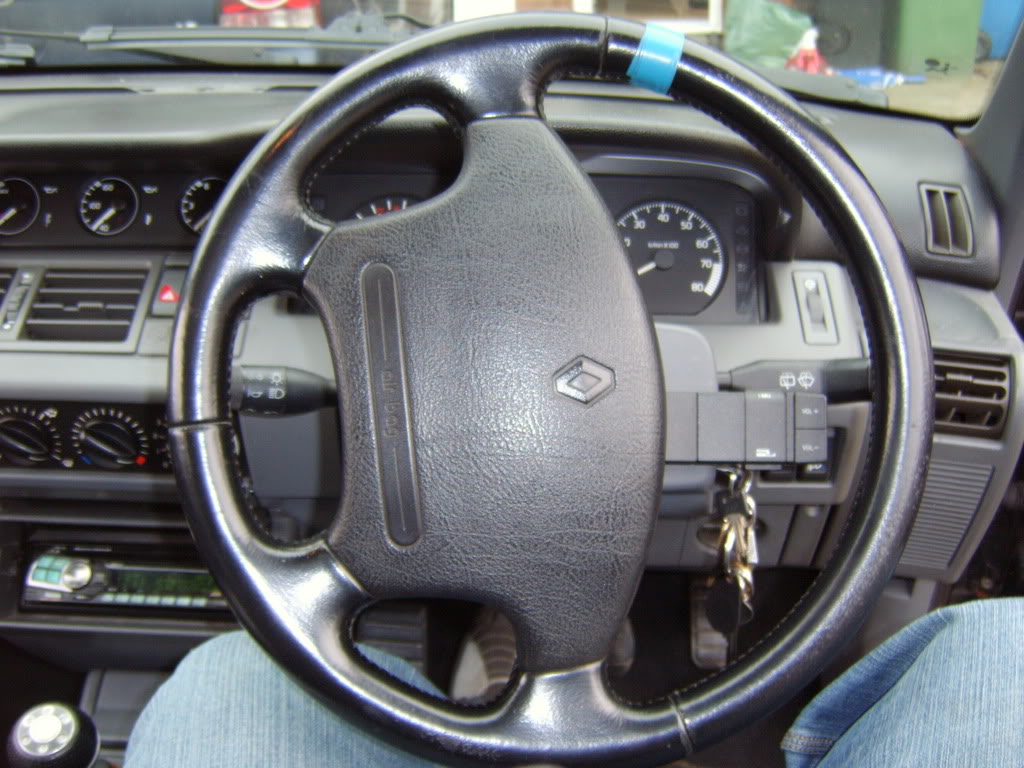

whilst i was messing with the car i decided to do some of the little jobs that are pecking my head.

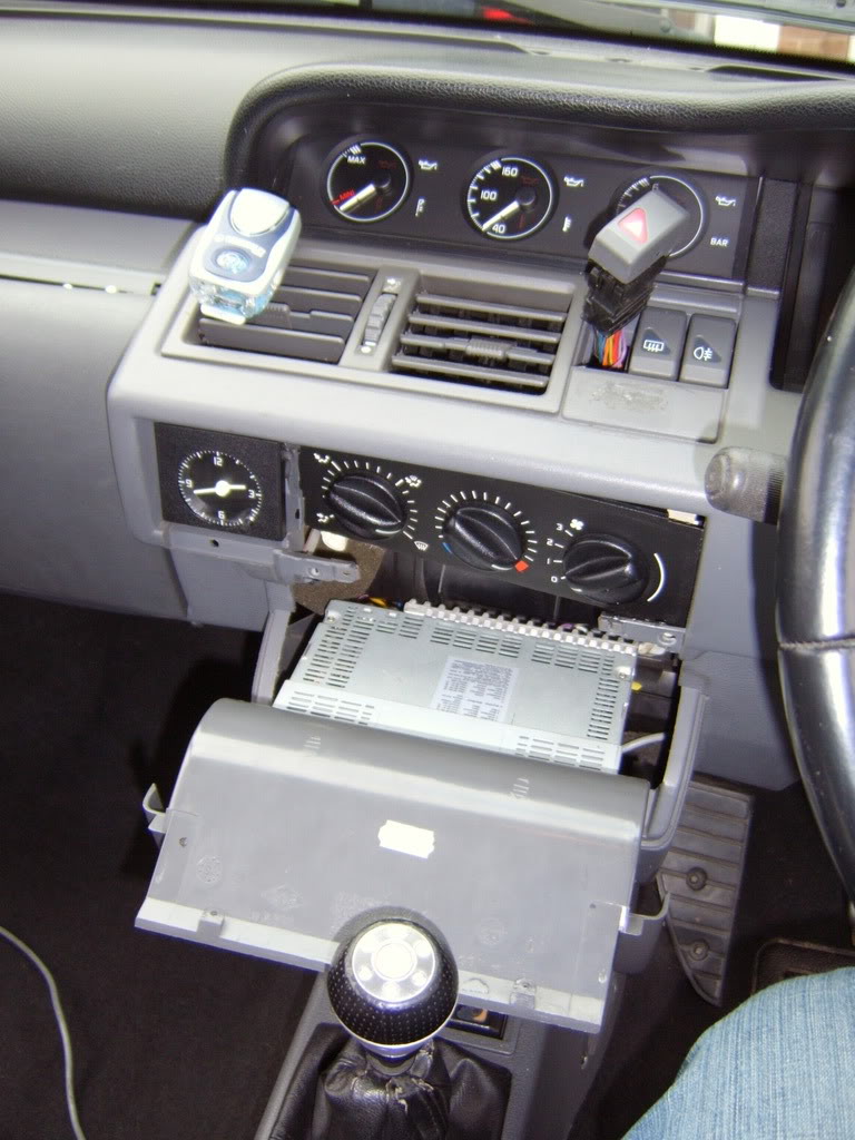

first up was the stereo controls. this has develop a rattle since i hanged the engine. it normal wouldn't bother me but it rattles most at motorway speeds, also i wont work with my stereo and im not paying to fortune that is need to get it work so it had to go
before
after
i also replaced the the hazard switch cos the light had packed in
all this needed messing with just to get it switch out
after sorting that i noticed all the stereo wires had been messed, i quickly re wrapped them till i can get another plug sorted then i'll re do them properly

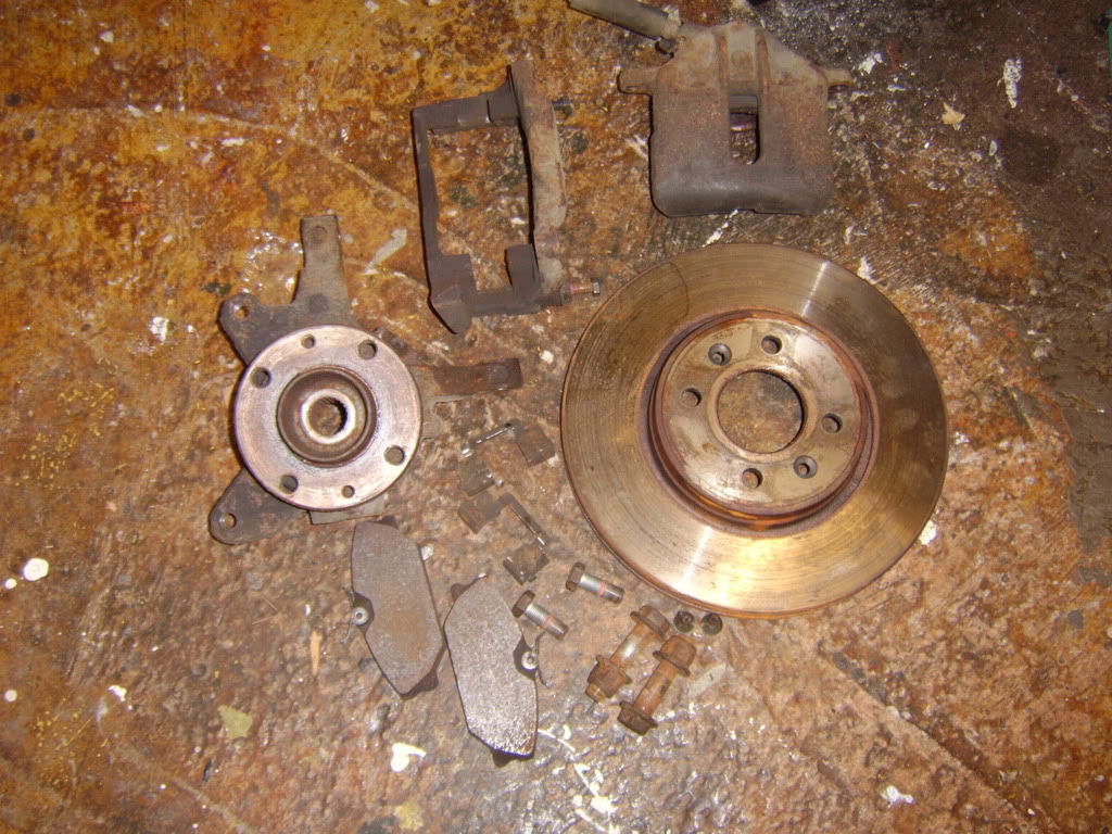

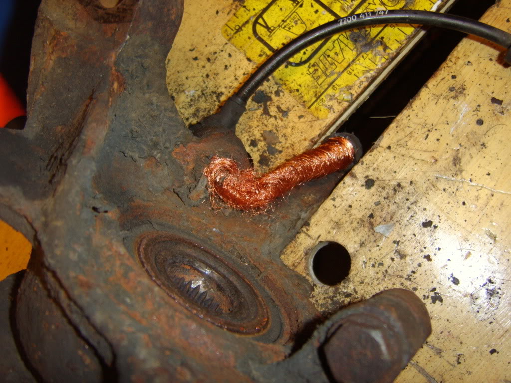

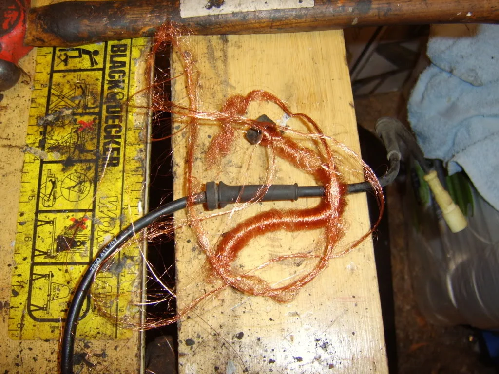

broke down the brake today ready to get them machined.

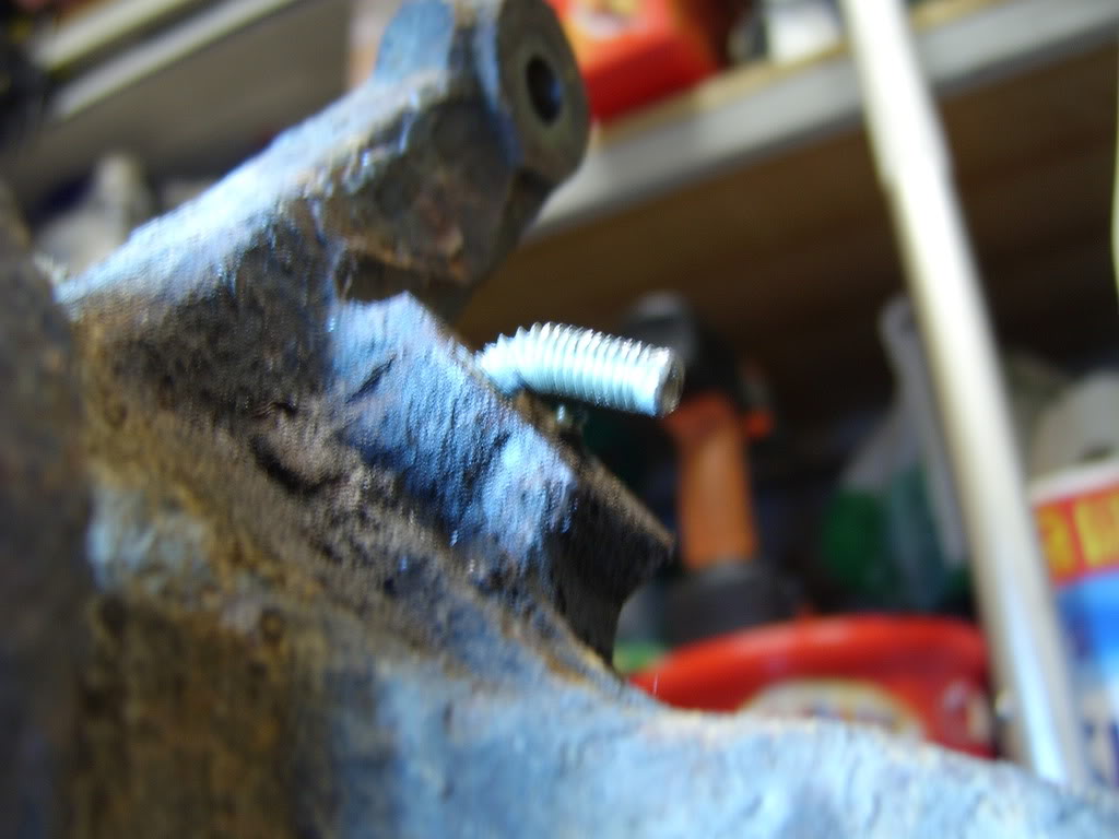

It took this long to do because i had to wait for a 18mm impact socket to arrive. I need this because the carrier bolts would not budge and I don't have a proper vice to to put the hubs in and get the beaker bar on them.

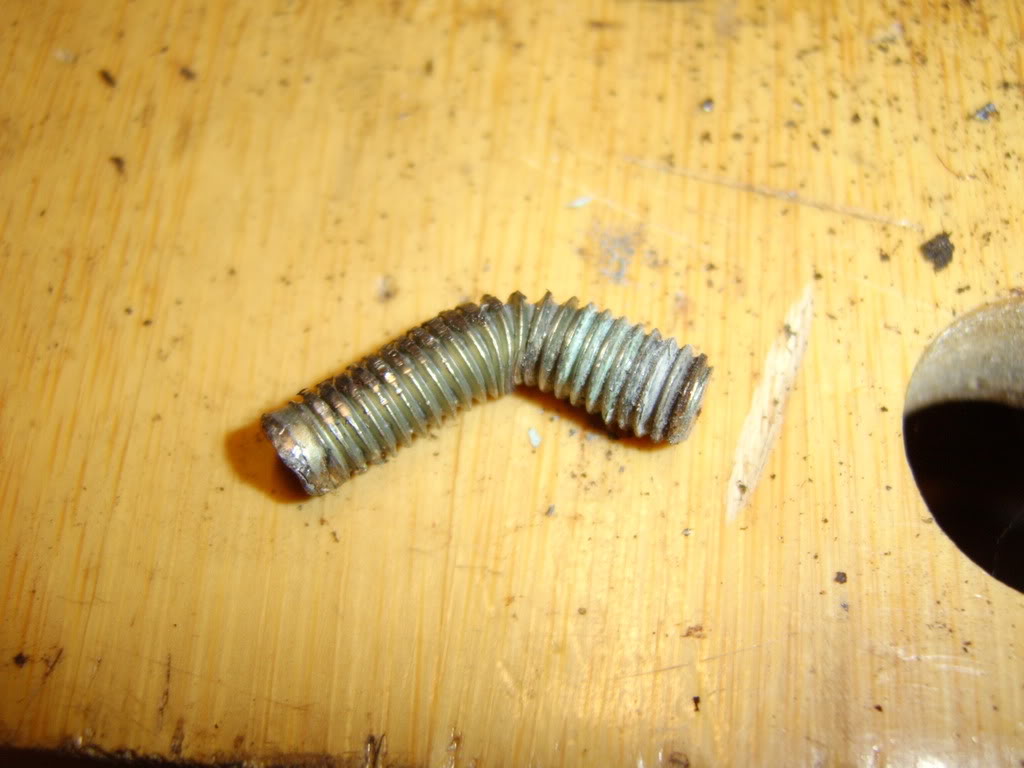

After removing the carrier bolt all came off fine till i went to remove the abs sensor. One of the bolts came out fine but on the other the torx bolt decided to round off. it took a lot off f**king about to sort it but firstly i need to remove the sensors. i thought they would simply pop out but no i had smash the crap out of them to get them out.
this what the inside of a abs sensor looks like
after smashing both side out i had to deal with the stuck/rounded bolt
i firstly cracked it with the hammer till it bend so i could then get some pliers on it.
state of it when was removed
the brakes broke down ready for cleaning and painting.
but the big question is what colour do i paint them?
