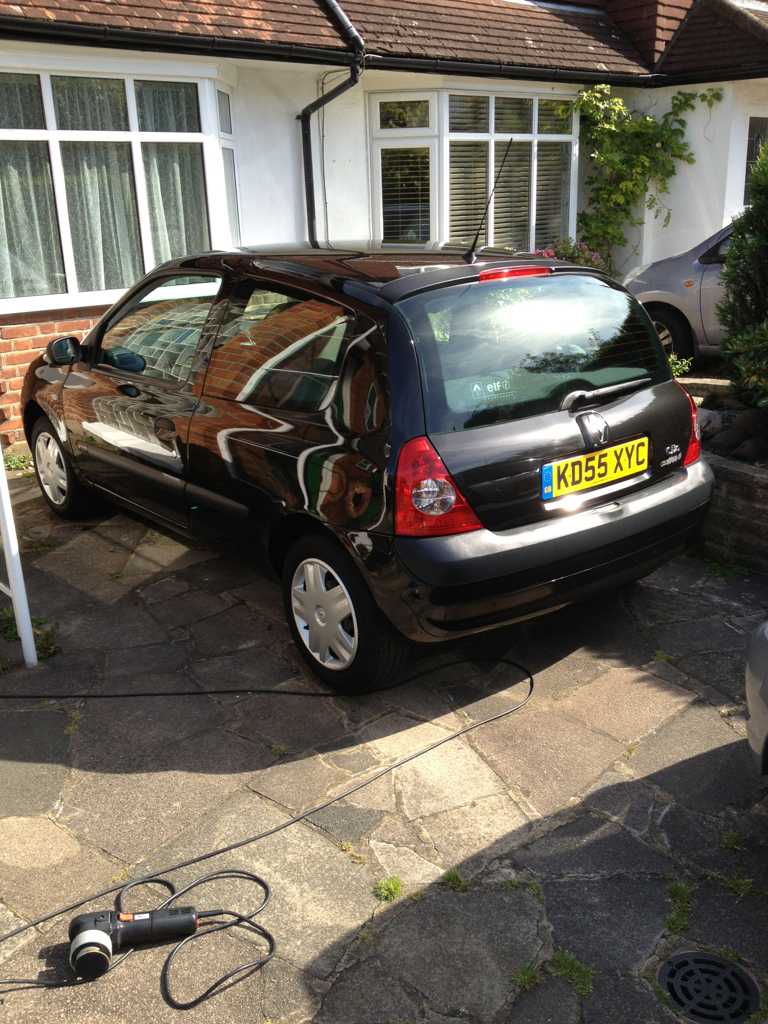

Exactly what I used on my old mans car:
Excuse the naff photo but you get the idea.

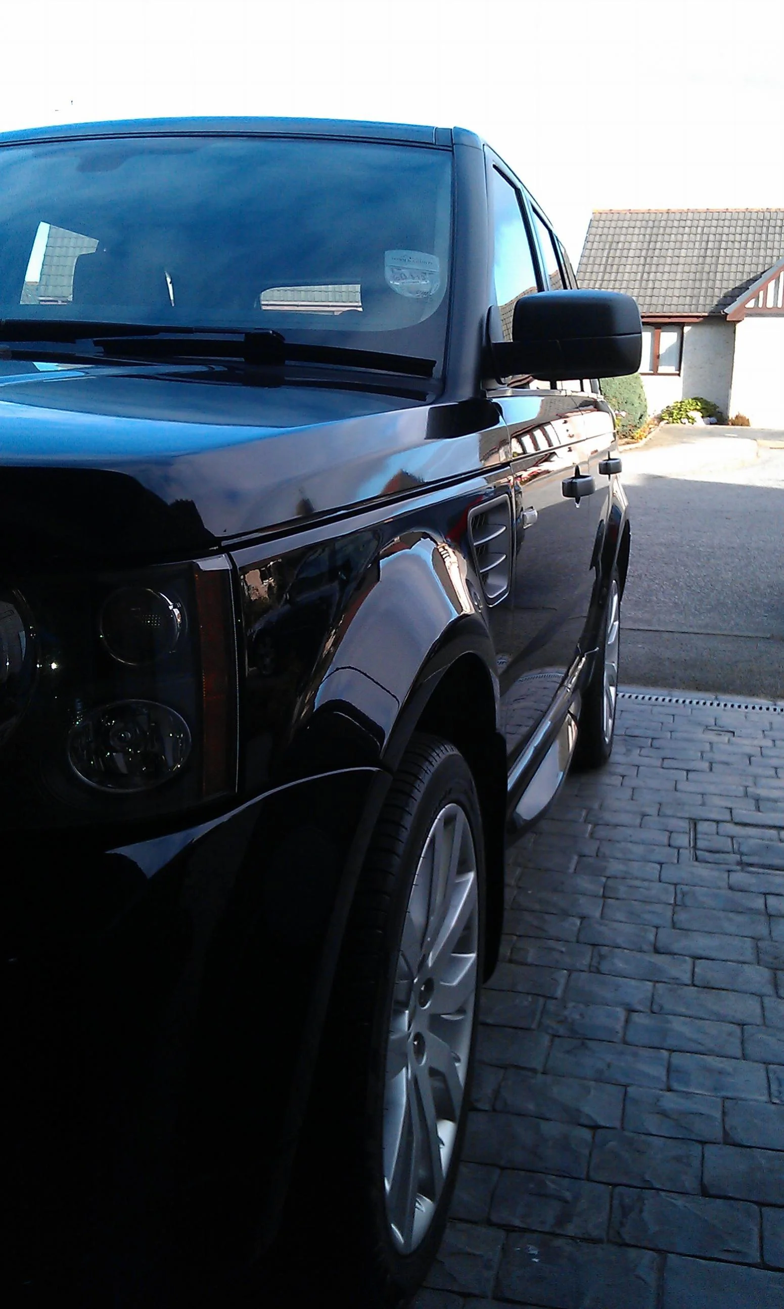

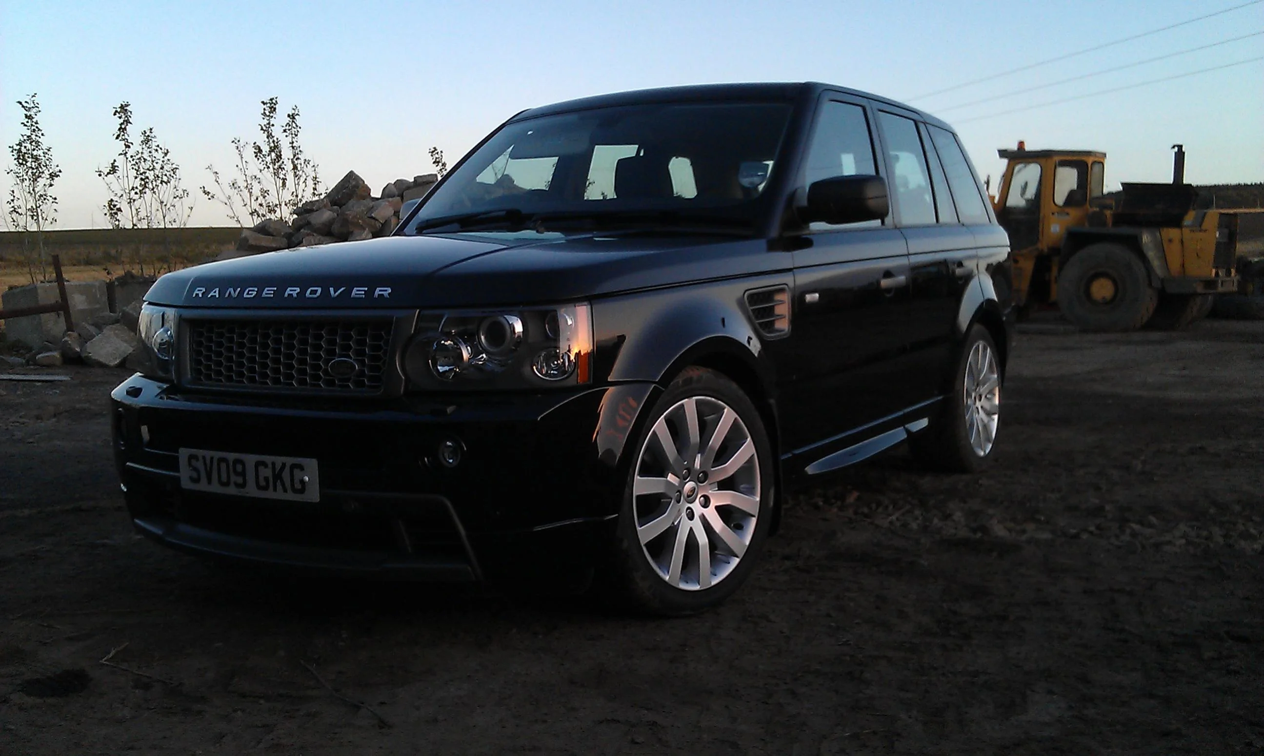

I know it aint no clio but its black at least. Was suposed to be until the white line man didnt put out the wet paint signs........ clayed(3m),Then used a DA polisher to polish(poorboys pro polish), glazed(poorboys black hole) and then sealed/waxed it(poorboys EX sealer with canubra)......(sound like a sales man for Poorboys dont I. Imo they are very good products for the price and work wonders on black cars)Also used poorboys QD to finish her off.
