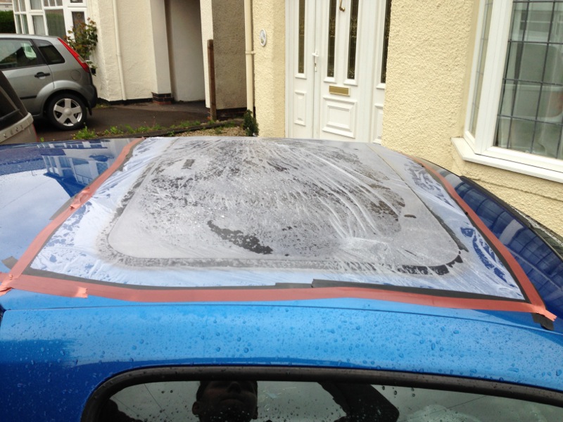

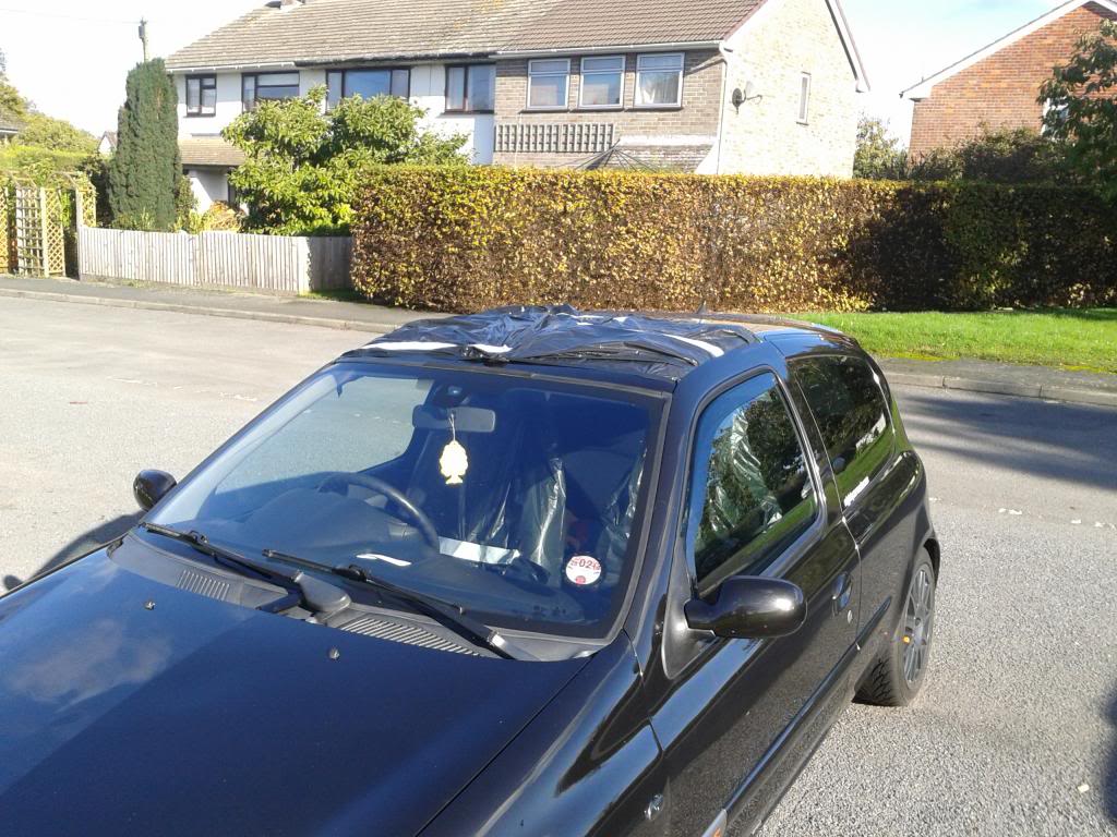

Tape a bin-bag over the sunroof? put something upright on the glass underneath it aswell so the water runs off & away, rather than settling etc
don't fancy tape on my roof either
Is your sunroof leaking?
tuck it in the windows?
yep drivers side drain pipe has started to
Why not sort it?
I'm 45 miles away from the car at uni, yeh I was back at the weekend checked the seals there all good so poured warm water down to see if it was blocked and it created an instant wet patch by the drivers sun visor.
On mine you can see the entrance to the pipes if you just pop the glass out, sun roof may have changed as yours is a facelift Mk2
Mine was both seal and pipe
I pushed a thin iron road down the pipe and pushed loads of s**t out and then re sealed with kitchen sealant. Has held up so far

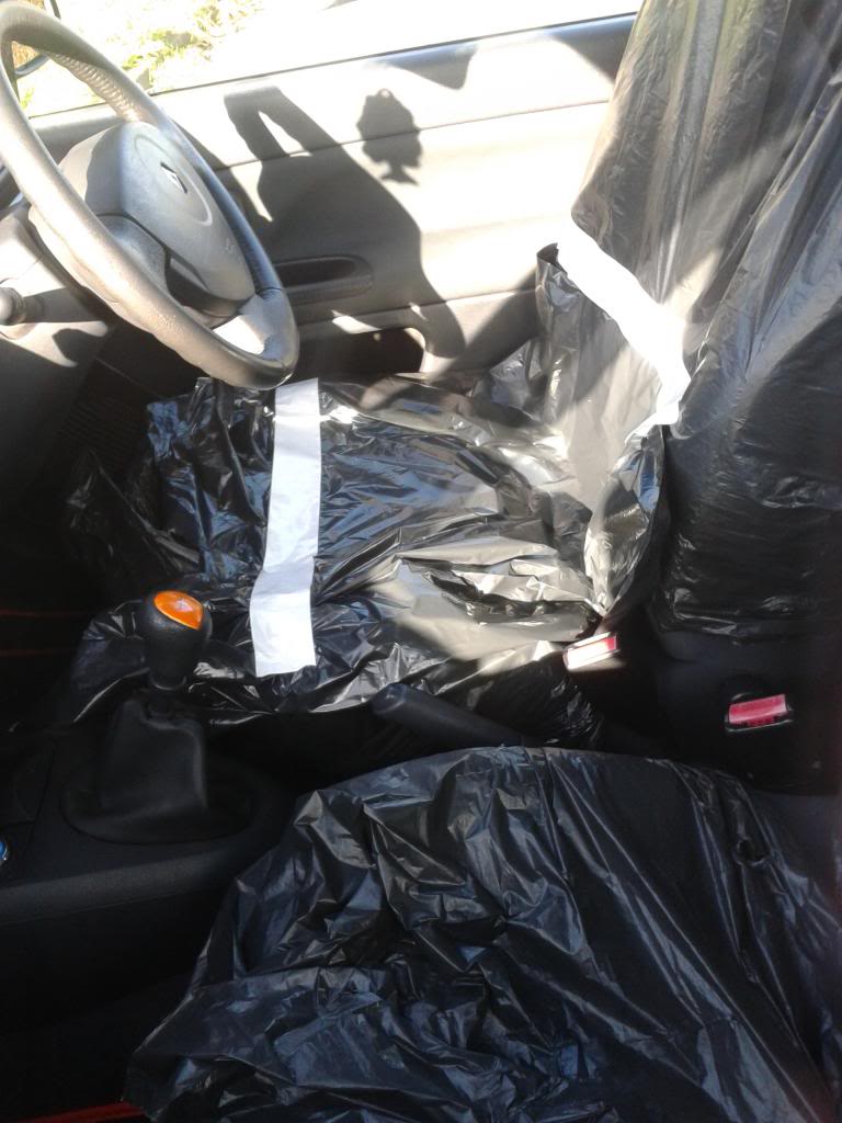

Just an afterthought (as it happened to mine) but you may wanna seal the tops or your door. Rain can run through the creases in the bag and fill up the little dishes ontop of the doorcards.
i speak from experience
