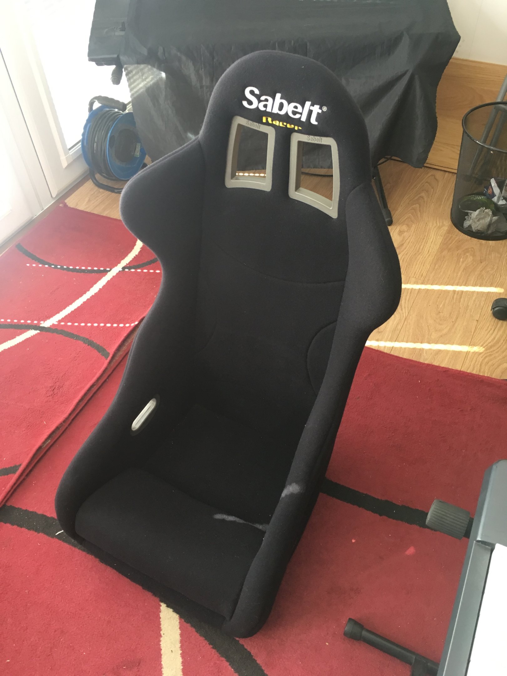

Randomly searched for sabelt seats on ebay the other day and found this for a bargain, really good condition and feels perfect, a lot more comfy than I thought and back is nice and upright. Will be getting the Jon Foz mounts soon for this!

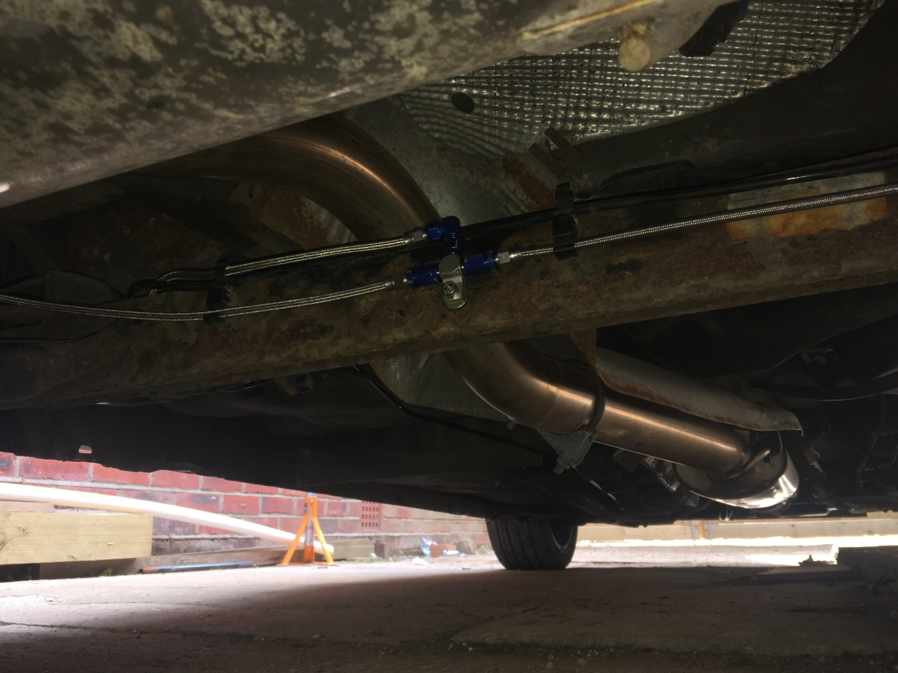

New brake routing, had it routed in the car through the boot but wanted to get the seats back in, decided to go back out the bulkhead and under the car along the same oem route using the orignal flexi line which then goes into a T on the beam.
Is that rust bad??!
Dont have the canon right now so crap lighting
