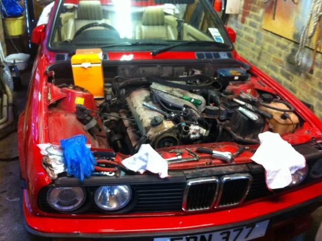

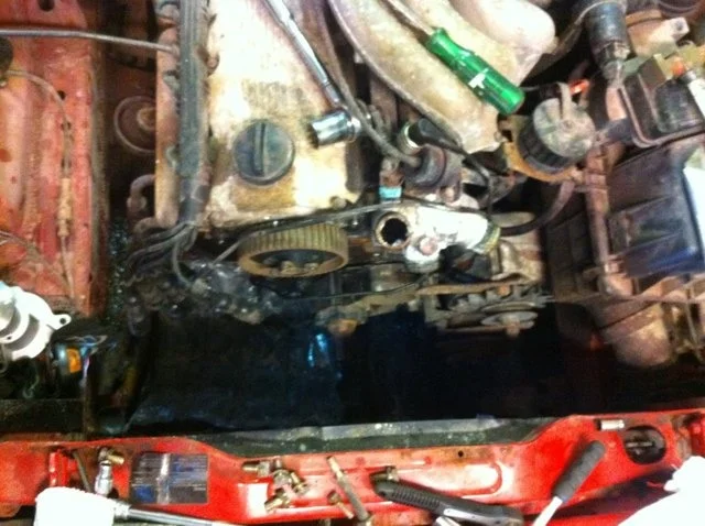

So, a busy weekend. I took Friday off to concentrate on this.
After 30 mins:
Bonnet off, old leaky rad out, coolant hoses and viscous fan out. Ready to do the cambelt.
Plenty more space than on an F4R.
The initial result was disappointing- the car was misfiring- turns out I'd put two of the leads the wrong way round. Schoolboy.
Put them the right way around again and now it was struggling to fire! Checked the spark and it was fine- checked the fuel, all appeared fine. Stripped it back down again to check I'd not cocked up the timing and all was fine.
Rechecked the fuel and it not enough was getting to the rail, so I bodged up a direct line from the pump to the feed and all works fine, so need to see what the problem is there.
All running sweet as a nut now, and it moved under it'a own steam! Managed to drive it out of the garage! :)
