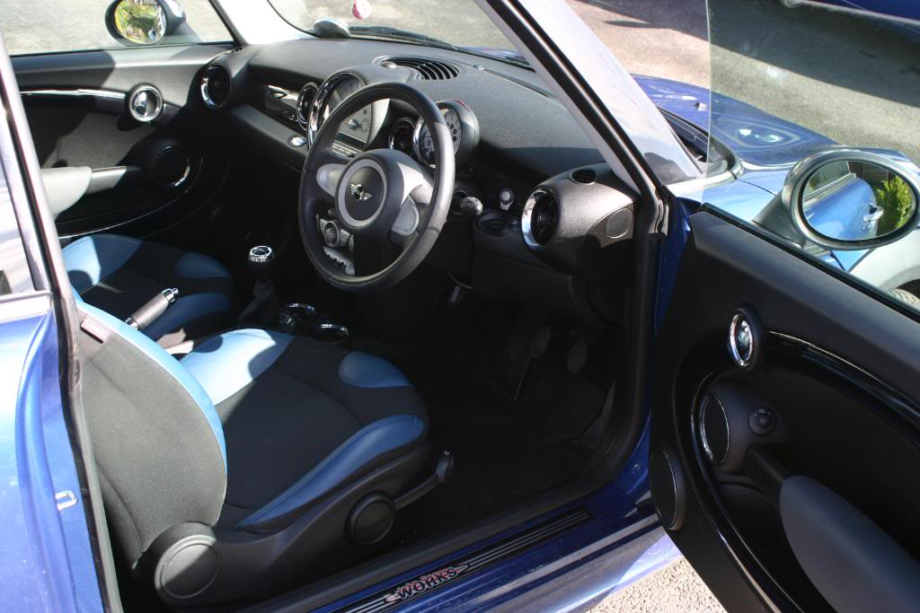

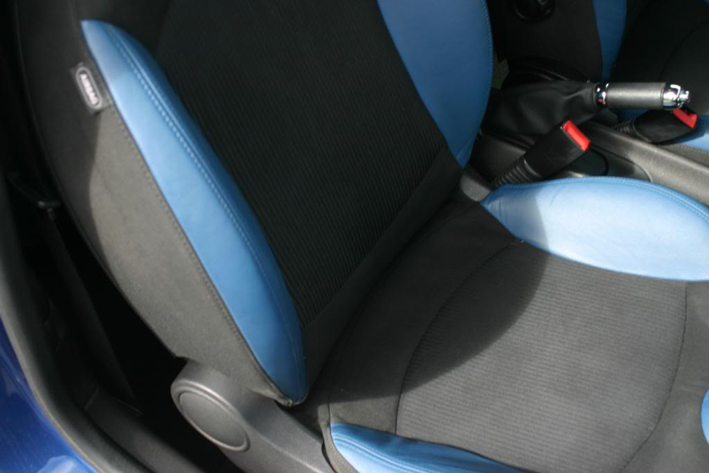

Interior:

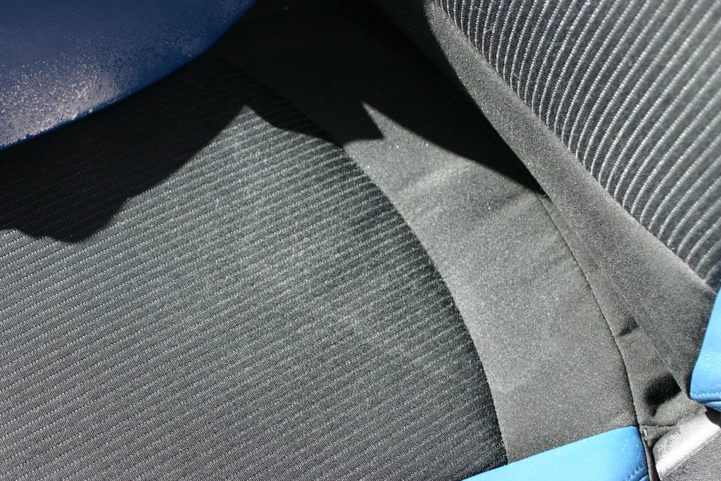

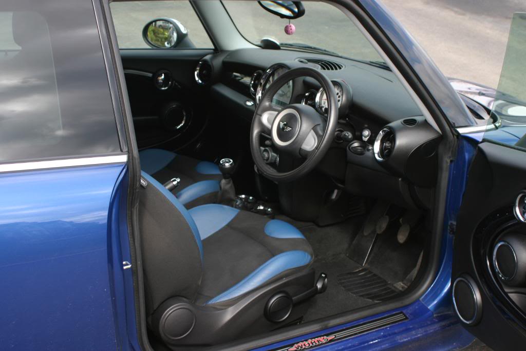

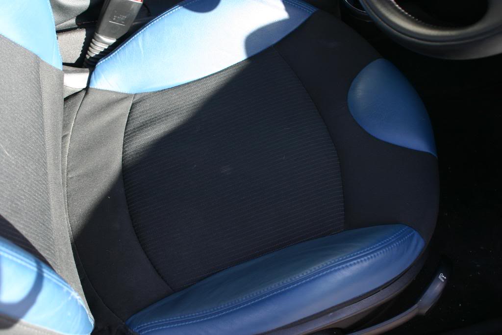

Hoovered to remove loose dirt.

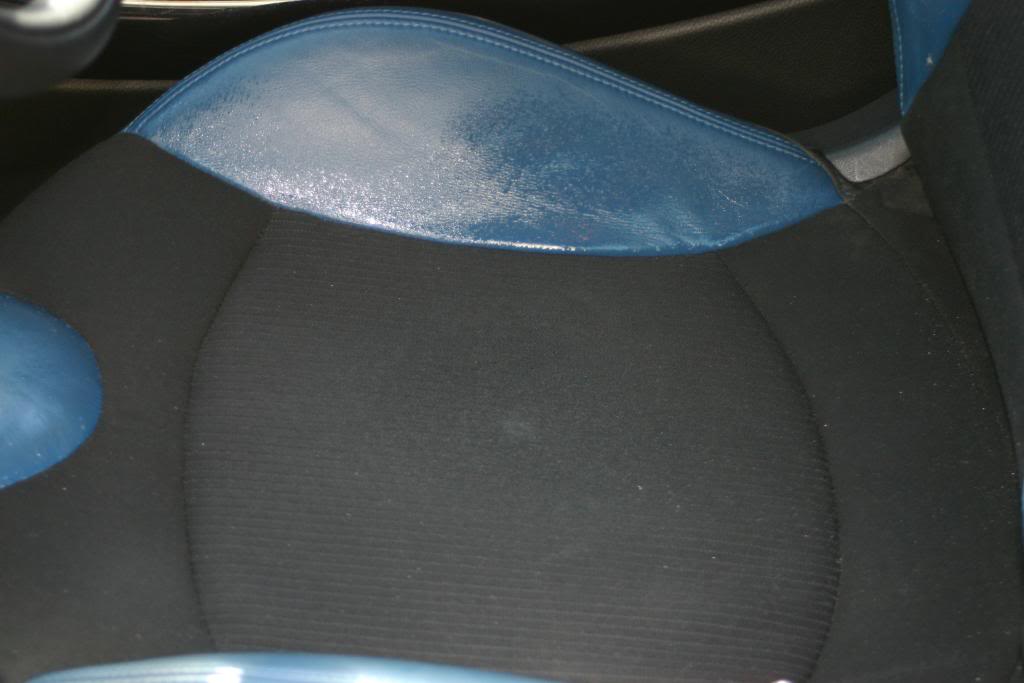

Wet vacuumed using Vax. The seats and carpets were treated with Megs APC which was allowed to dwell for 5 mins then vax'd with clean water. Stains gone.
Leather bits cleaned and conditioned with Gliptone.
Windows cleaned with AG glass polish.

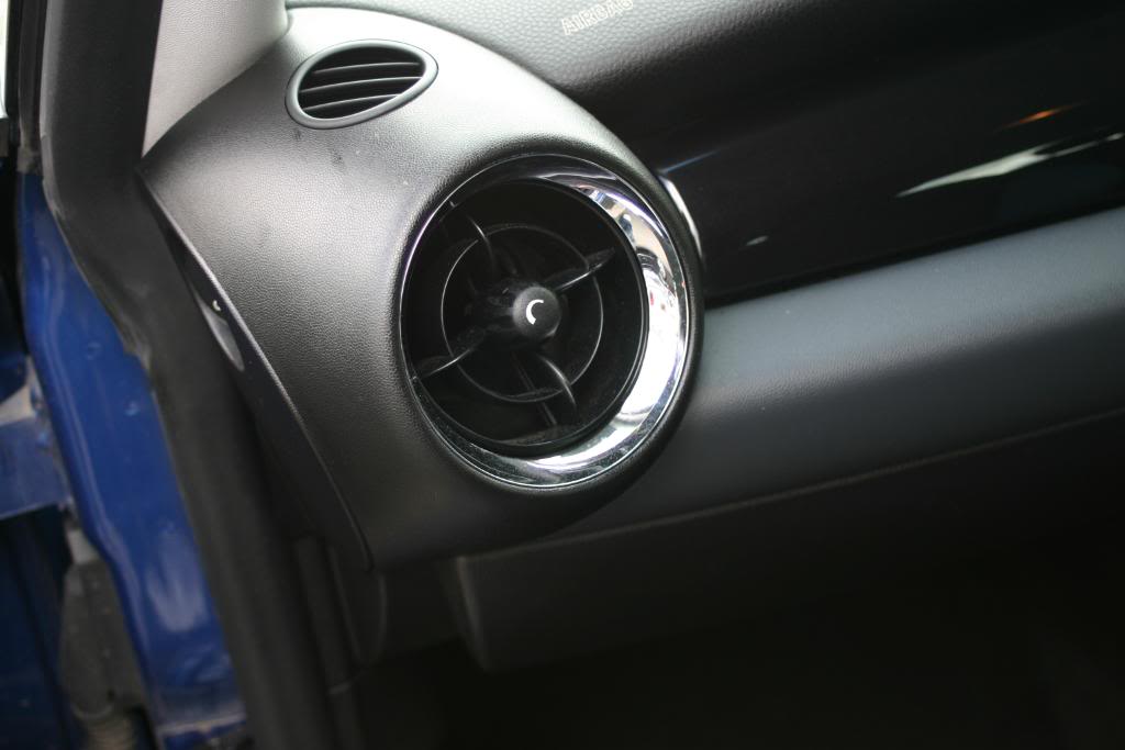

Trim cleaned with APC and dressed with AG Vinyl and Rubber Care.

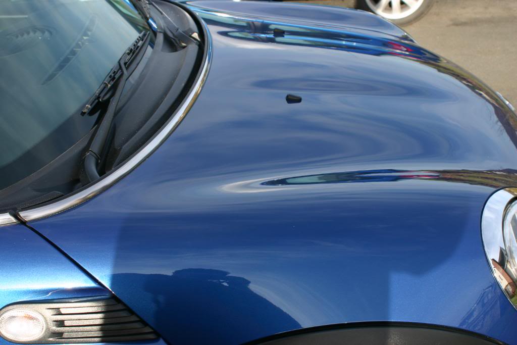

Exterior:

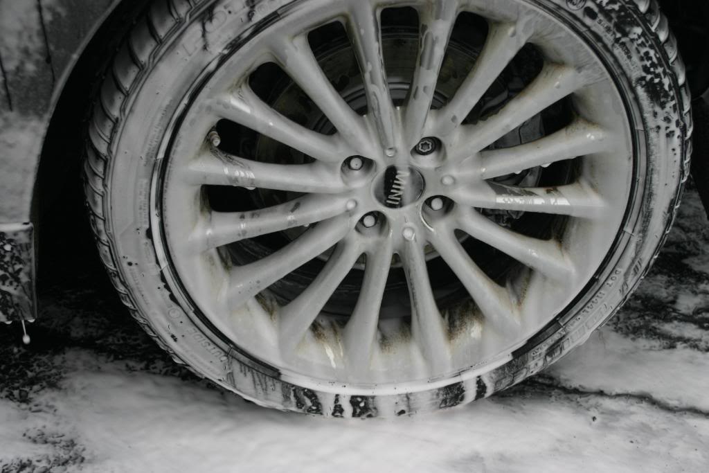

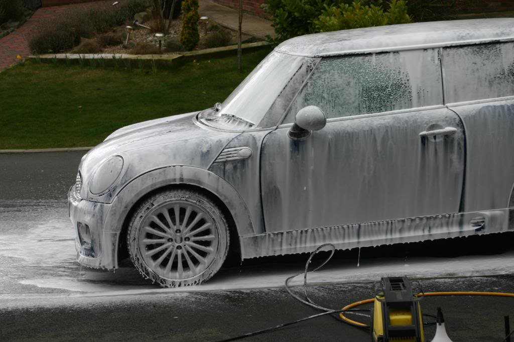

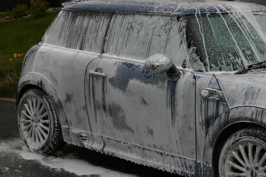

1st stage was a good rinse with the power hose and lots of snow foam.

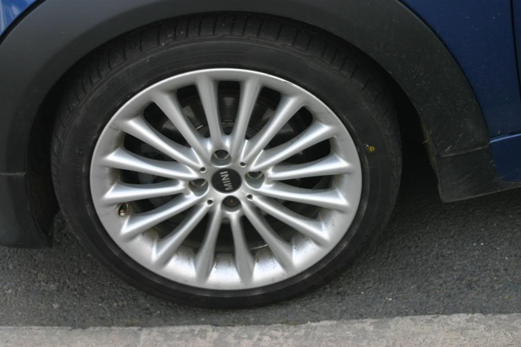

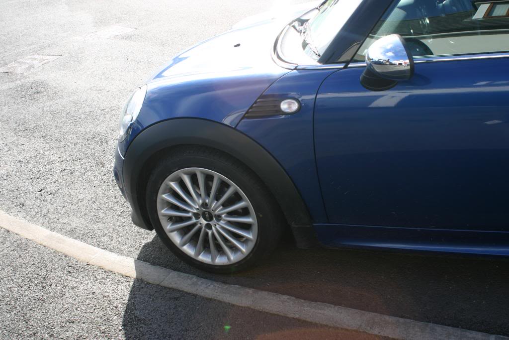

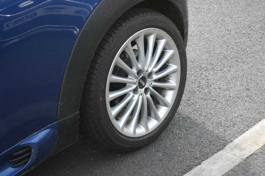

Wheels cleaned with megs apc and sealed with Blitz, then waxed with Collinite.

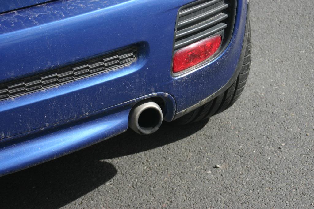

Exhausts cleaned with Brasso Duraglit and sealed with blitz, then waxed with collinite.

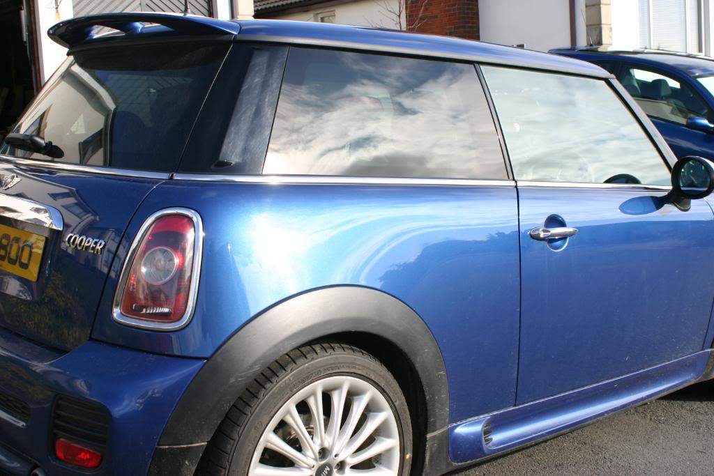

Car was then washed with 2 bucket method and duragloss shampoo.
Dried with Microfibre towel and Megs Last touch.

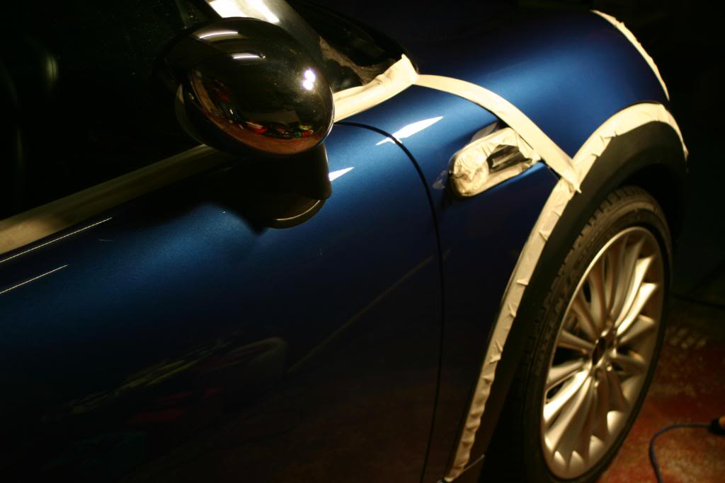

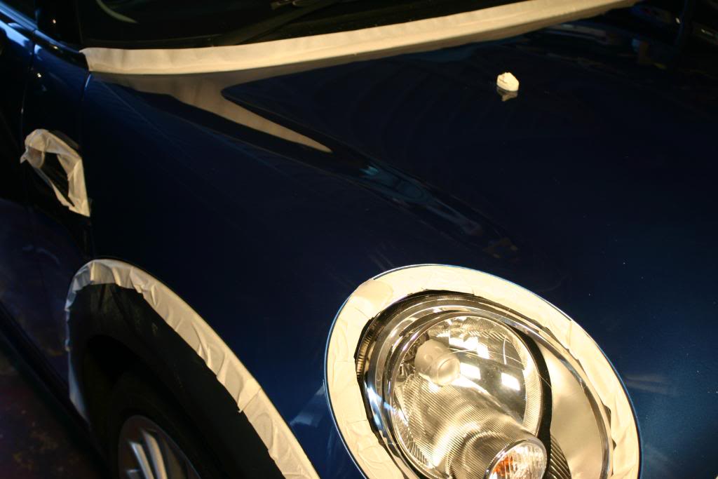

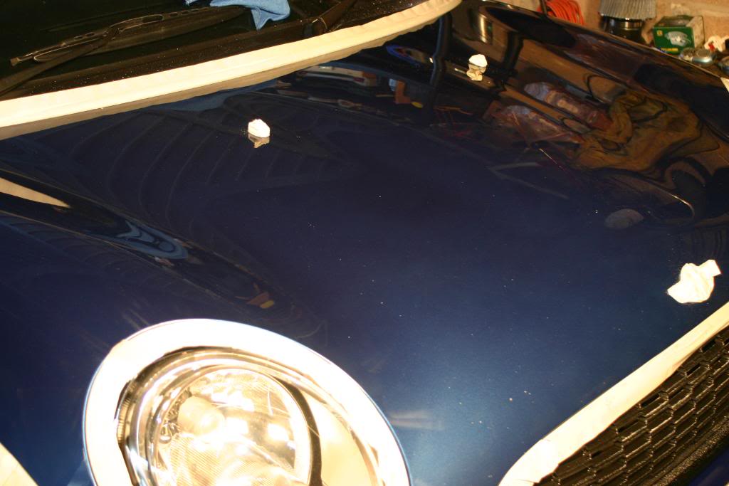

Taped up ready for polish.

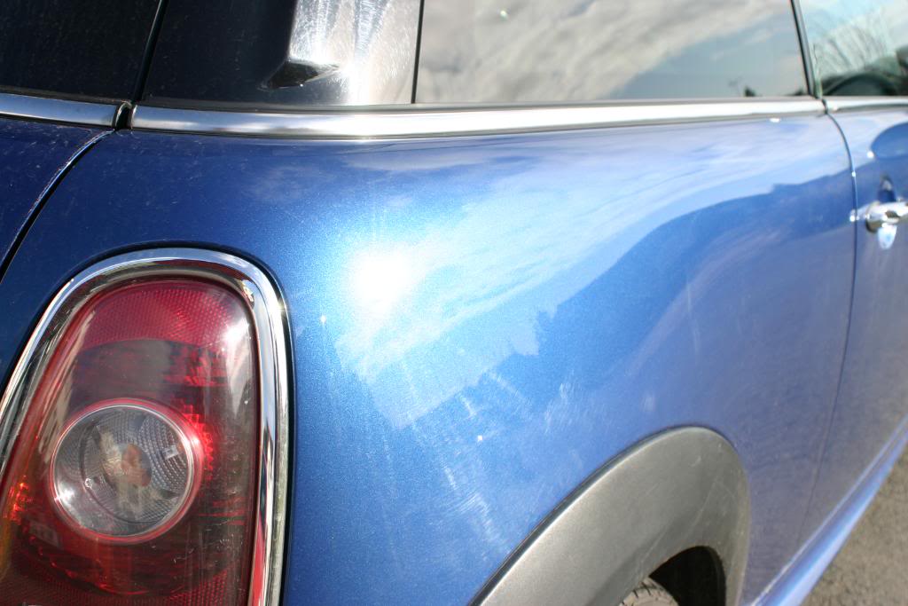

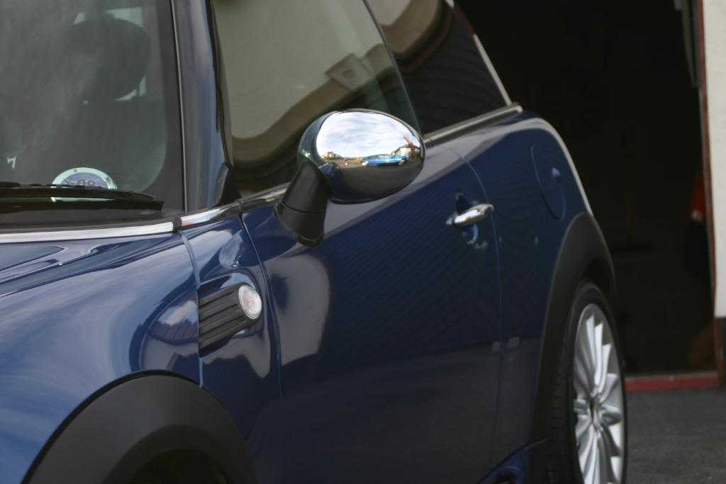

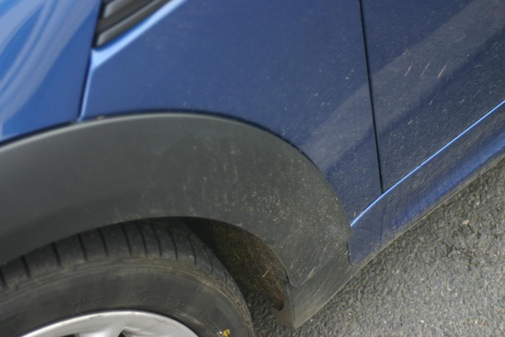

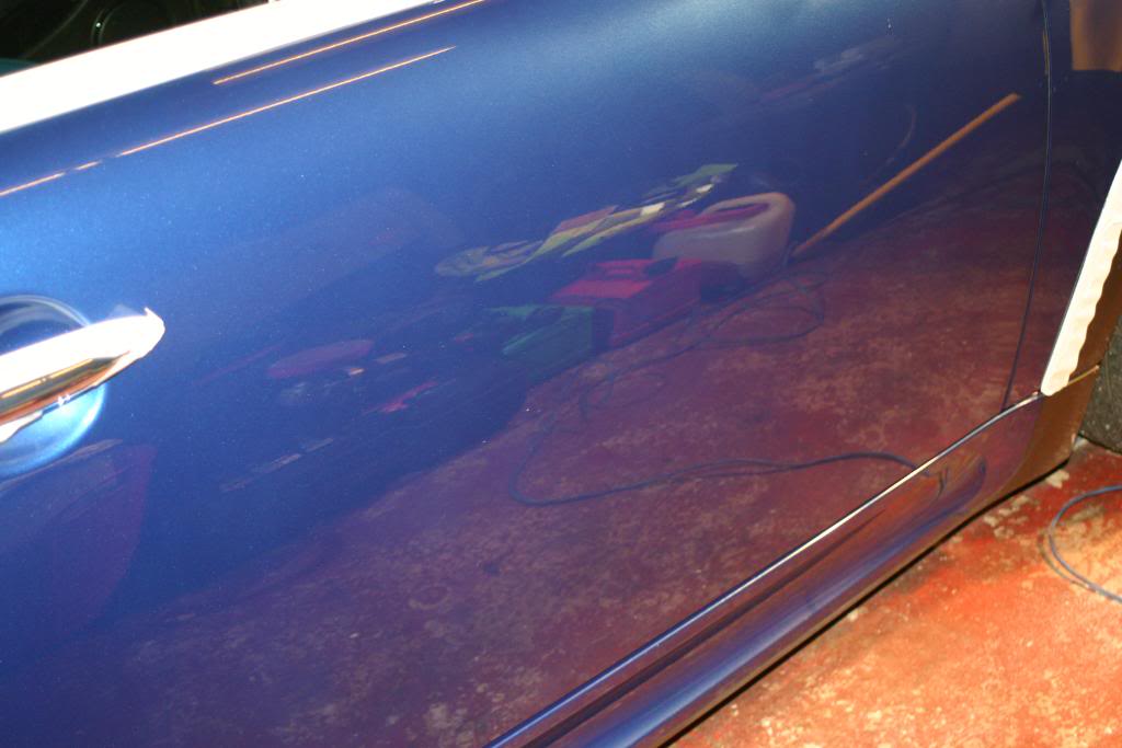

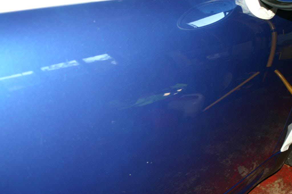

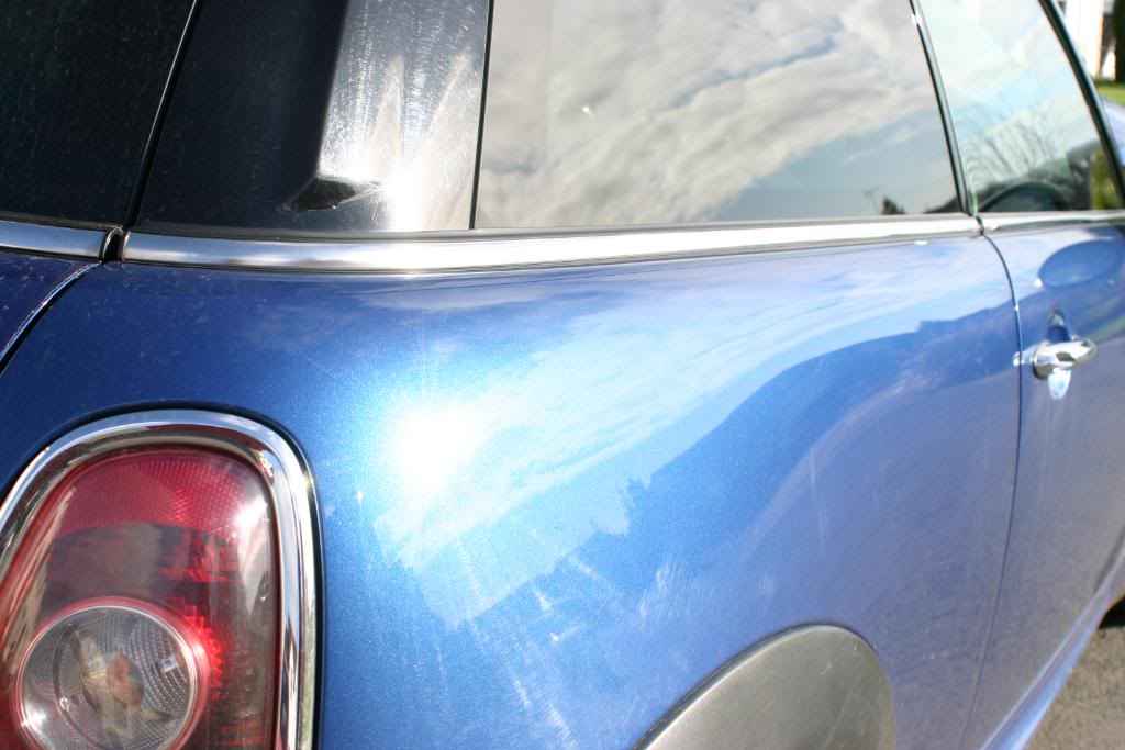

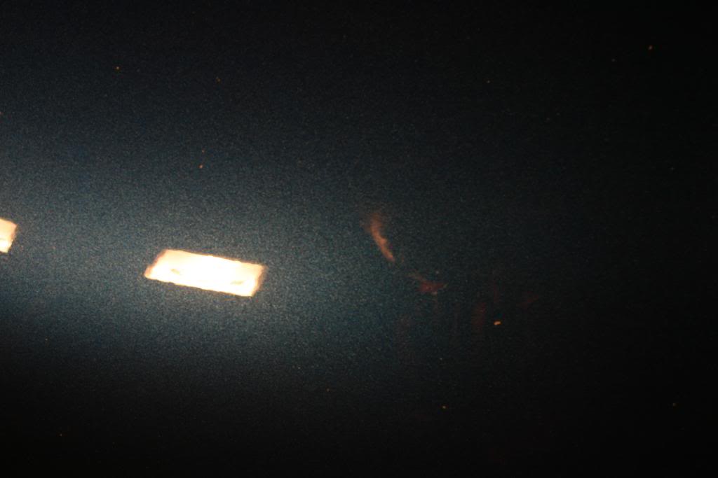

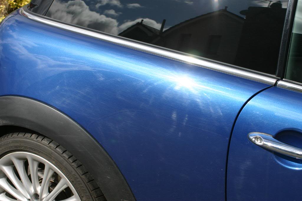

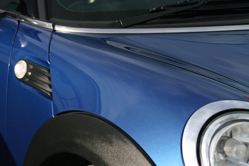

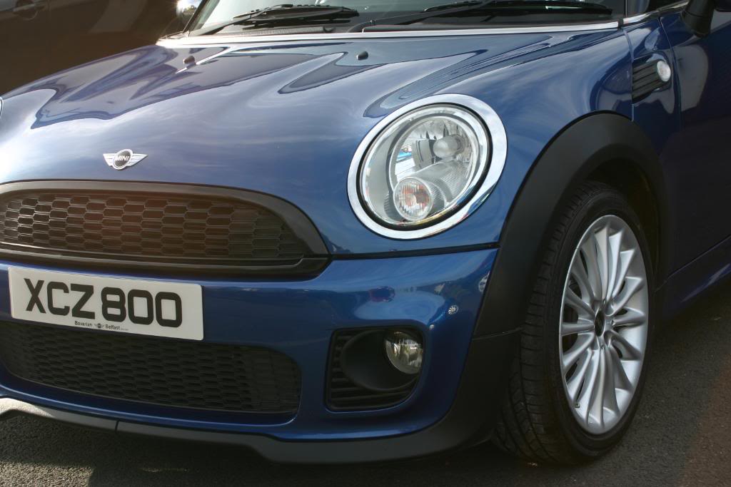

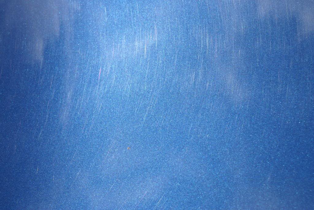

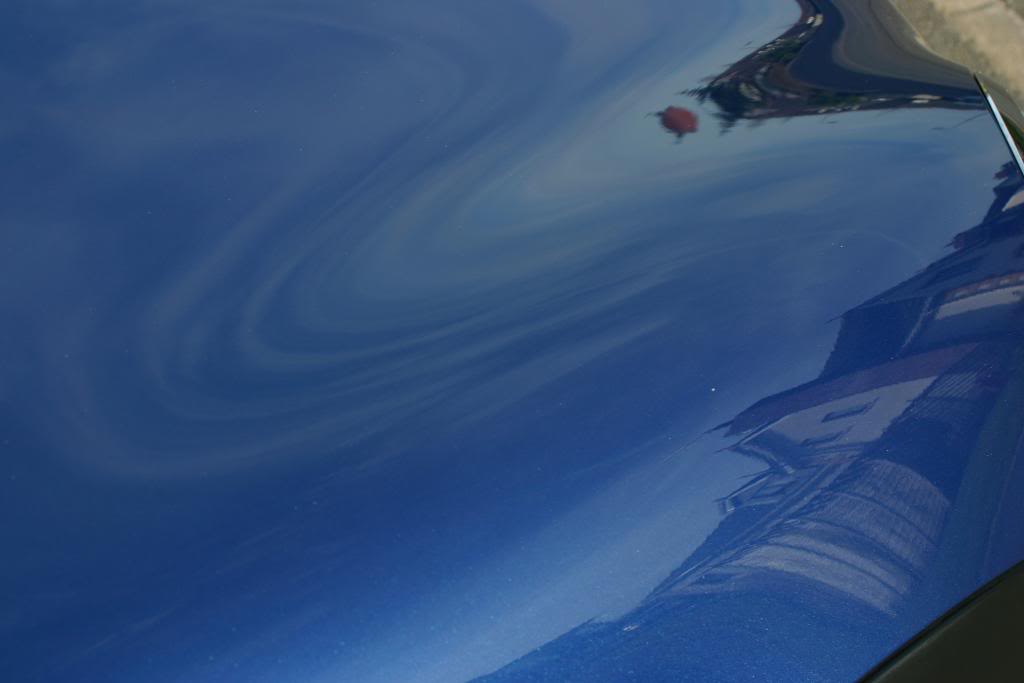

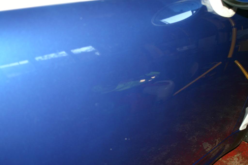

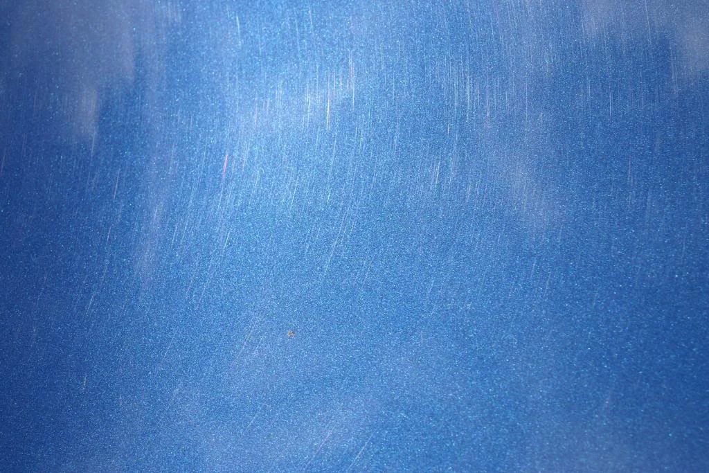

There were quite alot of swirls and randomed scratches, so used my favorite 3m Fast-Cut plus on a 3m Green pad combo.
Refined with Menz Final Finish on a white LCC Pad.

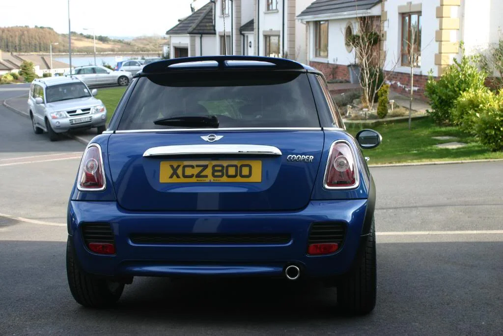

Isopropanol wipe down before applying 2 coats of Blitz and 2 coats of Swissvax Onyx.
Glass cleaned with AG Glass polish and waxed with collinite.
Exterior Plastics cleaned with APC and dressed with Megs trim detailer.
