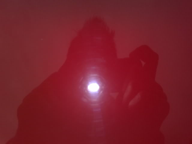

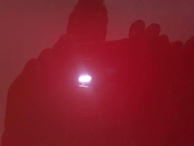

Its possibly the hardest substance known to man. After 2 passes with IP on a cutting pad, 1 pass with Final finish on a polishing pad and 1 pass of SRP and and coat of EGP the wing looks no different lol
Yes its a glossier red that the red of the car but its still covered in light scratches.
Makes reno paint look like butter.
Wing i've done VS wing i haven't.
Polished
Unpolished
Swirls are reduced but the RID's aren't touched and its still a little hazy.
Just had a look under street lamps when its dark. Most of the swirls have otally gone. I'll have to give it another pass though i think.
