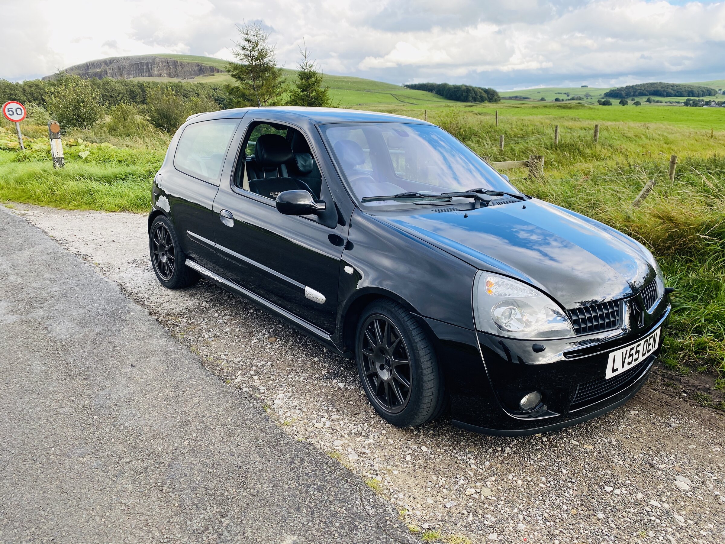

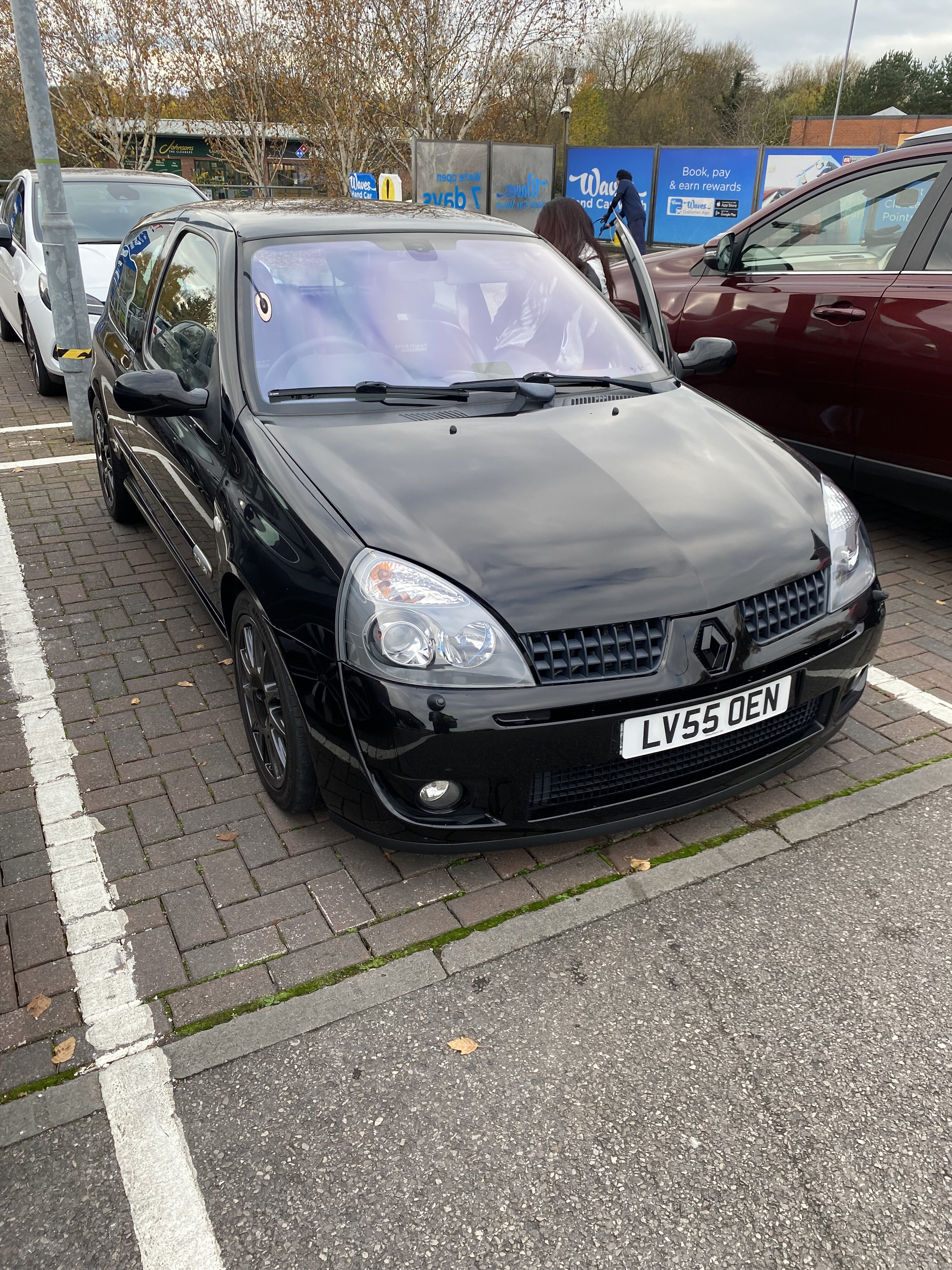

2005 55 plate BG 182 with 107,000 miles. The service history from 2005 - 2016 is Full Renault dealer. So much paperwork with this one!
Cup suspension and cup spoiler. Belts done in 2010 and again with dephaser in 2017 (87k)
Upon inspection it’s been cared for most of it’s life, however suffering neglect the past couple of years.

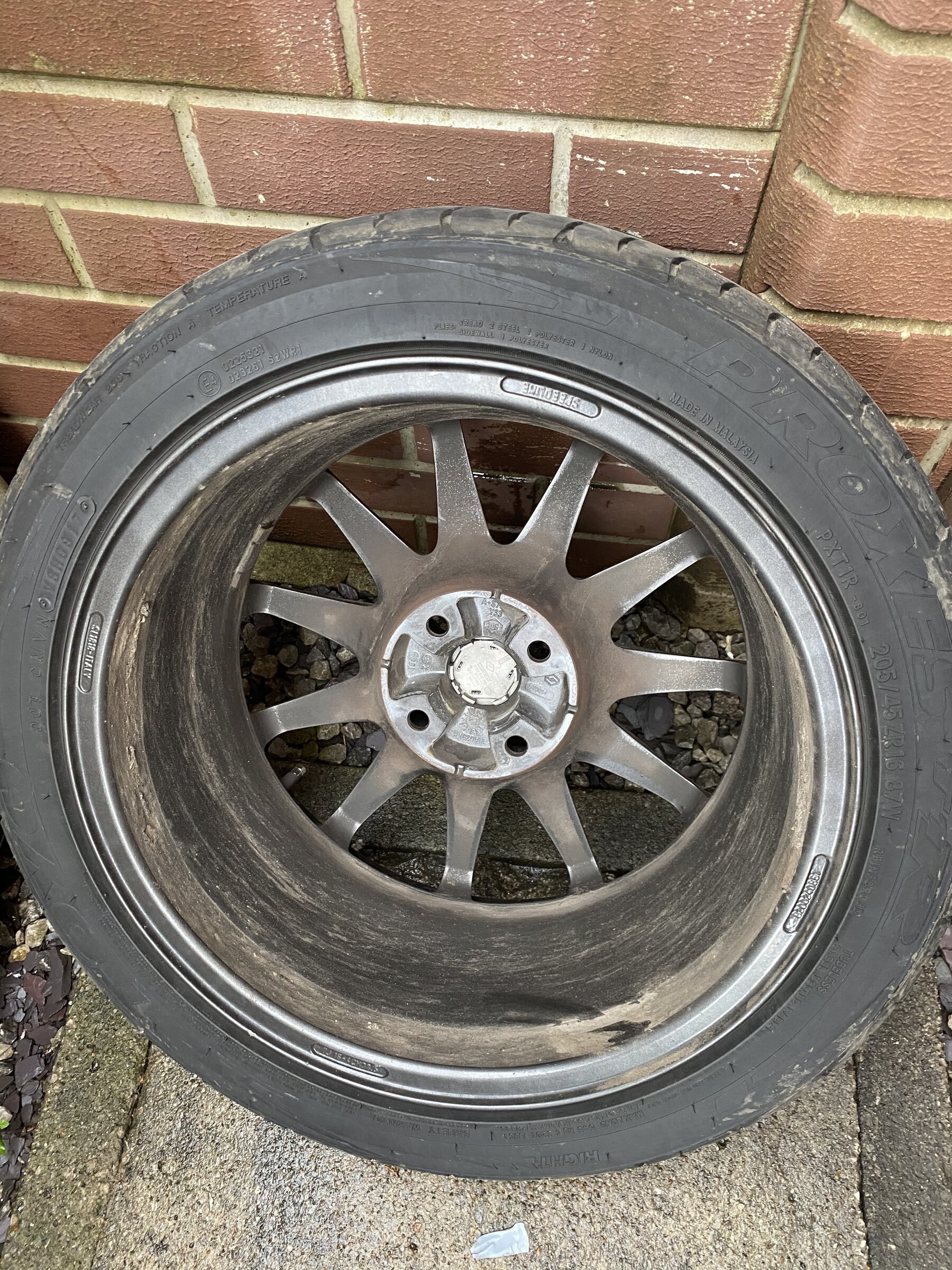

It’s got turini cup wheels, which having cleaned them up must of been refurbed not so long back, however two definitely require another refurb due to curb rash.

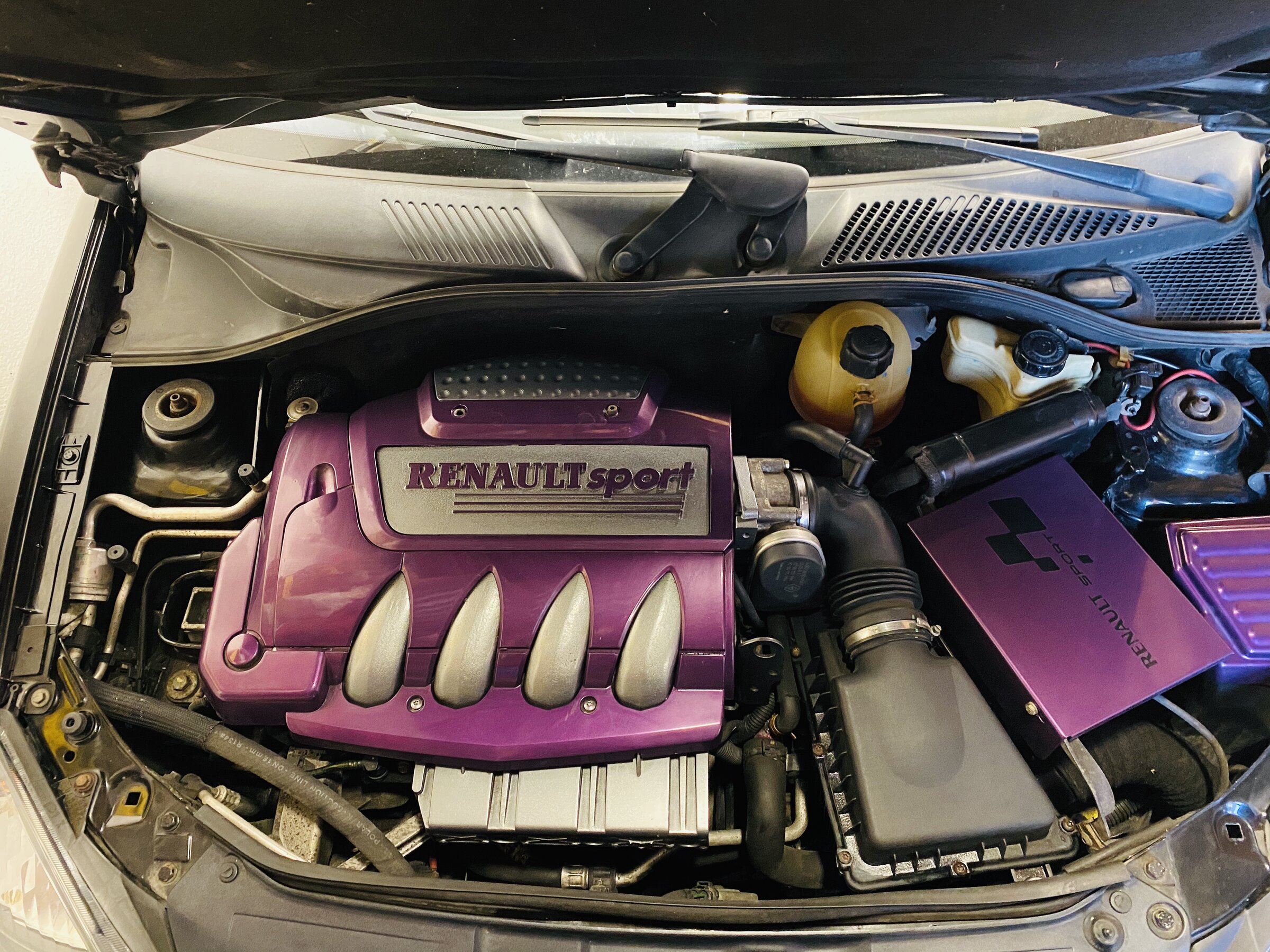

Engine bay looked nice with purple details, the interior was dirty to say the least.

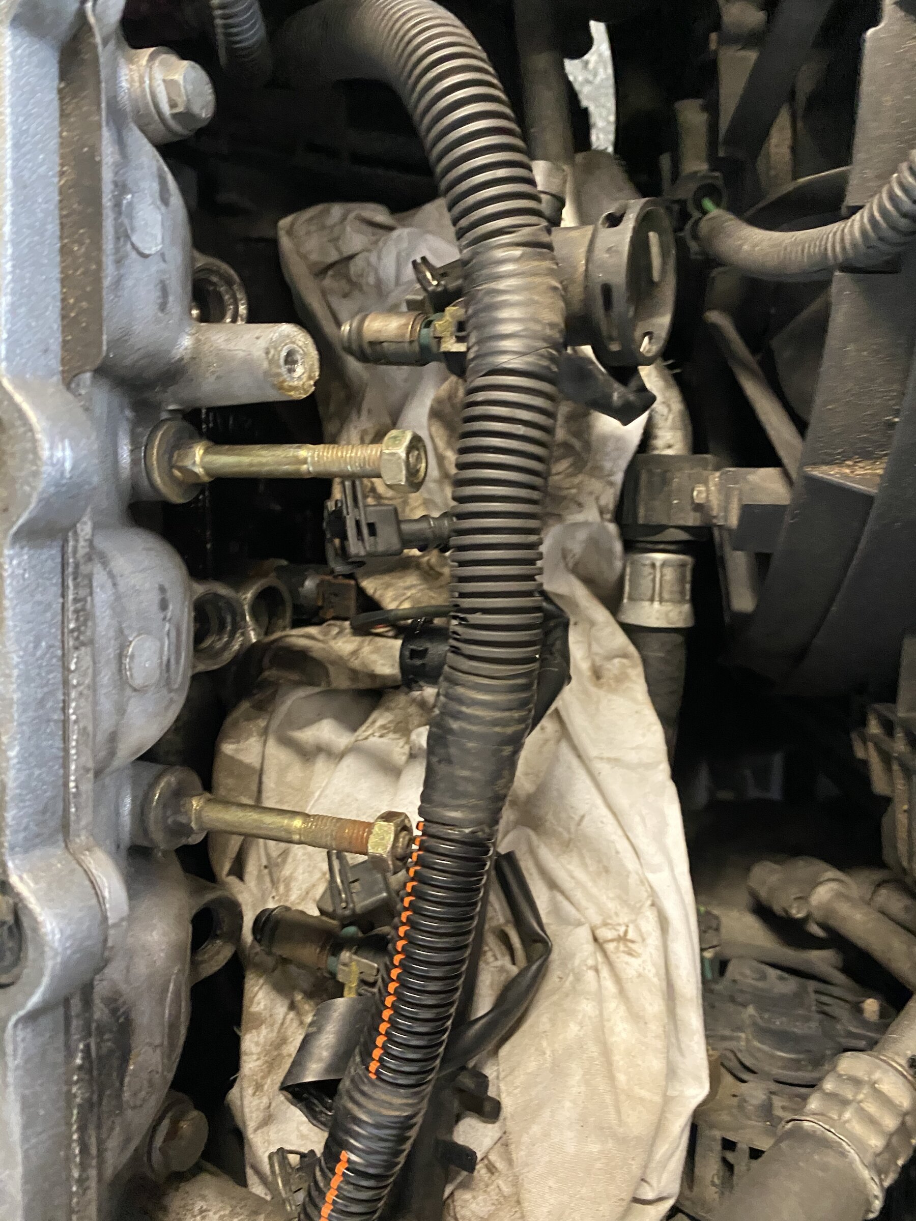

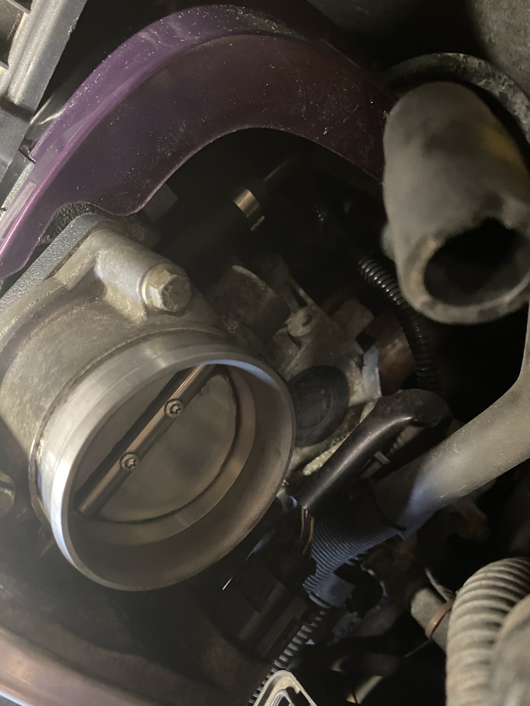

The car has a misfiring cylinder when starting, and was low on oil and coolant.

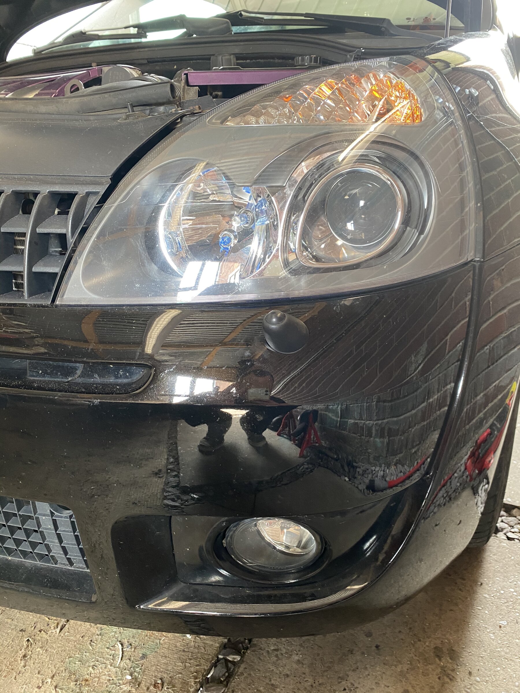

Clean bodywork, it’s had some work on the passenger rear quarter, and the drivers quarter has a small scratch which I will sort. It’s been resprayed at some point and headlights look new. For what I paid I’m not too bothered, and Standard cat still on the car.
Boot mat missing, xenon washer jets missing, no front splitter.
This will be another lengthy project no doubt, but if anyone recognises this car or used to own it, give me a shout🙋🏻

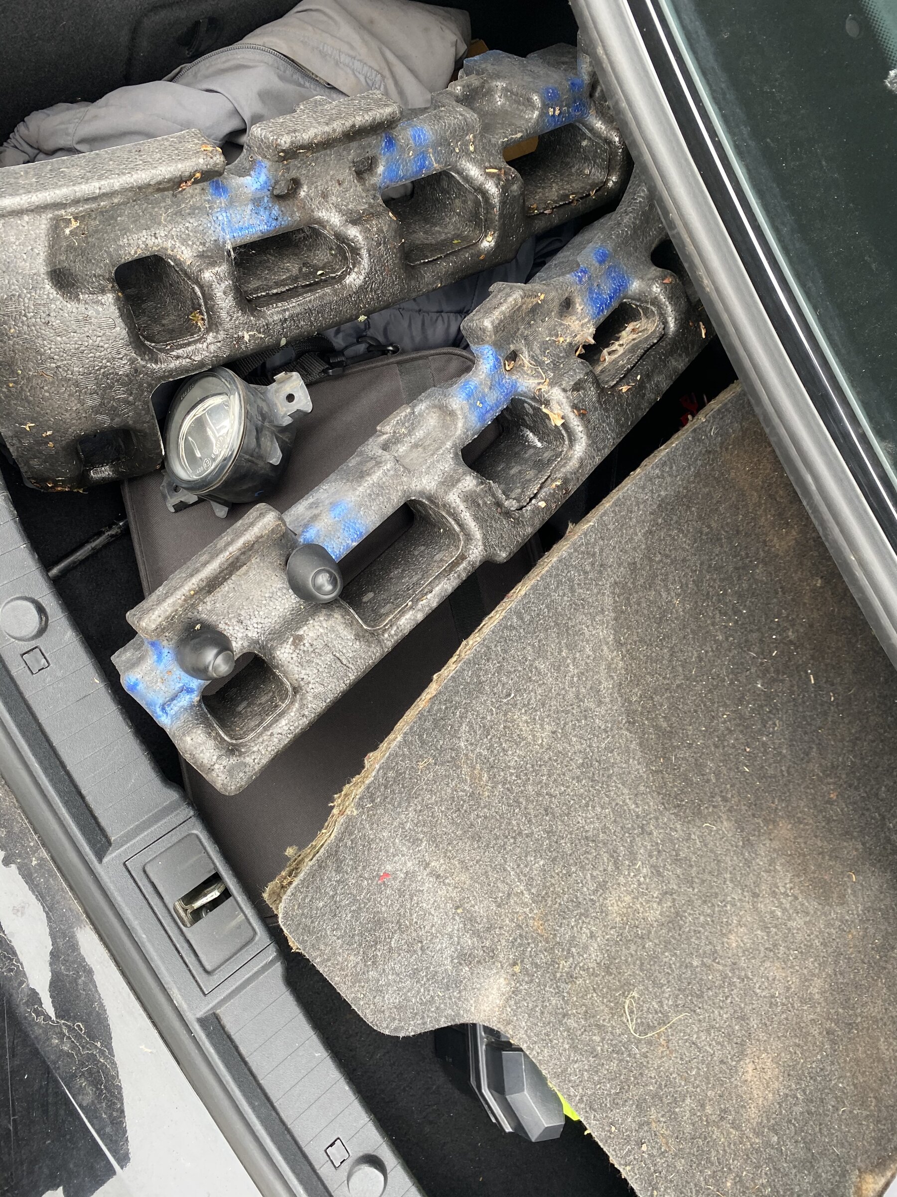

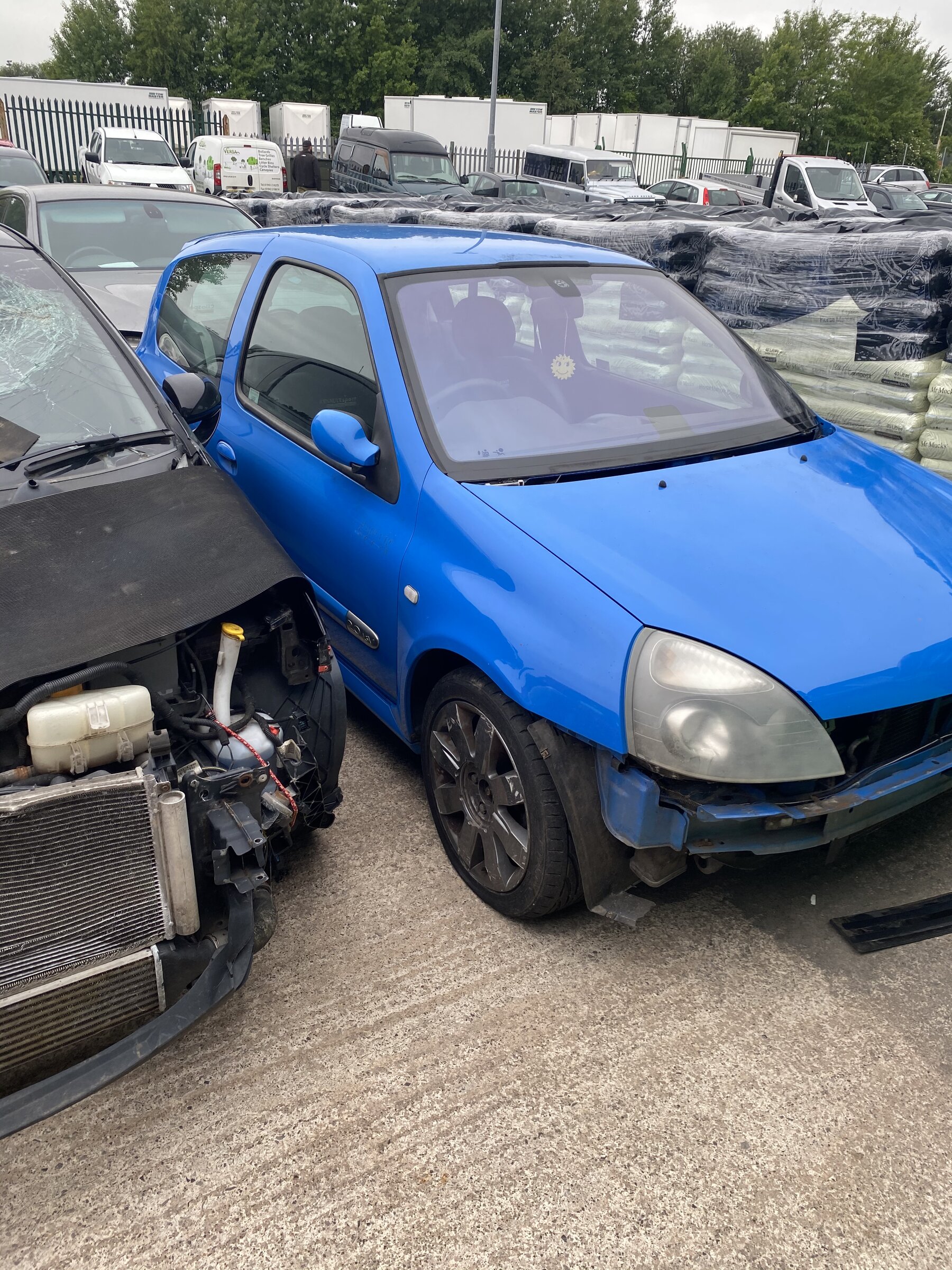

A trip to BTT Motorsport RS Breakers in Wigan (picked up:
2 standard washer jets
Rear bumper crash protection

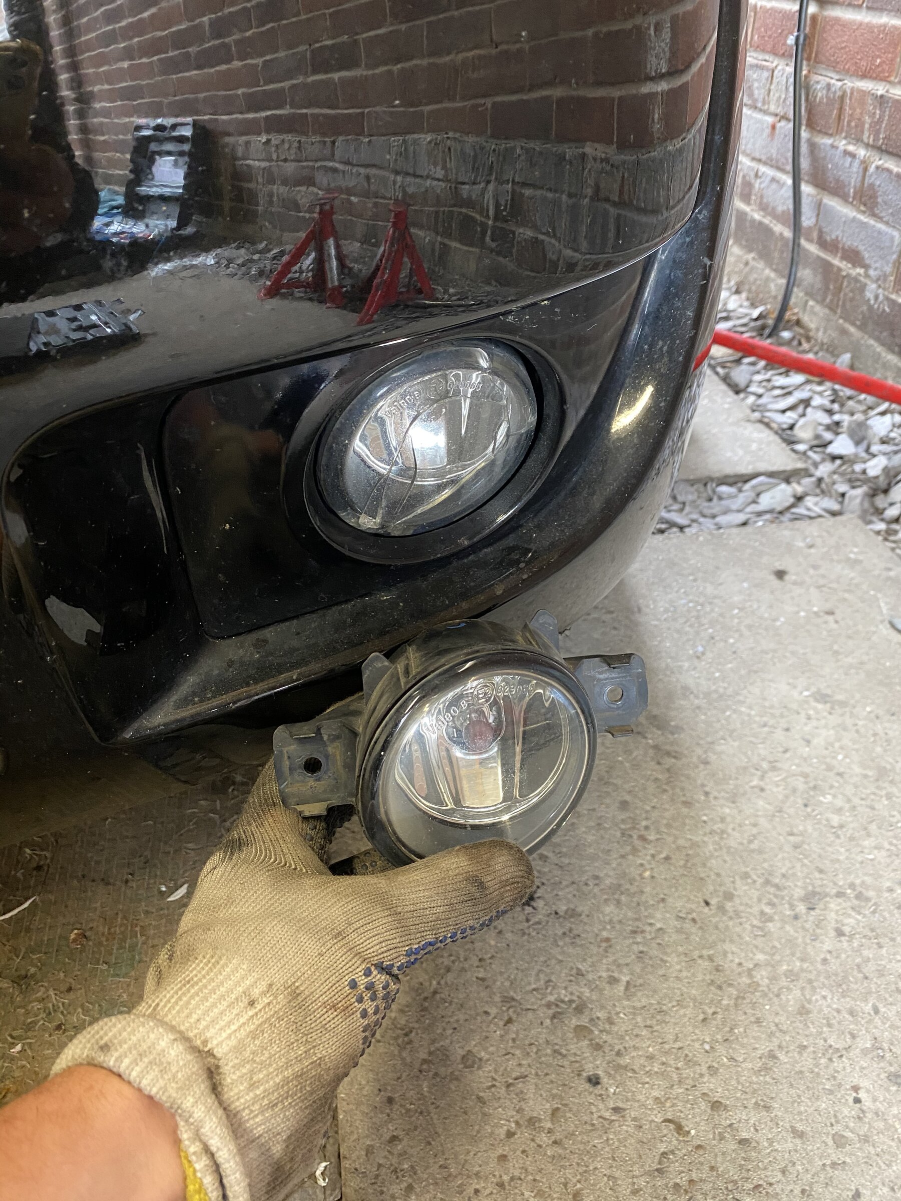

Passenger fog light
182 boot mat with the extra sound proofing

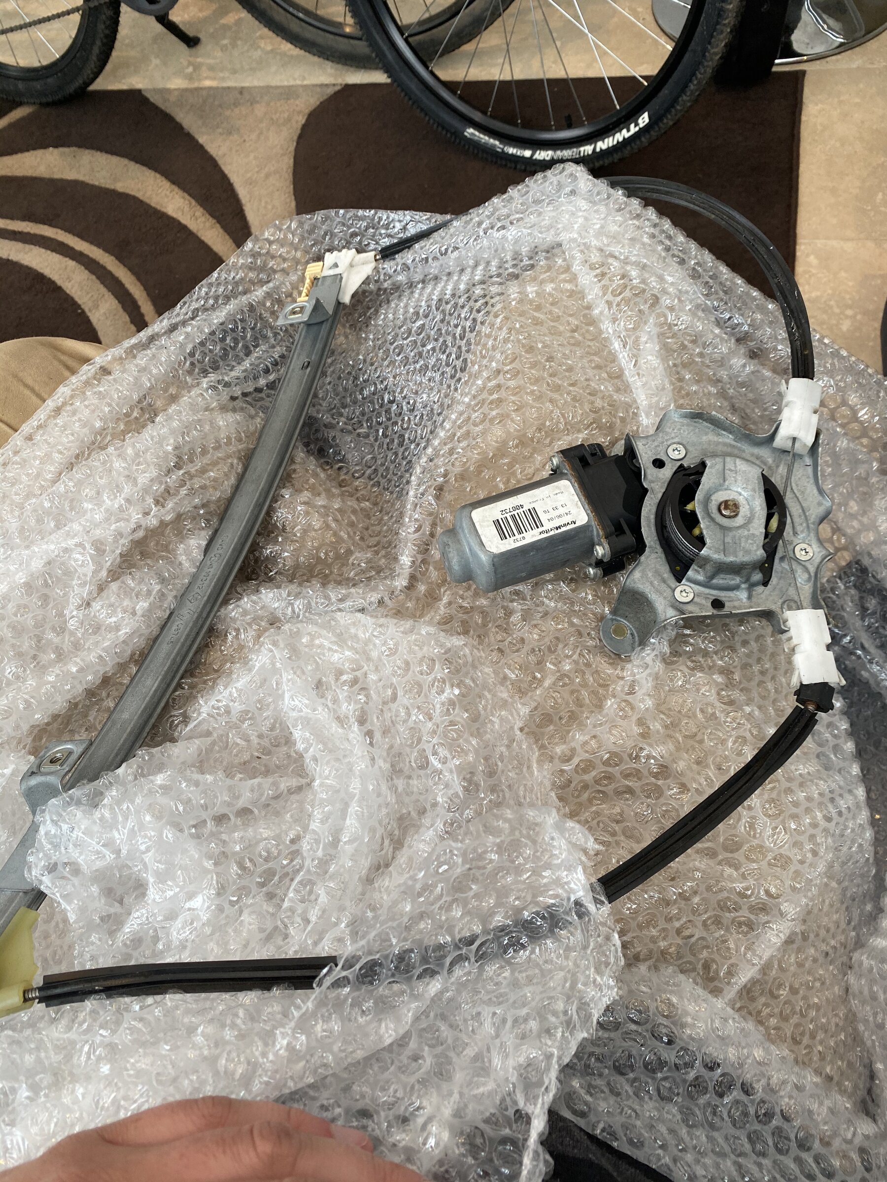

Drivers Window regulator (posted)

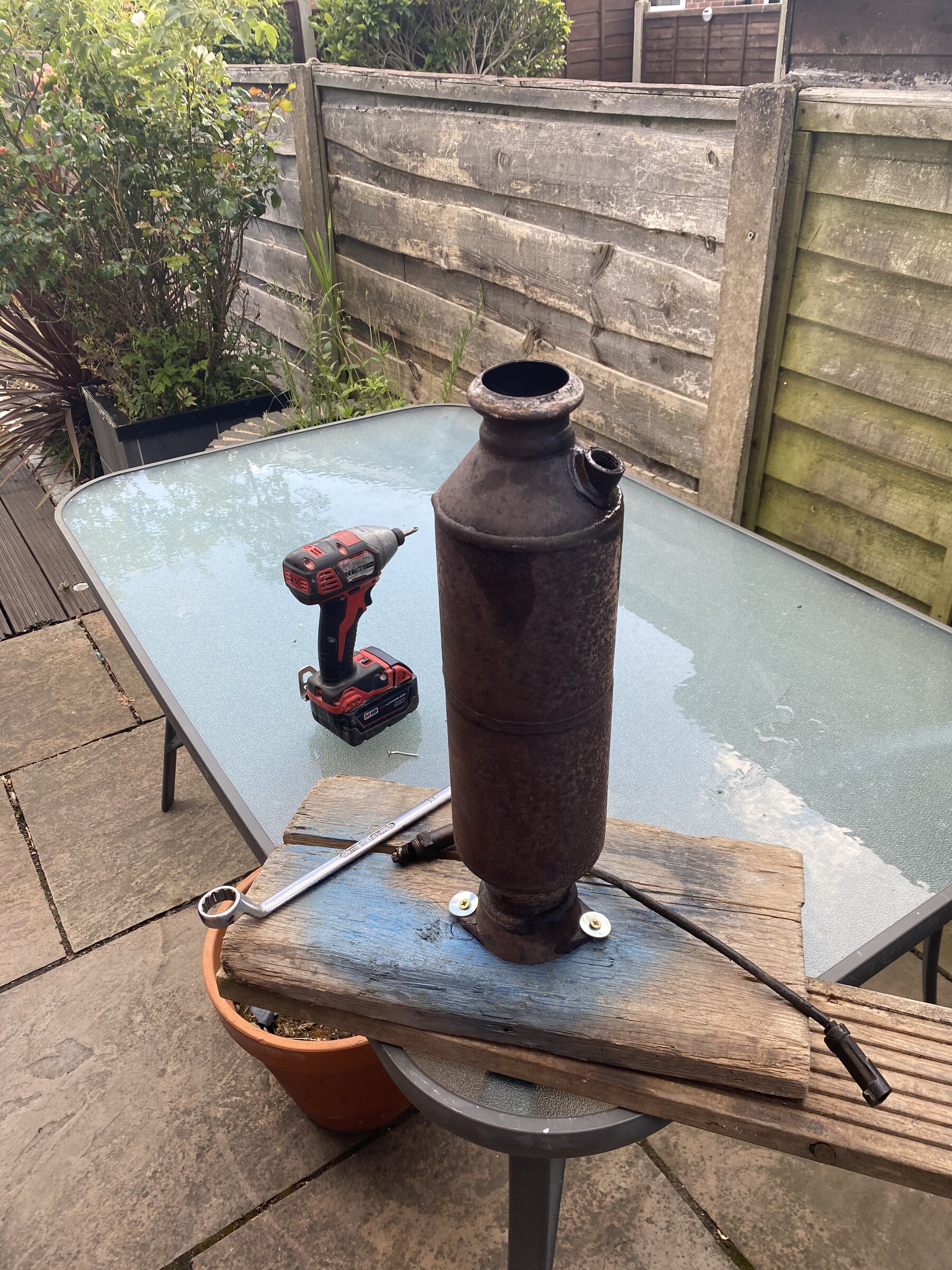

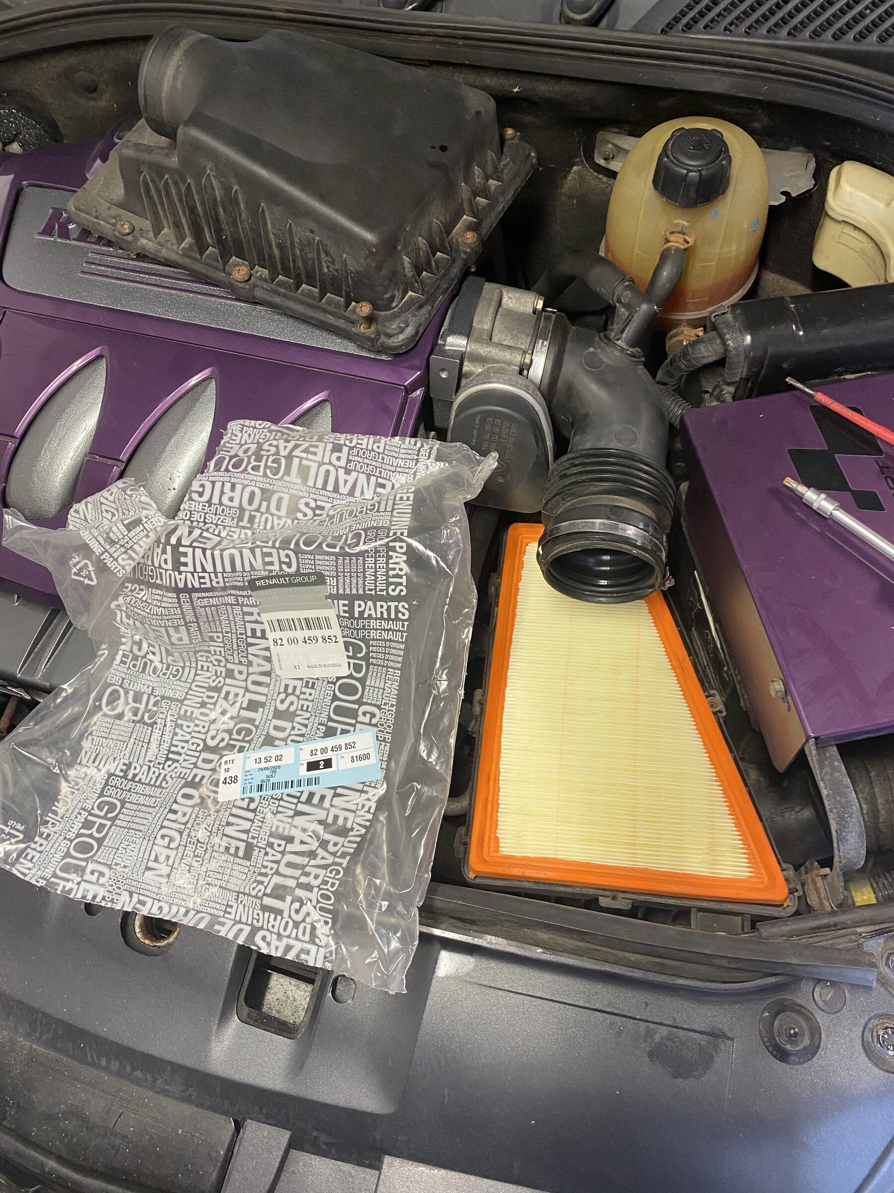

Sent the Cat off to Tommy which had a loose honeycomb rattling inside, and ordered:
•Cat2U 182 Cat
•Skoda Fabia Splitter

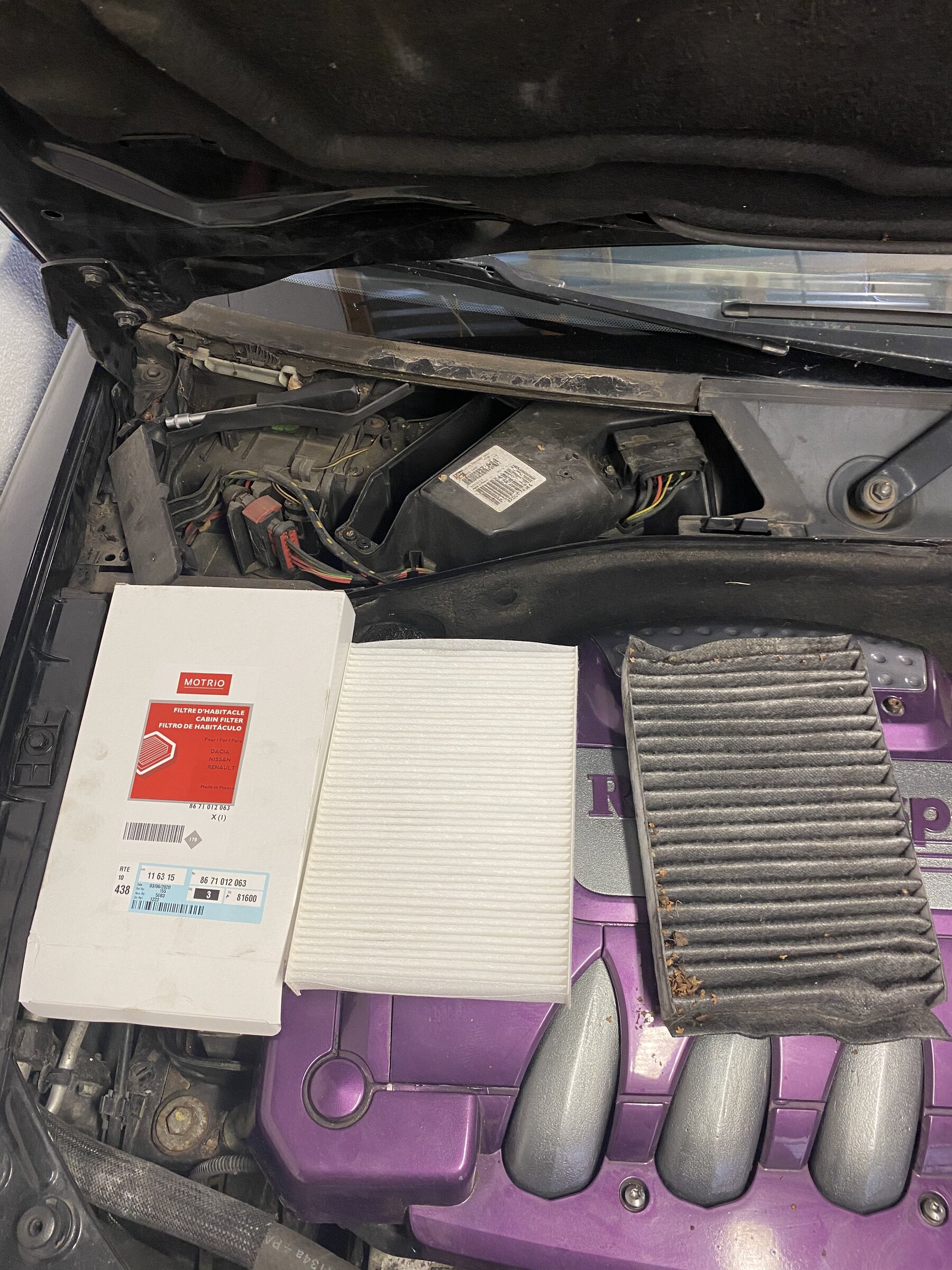

•RenaultpartsDirect: Oil&filter, air filter, Pollen/f

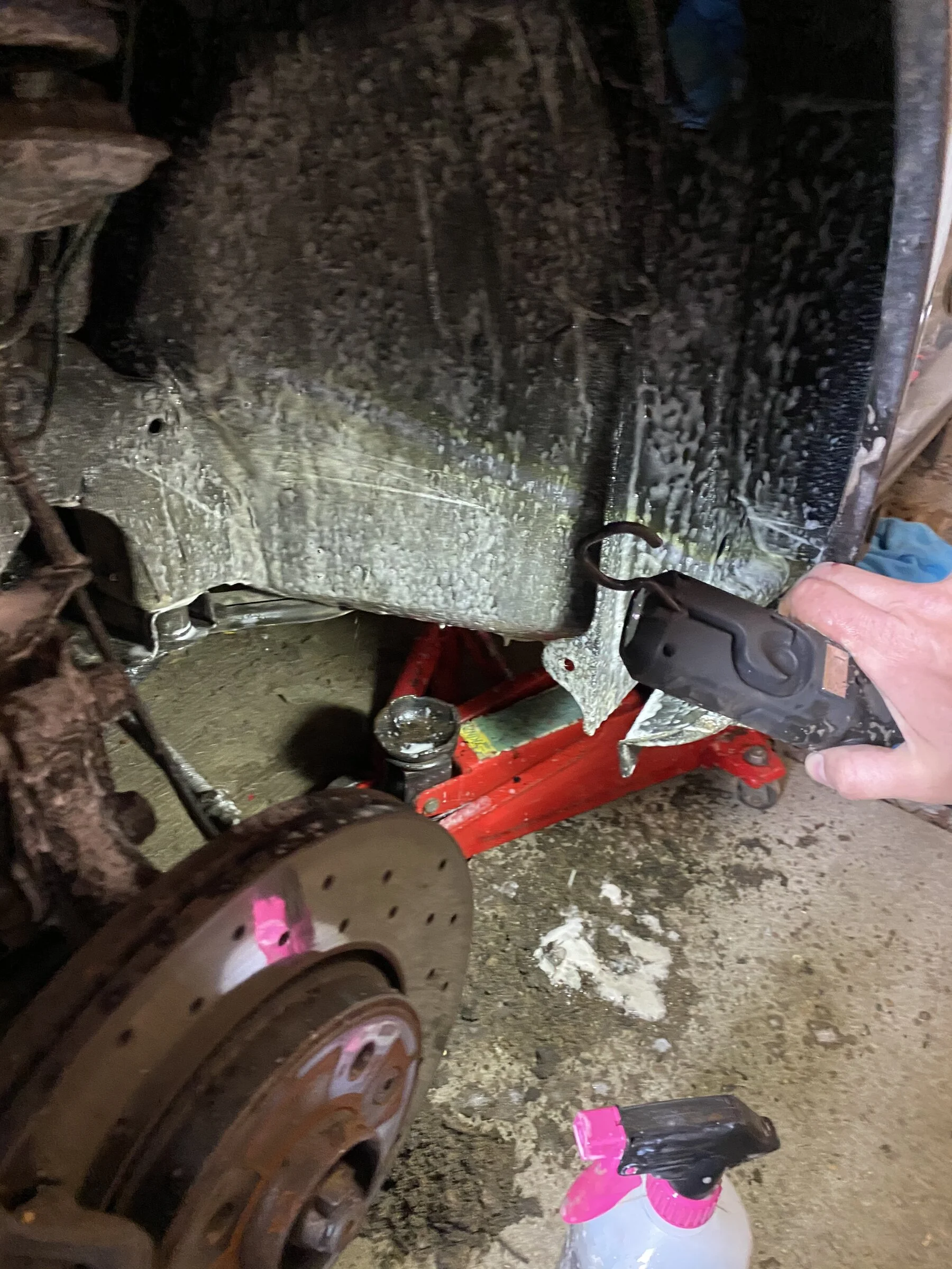

Stripping and cleaning🧼 🧼
Waiting for window regulator to arrive. Rear badges were positioned wrong so ripped them off. Need to get the glue off, any ideas?

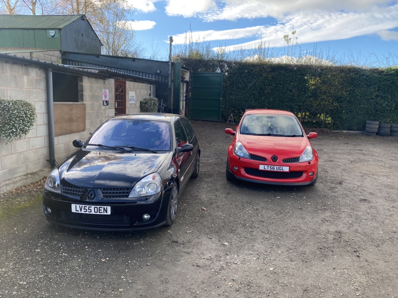

Booked to go back on the Sunday ferry. But this came up which I’ll store in the garage :)
Trying to break its back before I leave

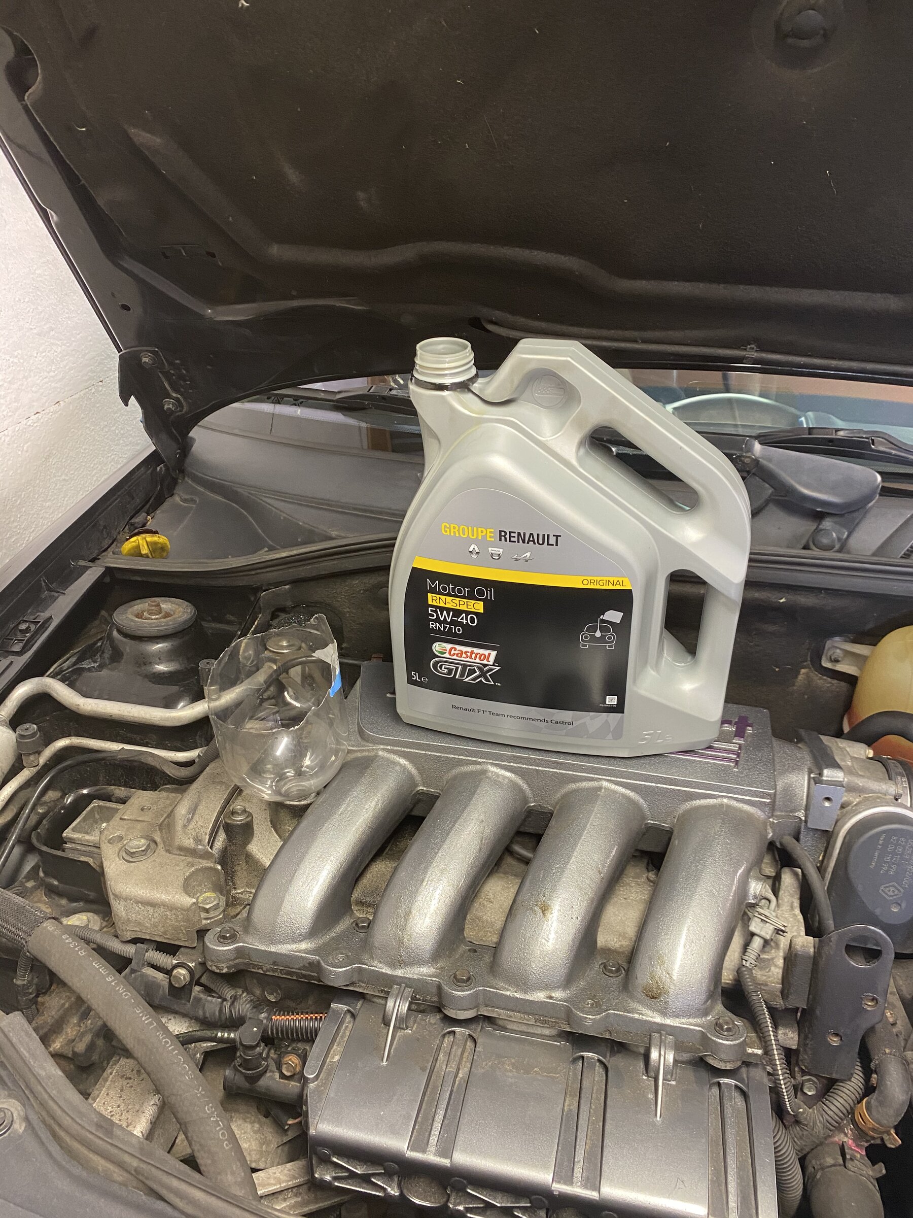

Dropped the oil and carried out a service.

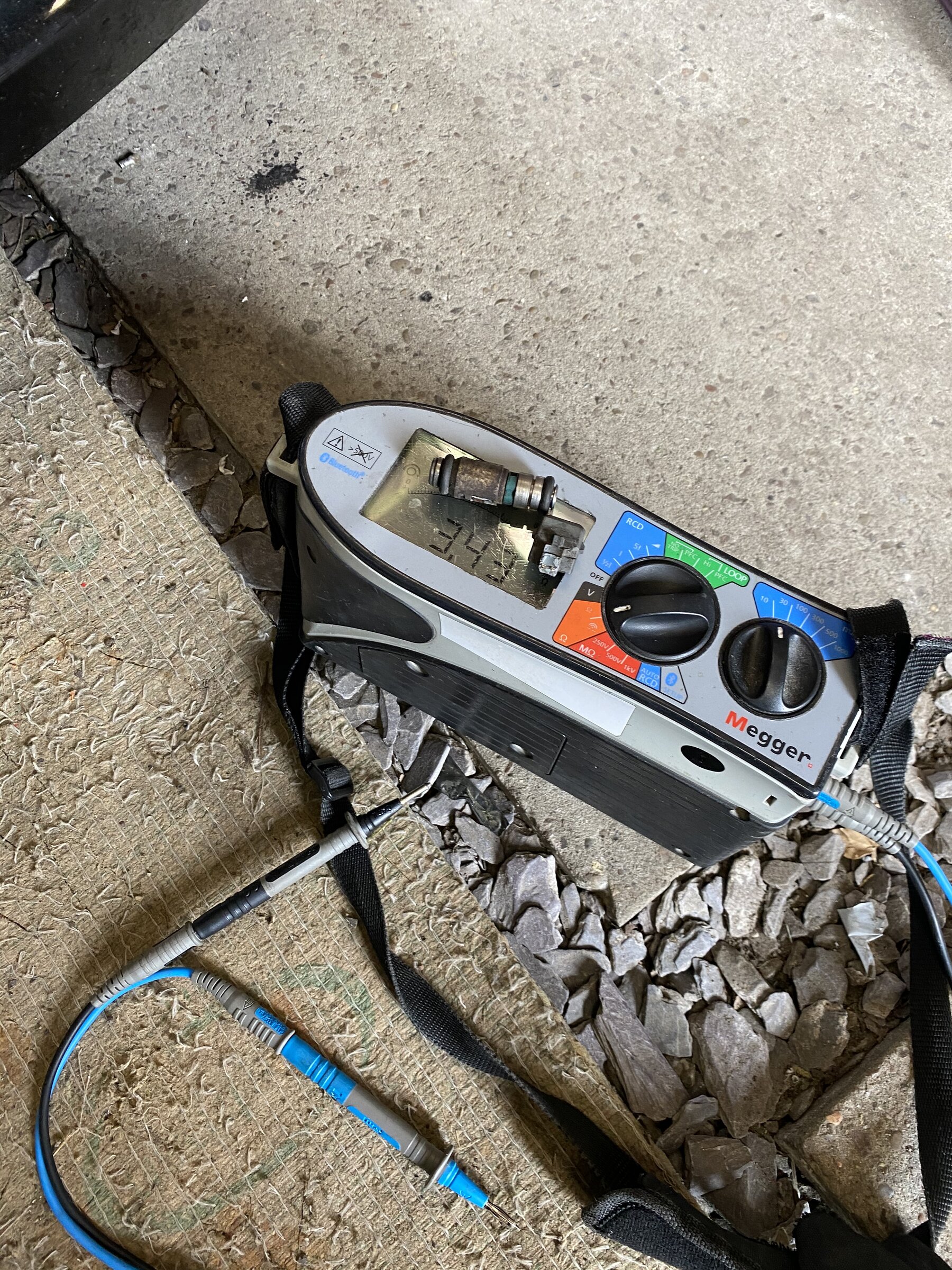

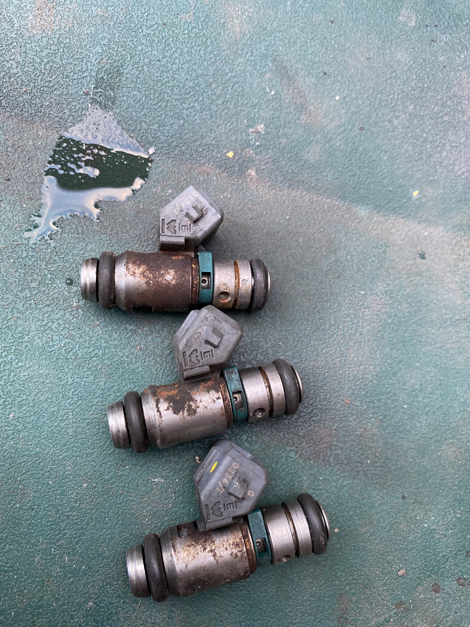

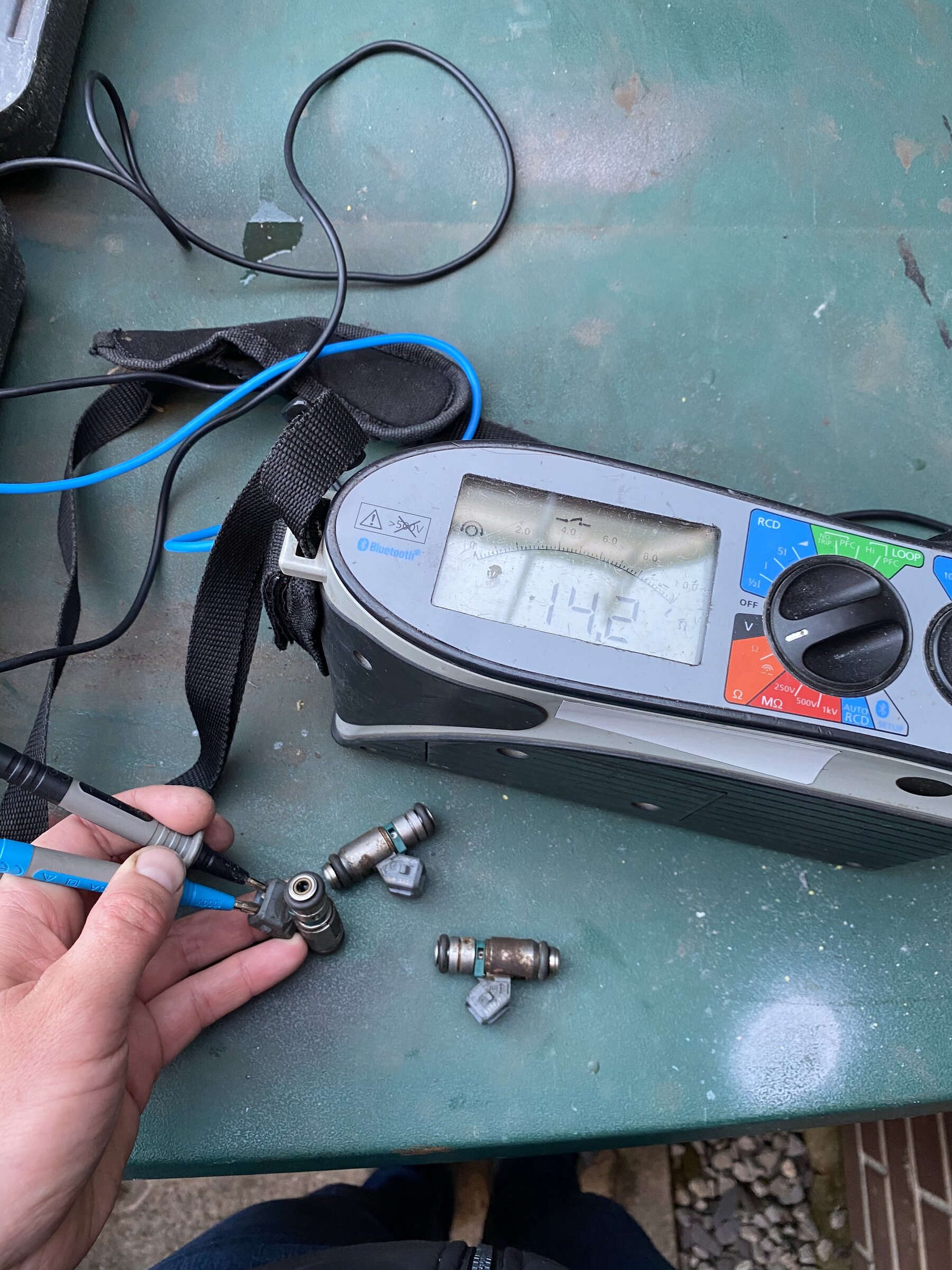

I had some old injectors from a past 172 knocking around, some fault finding and ithink I’ve fixed the misfire.
Don’t want to start it up until the cats back in place though.

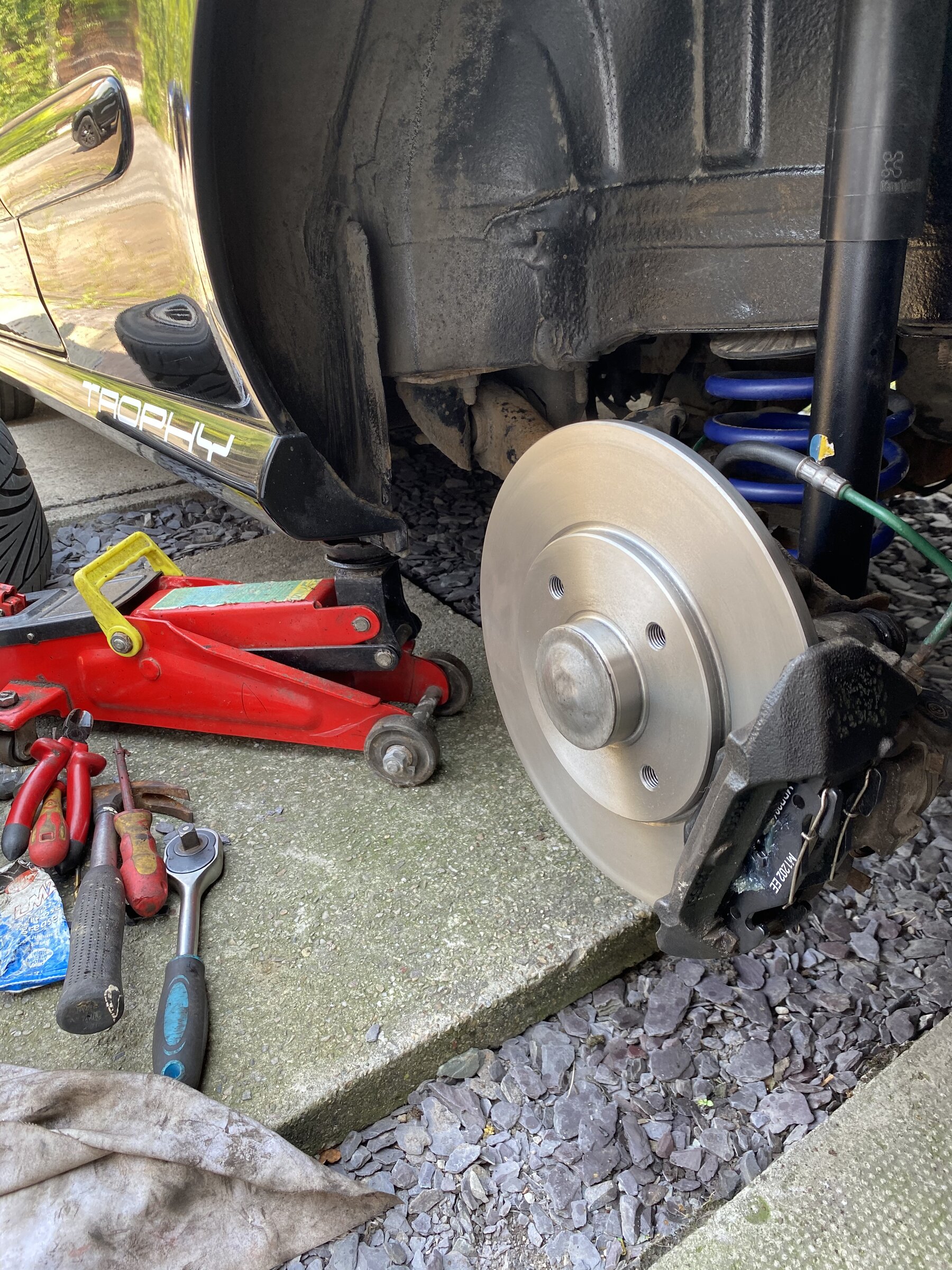

Back from 2 months working in Sweden, able to sort some more jobs on the black gold!

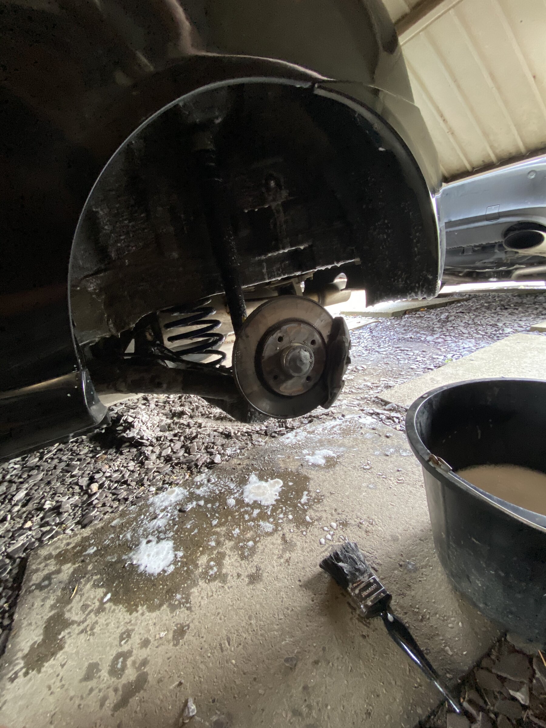

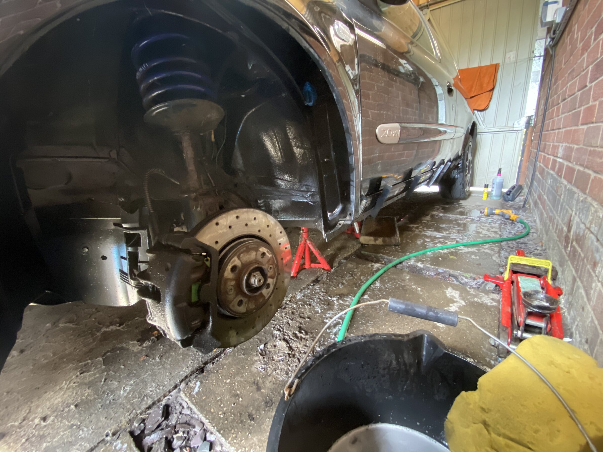

Replaced the rear discs and pads

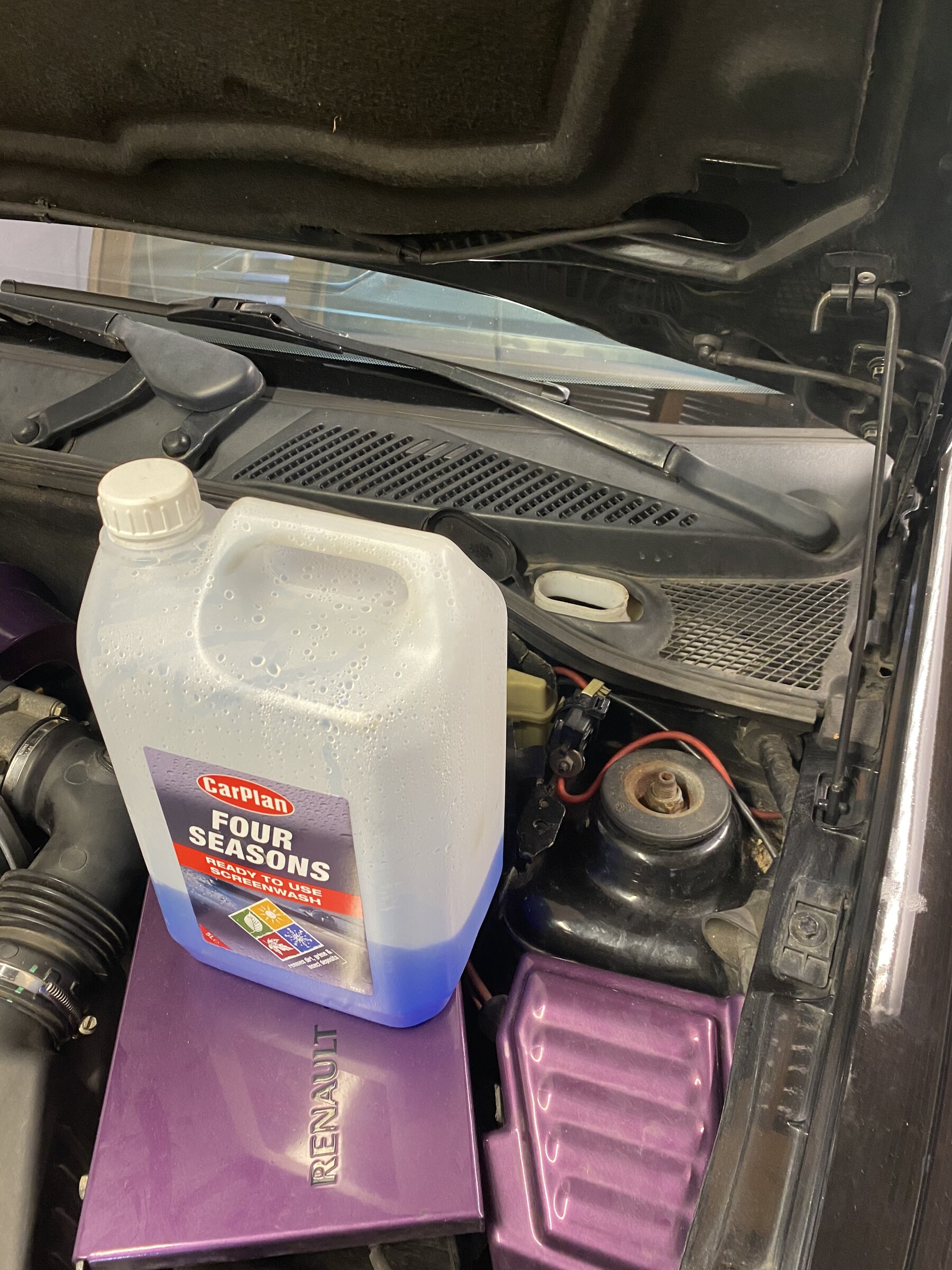

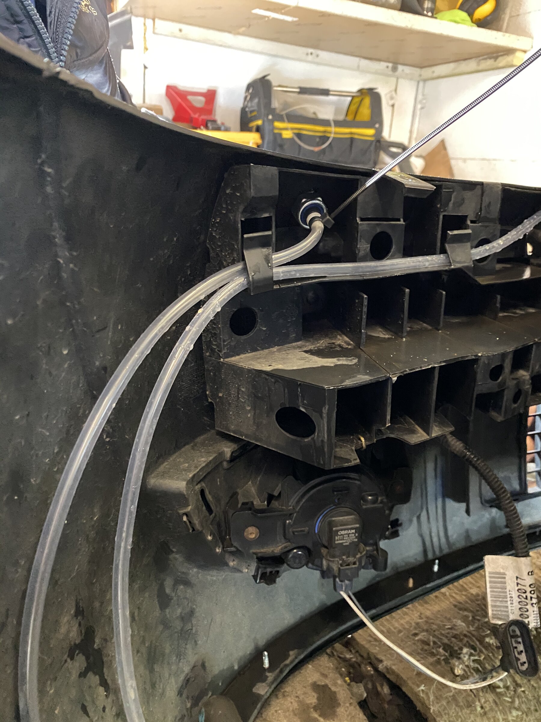

The washer jets were missing when I bought the car, as was all the plumbing.
A trip to B&Q for some 8mm rubber hose + couplers and M14 nuts and all working again.

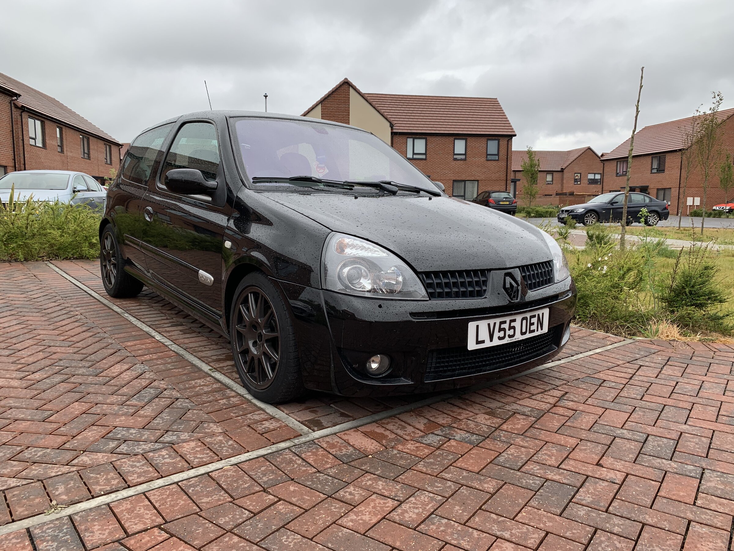

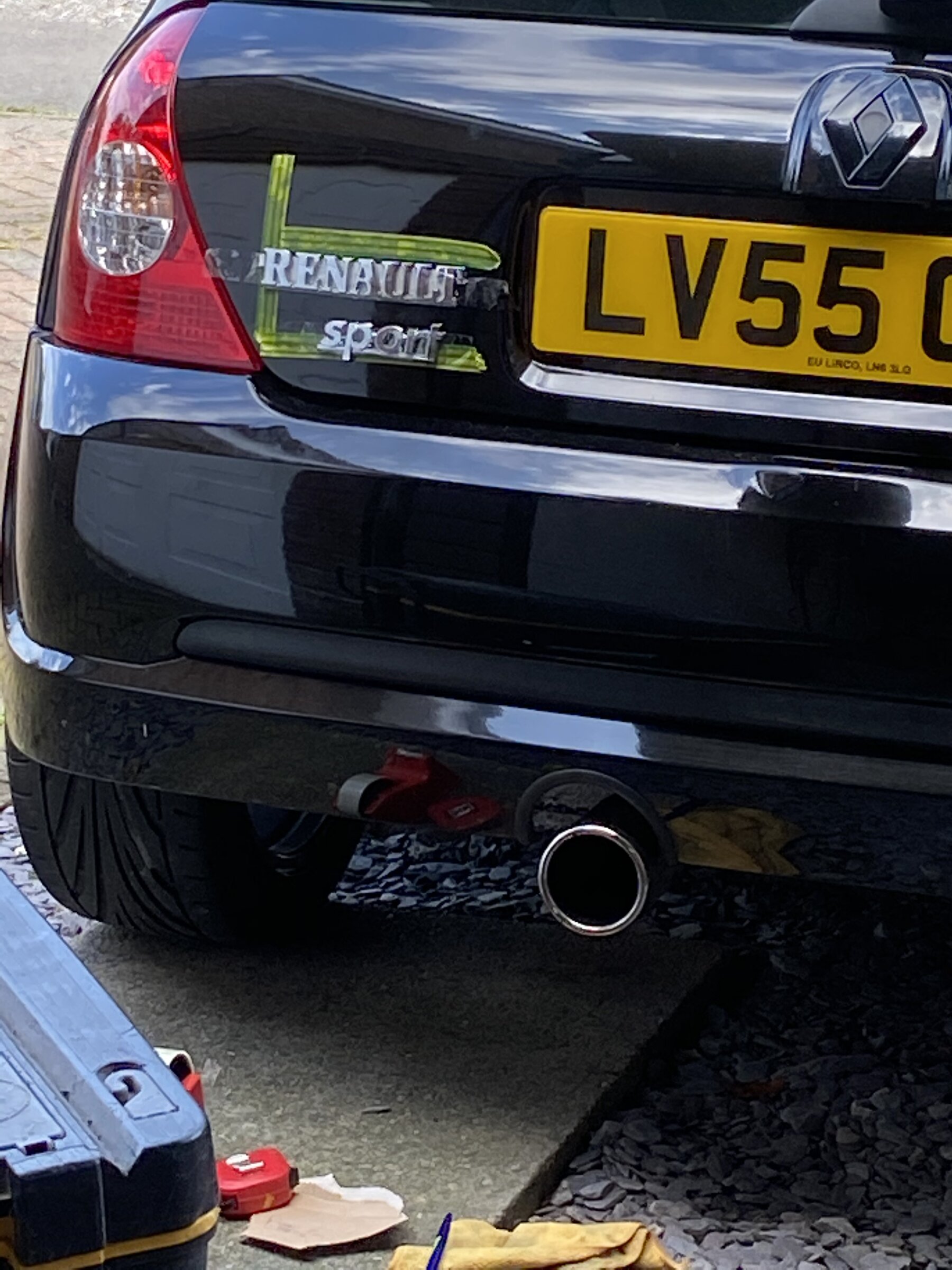

I removed The rear badges Renault Sport badges back in April as they were incorrectly spaced. A new Sport badge with some measurements from My previous cars I’ve got the badges looking more OEM.
stuck some road tax on, half a tank of Shell Optimax and went for a spin.

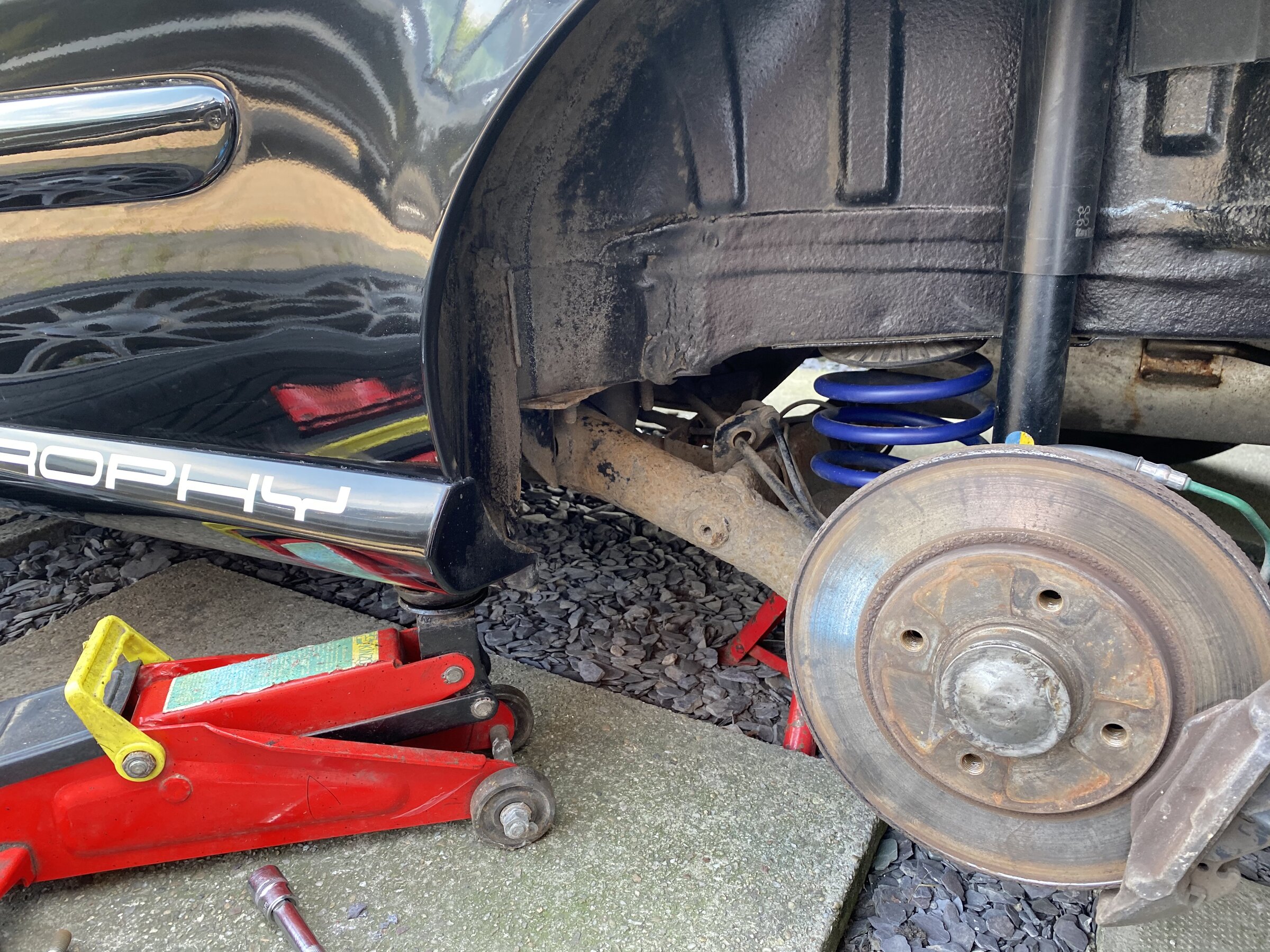

New shocks and wishbones just ordered, plus track rod ends.
Took it for its first proper blast, lt runs so well with the faults fixed and fresh service.

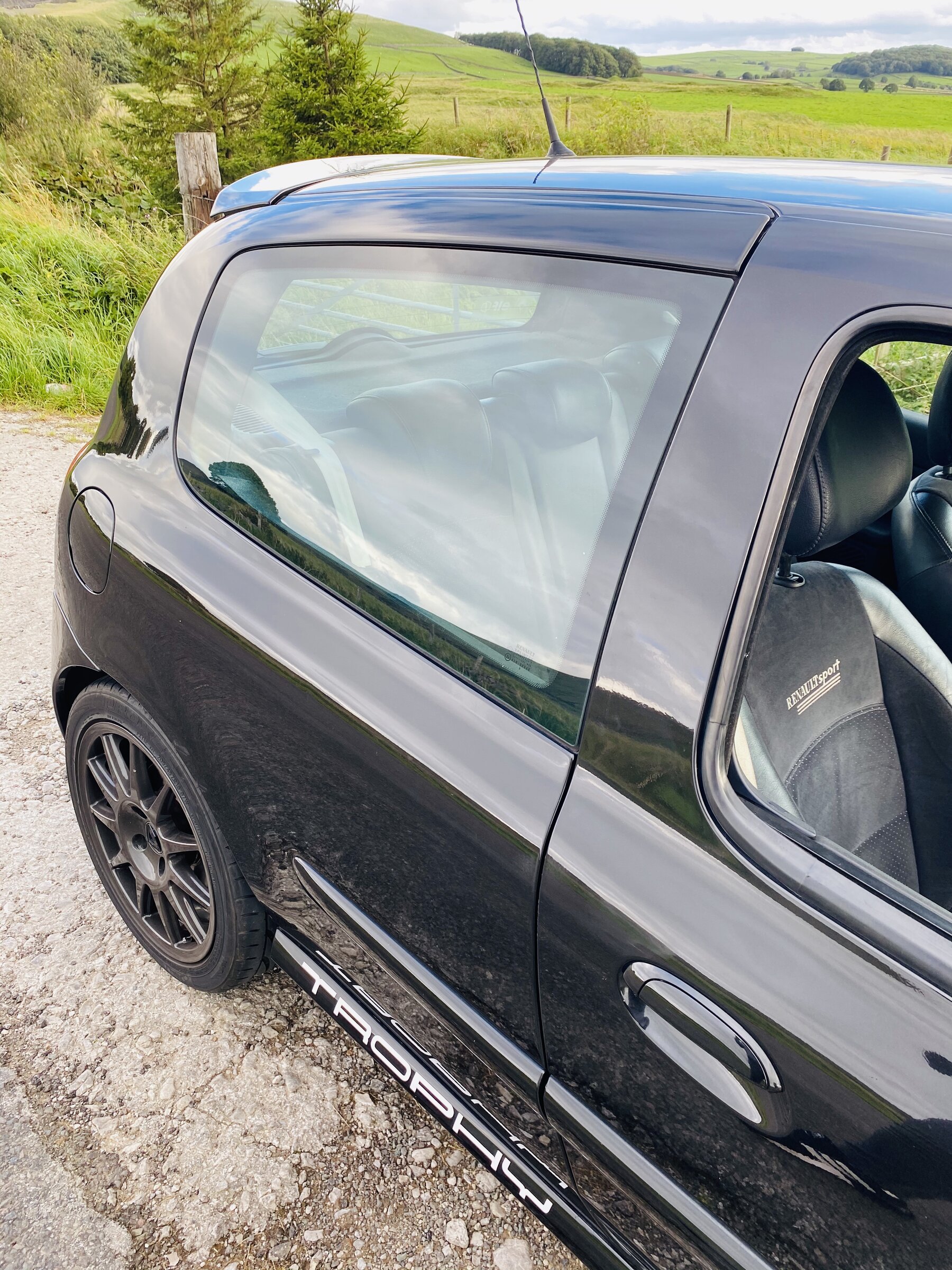

Car looks great, but what's with the trophy decals?

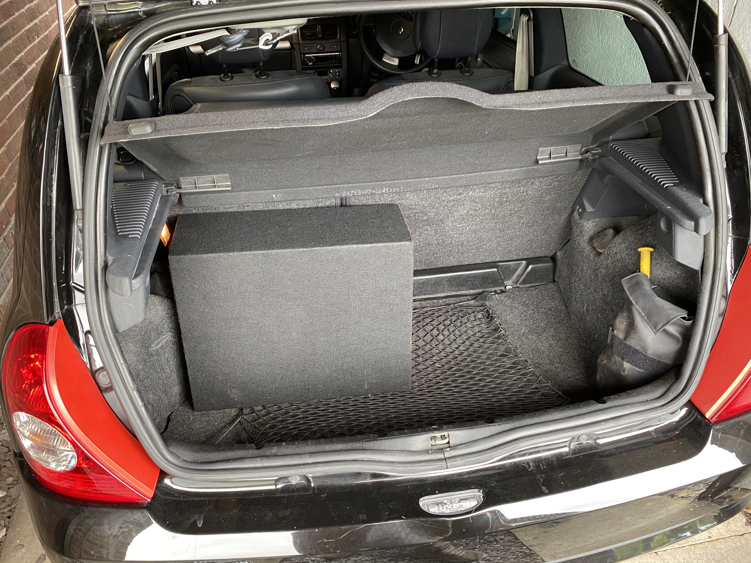

Old Sub wired in (old school)

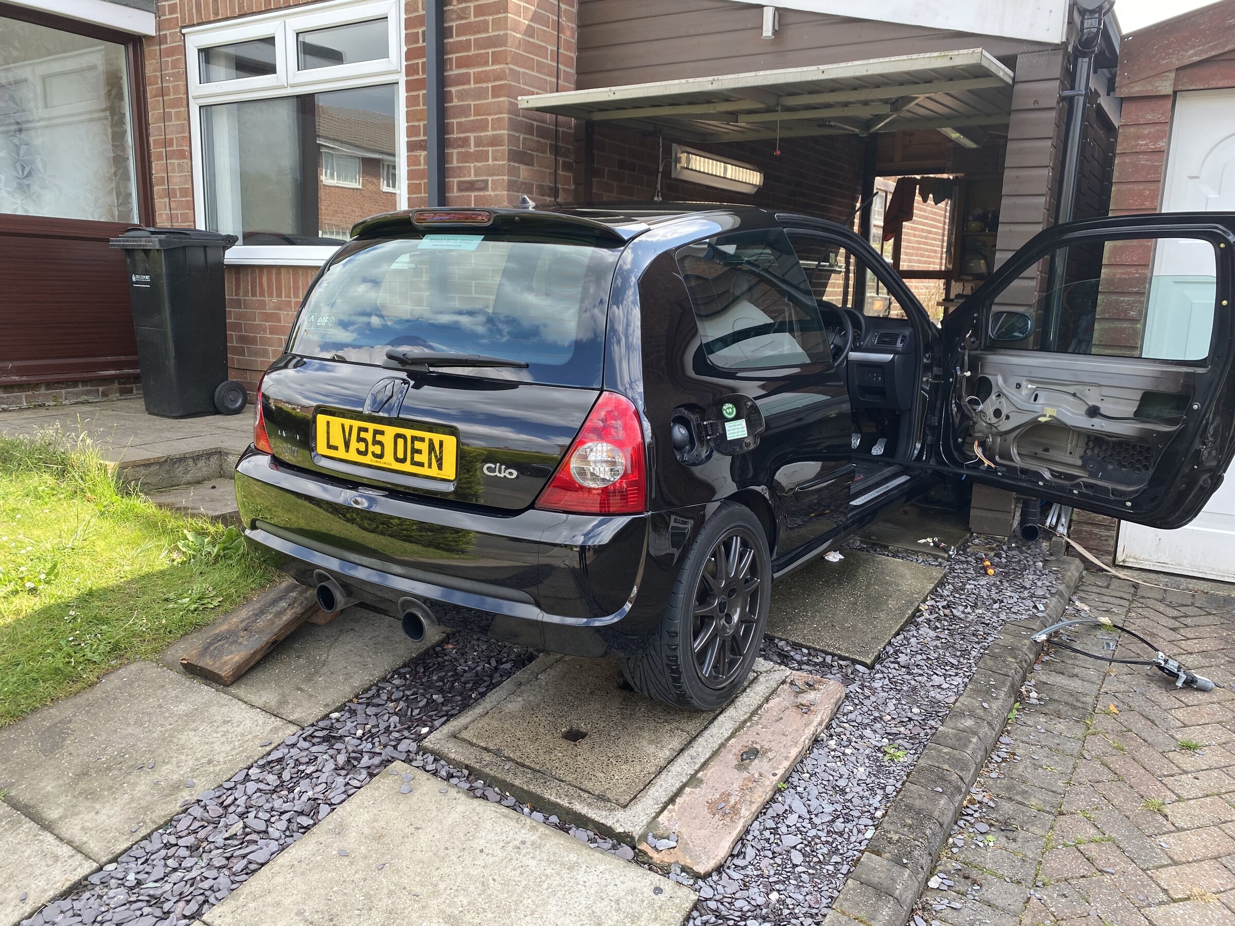

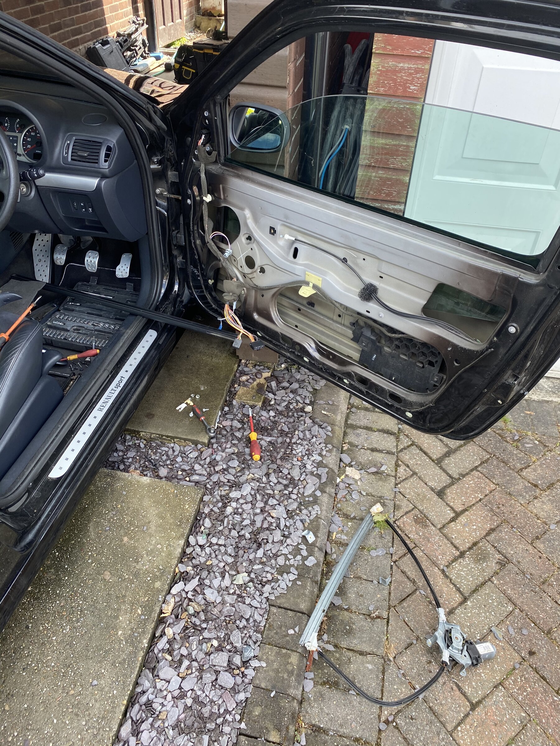

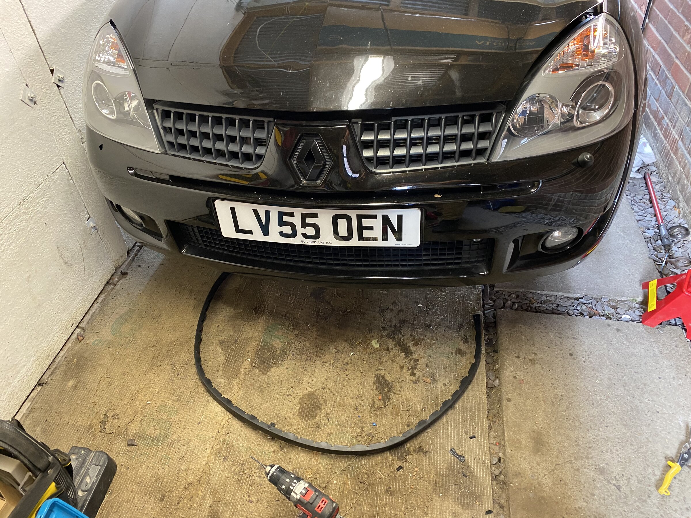

Added the Fabia splitter, boot net and fixed the broken drivers window mechanism.

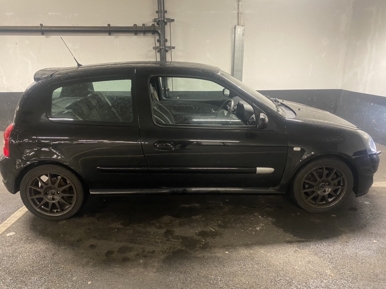

Not updated this thread for some time. I Moved house before xmas, and the Clio has not been used much.

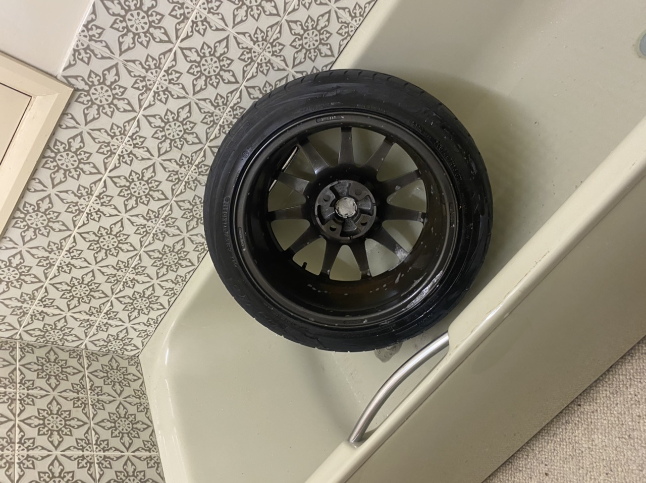

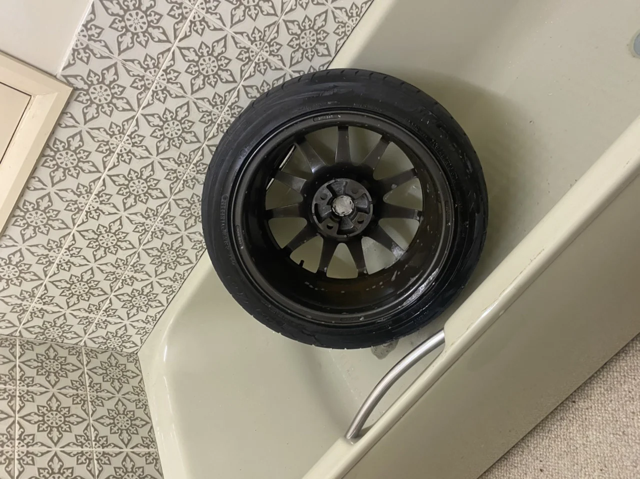

She got treated last month with a trip to Birchdown Autos for Full Belts, dephaser, ABS fault fixed and a fresh MOT. I also picked up some 182 alloys as I missed the OE look & a smaller front plate.
I did advertise the car for sale, I spend too much time working on the new house or away with work, and the Clio rarely gets used, however i have decided to keep it for now, and use it more often.
I've just ordered some new bits for her, and considering booking a track day this year. I have never done one. Which is ridiculous as this is probably my 20th Renaultsport!

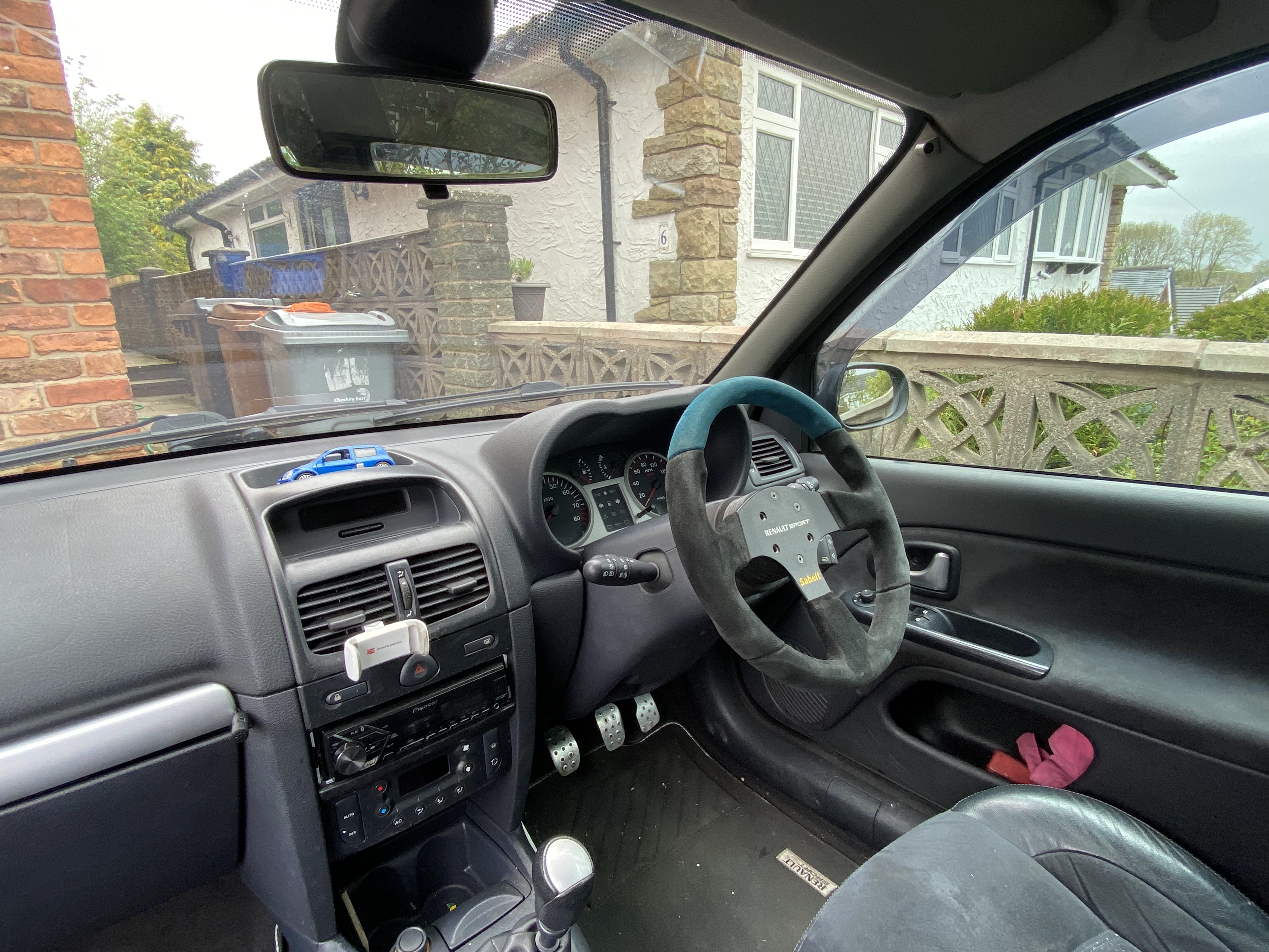

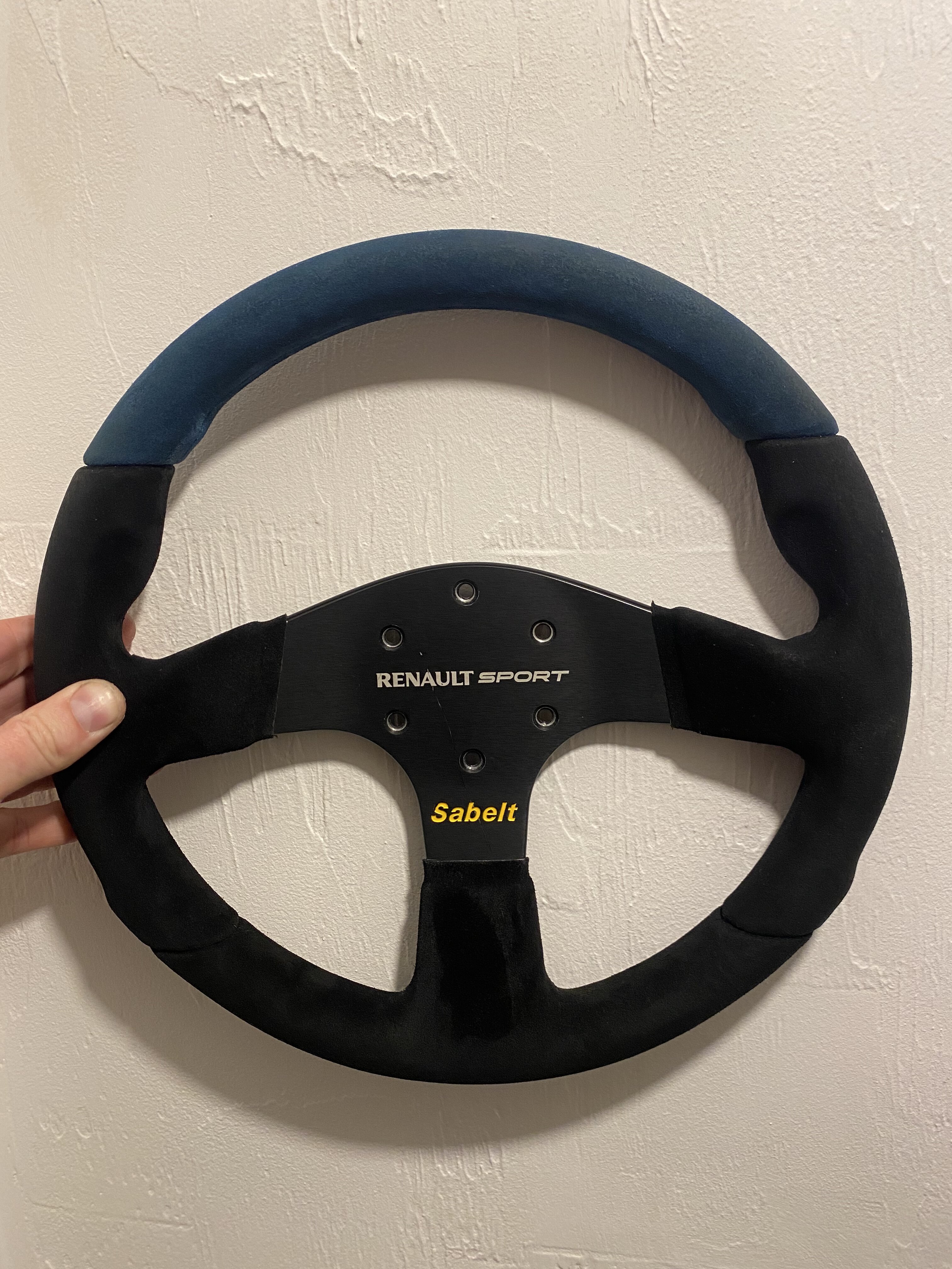

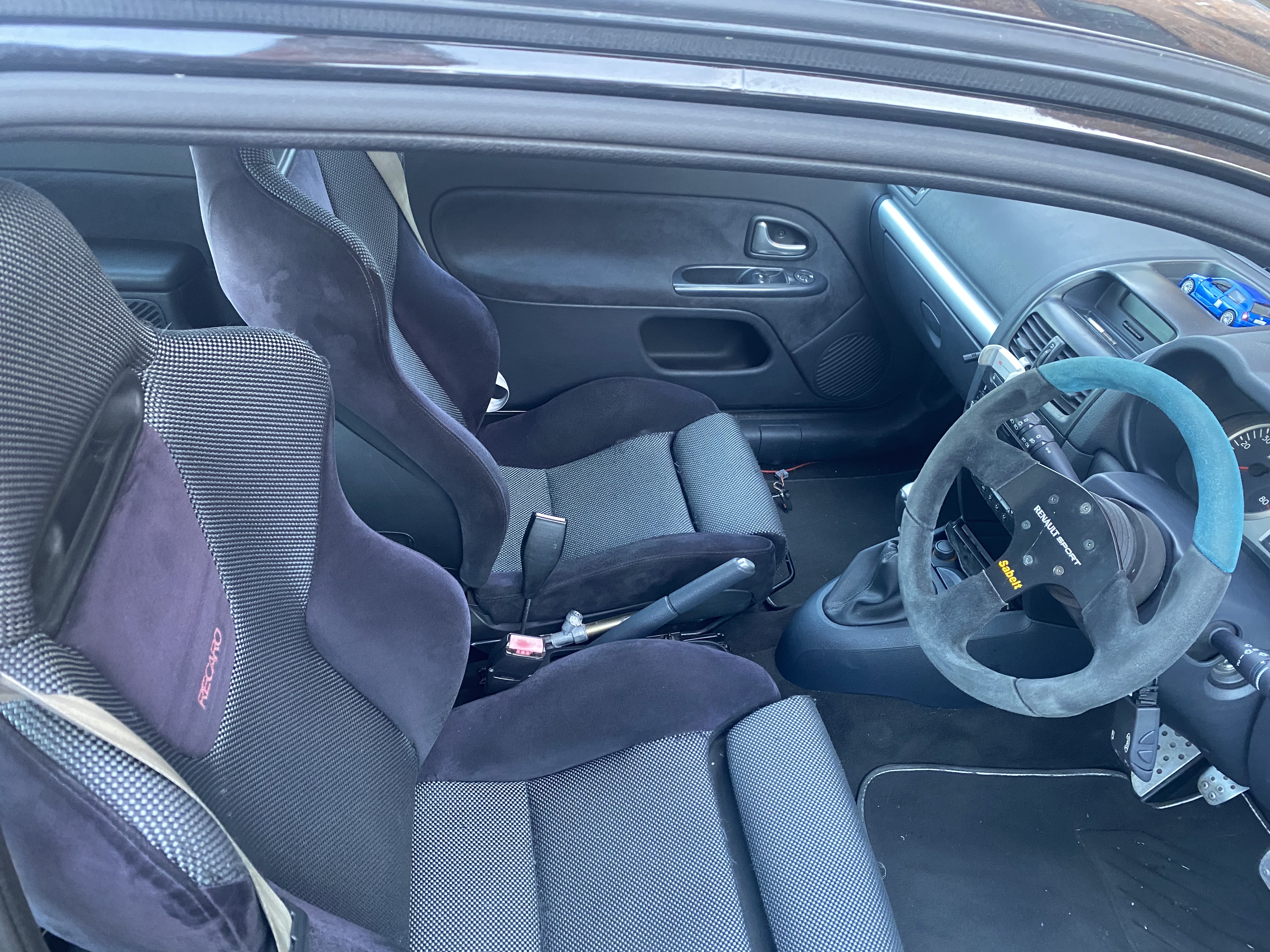

She got treated this weekend to some Evo Recaros and Sabelt steering wheel :)
Cars running well, just need to sort the airbag resisters out and perhaps order a volentech button plate for the cruise/ horn.
