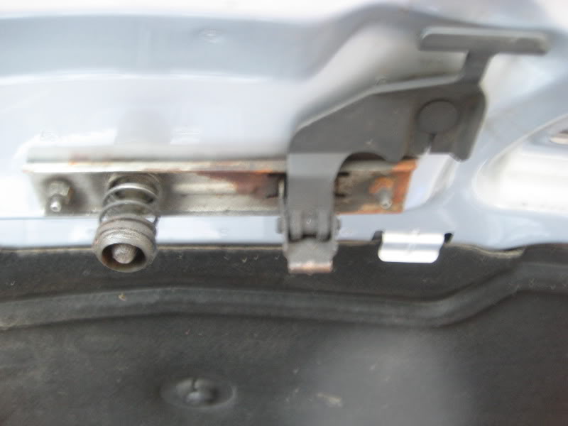

EVERY MKII Clio is affected, if their is rust on the catch or locking mechanism they get replaced FOC, if they are not corroded they will be lubed like they are on every service we do, again FOC
thats it in black and white, if you have a corroded catch come and get it changed

mine wasnt coroded atall not a spot of rust on any on the mech ??? still got it all replaced though :D

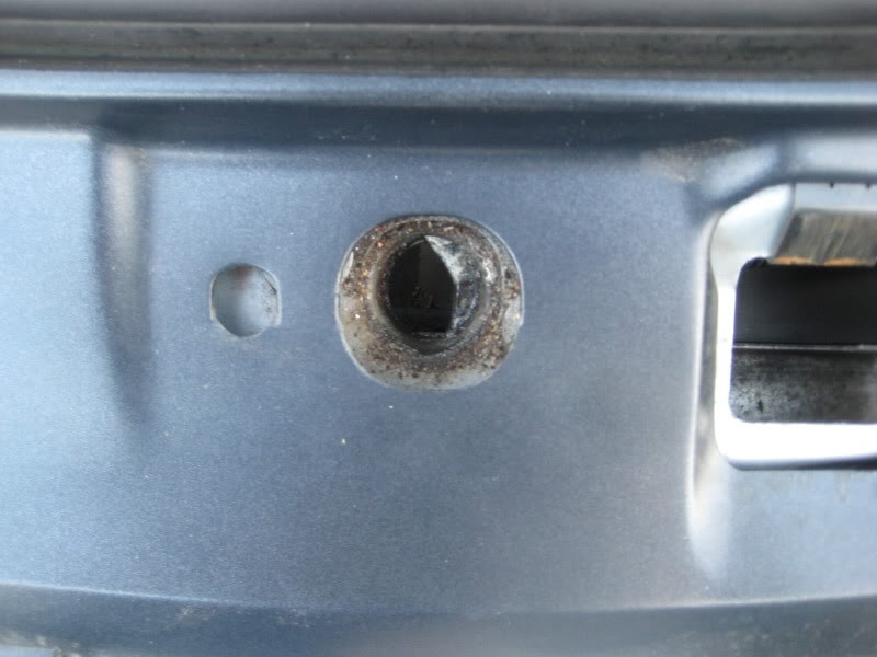

Can someone please post pics on exactly which parts need to be lubricated?

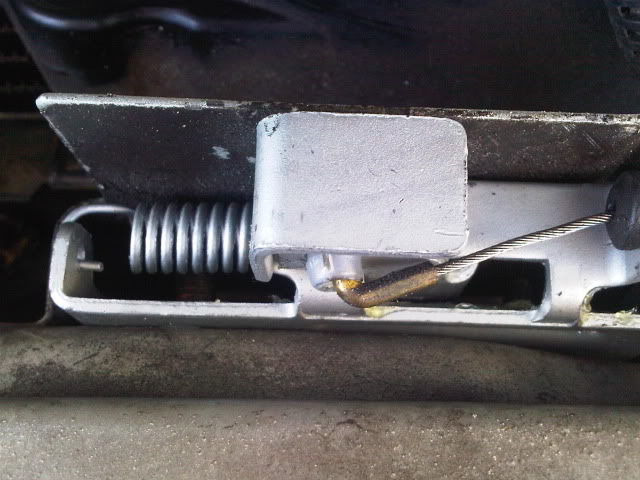

All they do is grease it up I believe. They don't change anything on the mechanism. I check mine often anyway so I always re-grease it etc if needed.
Do not grease it!! Bugs and s**t sticks to the grease, jams the safety latch up and that could cause problems.
I still believe its purely poor maintanance that causes the bonnet to flip up. In my 4 years at renault I never ever saw one come in with a flipped bonnet.

If thats what it looks like mines an old one, Mines plastic IIRC, Well not the catch but you know what i mean
  Maybe a 172 Cup..
Although I've sorted mine with WD40, and put a bit on every week when I check oil, still gonna phone Renault and see if I can get it changed FOC..

Just been to evan's halshaw about this today and can confirm whats already been said,if there is any signs of rust on the part attached to the bonnet it will be replaced(20mins)and the catch on the slam panel will be tested and replaced if need be (45 mins) all foc !!
