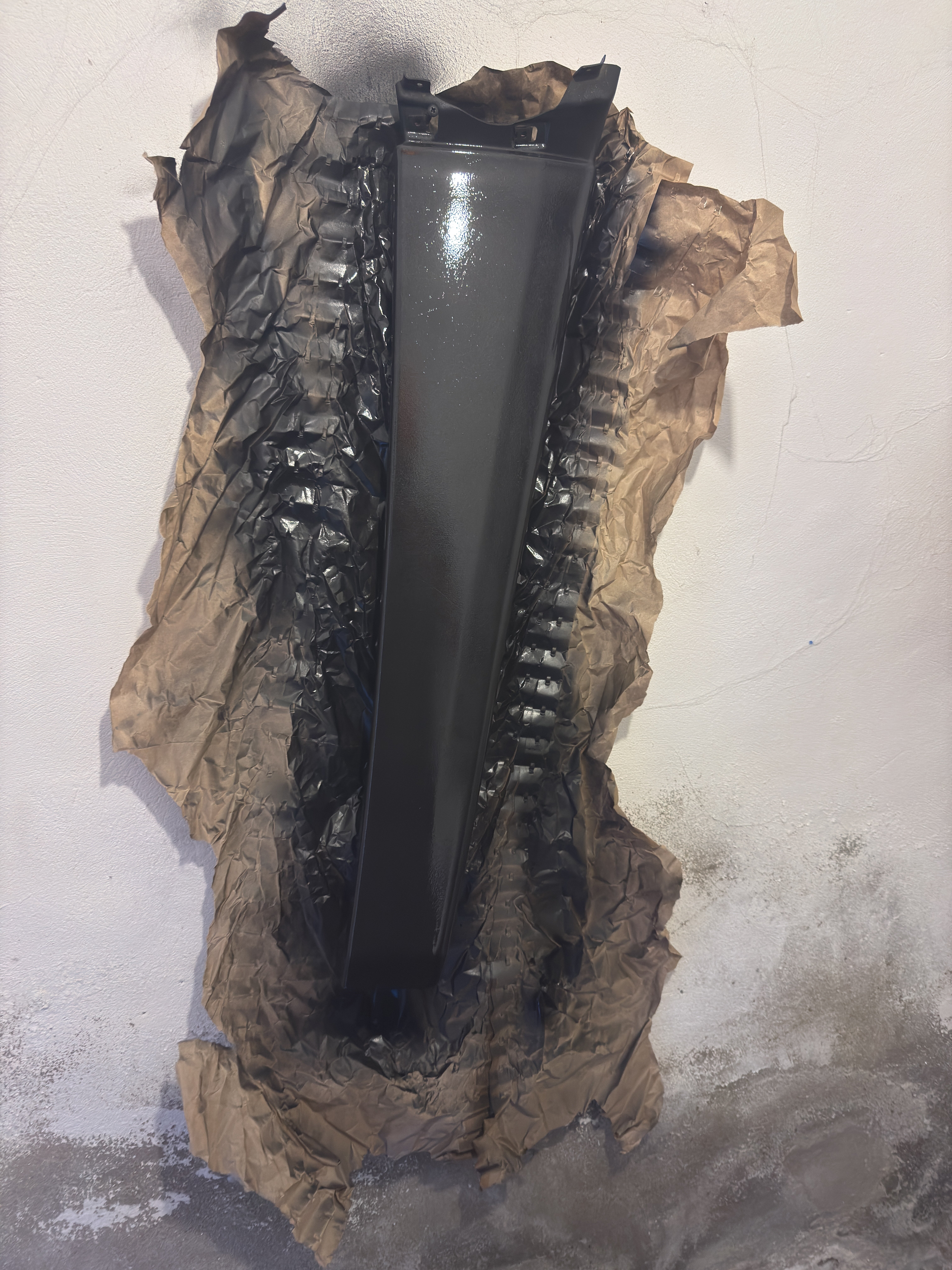

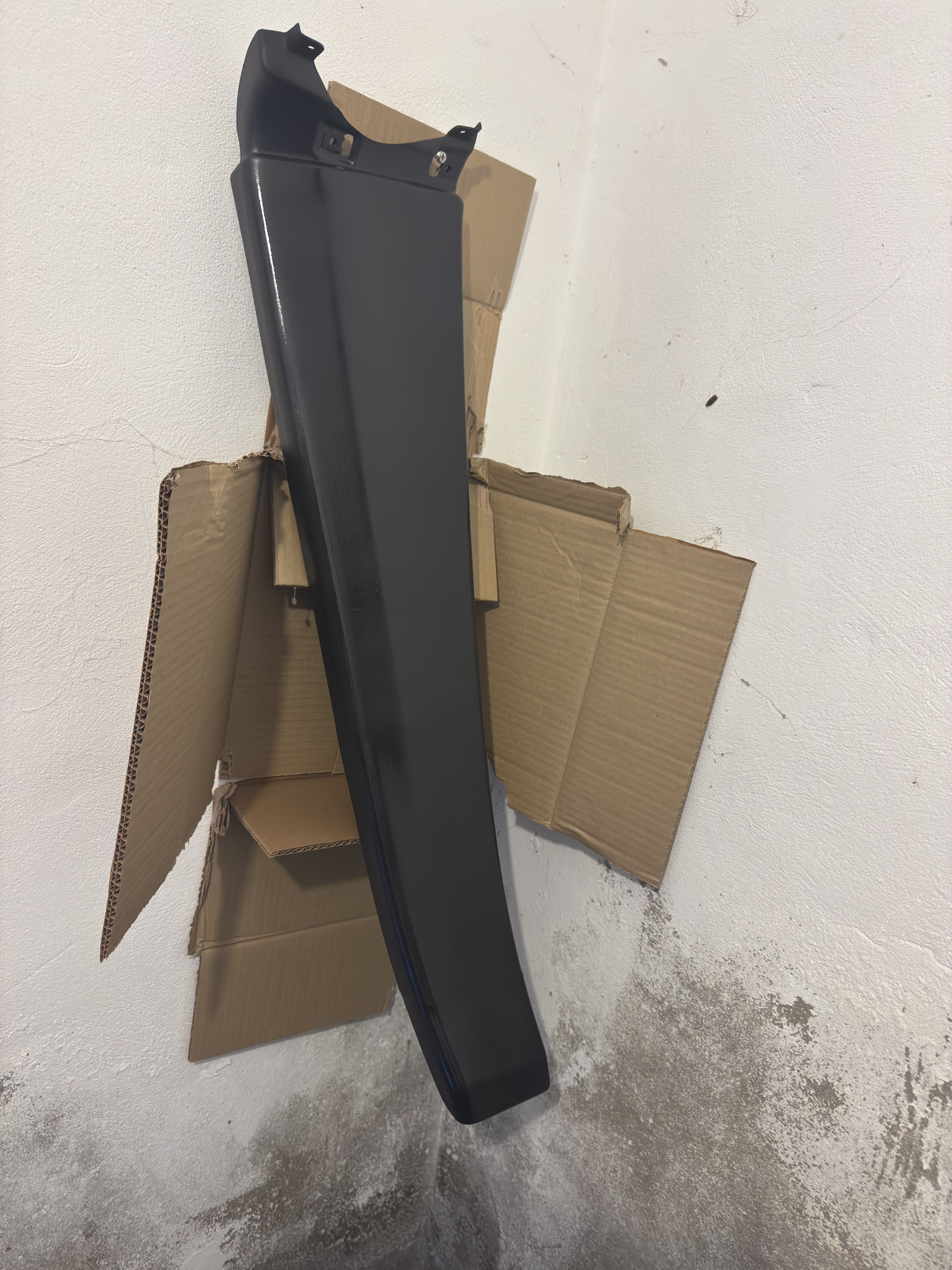

My drivers side sill cover had split and was threatening to nip my inner thigh with its plastic jaws everytime I got in and out.
For reasons unknow I failed to get pictures of me removing this part and melting hot metal wire into the crack. Perhaps it was the toxic plastic fumes that came off the metal that caused me to forget. I also removed the wrap that was on the sill covers. It was a carbon wrap and was starting to show its age.
Anyway, the two major cracks are now held together with the metal wire and some filler made up of superglue that's subsequently sanded down.
Tonight I took them to the spraybooth* and painted them with stove paint. I have no idea how they will turn out but as long as they look 59% as good as before, Ill be happy.
* garden store.

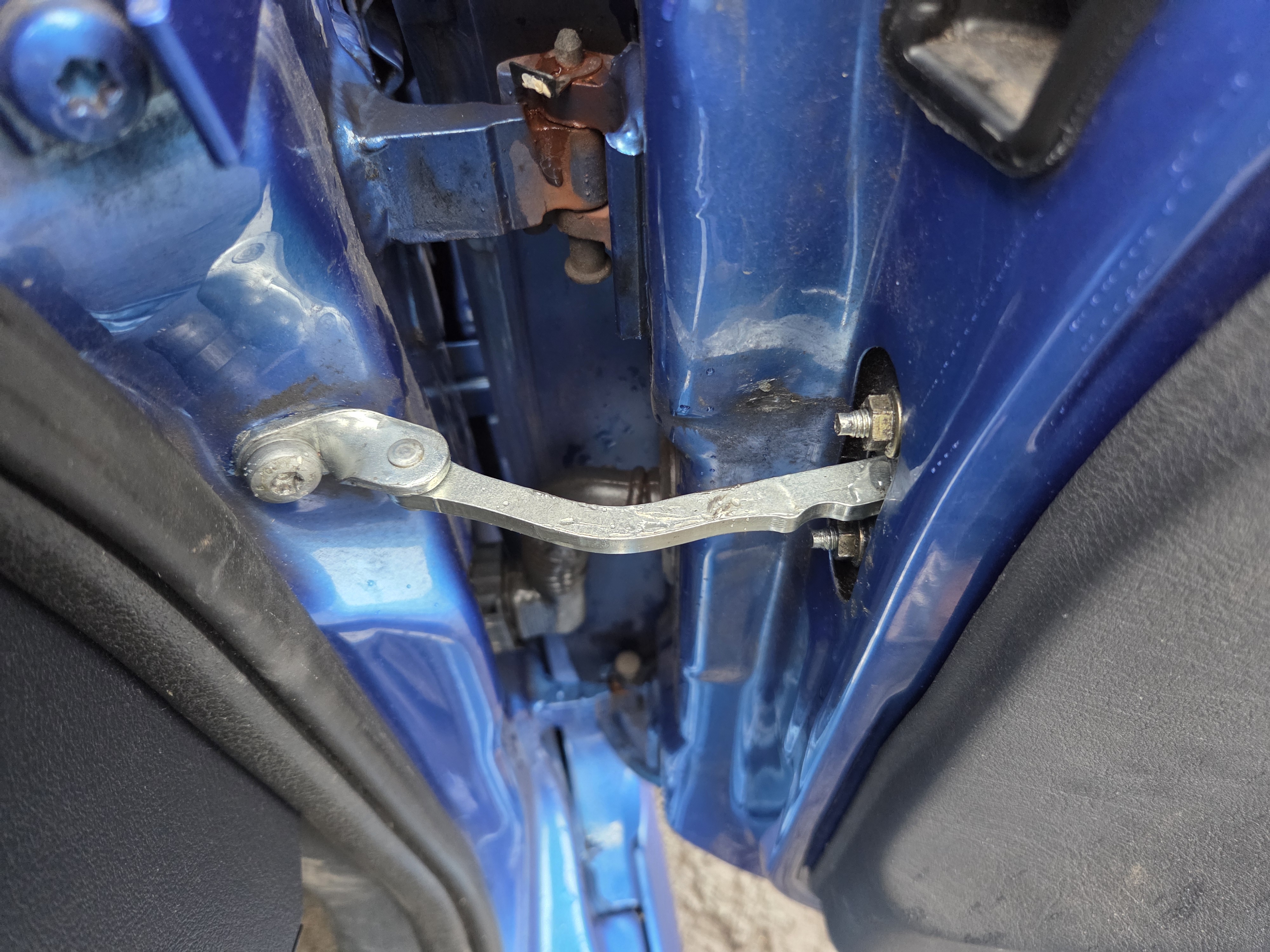

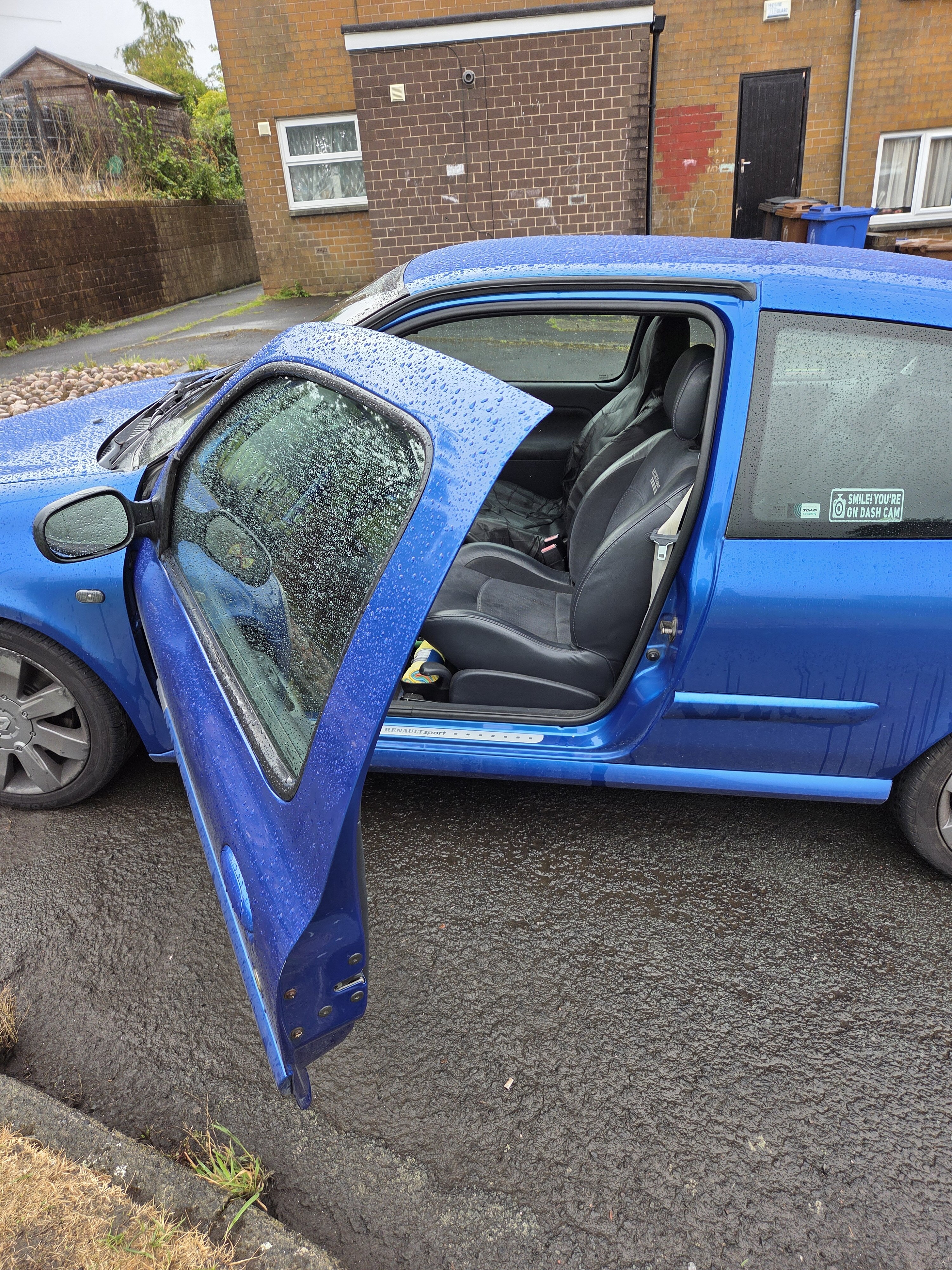

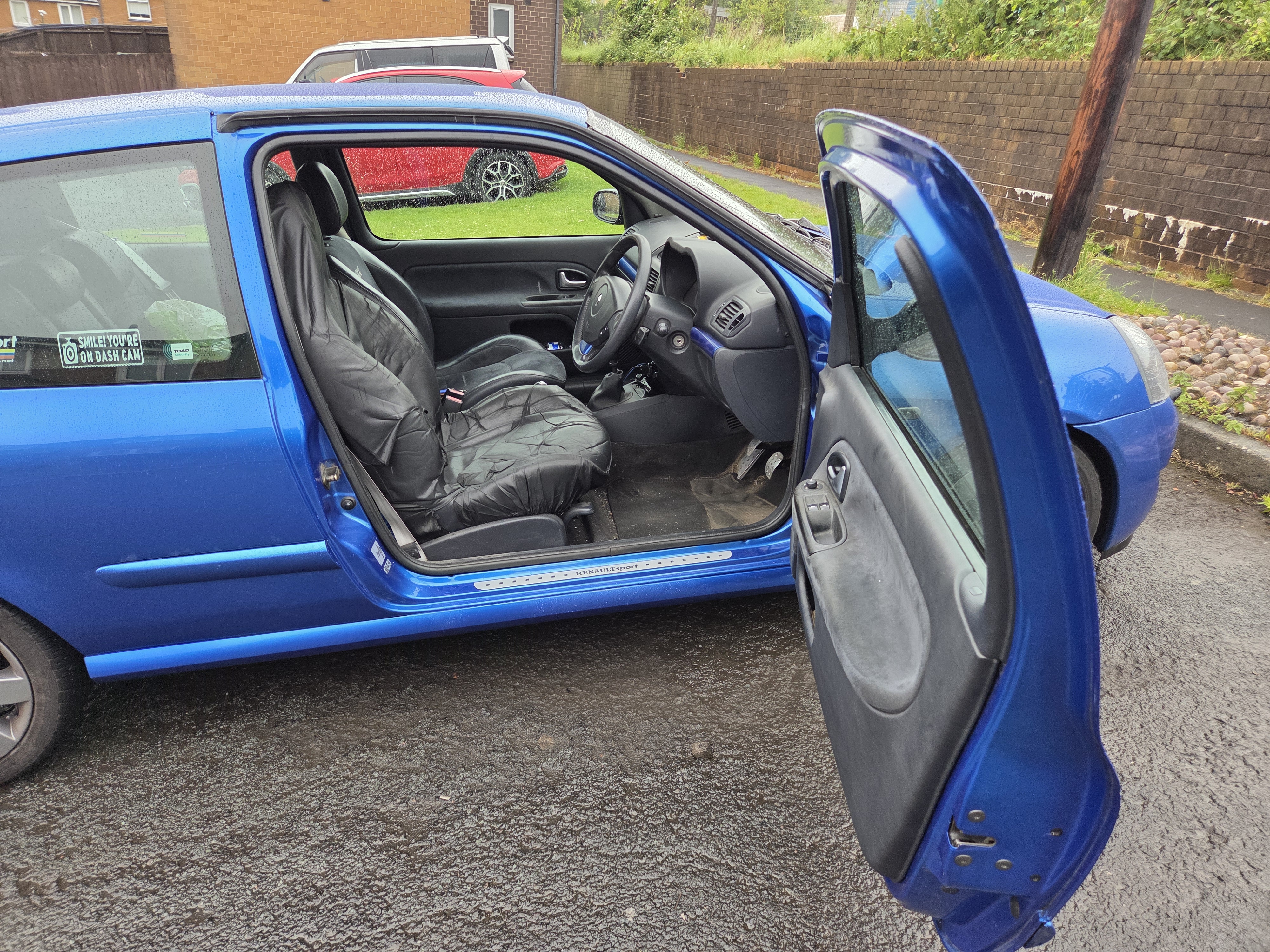

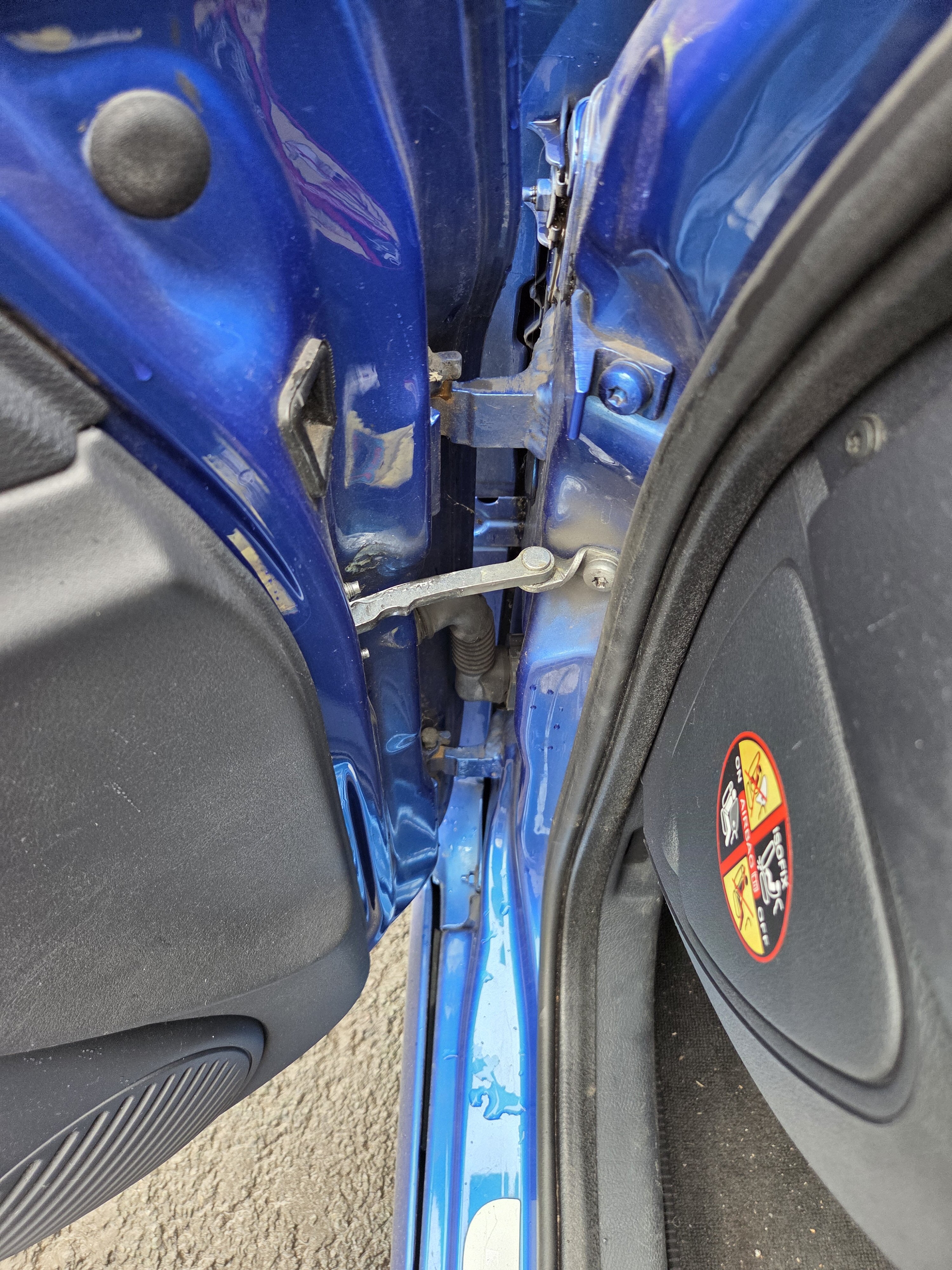

I changed the drivers side door check strap yesterday.
It definitely looks different to the original one, but it works. No more clunking of the door when I open and close it 😁👍
One thing I have noticed with this check strap is, the door opens way more than with the original.

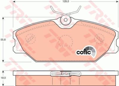

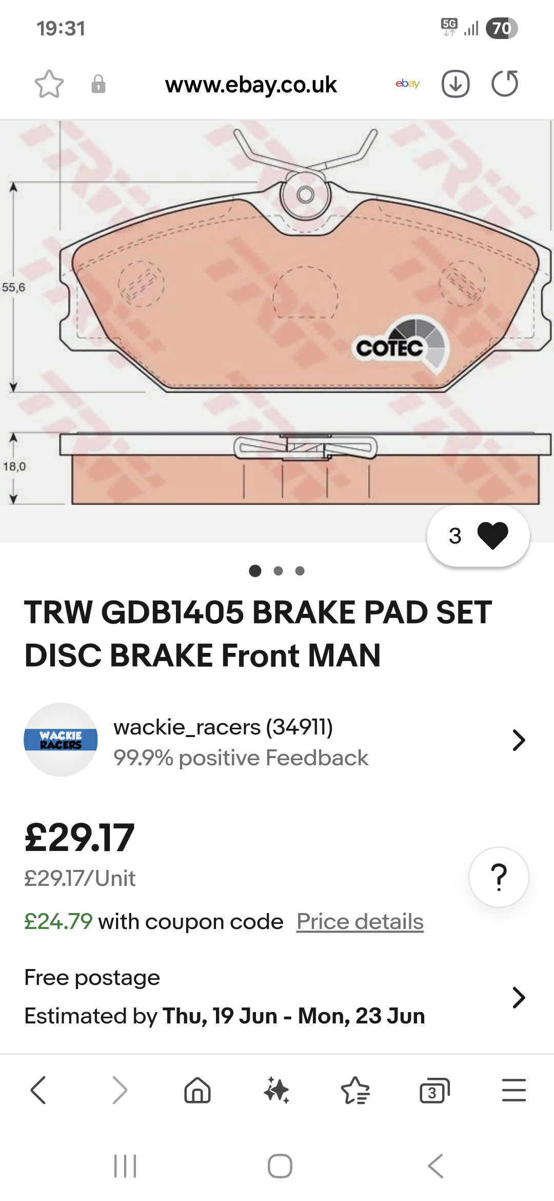

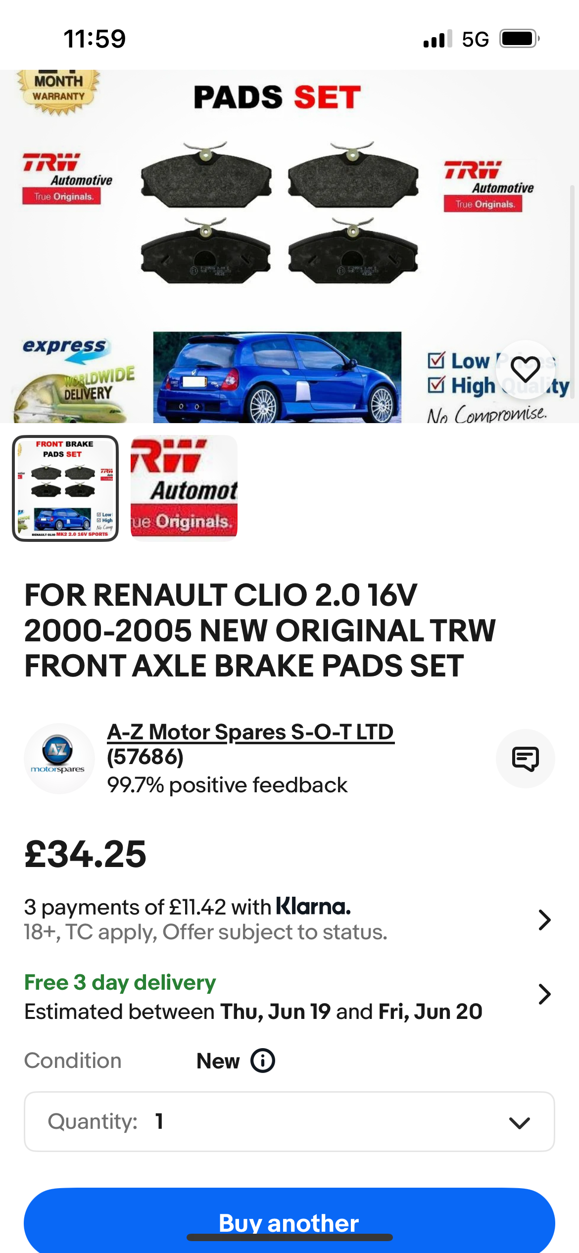

Gents, who make the OE pads for the 172 cup?
I have had enough of the worlds dustiest pads meaning every time I drive I have to clean the wheels as they look like they have been down t’pit for a week.
I fitted these TRW pads a few weeks ago. Dust is minimal for what they are, good bite and feel.
Absolutely silent also.
I paid £24 so it may be worth holding for a coupon or offer to come through if you stick on your watched list.
There ya go, £24.79
I agree. The dust is minimal, they last for absolutely ages. They never seem to fade when hot and bite from cold is very good.

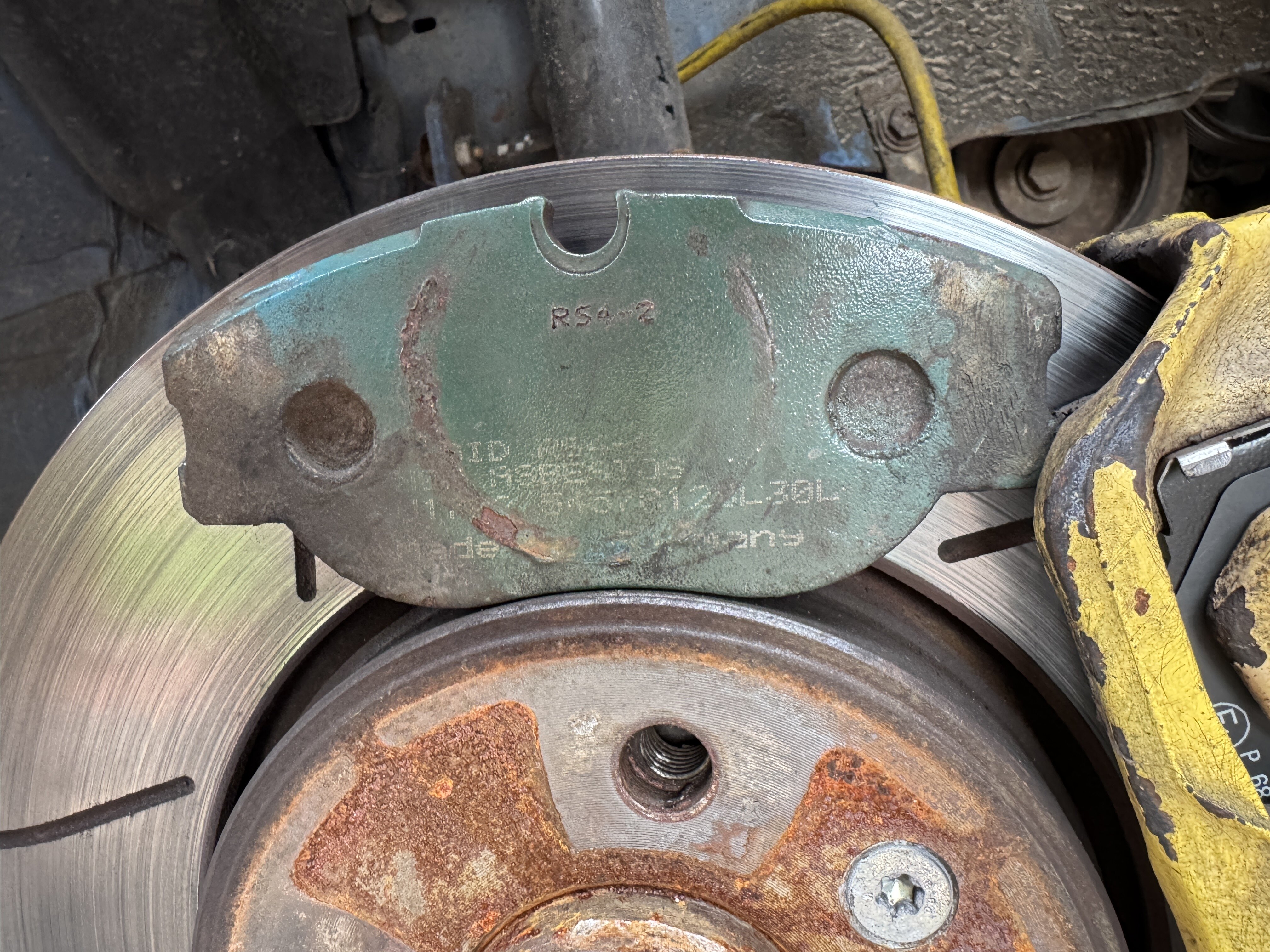

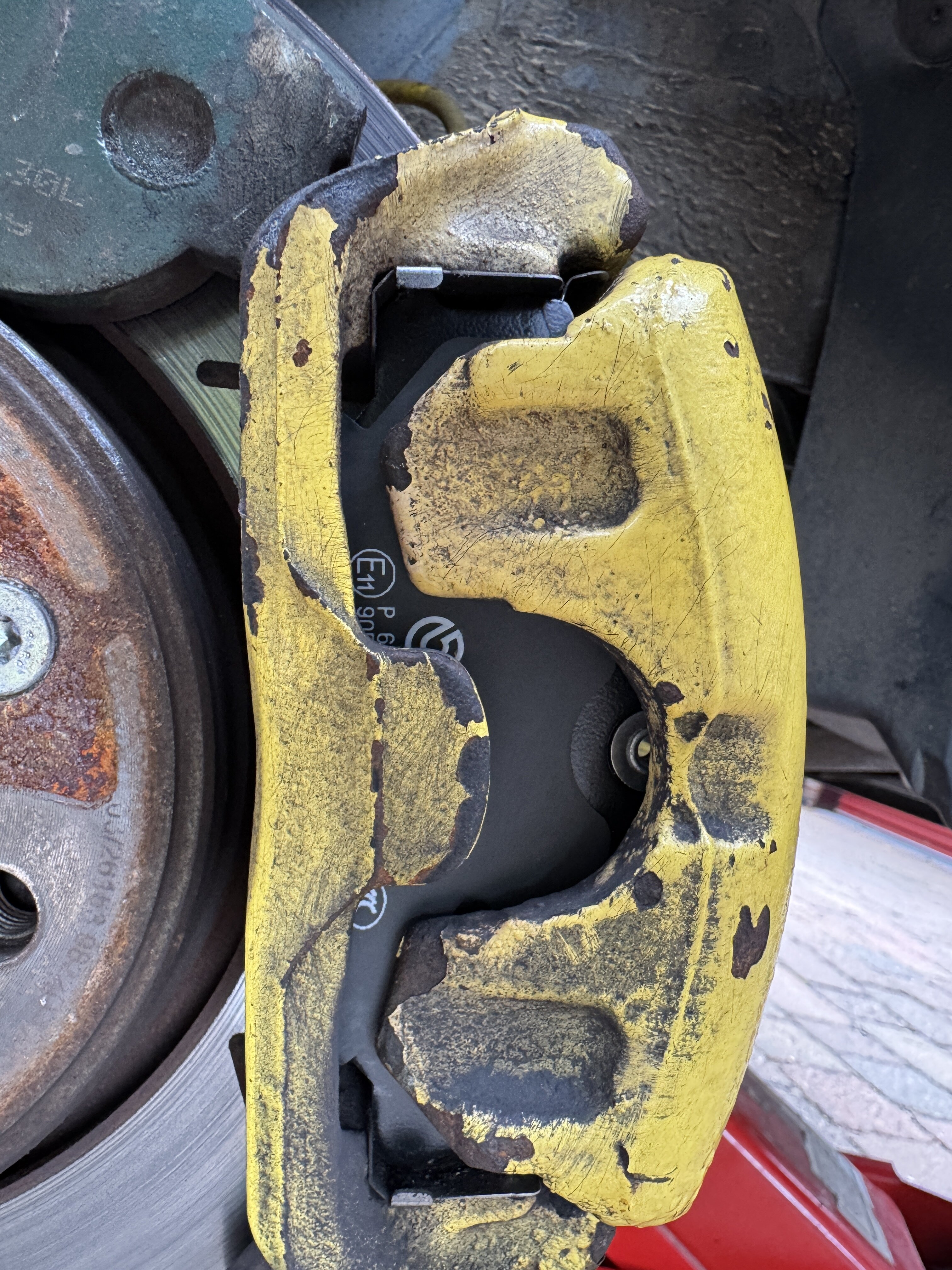

Tonight I changed the front pads on the car from RS4-2 to OEM Brembo.
I desperately need my callipers refurbing but I am delighted that the grinding noises have stopped when braking.

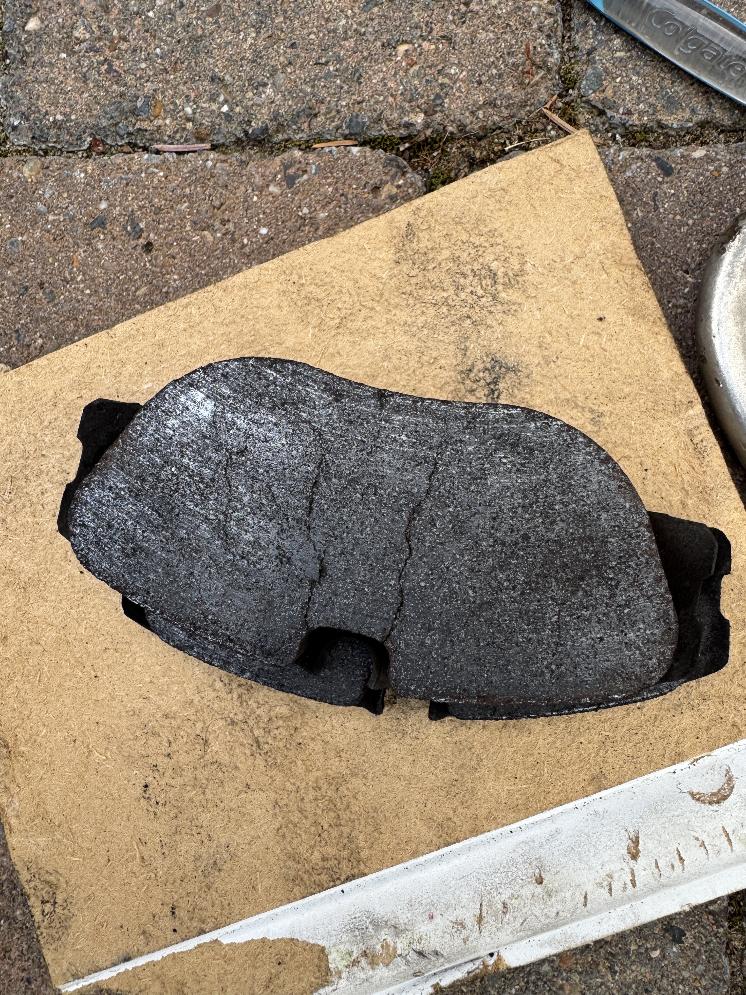

I noted that there were cracks in the pads and in one corner it had disintegrated.
Whilst I had each respective wheel off I used some silicon grease on the ARB bush, and top mount
Squeaks be gone! Off on a 90 mi round trip to play football tomorrow. Let’s see how long it lasts.

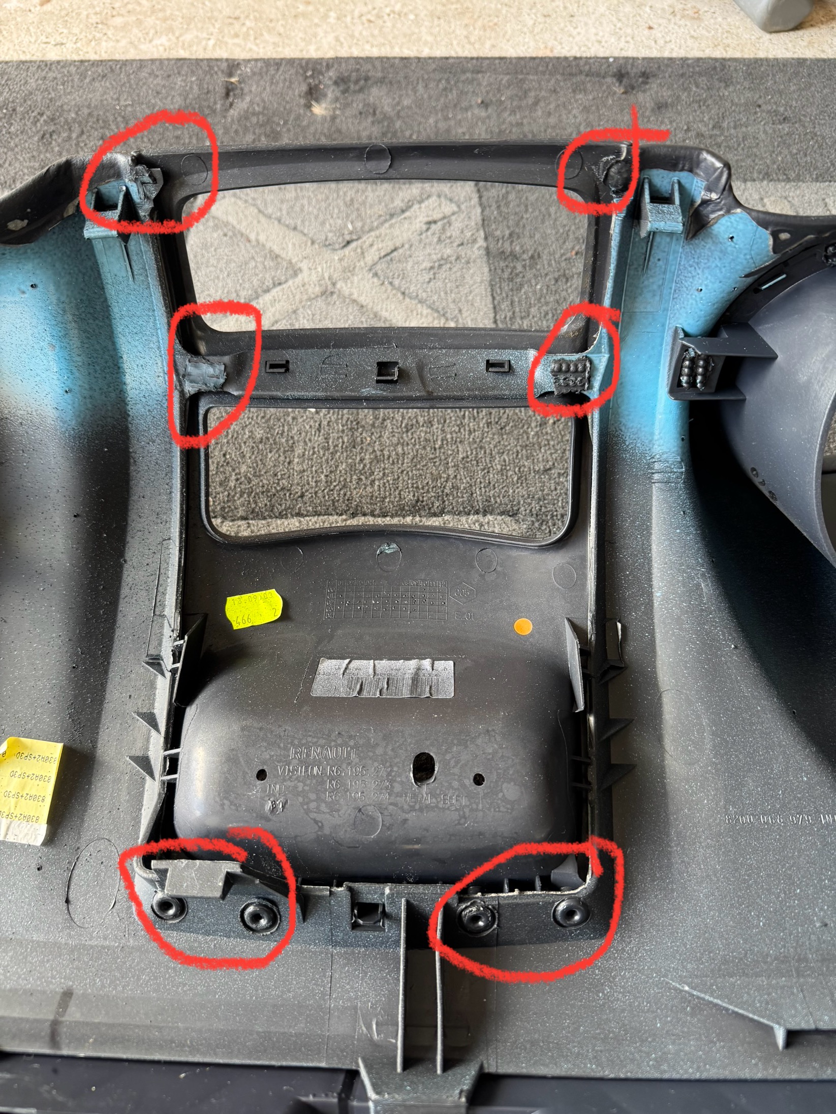

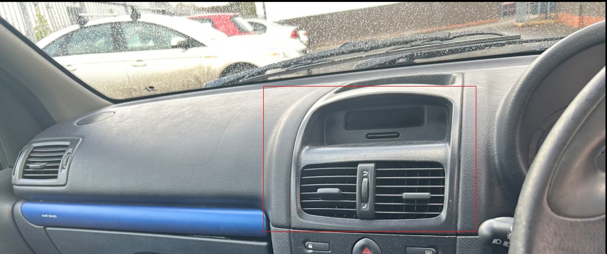

My center part of the dash is scabby. I also need two vents.
How do you change these out? I know if you take the dash top off it takes the center part out , but what about removing the vents?
This bit :

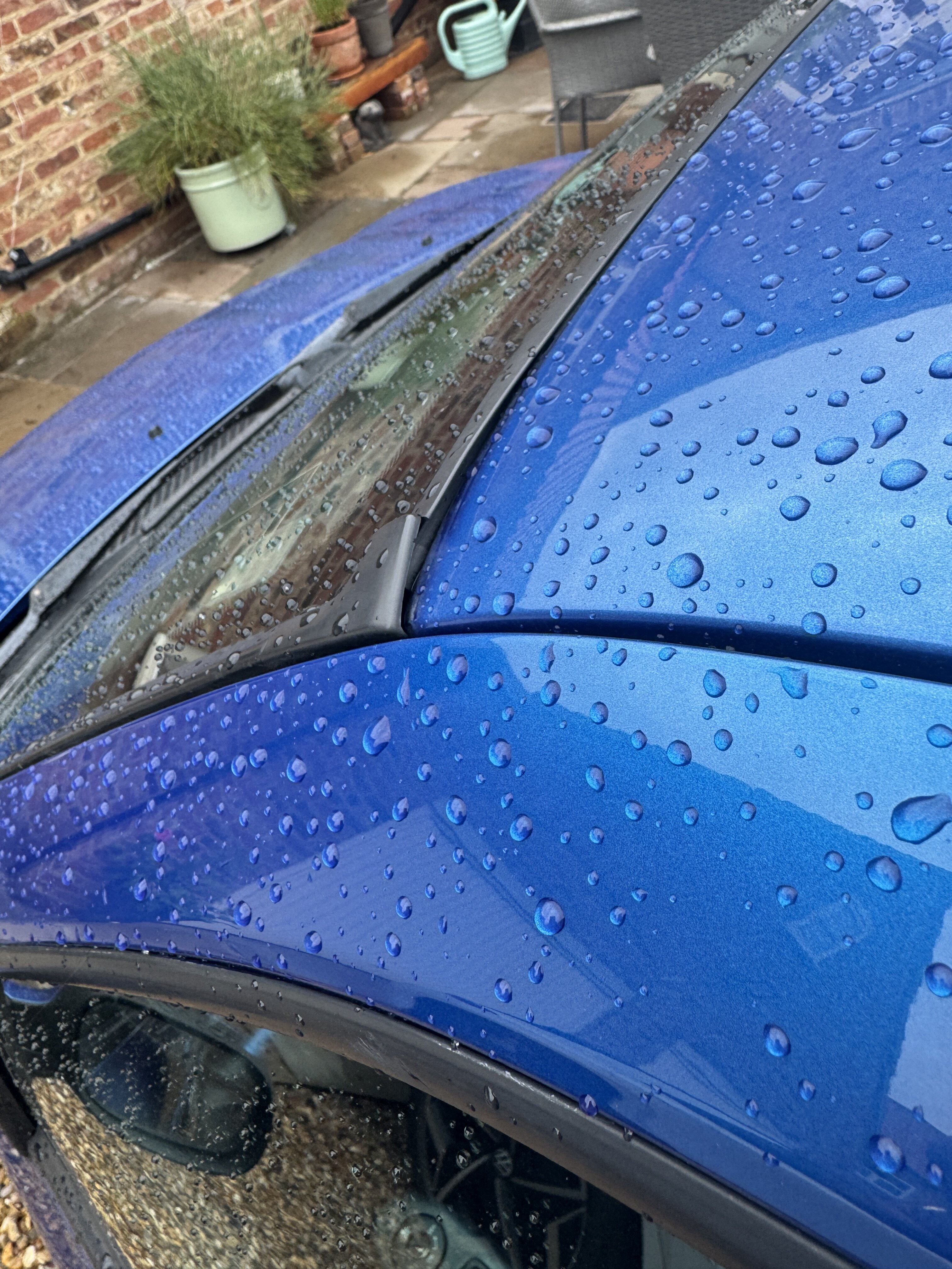

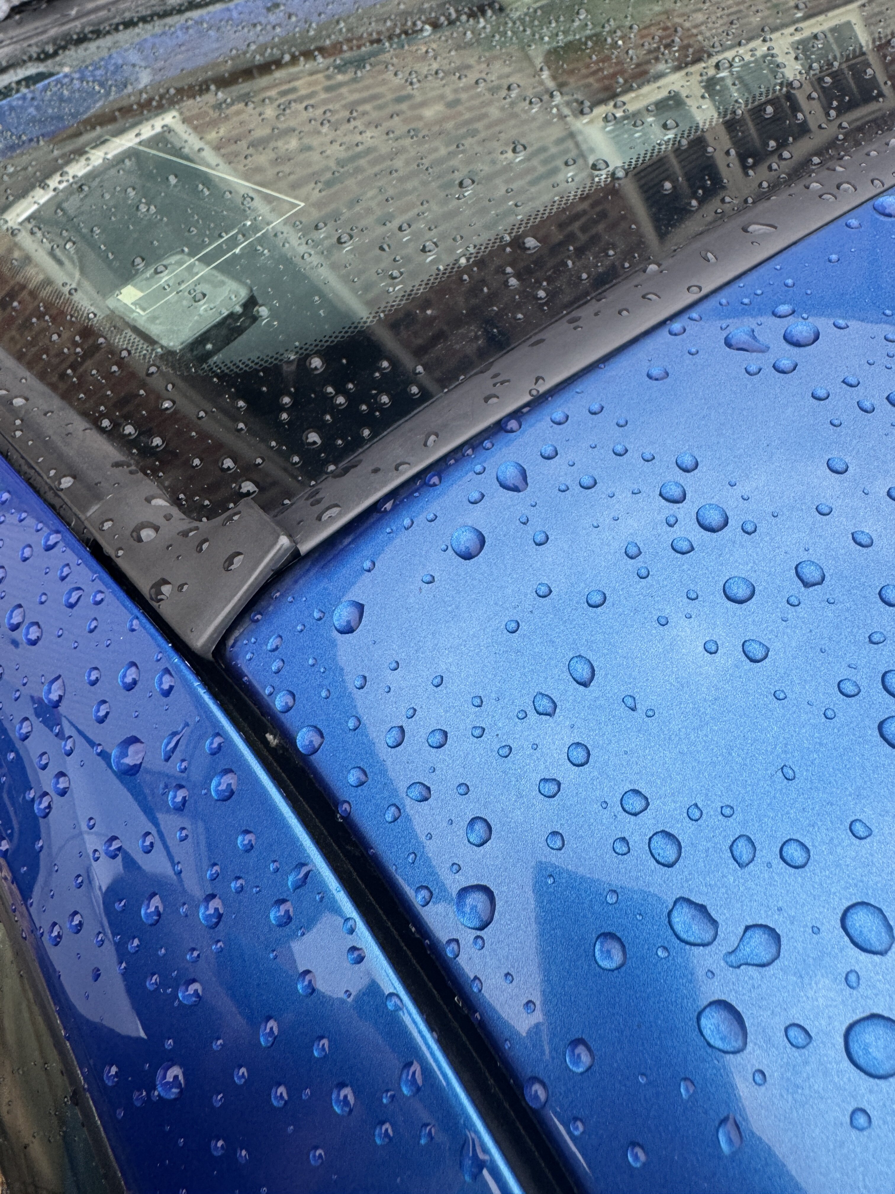

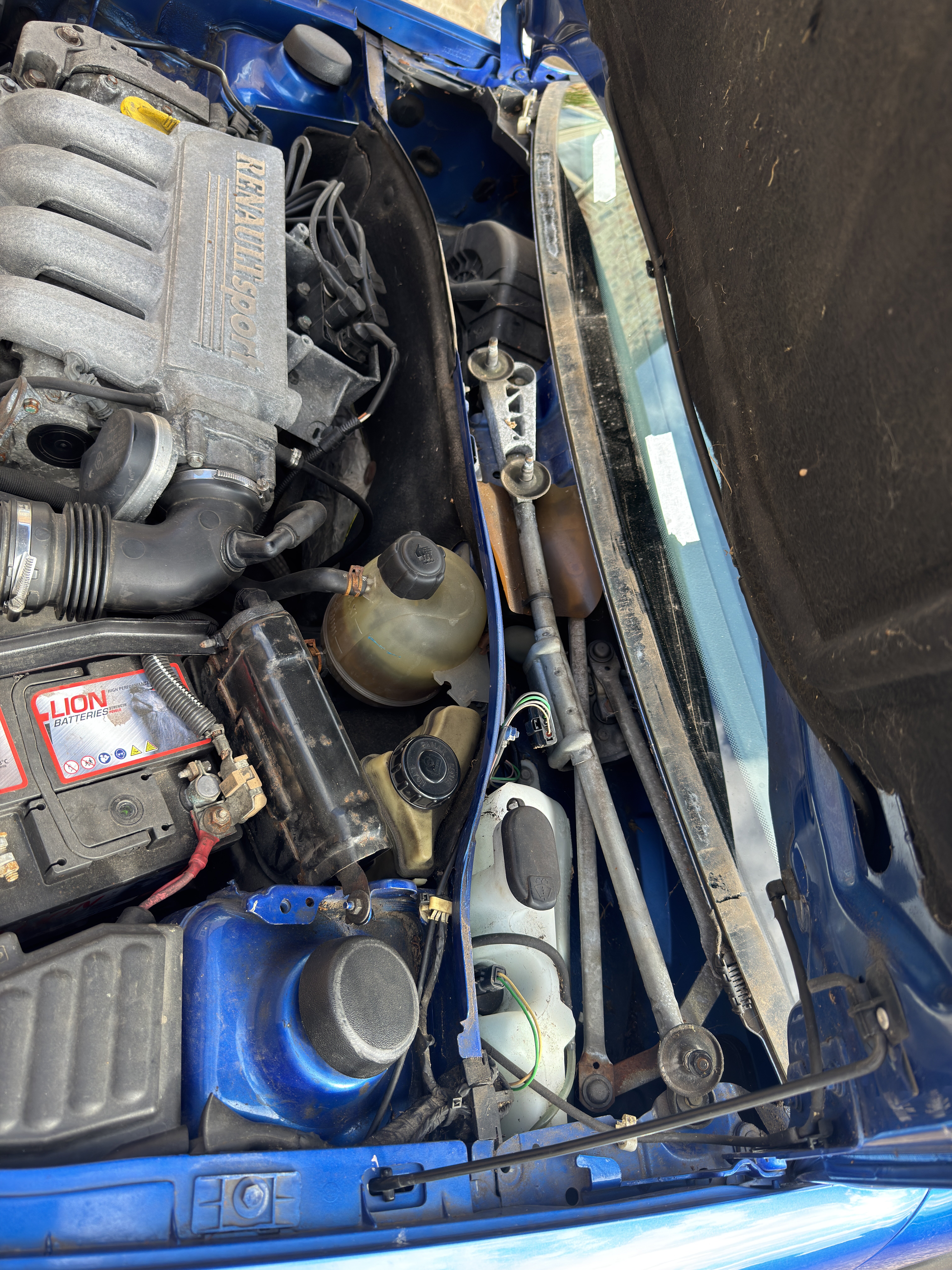

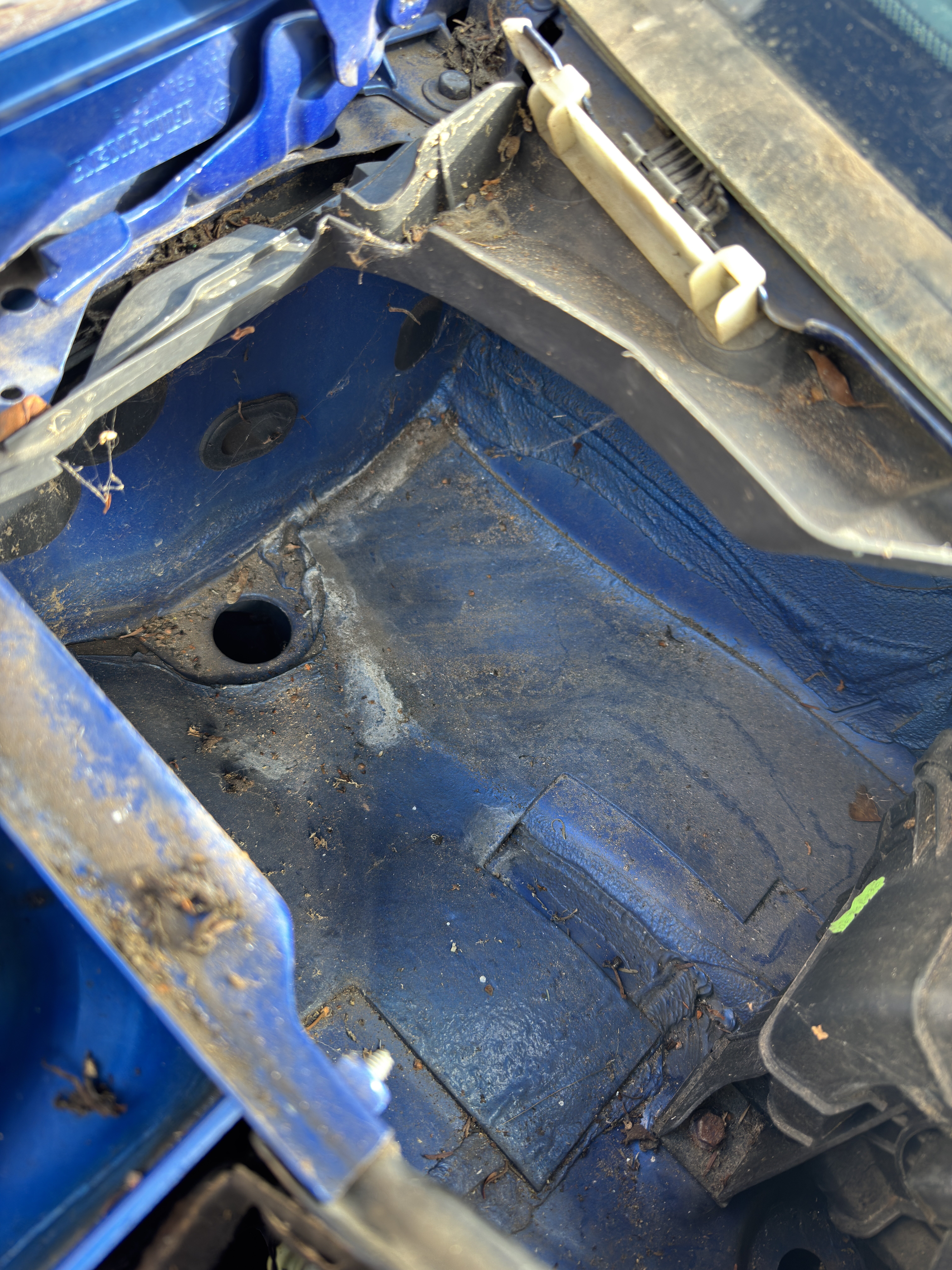

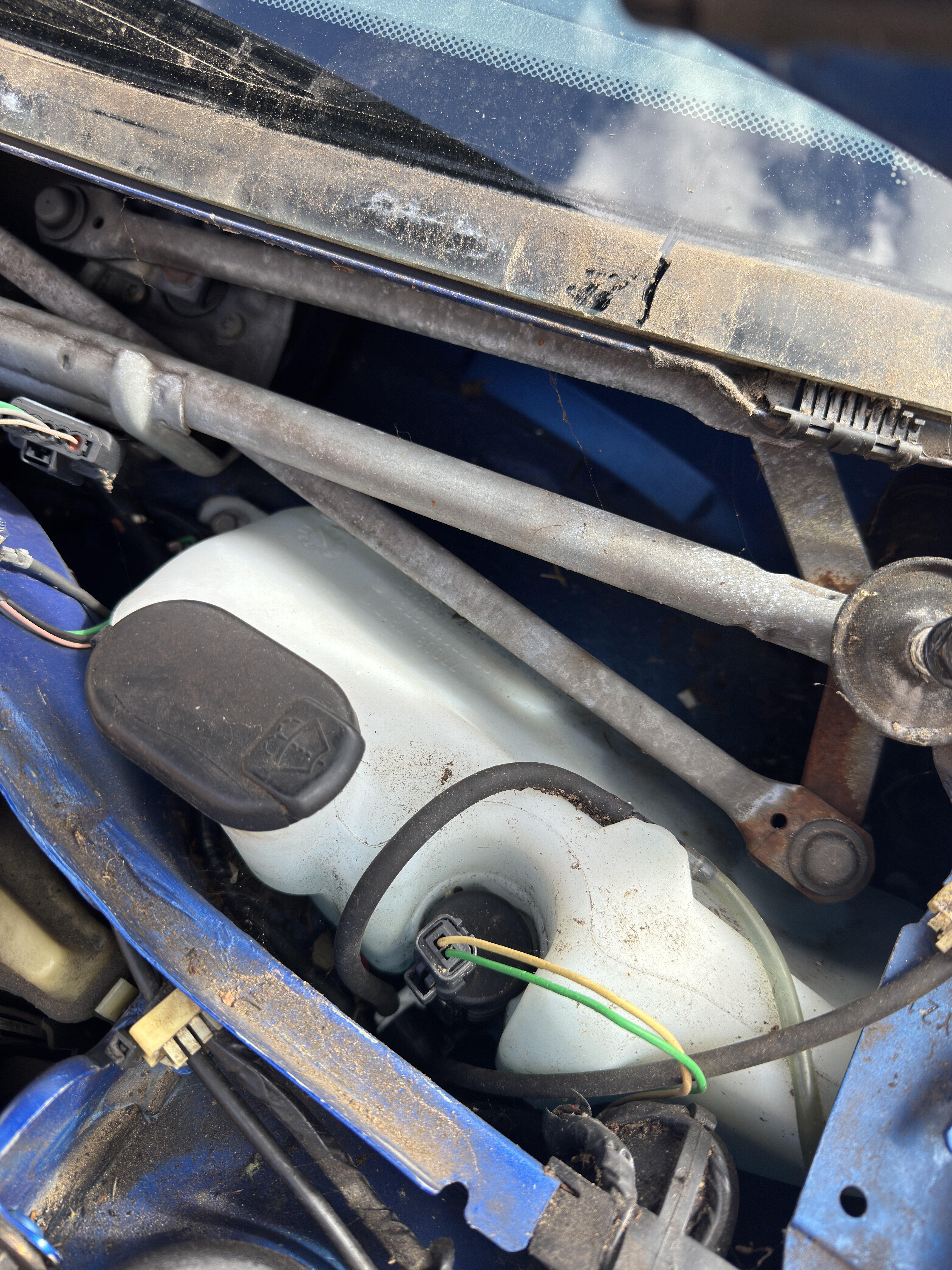

After the disappointment of not being able to fix the Exige I thought Id turn my attention to the Clio. Might as well have two cars off the road ...

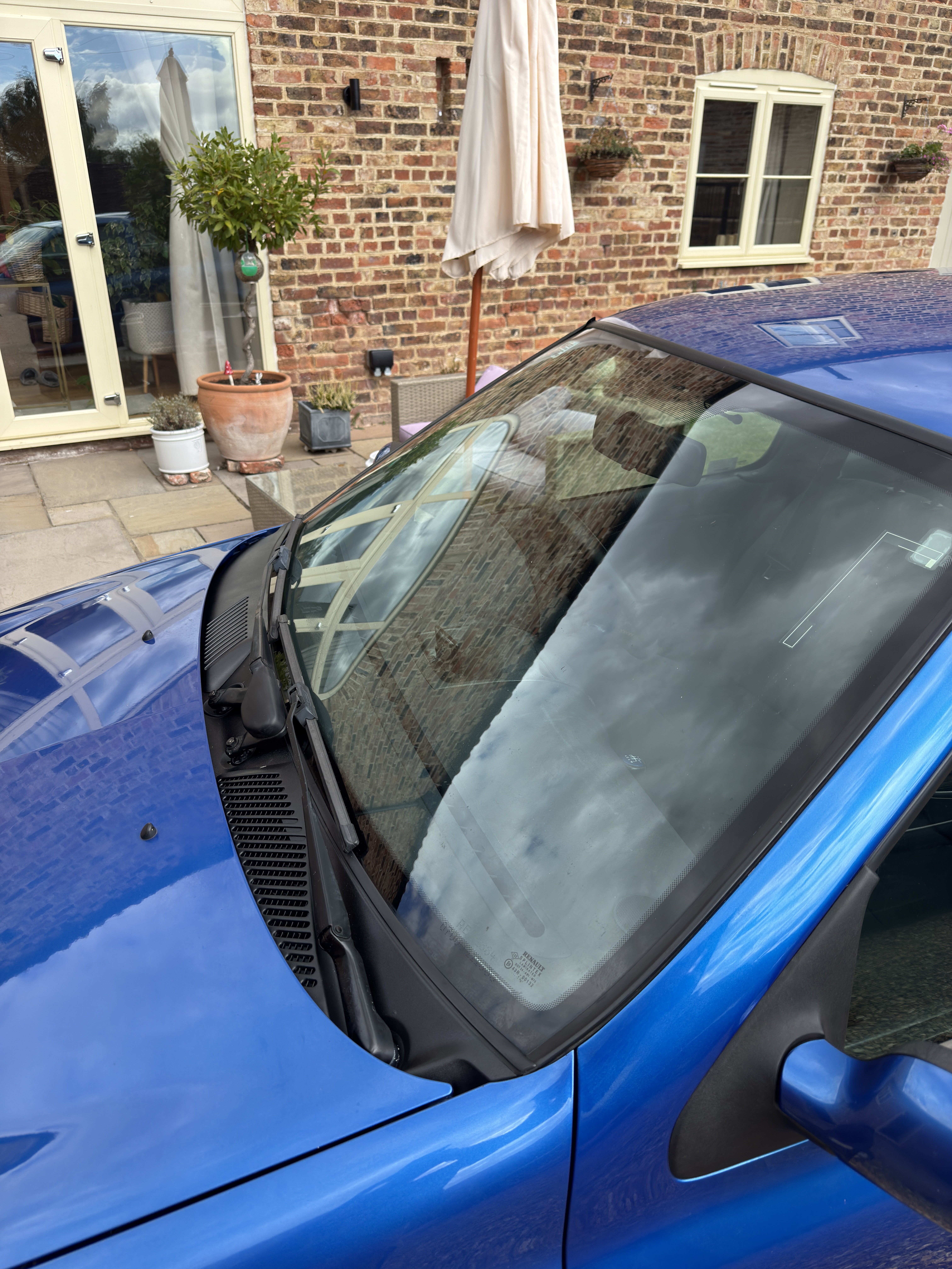

I wanted to paint the scuttle cover plastics and check that I had no nasties underneath it so I bought a wiper puller. Good job too! They were solid!
Fortunately other than a few spiders webs everything looked ok. There looked like some surface rust but after a gentle persuasion with an old toothbrush the muck came off.
Quick rattle can with some black and put everything back together again.
I need to do the front grille as well , but that's for another time

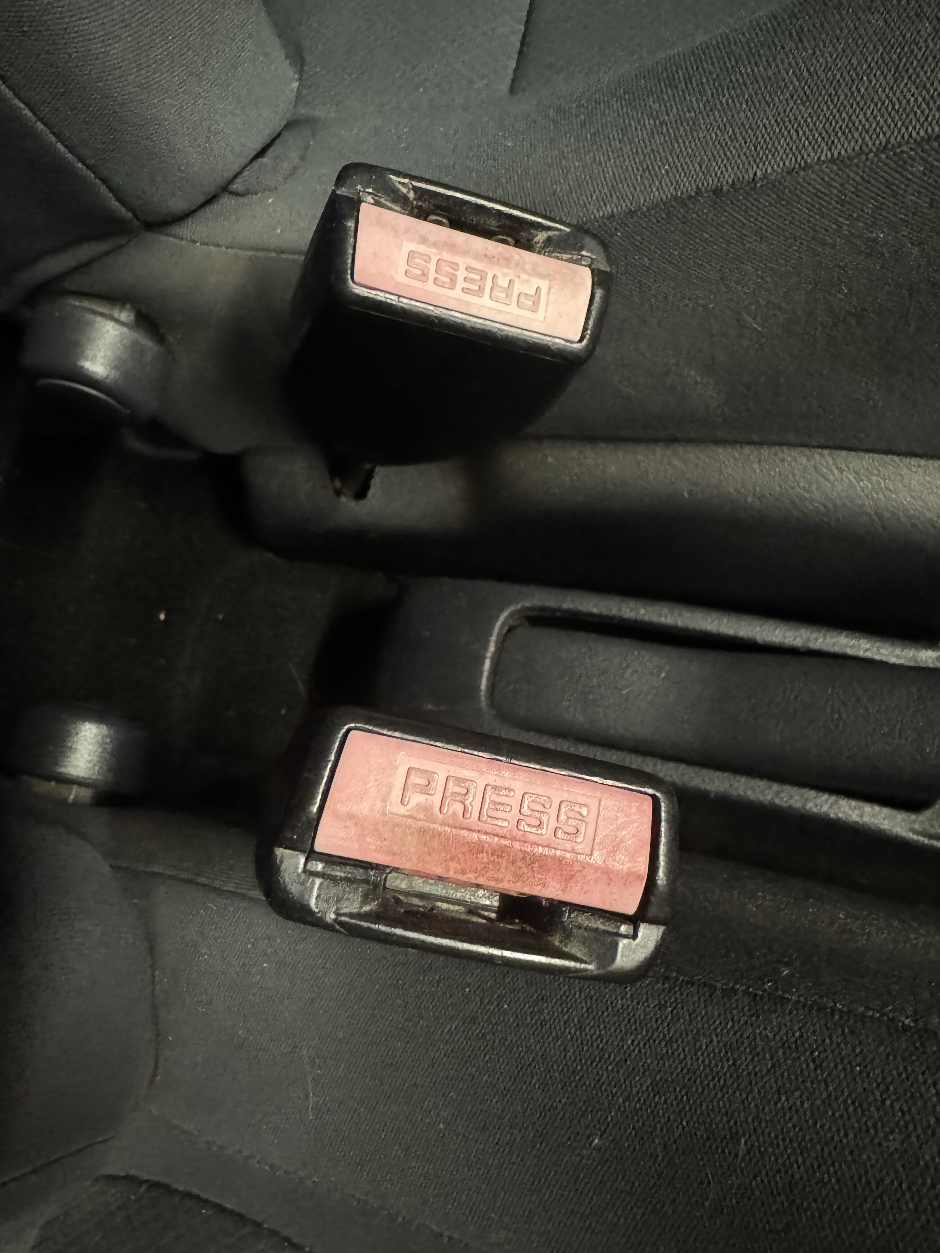

Any tips for getting the red colour back into the seatbelts?

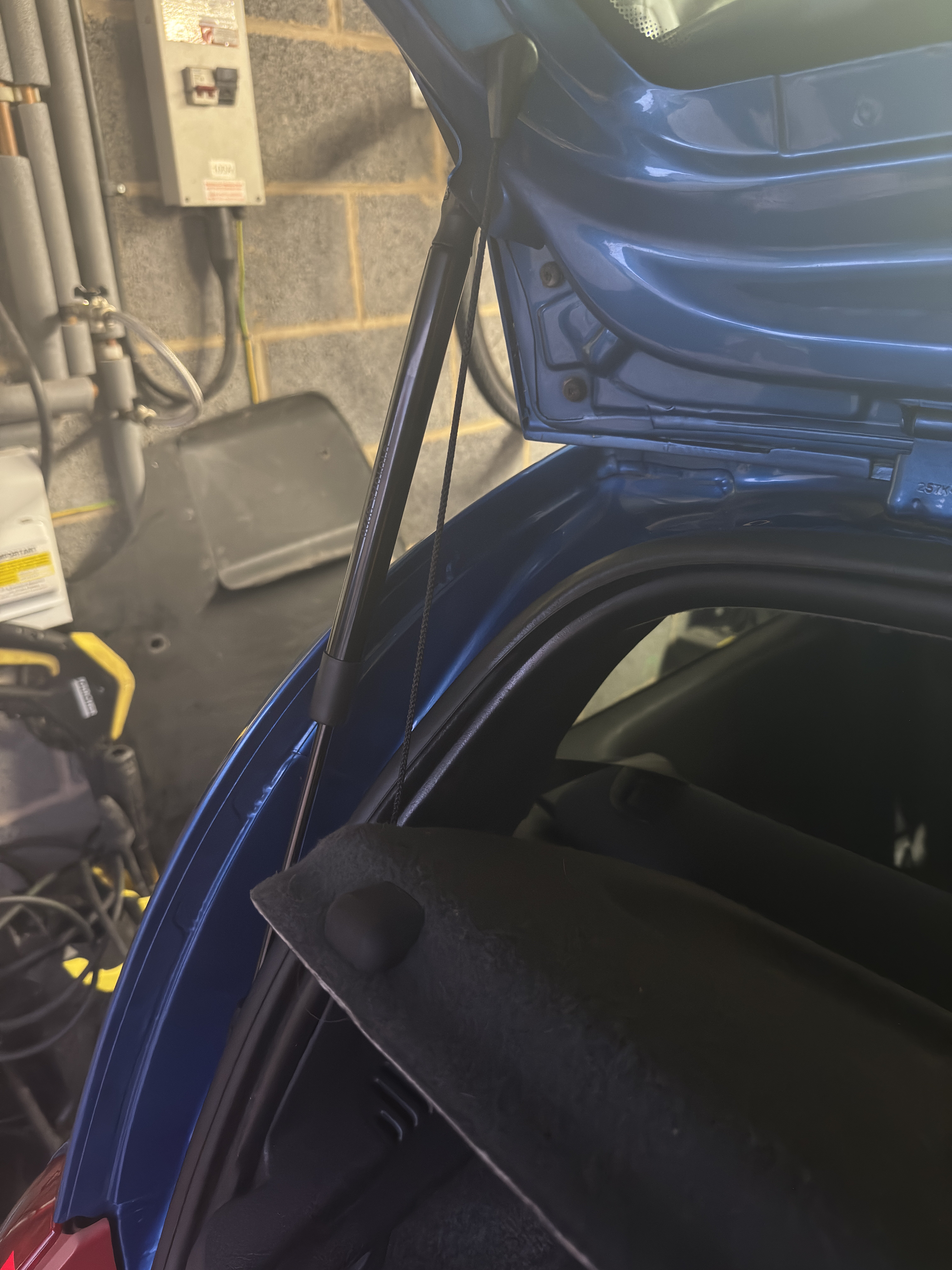

My boot was opening slowly and slamming shut.
Cue two new struts being purchased and the boot trying to eat me when I took one off.
Both new struts fitted now. I have to take care not to get uppercut by the boot on the way up and can pull up on the handle on the way down. :cool:

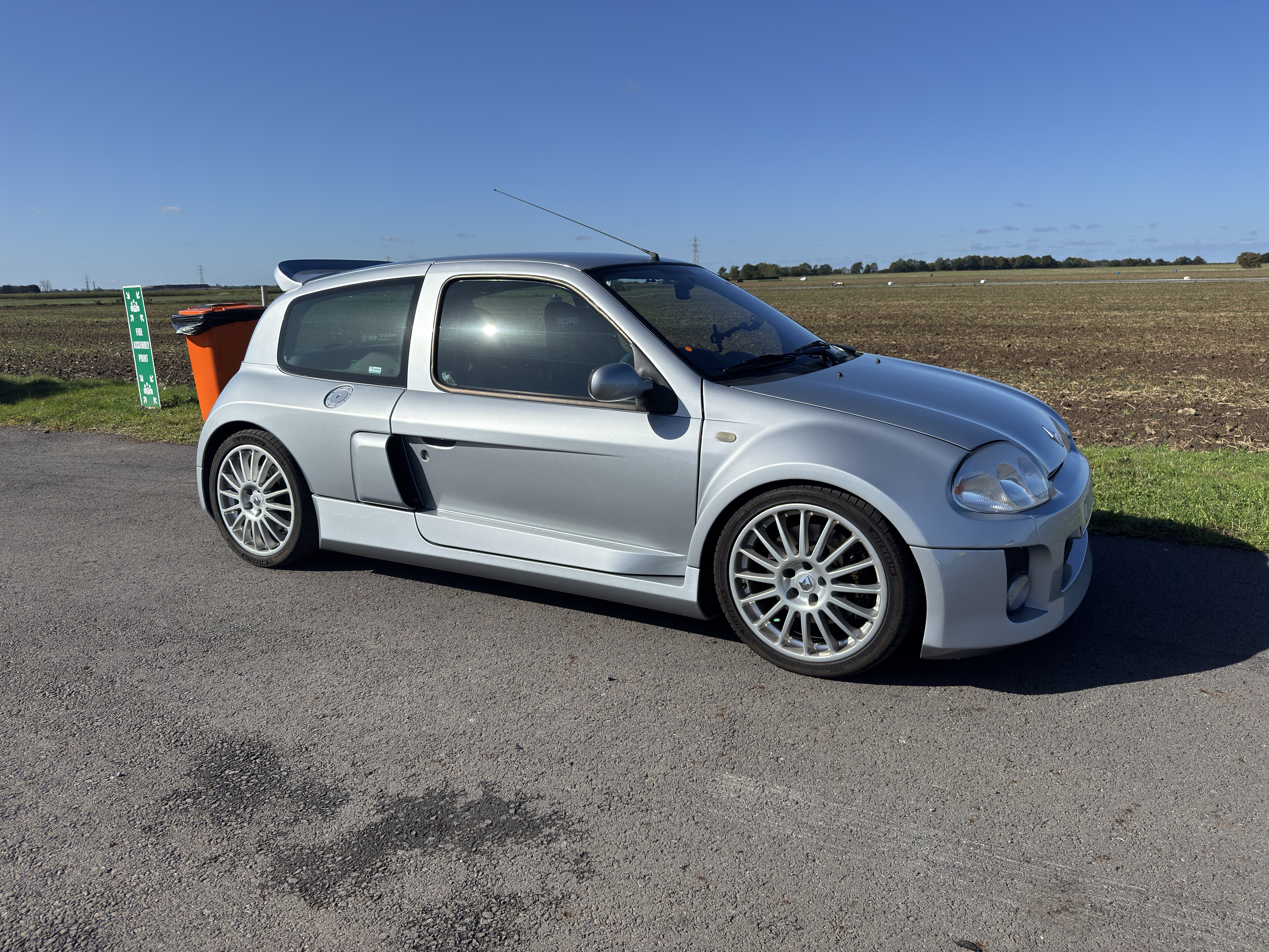

Always been curious how a V6 compares. Due to a very generous long time friend I am finding out ..
I have drive it around 125mi so far. Mainly from Midlands to Chez Bond.
Couple of comparisons I have noted between the V6 and the cup.
Power delivery is miles different. Its to be expected between a 3.0 V6 and a 2.0 4 banger
Vee isnt a lot faster in a straight line. Due to the respect I have for the car and owner I am not going to go full send ( hold my beer ) with the Vee in the bends.
Looking forward in the Vee its a phase 1 , 172. Nothing more. Nothing less
The V6 sounds epic when pressing on.
The OEM suspension is miles more compliant on rough road surfaces
The amount of looks the vee gets is bonkers.

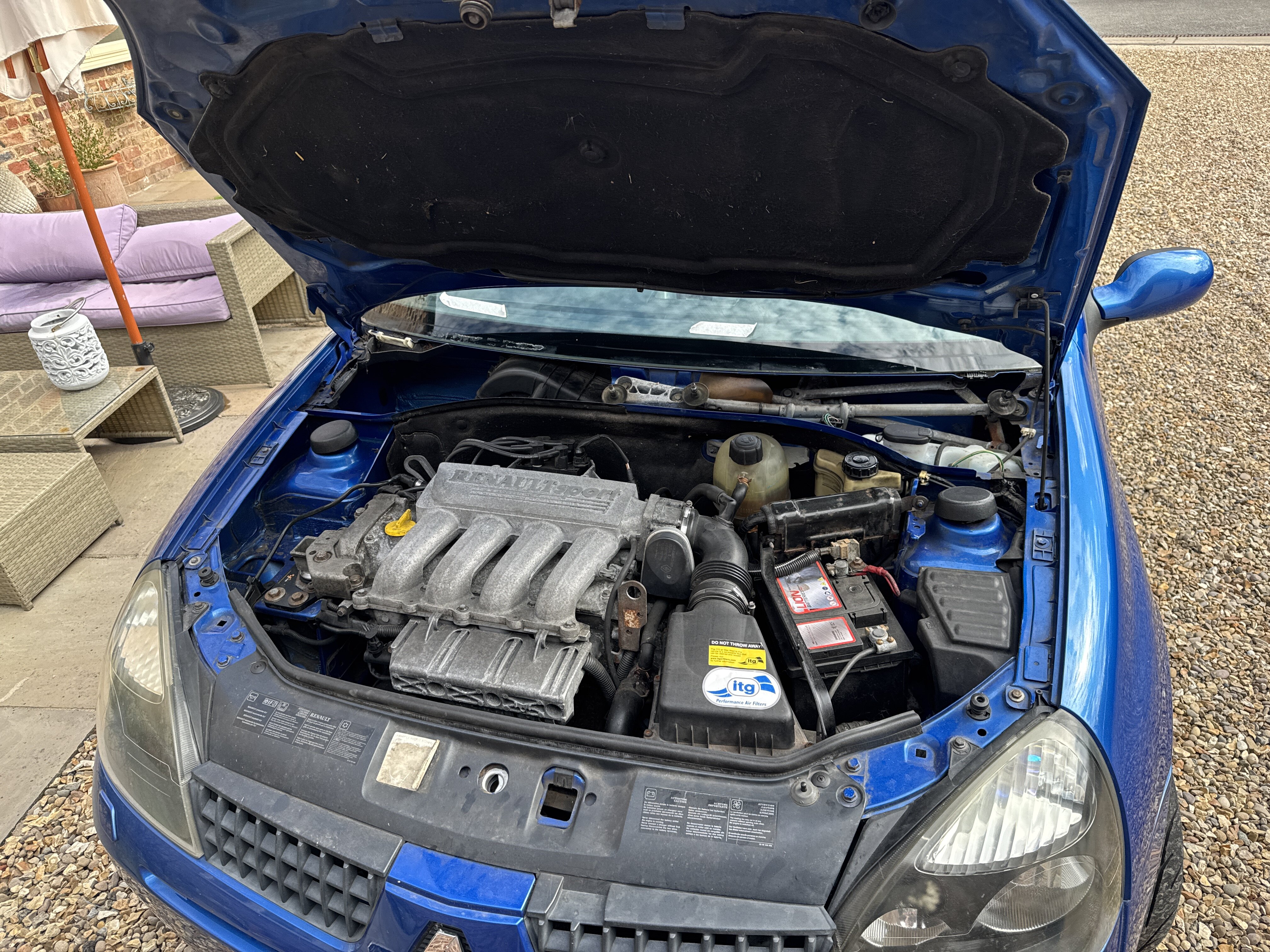

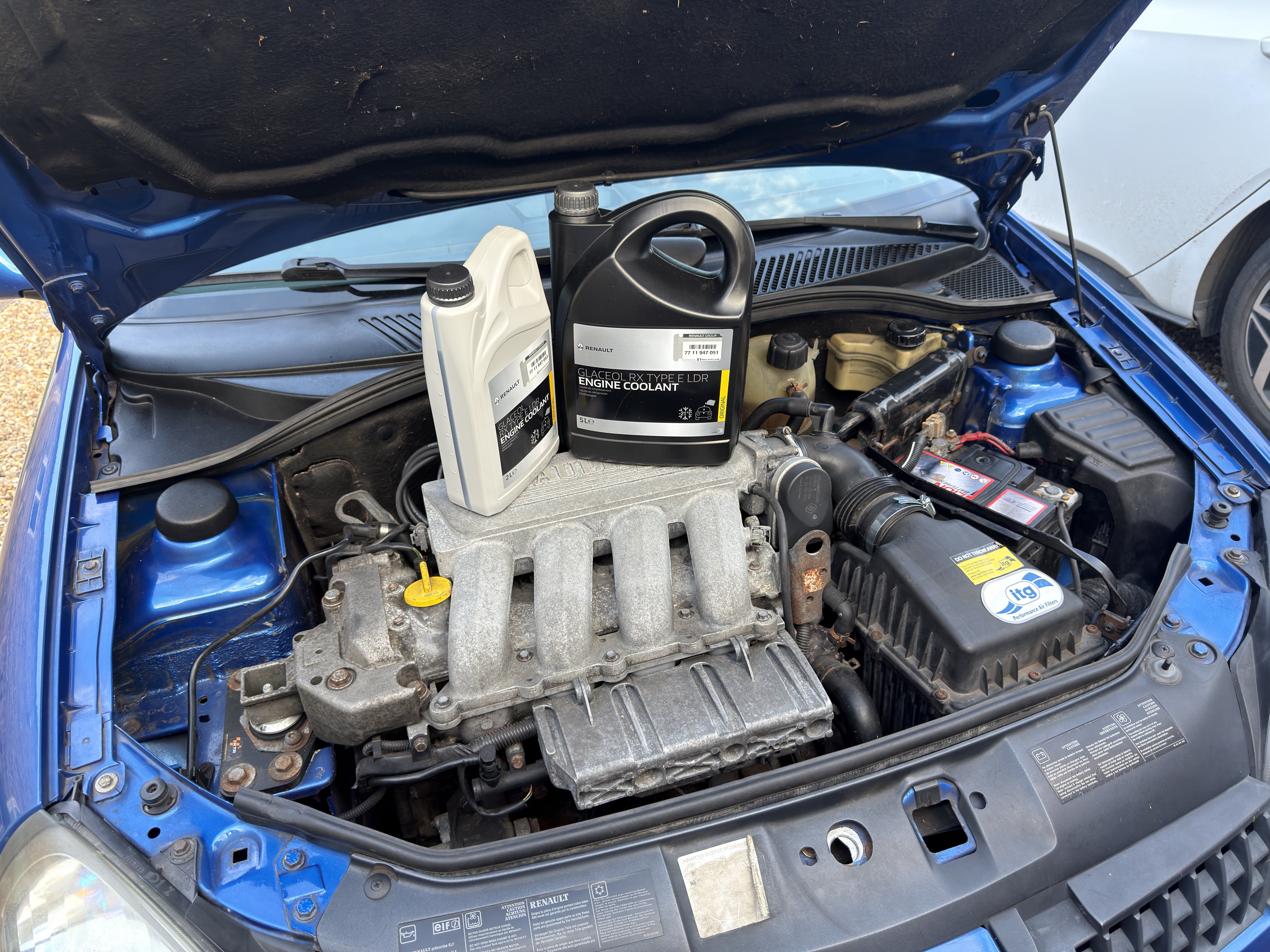

In tonight's episode of I did a thing :

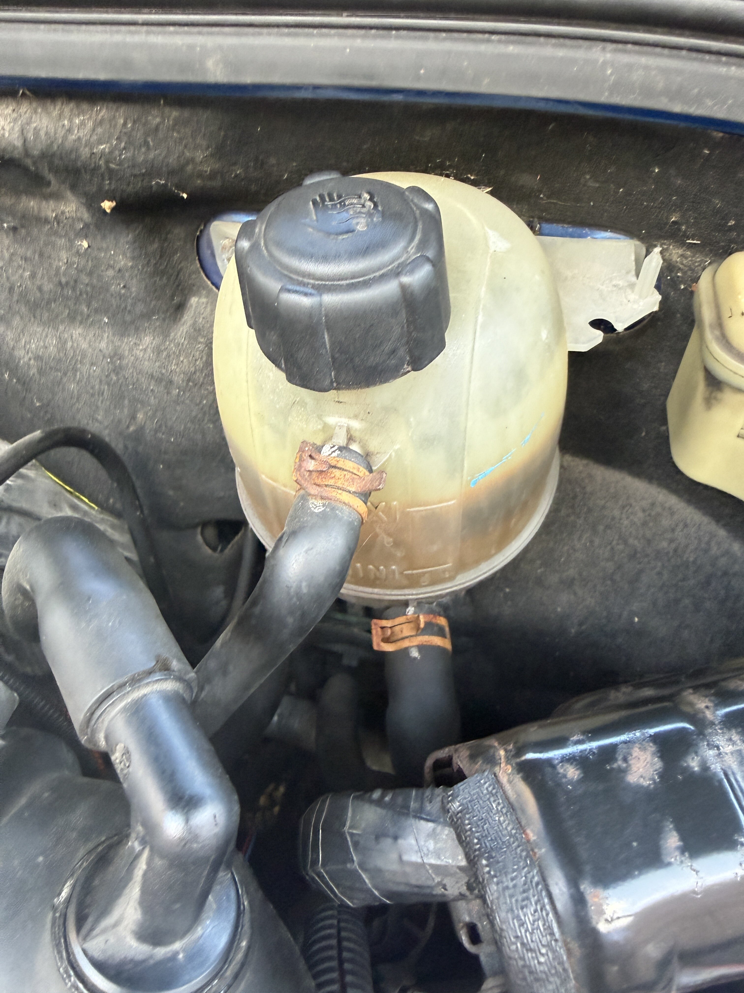

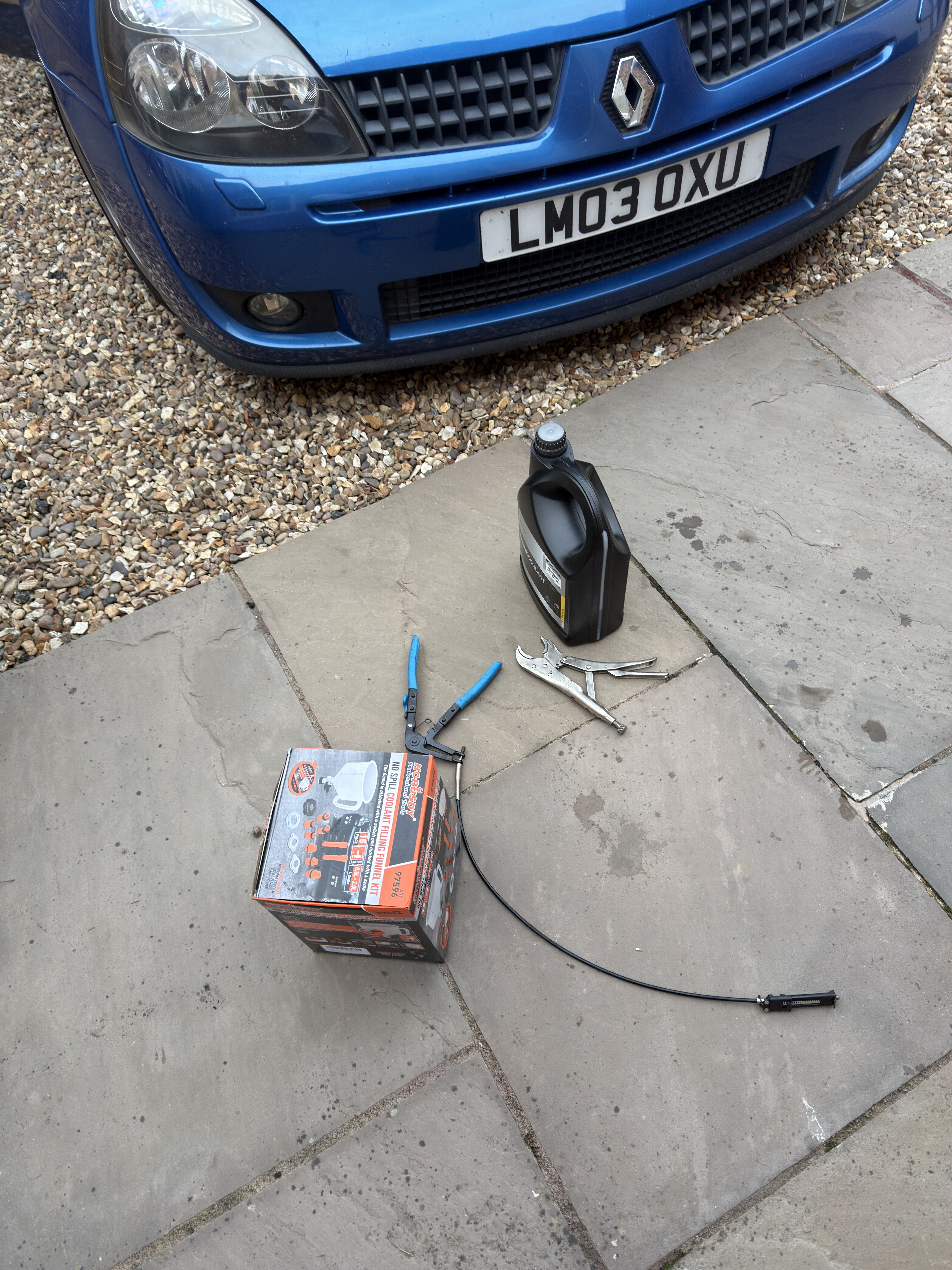

I noted that my coolant was looking a little worse for wear. It was sort of mucky , rusty brown.
Cue me changing the coolant over. I got one of the remote clip things from amazon , undid the bottom hose. Undid the pipe from thermostate to top hose and let the water flow out. Then I didn't use the hosepipe to flush back and forward until clear water came out of every pipe.
I filled it back up using the type D replacement , type E. Its not got the great colour any longer but hey ho. Hopefully it wont be seen.
Bled the system with the thermostat bleed point after taking off the airbox , that requires the throttle body to come off and hot air from the blowers.

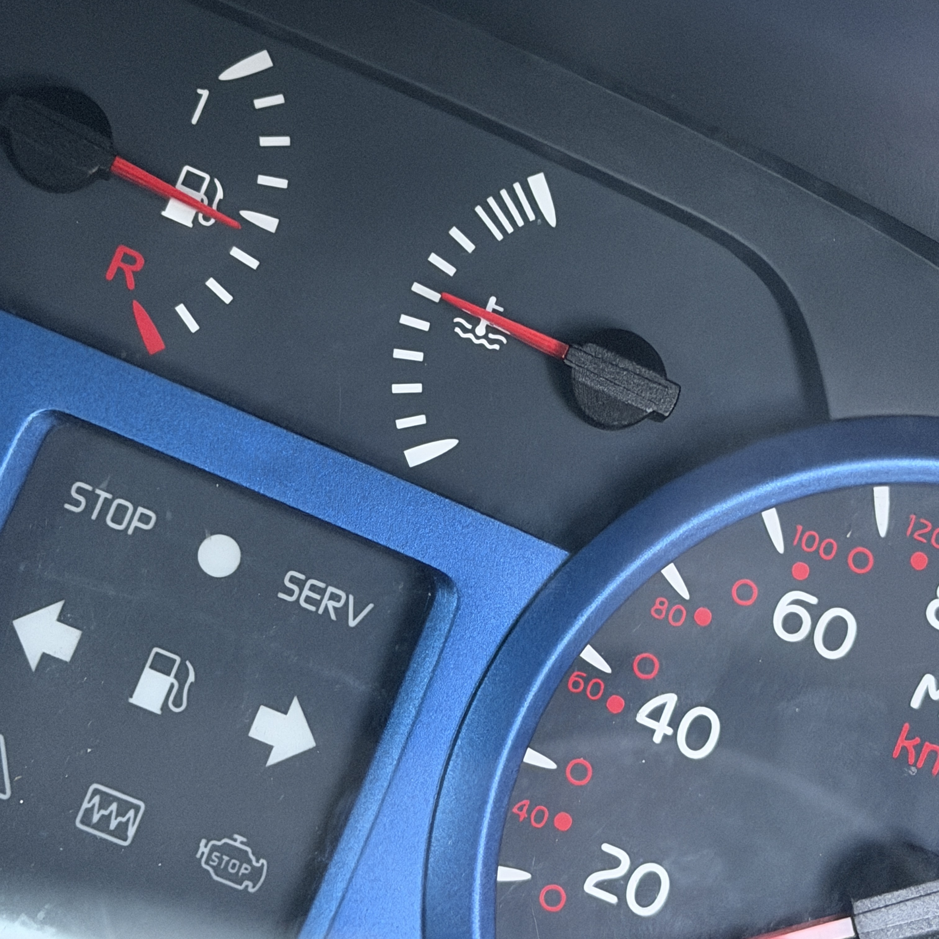

Solid temp line right where it was before.
Brown
Renault coolant
Few tools ( owner not pictured )
Temperature solid

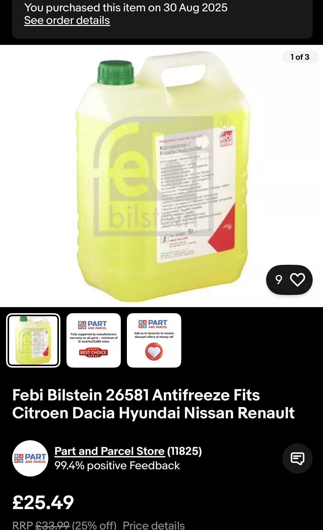

I bought this to retain the luminous yellow coloured coolant. I think I’ve got the new stuff in there at the moment which will be getting replaced next year.
