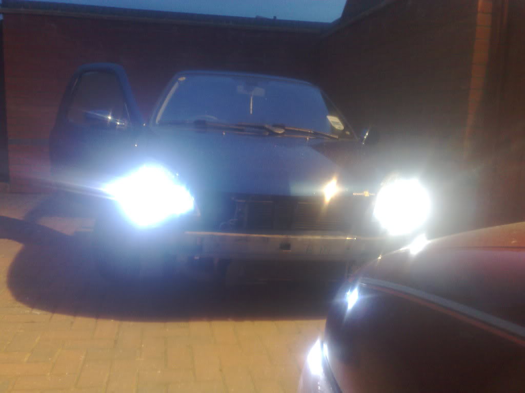

Me and my friend did a HID Conversion on my 1.2 campus years ago, and i'm 99% sure that you would need the bonnet up to be able to remove the bumper.
