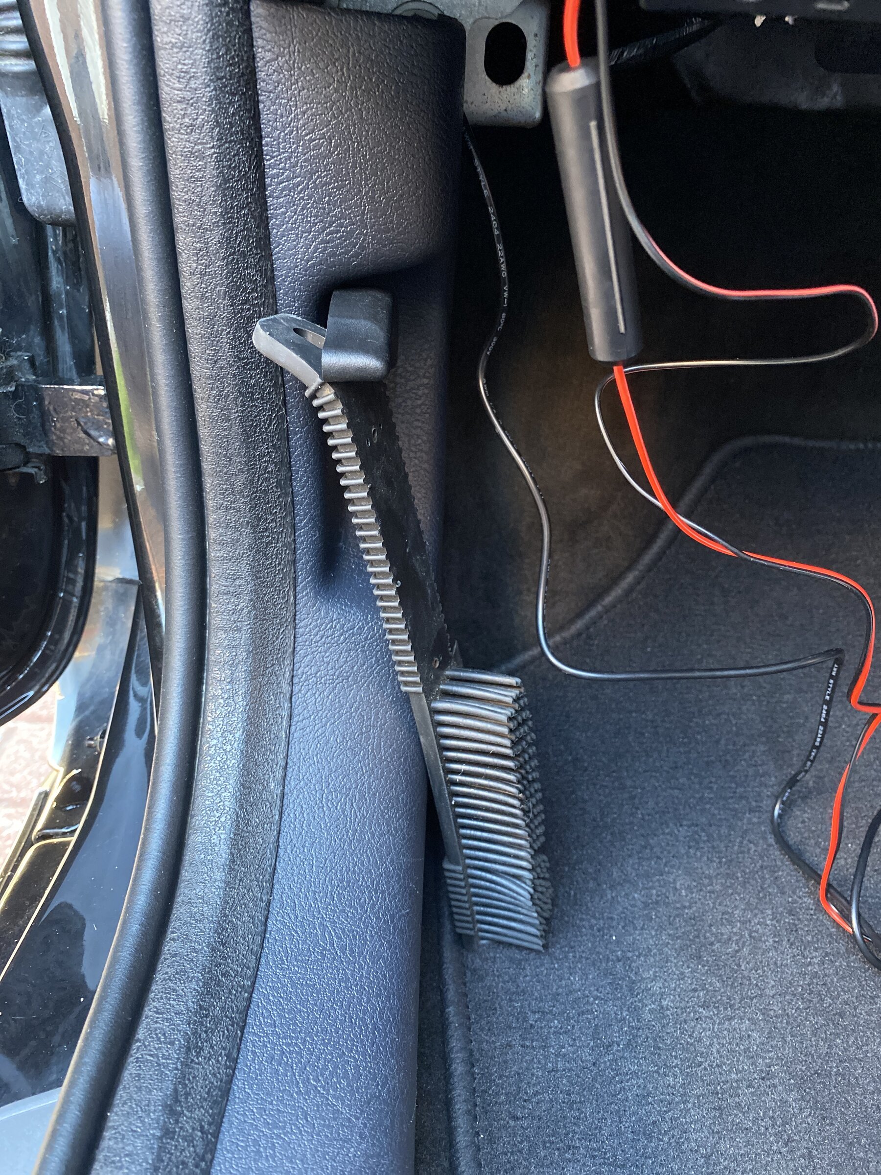

This happened to me today, from reading the above comments I managed to find a quick solution for the interior pull not appearing to work. Instead of using a human to hold the pull up i used a intior cleaning brush to hold it in the open postion and pull the bonnet. Replacment catch has now been order and lubbed up in meantime 😂 cheers for the tips 👌
