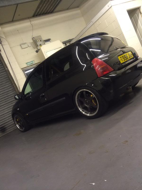

So lets rewind back to 2012, mapping of the car had gone very well and I was pleased with the results, had no major issues with the car, so I decided to book a track day, so a few touches were needed, had the camber and castor setup and also bought a mocal oil cooler with a thermostat plate.
All was fine on the track, apart from cooking the brakes so this was on the list to get right, anyway the car was running fine for the next year, so I just enjoyed driving it as much as I could, then at the end of 2013 the gearbox decided to s**t itself so I tucked it up for winter and left it, then just after the new year, the company I worked for closed down and we all lost our jobs (it happens) so the car didn't get touched for a while.

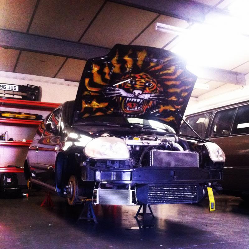

Show seson was coming around fast, and I really wanted to make a few shows so the late nights began, and a set of brembos popped up which were silly cheap, after a little research and people saying its too much effort etc, I bought the brembos, and trial fitted them.

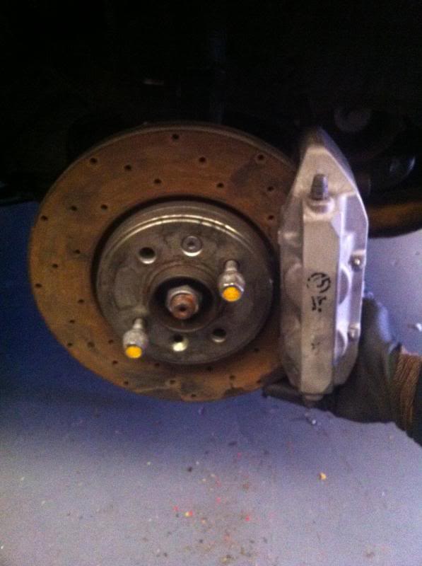

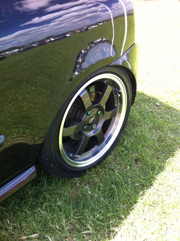

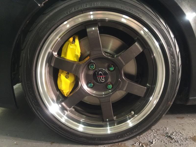

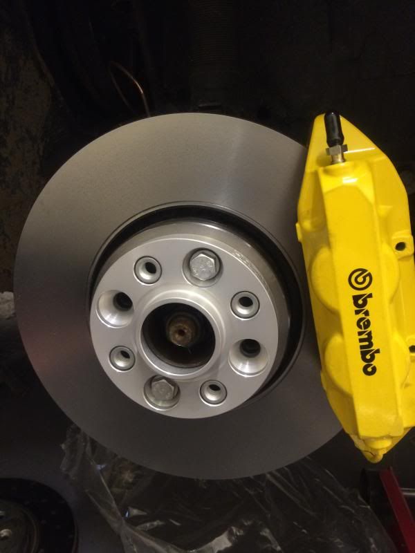

I Wanted to run bigger discs and also it was an excuse for some new wheels, as Ive had the turbines for years now, so I sold the turbines, and started looking for new wheels. By this time I had already ordered 300mm discs, new pads, new fitting kit, and a set of hubcentric spacers.
Then it was onto the brackets to fit the calipers after not finding much help anywhere, my friend who is into his Renaults knew a bloke who knew a bloke and we got a trial set of brackets made up, and they were perfect. so we got them fitted to the hubs.

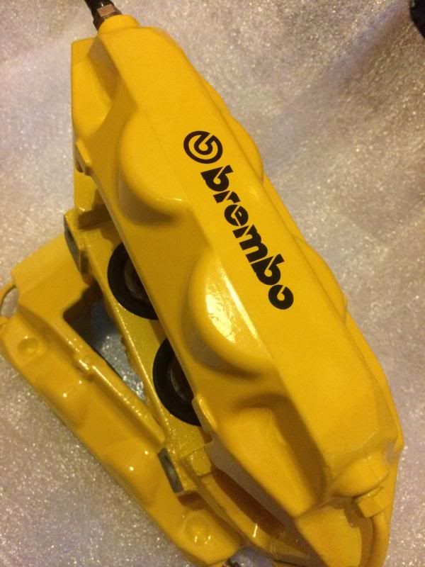

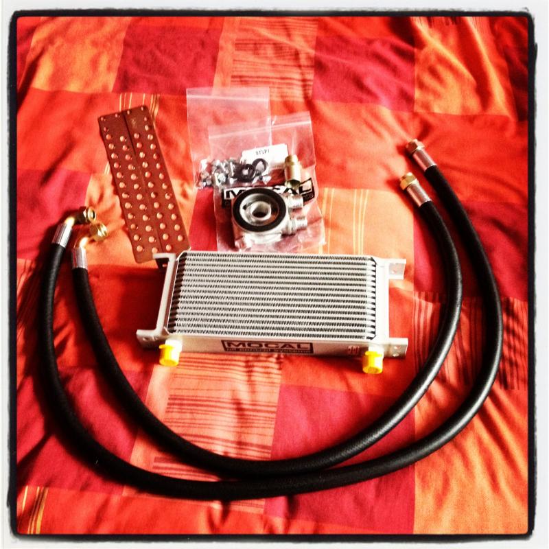

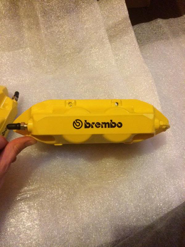

Now because brakes are important I decided to get the calipers professionally rebuilt with new pistons seals etc and a powdercoated.

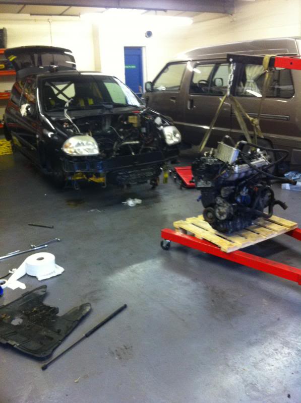

While I was waiting for them to be sent back to me I removed the engine to replace the gearbox, and also fix an oil leak and to replaced the fuel lines, and also service the engine.

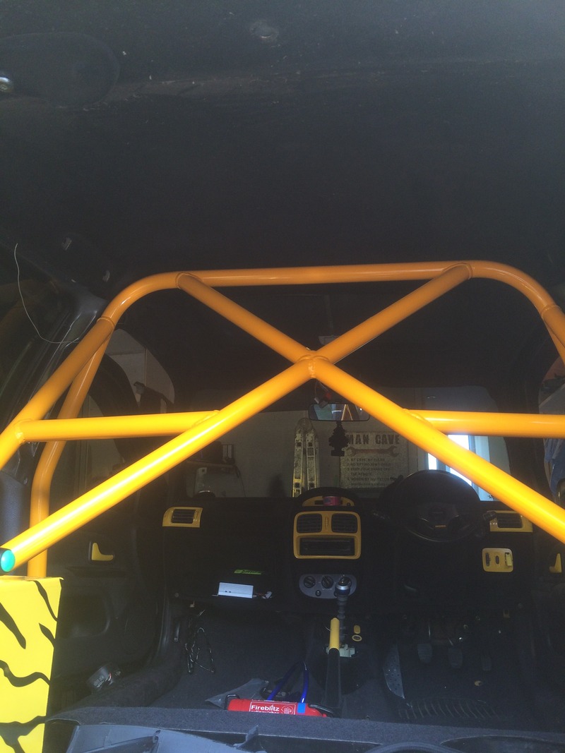

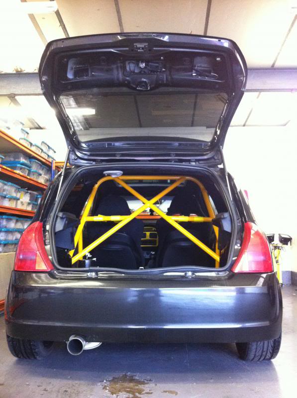

All that done, engine went back in, and new wheels arrived as well, heres a cheeky shot of cage fitted too.

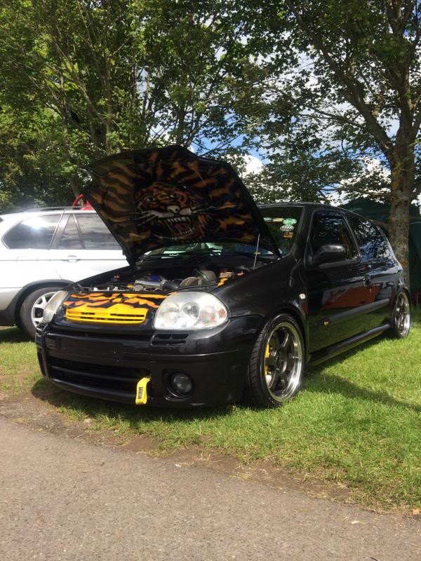

So modified nationals was only a day away, and the calipers were still back from refurb, so I just ran the old brakes, and new wheels, also gave it a full paint correction and detail.
Shot from modified nationals 14
A week later the calipers were back, so I made new brake lines and got them fitted, and what a better way to bed them in than going to fcs14
Ready for FCS 14
At FCS 14 in the paddocks

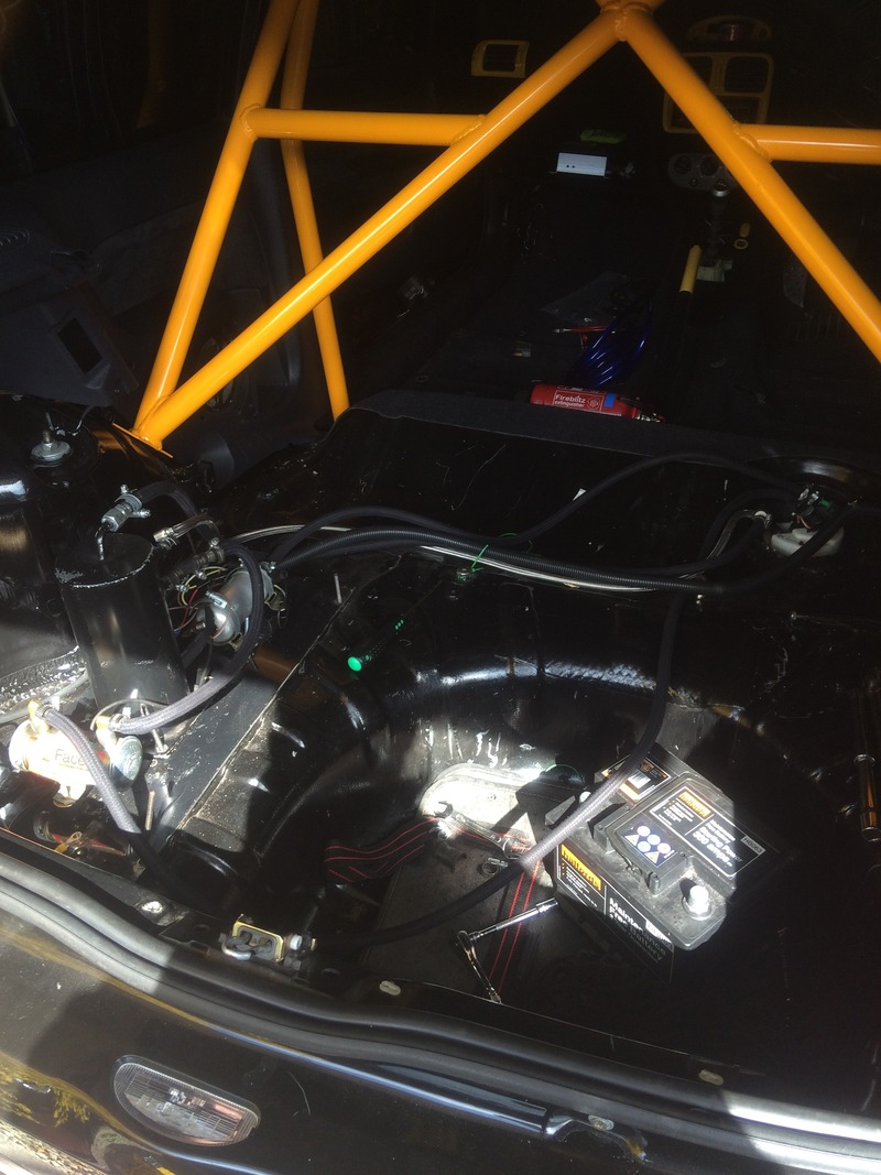

So I uncovered this today, battery is on charge as we speak, hopefully going to get it fired up this weekend, and then it will be moved into the garage where I can begin work on it again, Made a long shopping list of parts I need for it.

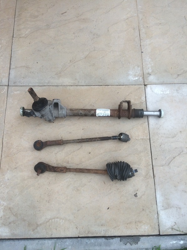

First things are a new steering rack and column, lower arm.
Then it will be onto the fuel system as im going to change my current setup.

Cheers @StuOwen86 cage was made by a chap on ebay, he does cages for fords etc too, was a while ago I bought it, Think it was around £150??
Then I got it powdercoated.

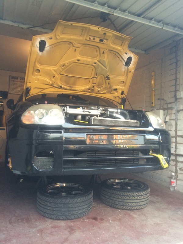

Anyway on the way I noticed a few issues which needed addressing. so I got the garage cleared out and rolled the clio in and started making a list of what I wanted to do.
Started to strip it down.

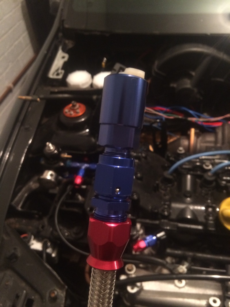

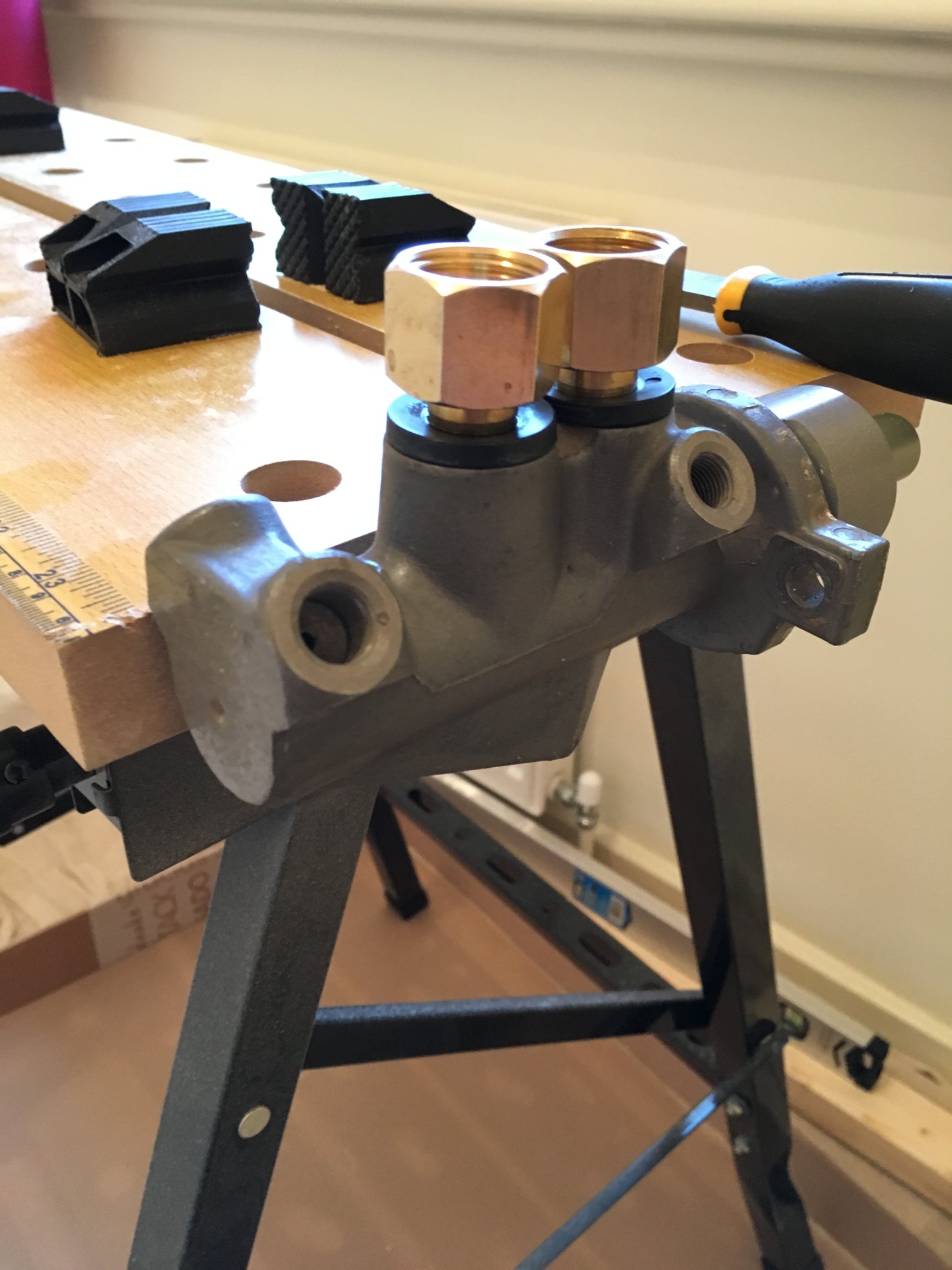

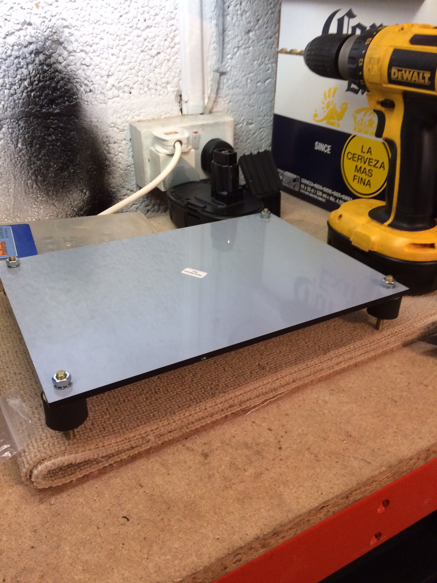

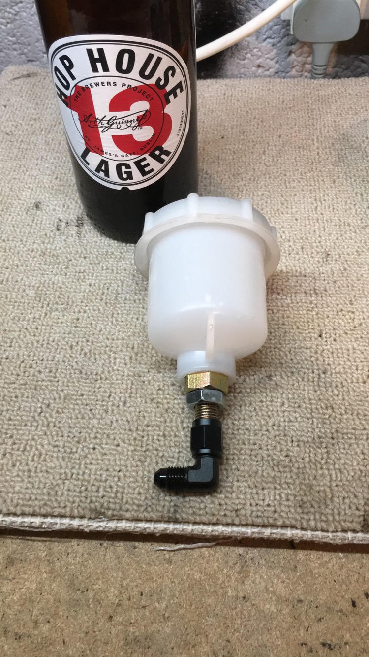

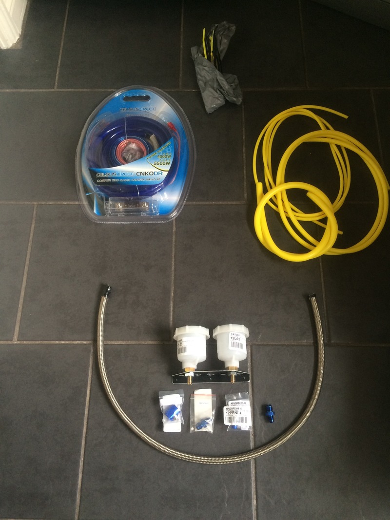

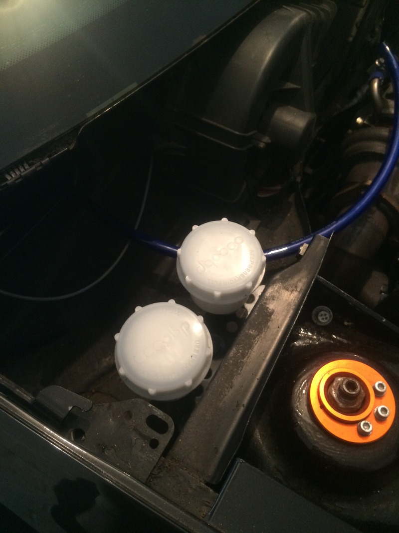

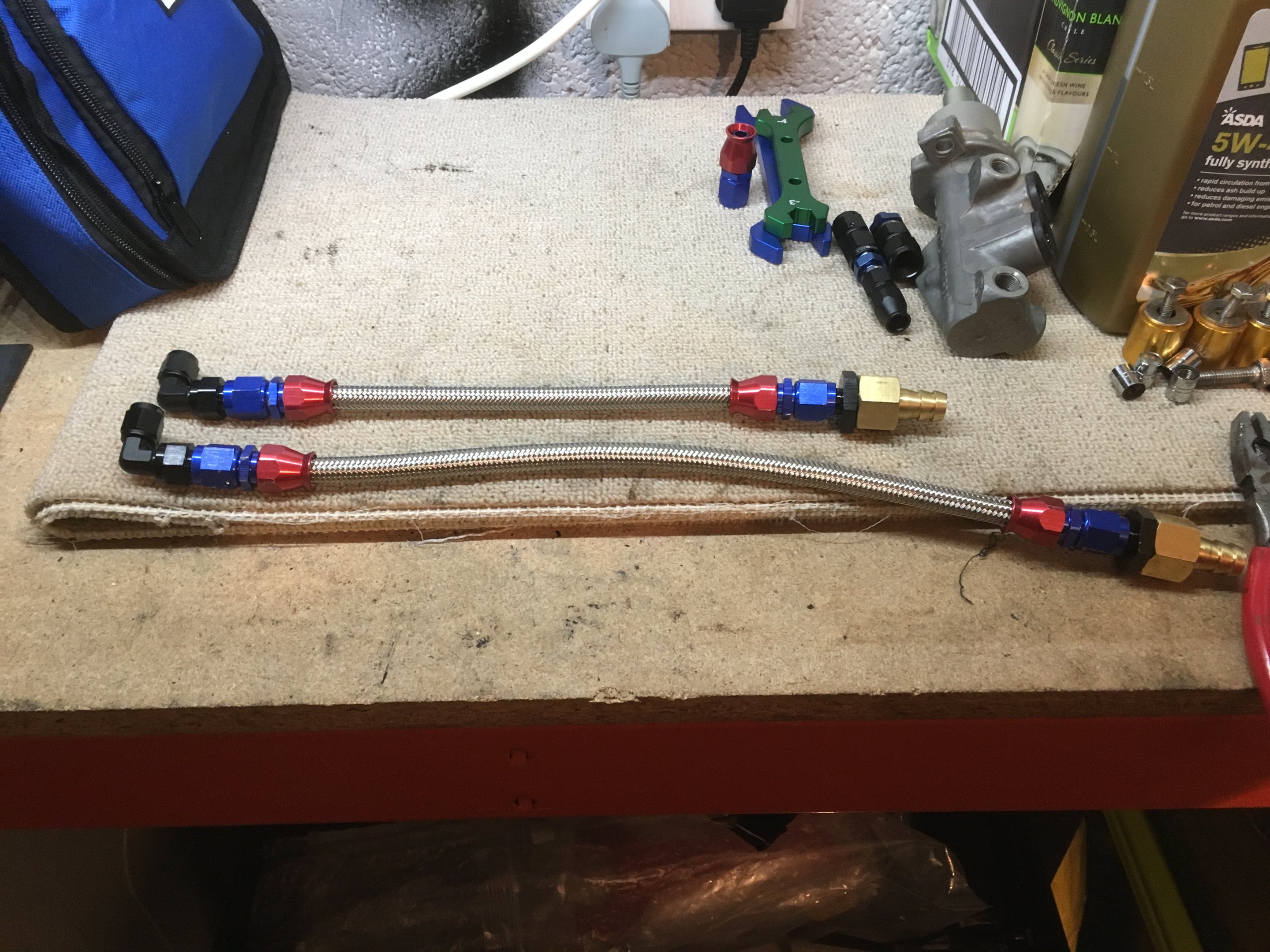

I was never really happy with the brake reservoir setup when I did the conversion, so ordered some bits to fix that, along with some yellow vacuum hoses and battery relocation kit...

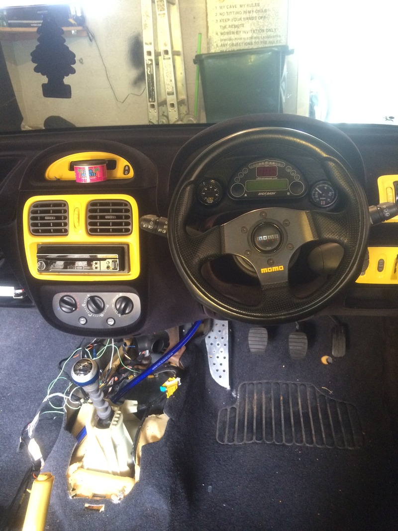

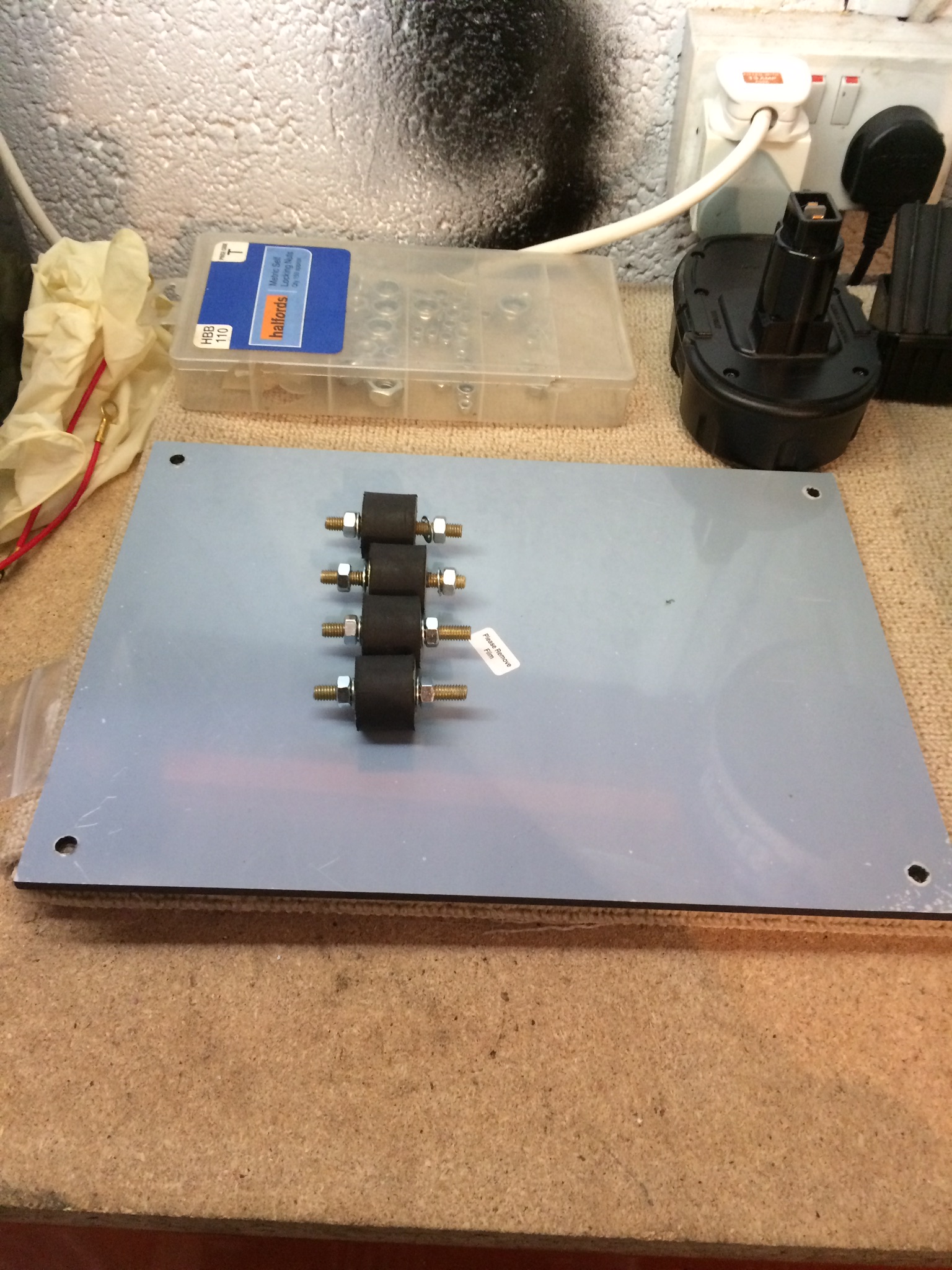

Removed the seats to start routing the new power cables.

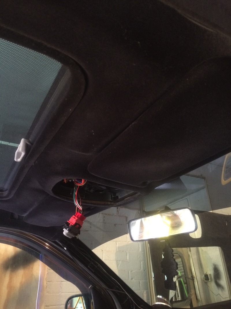

Then the rollcage came out at the same time to replace the headliner for a flocked one :)

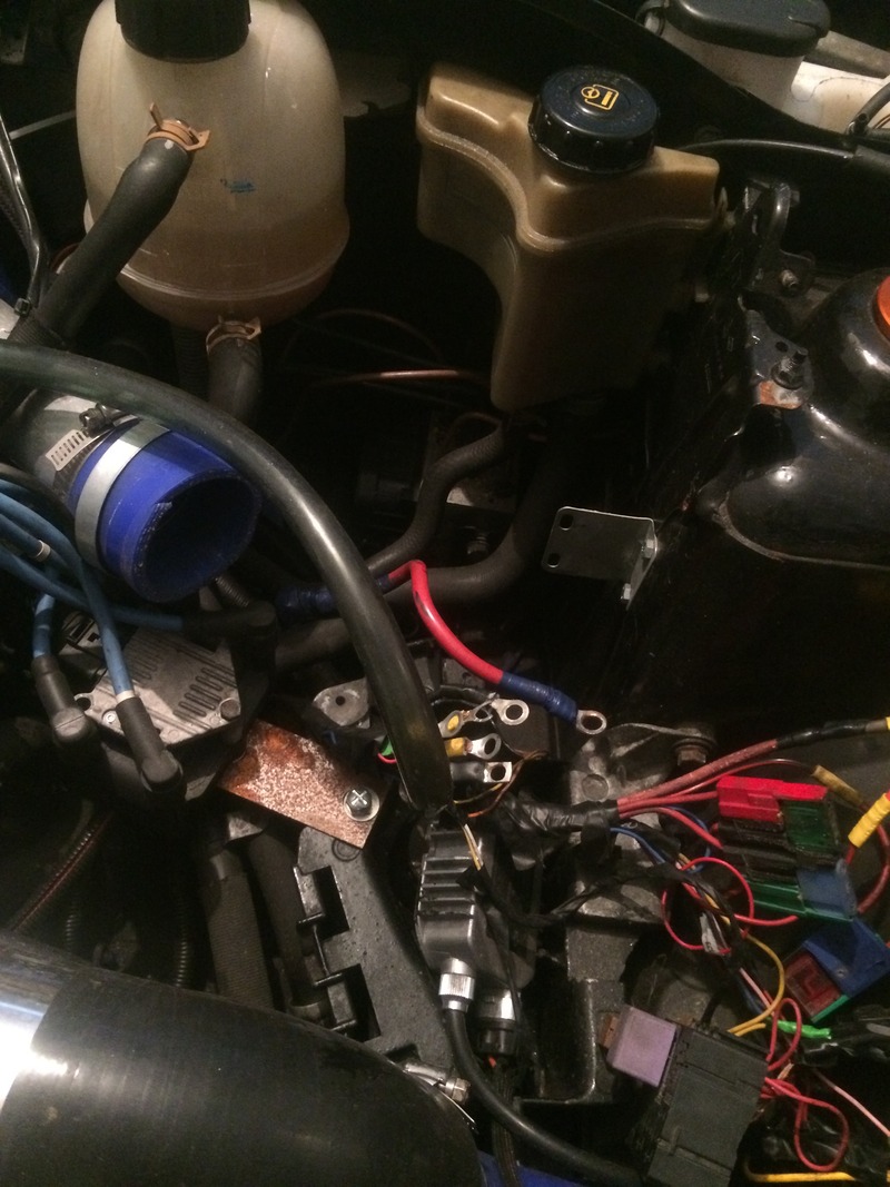

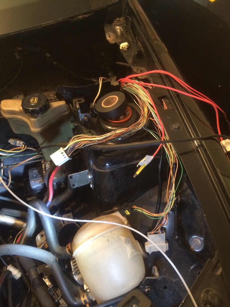

With that crossed off the list, there was a smell of fuel in the car, checked all the connections, which were fine, however the hoses had started to split, so it was time to rip them all out and buy good quality ones, so I begin taking the swirl pot, pick up pump and my 044 bosch out ready.

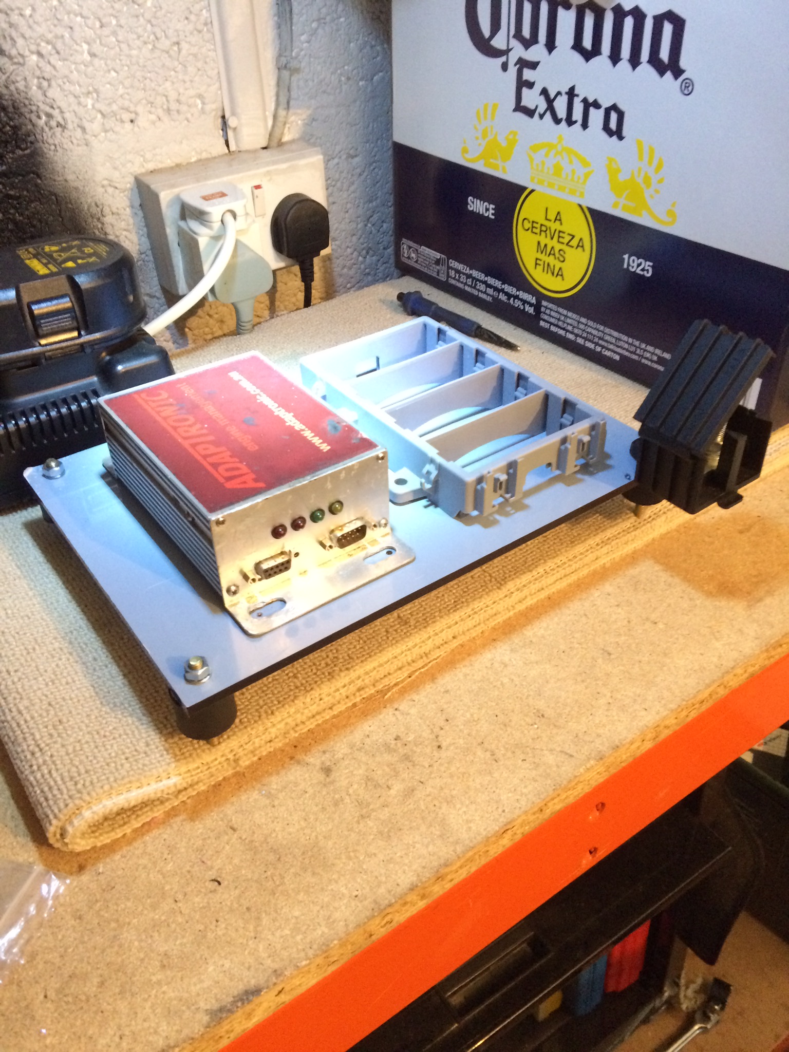

Very untidy, but the box covered all of this, but I still wasn't happy so time to relocate the pumps.

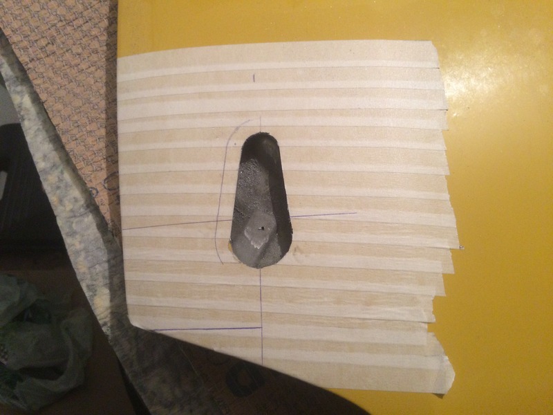

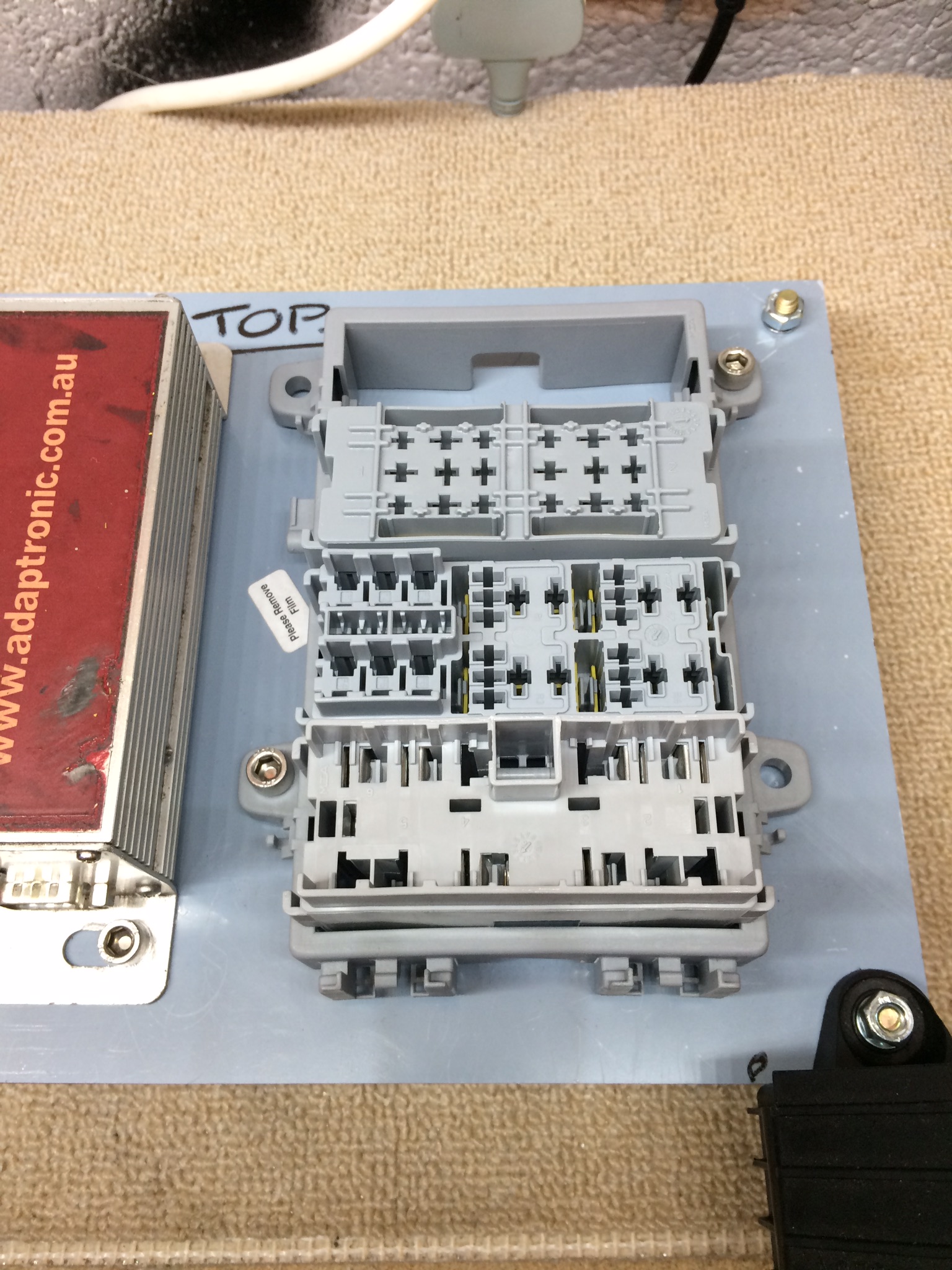

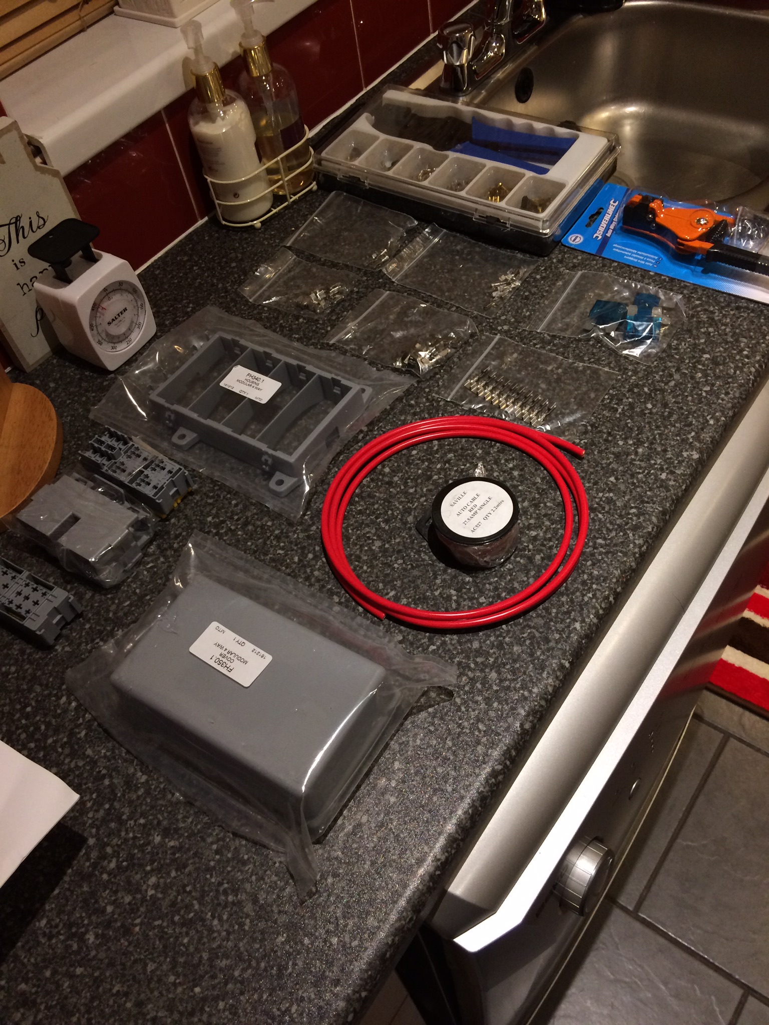

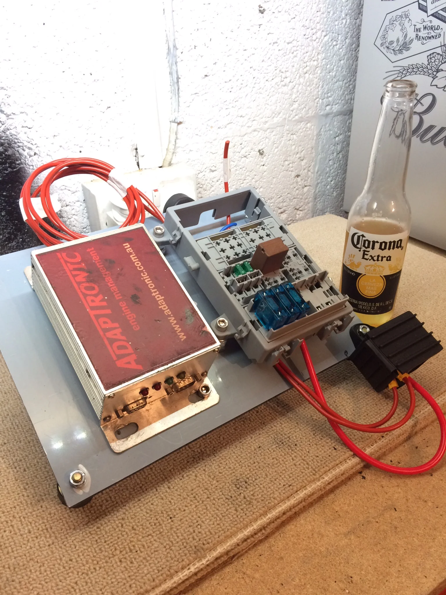

While I was measuring up for lengths of hose and fittings which I needed, I decided I wasn't happy with wiring of the car either, It was always on the to do list once the car was running years ago, but like most people I hate wiring and something always goes wrong... never the less it was time to learn, so I removed the fuse box cover to this mess! (sorry guys)
Everything was then labelled, excess bits cut off, and loom was extended, and now sits inside the car.
Starting to look a little cleaner now, tested everything electrical on the car and success it works.
Then I just started to test fit the new brake reservoirs and bracket, I wanted them hidden from the engine bay, but easy to gain access to.

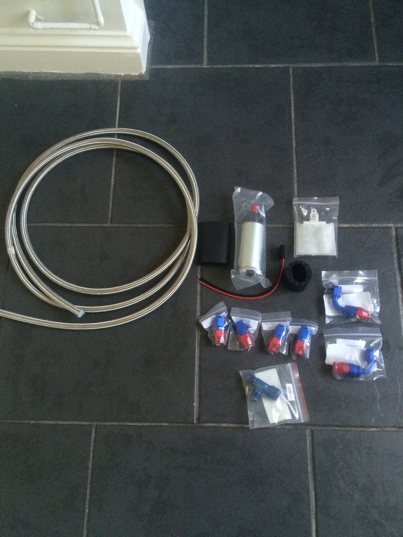

Day after I ordered some fuel system bits they turned up, which was great!
I was tempted to not run an external pump and just run an internal uprated one, but after days of doing some research and speaking to others, I decided to stay with the two pump setup, but I removed the external fuel pump for an in tank uprated pickup pump to feed the swirl pot and bosch 044.
First lot of fuel line and fittings and pump turned up.
Started planning out the routing of the fuel lines to the regulator.

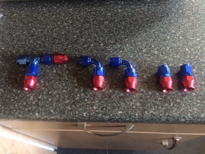

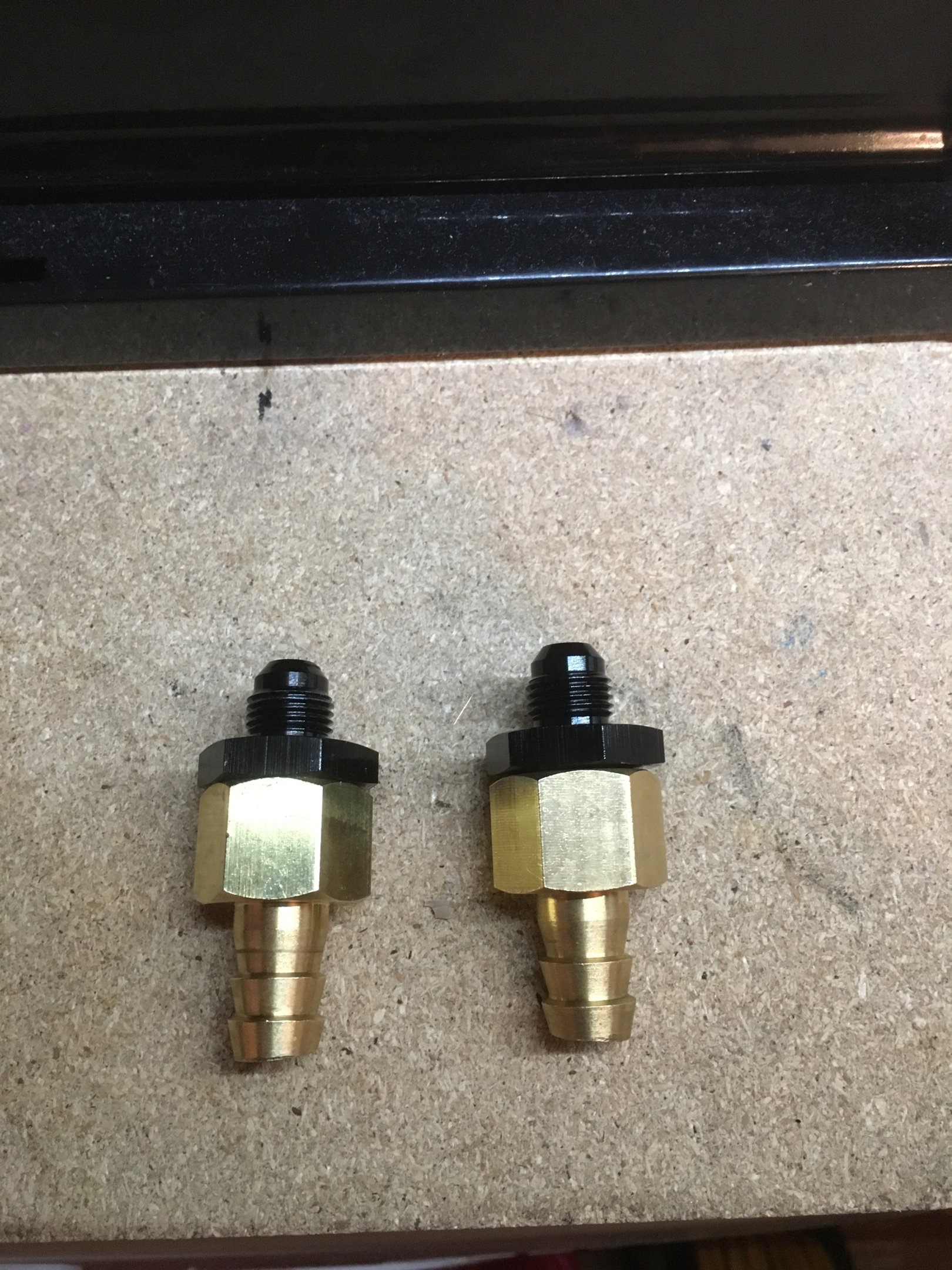

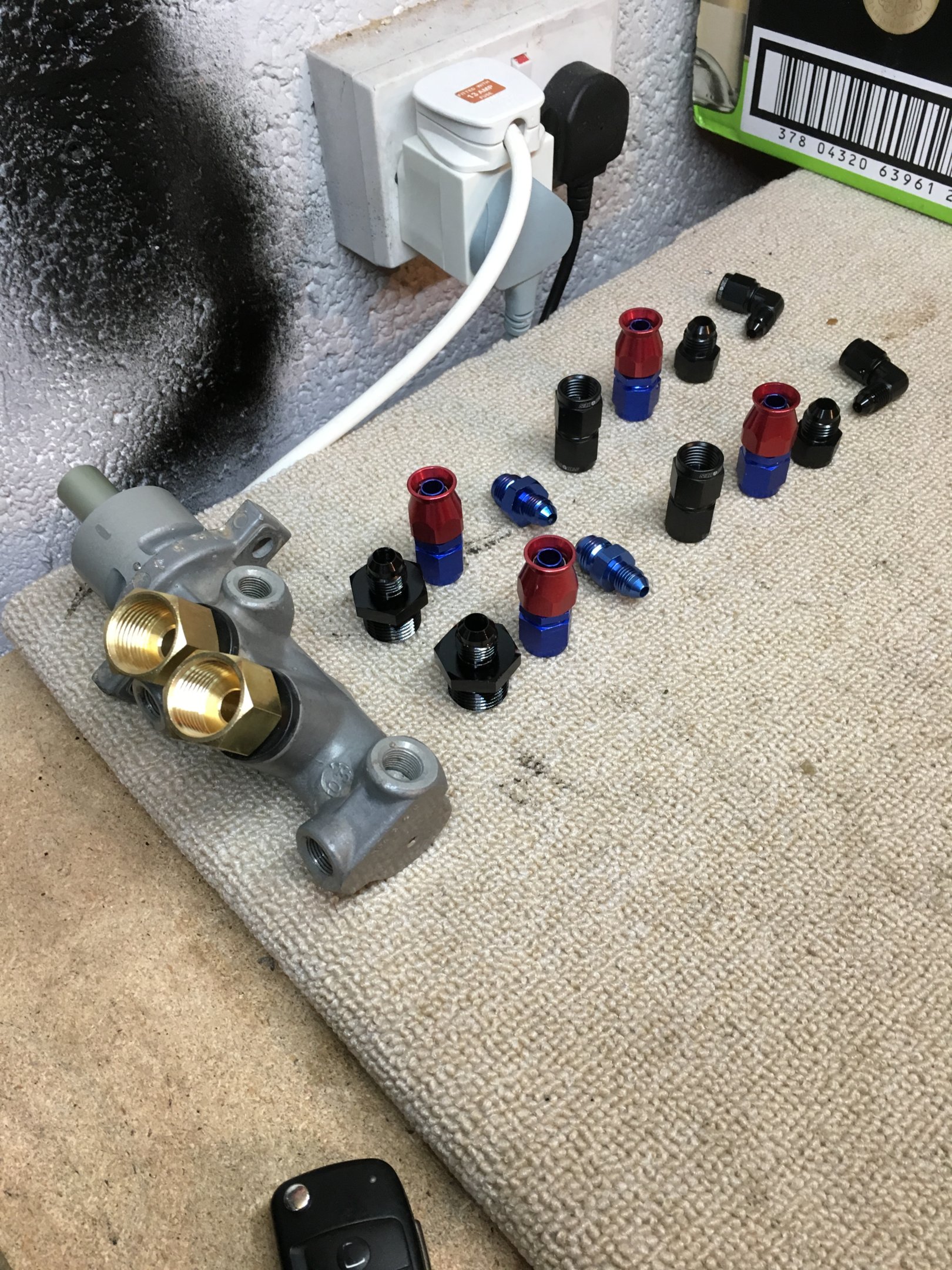

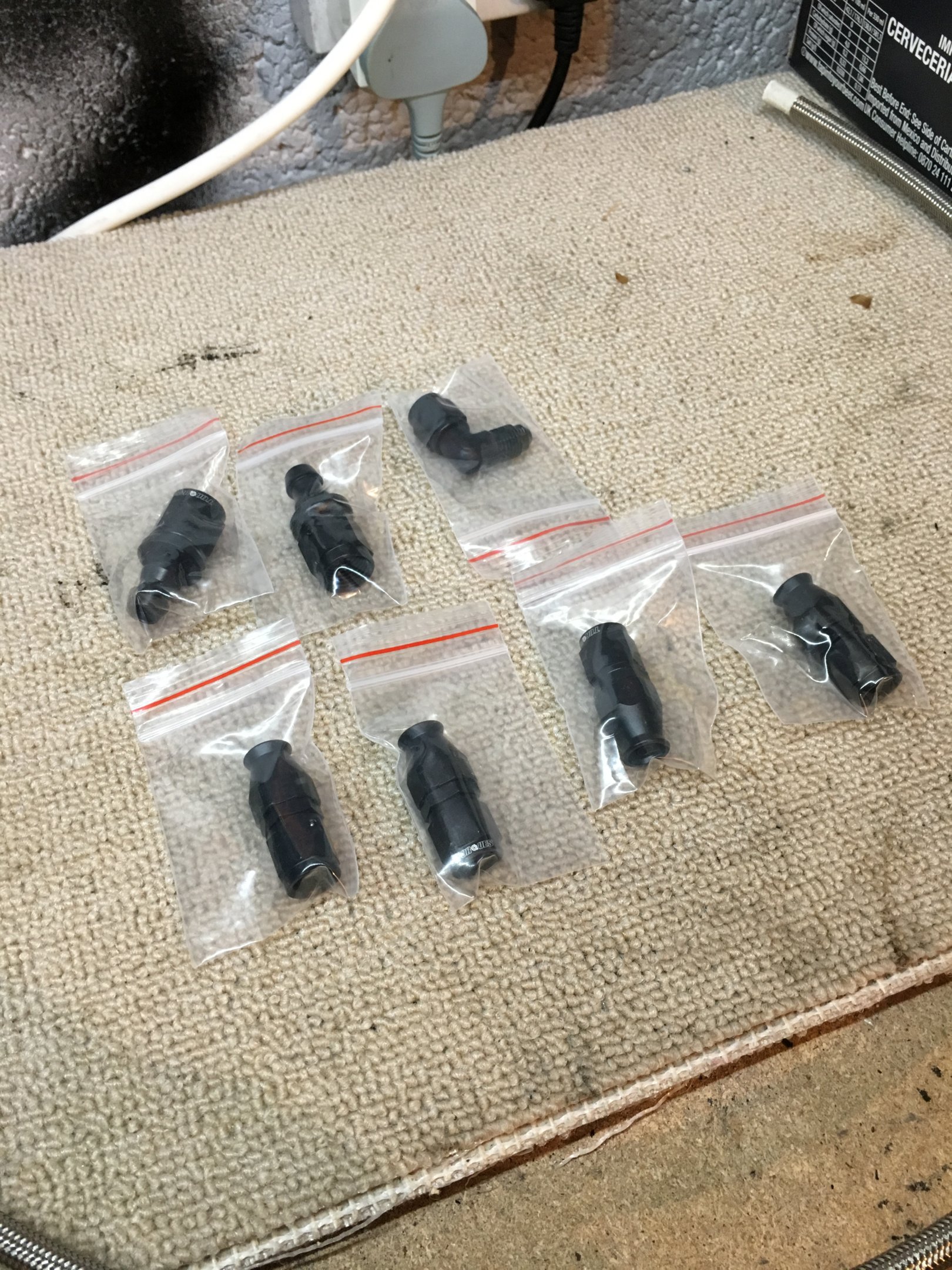

I bought some of these connectors from torques uk to convert normal push fit fuel connectors to AN6 but for some reason I didn't trust them? Anyone else used them?
They fit quite well onto the pump sender on the top of the tank but instead I used some oem fittings and made them fit onto the fuel hose instead.

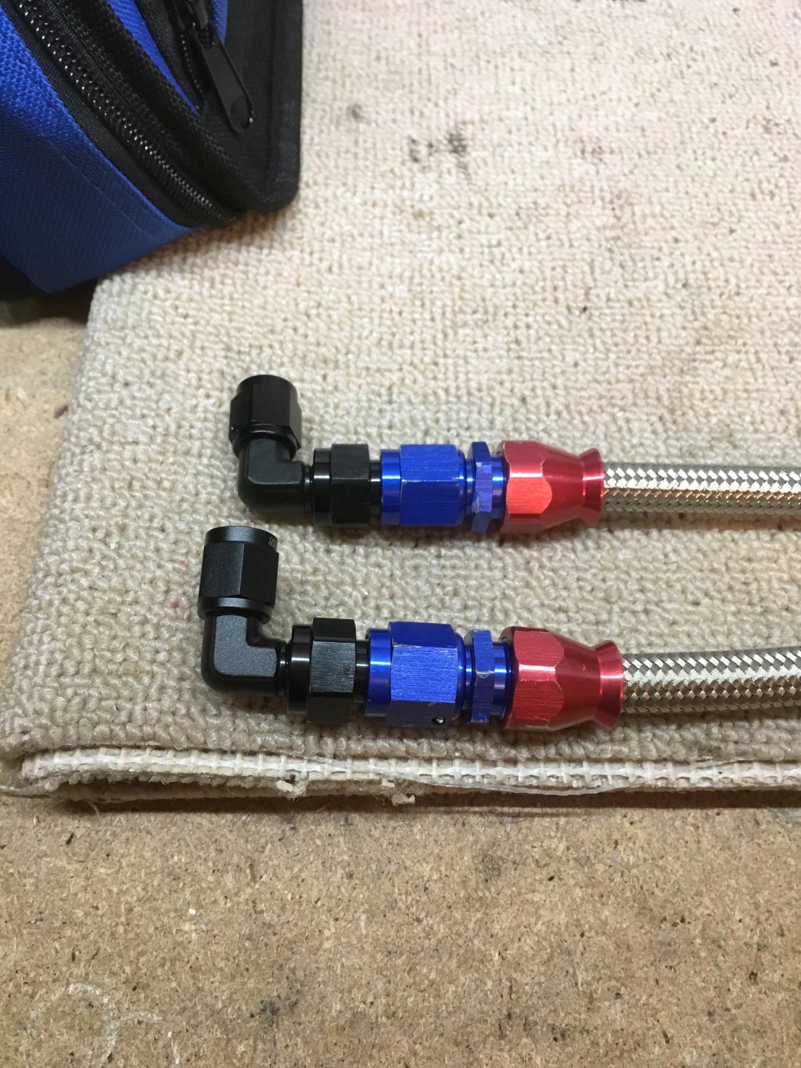

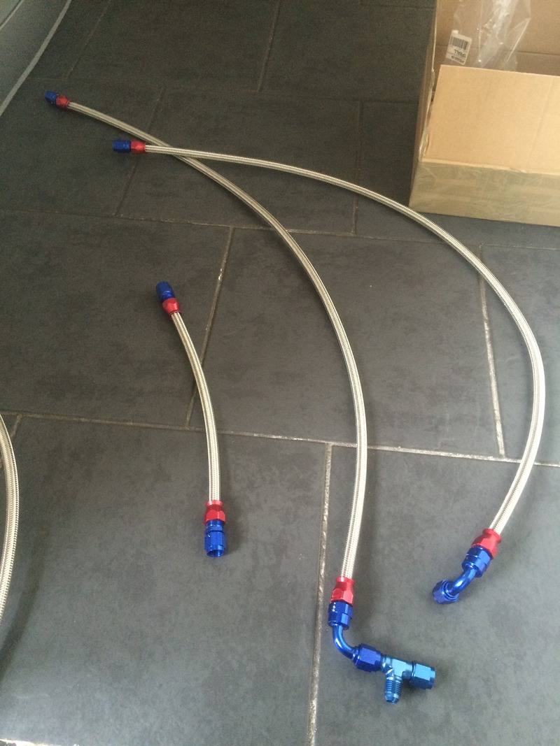

Couple of hoses made up to suit, The pipe was a nightmare to cut and fit the fittings on but with lots of swearing got it all done, Fuel hoses run inside the car completely now, with no smell. Result!

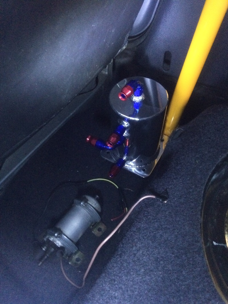

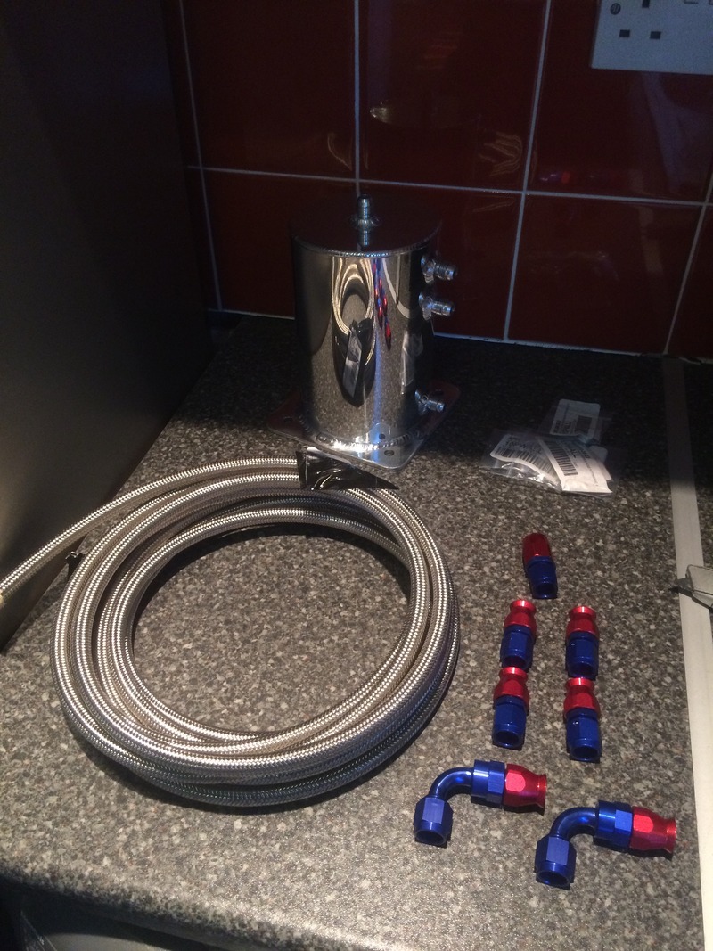

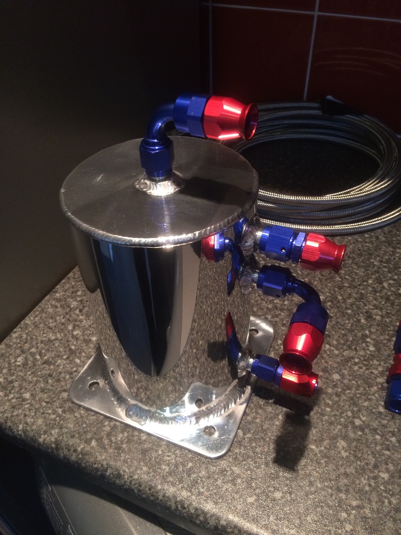

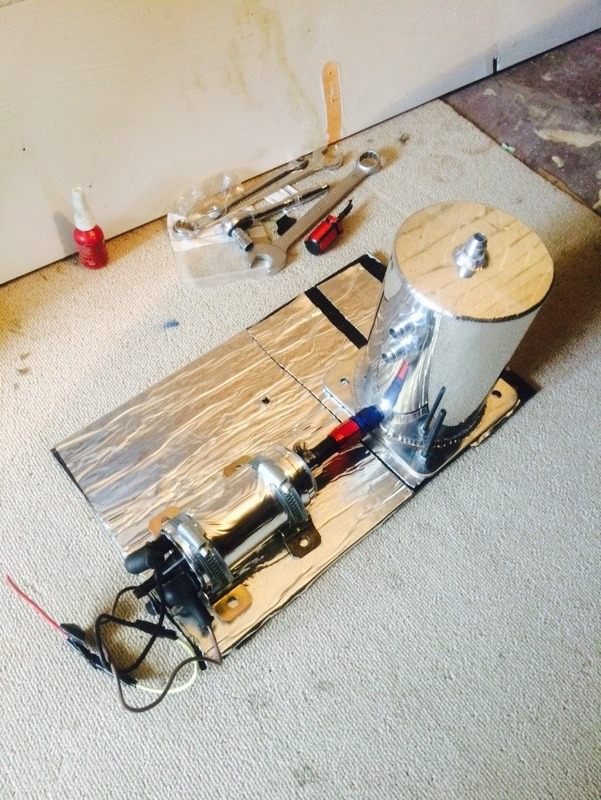

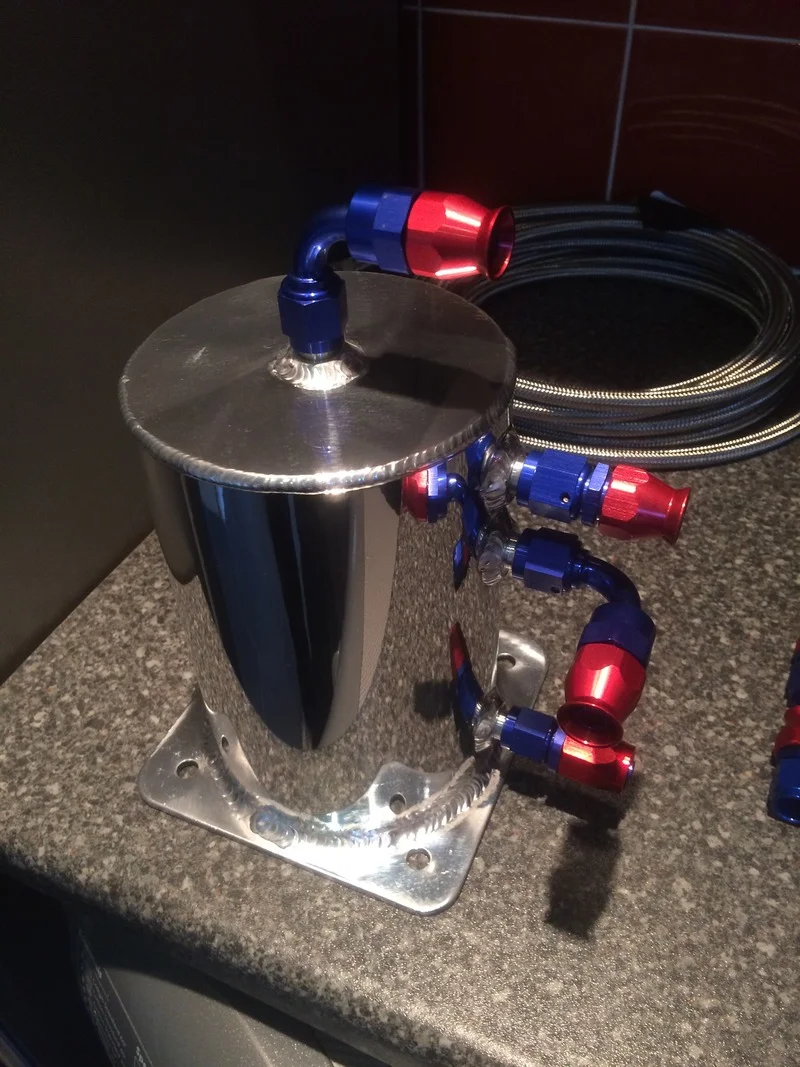

So my new swirl pot, more fuel hose and more fittings arrived.

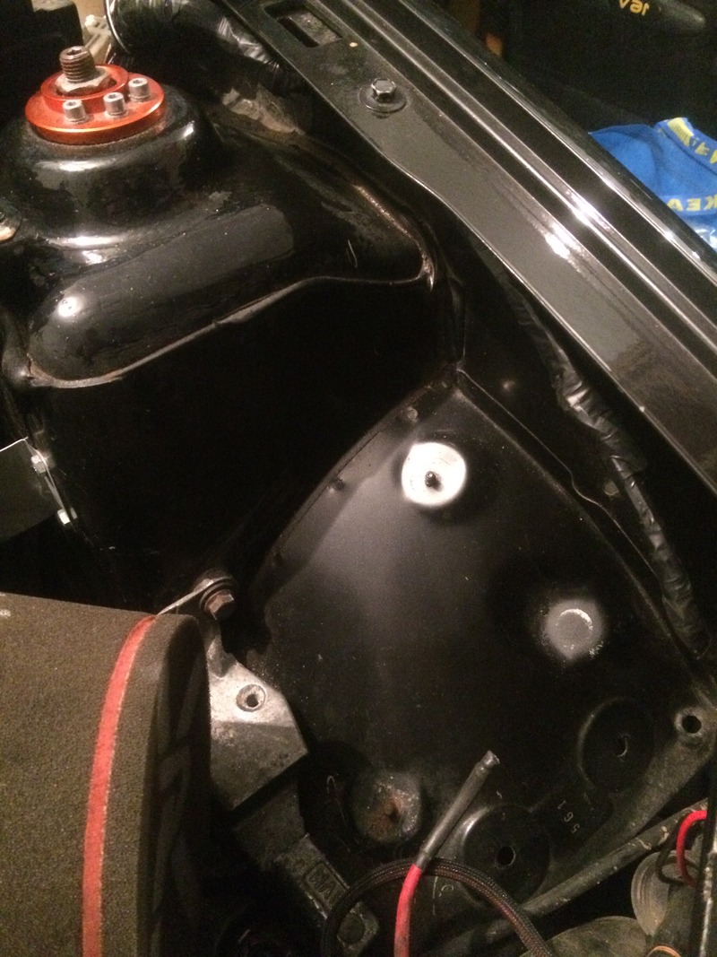

Decided, I wanted the fuel set up closer to the tank and behind the drivers seat so started to place things and started making a template to mount them on.

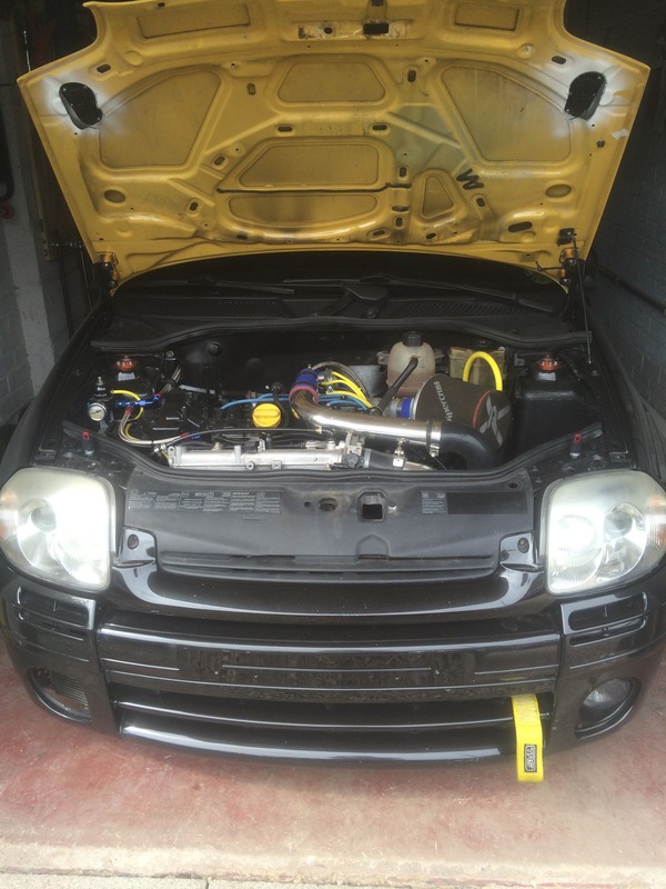

once all the work was done, it was time to bleed the brakes, give it a clean and take it for a drive
Engine bay is starting to look better, but still a very long way to go.

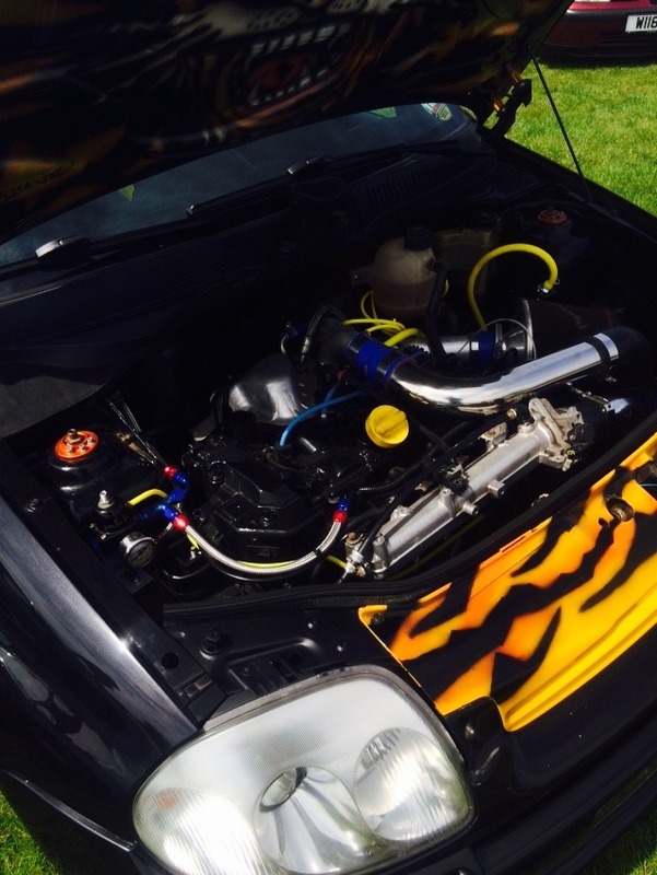

Went to a few shows, including modified nationals and FCS few shots here.

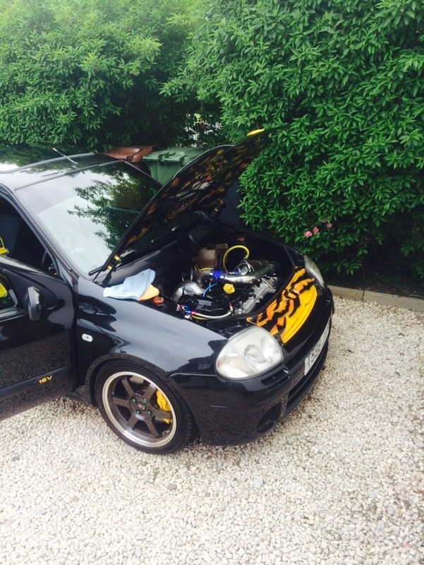

On the way back from FCS I noticed the car was loosing oil, got it on a ramp, couldn't see a leak from anywhere... then a little starting coming from between the gearbox and sump, so im guessing its the crank seal which has failed, so that's an issue I need to sort.

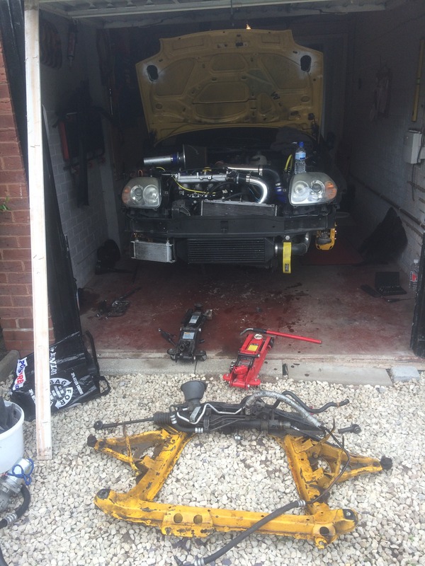

Finally got round to sorting the garage out the weekend, new toolbox and some storage units, rolled the car out, started her up, had a quick look round and decided I'm not happy with a lot of bits, plus there is a small oil leak which looks like its coming from the crank seal, and also there is a very bad exhaust smell coming into the cabin so I'm guessing a gasket has failed.
Anyway, Im not going to drive her again until I'm 100% happy with everything. so I've started ordering bits and bobs.
All the yellow will be going, the tiger and airbrushing is going.. time to grow up now!
Engine is coming out to sort all the little bits out
got my epas rack and all the bits for that as well.

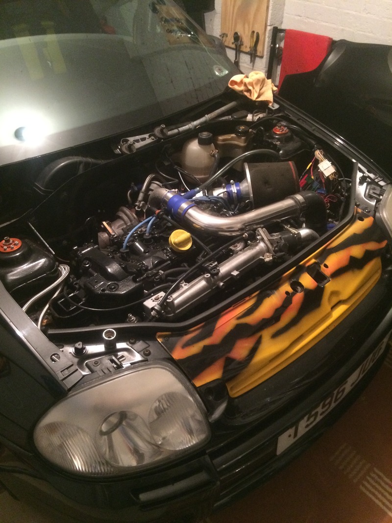

I don't really update much on here anymore, but not really done too much on this for a while as savings are being eaten up by our wedding and honeymoon next year.

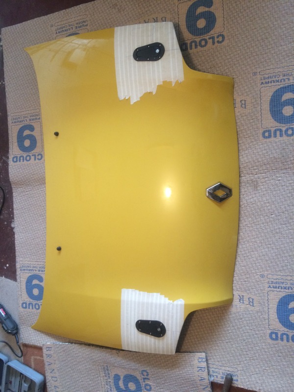

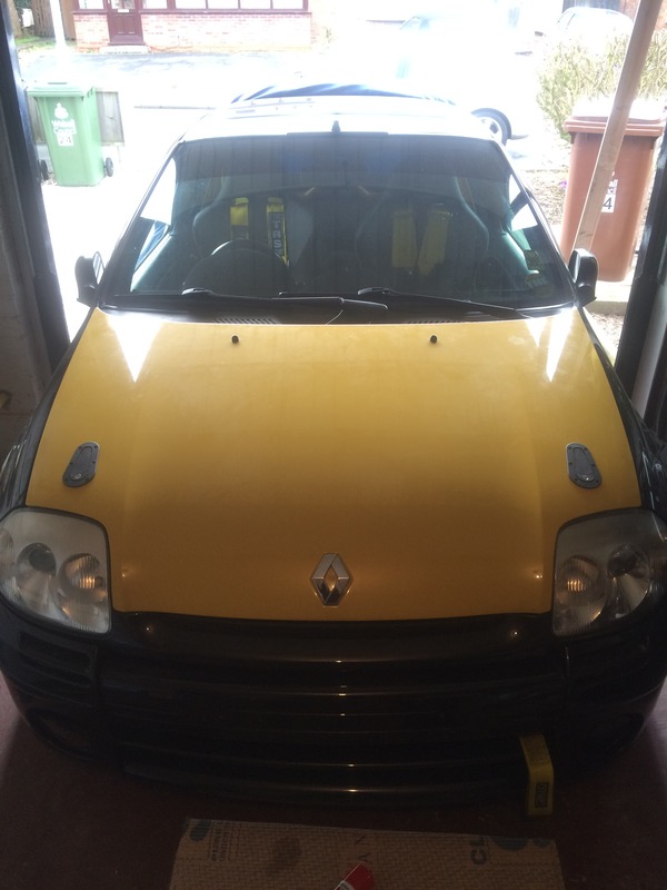

Anyway The tiger and all the yellow is going, took me awhile to find a replacement ally bonnet, but one popped up so I raced up to get it, got it back and wasted no time fitting aero catches too it. Took my time and tired to get a neat finish to the underside of the bonnet.
Added a black grille too, bonnet will be going for paint soon when my painter is back off holiday!

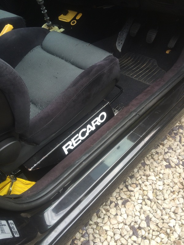

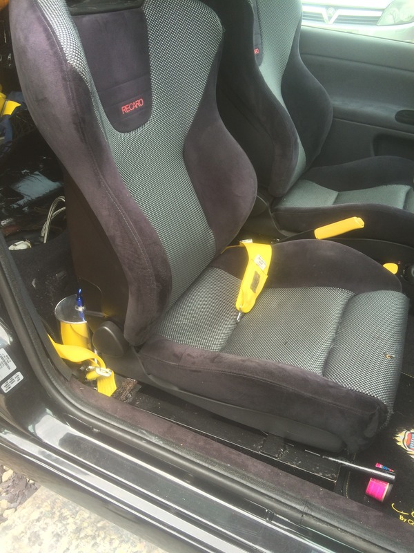

Bought some proper recaro adapters for my seats to, ride height is so much better now and I actually feel a lot safer compared to the ones we made.

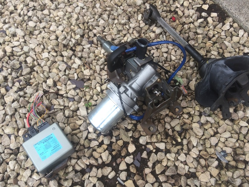

Got all my epas stuff too for the conversion, started stripping the car down, subframe bolts were a nightmare as normal, so off to Renault and got some new bolts and nuts ordered.
Next up is to refurb the subframe, get it painted black, new bushes, and paint the new steering rack,.

Says yellow is going, buys yellow bonnet [emoji38]. Enjoyed reading through your build, keep the updates coming.
haha I know, its the only one I could find, should be sprayed up soon, more updates hopefully later this weekend :D

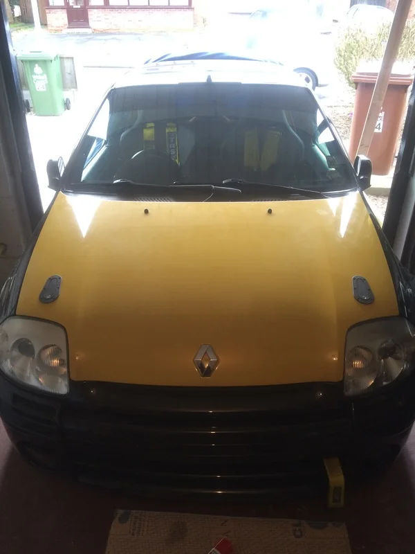

Not updated this in a few years, Life has been busy and the car was left in the garage in pieces. It has gone through a lot of changes, mainly trying to tidy it up and ironing out some teething problems, mainly getting rid of quick fixes and stupid mods such as airbrushing, bad wiring etc.
Stupid airbrushing has gone, Tiger stripes gone, most of the yellow gone.
Rota wheels gone
Recaro seats gone
carpet gone

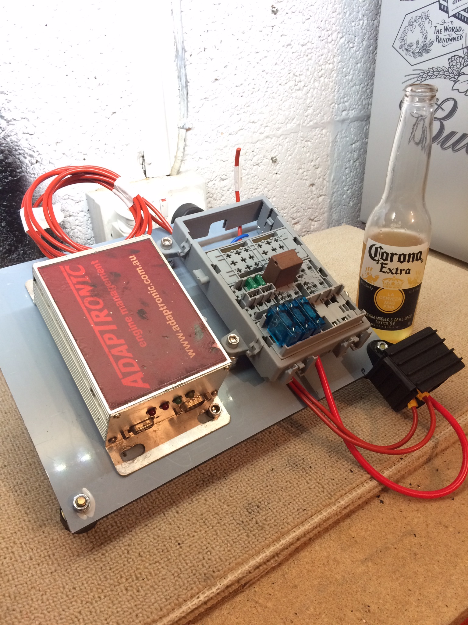

Rubbish wiring gone
EPAS wired in.
New fuse box relocated and wired in.
bonnet aero catches fitted.

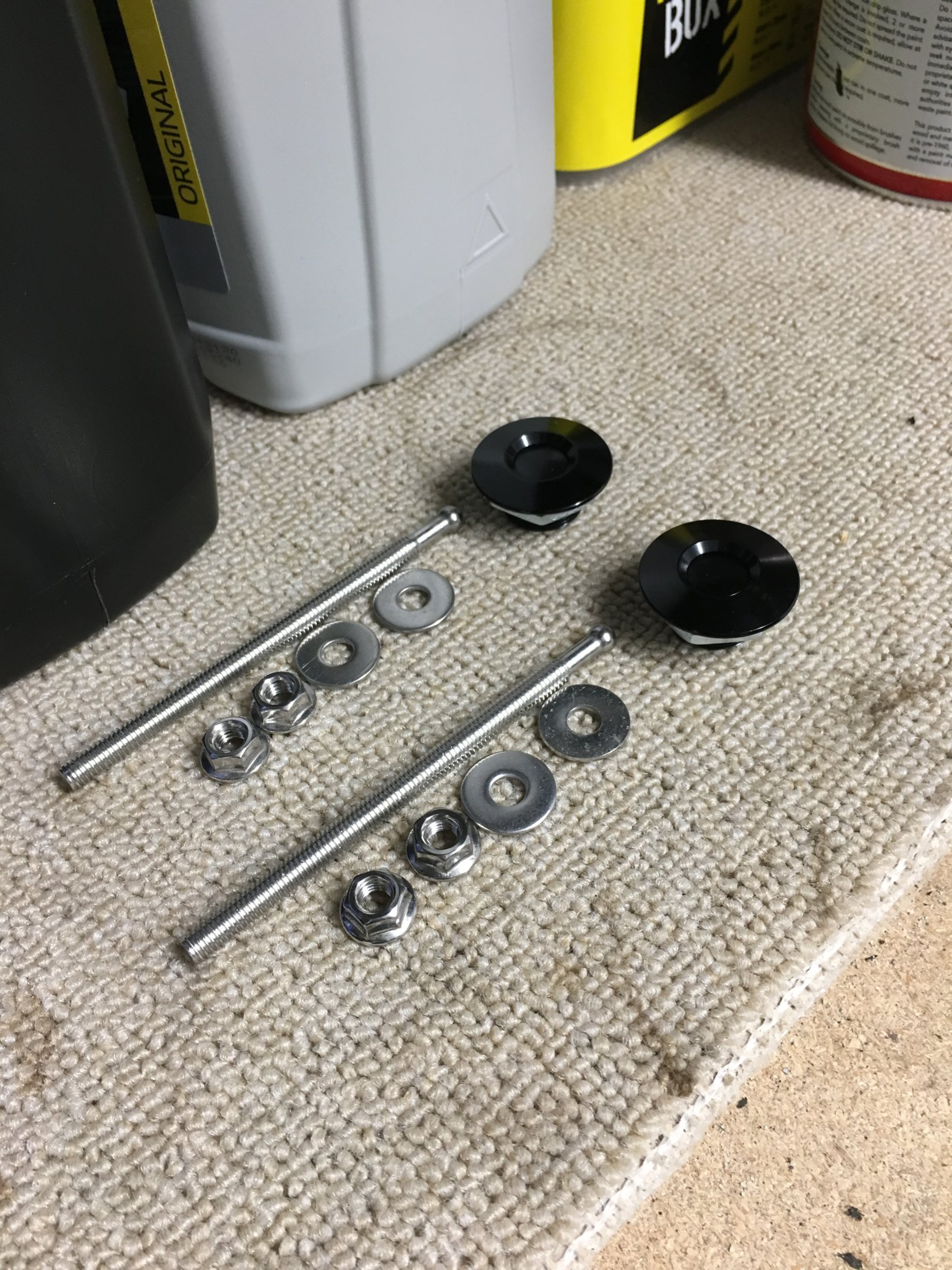

quick release catches fitted to front bumper
New brake lines made for reservoir
new gearbox (jc5)
Got the car back on the road this year, had some fun it in, no track days unfortunately. Just been trying to enjoy it. Went to Trax at Silverstone this year (first show I've been to in years) car drove pretty well down there, Way back home wasn't so good. Saw some awesome Clios on track, and a lot of boosted ones. Was nice to speak to a few people in the Renault scene, really starting to get the passion back. Spoke to @Brigsy just as he pulled up next to the Top 25 stand, so impressed with the van, such a tidy conversion, fair play!
Photo updates later tonight or tomorrow...
