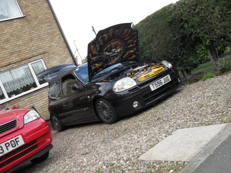

UPDATE 5/12/10

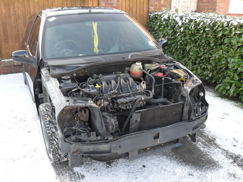

Not been able to do much lately, due to work and the weather, But i suppose i shall share somthing with you lot, I was gonna keep this on the hush but oh well.

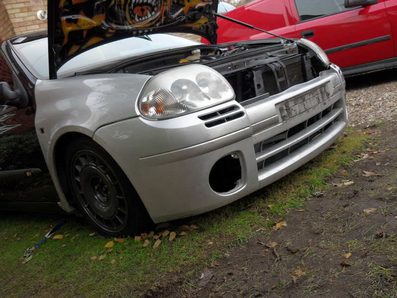

Wide much?

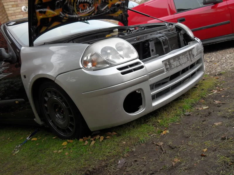

Oh haii 172 front end!
172 sideskirts

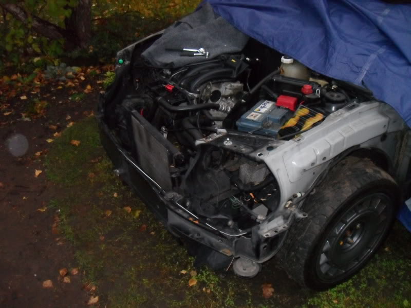

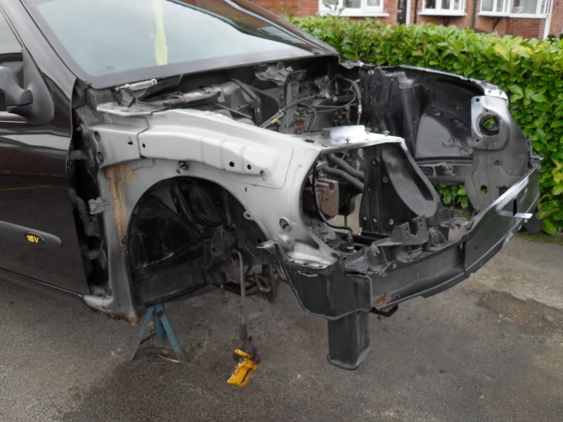

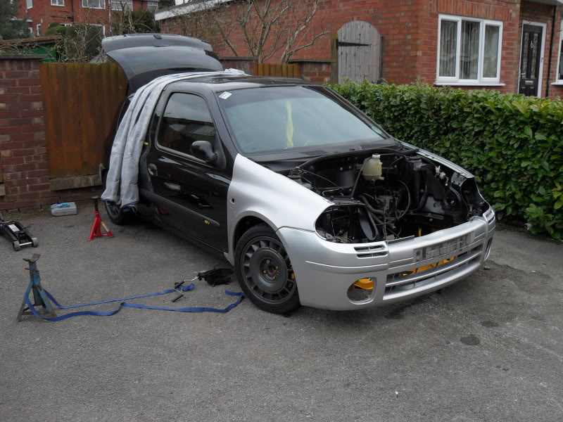

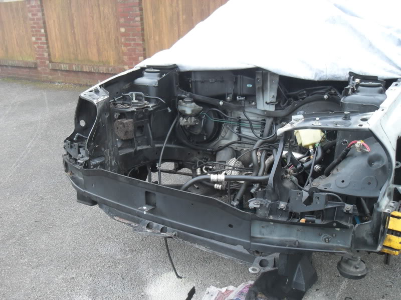

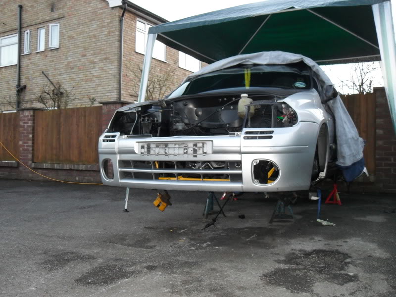

Front end ready for the old lump to come out.
Just waiting on a few bits for the new engine, soon as i have them they sahll be fitted and the engine will get a final check over and dropped in. :)

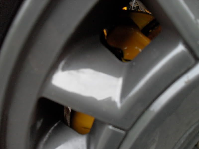

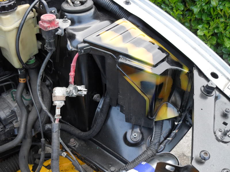

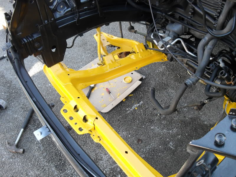

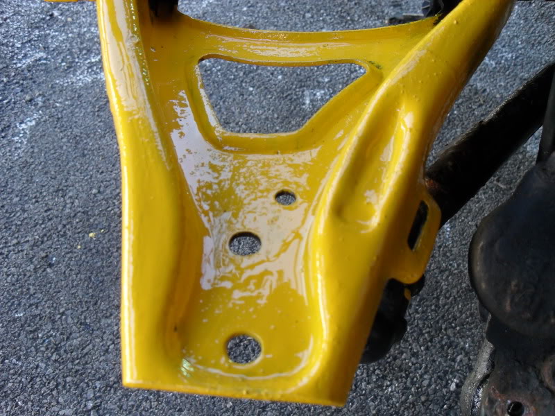

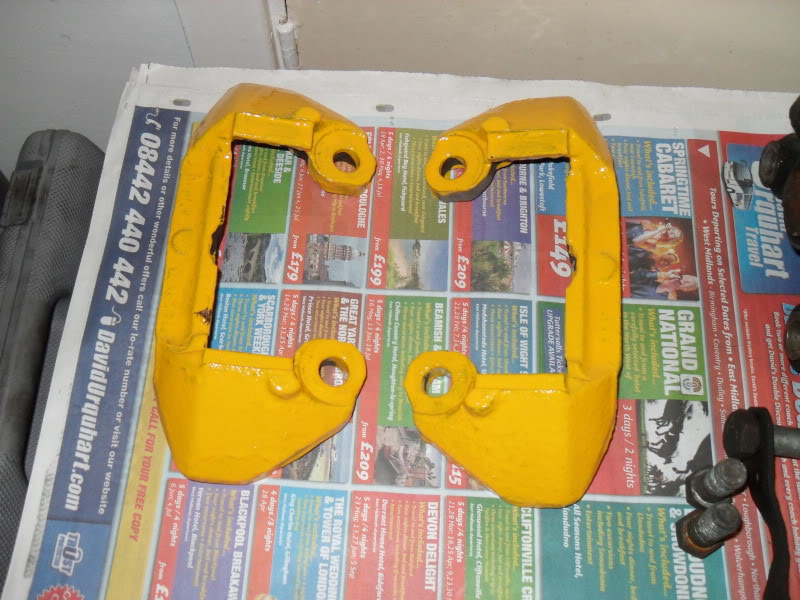

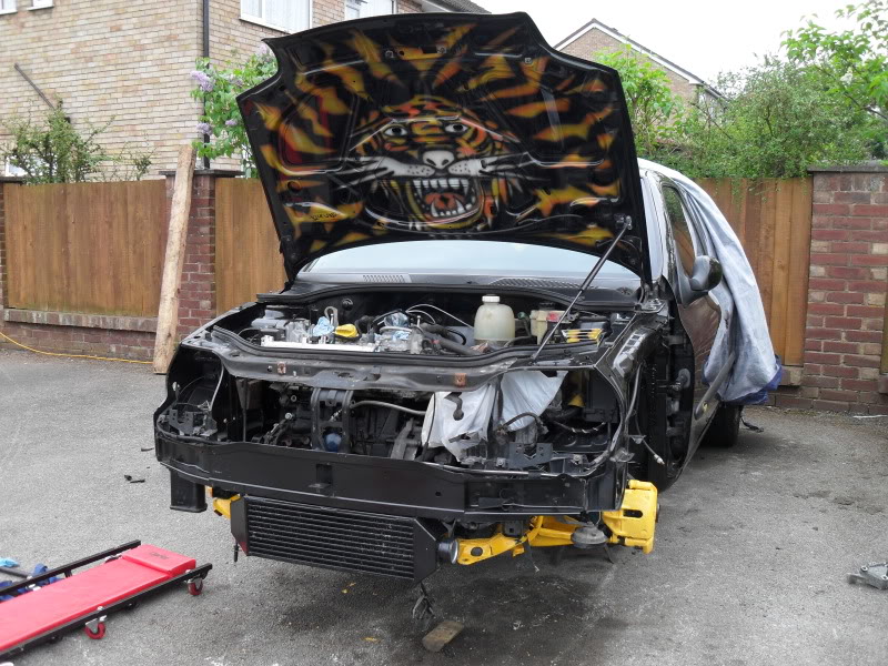

Cars coming along awesome bud but 1 niggle, i wouldnt of painted the yellow bits on the dash, i would of used yellow flock as paint = shiney and defeats the point of a flocked dash
Re: The Black clio Project, From Day 1.
This is true, I was going to have the flocked, but at the time i had ran out of money and needed them done asap. the interior light surround and rear doorcard inserts are yellow flocked ;)

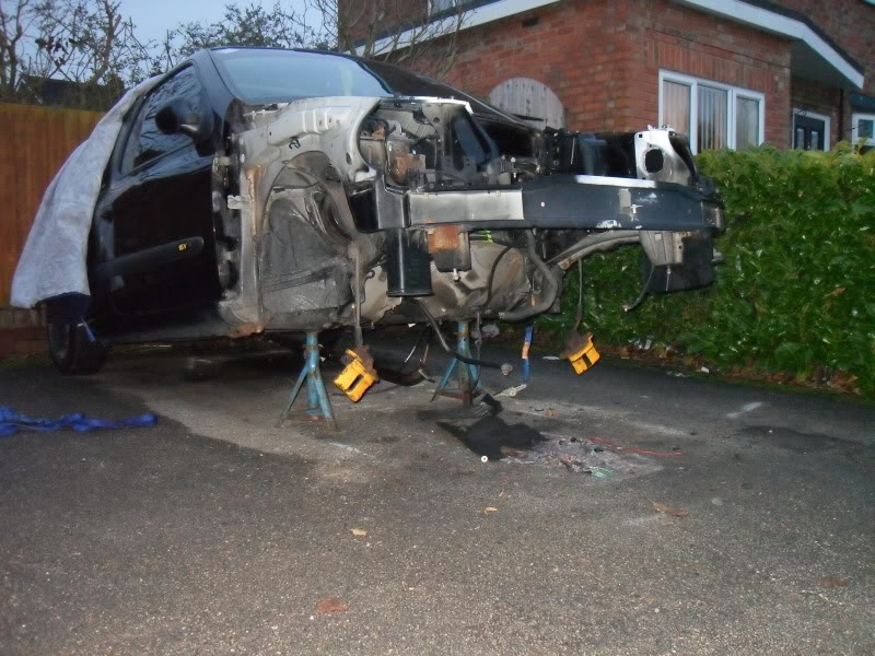

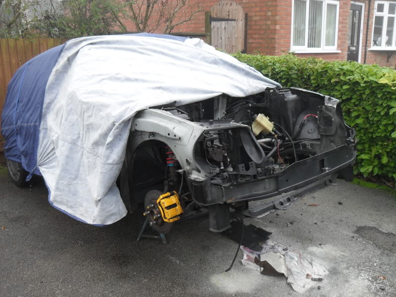

UPDATE 29/12/10
Not much due to christmas and the weather and mainly partying alot.

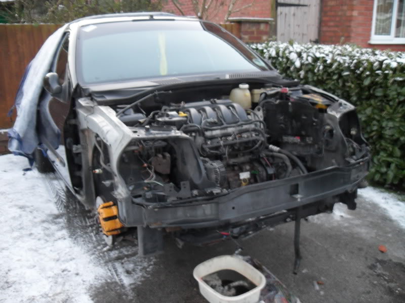

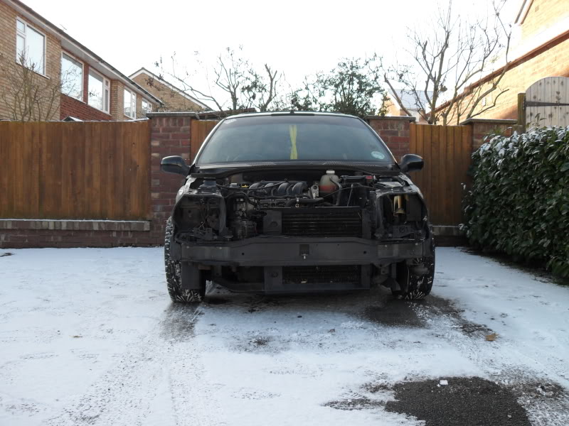

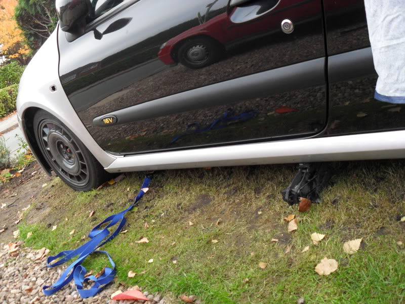

But anyway Last week Rolled her round onto the other drive.

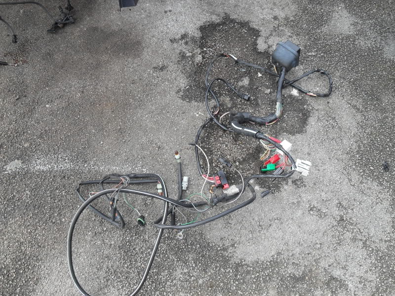

Then drained all the fluids, Rad off, Driveshafts out, Battery and ECU off, Loom out, Wiper motor and washer bottle out.
Then exhaust off, PAS pump, Alternator, fuel lines, Gear linkage all off.
Undid all the engine mounts,

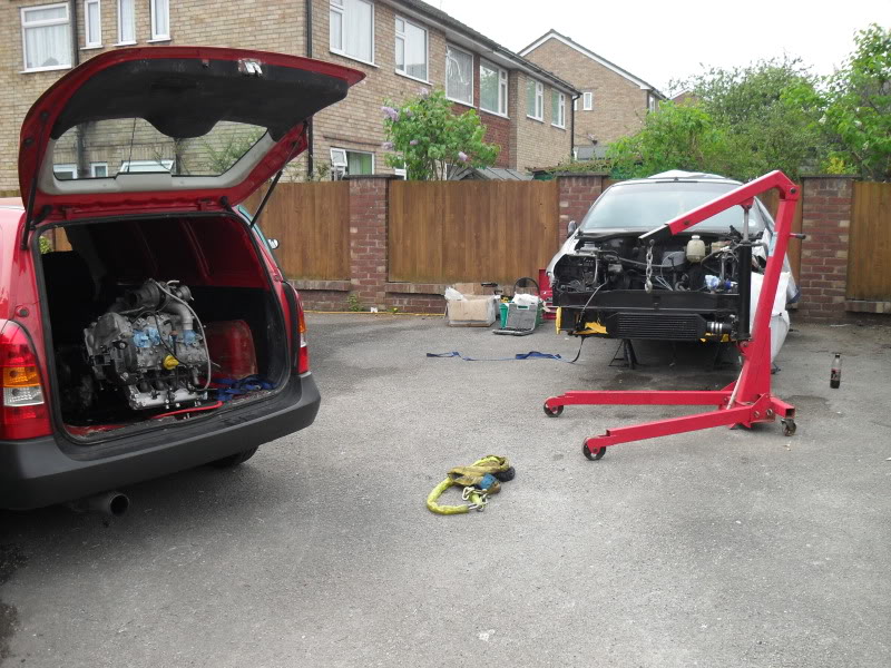

And after a few swear words Engine was out. :)

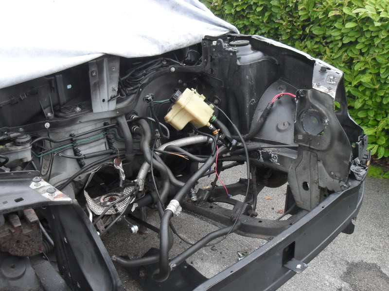

Current state.

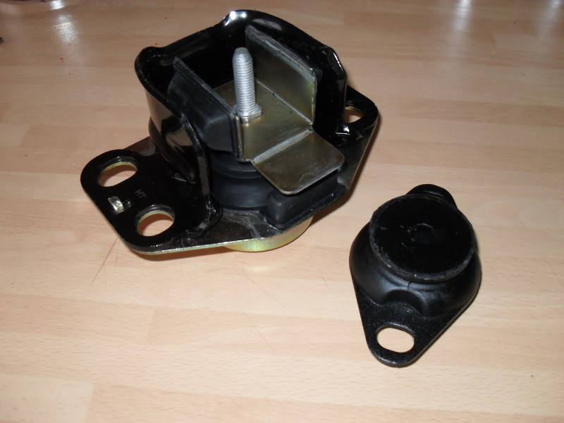

Next few things shall be getting a few more parts and new engine mounts as mine have seen better days!
Im also changing to the 'widetrack' clio setup at front to allow me better handling and better brake options :)
Cheers.

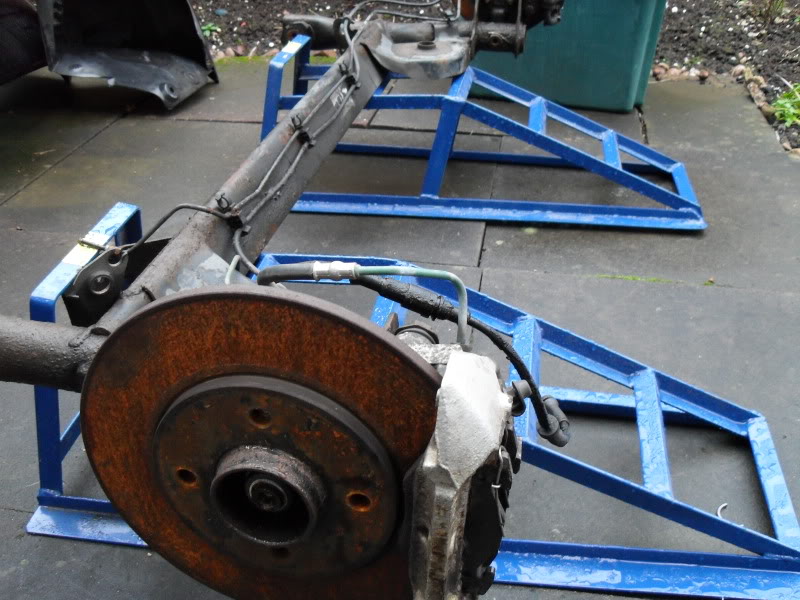

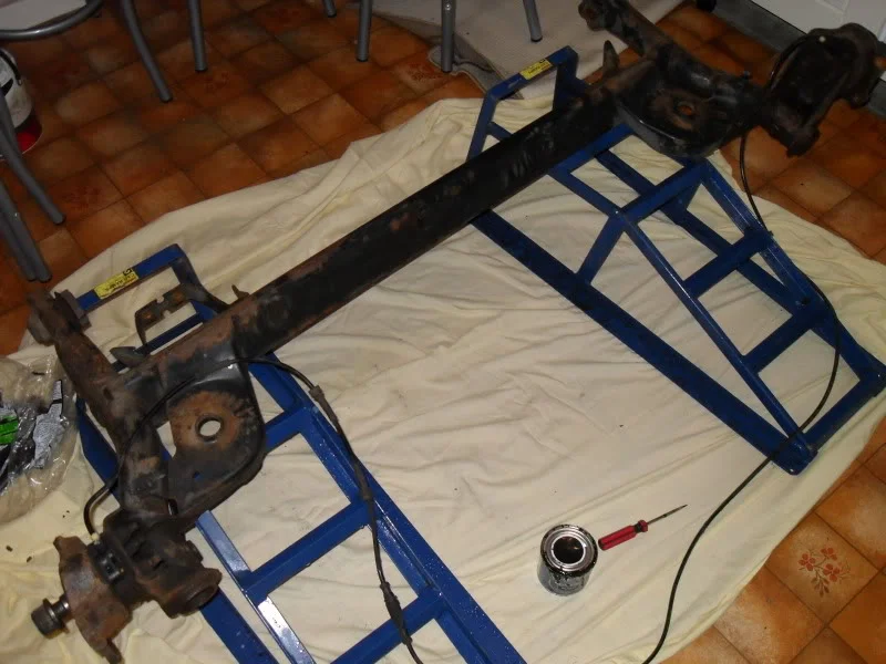

Anyway 172 rear beam, this shall be treated to a good coat of paint and new discs and pads!

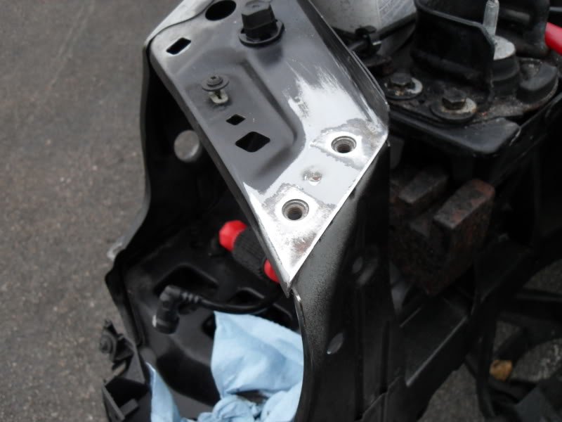

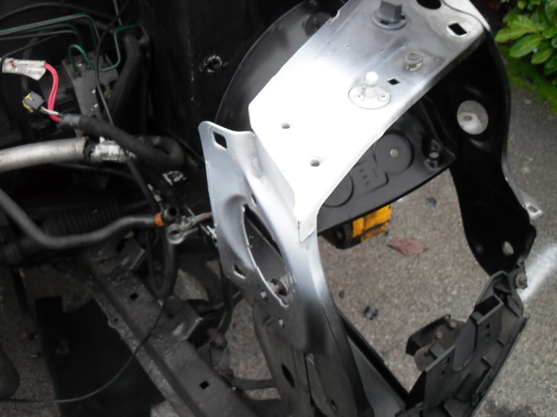

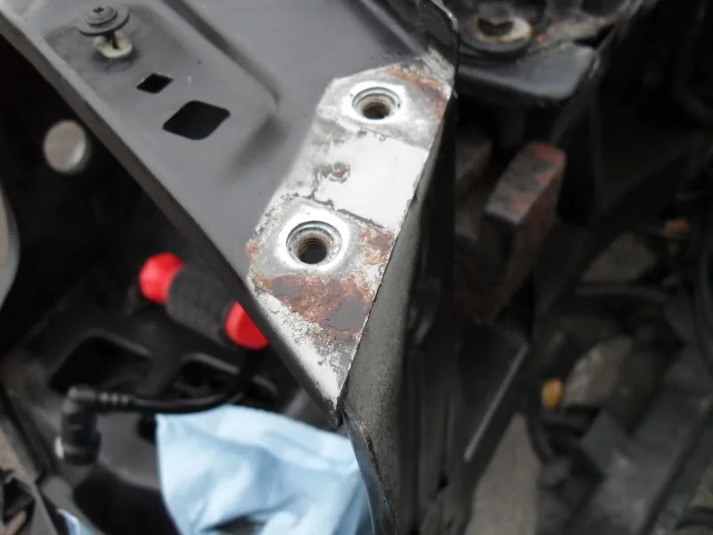

I started to get rid and treat patches of rust.
Before
During
After, Fresh.

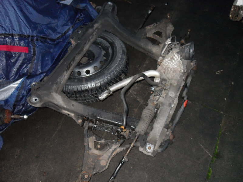

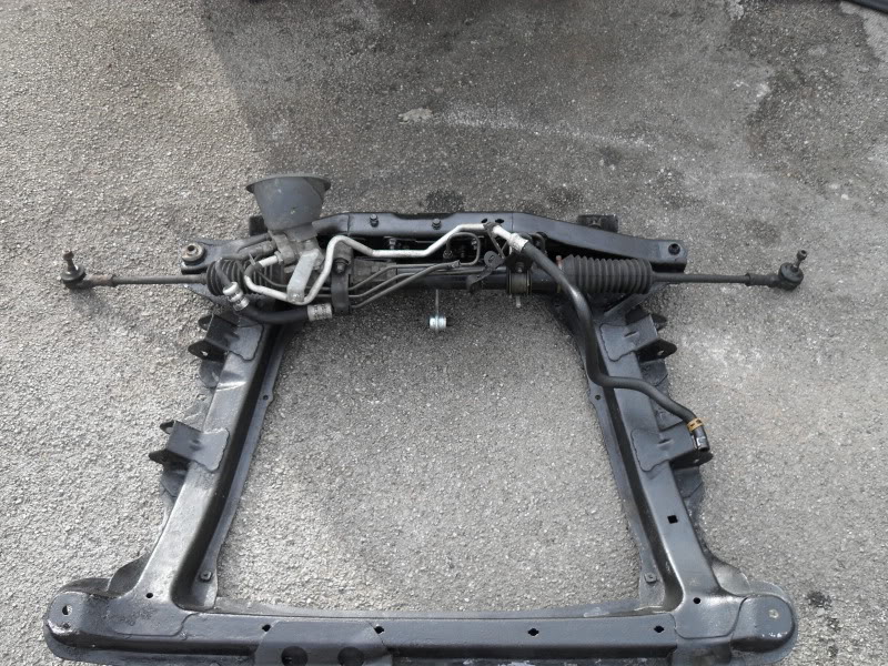

Also dropped the subframe off. to replace the steering rack, and bushes etc.
Subframe off.

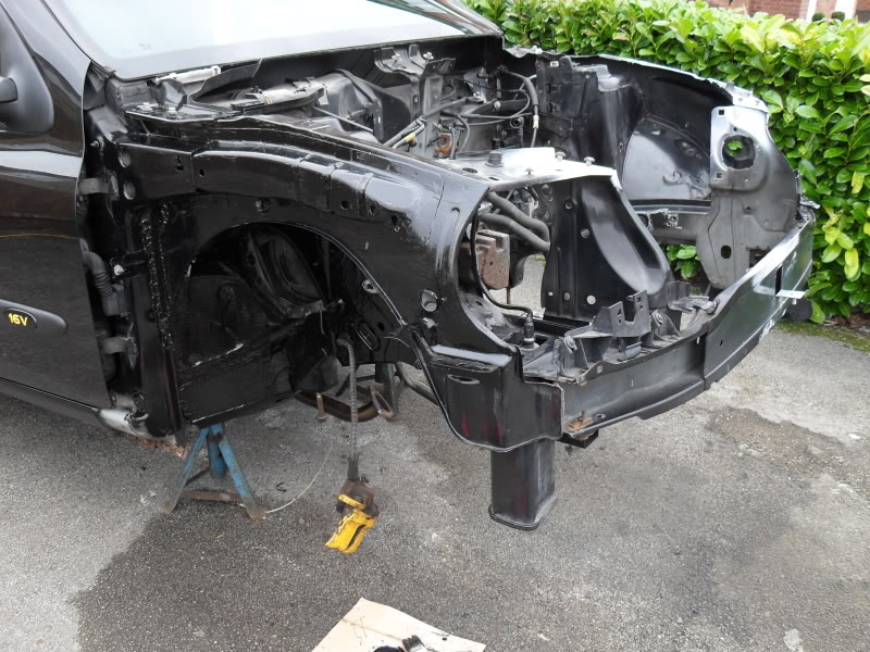

Rust treated, Inner arches and front chassis painted.
Before
After

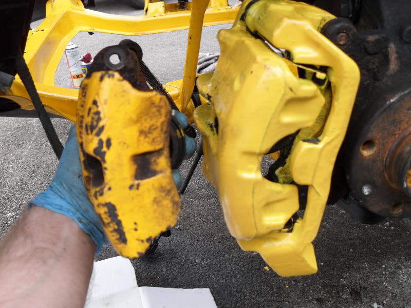

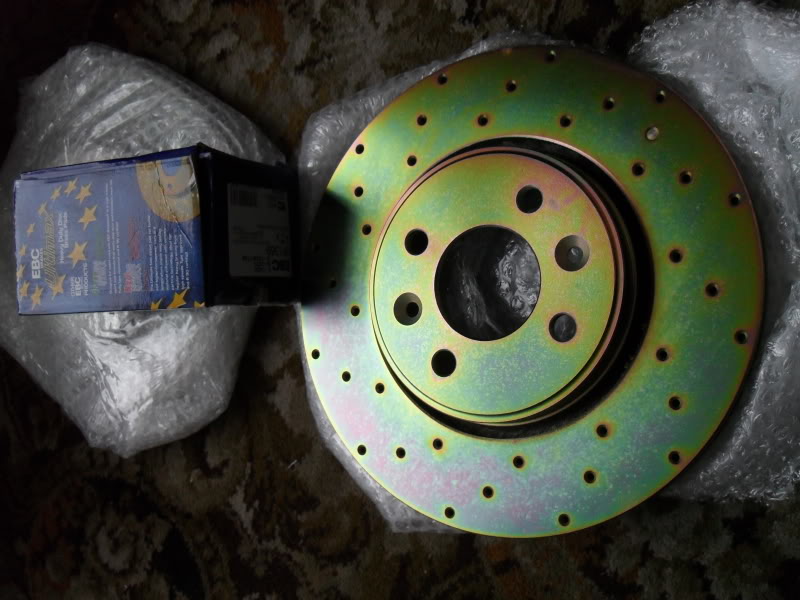

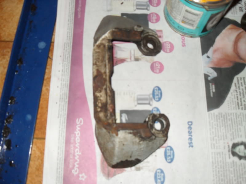

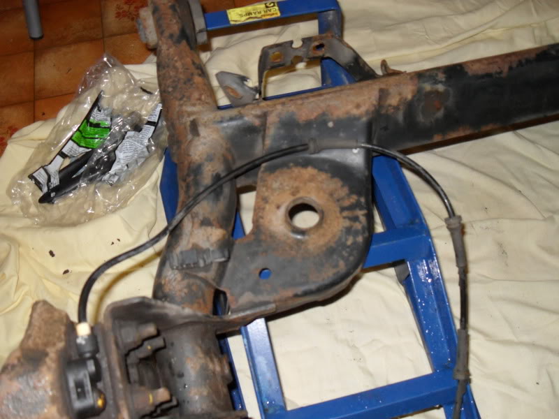

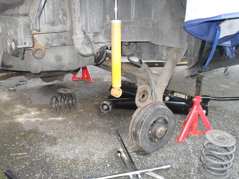

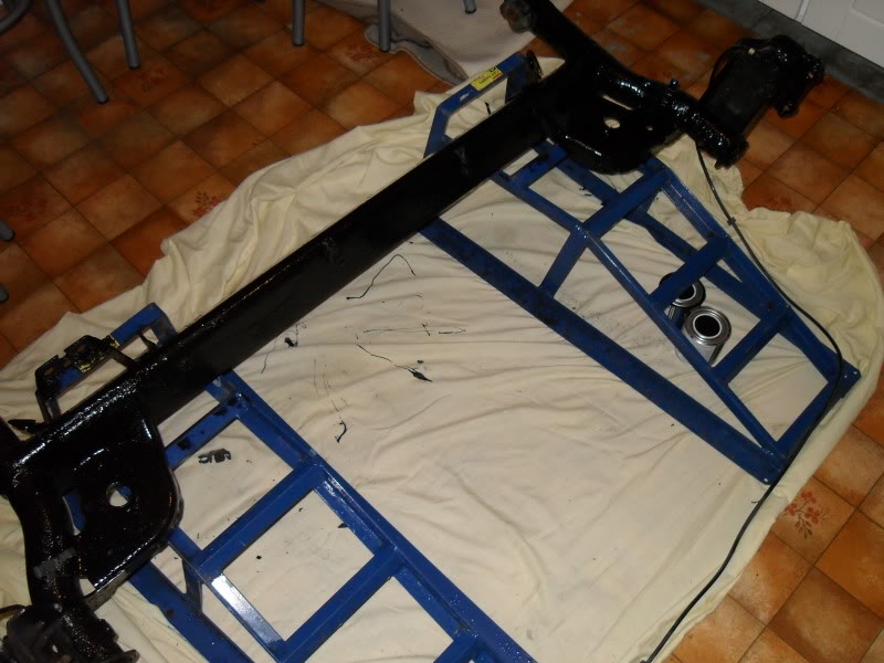

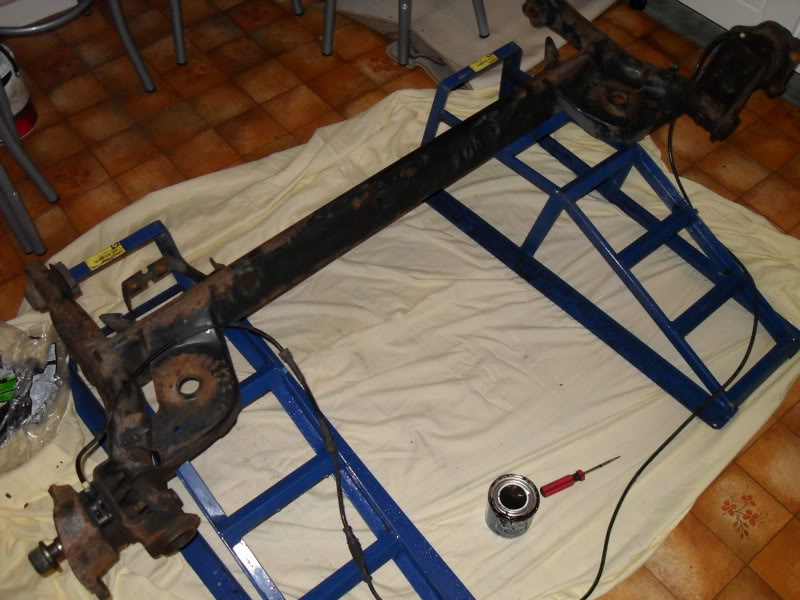

Also Stripped the Sport rear axle down for a rebuild and Some new Brakes, bearings and brake lines ;)
Before
Beam painted at 2am in the morning :D
Calipers Before
After First coat.
Dropped the Old Axle off too.
This weekend, hopefully the new axle will be on, Front subframes should be rebuild and back on, then She may be back on 4 wheels!

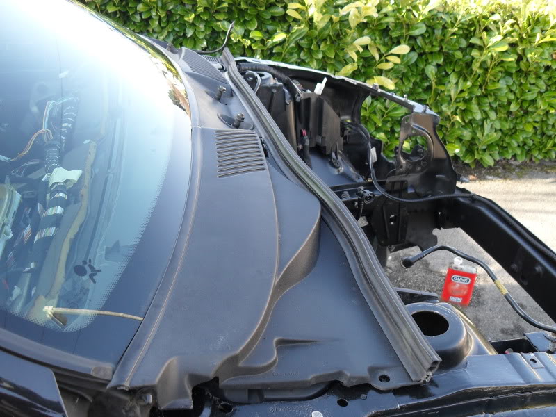

Started to wire things back up, one part of the loom
Heater motor, wiper motor, washer bottle all wired up and scuttle panel refitted.

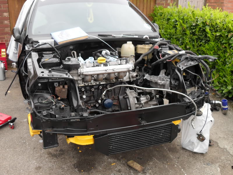

UPDATE 3/5/11
Well alot has happened since i last updated, mainly roadtrips all over the UK to source parts and build engines etc :)
So basically long story short, the 6speed box wouldnt fit into the bay unless bits were chopped etc, then having a good think, head stratching and talking to some clio guru's the end plan was to get hold of a F4R block out the clio 172/182 and put all the 225 internals into the block and use the JC5 box.

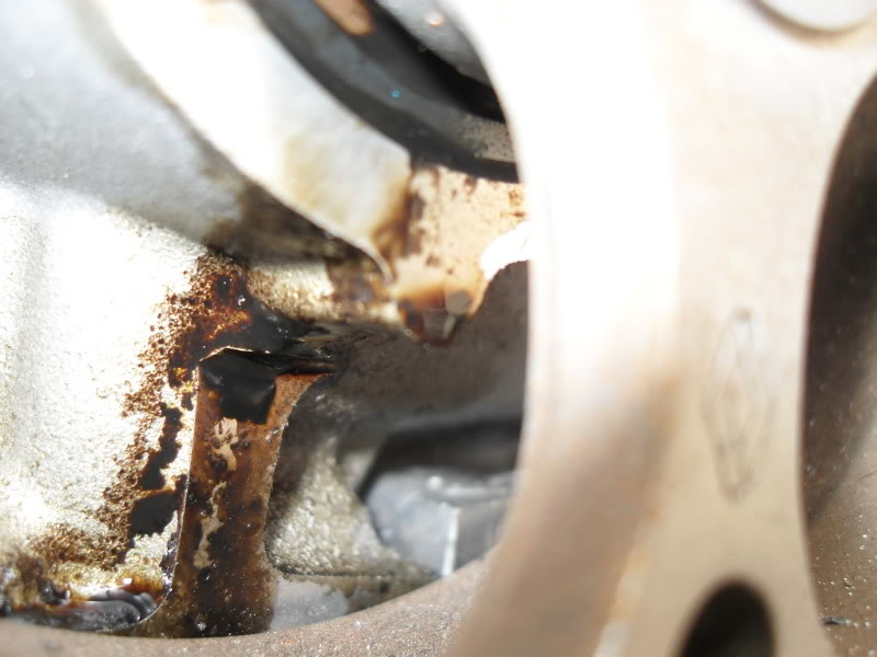

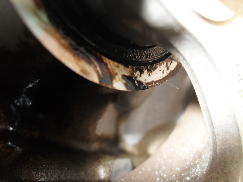

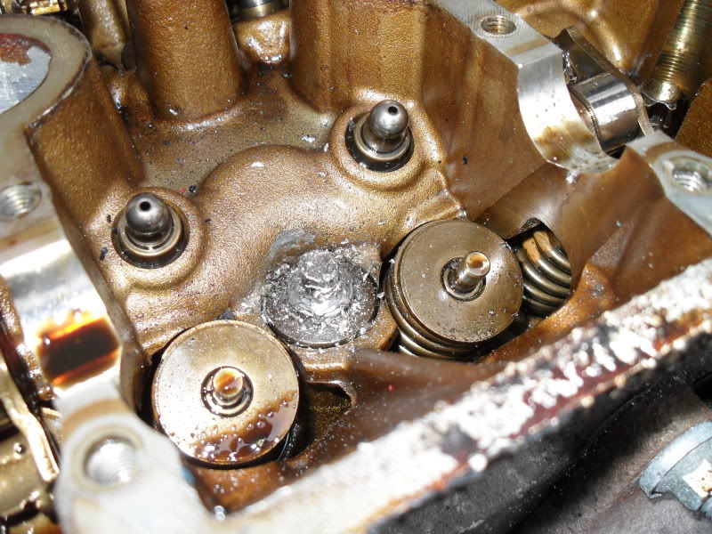

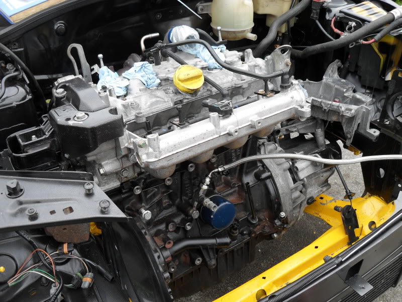

So I began stripping the F4RT 225 block down for the head etc. finding out the cam seals were knackered, Full rebuild it was!

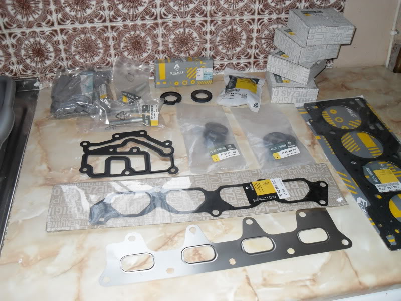

But no not so striaght forward as to make the 225 head work onto the block it need machining to take the pulley as the F4R block doesnt run the water pump of the cambelt. So on the hunt and fone calls i went, spoke to a few people in the know... but i was feeling this is impossible now... so i made 2 last calls... they both got in contact with a guy, minutes later i had a txt saying 'call me re 225' Straight on the phone i was to the man who knows his turbo conversions. hope was in sight!
So seconds later i went to renault to ordered all the parts we needed. nice big bill, but got them on trade so all is good!
Started to strip the head down, one headbolt was an arse and needed to be drilled out so new set fo drill bits and few hours later it was out.
Cam seals

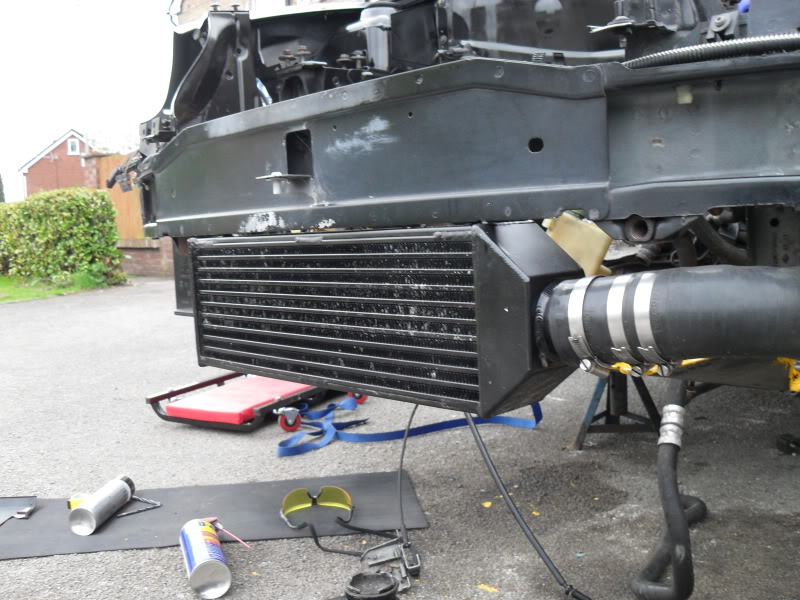

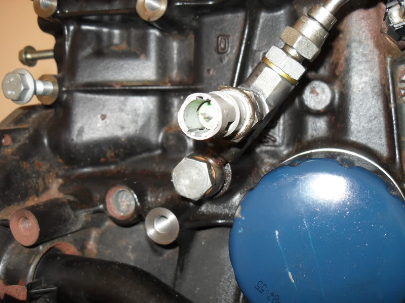

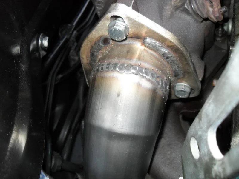

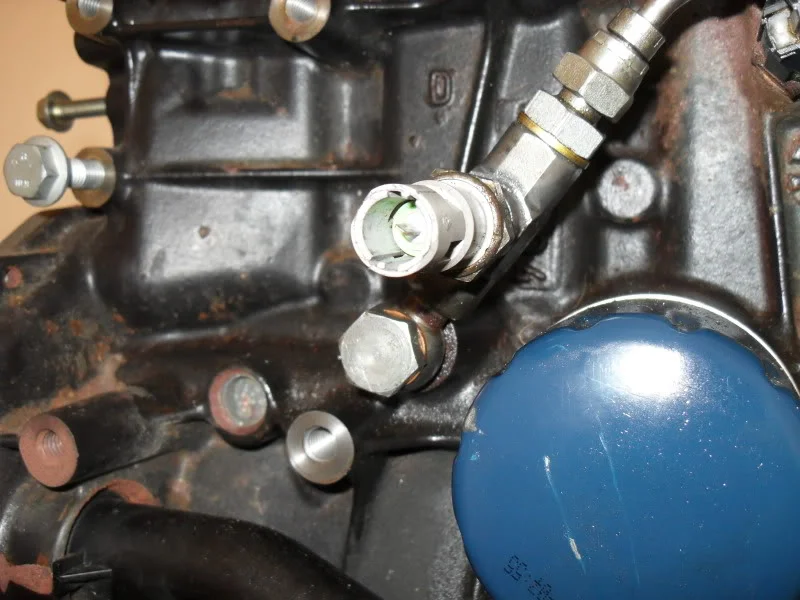

Then i need to source an oil feed kit, intercooler and more parts. Luckily someone was selling, so up to leeds i went.
Oil feed kit fitted.
Intercooler.
Fitted.

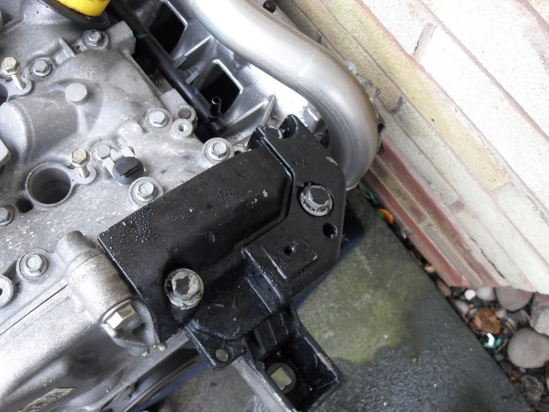

New engine mounts arrived.

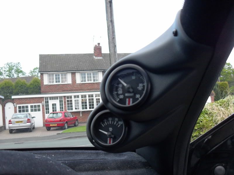

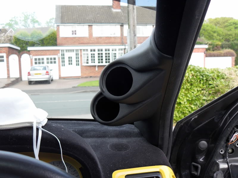

New gauges arrived.

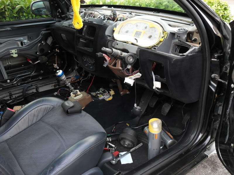

Started to refit dash.
Test fitted pods
wired fusebox back in

Then after a mega long day up north, We have a fully rebuilt engine, I cant thank the guys enough for all the work, info and help they have given me ( you know who you are ;) )
No pictures of the engine rebuild as i was learning too much and all the info going in and the rig up drill we used :D and the laughs.

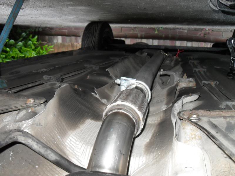

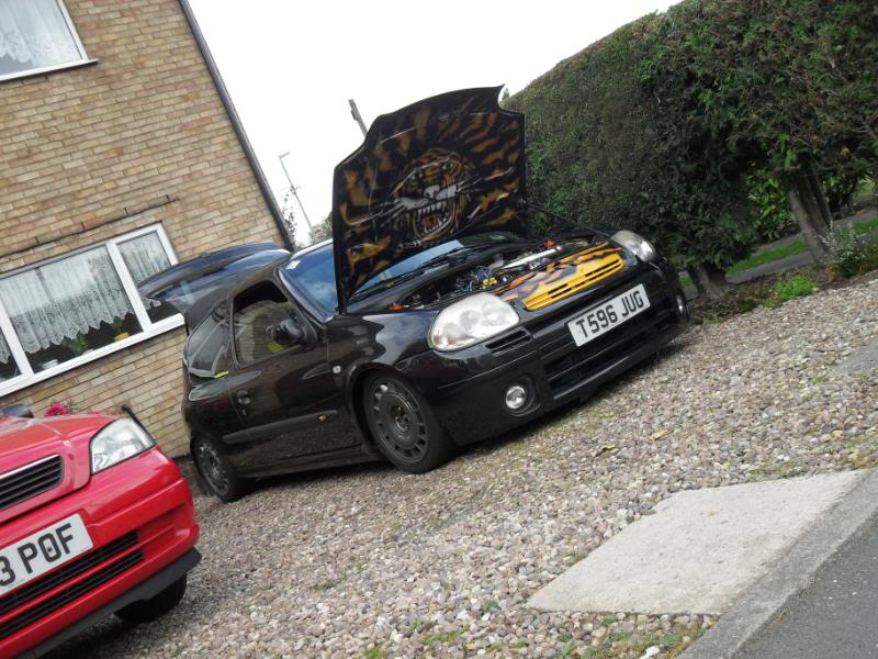

Day after It was time to drop the engine in so i could send it off for the exhaust! Will have to come back out as im changing the box so it has a speedo drive in and paddle clutch to fit :)
Day started like this
Put the box on, dropped it in.
The tiger is back, as i like to be different :D

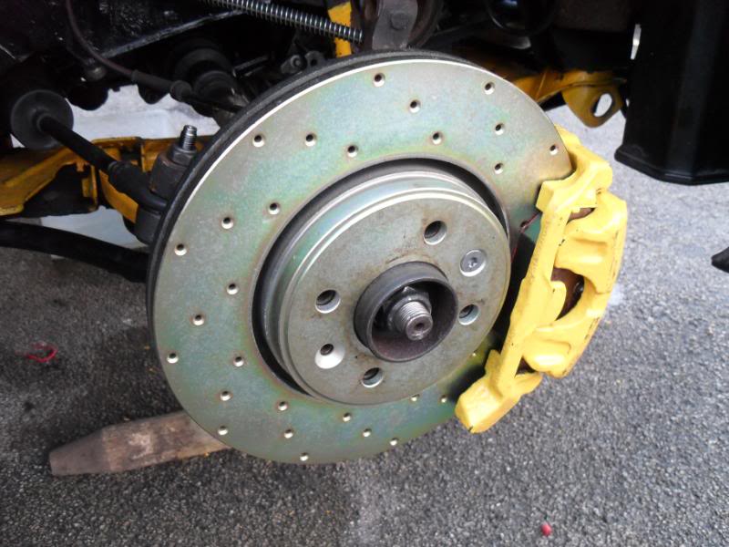

New brakes.

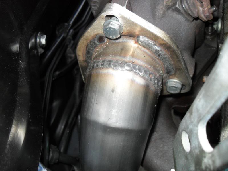

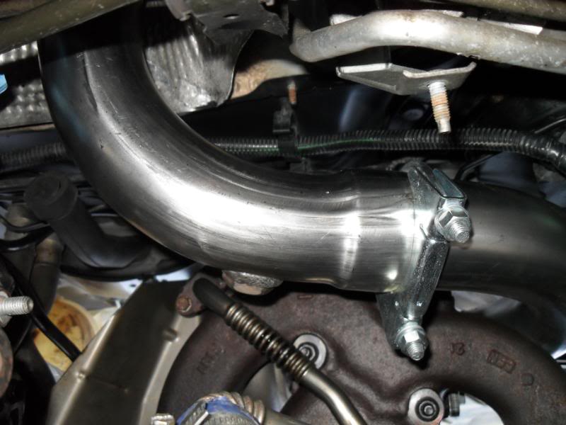

Car is currently on 4 wheels and having the exhaust done. more parts ordered.

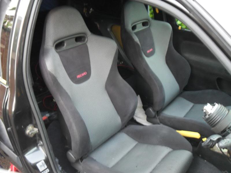

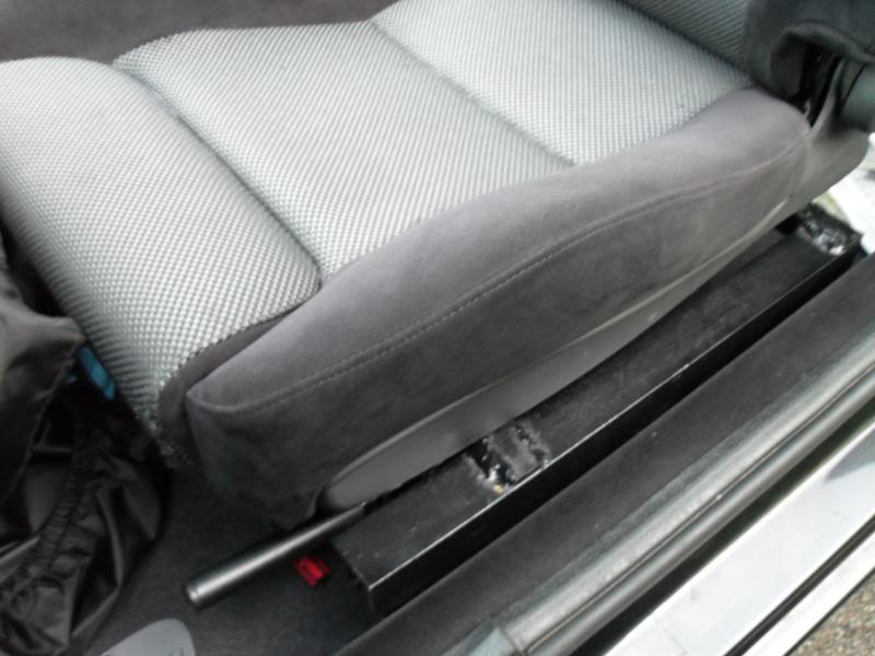

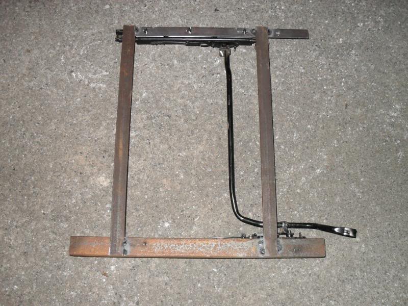

Also i picked up some rather nice recaros from a good mate :)

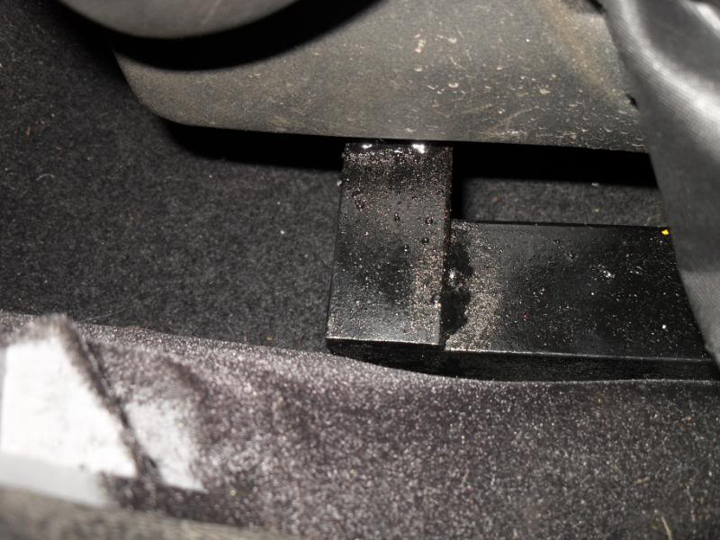

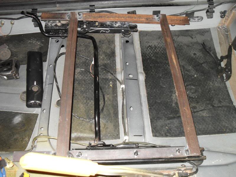

so to get them to fit i called good old matty! nice one kid!!!
started off as normal runners, then welded new bits on
Then a lick of black paint.
And they are in

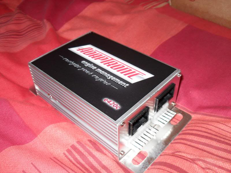

Some more goodies. stand alone ECU

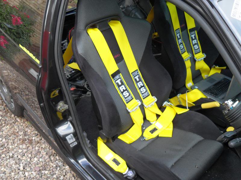

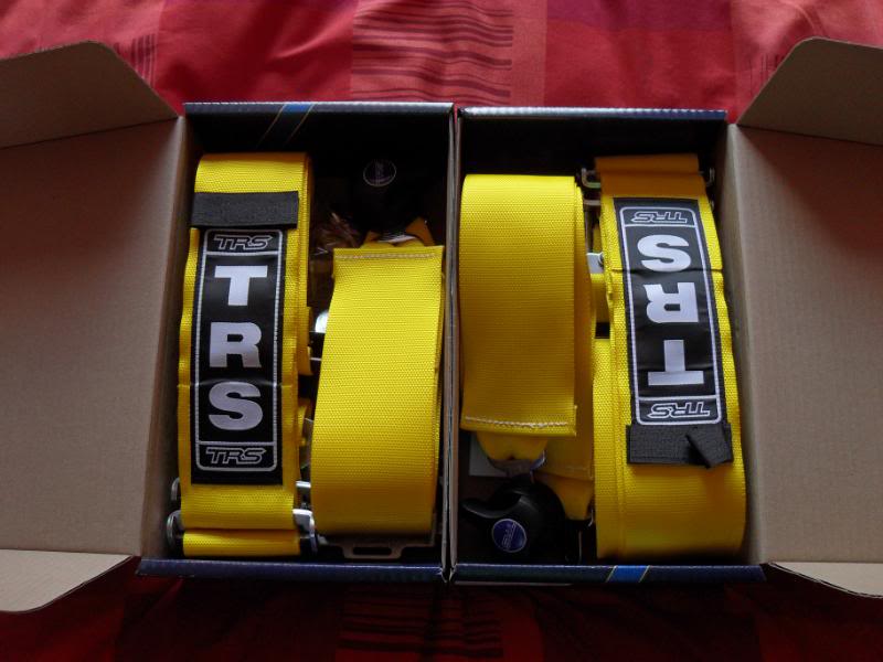

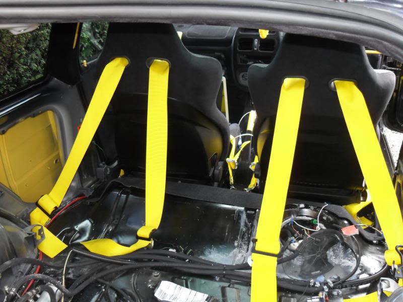

3" 4 point TRS harnesses

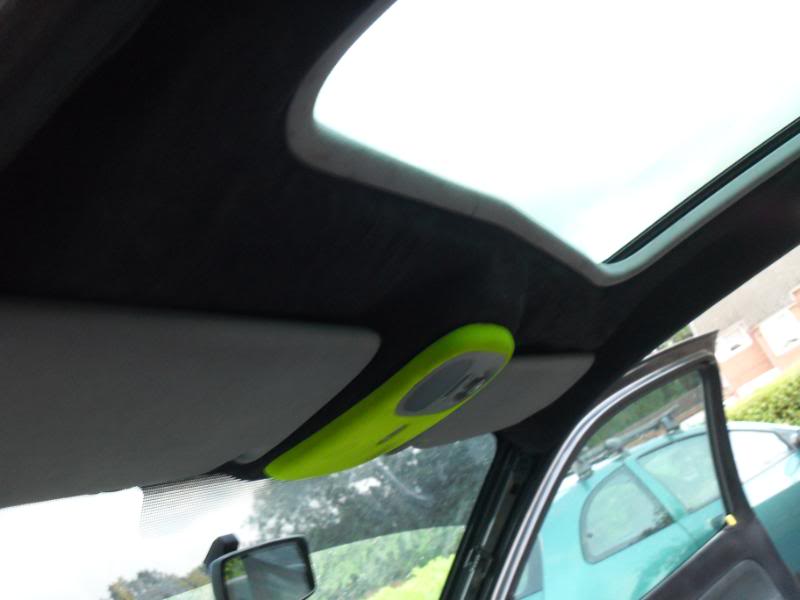

Also retrimmed the headliner thanks to sarie :)

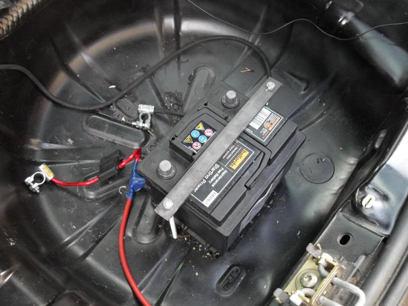

Battery relocated

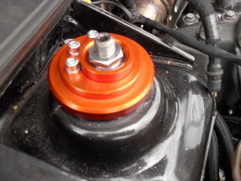

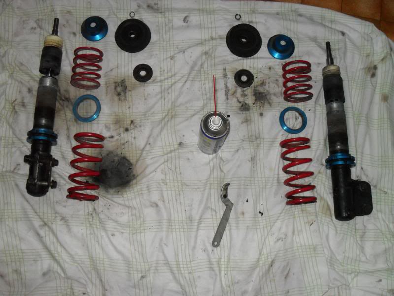

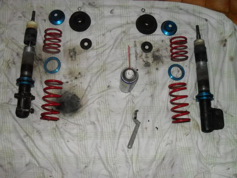

Coilovers were stripped and cleaned, and rebuild with AST full adjustable top mounts
then fitted to the car

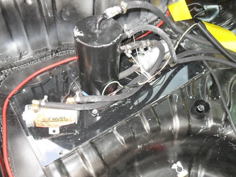

New fuel pump setup, pickup pump, swirl pot, another pump to engine, Nice one andy :D

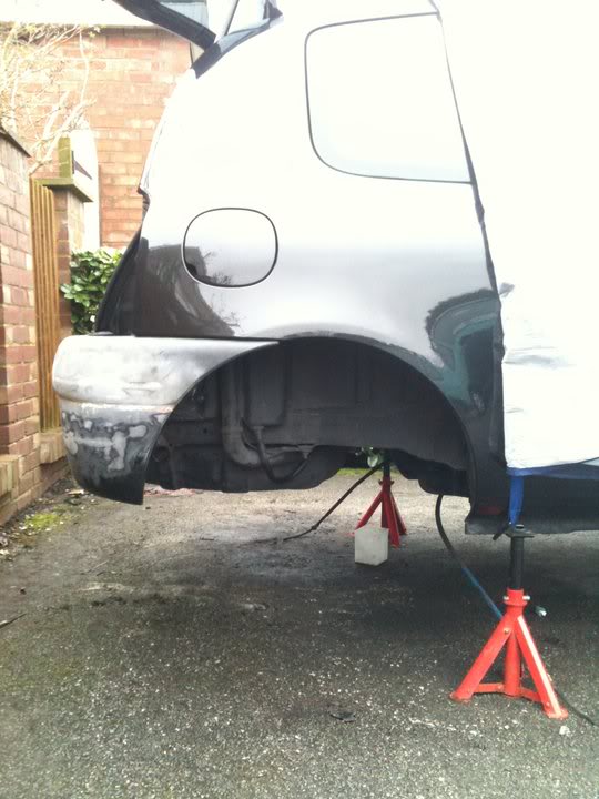

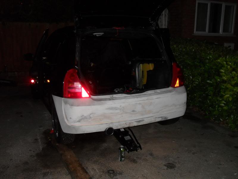

New rear end, from a 182, which was smoothed, palstic welded and its and bobs,
trial fit
so then off to the bodyshop at midnight, to crack on, all prepped etc and then sprayed he next day, then fitted to the car, no pics tho as i forgot to get any lol!
then harnesses fitted

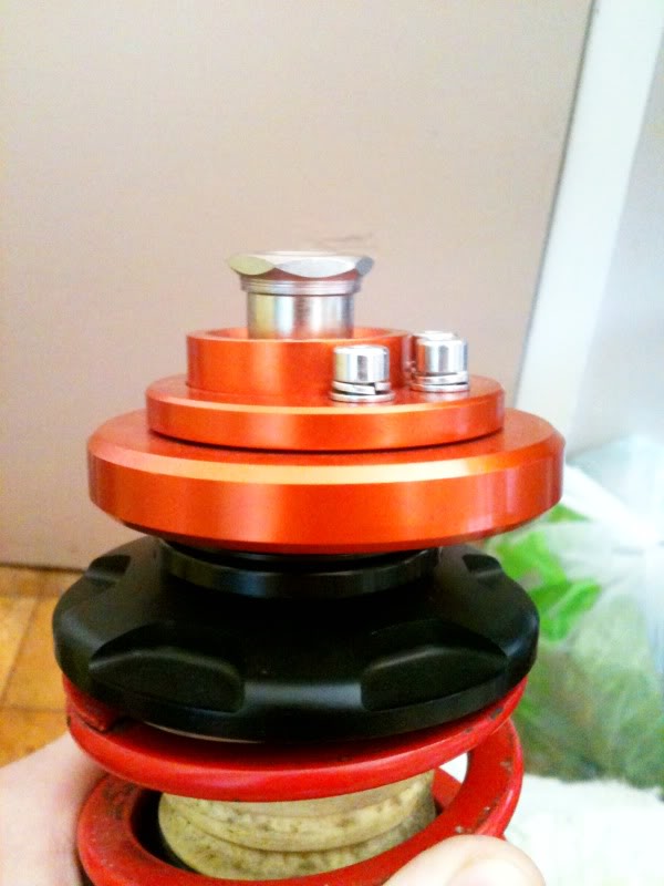

Looks brilliant mate! Must be a machine! Are the top mounts ment to be on wrong? Lol
On wrong? on the car you mean? they were just like that when i took the photo, i think they are sat correctly now, but i havnt no idea?
can you advise me on how they should be?
cheers
cheers
The big orange bit that the smaller skrews into is ment to be under the car in the arch. And the smaller bit bolts down on top. I have pics of them fitted on my car in my thread if you have a look to compare them :)
Ohhhhh that makes more sense, i was having trouble with them!!! cheers dude, i feel a right dick now!
many thanks dude :D :D
