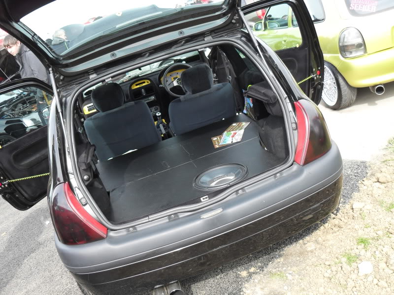

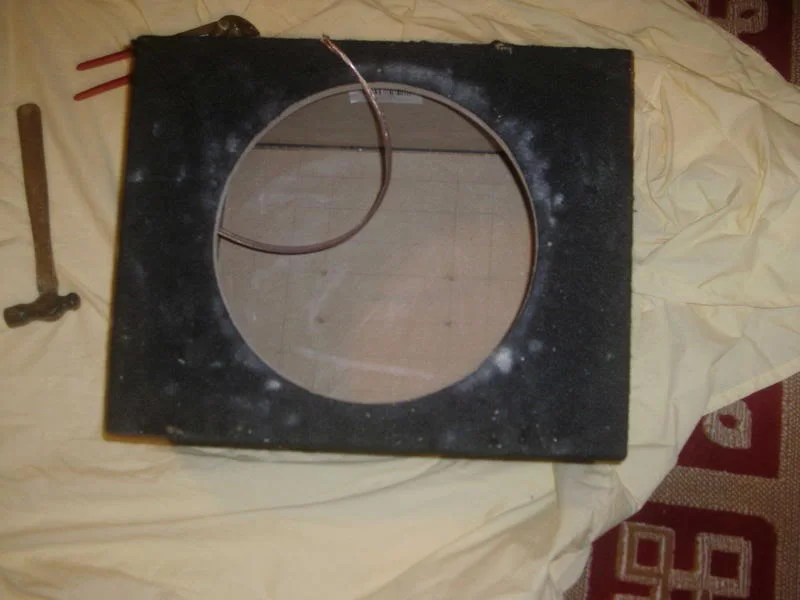

1st i retrimmed the sub box.
Before
After

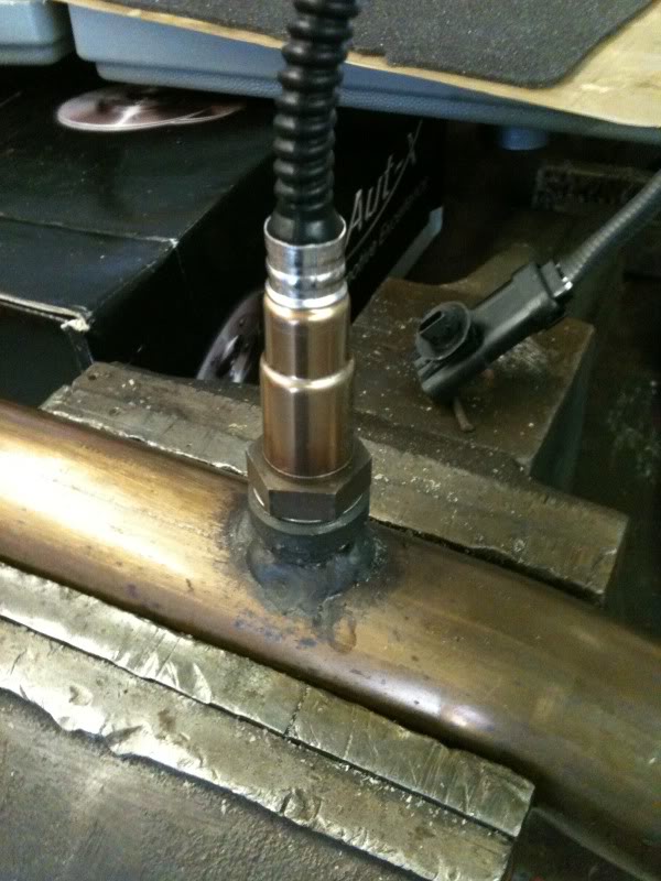

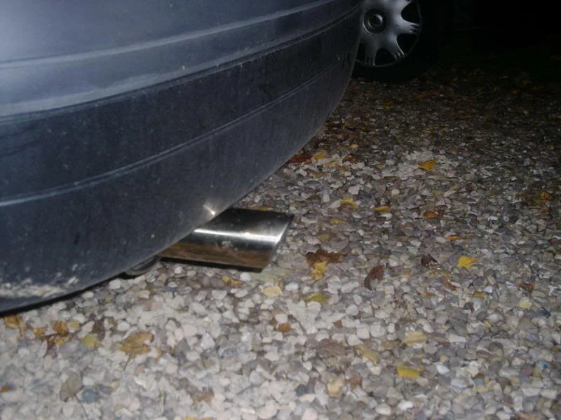

Then took my exhaust off my old one which was a b**ch to do.
then put it on my new one :D

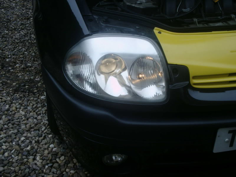

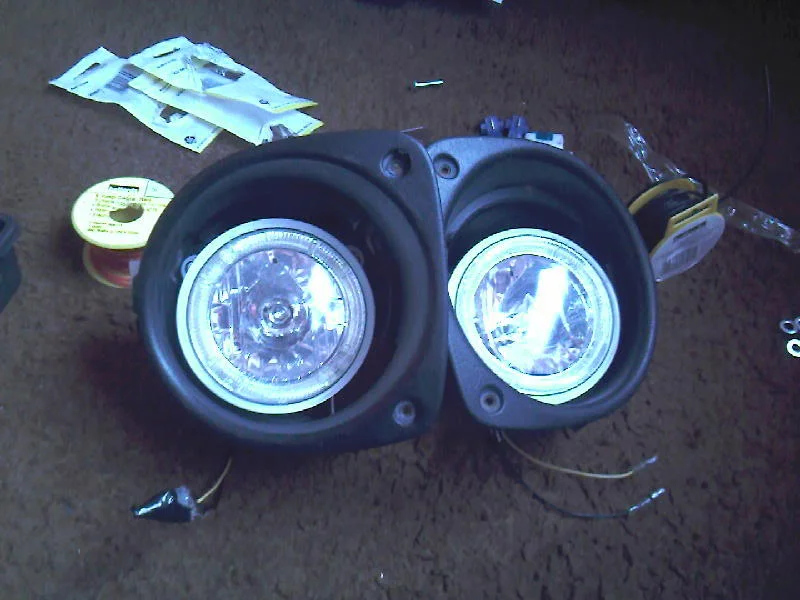

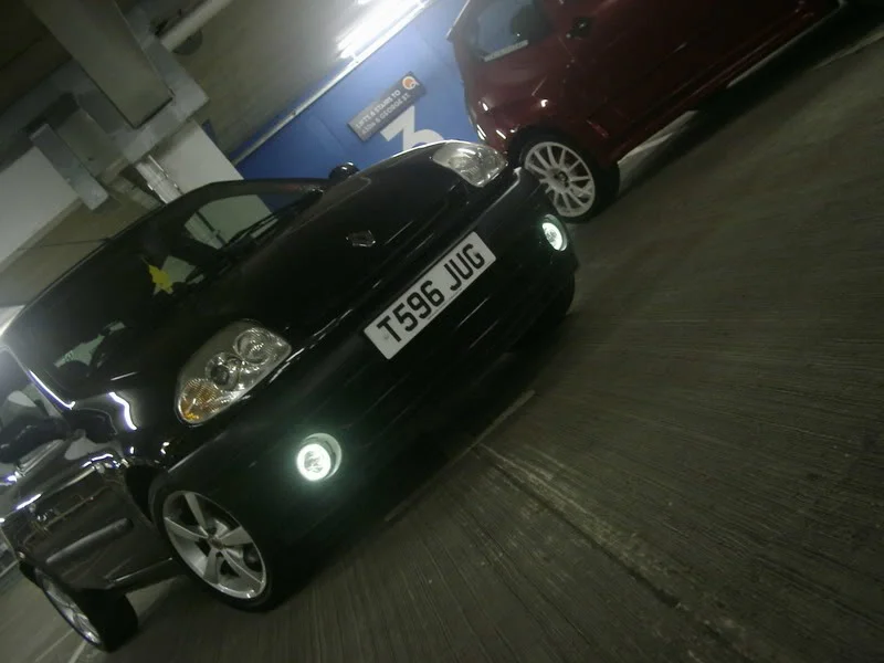

but in the mean time, i stil have my angel eye fogs off my old clio. so i thought might aswel whack them on the new one.
So I made new brackets for them and put them in the surrounds
then popped to work to get a few bits and pieces

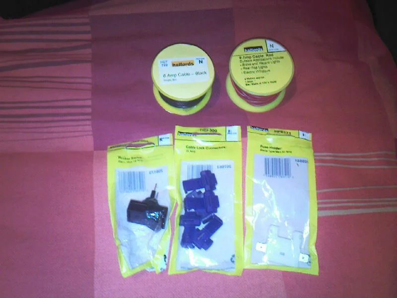

Need some of that as im making my own small loom instead of using the one that they come with.

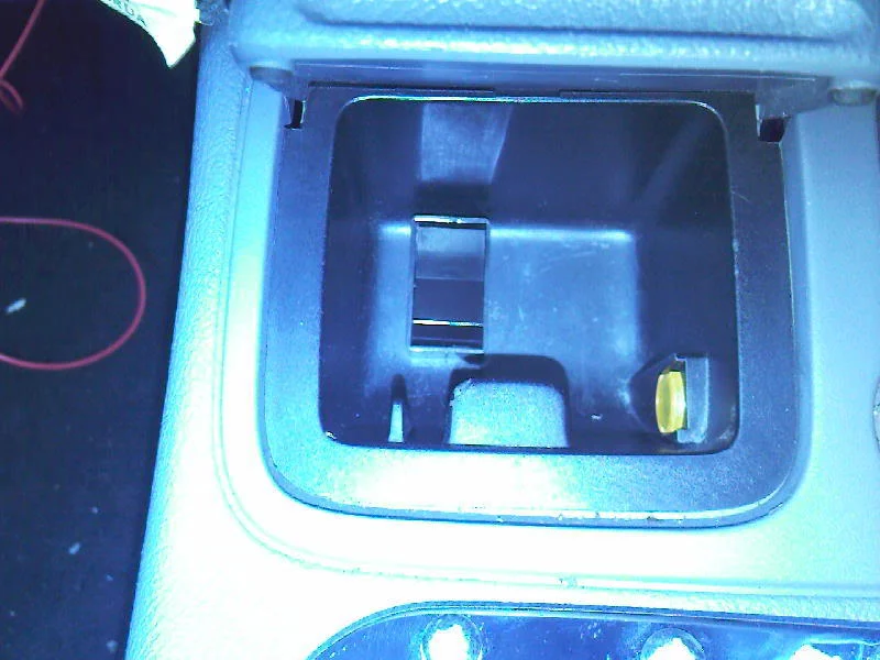

Switch in place.
Also when i popped to work i ended up gettin this too

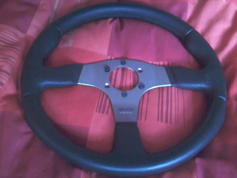

A momo race wheel for £12 gota love workin on parts there.
Anyway Finished my fogs :D
Took a while as i kept running out of things.
Hid the switch in the ashtray.
got them all wired up so the fog comes on with the stalk :) and the halos on that switch.

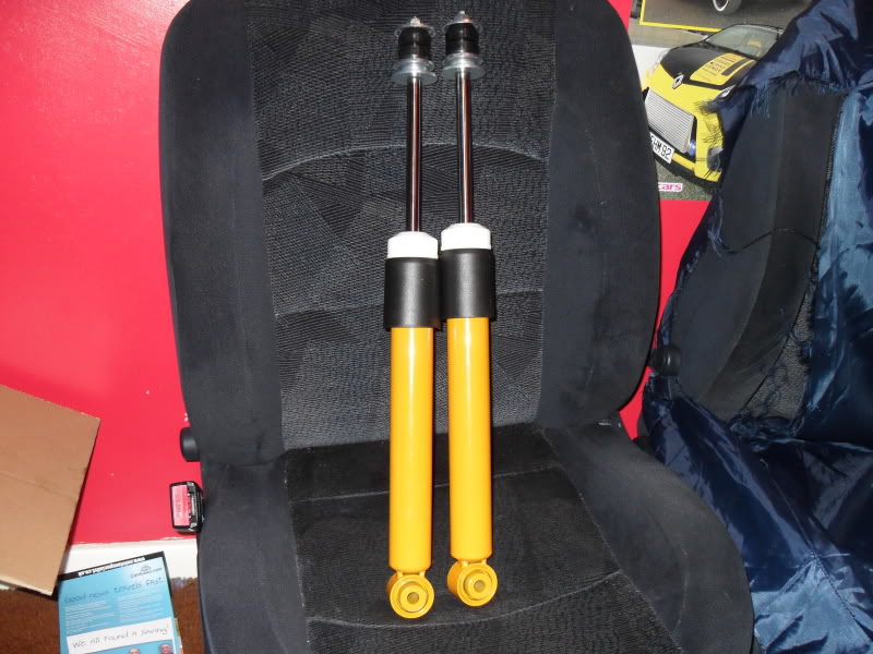

[FONT=Times New Roman]Got these last night.[/FONT]
[FONT=Times New Roman][ATTACH=full]737588[/ATTACH][/FONT]
[FONT=Times New Roman][ATTACH=full]737589[/ATTACH][/FONT]
[FONT=Times New Roman]Fitted them today.[/FONT]

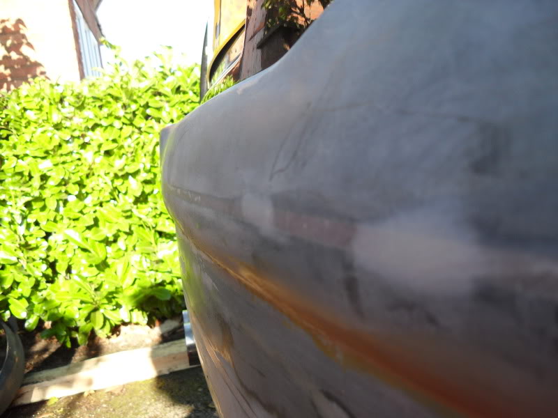

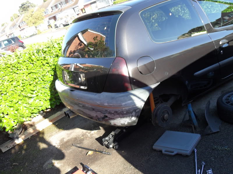

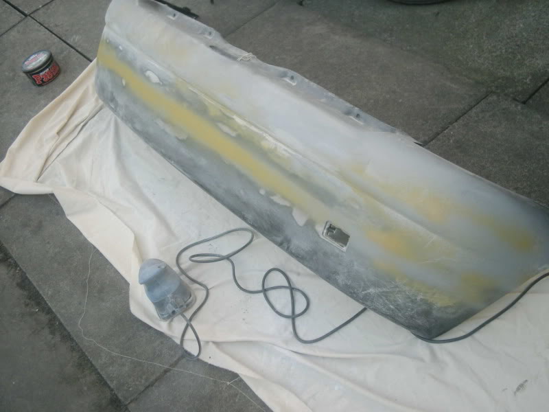

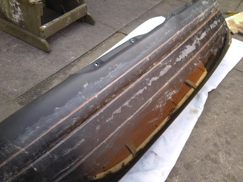

I bought another bumper for cheap as im smoothing it.
1st layer of fibre glass
Its sanded down now ready for a skim of p38 and then paint.

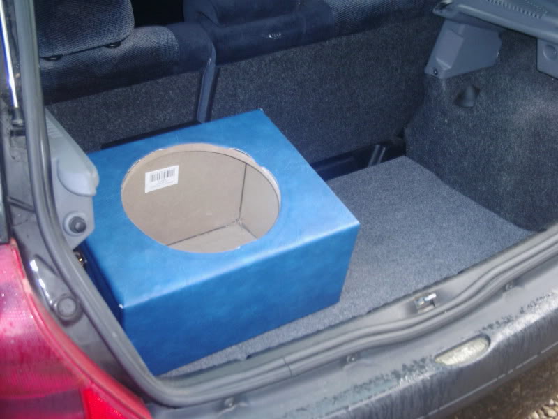

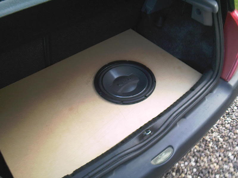

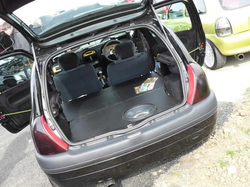

Then i got bored and changed the way my sub was.
from this...
To this
Just need to make some side for it and then carpet it.

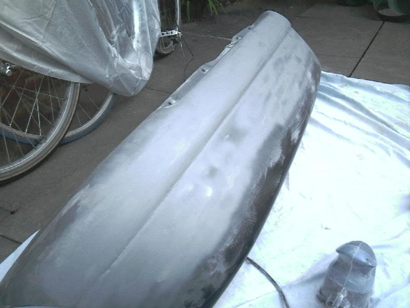

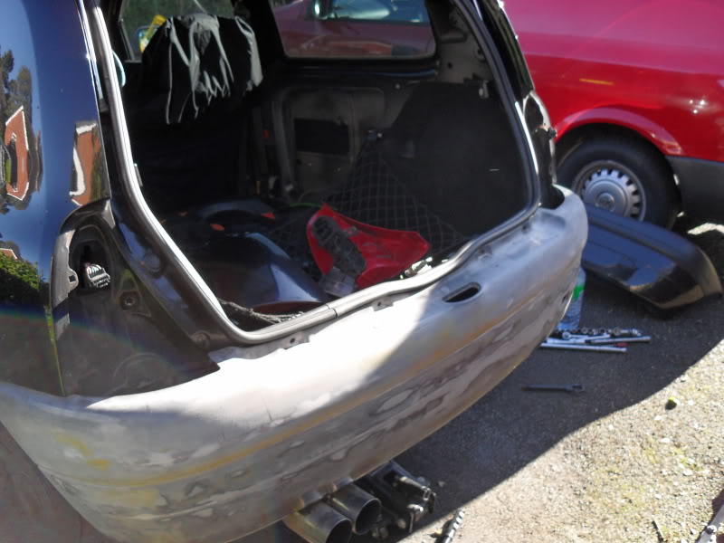

Also did some work on my bumper.
Shot some primer over it to see the flat spots. bit more filler here and there and then its ready for paint :D

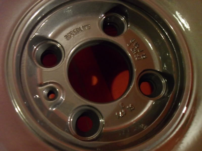

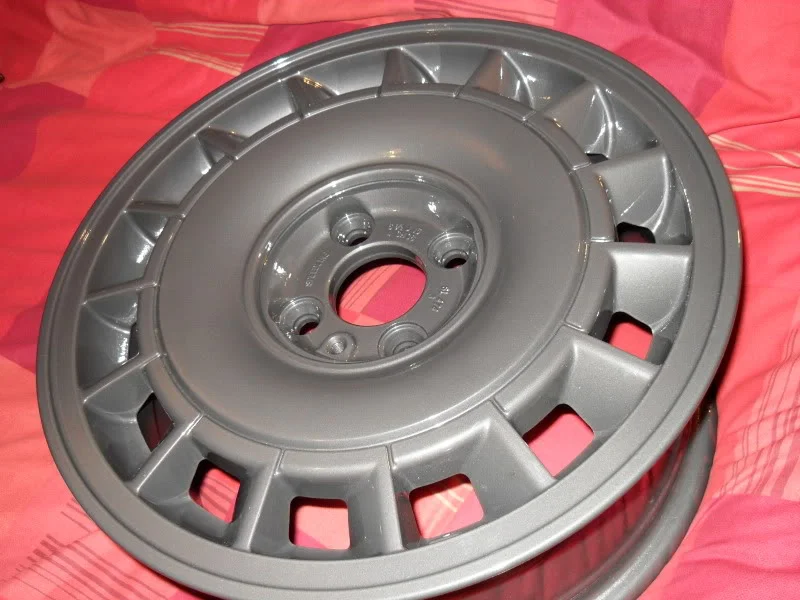

Plus i sent my wheels off today for a refurb :)

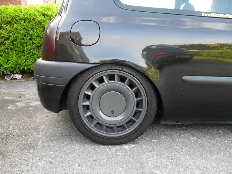

UPDATE 30/6/09

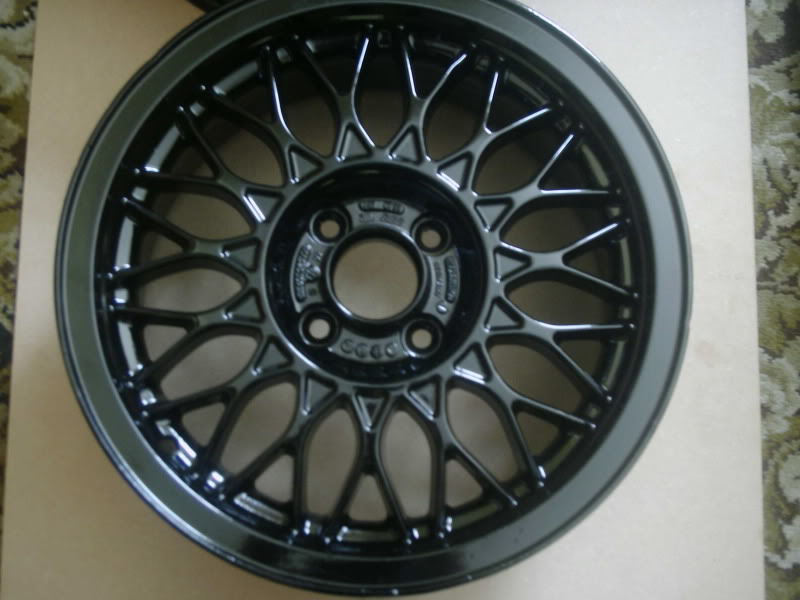

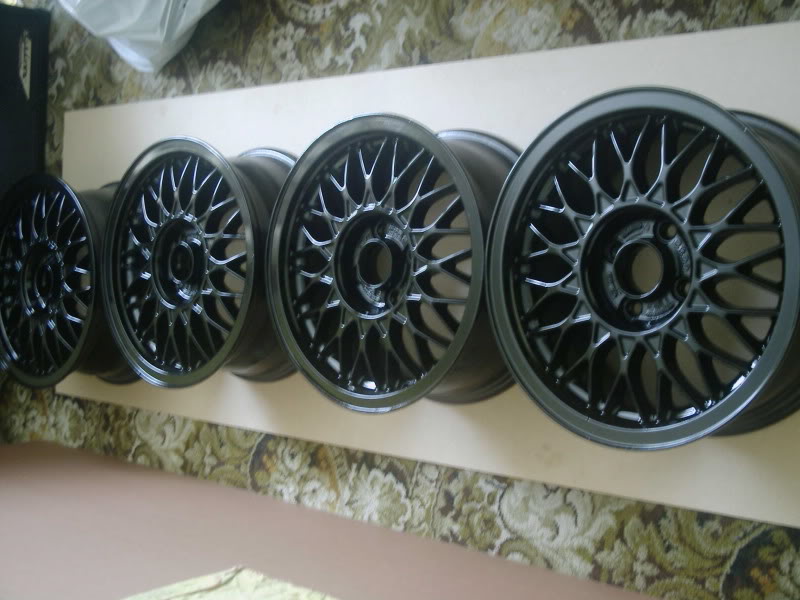

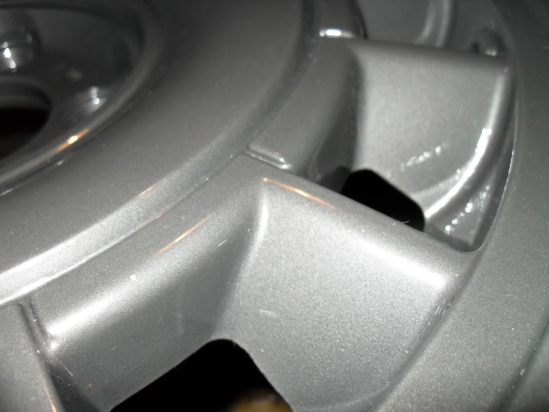

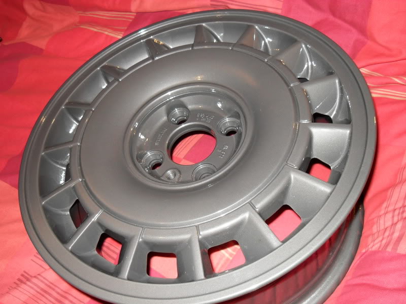

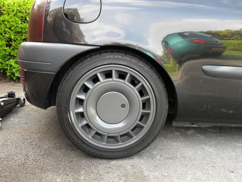

Well after about 4 weeks i have my wheels back after them been redone 3 times as the quality of service was shockingly poor. They came back with very bad paint, dents in the lip still, chipped paint from where they have been stored at the place, and as i kept going in i got the same excuse very time, in the end i lost my cool and took my centre rings back as they have been wrecked.
Anyway pictures of the wheels atm
I think im gona sell these as the money i need to spend on getting them how i want i could get a better set of wheels.
Also ive done a few small touches.

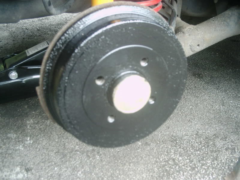

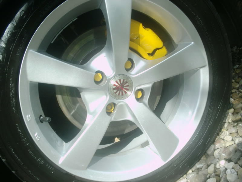

Drums painted
Calipers and wheels nuts painted.
Also the bumper is coming on now smooth, just needs abit more touching up but no rush :)

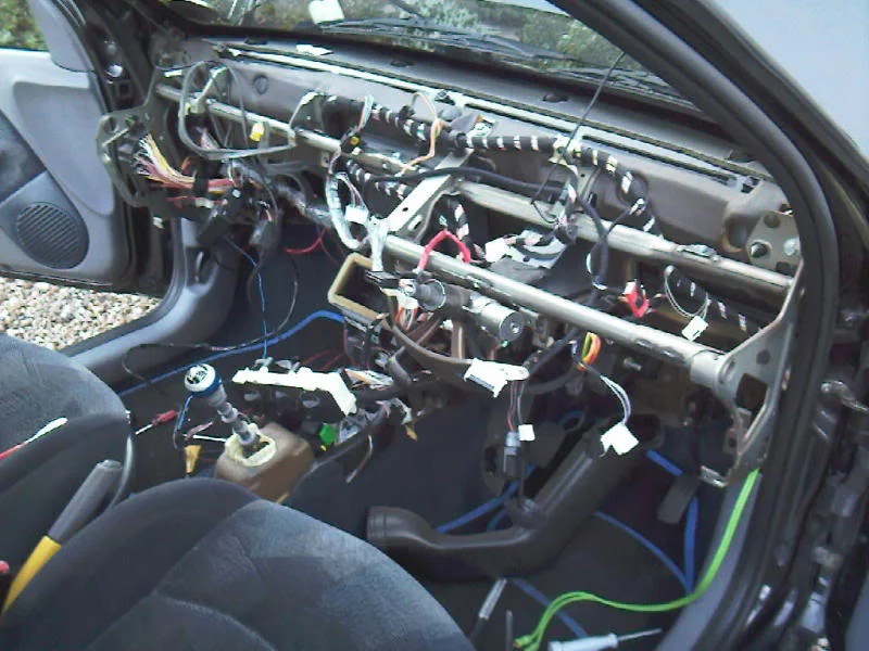

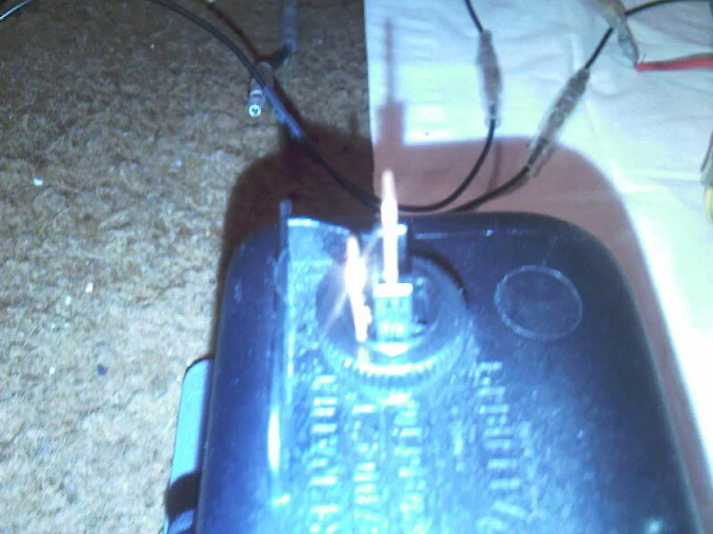

UPDATE 15/09/09

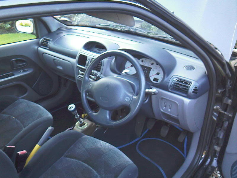

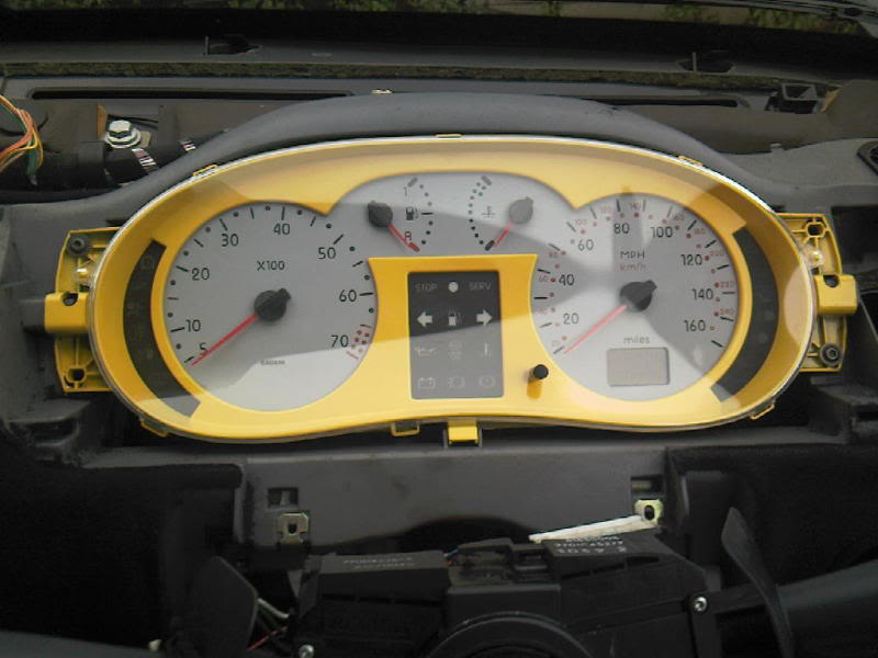

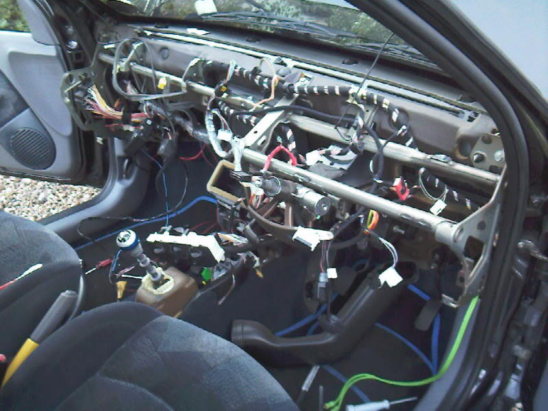

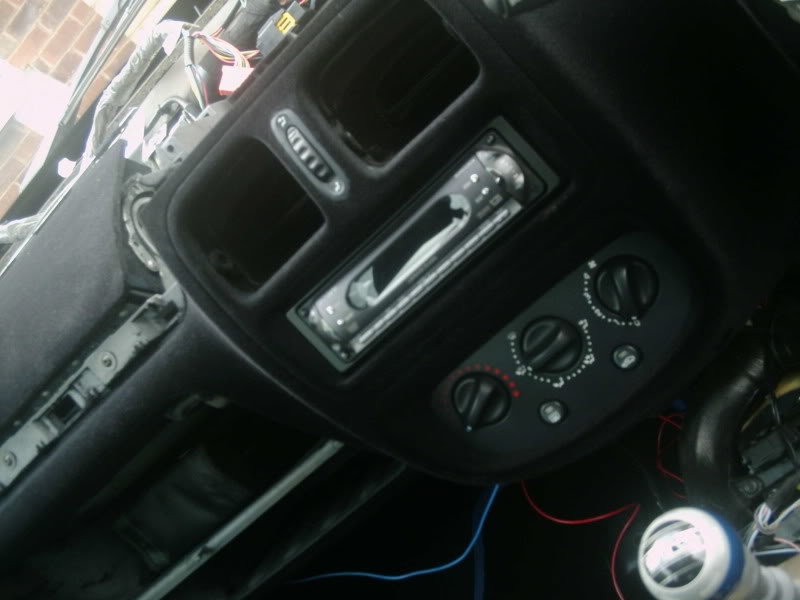

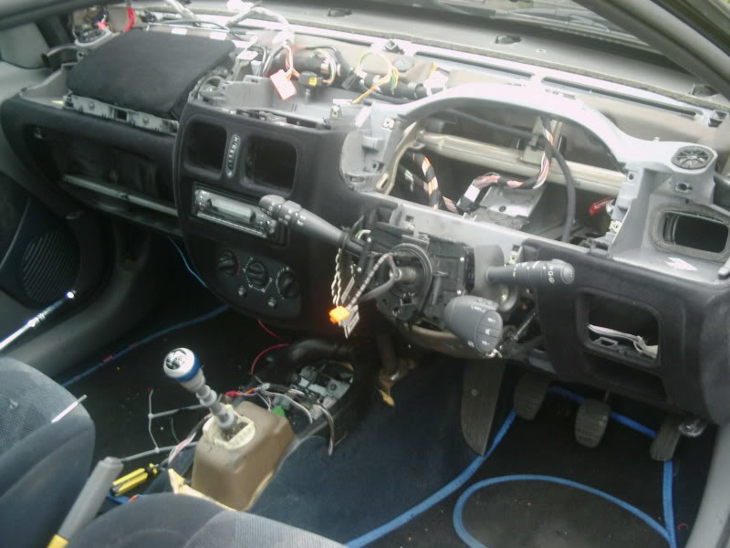

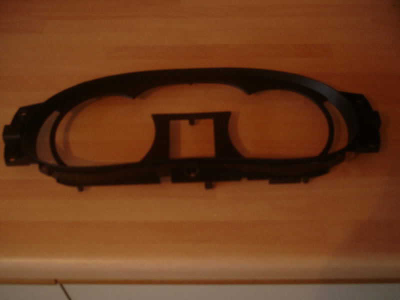

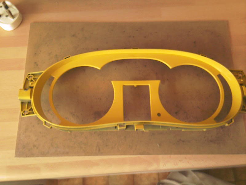

Forgot to update this after trax, anyway While my dash was out i started doing a few touches :D
Speedo before.
During.
After.

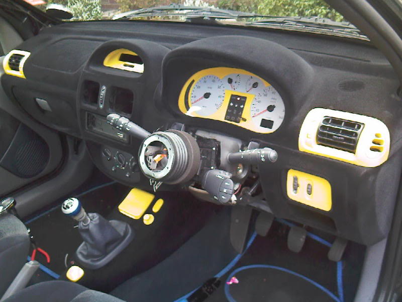

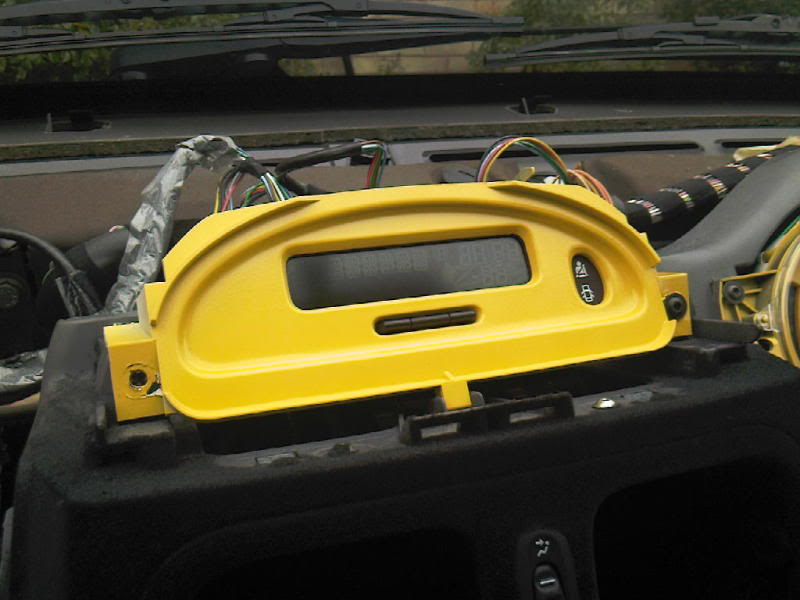

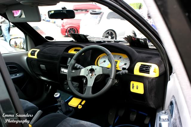

Also i painted the clock, air vents, Central locking button, hardazd switch, and tons more yellow as you can see :D

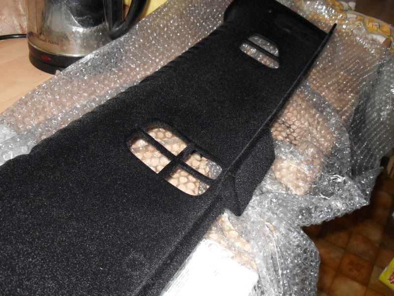

Started to refit the dash, which i had Flocked :D
Dash nearly in with boss kit on etc.

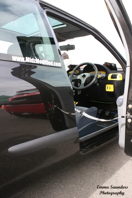

the finished thing at trax. Big up to Di for taking the photos, cheers :D

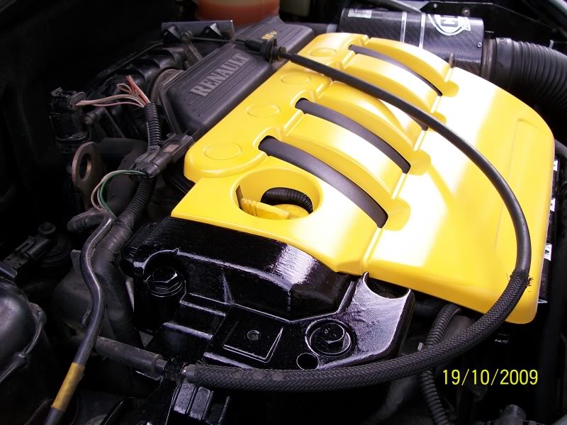

UPDATE 19/10/09

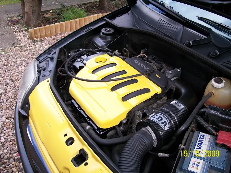

I have been searching for a set of these for months on end, but at last i got some. :D
They are Renault turbines, they came on the mk1 clio vavlers etc. Not to everyones taste but i love them, and they will do until i can afford my wheels :)

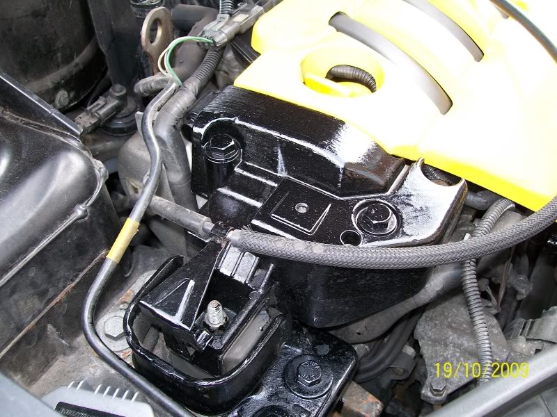

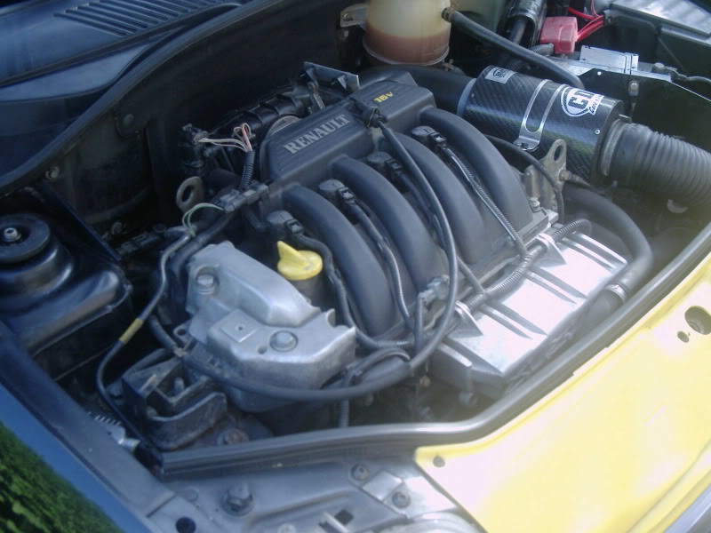

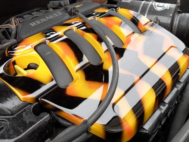

Also ive started painting and tidying up my bay :)
Before
Painted the engine mount and cam cover.

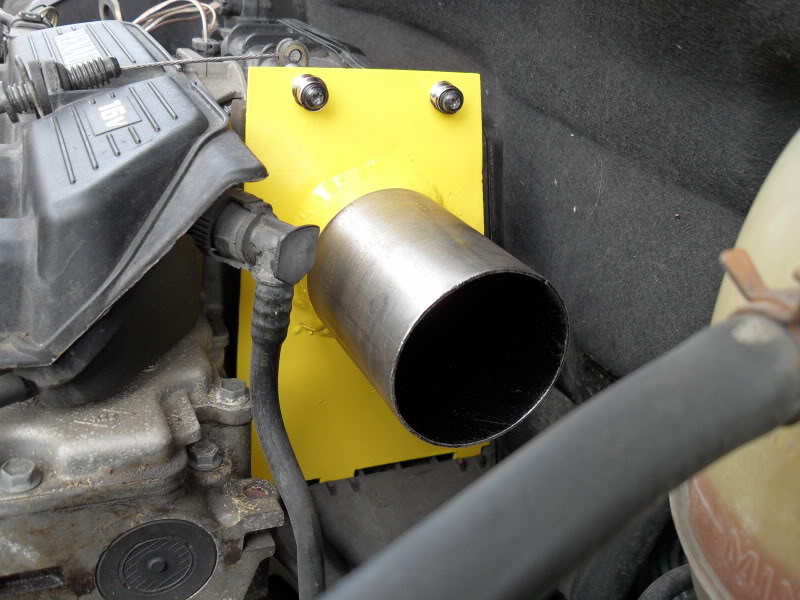

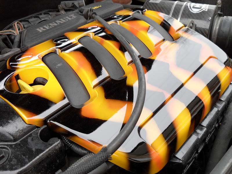

Also got a engine cover which i sprayed yellow.

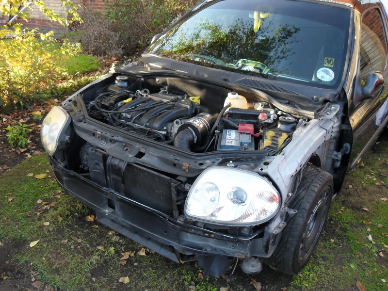

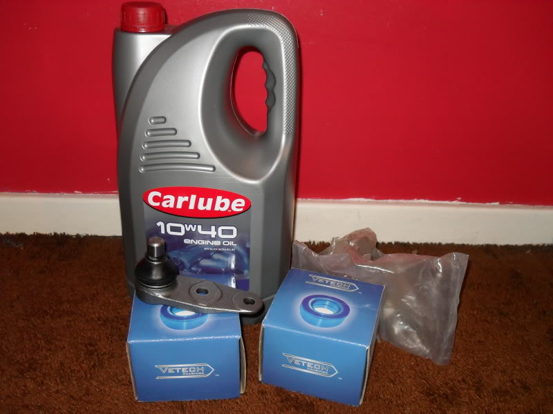

1st things 1st, getting the car running right, so i ordered 4 new wheel bearings, still waiting for two to arrive though, new oil and new lower ball joints.

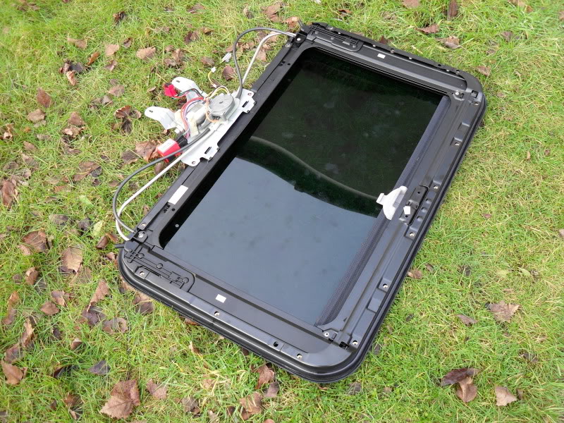

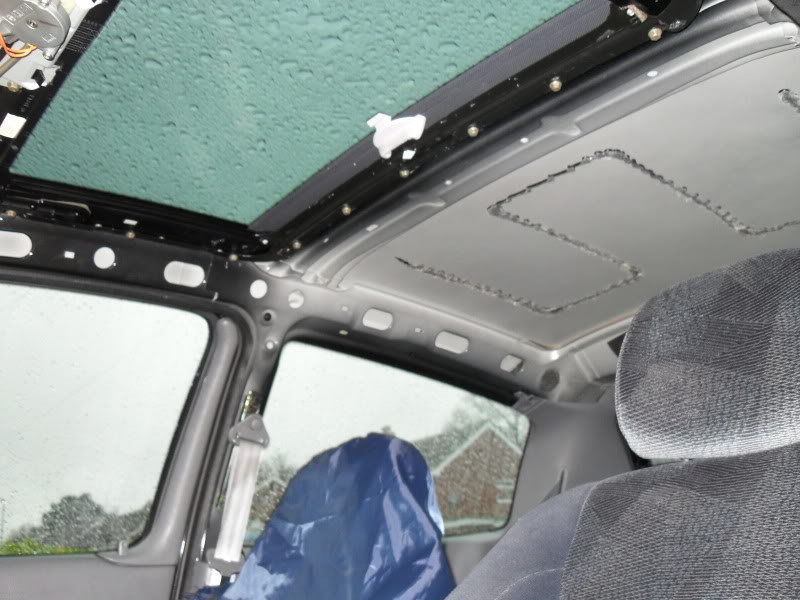

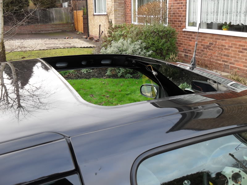

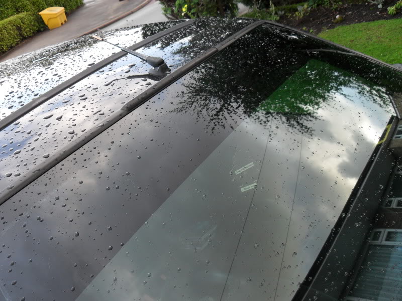

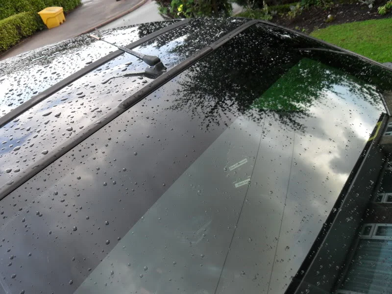

also my sunroof was leaking quite bad(common thing on clios)
So whipped that out and resealed it.
Might have to redo it again but we shall see.

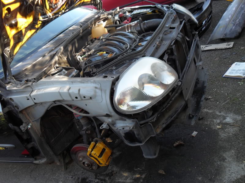

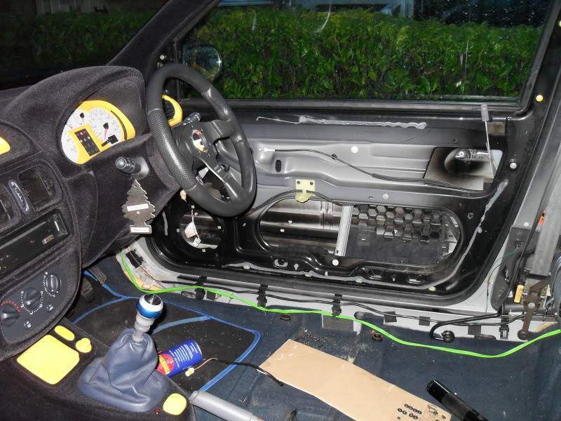

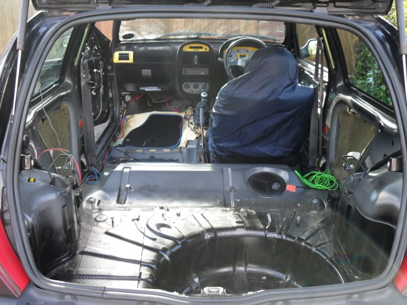

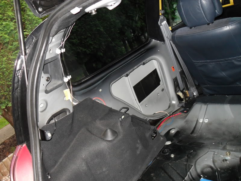

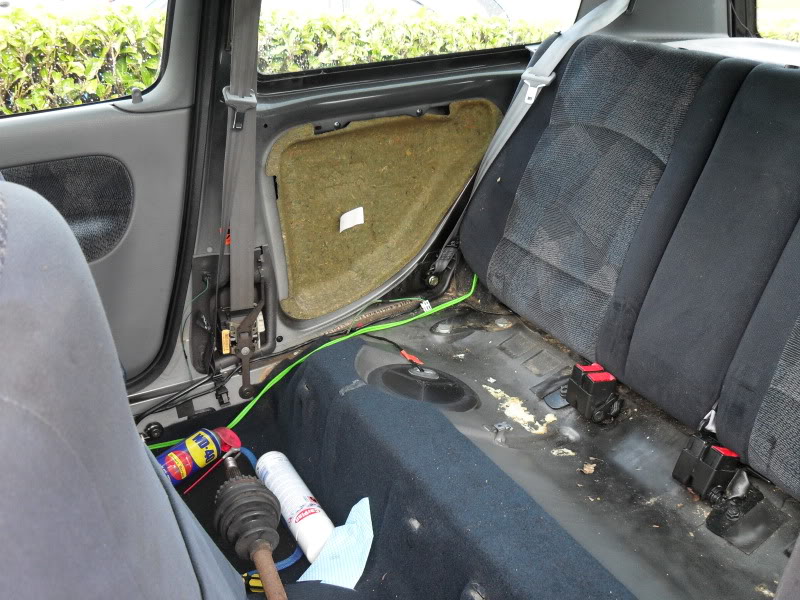

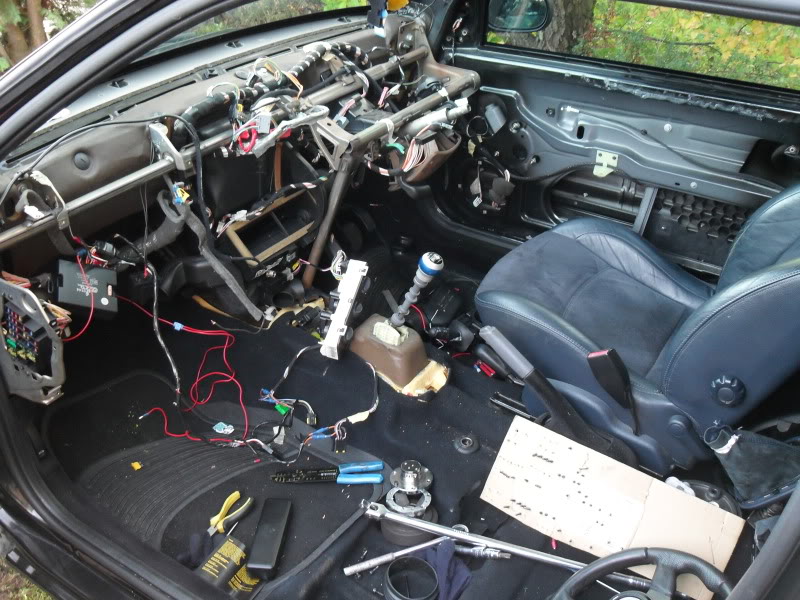

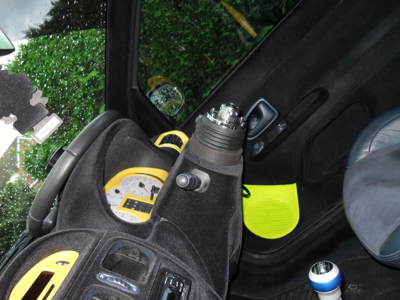

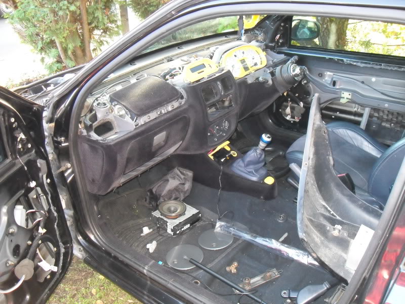

Also ive started stripping the interior out, to be sent away and have done ;)
Roofliner and back plastics out, Also rear seats out.

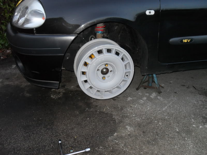

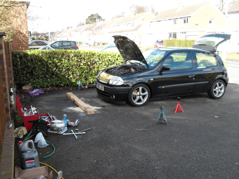

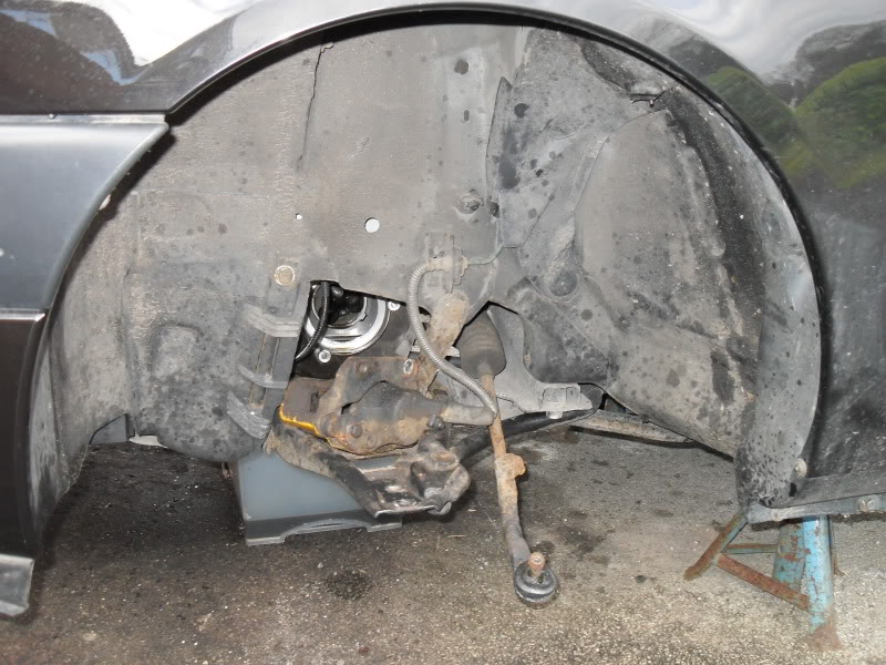

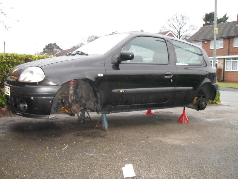

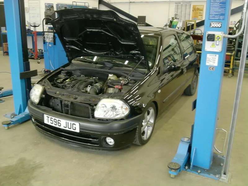

After this today i decided to get to work.

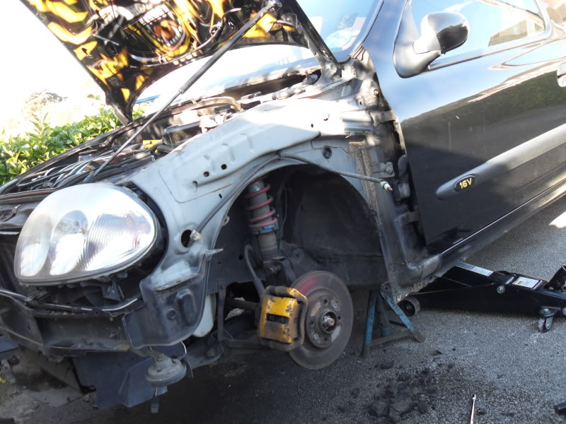

All wheels off, front pads, disc and caliper off, and also TRE taken off, Ready for the hubs to be popped off and driveshafts to be replaced.
However i snapped a tool so need to get another to carry out, and need to get some rounded bolt, screws out aswel, shall do that tomorrow.
Current state of her.

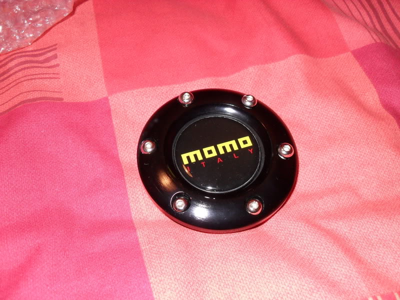

Oh and my long awaited horn button turned up!
Once all of this has been taking care of i can start on other bits

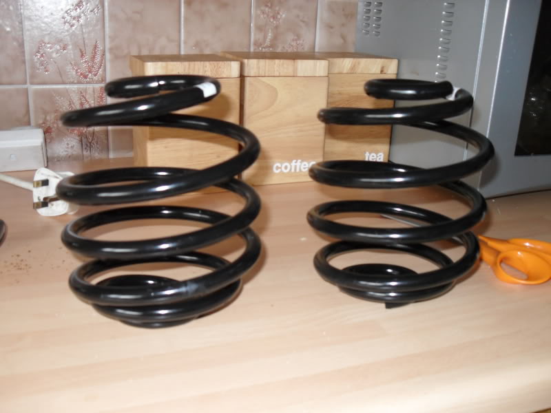

Get custom springs for the rear made.

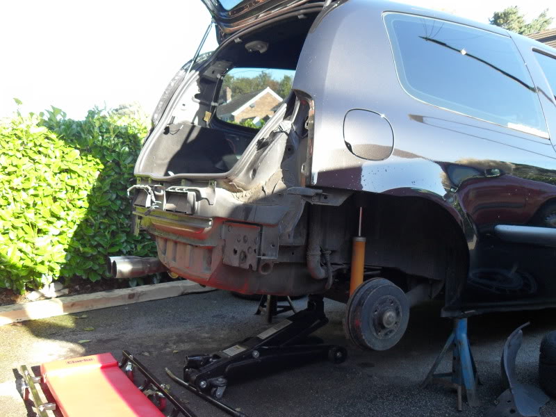

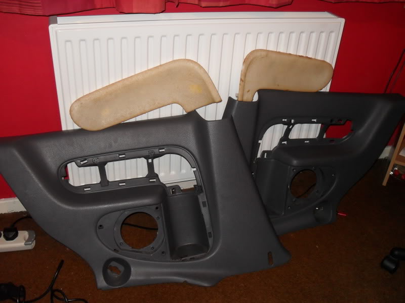

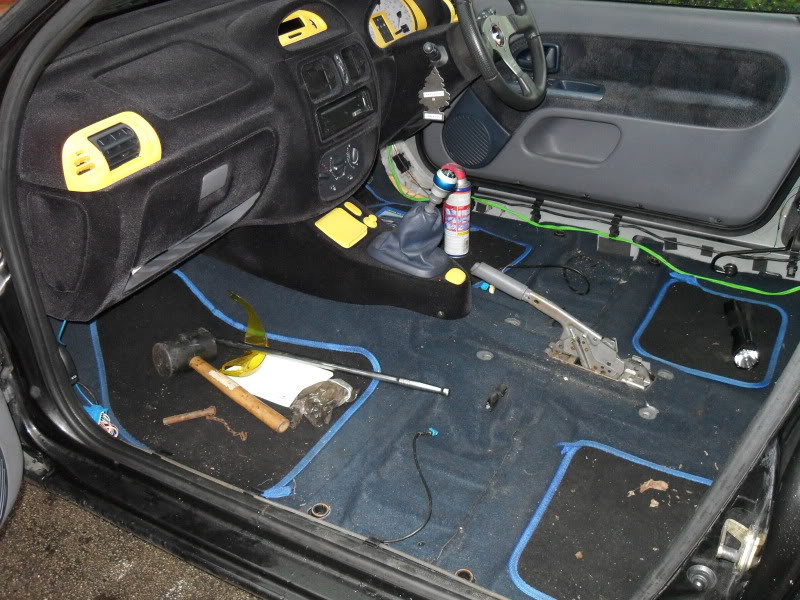

Havent done much the weekend but The rear doorcards are now out and been stripped ready to send off.
front and rear seats will be coming out next week hopefully so the carpet can come out too.
Read hubs have being taken off, just need to replace the bearings in them, Front hubs will be off as soon as ive drilled through the rounded nuts/bolts.
Bad news though, while i was working at the back of the car i realised somthing wasnt right with the suspension, Seems the Damper has slide off the rubber mount which keeps it attached to the axle, so ive emailed the place where i got them and hopefully New ones will be going on. fingers crossed.

The interior has now been stripped and just prepping last few bits before it all gets sent off.
Oh and these arrived the other day fresh from Vmaxx, i hadnt even spoke to them but onyl to speedbox, good service or what :D
Seats out

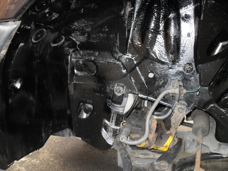

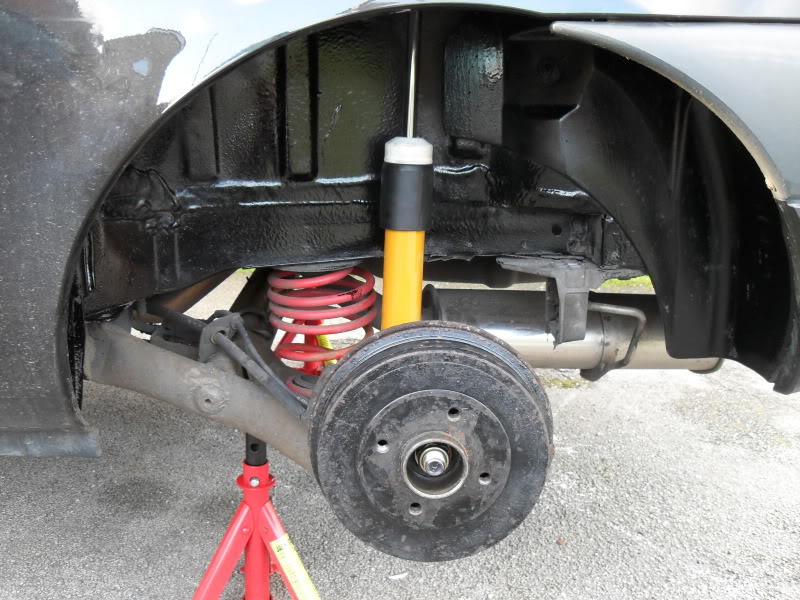

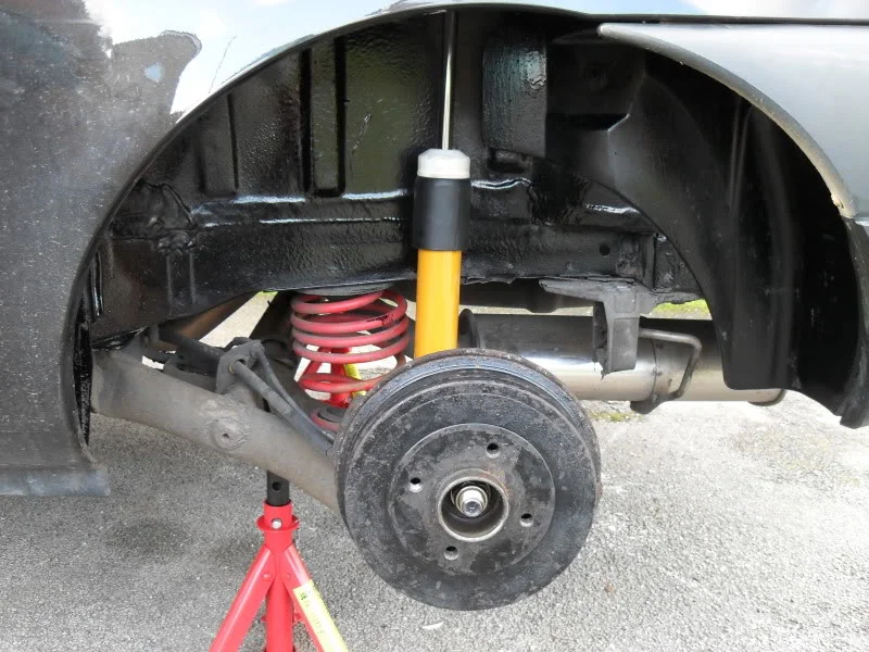

Then Cleaned and painted all the wheel arches, fitted the new dampers and then Build the rear brakes back up :)
Before
After
Rear painted and brakes and new dampers back on.

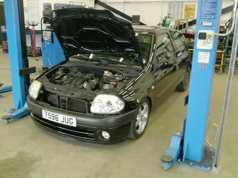

Update 16/02/10

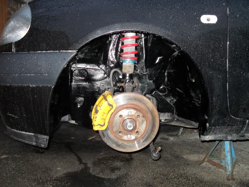

Built the front up, new lower ball joints, cleaned and painted coilovers, set the camber up, new driveshaft on, new wheel bearings in. Fresh gearbox oil, and topped up the engine oil.
Front
Then today just after 12 she started first time, its being about 3 weeks since i last started her up and drove her.
How she is rolling atm until the interior gets done. 1 Seat FTW!

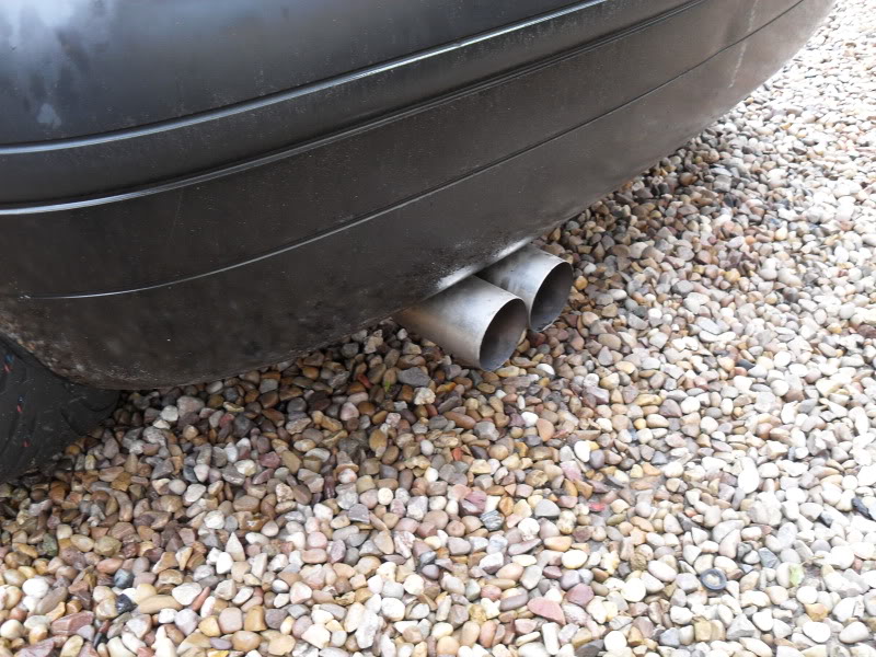

Then today i took it to john ashley and booked in for a different exhaust.
UPDATE 27/02/10
Booked the car in for a ew exhaust last week.
Old exhaust
New system
New system has a custom made Decat, custom Mid pipe and a backbox.
Sounds so much better too.

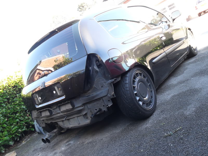

Cars back off the road for awhile, as I need 4 new tyres due to the crazy amount of positive camber i was running, which now has being sorted as i bought some camber gauges and set it all up properly.
then Just a quick taster before they get sent off for refurb. :)

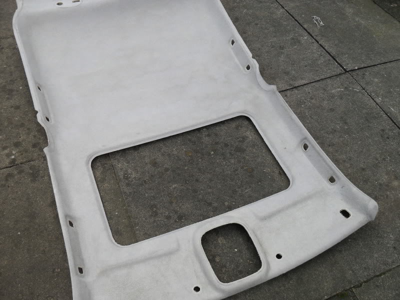

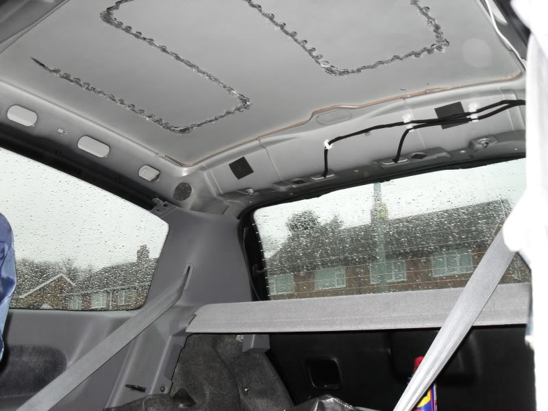

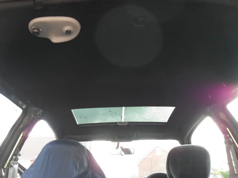

Headliner before
Headliner after

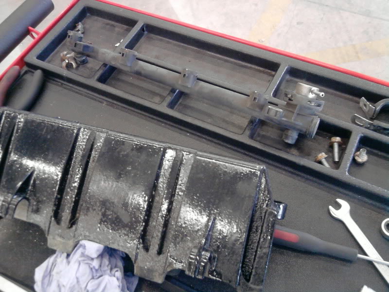

[FONT=Times New Roman]A company call ASNU came into college to show us how they clean fuel injectors etc, and said if i took mine out i could have it done for free, so me being me, Got the car in the shop and took the injectors out and got them all nice and cleaned with new fliters in and O rings.[/FONT]
[FONT=Times New Roman] [/FONT]
[FONT=Times New Roman][ATTACH=full]737646[/ATTACH][/FONT]
[FONT=Times New Roman]fuel Rail out and injectors.[/FONT]
[FONT=Times New Roman][ATTACH=full]737647[/ATTACH][/FONT]

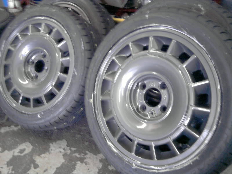

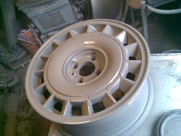

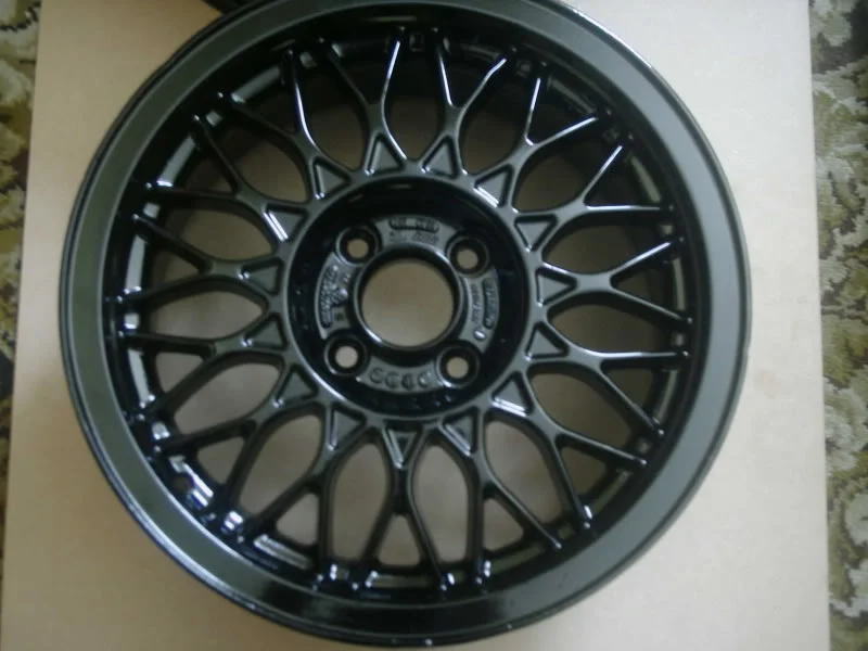

[FONT=Times New Roman]Then Got a Phone call saying my wheels were ready to be picked up :)[/FONT]
[FONT=Times New Roman][ATTACH=full]737648[/ATTACH][/FONT]
[FONT=Times New Roman][ATTACH=full]737649[/ATTACH][/FONT]
[FONT=Times New Roman][ATTACH=full]737650[/ATTACH][/FONT]

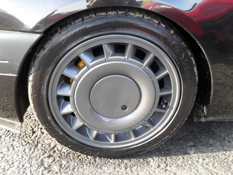

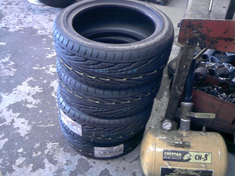

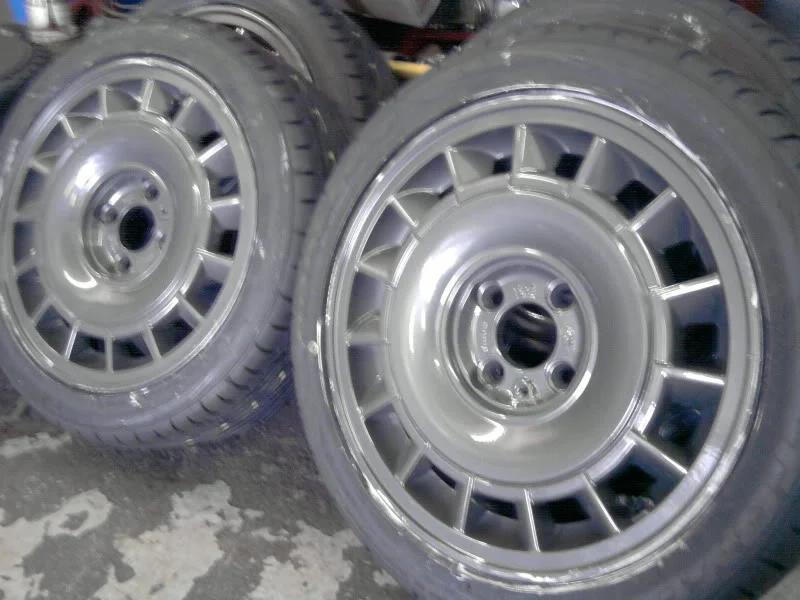

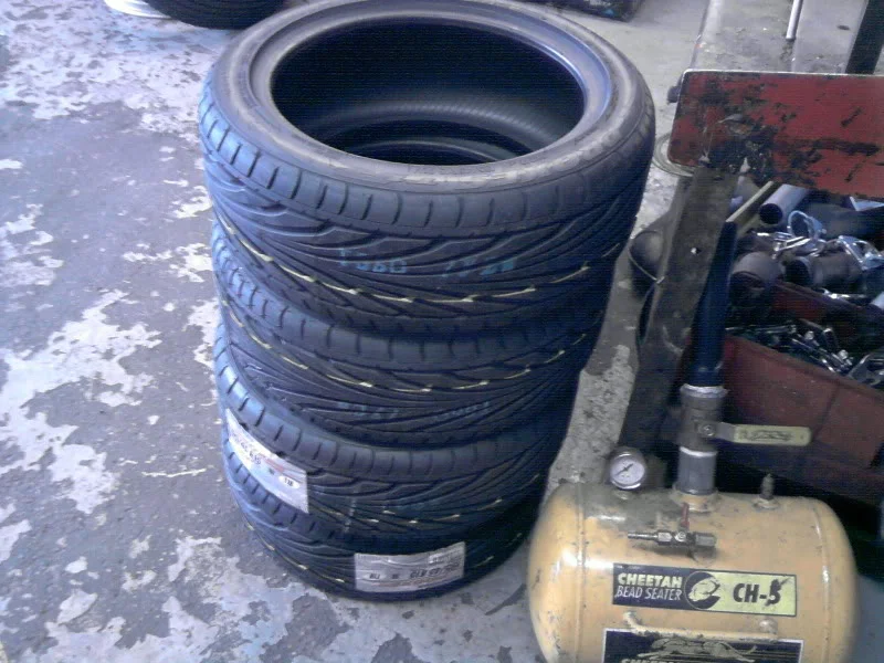

[FONT=Times New Roman]Then while at work, i bought myself some lovely new rubber, toyo proxes, cant beat them![/FONT]
[FONT=Times New Roman][ATTACH=full]737651[/ATTACH][/FONT]
[FONT=Times New Roman]then on my lunch break i decide to fit the tyres and Balance them, also tracked them up :D[/FONT]
[FONT=Times New Roman][ATTACH=full]737652[/ATTACH][/FONT]

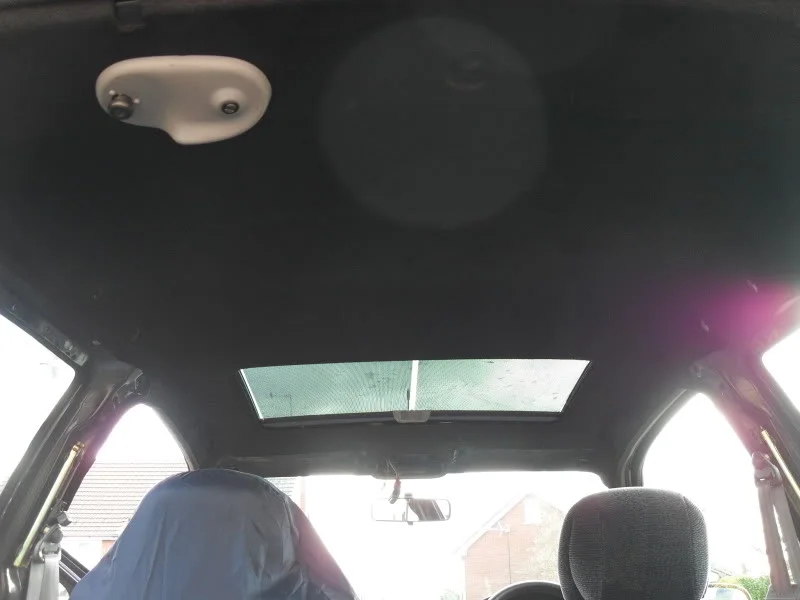

[FONT=Times New Roman]then got home and put my roofliner back in[/FONT]
[FONT=Times New Roman][ATTACH=full]737653[/ATTACH][/FONT]

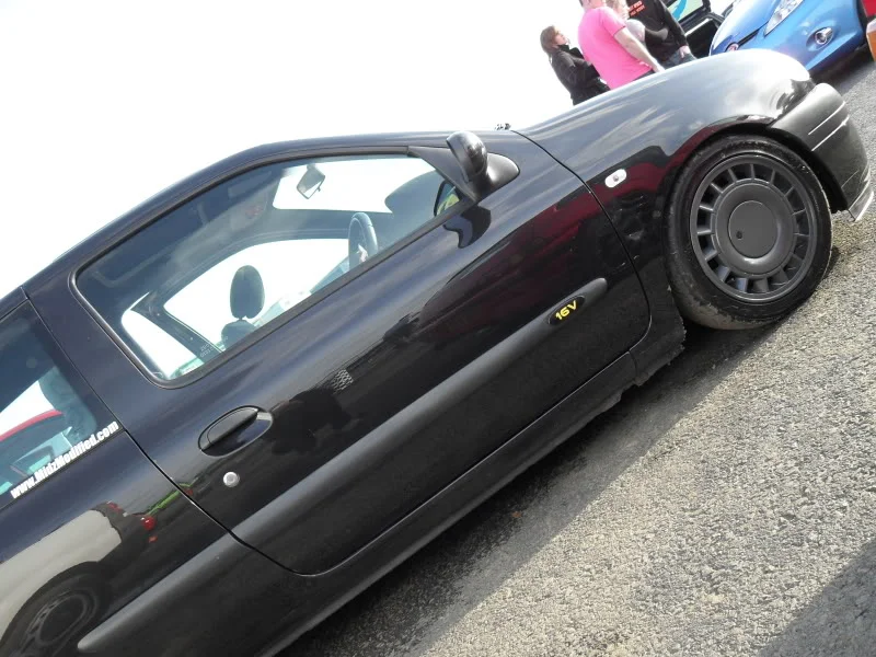

[FONT=Times New Roman]And Then had to get it ready for fast show, so heres a few photos from the pod.[/FONT]
[FONT=Times New Roman][ATTACH=full]737654[/ATTACH][/FONT]
[FONT=Times New Roman][ATTACH=full]737655[/ATTACH][/FONT]
[FONT=Times New Roman][ATTACH=full]737656[/ATTACH][/FONT]
[FONT=Times New Roman]The interior wasnt ready so i couldnt put it back in, however should be done in a few days. Few suprises coming this way aswell but youll have to wait and see :)[/FONT]

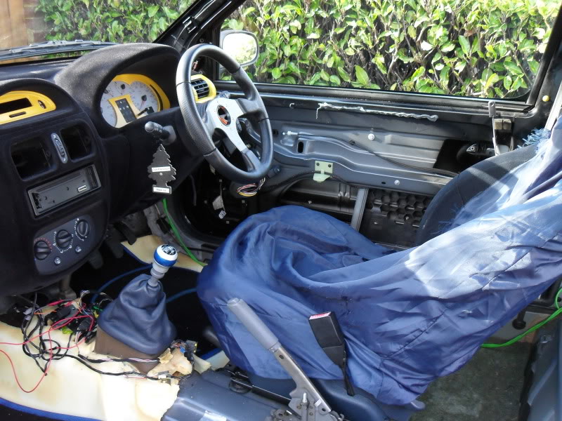

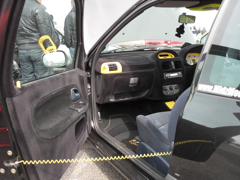

[FONT=Times New Roman]Interior is all back in and been flocked.[/FONT]
[FONT=Times New Roman]Carpet is now black.[/FONT]
[FONT=Times New Roman]False floor finished[/FONT]
[FONT=Times New Roman]and airbrushing done by marian :)[/FONT]

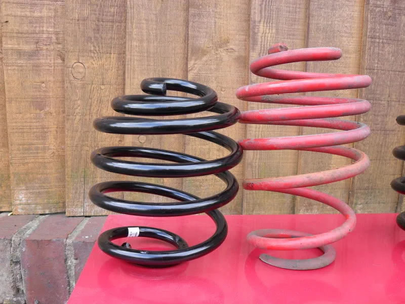

UPDATE 15/06/10

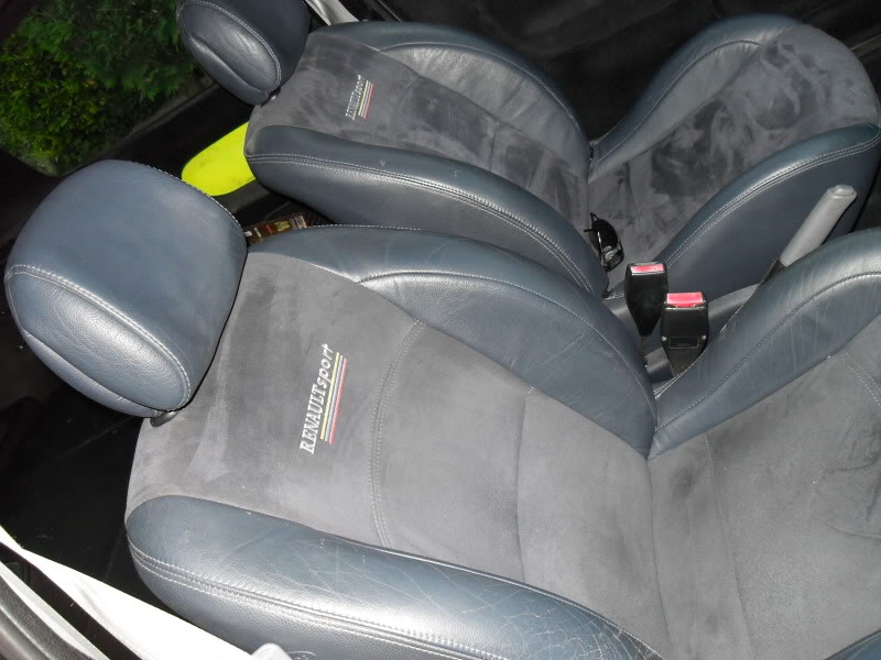

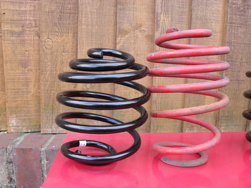

Havnt upated in a while, but after ISTS i went on the hunt for some seats, but i couldnt afford the buckets i wanted, so i found a set of renaultsport 172 seats for £80, not the best but they will do until i find a good set of buckets.
Also as ive removed my rear seats etc, the car didnt sit right and i had the coilies as low as they could go, so i decided to get a set of custom 90mm springs for the rear made up :)
new custom spring Vs. vmaxx spring
Before
After
Also my seats fitted.

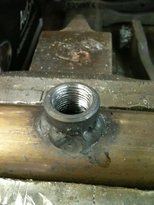

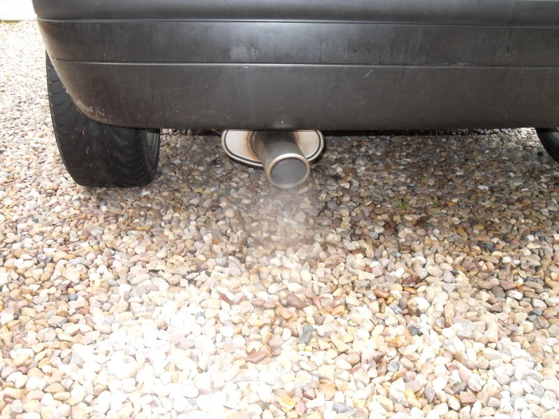

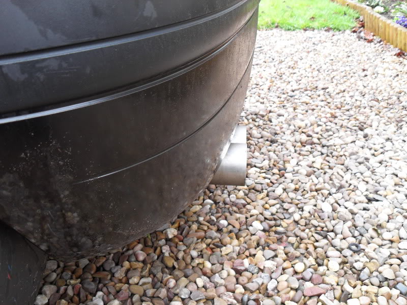

Well the end of last month it was MOt time, so old lights on, Cat back on etc. Passed the MOT but The lamba sensor was pretty much past it, as it was a universal one from when i had my decat made up. So I bought a proper one, non of this universal crap.

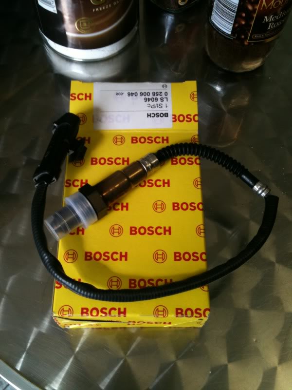

Then when i came to fit it to the decat it would just not fit. On closer inspection, where the lamba sensor hole was, there wasa ton of weld all over the bottom of the thread, as the tip of the new sensor was slighty wider, this meant alot of filing and retapping the hole was in order, Best bit of kit i have bought would be a nice new tap and die set.
Freshly tapped thread
Nice new sensor fitted, what an improvment a decent sensor can make :)
while i was doing this i need to replace my engine mount aswell, so i did that too, Also my brakcet for my induction kit had broke a while ago, so matty made up a ncie new one for me! Nice one!!!

Right then, The Clio is now off the road for winter, and I've picked up a nice run around.
The Car is going through a few changes, Mainly engine wise, as i new engine shall be replacing the 1.6 as i need boost! Also I'm gonna get a few bits of bodywork done aswell to freshen it up as i feel the bodywork is not too good for being 11 years old. The interior is gonna be freshened up abit aswell, maybe new seats, and might change the flocking, Plus a few other goodies.

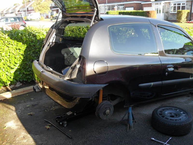

Anyway. So far Ive stripped the rear interior out as it needs repairing, or may change it.
Then I stripped the rear of the car down.
Then Test fitted the bumper ive smoothed.
All thats left to do is get rid of the hole for the light and relocate. Also ive started to make a new numberplate holder for the rear aswell.
Then I put the wheels back on and rolled her back onto the other drive, so this is her current state.
More updates soon :)
UPDATE! 27/10/10

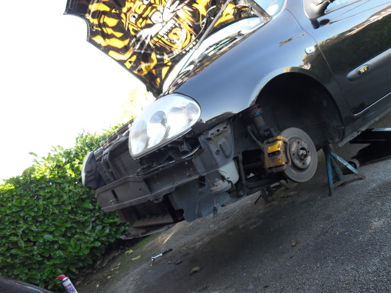

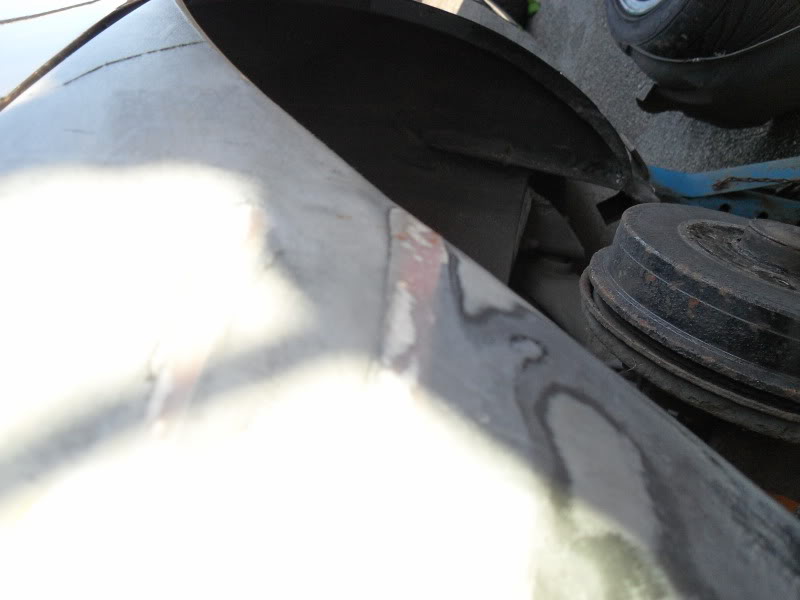

Started stripping the front down :)
Bumper off
Wing off
Other wing off
The front is pretty solid, no rust apart from a small bit of surface rust on the sill. But will sort that out!
Gonna give it a quick going over and paint it to protect it aswell.
Some goodies shall be coming sunday, so keep watching!

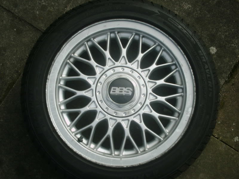

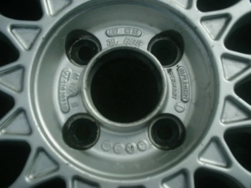

sorry if i missed it but how come you didnt put the bbs on??
i like this project though
Re: The Black clio Project, From Day 1.
Good Effort! Have to agree, the BBS wheels were sweet. Love the interior.

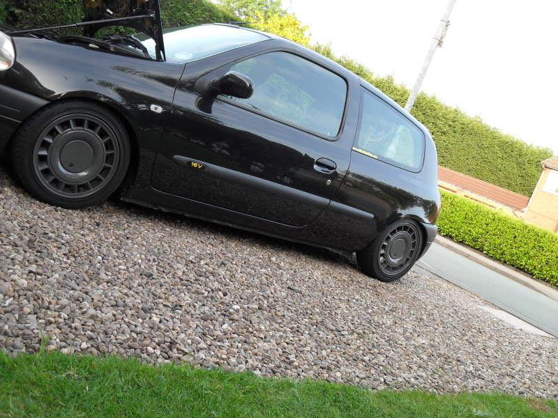

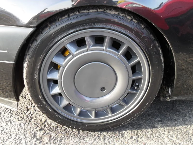

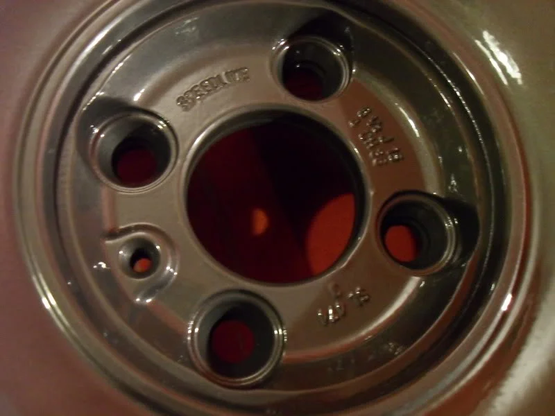

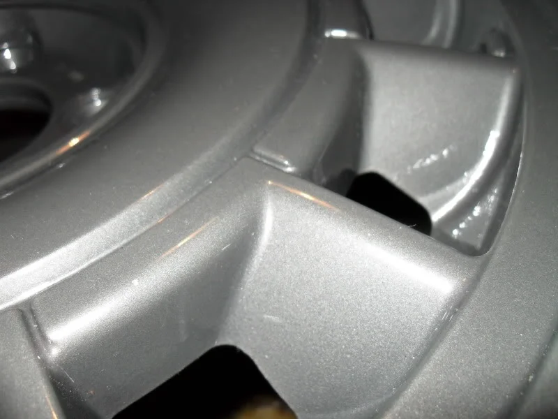

It took the company ages to try and do a proper job, the centre rings and caps, were destoryed by them, Im sure i have a photo somewhere of the damage they did, I also had to get them bored out, so in the end i just put them up for sale and got some money back, wish i had kept them at the time now, But new wheels shall be going on next year i think :)

UPDATE 16/11/10
Bonnet removed, just getting a few other things sorted so i can drop the old engine out.
Started stripping the interior out more aswell.
All the dash removed, all doorcards removed now too, time to get that loom out :)
Also got a few more goodies to go on etc so will update more soon.
cheers.

car looks really good, must of spent a few quid! whats the name of the colour for the wheels? thinking about gettin my 172 ph2`s done the same lol.
Cheers bud, When i sent them into refurb, i asked for gun metal grey, and he said thats the closest they had to it :)

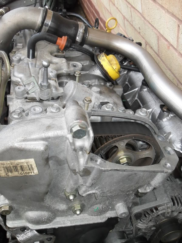

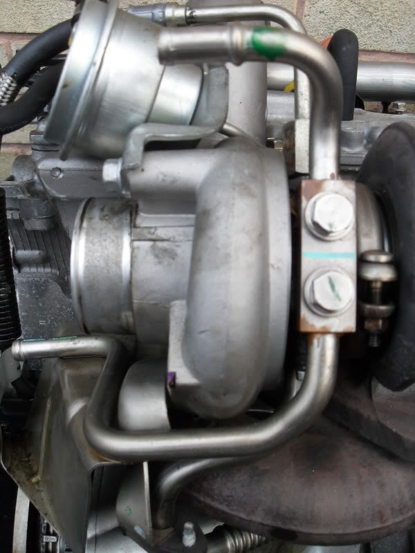

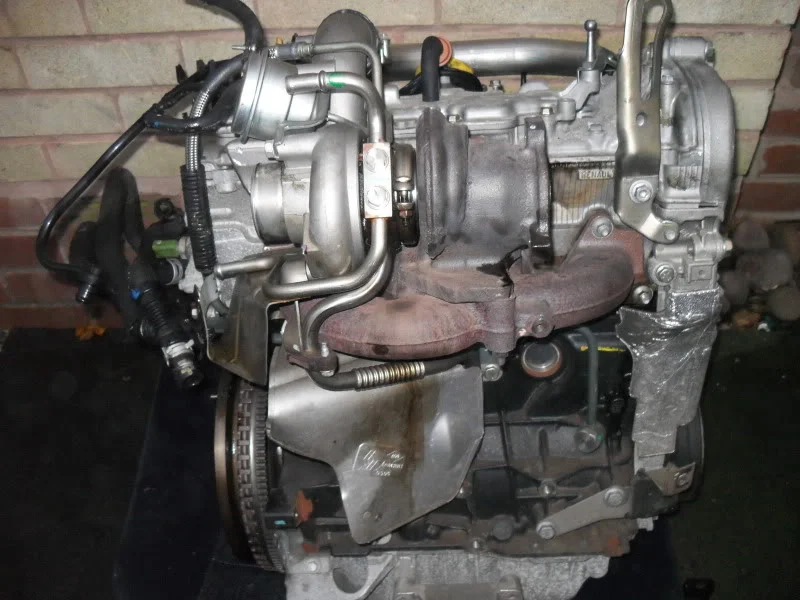

UPDATE 19/11/10
Oh hey 225 F4R Turbo block :)
Now the fun starts :)
