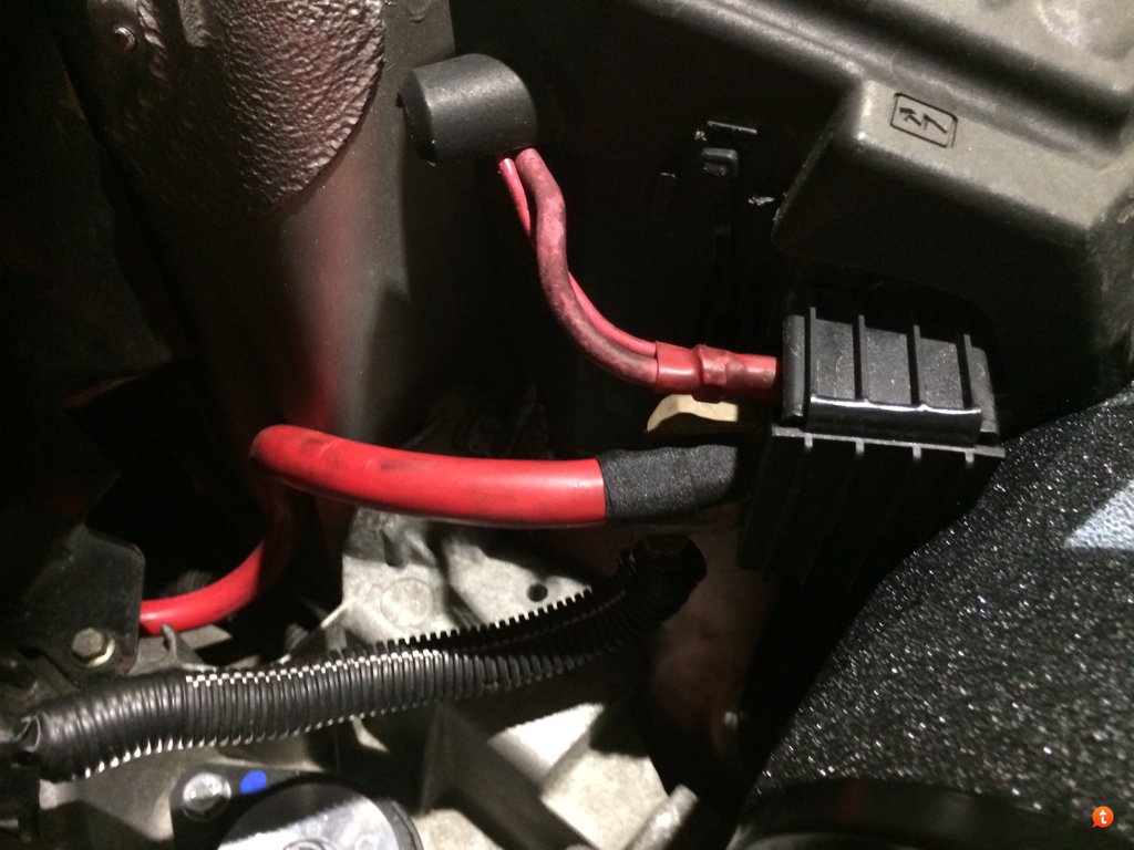

I will take a few more pictures tonight to help people. I've got one of those mega fuses to fit. Went for 250amp fuse.

I crimped the cables! yep pretty thick, Its hidden going through the car and I got it through the where the bonnet release cable goes through.

Looking into doing this, is going through the bonnet release grommet the most common route people use?
I want to move the battery to the boot if it's not too much hassle
  Clio 182 FF
Yep bonnet release grommet is the best route, just need to remove the expansion tank to gain access.
GrahamS
  335d, GT4
You shouldn't need to remove th expansion tank. I've put loads of stuff through the bonnet release grommet and haven't had to remove it.
